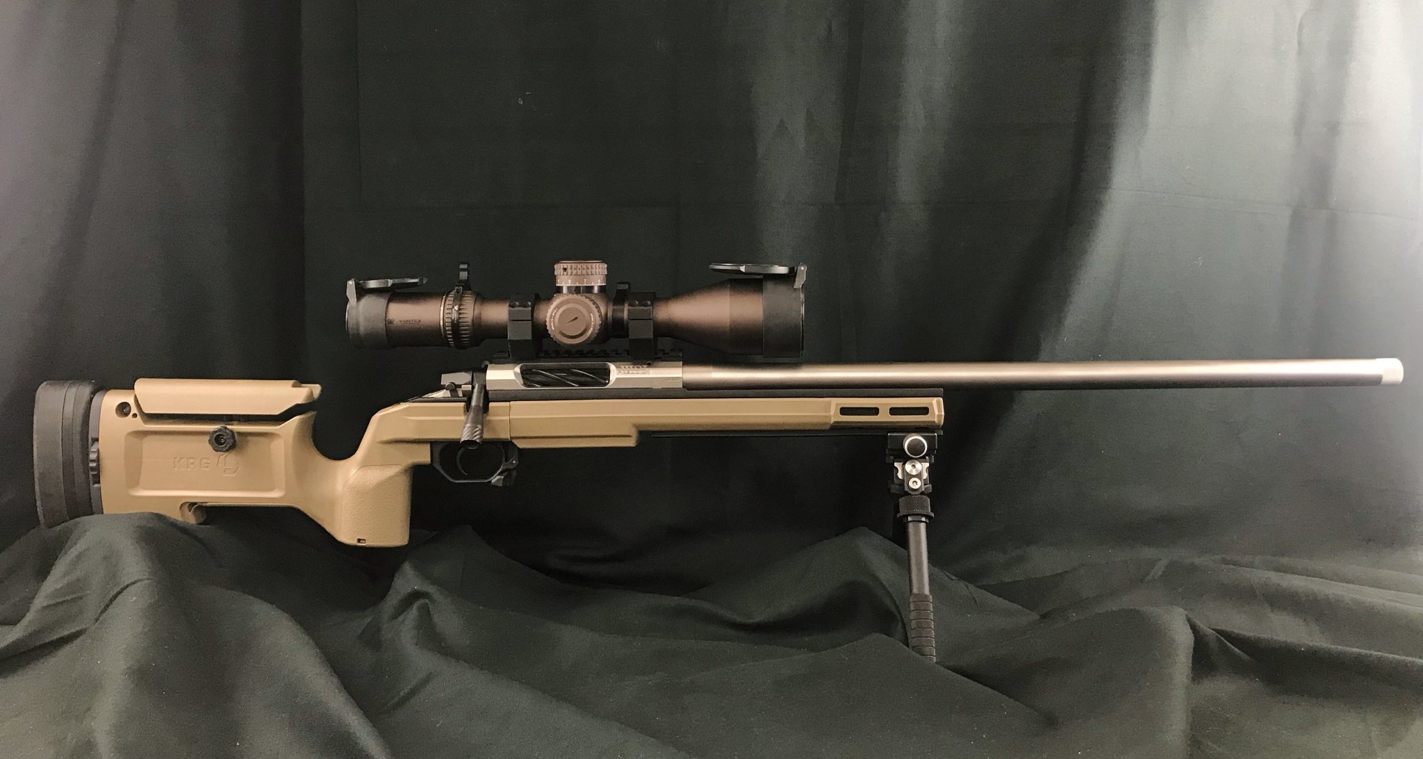

Finally picked the rifle and everything else up today and mounted scope. KRG took a little finesse with about 50 thousands taken off mag catch latch to allow for mag function, and bolt hits the cheek piece once high enough. It’s definitely touching where I like it so I’m going to add a cheek eez pad to keep from altering the polymer any. Other than that it’s a plug and play with the Havak. This is a newer batch of Bravos so it already had the recoil lug area relieved.
Guys the action is like glass once you drop a little lube on the lugs and the bolt stop channel. The little bit of binding/roughness that guys might feel is from bolt stop having a pretty heavy spring to it. I dropped some Wilson universal lube in the stop channel and it ran like butter and only getting better. I cannot wait to shoot this thing!
Send KRG an email and get a tikka cheek rest, it will fix the bolt hitting it.
