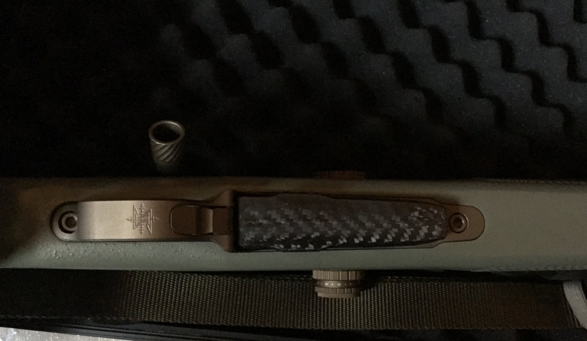

Got my Havak in today. Fit and finish is stellar. Bolt lift and throw is a bit heavy but I expect it to loosen up a bit. Bolt does not bind or is not gritty. I wiped it down with a clean rag, used a bit of lube and it was very smooth. Trigger is crisp, a little heavy for my liking but it can be adjusted, probably 3.5lbs. I was definitely bummed it did not come with the carbon fiber mag, as I was told by the customer service rep that it would. Action to barrel fit and bedding appears to be well done. I mounted it up with a Bushnell DMR-2i, Harris bipod, Short Action Precision sling, and a Seekins ATC muzzle break. I will definitely be cerakoting the silver action and barrel to a matte or graphite black. Before that I will be shooting it tomorrow with factory Hornady 143 ELD-X and 147 ELD-M. Will make a post regarding accuracy and velocity on Labradar. I'll put pics up soon! Purhase time to my FFL was a little over 3 months!
@ChiefSillyHorse So you got a Creedmoor if it did not come with a cf mag? Not a PRC?
I got a 6.5CM no carbon fiber mag, only a magpul AICS 5rd. I'm gonna email them about it but I'm sure they will say that they cant keep up with production or something. Just kind of a bummer since that was a very unique part of the rifle I was interested in.

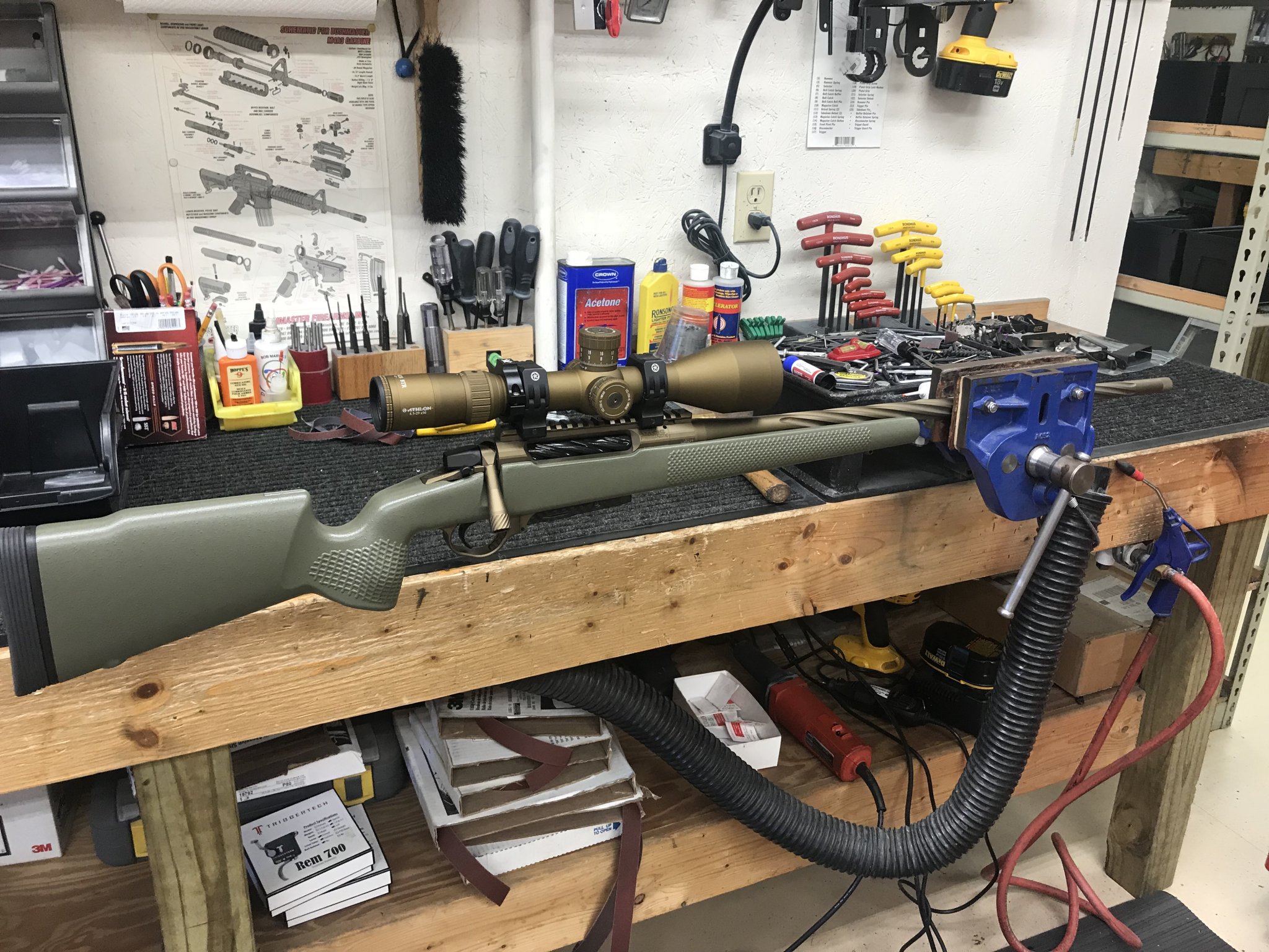

Seekins Precison Havak 6.5creed
Brand new in box Medium height 30mm badger rings.
Freshly pulled Nightforce NXS 2.5-10x42 glass.
Mounted everything up, ran out of windage to thr Left.
Ran out of elevation going down. Rifle shoots 9” to right at 75yards and 4” High.
How in the hell is this happening!??!
I pulled the Nightforce, pulled the rings, and remounted. Same results.
I have Seekins rings in the mail - but I’m out in the woods hunting and they are 120 miles from me.
Super bummed.
Here she is.
I don’t understand. :-/

I’m super confused.
The only thing I can come up with is the Seekins rail isn’t square? It’s factory installed and I don’t need to adjust right?
It doesn’t look like it can adjust.
I’m heading home from hunting this PM and will slap Seekins rings on to check.

Okay, I feel like a total dork. I’m home now.
I thought I had pulled the Nightforce cap (Allen) and adjusted windage, and I had only pulled and adjusted the elevation knob - not windage. Triple checked myself just to be sure and found it.
I’m good on windage which was my biggest worry. I’m out of elevation and still shooting high - but I’m sure that’s the 20 MOA rail.
I was slinging Barnes lighter weight pills and I’m going to be hunting with 143gr ELDX - which I just picked up and will try to sight back in shortly.

That nightforce has 100 MOA of elevation adjustment, a 20 moa rail isn’t going to max you out. Did you readjust your zero stop to accommodate for the rail?

It’s actually the 2.5-10x32 non-zero stop model. My other NF Zero-Stops have 4 Allen’s after pulling caps, and I didn’t realize after pulling the cap there was 1 Allen screw horizontally that allowed me to adjust more elevation on the non-zero stop model. The instructions don’t say anything of the sort.
Got it figured out - and can’t wait to shoot again this weekend up hunting!!! :)
