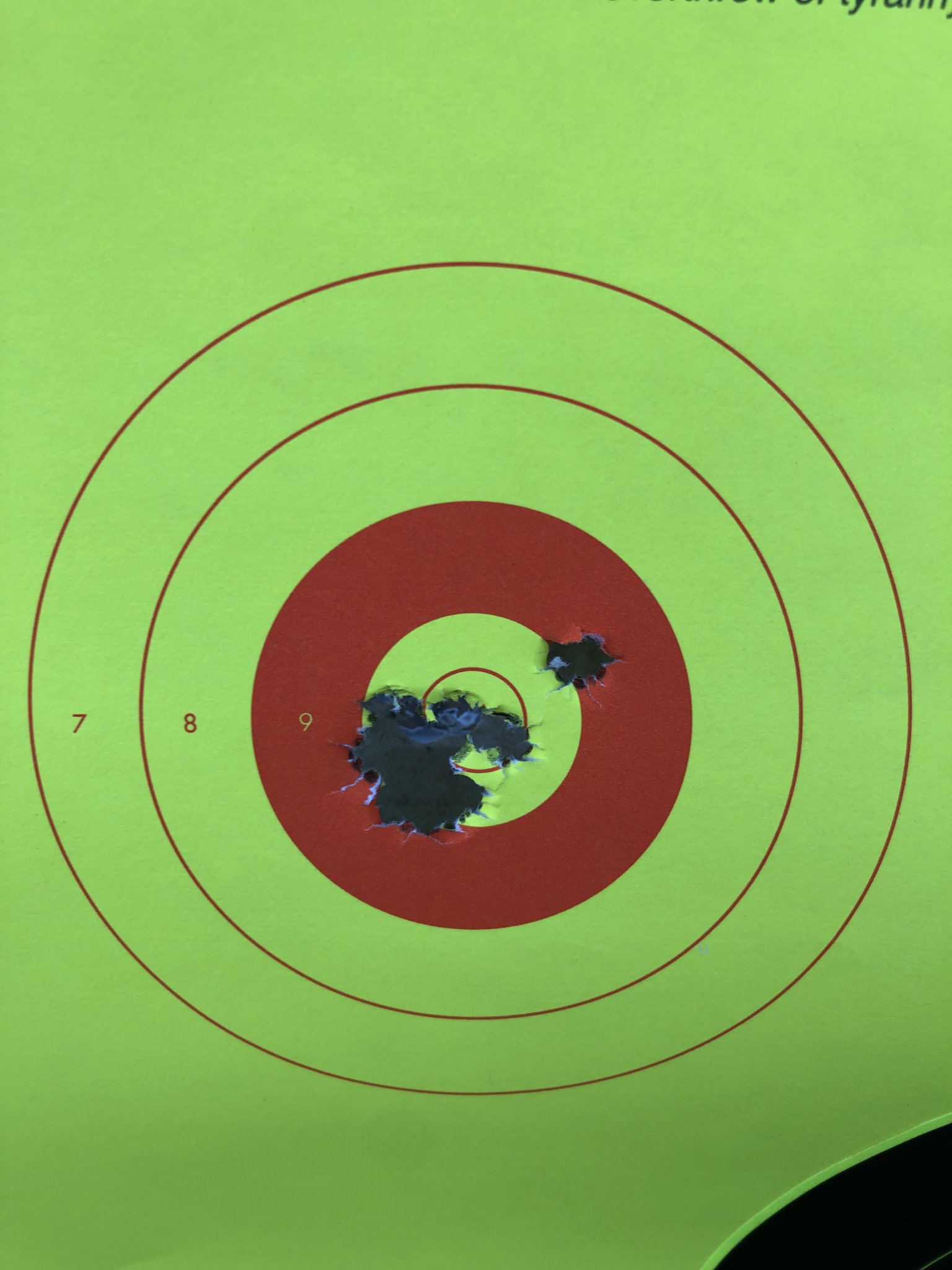

I tried 200g Edge TLR’s with H4831 and it shot decent at 50yd but then went to hell at 100. The 200g accubonds it’s just a crapshoot. You may be onto something with the barrel rigidity. Did yours have bad copper fouling? This one I can shoot 15-20 rounds and the lands are coated in copper and it takes hours to get out with CR-10.

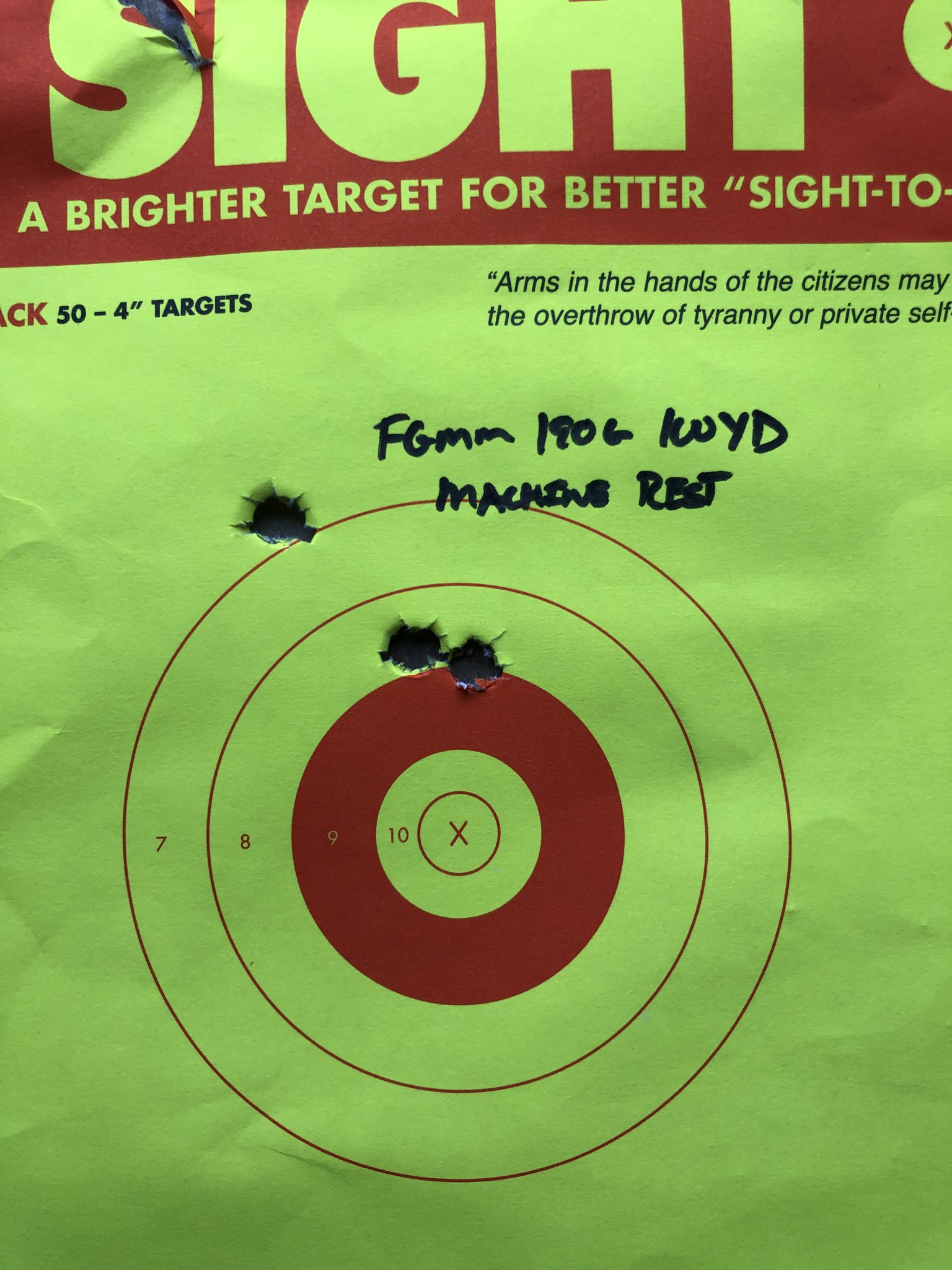

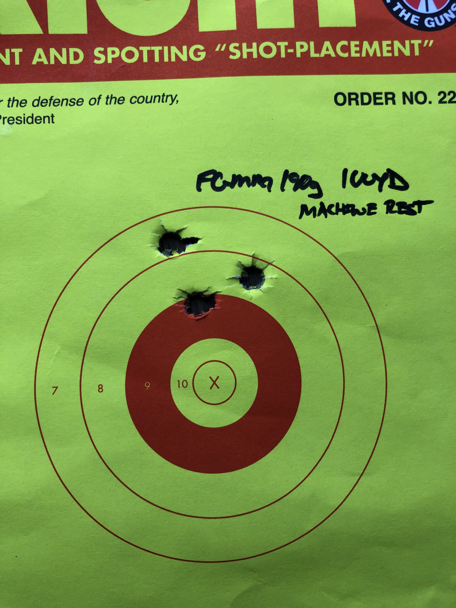

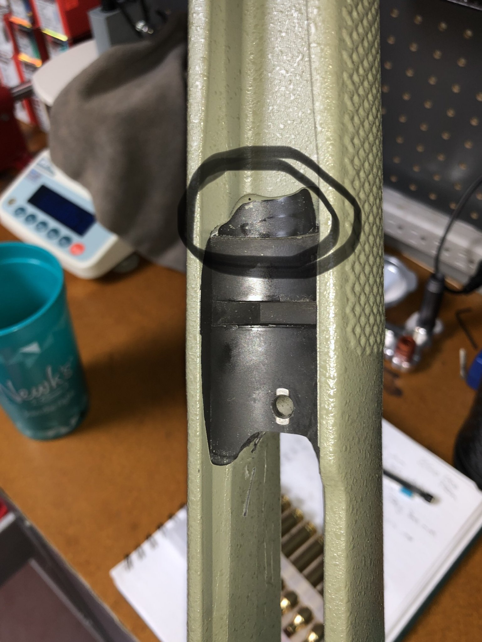

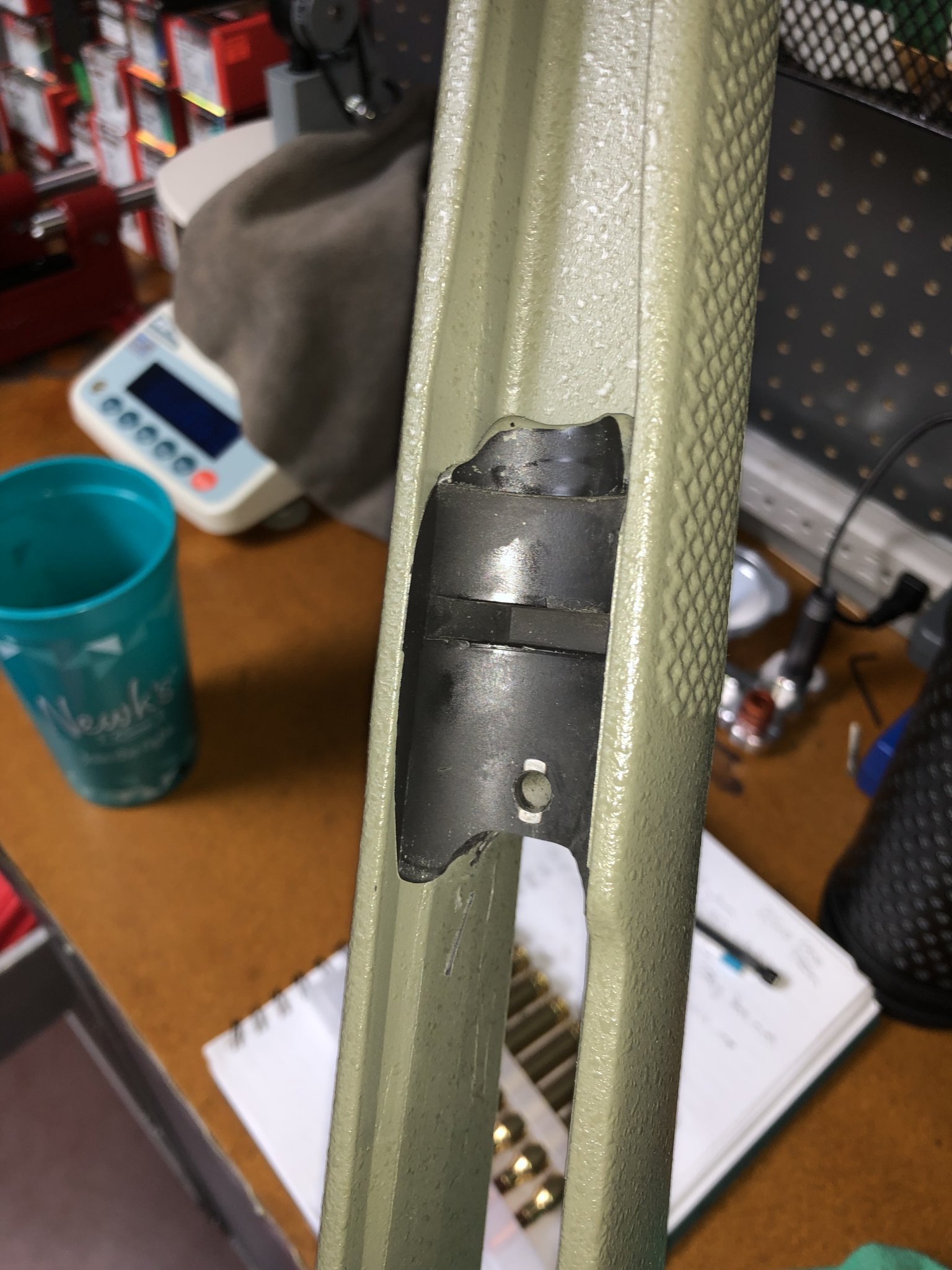

About to test some 190g FGMM per Seekins and I am examining everything before range time. All of my rifles are in chassis so not that familiar with bedding...Is that spot ahead of the recoil lug normal? Most bedding jobs I’ve seen end at the recoil lug/end of receiver. It is supporting the first .75”-1” or so of the barrel after the action. If you slide paper down the barrel it stops .75”-1” before the receiver face.
It's a common bedding technique. I've done it and seen gunsmiths do it that way and swear by it. I've also often seen and done the full free float technique. I've seen both ways work extremely well to maximize a rifle's potential.

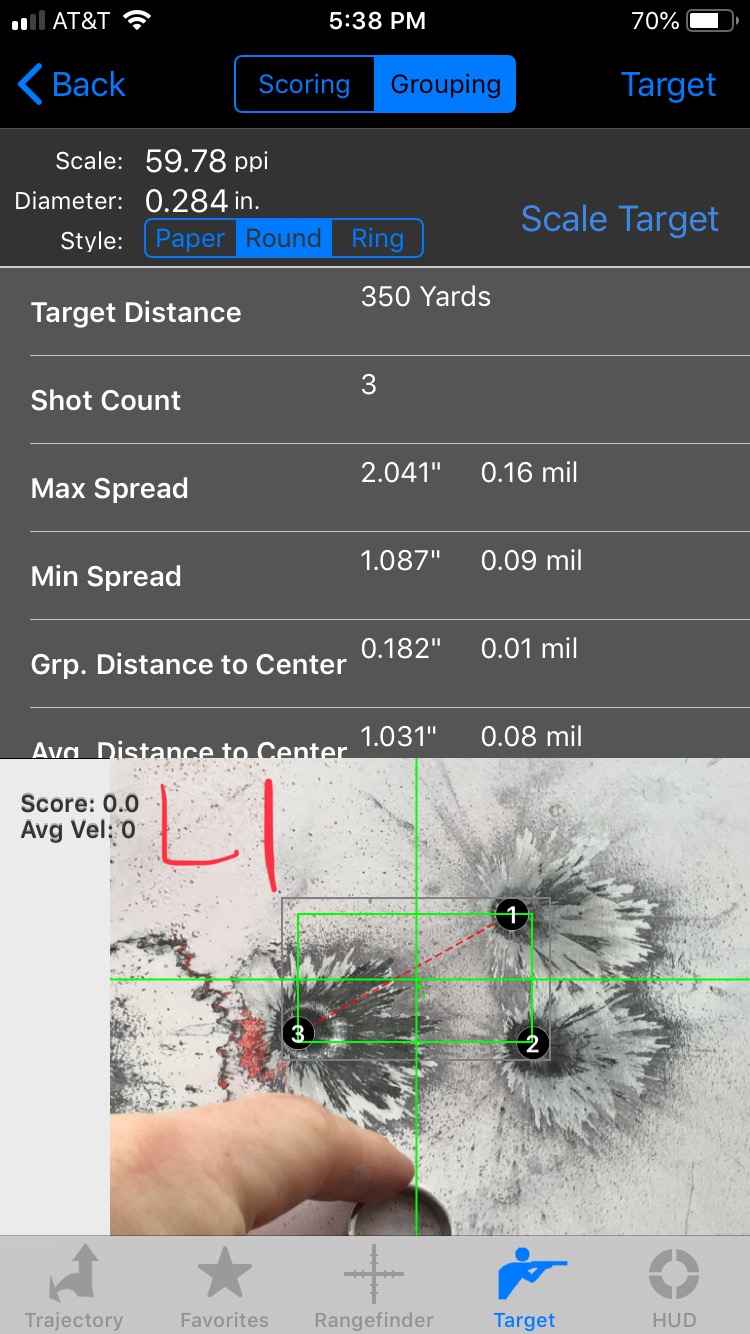

I received my 300 WM ph1 back today. Looks like they did a lot of work.
I assume the single target is the one they shot with the Berger factory 215 ammo I sent with the rifle. I’m guessing the others are with federal gmm 190 smk but asked for clarification. 12 of the Berger rounds were shot so it makes me wonder what the other ones looked like. If the brake was loose, I wonder why they didn’t shoot another group with it tight.
I’ll throw some rounds together and try to do some shooting on Sunday.
Holy smokes! That work order is crazy. Sounds like they shipped out a boat anchor the first time. Hopefully the completely NEW rifle replacement is better for you.
Jeez Louise! I’m pleased they fixed you up which shows great (followup) service, but worried about that list being an indicator of the initial QC, as apparently a boatload of stuff needed to be redone. Again, for this price, all weapons should be test fired and none should leave the shop if the can’t hold 5/8 inch or smaller groups off sandbags.

The barrel wasn’t concentric...and the headspace was wrong!? Woof
They responded to me today and said the bedding should not have gone past the action and the barrel should be full free float. So I will be taking care of it and trying 190g fgmm and 200g precision hunter.

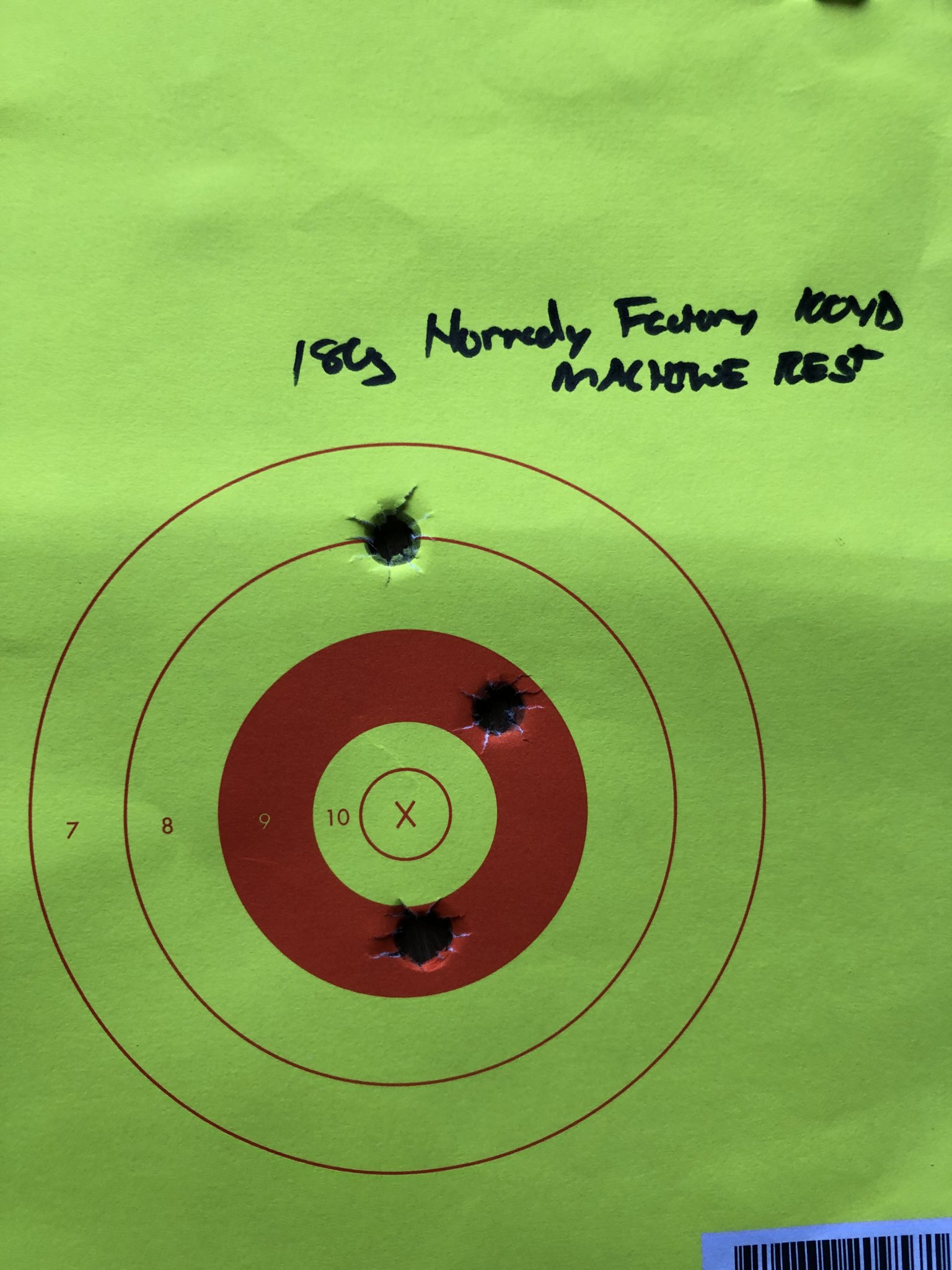

Filling out RMA form now, just got back from the range. No real difference after removing excess bedding.

Might try a load in either extreme like the Barnes 175 LRX and maybe a Hornady 212 ELD-X load before it goes back.
Sometimes they just don’t like a load. I couldn’t get the Hornady loads to group anywhere near what I wanted in my sendero, but 175 LRX did dandy.
Sometimes they just don’t like a load. I couldn’t get the Hornady loads to group anywhere near what I wanted in my sendero, but 175 LRX did dandy. View attachment 7003524

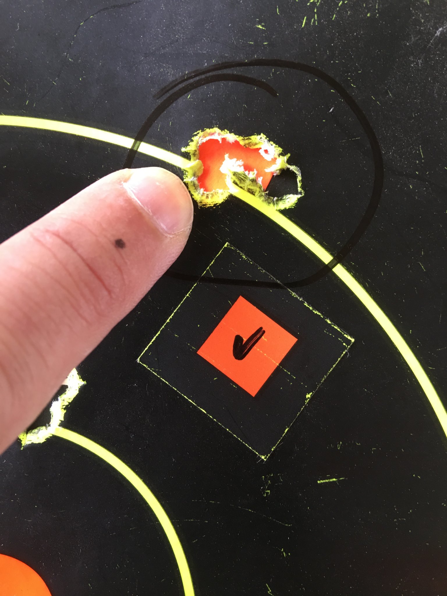

I’ve tried 200g accubonds with RL23 and h4831 (ladder test). 200g Federal edge tlr with H4831, and hornady precision hunter 200g eld-x. None would group well. They said they test with 190g fgmm so that was my last test before giving up. The groups above are 190g Fgmm and 180g interlock Hornady custom factory ammo. A $2000 rifle shouldn’t be this difficult. 3 of the 4 groups above are using a machine rest with hydro dampers and a remote trigger actuator. For the reloads I’m turning necks(gives me 2 thou tension), using comp dies, and measuring the powder to the kernel with a fx-300i scale. Your group is what is expected to find through all of this testing.
Pretty frustrated at this point as I’ve spent almost $200 on factory ammo, and had to make 4 range trips to range that charges $20 a trip since we don’t shoot on our land during deer season.
I let my wife bang out 9 rounds with one of my other rifles, only the second time she’s shot it. Just adds insult to injury!

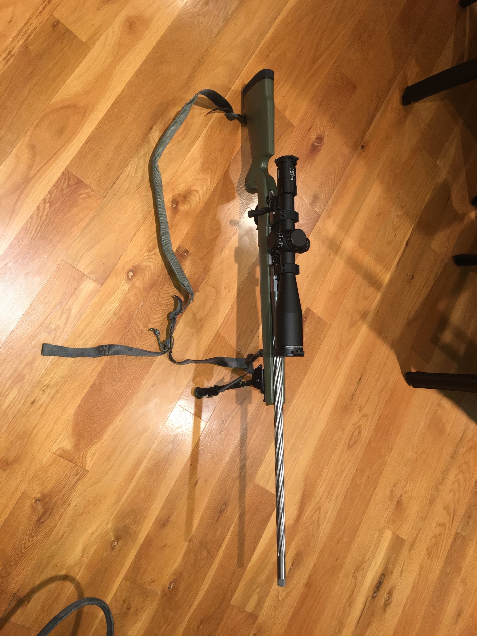

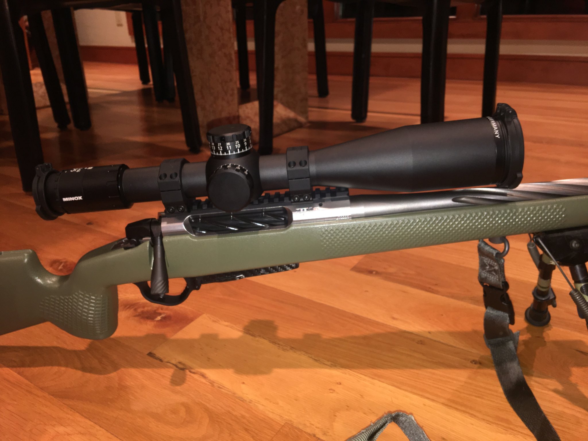

Got my 300
rigged out.
Here’s a tidbit I was not aware of.
The long action only takes the Carbon fiber magazine unless you completely swap the bottom metal and fit a different one for it.
I was rather hoping to use the Pmag 5L Magnums as well in the current configuration.
Oh well, it still looks damn good. I’ll get a range report by Saturday with 2 loads I have already.

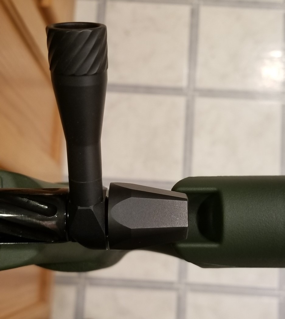

I put mine in a Havak and found a few issues.
First the mags would not lock in place. I had to remove over 0.060" off the magazine release lever to get them to latch, seemed excessive. From Seekins "The magazine latch will need to be trimmed down slightly to allow the mag to seat and engage the latch correctly. On the New havak bravo this part is modified here to make the two work together."
Then the bolt won't cycle fully as the cheek riser gets in the way. KRG only advised I contact Seekins. Seekins just said to cut it. "The only way to get a round this would be to Dremel out the lower portion of that recess so that it goes clear through the cheek piece so it can clear." Asking if they modified that on their Havak equiped models "We are not modifying that part from the factory since you still have some adjustability from the factory setup." On my Tikka this is a known issue and KRG now cuts a half moon into the riser to get around this problem and sent a replacement riser out to me for it.

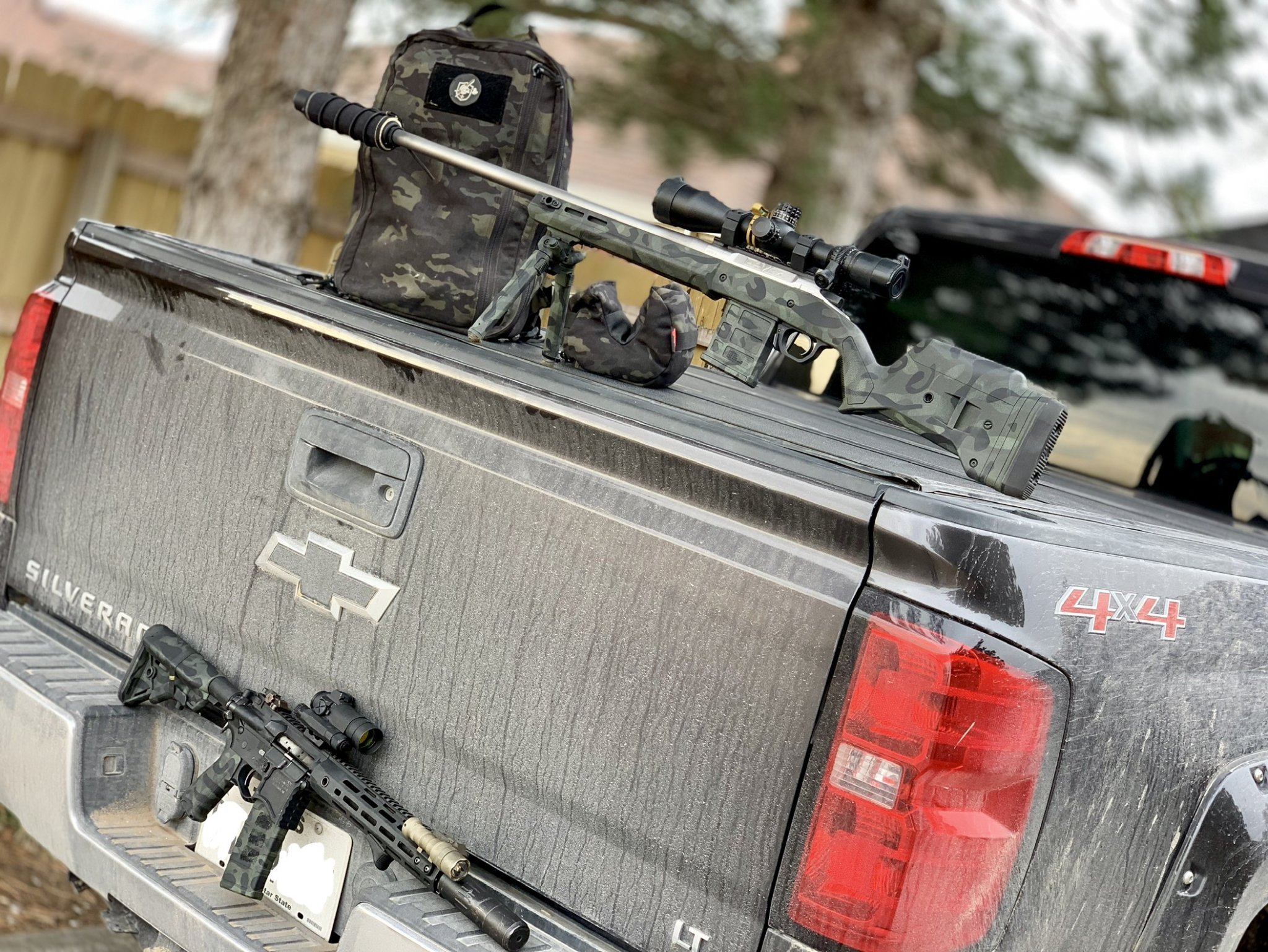

A couple groups I shot today doing seating depth testing. Off the back of my truck cover with abipod and rear bag.
28 Nosler
79.2 H1000, 215M, Nosler Brass, 180 Hybrid, MV 3085, these groups were .050-.065 OTL and had the best ES and SD.
Nothing spectacular, but not too shabby for a factory setup.
Weather was 30 degrees with 20 mph winds.
200 grain accubonds. Should be at 2900 FPS with a 26 inch barrel. That's a lot of oomph.
I will get out on a better day with more time. Pretty optimistic.

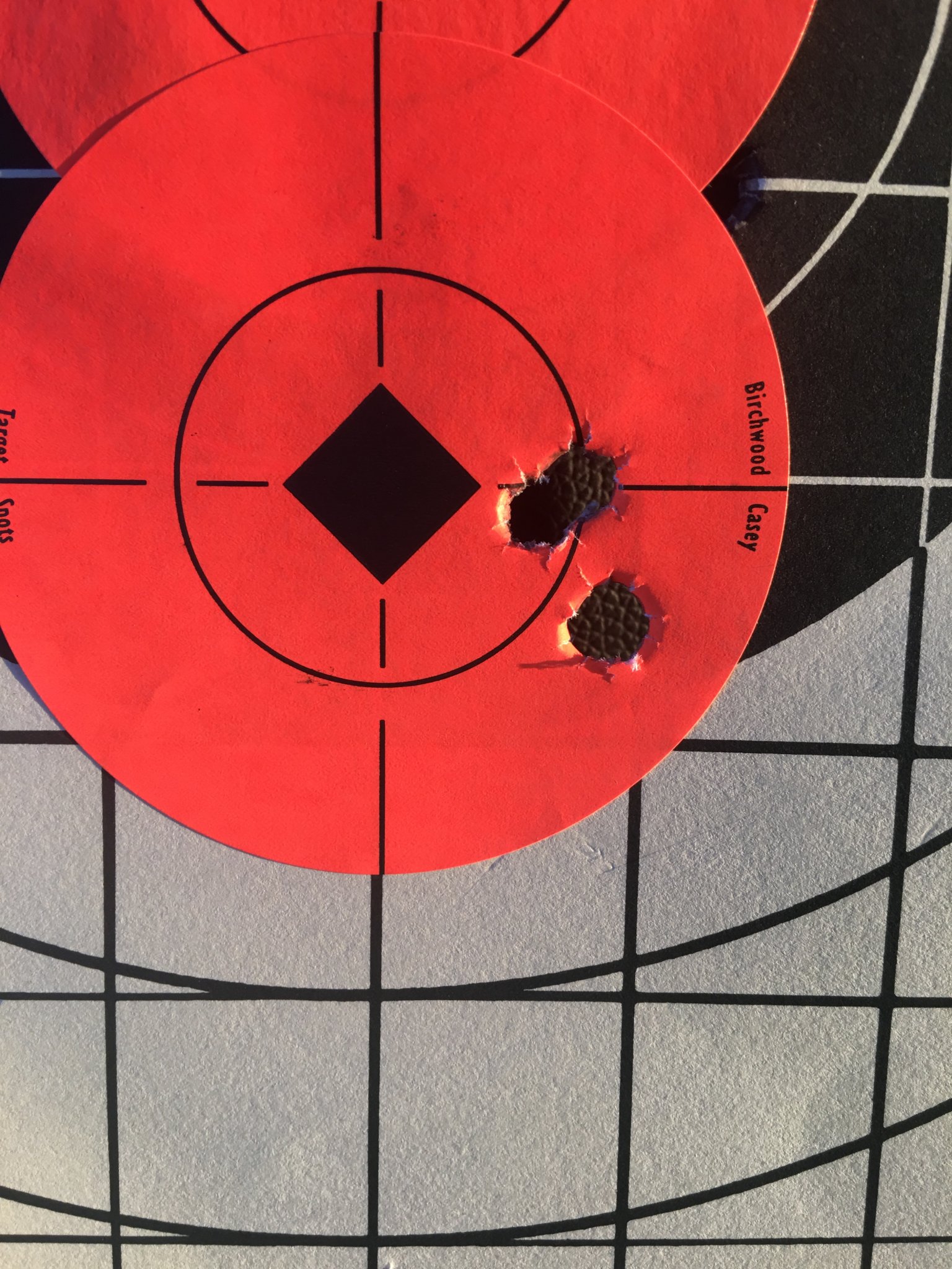

I put ten rounds each of Hornady 147 ELD-M and 143 ELD-X through the new PH1 6.5 PRC today. This was not before a thorough cleaning, inspection, and degreasing. Straight out of the box, the Havak’s Timney 510 recorded trigger pulls averaged 4 lbs. The 510 wouldn’t adjust much below 2.5 lbs. with any consistency. I swapped in a TT Diamond (set at 16 oz.), installed a Live Oak Precision self timing muzzle brake, and mounted an LRTSi 4.5-18x44mm in APA 0.750 rings.
The rifle was set up on a Ransom Rifle Rest and Protektor rear bag (front sling stud removed).
Temp: 30°F
Elevation: 60’
Pressure: 30.21”
Calm conditions
Hornady’s factory loads:
147 ELD-M (published velocity 2910, *IIRC- 26” bbl)
0.91 MOA (4 rounds)
2889ft/s (n=8)
2871 Low
2919 High
48 Extreme Spread
21ft/s Avg. below published
143 ELD-X (published velocity 2960, *IIRC- 26” bbl)
1.12 MOA (4 rounds)
2859ft/s (n=9)
2832ft/s Low
2879 ft/s High
48ft/s Extreme Spread
101ft/s Avg. below published.
These are sexy rifles. I love the ergos. My action is slick and smooth, yet tight and crisp. Hornady’s factory loads didn’t impress, but I’m hoping the rifle will shoot with hand loads.

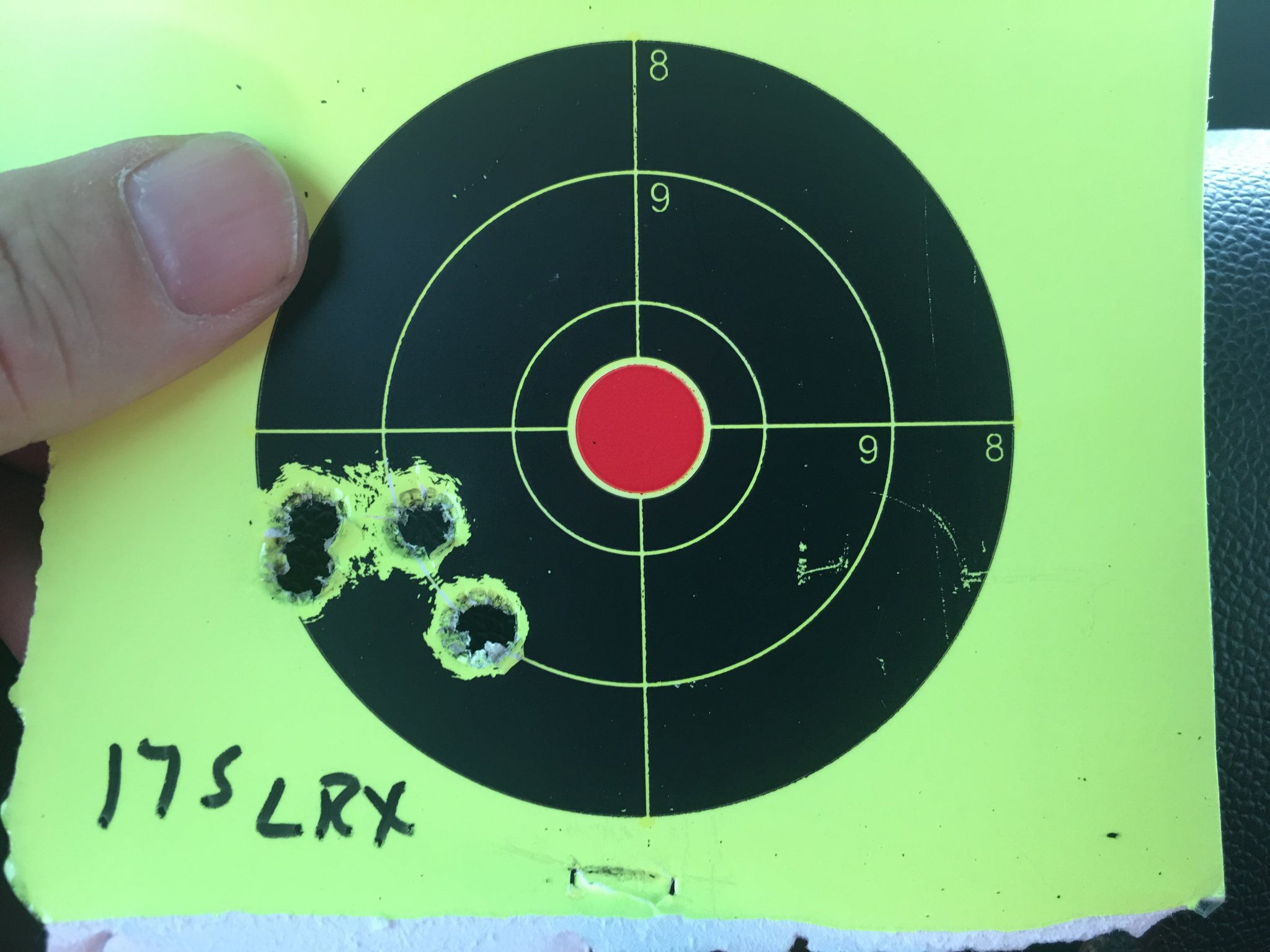

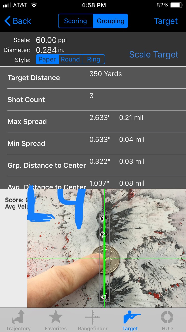

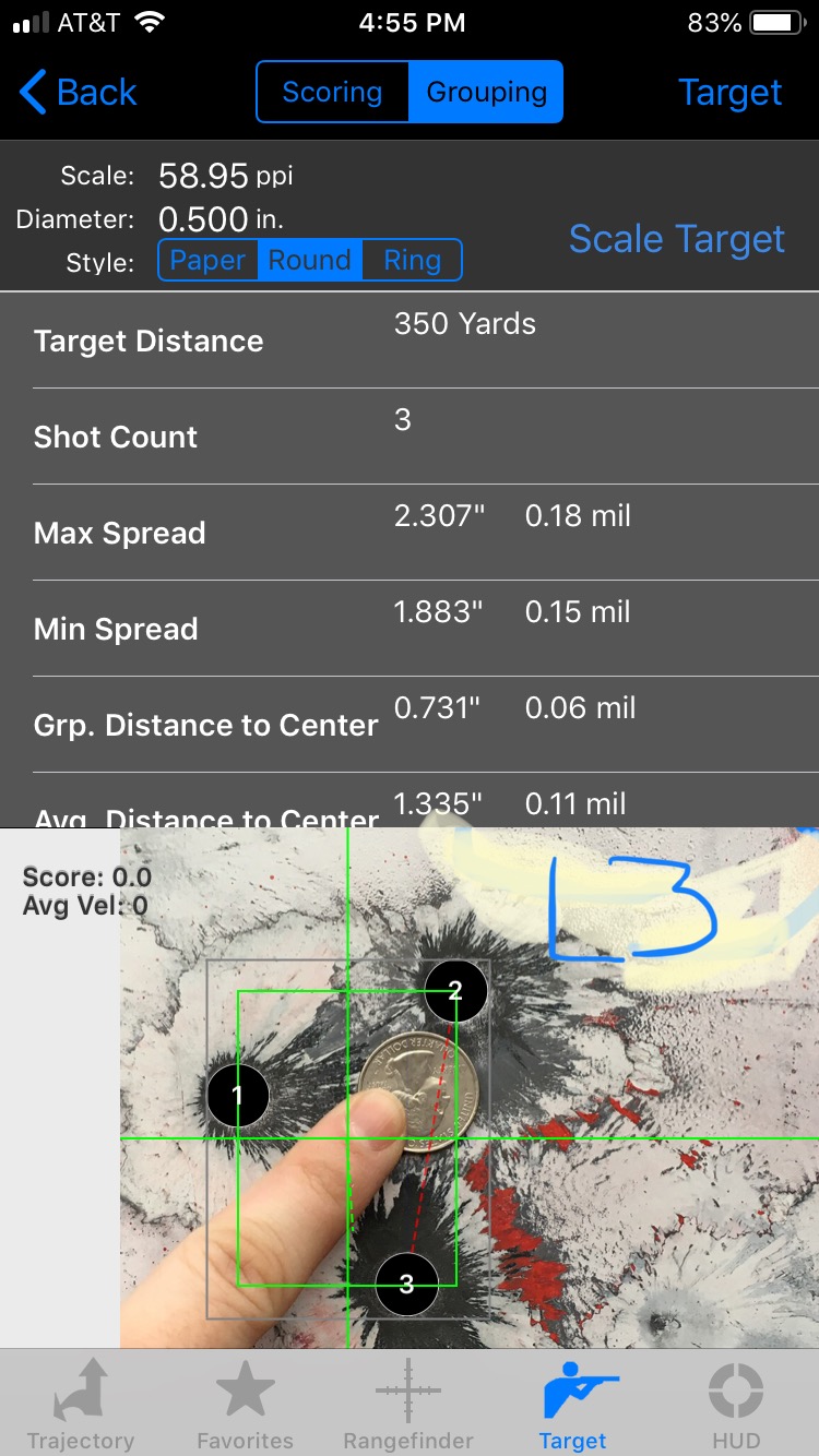

Too the 300 out again today.
175 Barnes LRX.
It’s a start
I fired this group free recoil.
Out of curiosity anybody seeing better results with a heavier hold vs free recoil with this weapon?
My sendero likes to be loaded into the bipod so I’ll try that technique next time.
Pretty close to it. My shoulder is against it but with zero forward pressure and with left hand controlling the rear bean bag. Like I said some guns work with it and others hate it.

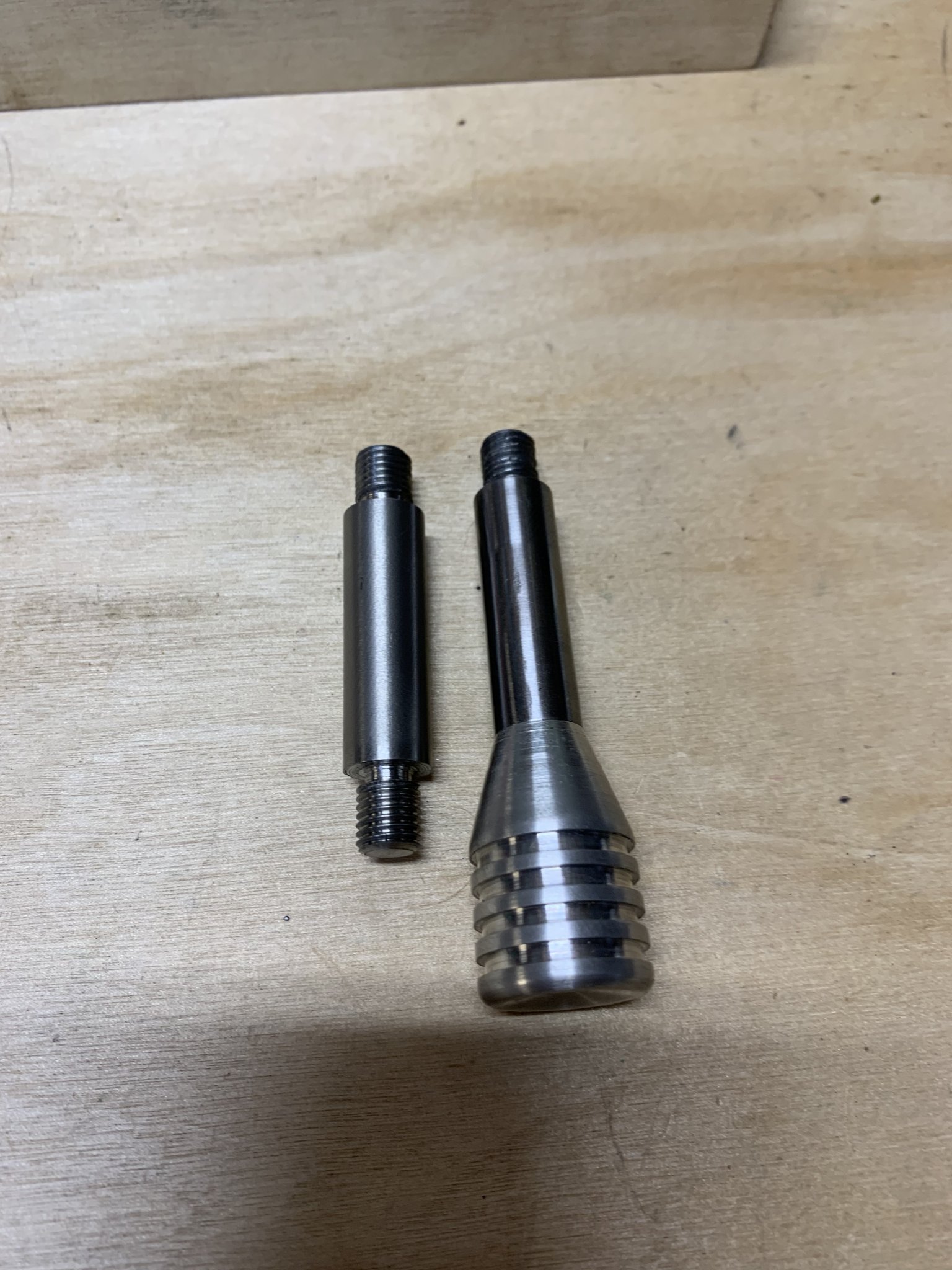

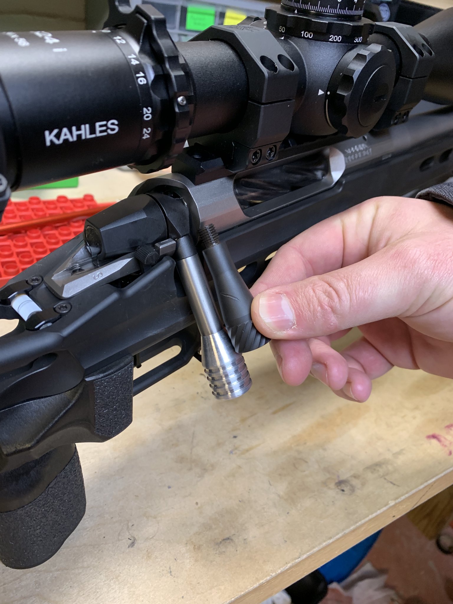

Built one of these for a friend the other night for a friends seekins havak and was thinking of making a run of them and selling them wondering if you guys would be interested in them. Haven’t come up with a good price I’m making them on manual lathe not Cnc. Bolt knob conversion for havak. Length of center would be determined by customer.
