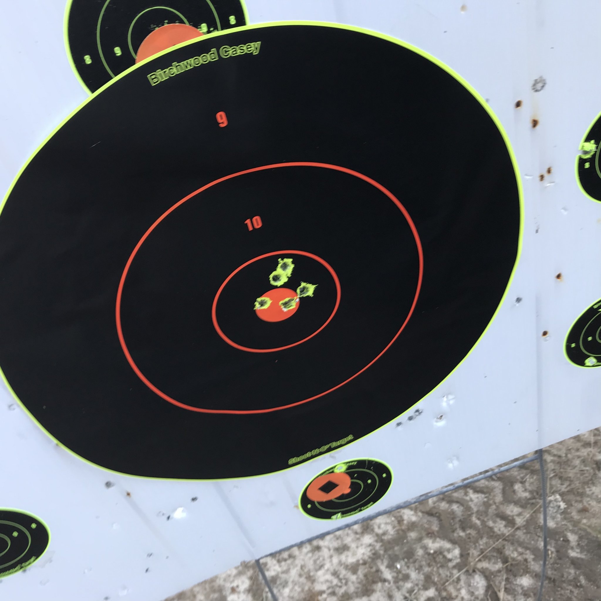

Maybe shooter error. Im just reporting what my experiences are so far shooting the rifle. Perhaps it is the ammo. Will try other ammo but i am getting about 1.5 inch groups at 100 yards with Hornady 140 ELD match. Hey it looks like i am getting good “accuracy” at least.

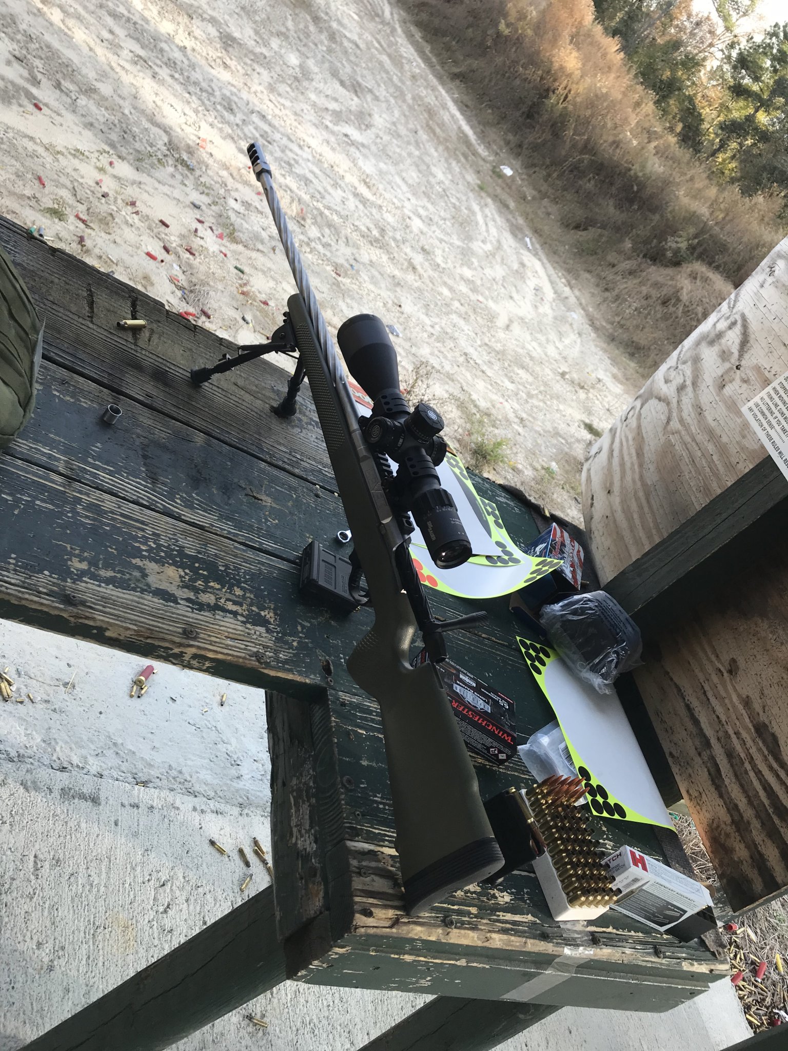

Maybe shooter error. Im just reporting what my experiences are so far shooting the rifle. Perhaps it is the ammo. Will try other ammo but i am getting about 1.5 inch groups at 100 yards with Hornady 140 ELD match. Hey it looks like i am getting good “accuracy” at least. Now to find precision. 1 inch is really tiny. I bet its the ammo. Good chance it likes the 143s or 147sView attachment 6980945View attachment 6980946

I didnt shoot with one that day. Ill bring one to the next shooting session.Where’s your rear bag in the pic? Are you shooting without one?

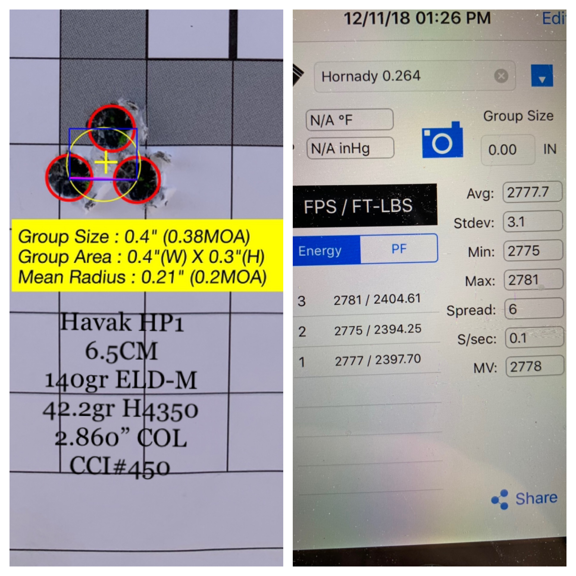

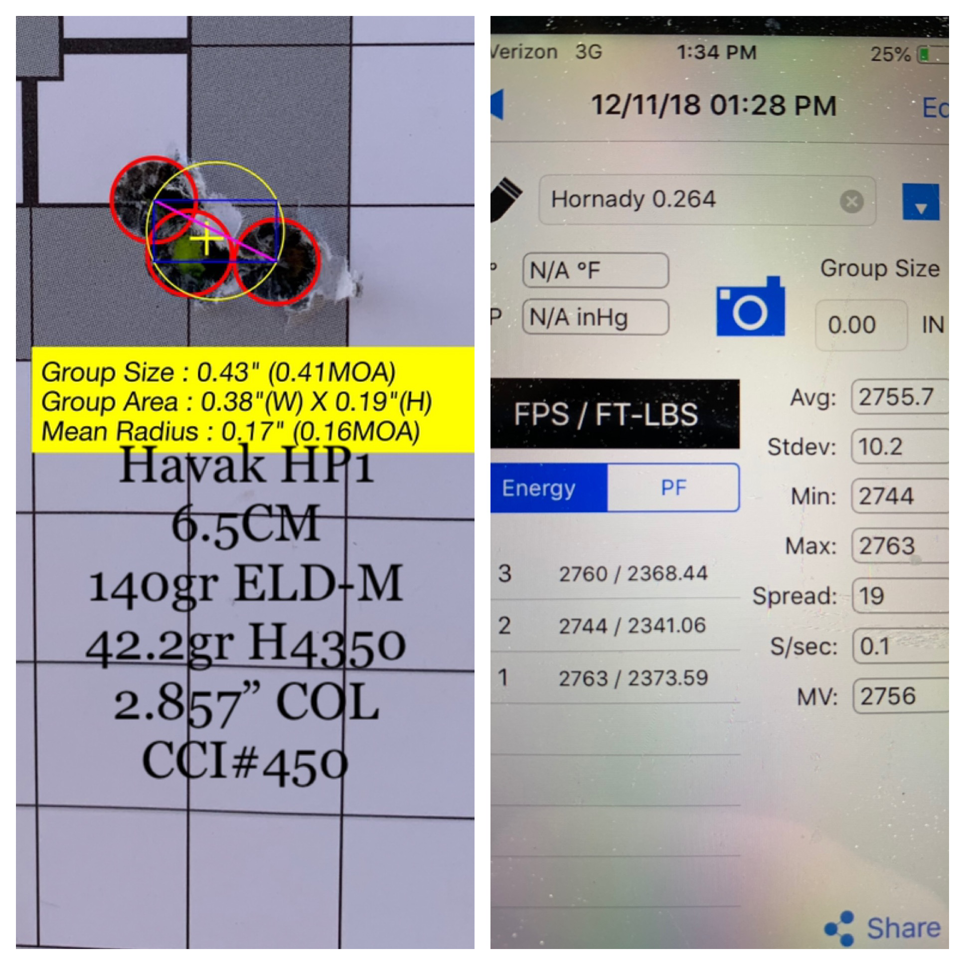

After some work, this is where I’m at with my 140gr ELDM load with my Havak HP1. I’m stopping here and rolling with it. View attachment 6984415View attachment 6984416

I’ve heard good things with RL16. Once the 8# jug of H4350 is gone I might look into it.
I’m also wanting to load for 143gr ELDX for hunting. What are the odds of my 140gr ELDM load being close? (Probably zero knowing my luck)
