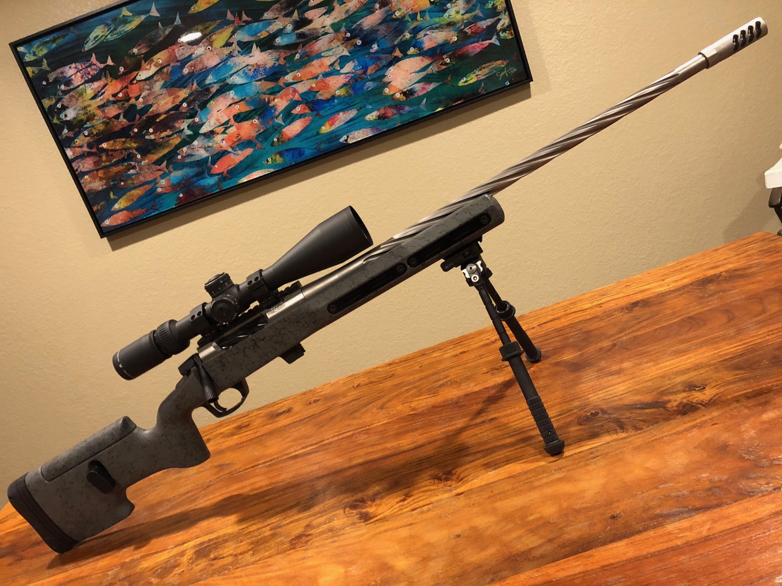

Is that the game warden you had modified? Who did the dip? Looks great.
JR/Kl, that is the Game Warden that originally came with my Havak. I sent the stock to Joe Ducos and he did his adjustable cheeckpiece install with the LRI ULTACH hardware I sent him. Joe's done two stocks for me like this and his work is fantastic. Great guy too.
I had the stock dipped in Kuiu Verde 2.0 camo by Tampa Hydrographics. I've used them for a couple of stocks on hunting rifles and it's seemed to hold up pretty well so far. Tony the owner does good work and usually turns them around in two weeks.
Reactions: mdmp5 and grants471

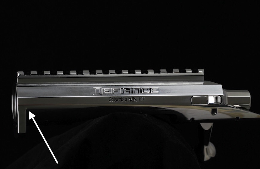

For southerngolfer and anyone else interested. I recently contacted KRG regarding the fit of the HAVAK action in the Bravo stock and received the following reply. Looks like a slight mod or patience is required.
Hi,
We have not had the chance to try one out as of yet, but we did speak with Seekins at SHOT and it seems like there might be a little interference at the junction of the recoil lug and the receiver. The one piece lug design isn’t a true 90 degrees (pointed out in the attached sample pic). Our next run of backbones both Whiskey-3 and standard Bravo will have a chamfer on the lead edge of the recoil lug slot so this shouldn’t be a problem with some custom actions in the future. I don’t have an ETA on those but our current models could be modified to work just fine.
The Spigot mounts are past due, we hope to have them within the next week or so.
Thank you,
-KRG
Reactions: southerngolfer
