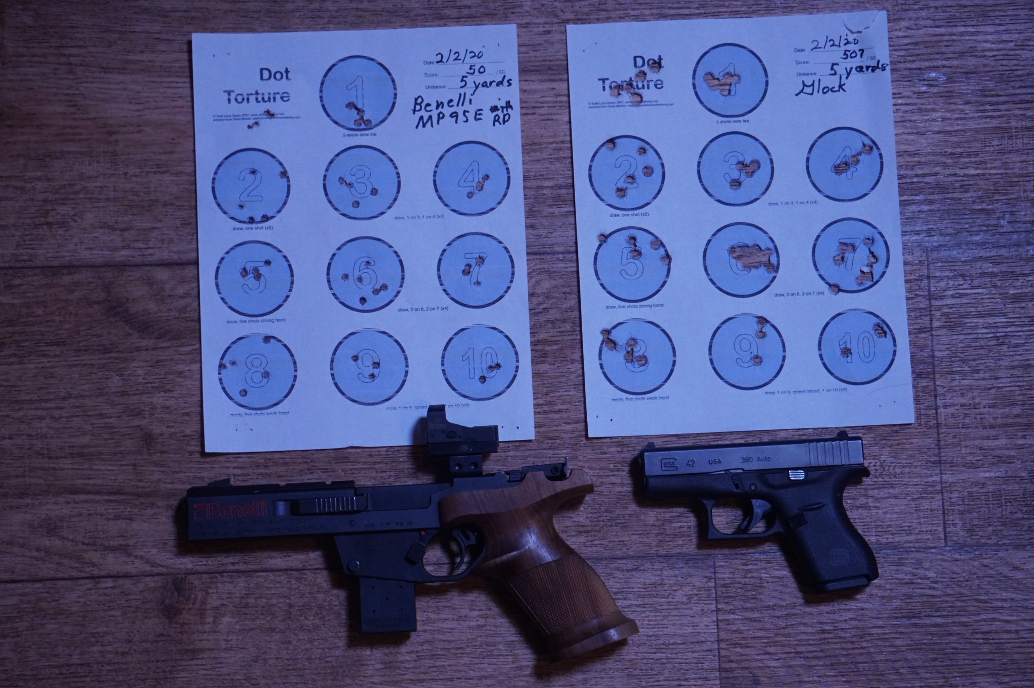

Wanted to try some opposites of mine.
A Glock42/380 and a Benelli MP 95 E/22rf with a Fastfire. Both at 5 yards.
Darned if I couldn't shoot the 22rf with RD much better. Going in I thought I'd do significantly better with it, but no, I was shakey and the dot bouncing around all over the place made me lose my confidence somewhat. Looking back I should have shot this pistol first and the Glock afterwards because it seemed I used up my concentration quota up with the little Glock. I had to aim above top of the bull about a 1/2" to hit center with the Benelli which didn't help and it would've been easier I think if I had a small aiming spot in the middle of the bull to aim at.
The Glock sights were right on but I had to strive hard to keep all the shots hitting blue. I knew if I muffed a shot the slightest bit it'd be a miss for sure, even so I was almost out on a half dozen shots! The trigger is heavy, maybe 5lbs??? Squeeze, squeeze, squeeze, then it would finally go off.

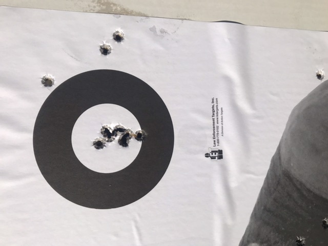

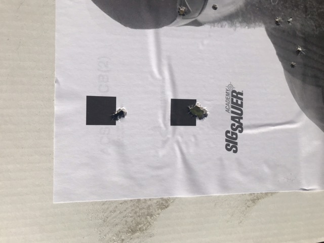

I shot my co worker’s P320 with a red dot (DP Pro) milled into the slide. 147 grain ammo.
Verified zero at 25 yards and then shot 1-2 inch dots from 2 to 5 yards. Up close hold over was 1 inch tops.
Photos are rotated to the left. Top square is 5 yards. Bottom square is 2-3 yards.
For the circle, 3 shots to the right are 25 yard zero confirm shots. The rest in the circle are 2-5 yard shots with one 10 yard shot thrown in.

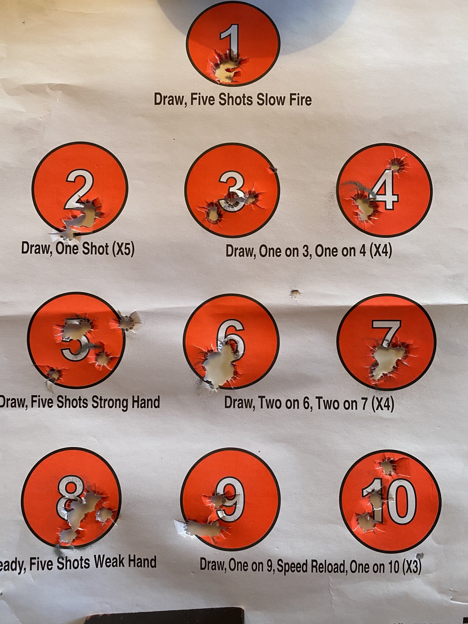

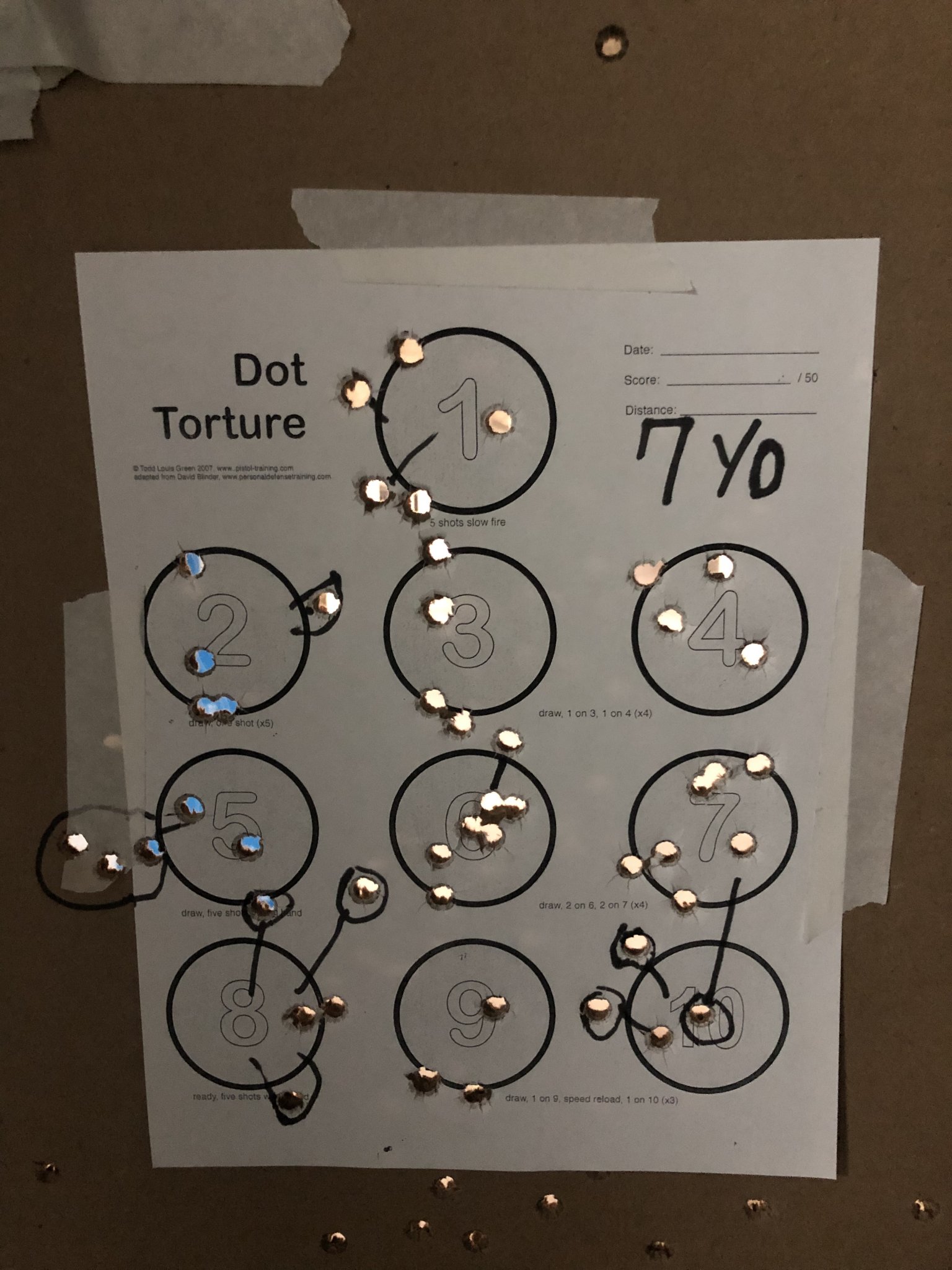

Shot the dot torture today. I was at an indoor range where the closest marked line was 7 yards so I said F it and went for the 7 instead of guessing at 5 yards. Wasn’t perfect but not as terrible as I thought for not doing it in a bit.
Question for the better shooters than I. After about 100 rounds on the practice range I’ll start anticipating the recoil, where on the first 100 ( rough estimation) I won’t anticipate at all. Any thoughts to rectify? I was planning next time that after every 4 mags or so to do 10 perfect dry fire reps. Lemme know your guys thoughts. Thanks
Oh and for the target I circled the misses and drew a line to where they belong. Or Atleast drew a line to where it belongs

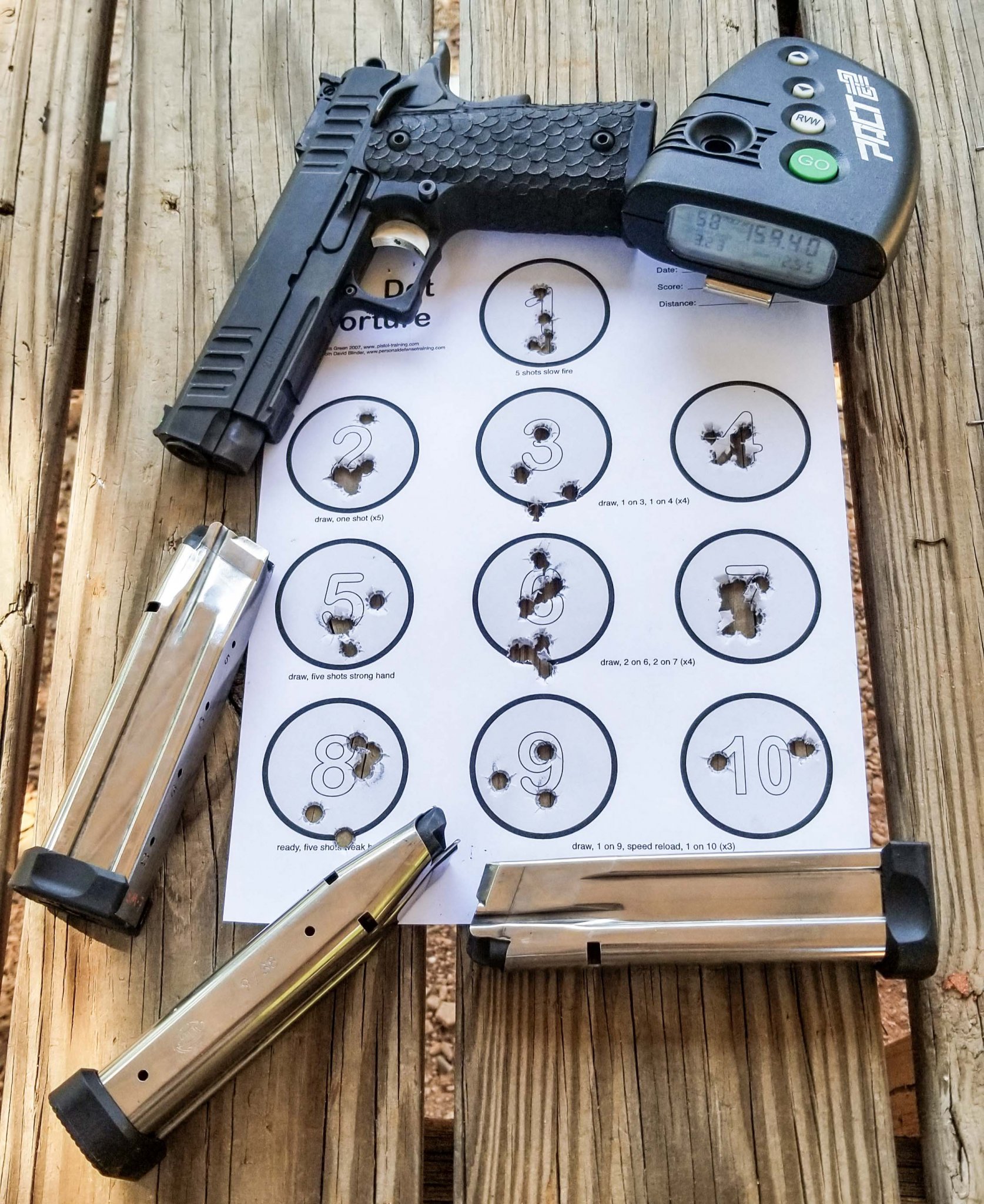

I need to slow down. 83.83 secs total shoot time from 5 yards with my dan wesson .45 from 5 yds, threw a few. Also need heavier weight paper as the swc's tore shit up.

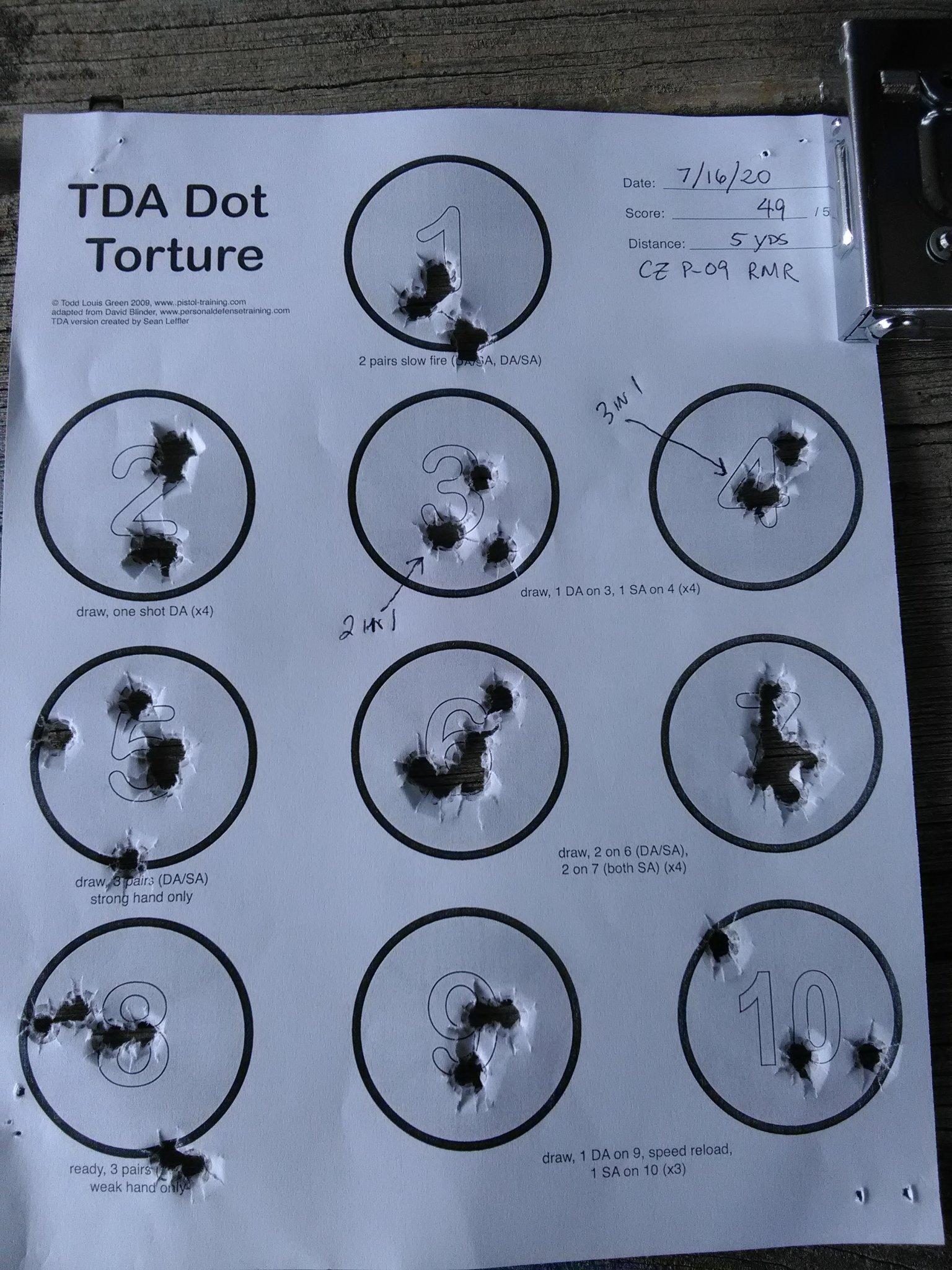

Well I'm back with targets from a new gun and an old gun with a new sight

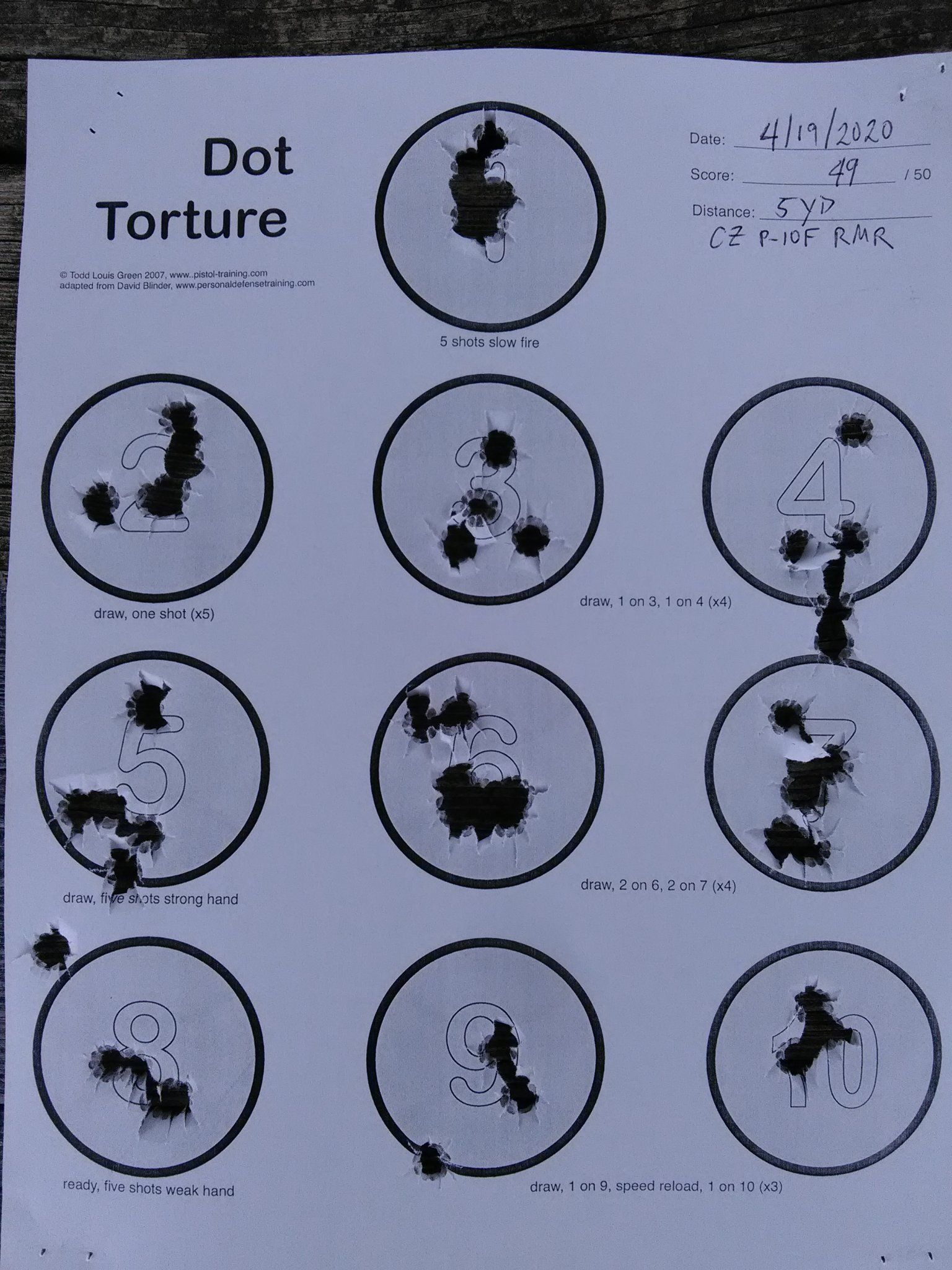

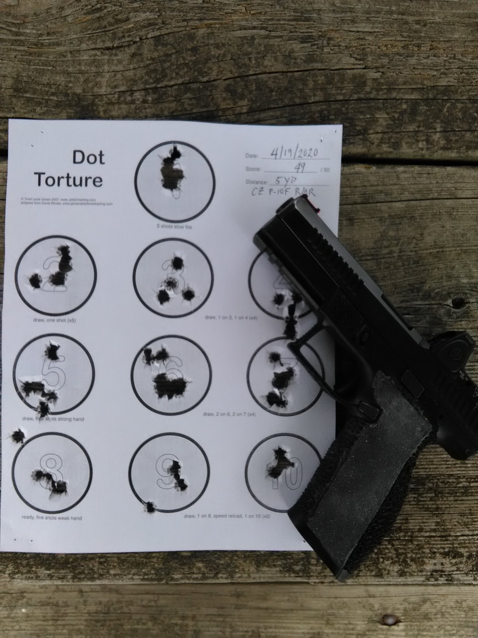

First the P-10F. I've shot the drill at 5 yards with it before, using a red fiber optic front and plain serrated rear and was able to clean it. Back in January I put an RMR on it to compete in USPSA and IDPA Carry Optics but hadn't gotten around doing the torture with the RMR on it until now.
Only managed a 49 at 5 yards, tossed one high on the weak hand (dot 8)
Here's the target with the gun out of the way

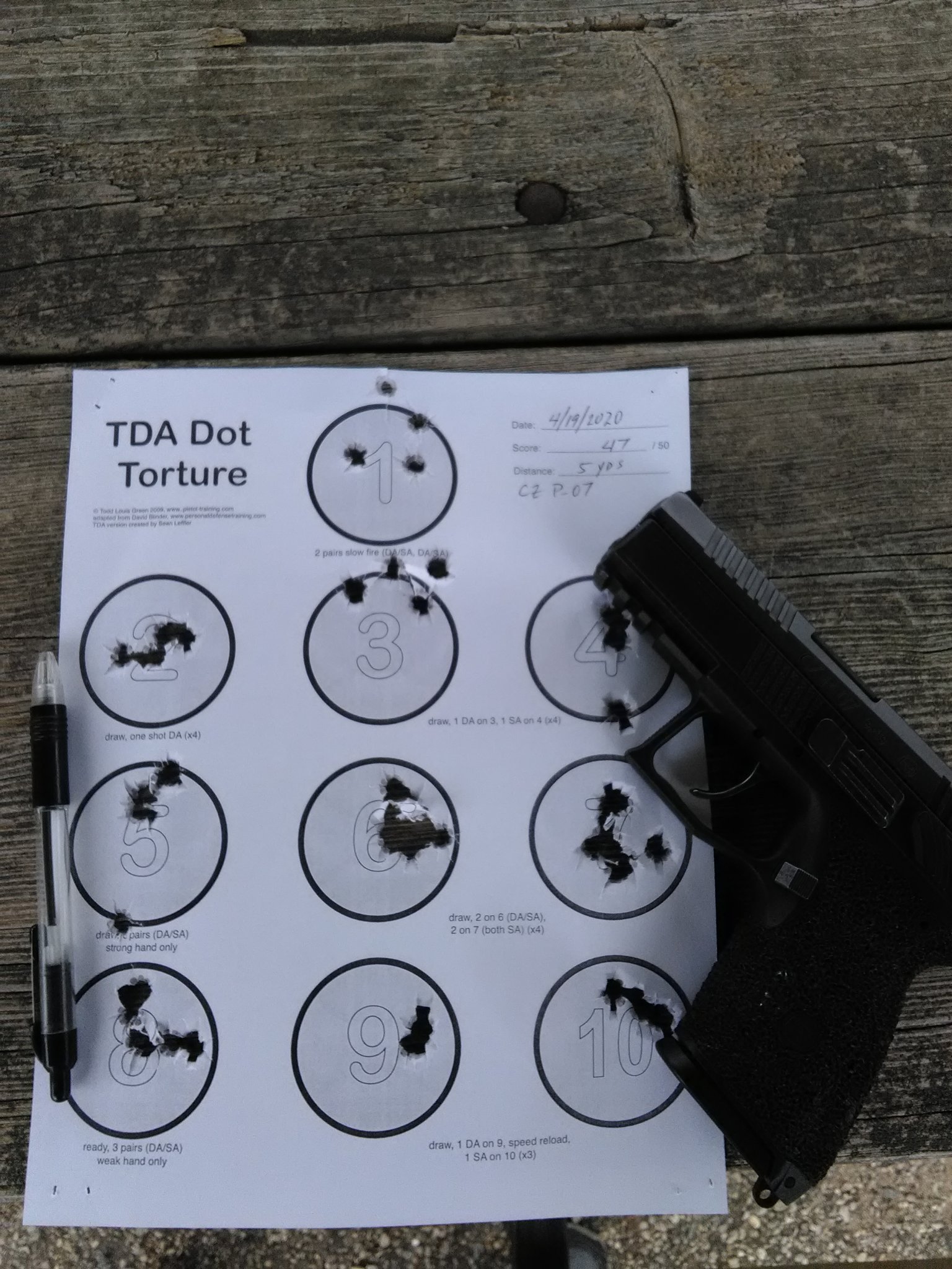

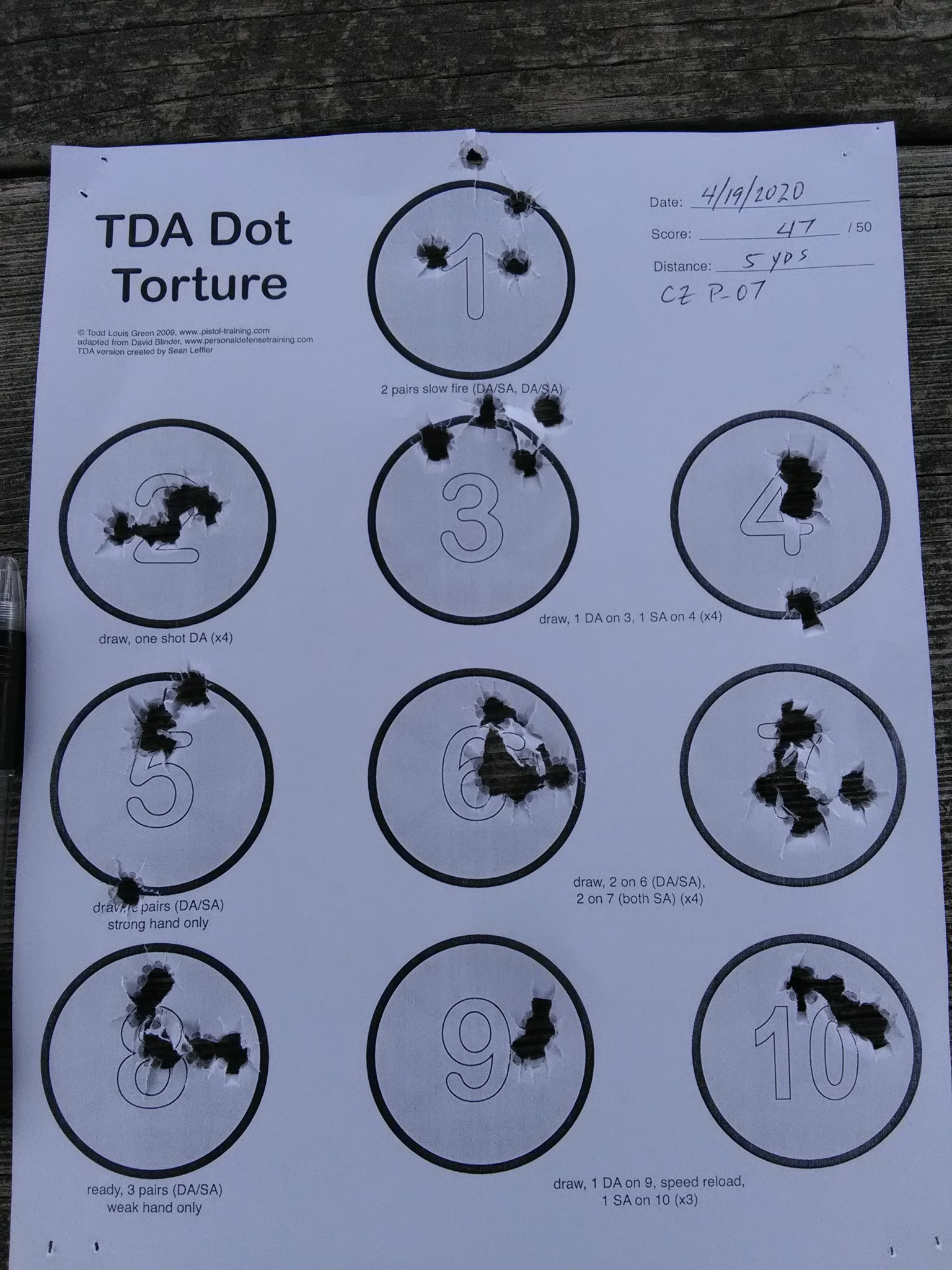

Second gun is my new carry gun. I used to carry a P-07 about six years ago and like a fool traded it for a P-01. Roll fwd six years and after a very successful season in USPSA Production with a P-09 I started thinking I should carry its little brother. So I found a guy had what I wanted and wanted what I had and traded straight across
The high shots on dots 1, 3, and 8 (in dot 5 at 6 o'clock) are all the reason why I'm methodically converting all my pistols to red dot sights. Once my P-09 slide comes back milled for an RMR from DP Customs, the 07 goes next. ETA: the P-07 still has its OEM sights, which are not the easiest for me to work with based on my presbyopia. I think with a red FO up front I would have cleaned it or at worst a 49.

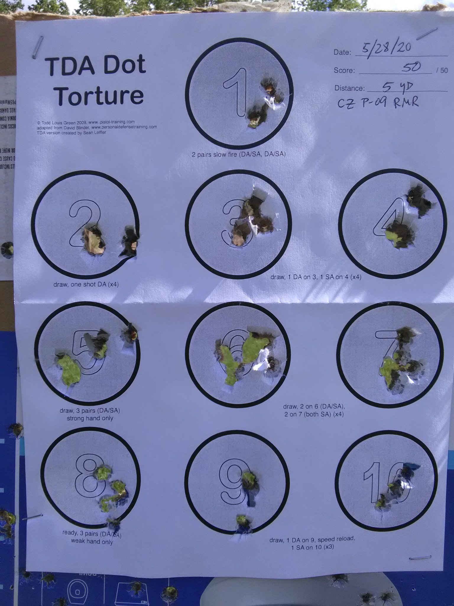

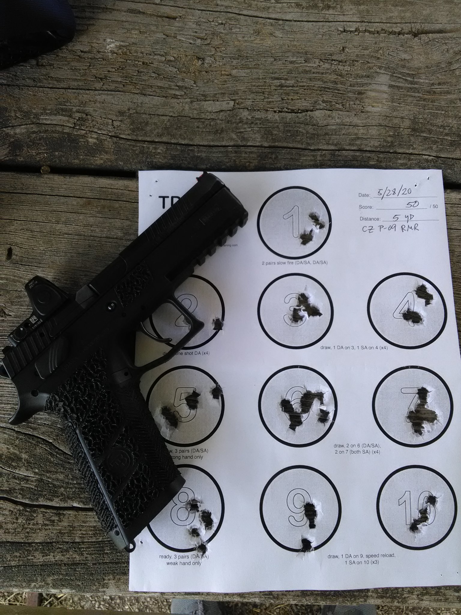

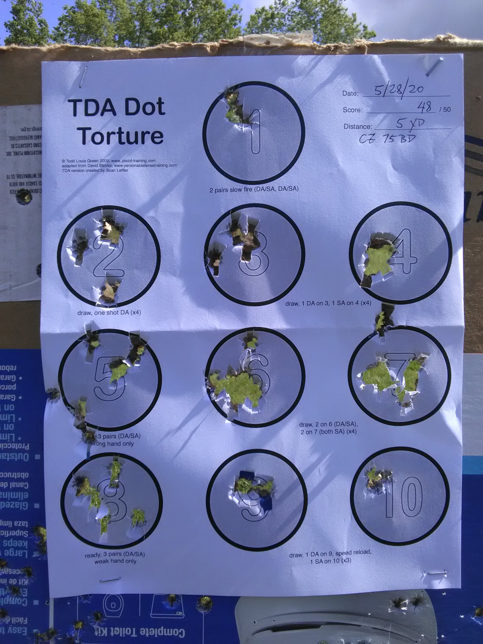

So without further ado, here's my ol' trusty P-09 with a sight that I can actually use. This thing is like fucking cheating and it feels like a plastic Shadow. Worst of it is, it's bone fucking stock except for a 15 lb hammer spring and a Glock 17 ISMI flat wire 13 lb recoil spring.
Read 'em and weep

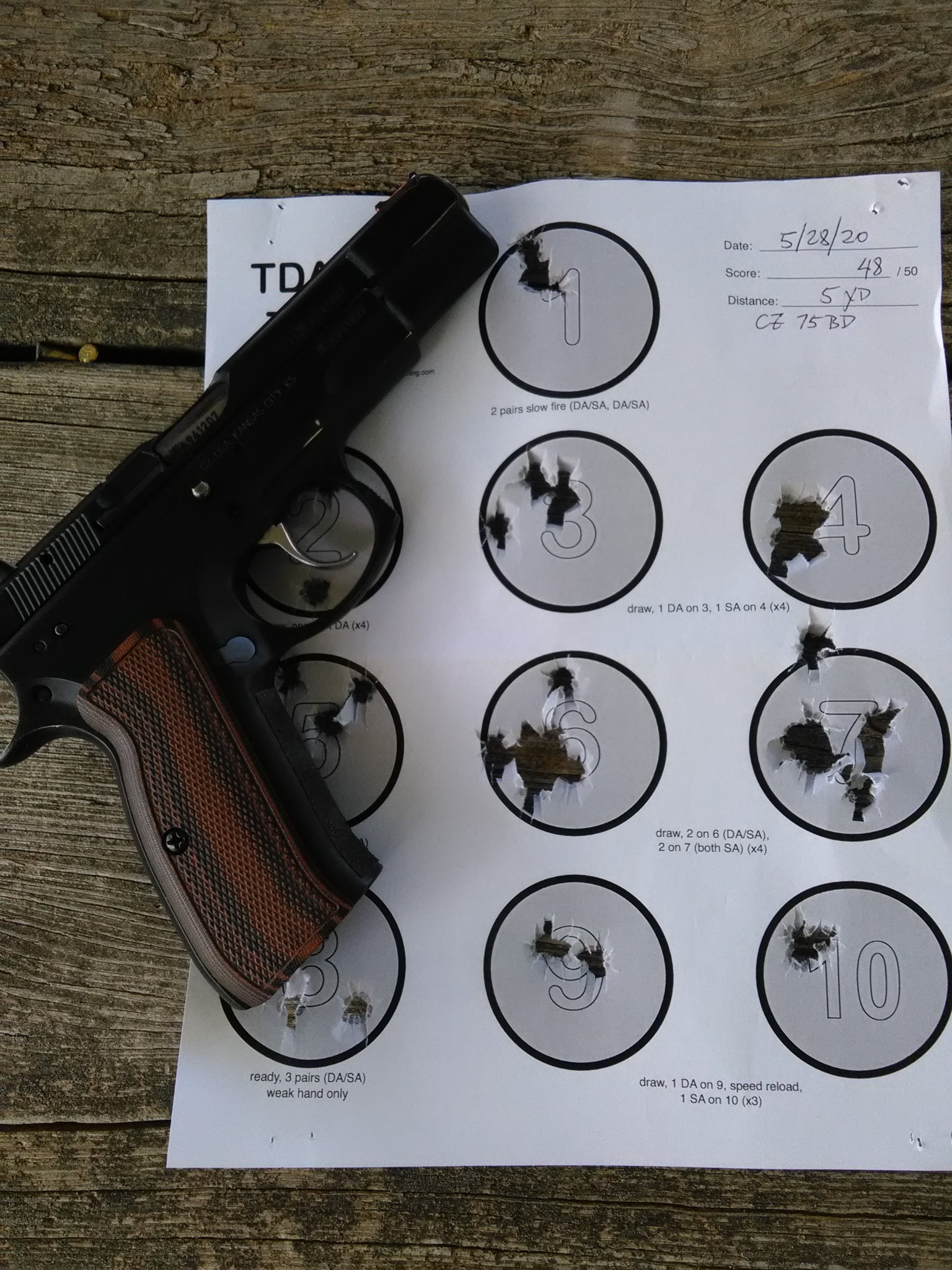

And just to keep it real, a 48 with my old 75BD. I have polished the shit out of the guts and put some CGW goodies in there, I have to admit.

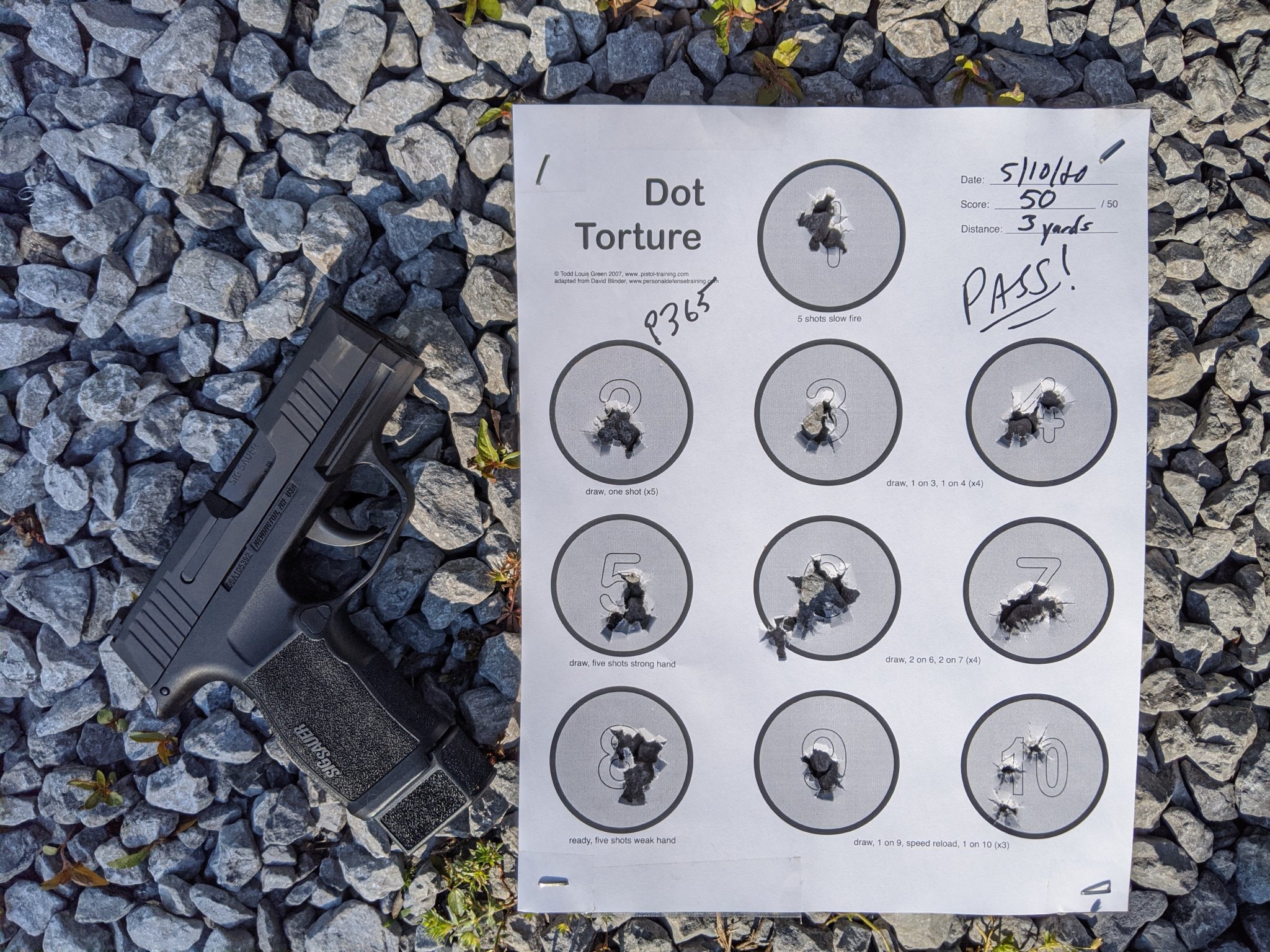

Shot it this way my first time on Sunday with my P365 and it was much more fun. My score was 3 yards/235.67 (195.67 sec time + 4 misses). Since I passed, I will shoot it this weekend at 4 yards.

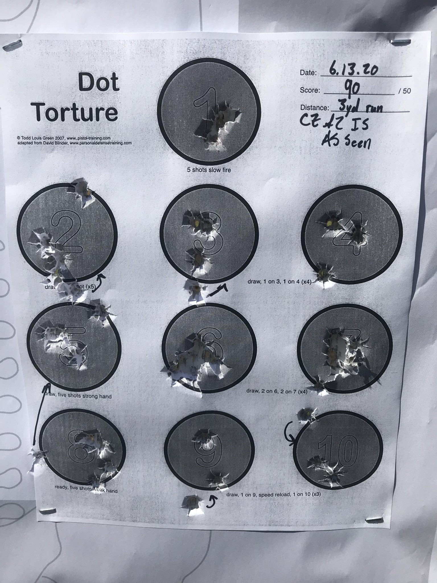

It laughs again at me, but I'm getting better. Still need reps on the DA pull for my S2. 96% today from 3 yards. 90% while sprinting, and 86% with my issued G17. All shot with irons.
The 96% target was shot on a SA/striker target, but I shot it as the DA/SA target.
The 90% one as mentioned, was done with sprints. Gives me 19 total 47 yard sprints and forces me to immediately bring my breathing down and place a well aimed shot. My “rest” was jogging back to the 50 yard line. Tiring, but I think realistic and very practical. This was shot as instructed because another guy was running the drill with his G19.

  • Date shot: 7/16/20
  • Make and model of handgun used: CZ P-09 with RMR RM07 (6.5 MOA)
  • Target used: TDA dot torture
  • Distance shot from: 5 yds
  • Score: 49/50 (dropped one on WHO)
  • Pics of target or it didn't happen
In my experience, the P-07 and P-09 are the most accurate polymer handguns CZ makes. Noticeably more accurate than the P-10 series (I have two of them), and likely as accurate as an OEM Shadow and possibly a Shadow 2.
The slide to barrel lockup and slide to frame fit of my P-07 and P-09 is crazy tight and something that the P-10 series can't equal with its lack of full length contact between frame and slide.
