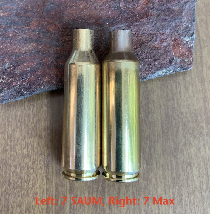

My new lot of ADG/Sherman 7 Max 40º (h.s. "300 MAX") : avg=2.008, min=2.007, max=2.0095, N=20.
My new lot of Norma 7mm SAUM : avg=2.020, min=2.0190, max=2.0235, N=20.

I take it it’s just shorter in the neck length?
Both cases are unfired. SAUM is Norma, Max is ADG/Sherman. The Max neck-shoulder and shoulder-body junctions are somewhat rounded & indistinct, possibly result of hydroformed Max? So kind of difficult to get a precise neck measurement. Shoulder angle, body length, and body taper differ (by design).
Sorry, in the photo the cases are not quite aligned at the base.
Both cases are unfired. SAUM is Norma, Max is ADG/Sherman. The Max neck-shoulder and shoulder-body junctions are somewhat rounded in indistinct, possibly result of hydroformed Max? So kind of difficult to get a precise neck measurement. Shoulder angle, body length, and body taper differ (by design).
