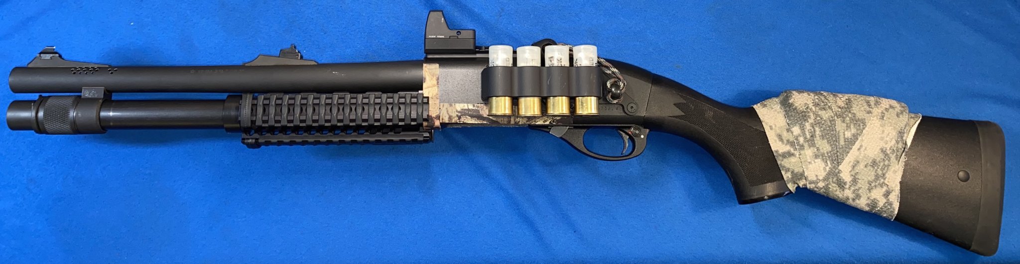

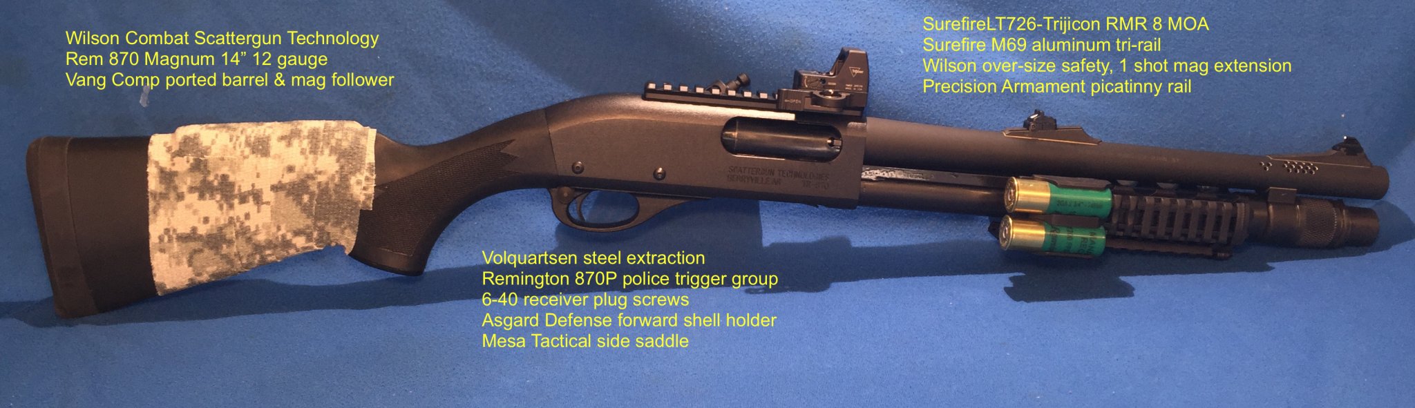

Vang Comp is very good, but are there any other shotgun 'smiths who work on Mossberg 590a1 for mods and upgrades? Wilson Combat/Scatterguns only works on the Remmy 870. Aim Pro Tactical went to crap and then left the gunsmithing biz.

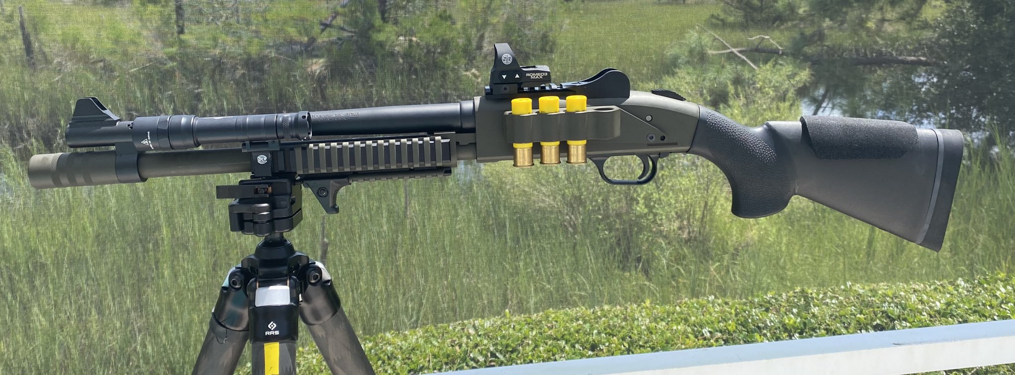

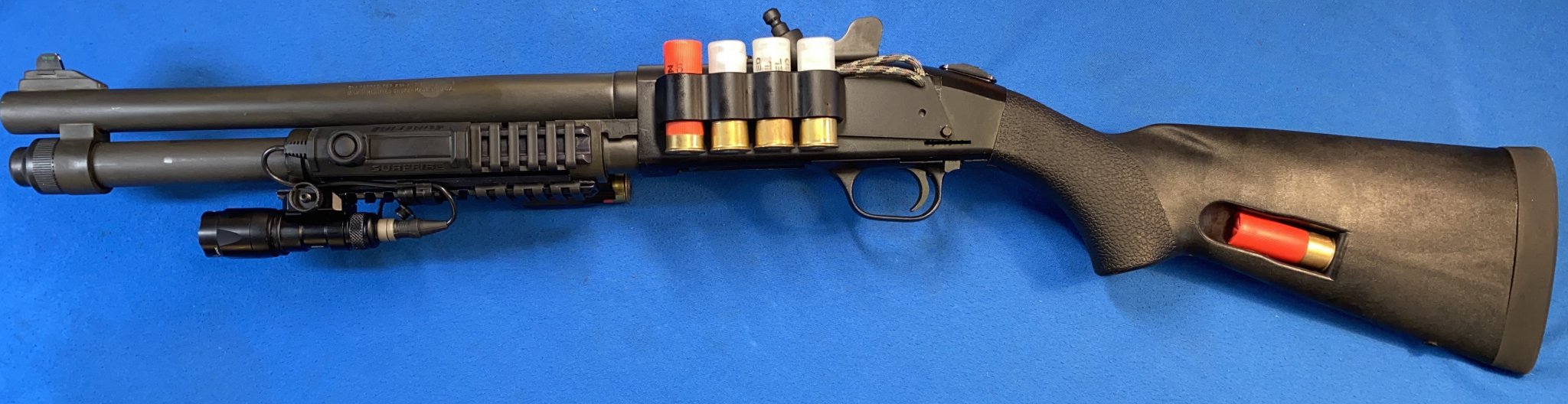

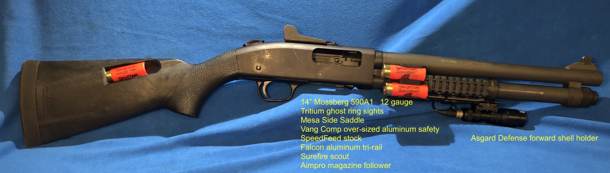

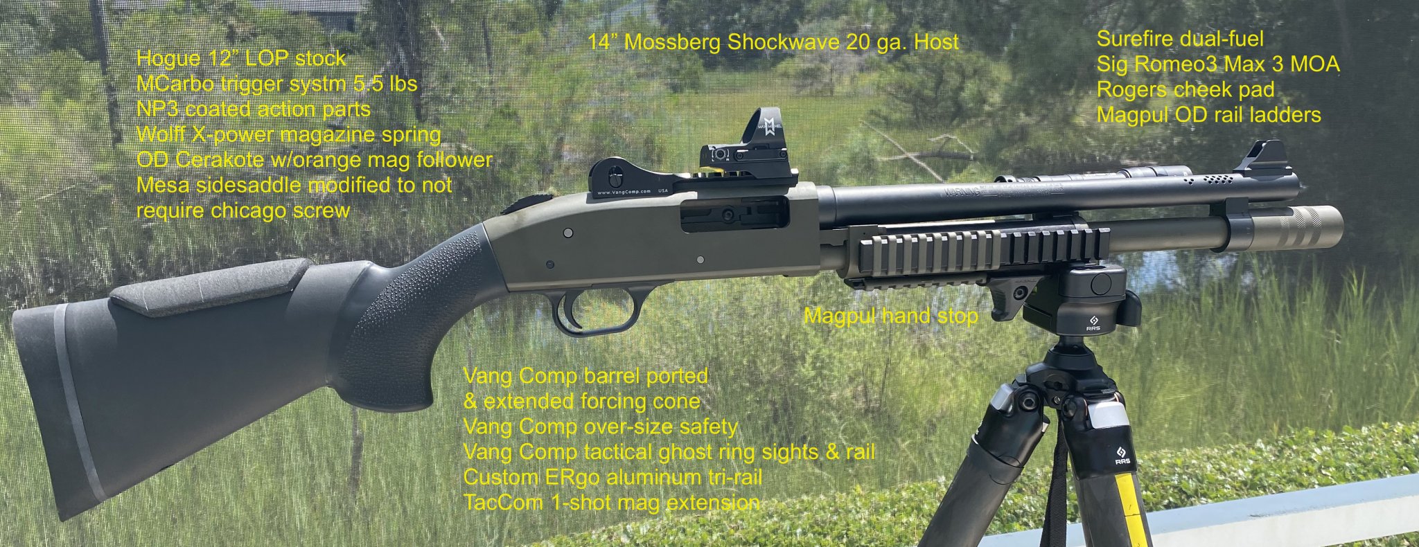

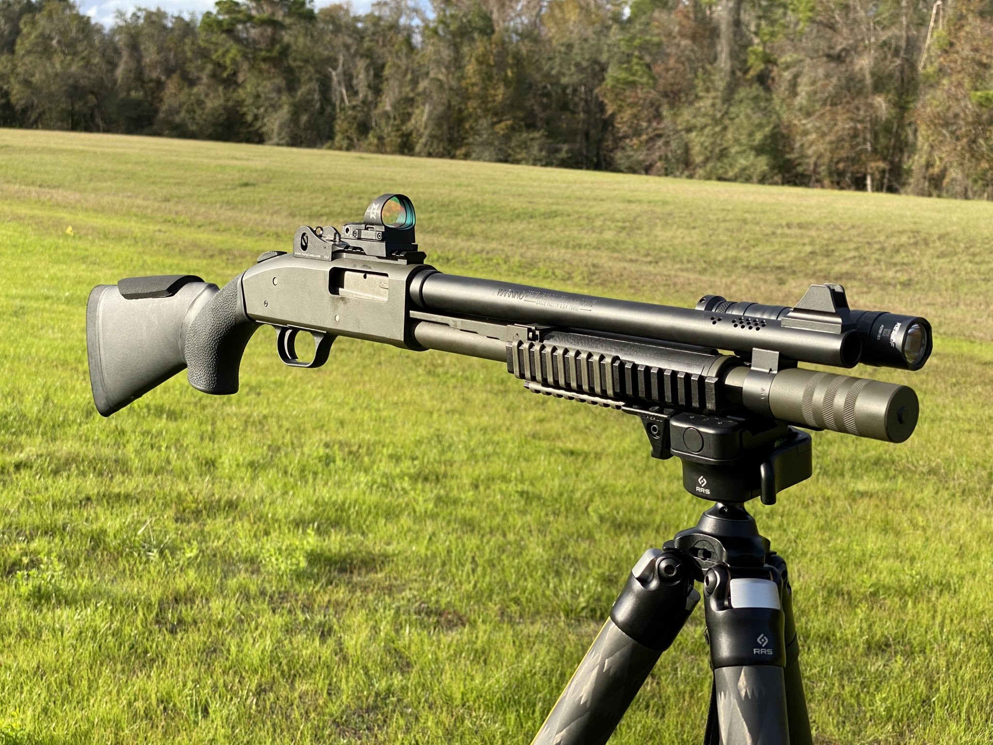

What is the end-game you are striving for with gunsmiths / add-on mods ?
Except for the barrel porting and extending the forcing cone, I have modified all these myself.
A Mossberg 590A1 SBS / Wilson Combat SBS / Mossberg 20 ga. SBS.
Cody @ Vang Comp related the 20 ga. was one of the nicest they have ever been part of modifying. A nice home defense project.

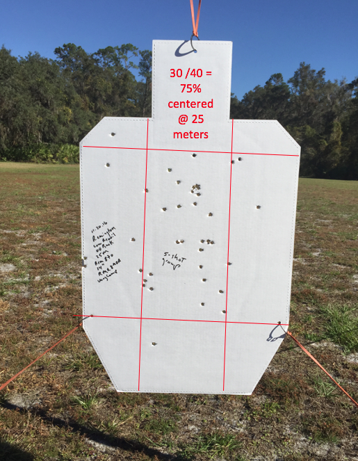

Hard to beat the WC 25 meter target with Vang Comp porting etc.....all the buckshot are accounted for on the target.
View attachment 8199274View attachment 8199275View attachment 8199279View attachment 8199281View attachment 8199284View attachment 8199285View attachment 8199286View attachment 8199287
Does the porting help a lot with recoil and recovery?
I would say the porting diminishes the muzzle rise "some"; the red dots do make accurate follow-up shots faster. At 25 meters and in, the muzzle rise shooting Federal Flight Control buckshot is not as critical as slugs. The Vang Comp port strives for 32 MOA patterns, 8" @ 25 yards; lots of pellets inside and about the 8" POI.
The Rogers School uses the Winchester 1300 pump (same as FN Herstal Police shotgun) with buckshot for testing. No porting of 18" barrel and there really is not that much muzzle rise with proper gun control.
The steel head plates are 8", the #7 target is at 25 yards.
