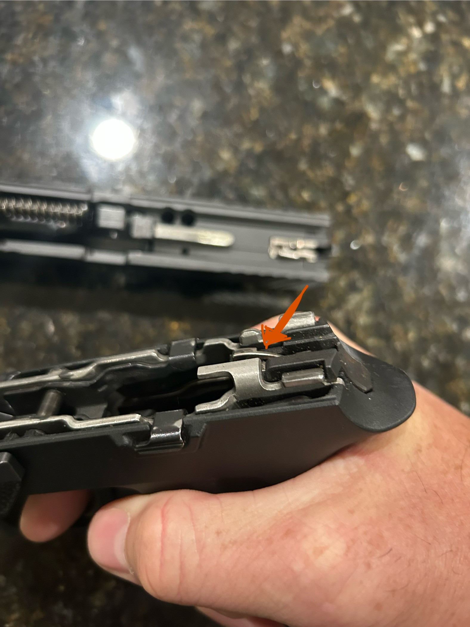

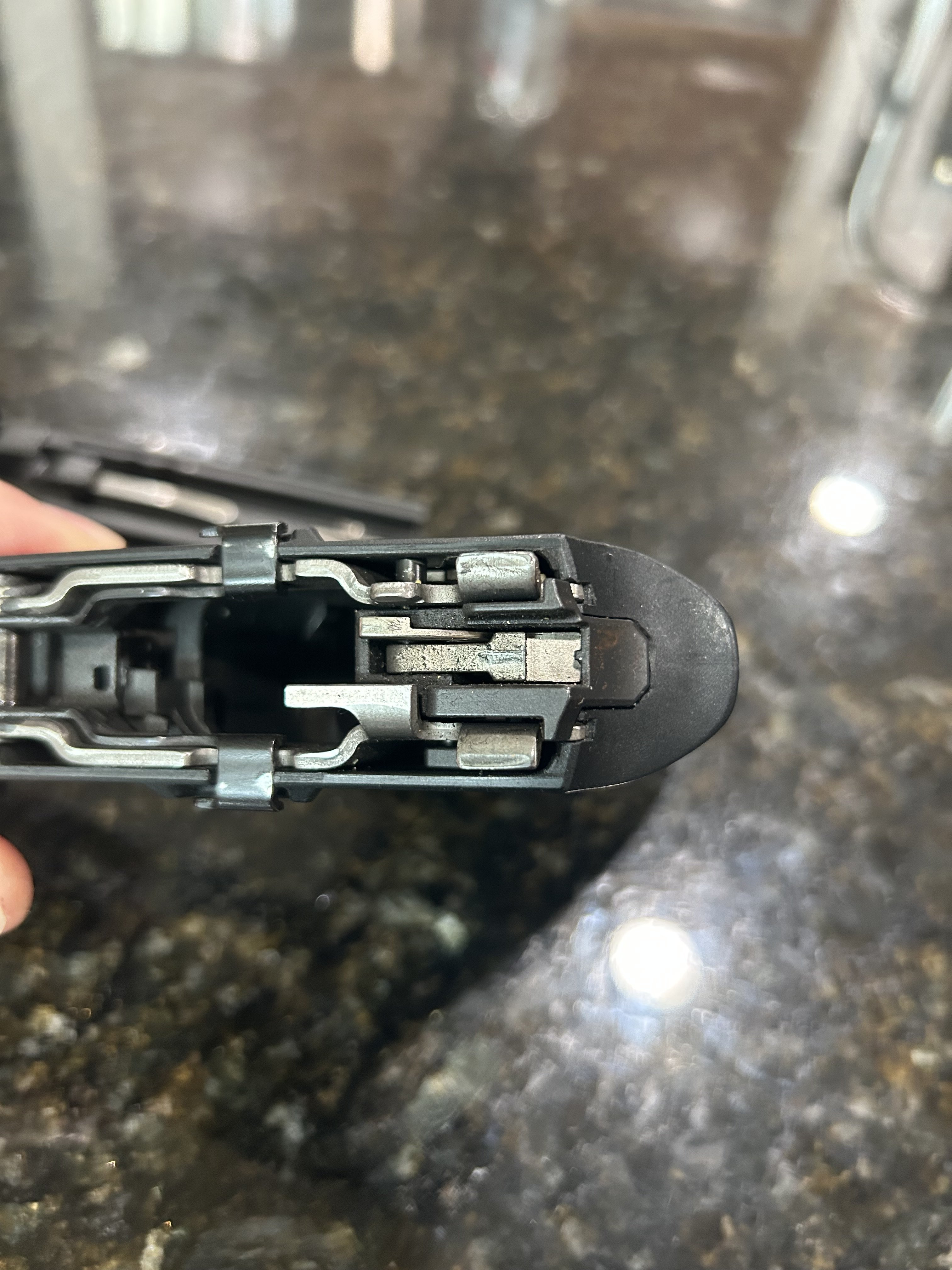

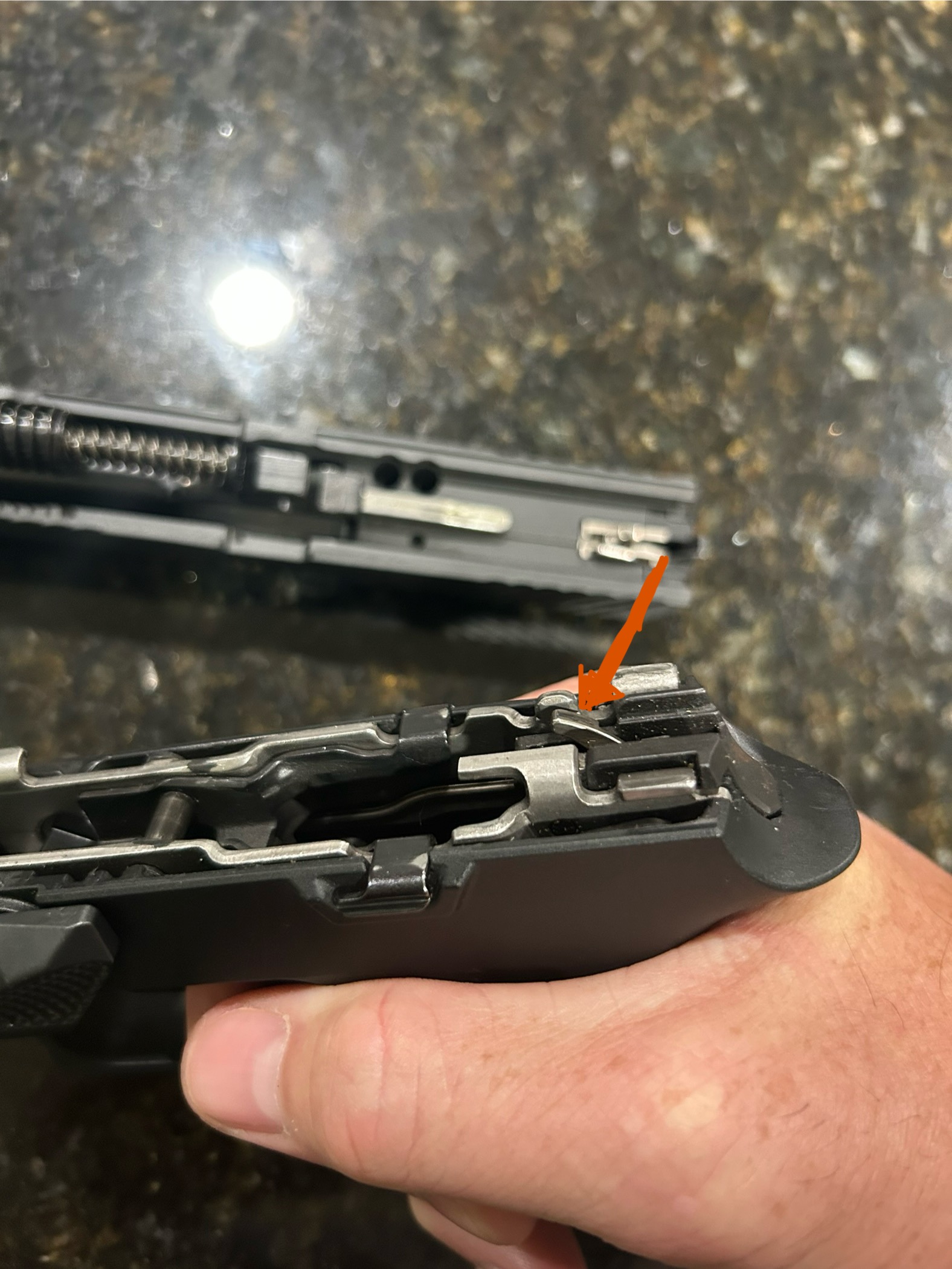

This is what happens inside of my (unvaxed) p320 when you take up the pre travel…
A little dingus moves up.
That little dingus interacts with the striker safety.
There is no second shelf on the sear…

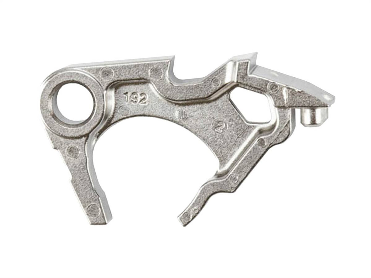

I have yet to recall any Glock parts so convolutedly intricate.
Glock trigger parts are all stamped steel (and plastic, of course) - nothing MIM, correct?
There are Glock parts that are almost certainly MIM - the firing pin, the firing pin safety plunger, and the locking block immediately come to mind. But like every part in a Glock, they appear to be designed as part of a system that is very tolerant of widely varying component dimensions.
MIM is not bad technology - it's successfully used for many automotive powertrain components (stuff like connecting rods, transmission gears, ring and spider gears in diffs, etc.). Sig's problem isn't the MIM process, it's the excessively fussy design and the dogshit component supply chain. Like most polymer pistols, the cost-of-goods-sold is so ridiculously low that there is zero excuse for outsourcing critical firing control group components to India. Go talk to a domestic company that makes critical auto/medical/military MIM parts, pay 2-3x for parts that actually meet the print, reap the financial benefits of not discharging live rounds into your user base.
Exactly, I don't recall Ruger having problems with spontaneous discharge despite using MIM parts, but then again, they manufacture them in-house and have invested a lot in the technology.
I suppose my statement could be misconstrued along those lines - I was thinking more along how SIG could only use MIM to fashion these really intricately - shaped, tiny parts.
Comparing the Glock’s internals - its staplegun mechanism just looks so much more fault - tolerant.

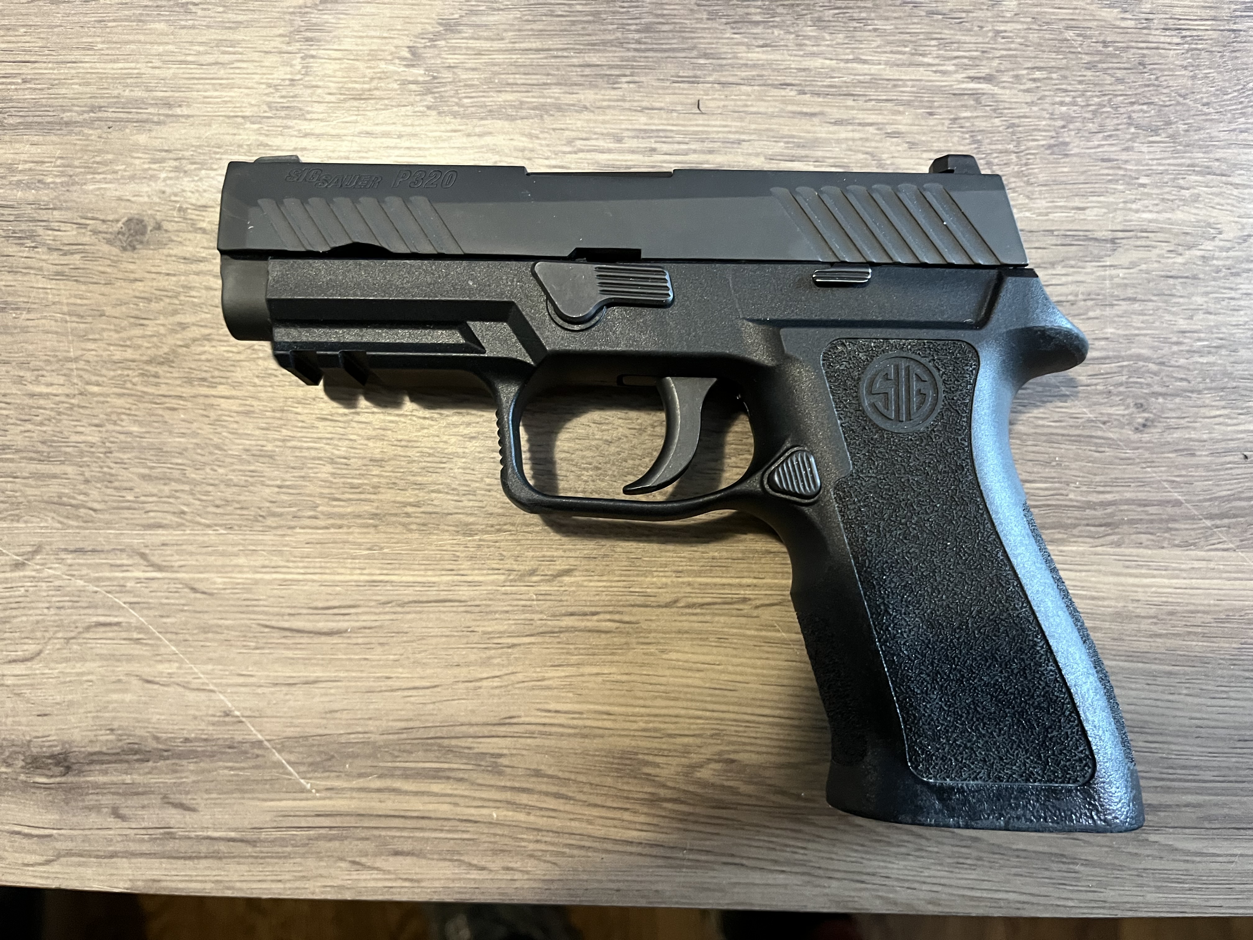

A P320 I have been fooling with, flared the magwell, rounded the trigger guard, shortened the frame planning on molding in a light after removing the rail. Probably adding the safety.
17+1 compact compact.
