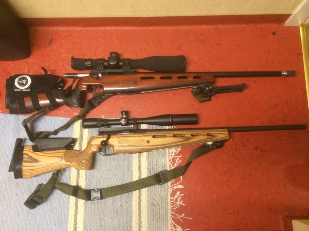

My pair, one in 6,5x55 imp and the other one is .22 lr. They are the scandinavian version 200 STR but hey. They both like to just hammer the targets. Love them both!
