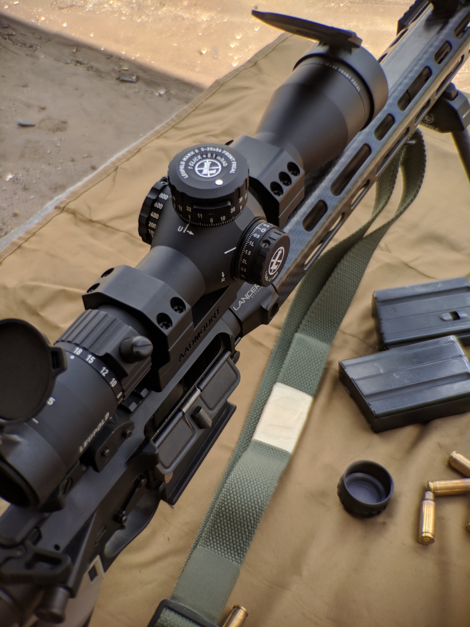

Mine showed up this morning. Initial thought, best thing I've ever seen some out of Leupold. The turrets are great, they feel very nice, are very audible, almost no slop and no mushiness. Glass is crisp edge to edge and the eyebox is very forgiving. Mine is the Tremor 3 version and even on 3.6x I can easily see the crosshairs, all the main grid lines, and the 4th wind dot is very pronounced. If I really concentrate I can see the other wind dots on 3.6x. At 5x the smaller wind dots become very pronounced and easy to quickly to pick up, and at 7x you can concentrate and get .2mil hash marks with them becoming very visible at 8x. At 18x the reticle still isn't too thick.
I can only find one complaint right out of the gate and that's the indexing mark for the windage turret. The location of it and distance from the knob (doesn't run right up to the turret like most) knob is awkward and it's hard to tell exactly which mark its on. This isn't much of an issue for me as I'll zero it and forget it, but it's still a little annoying and goofy. Whoever decided that was a good idea should rethink things.
From initial impressions I have no doubts that this optic will fulfill the role that I bought it for flawlessly (DMR rifle). Shooting and tracking feedback will be coming shortly.
