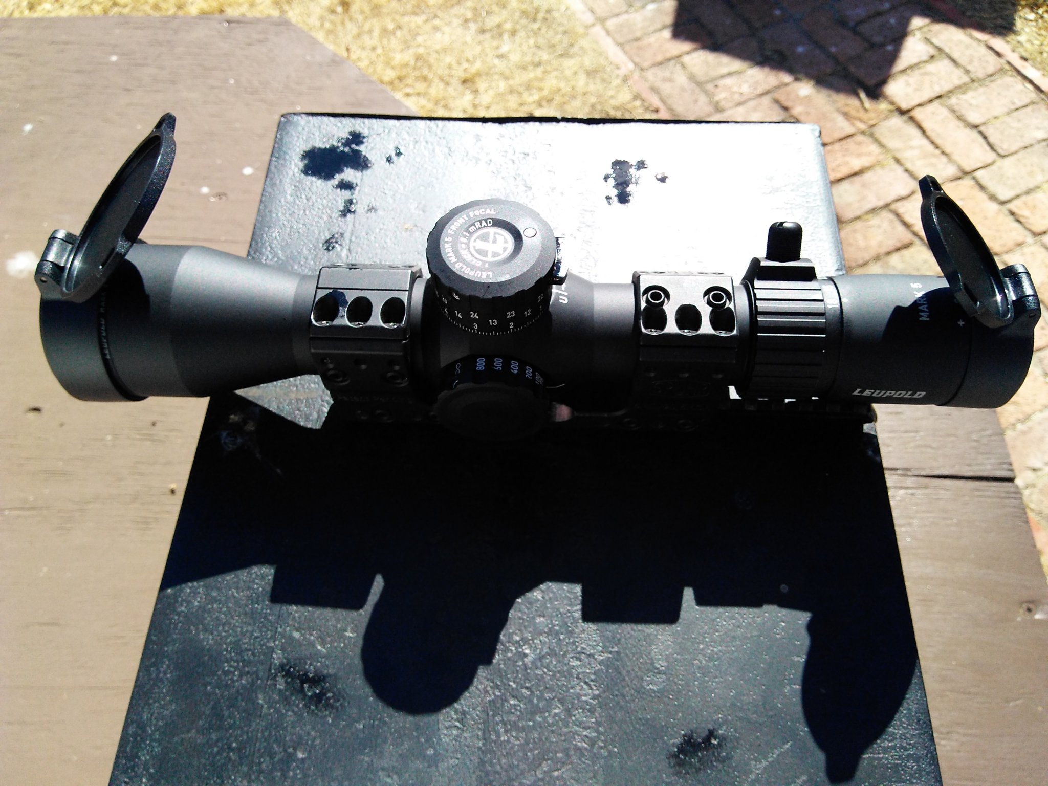

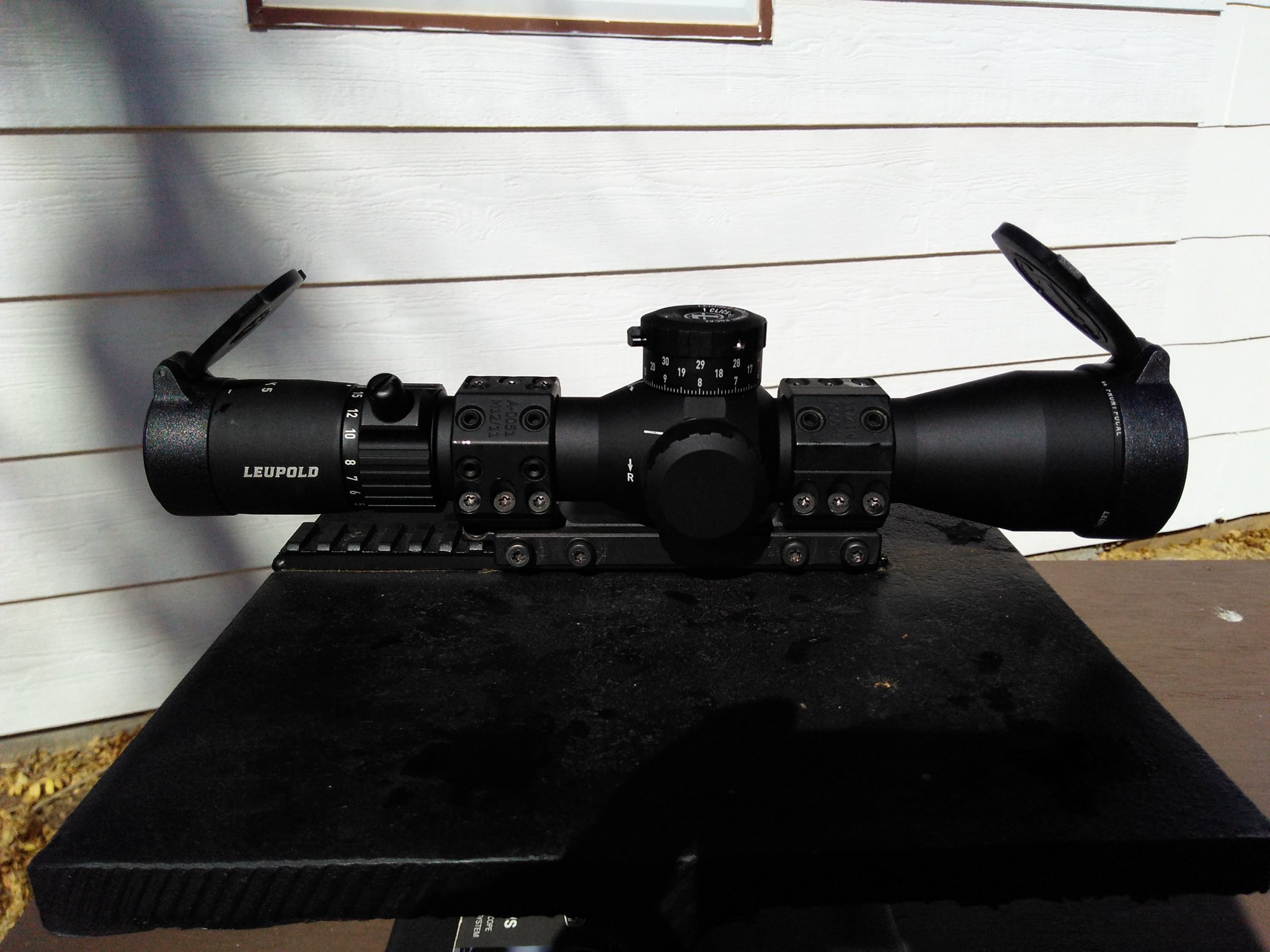

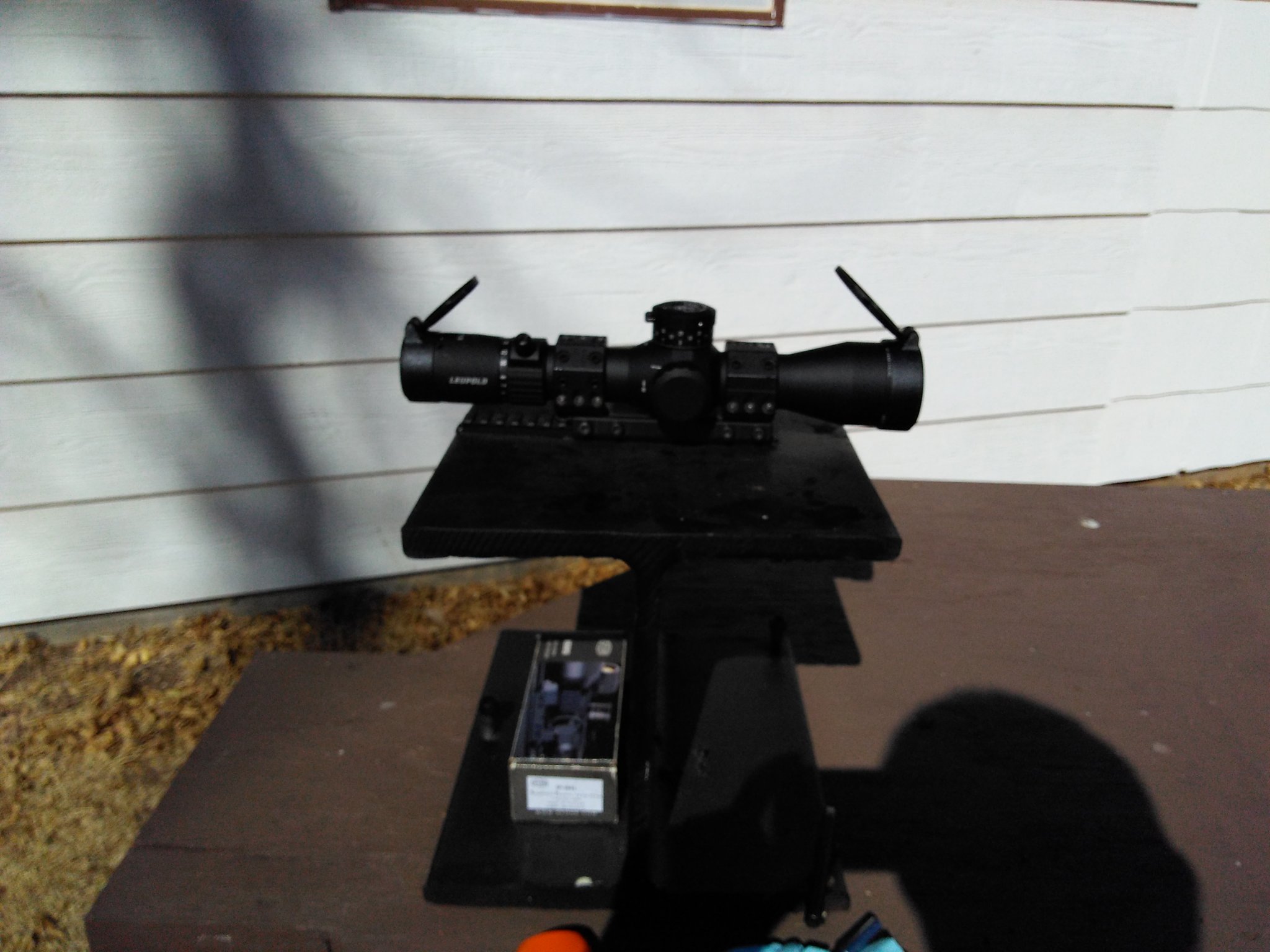

I just received one of the 3.6-18x44 non-illuminated TMR models in the mail today for a customer. He had already provided me with a Spuhr mount and approved me running it on my tracking test stand. I took it straight out of the box, and put it on the test stand. Here are my test results, your experiences may vary. Pic of my test setup included.
Tracking was very good. My target only goes to 14 Mils and with the scope set on 14 mils the cross hairs looked to be at about 13.95 mils. This is easily within the error of my test setup. The return to zero was perfect.
When installed and leveled to the mount with spuhr's method, and with the mount bubble centered, the cross hair was perfectly straight with a plumb Bob hung on the target. Whenever I dialed to about 10 mils of elevation it appears that the reticle shifted to the left by 0.1 mils. This was a gradual shift and not a sudden jump.
Cross hair had no visible movement through the entire power range.
The parallax knob only has markings down to 75 yards, but the knob goes lower than the 75 yard mark on the knob and will focus down to about 40 yards.
I was impressed by how well the Mark 5 tracked.
