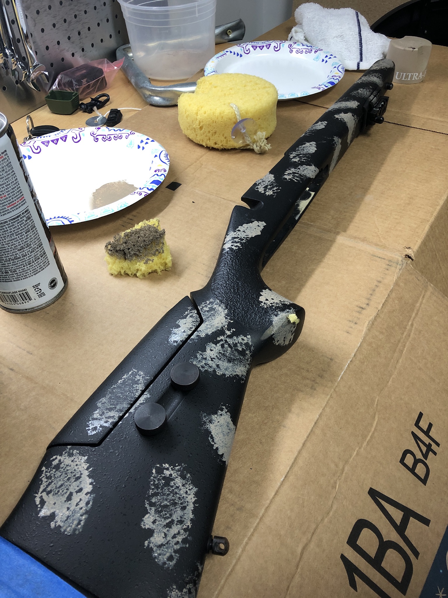

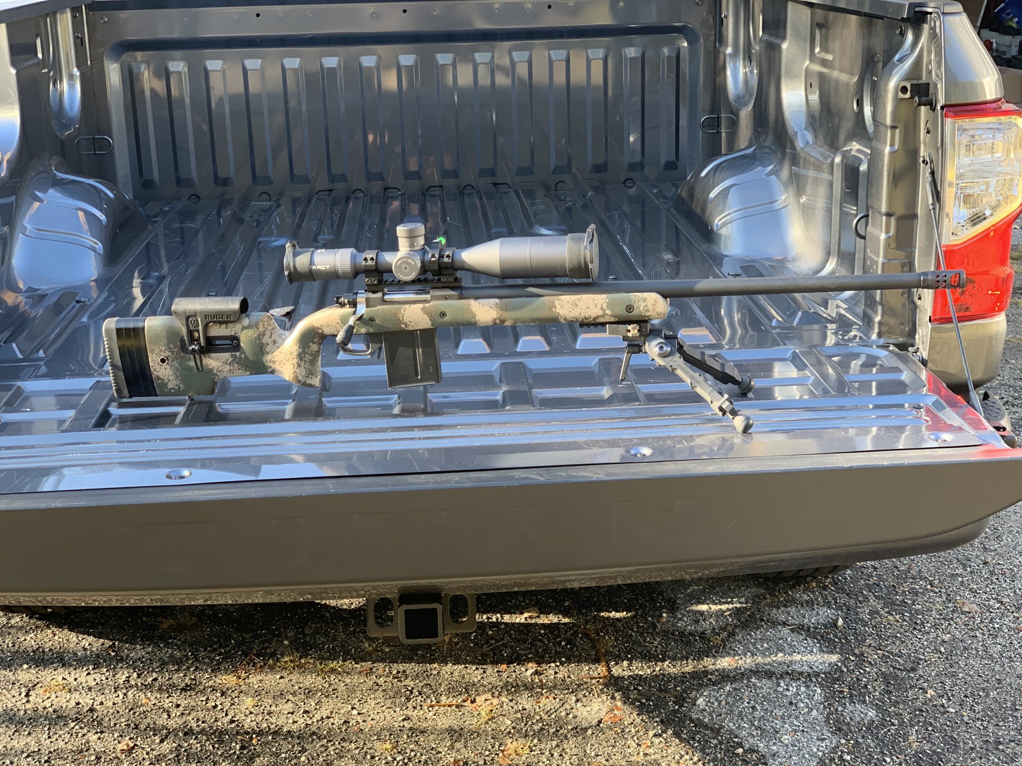

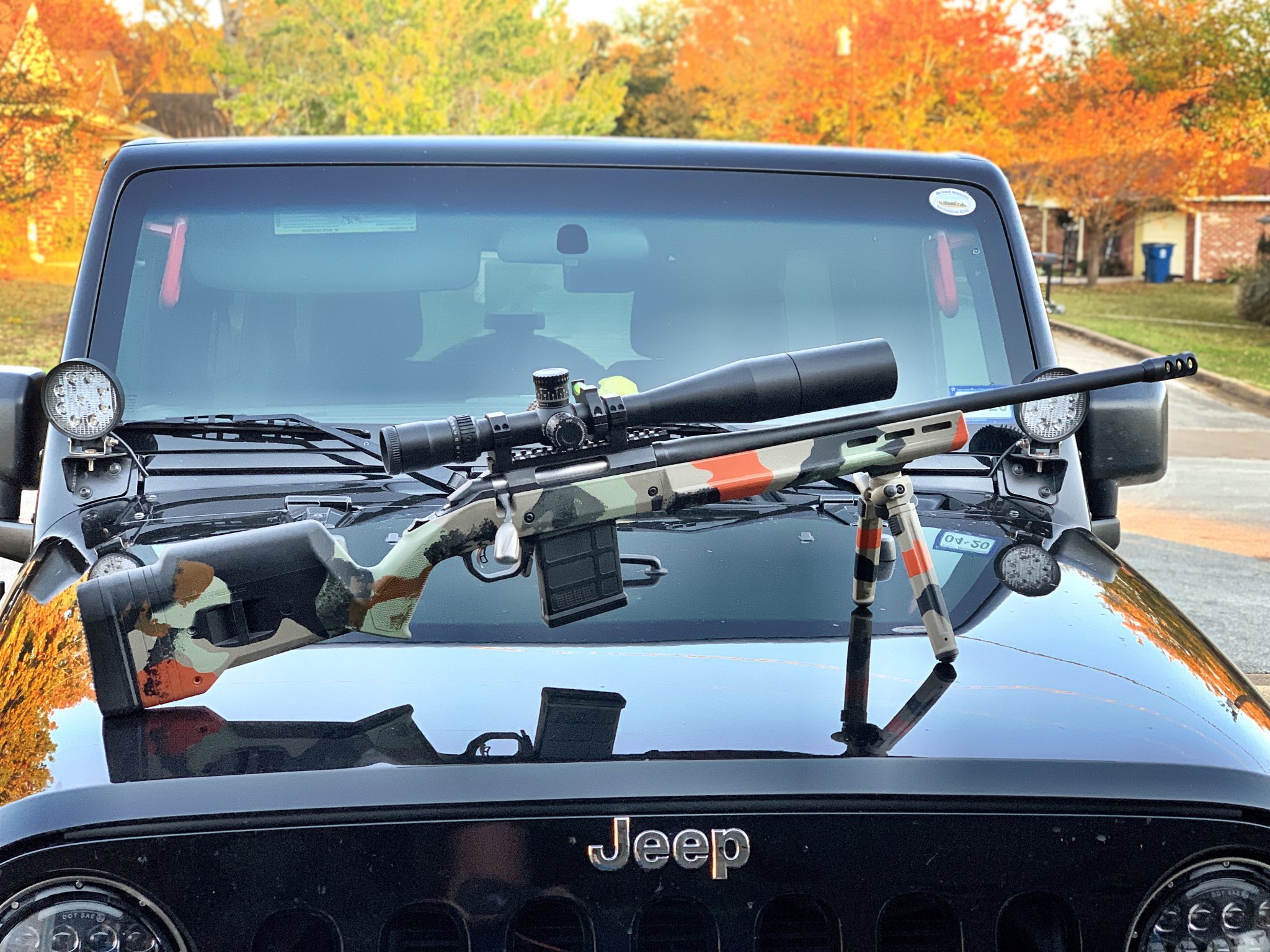

Rifle look really good.

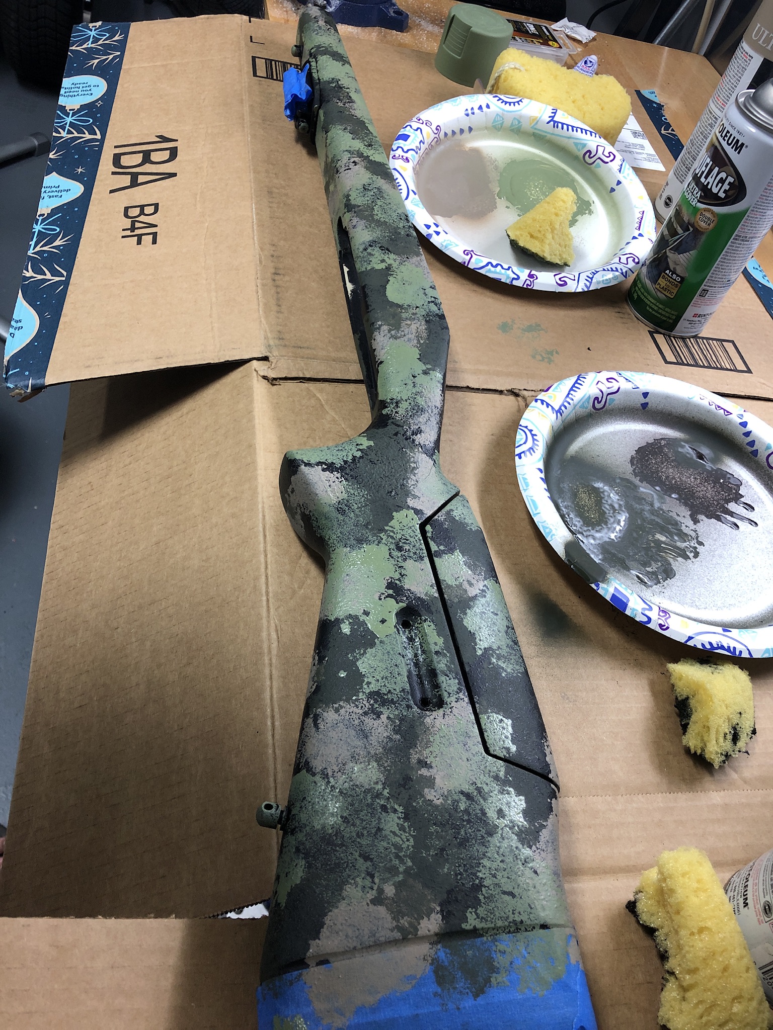

Kinda an odd question but what sponges did you use?
I have a McMillan a3 I am wanting to do a similar paint job to.
The cheaper the better. The big grout sponges in with the tile grout at Lowe’s or Home Depot. Cut them with scissors, then rip little chunks out of the smooth edges to make them more “natural looking”
I went to hobby lobby and bought a 4 pack of the natural sea sponges for like. $4. They’re small, but the right size. They worked great. I got them wet and squeezed them out really good so they were damp. Dip in paint and go to town
Two thumbs up for the small sea sponges. Always worked for me in the past. The natural sponges are good to go out of the package. I tried the grout, and also car sponges in my first few attempts and didn't like the time I had to spend picking on them first to not make the stock look like some horrible painter's accident.

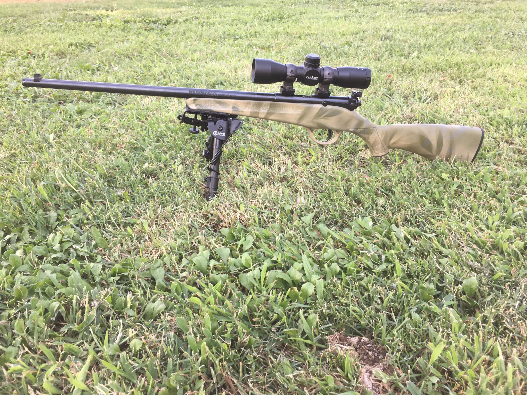

A rascal I picked up with a blemished stock , the kids had fun giving it a krylon camo job using some leaves for stencils
Reactions: Snuby642

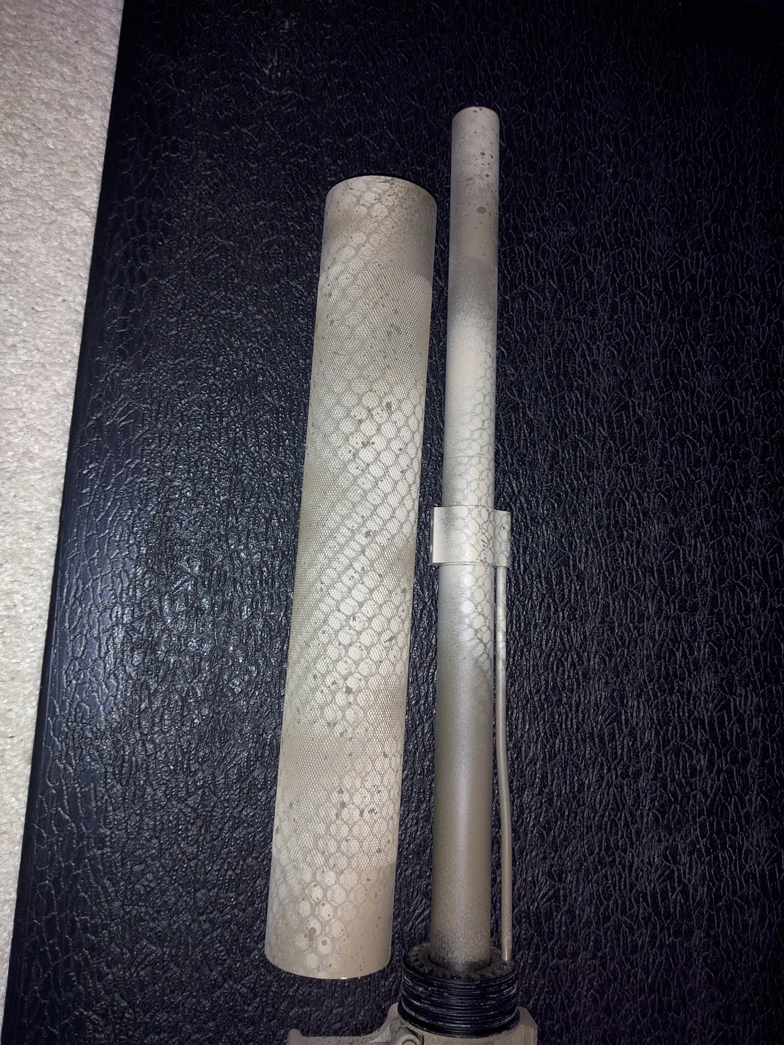

My previous Aluma-Hyde project since I'm not one to usually sell my weapons. CMMG done up with some taping to protect some areas. Found an old mesh laundry bag for some added "texture". I may try the sponge method on a different setup. Glad to say I color outside the lines....
I've used Ghillie netting before to get a similar effect but larger, slightly reminiscent of Kryptek.
