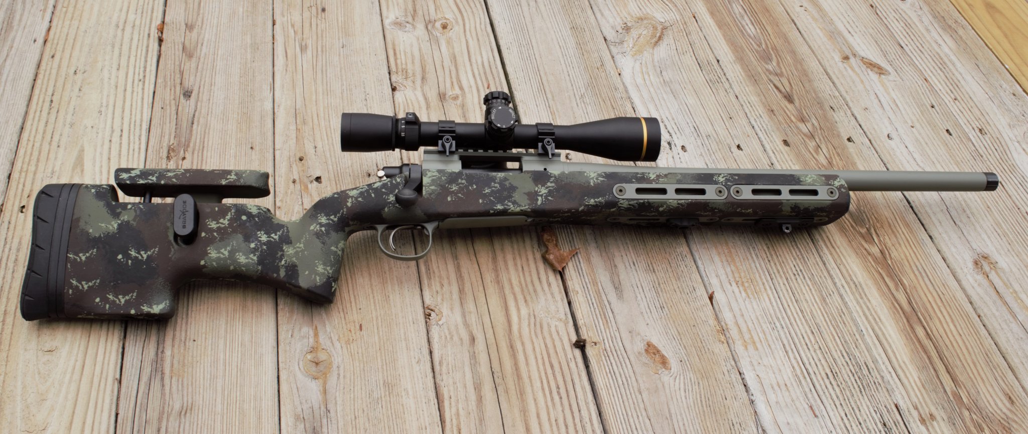

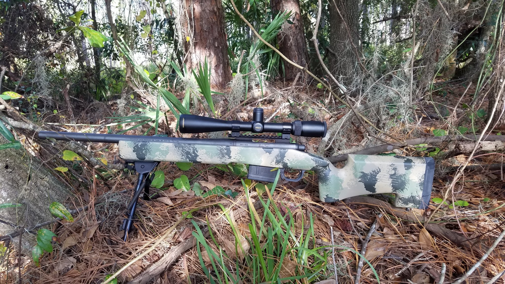

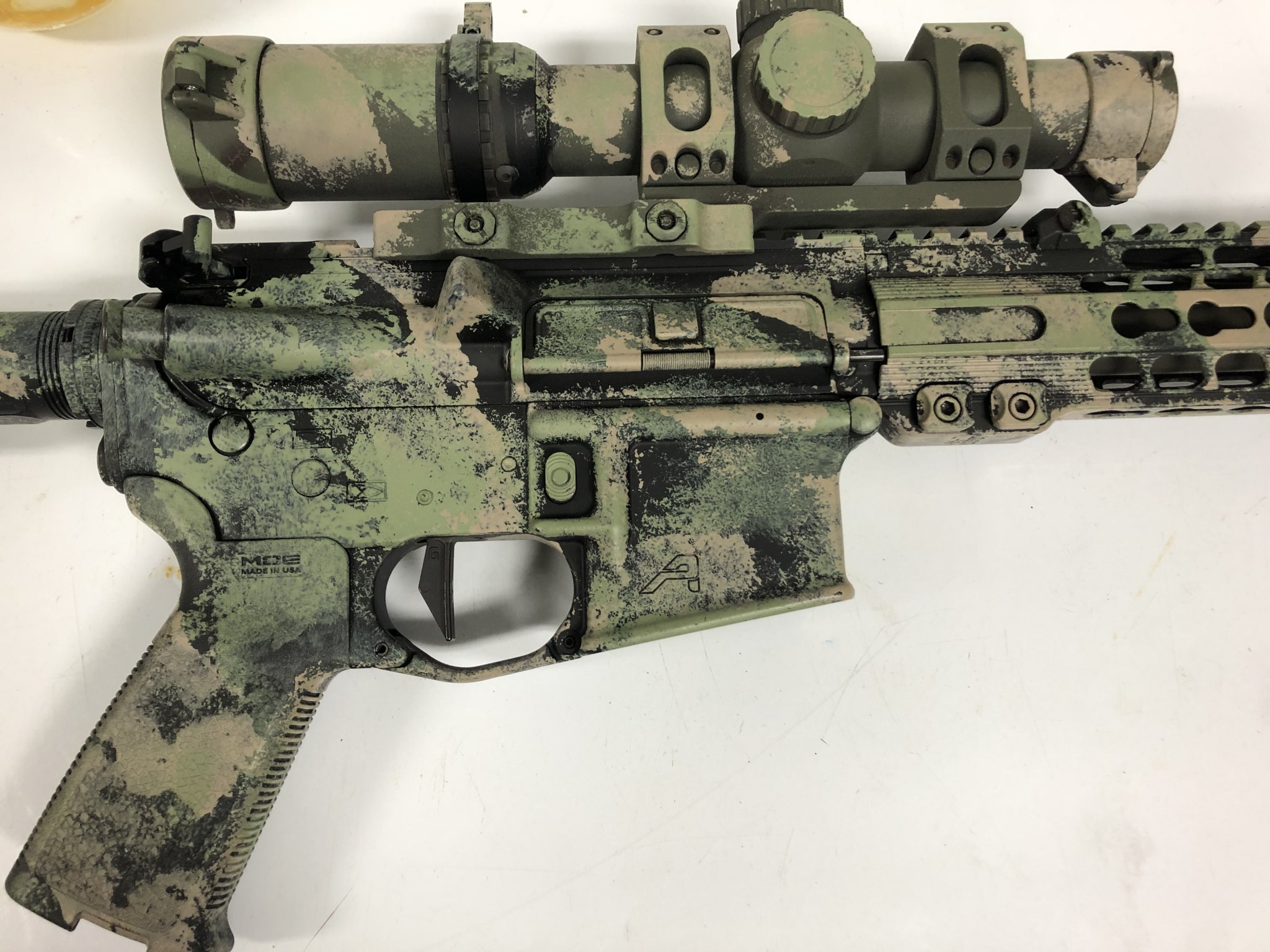

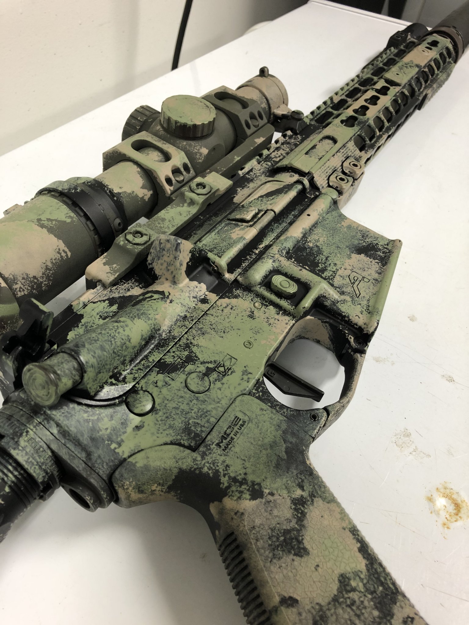

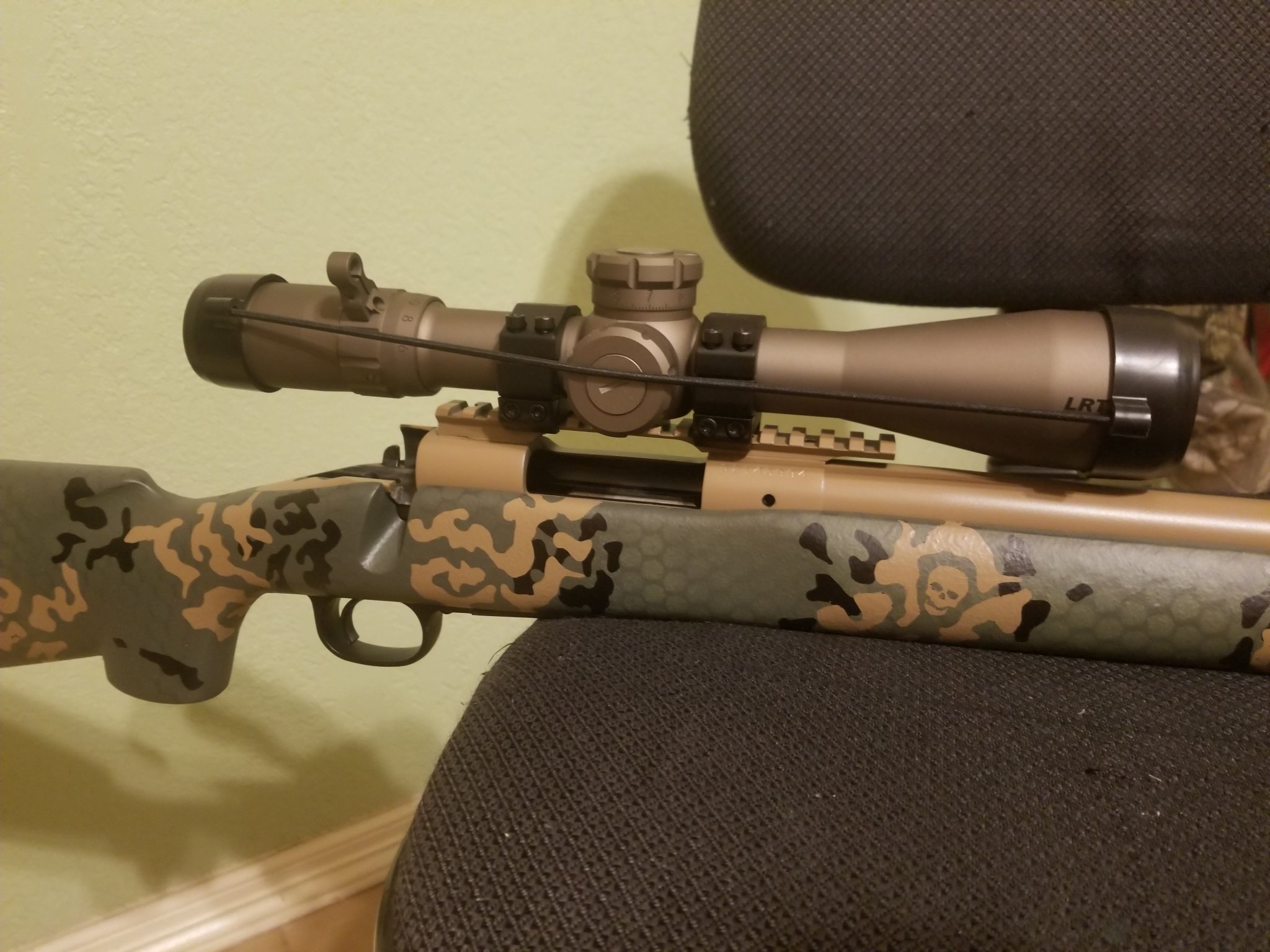

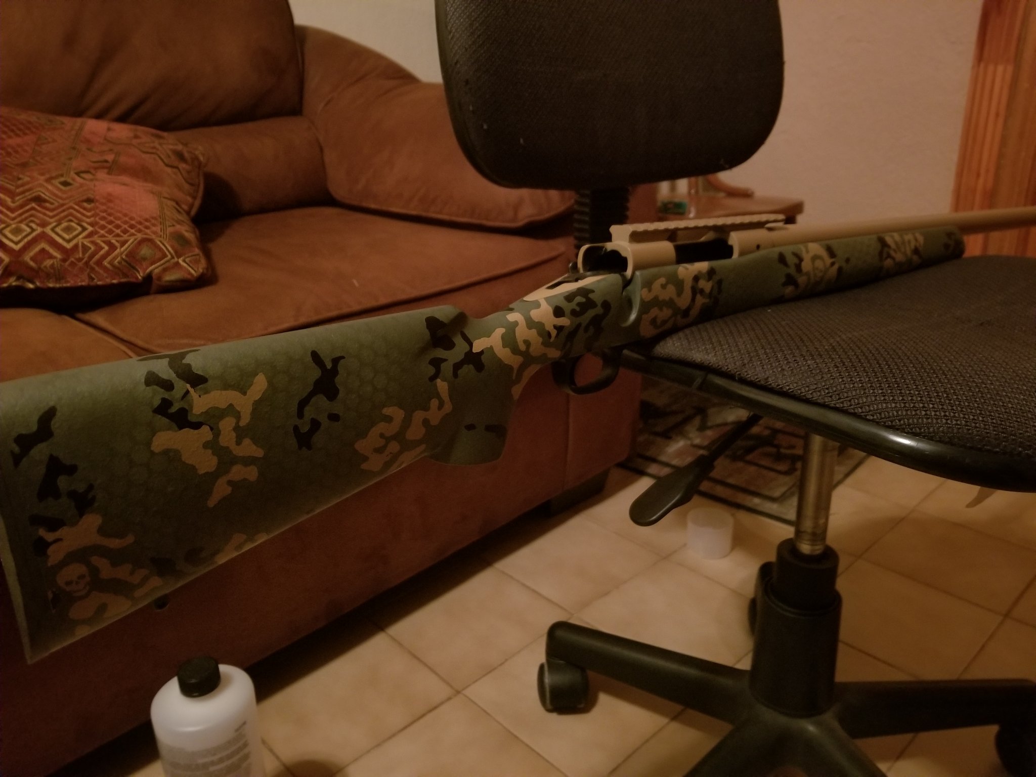

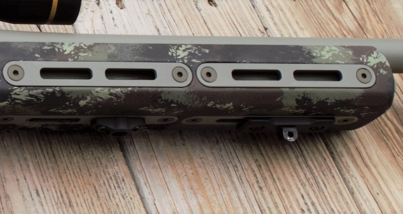

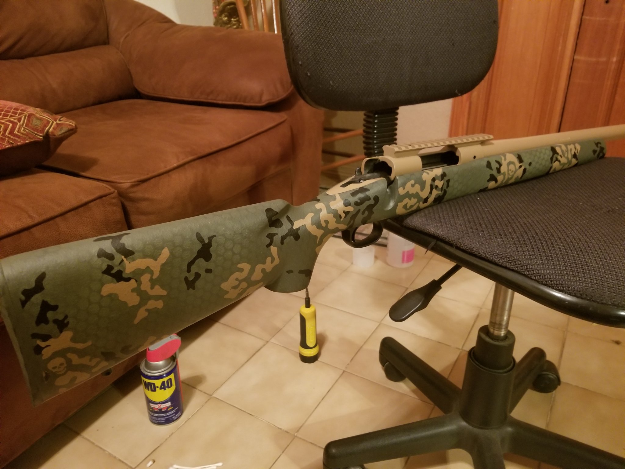

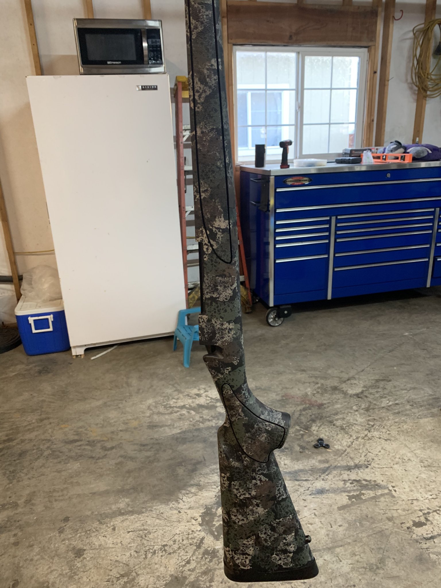

Just finished this up the other day. Standard technique, alcohol prep, sponge the color, double layer of matte clear coat.
Would you mind sharing your technique???
I used the same sponge method as the OP and basically did stripe sections of army green and khaki Krylon, then came back and did a second layer of green on the khaki and khaki on green. Made sure not do do too much so the black showed though giving a kind of worn look.

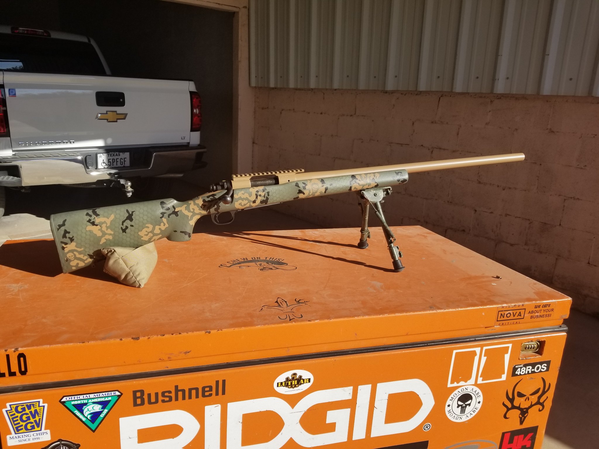

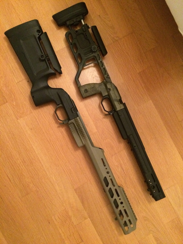

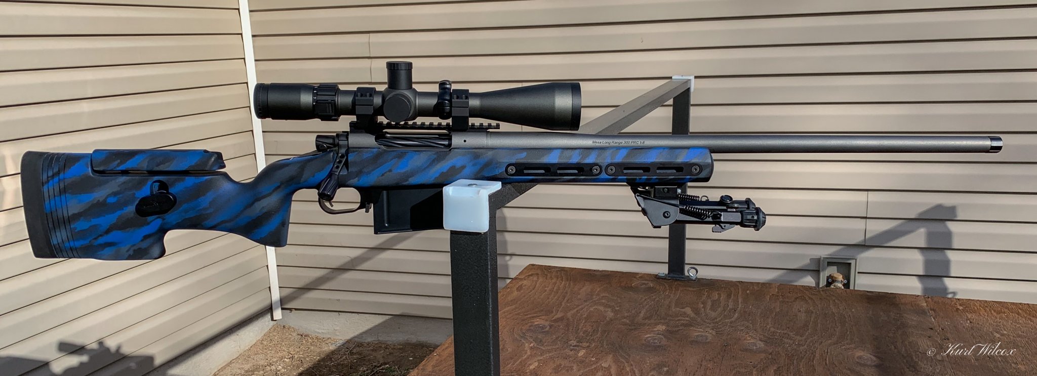

Mix match.

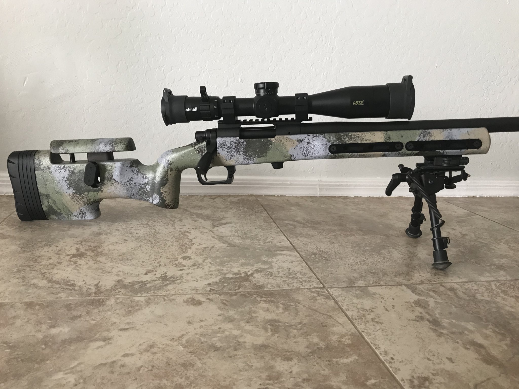

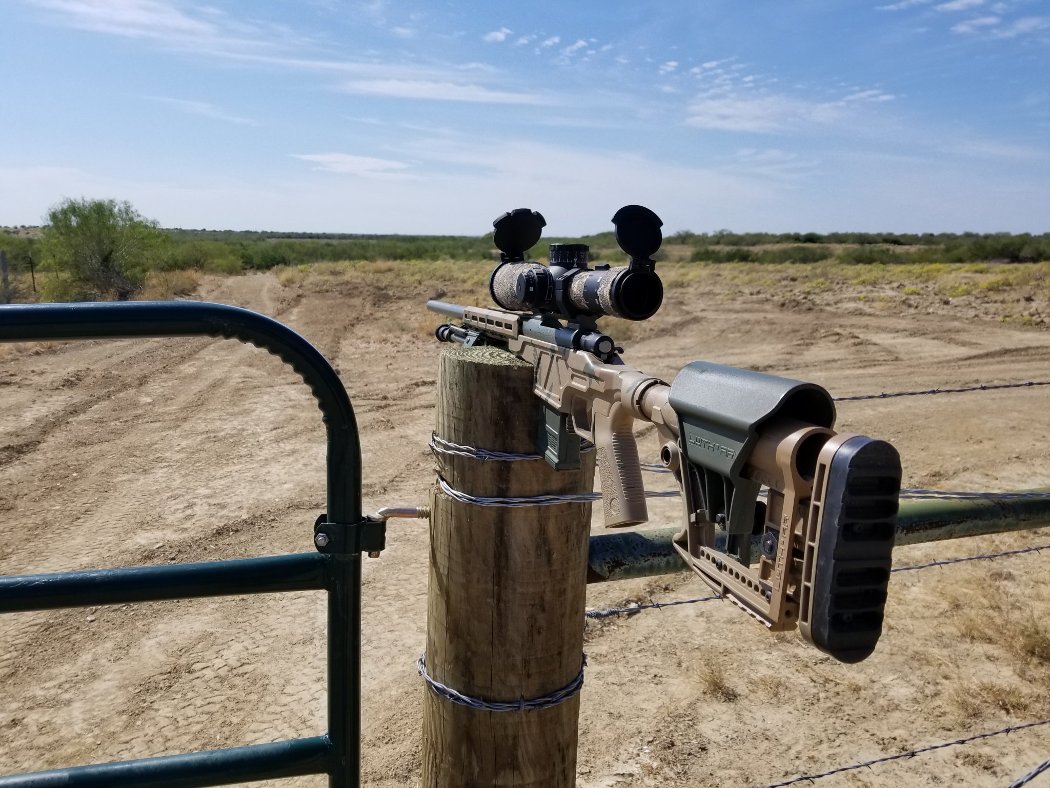

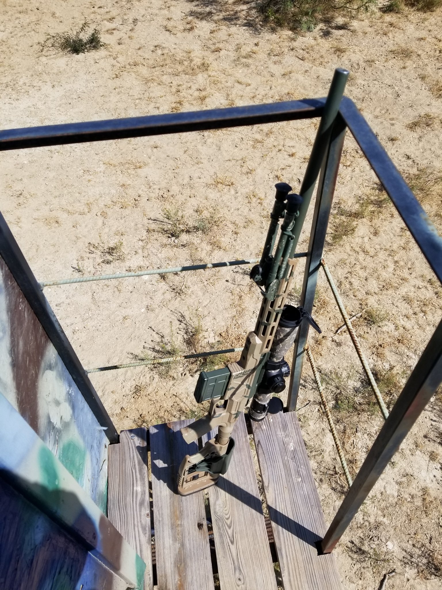

On top is a KRG Whiskey-3 for Remington 700 Long action.
Under it is a KRG Bravo with the enclosed forend for Remington 700 short action.
Reactions: stello1001

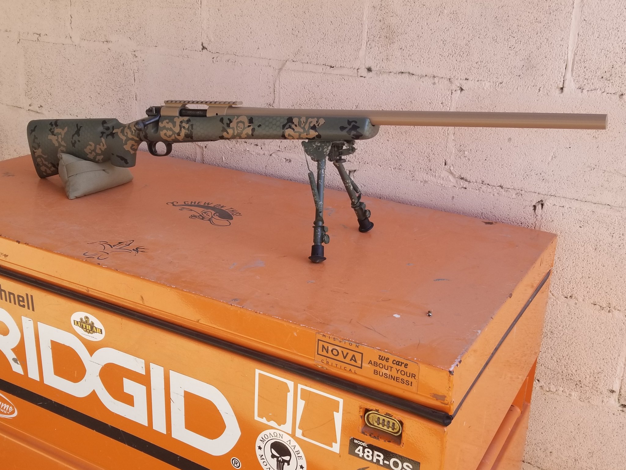

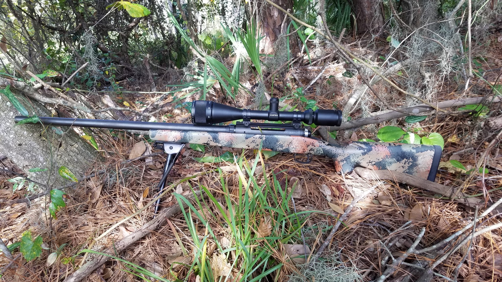

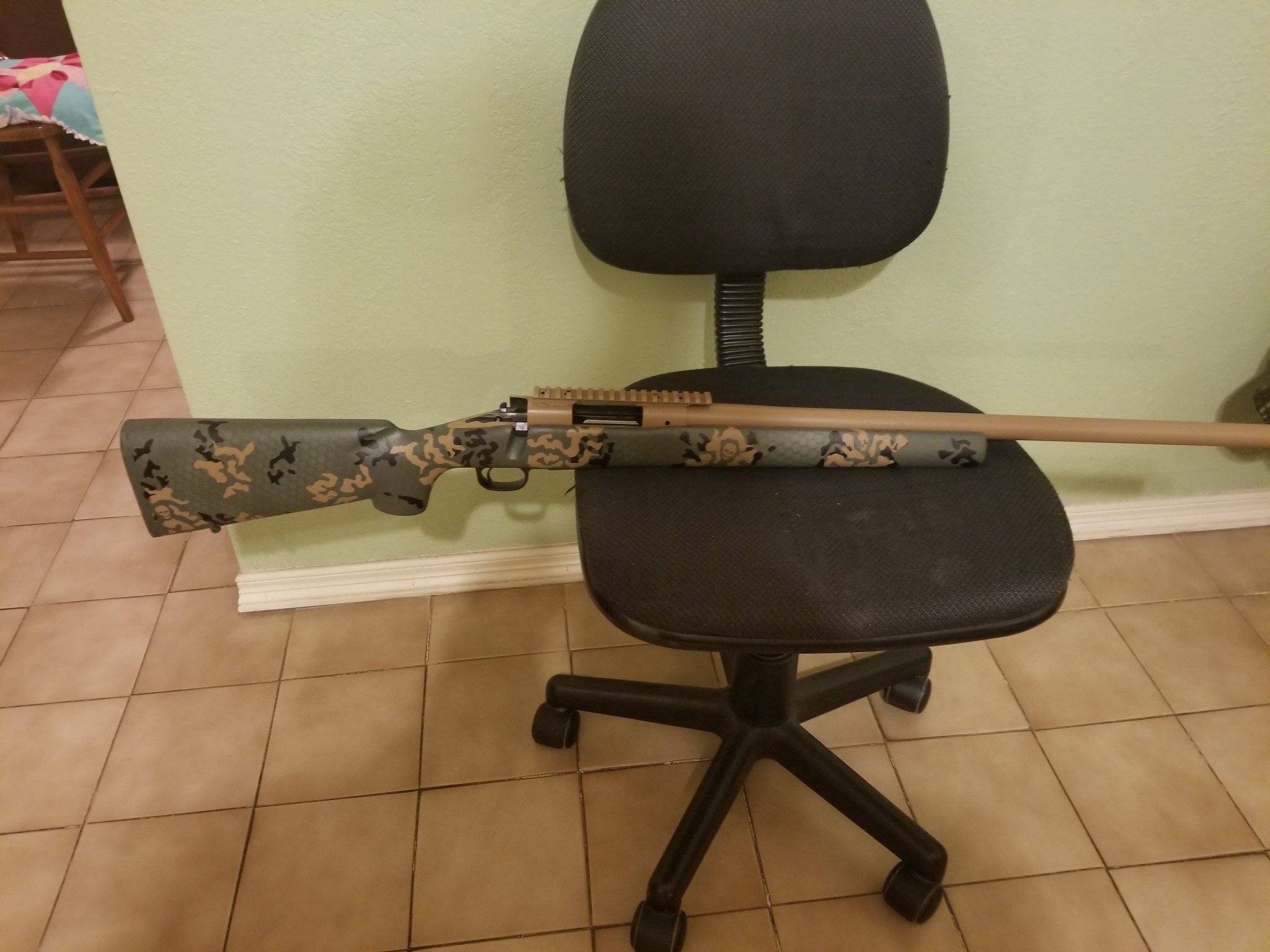

I did not use any clear coat. The paint seems to hold up fine enough without it.
Did a practice stock before I did any of my nicer ones. This is just a Remington adl stock.

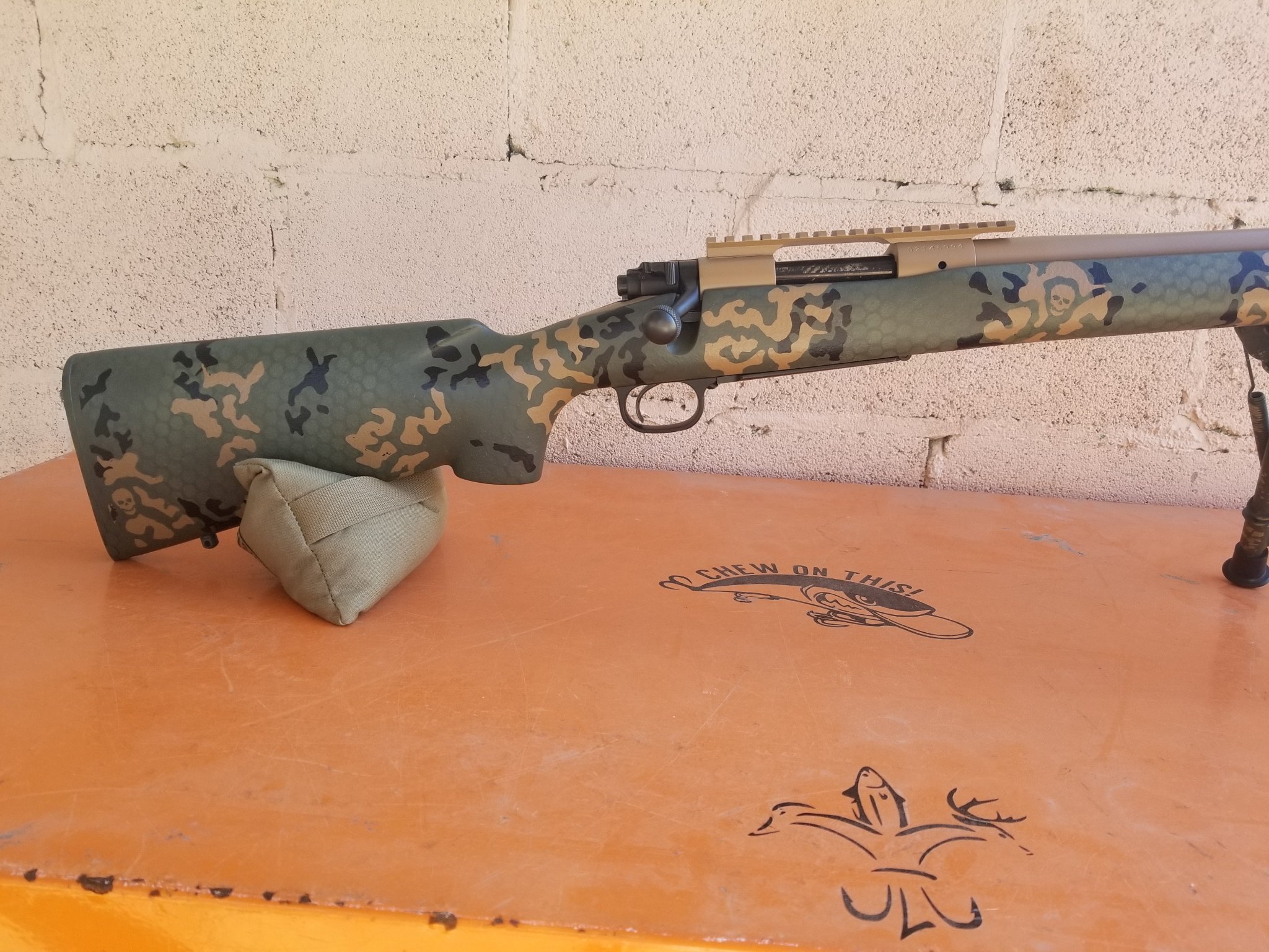

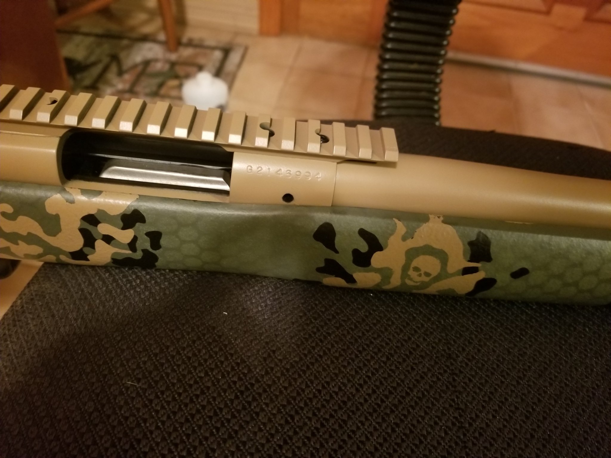

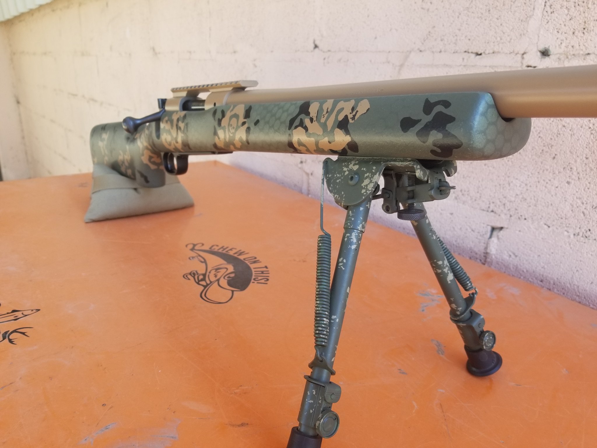

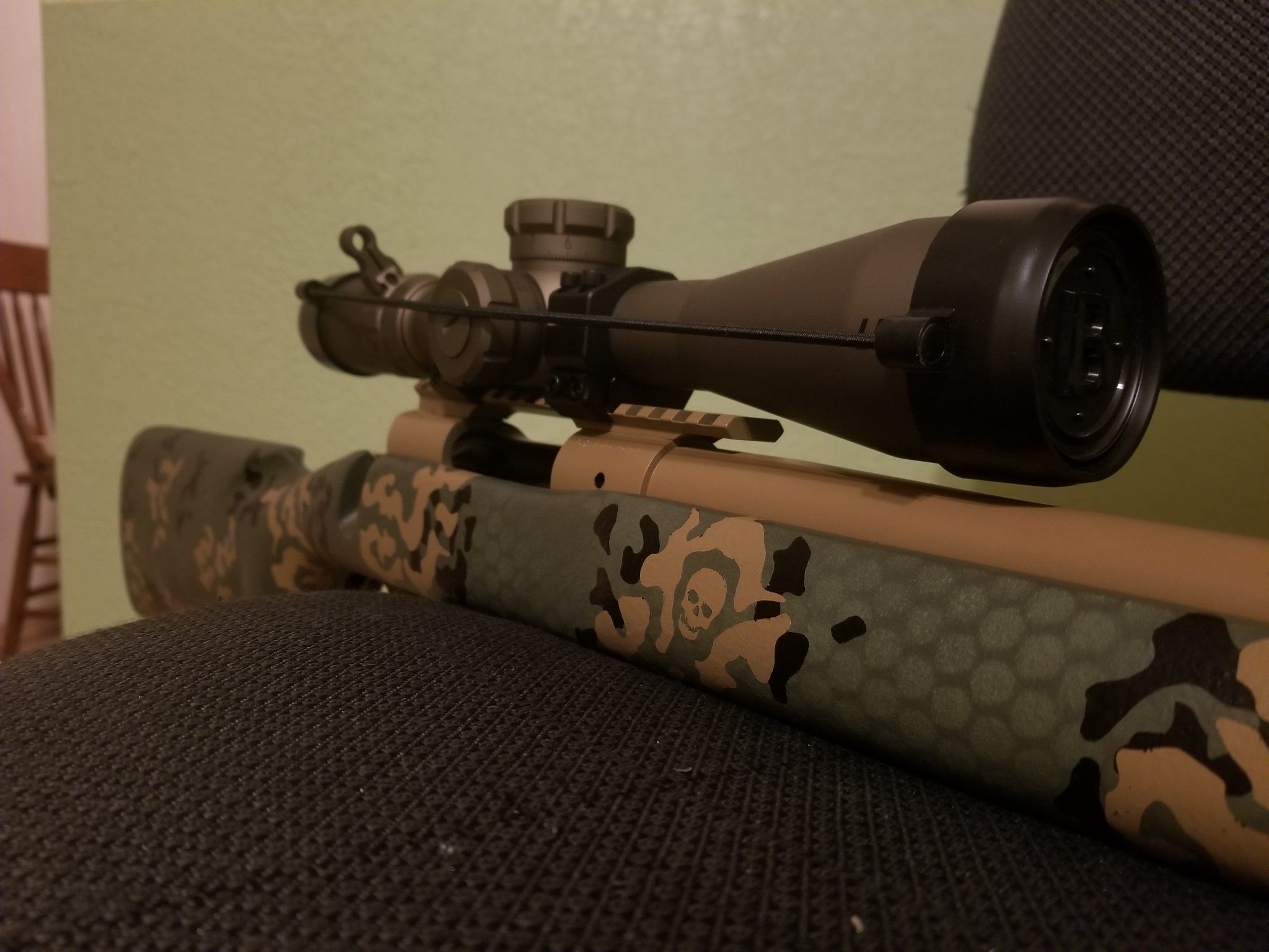

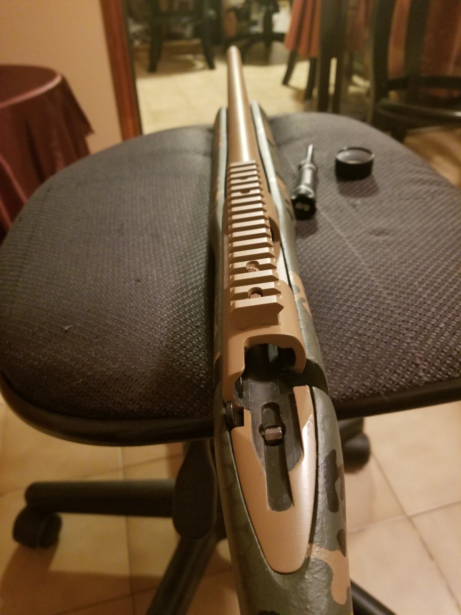

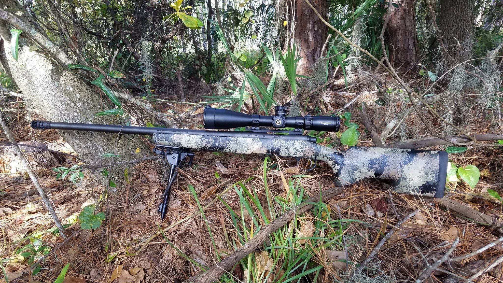

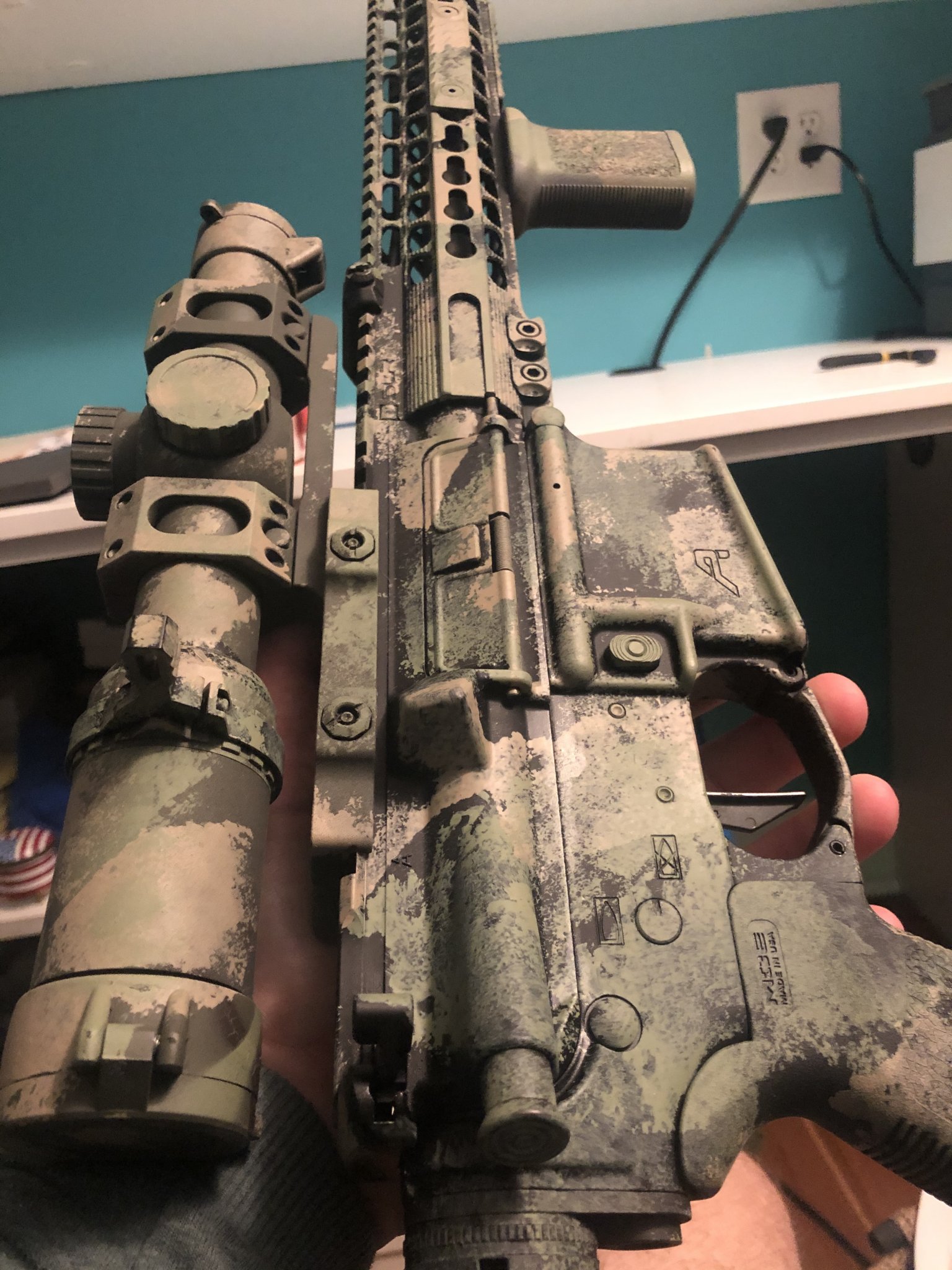

A few more because I took the rifle out for some natural light.

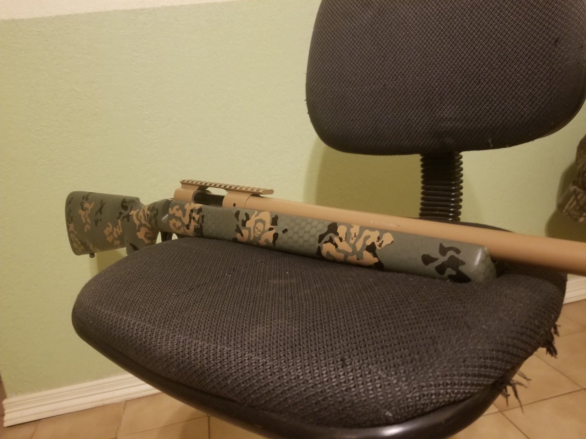

That nutmeg color paint gave me a lot of trouble. It would literally take forever to dry off and it even ran down as soon as it made contact with the rifle. Some of it even came off when I pulled the stencils. I guess it wasn't completely dry even though I waited a long ass time...

I think my rifle came out pretty good regardless of the shitty nutmeg paint. It definitely looks much better now.
Anyone have Any suggestions what color I should do the rings for my rifle above? Really don't want to keep them black. I was thinking OD green...

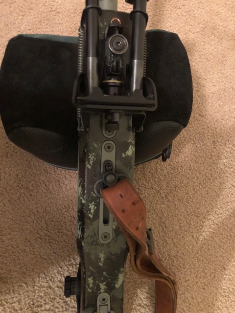

so how does the paint hold up on the metal? Does it scratch easily?
So it's actually pretty good. My howa rifle has some scratches on the barrel but all are at the muzzle and just before the muzzle. I gotta admit though, I did not have a case for that rifle and the 2018-2019 hunting season was really really harsh on it. It always went in the buggy tip down into the feet of the passenger or just riding in the backseat lol. I also dropped my rifle from a pretty tall deer stand. The rifle has a few scratches on the chassis but those are all on the under part of the handguard or right in front of the magwell. That is because I use the magwell as a barricade stop and one of the deer blind I used extensively had a metal window frame. All in all though, those scratches are barely visible and the paint has held pretty good for about a year and a half now.
