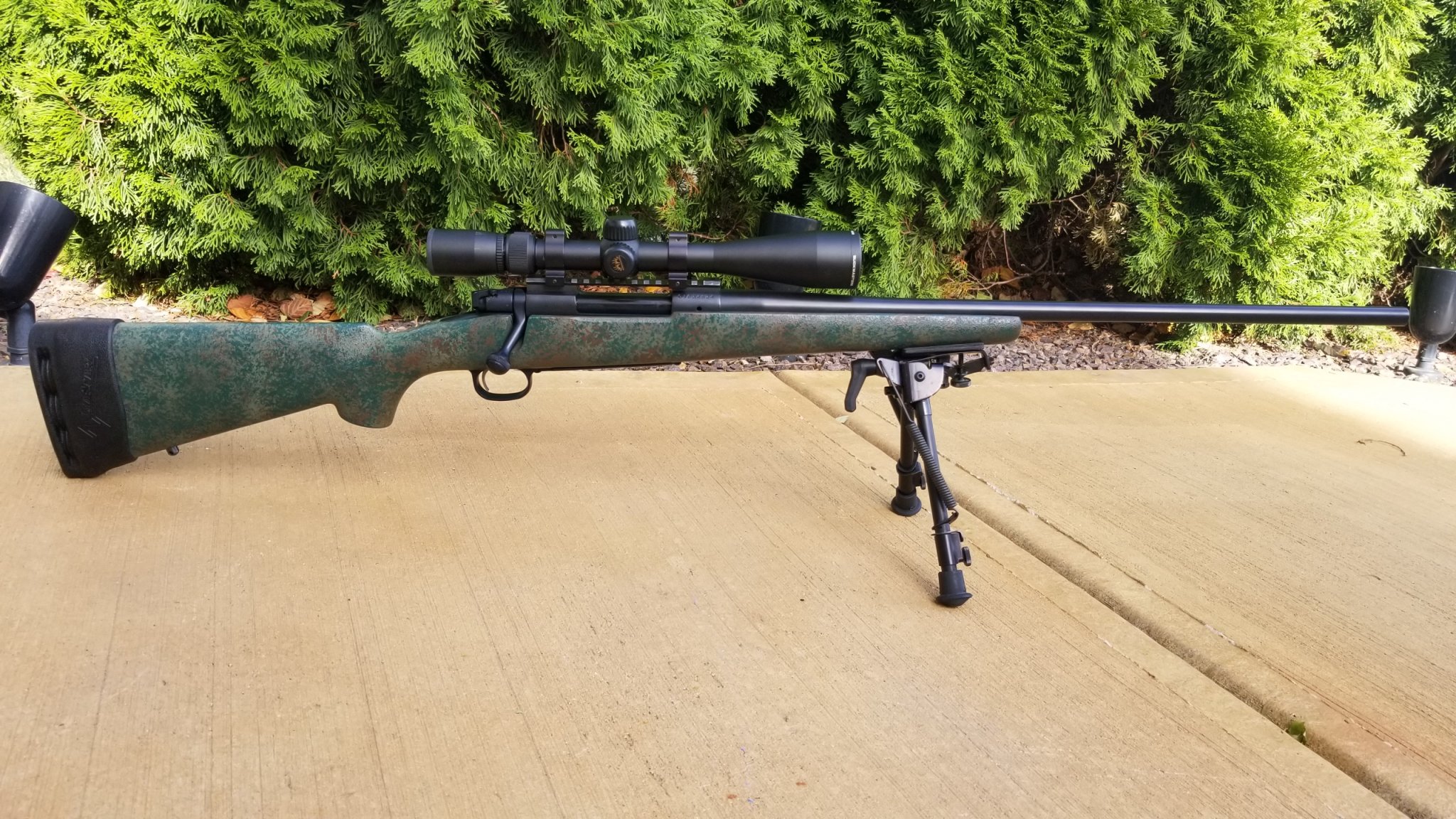

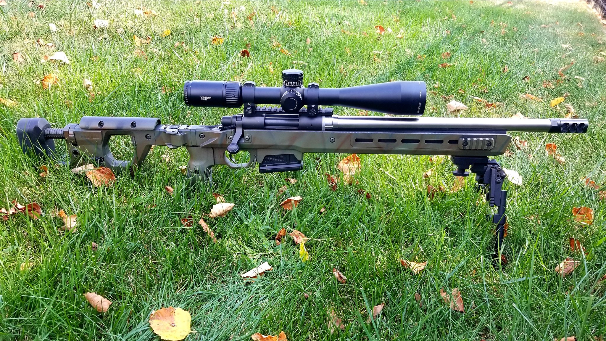

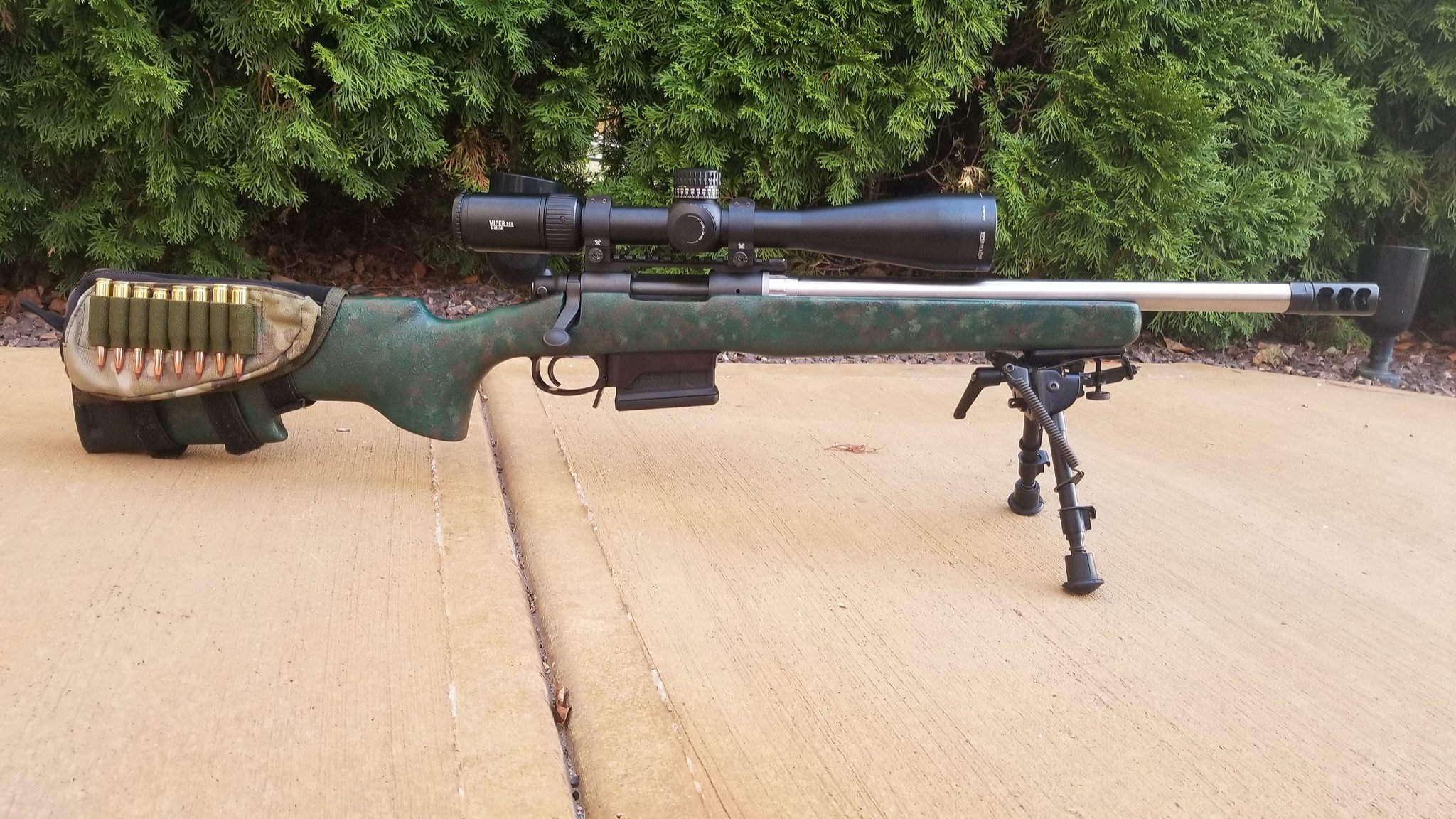

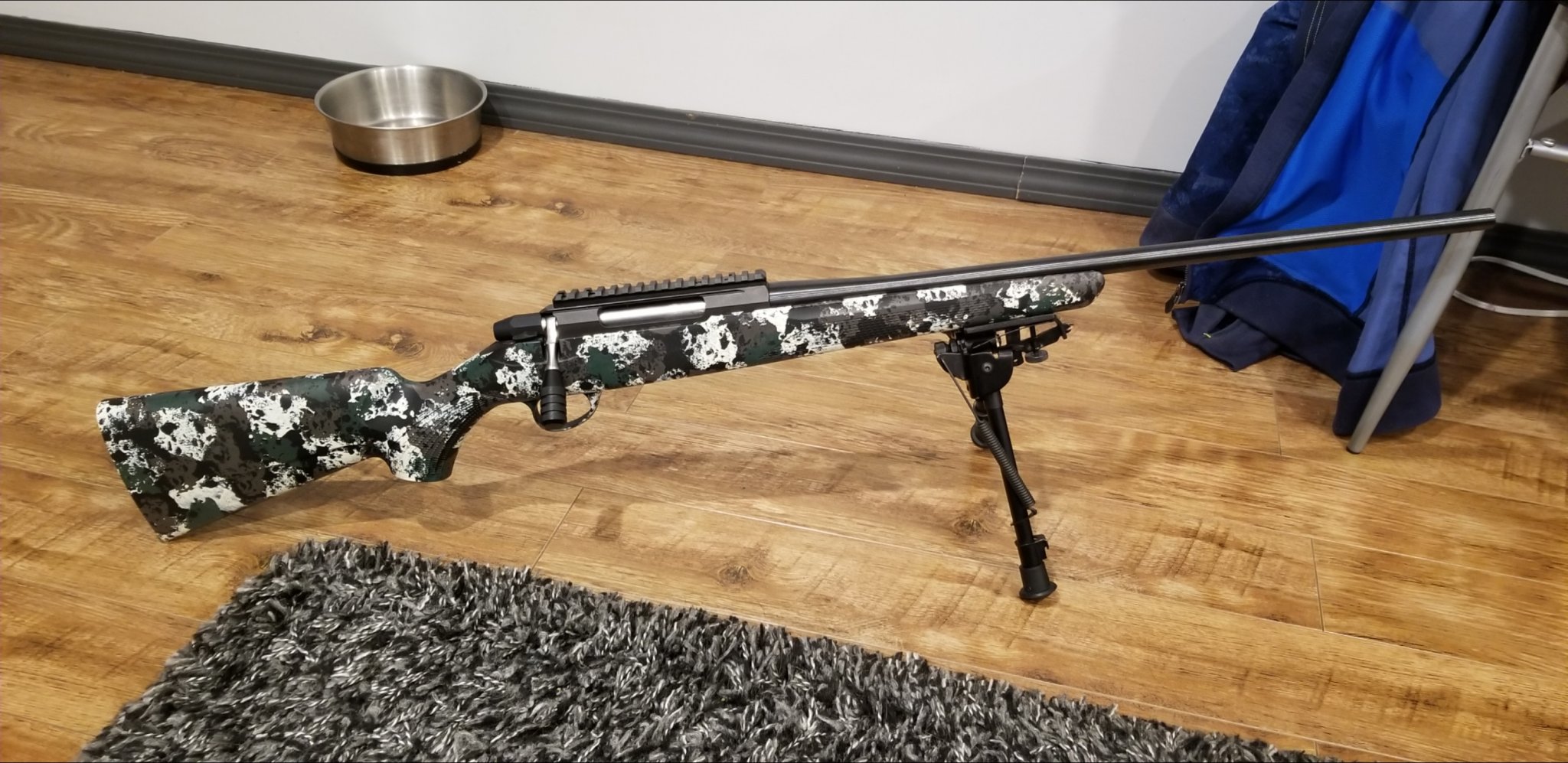

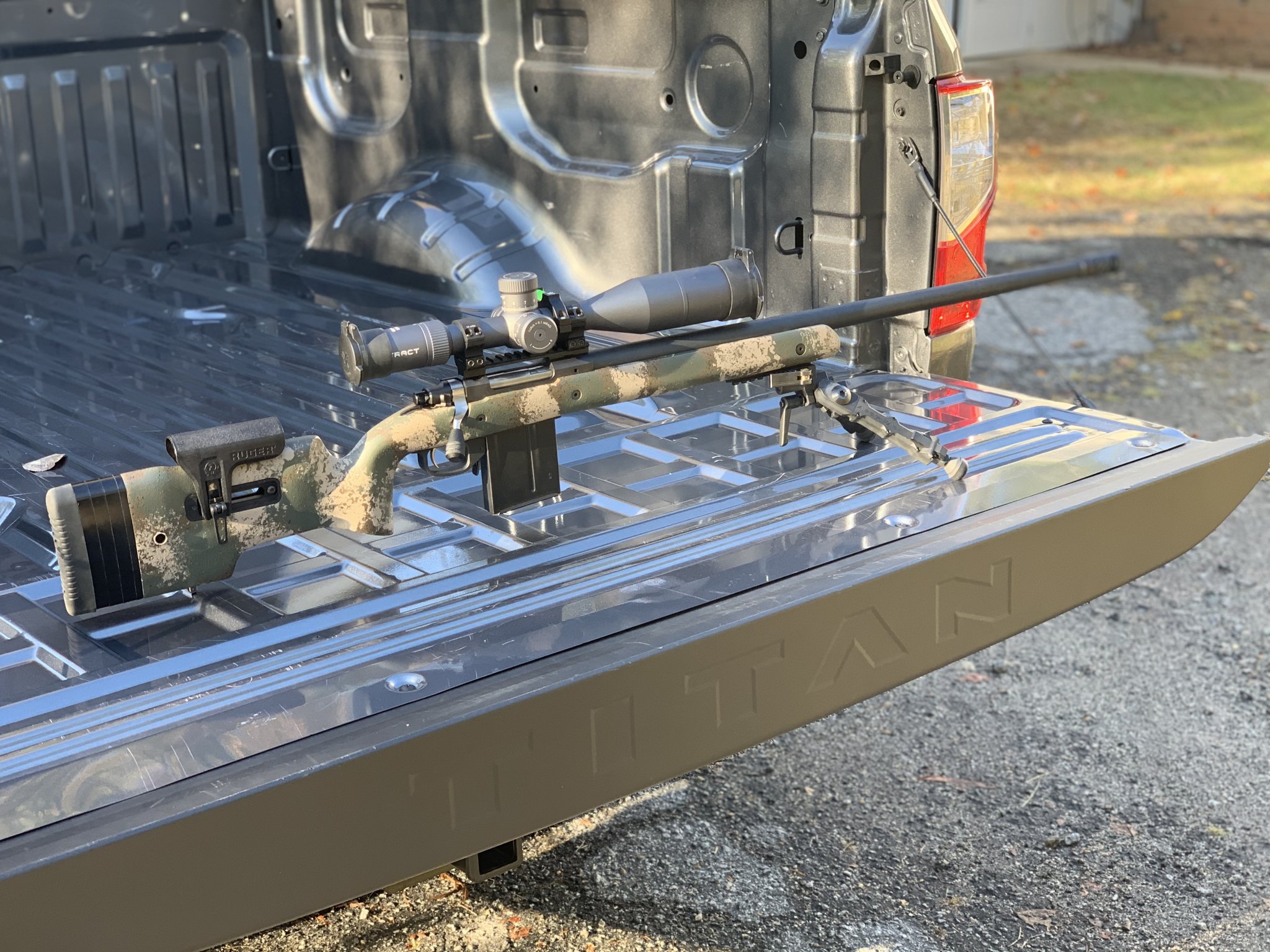

Just got done sponge painting my T1X and Howa/XLR Element...
How does that clear hold up to abuse? Realistic use not using it as a hammer of course.
Chip and scratch resistant?

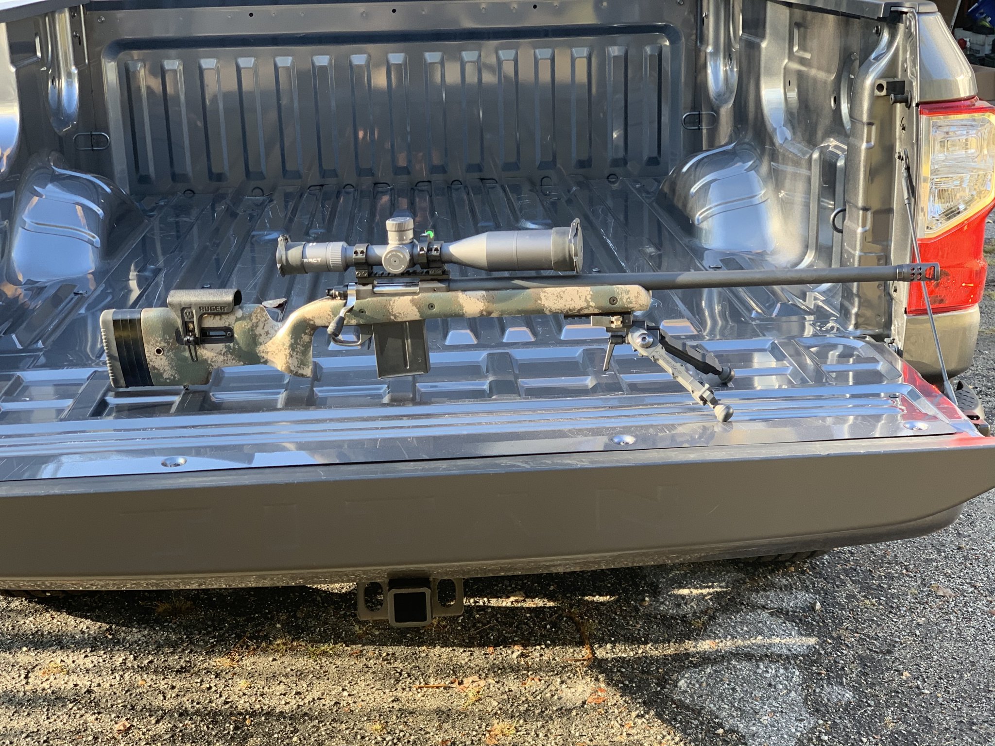

I've done a few like this. My 22lr seen thousands and thousands of rounds training off barricades ect. Held up great. I took quite a bit more time scuffing it and cleaning before I painted mine though. My others have held up great too, haven't seen as much abuse as my 22lr. My 223ai coyote rifle got banged around quite a bit in the truck

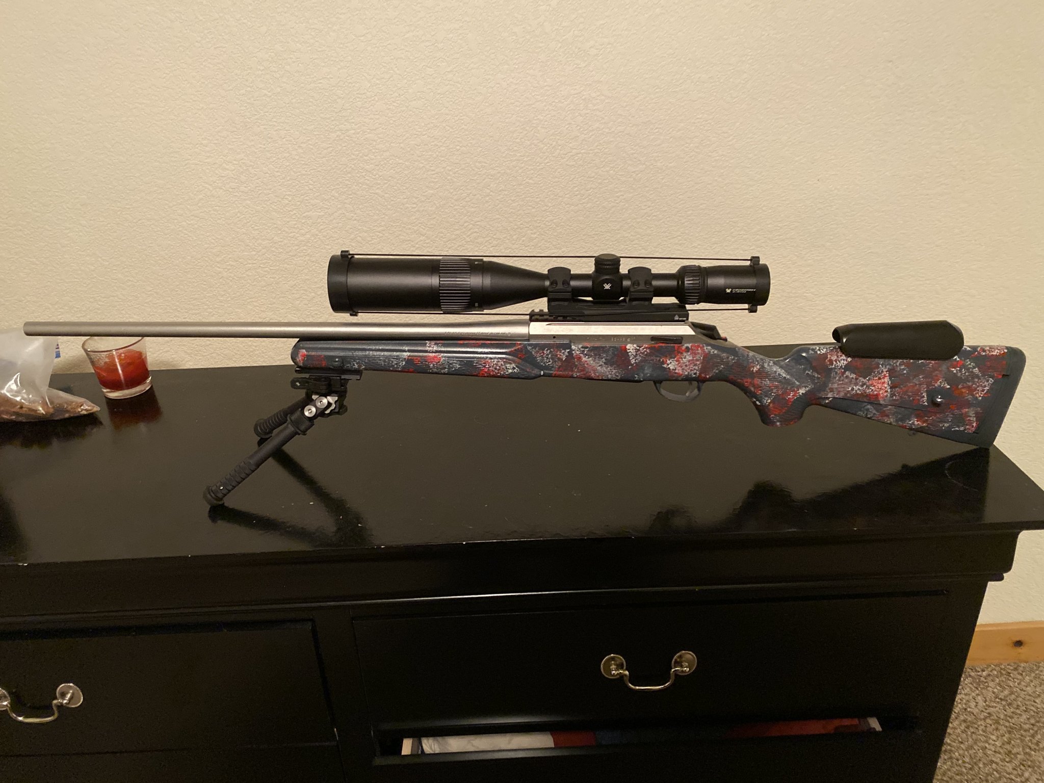

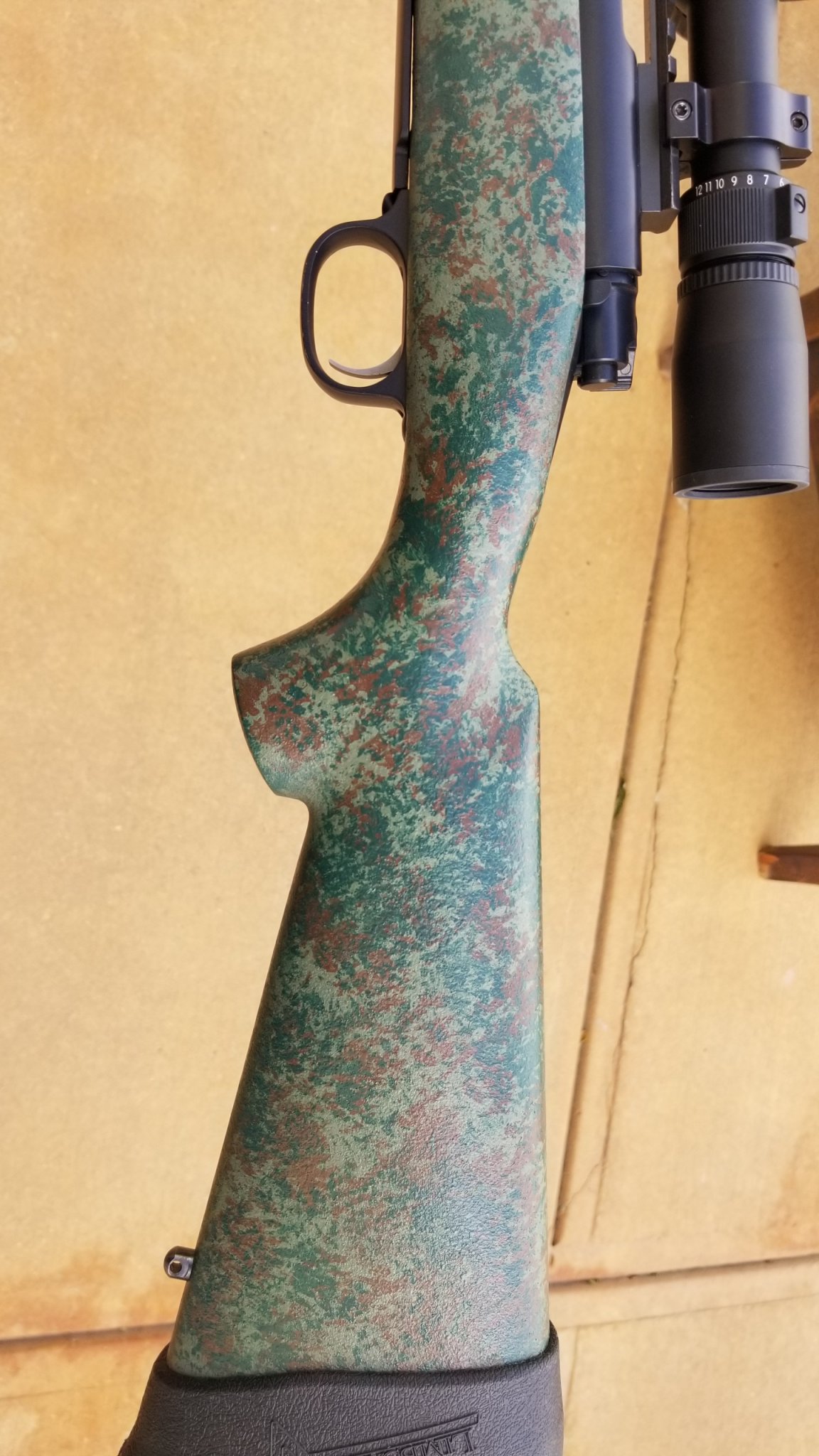

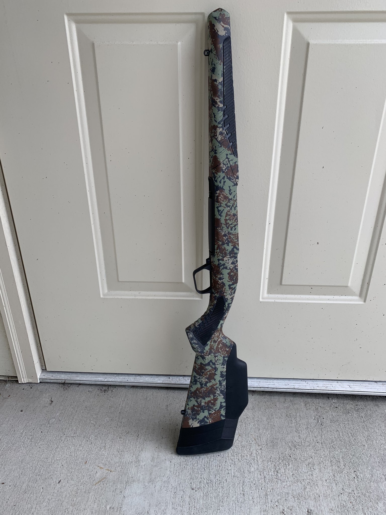

Just got done with practicing on an ald Savage Axis stock. Quick, easy, and it turned out pretty good.
Looks great but I would recommend taping off the recoil pad so paint doesn't get on there. IMO it gives it a more professional, finished look and the paint will wear fast on the rubber. Just my two cents-you can take it or leave it....
Good call and a point I learned. This was a practice piece to get down the pattern for the colors and I will absolutely tape some areas on future stocks: butt pad, safety areas, barrel and receiver areas to keep out the matte clear final coats, as well as remove sling studs.

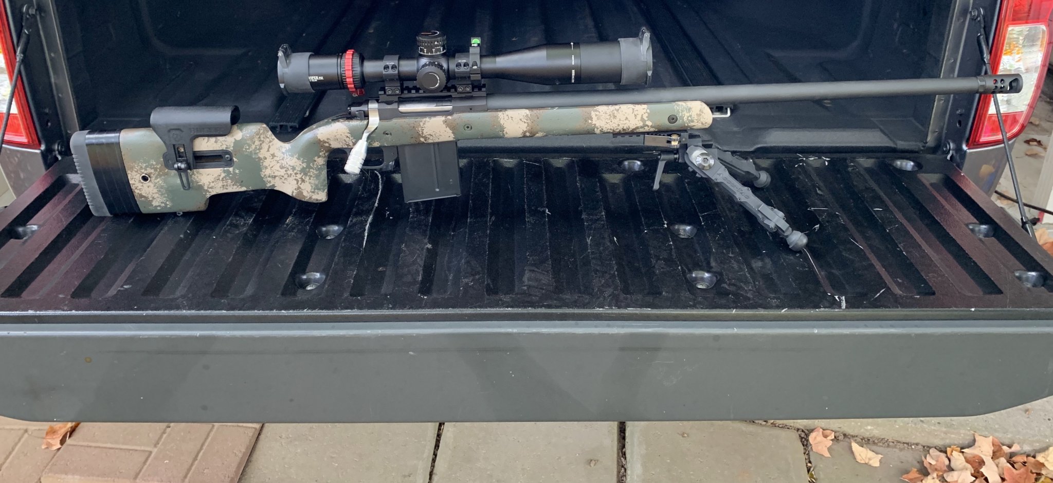

Did you paint 3 or 4 different layers to make it look like that? Love the colors/shades.
I leveraged the original black color of the stock. Started with tan, then brown, then olive.

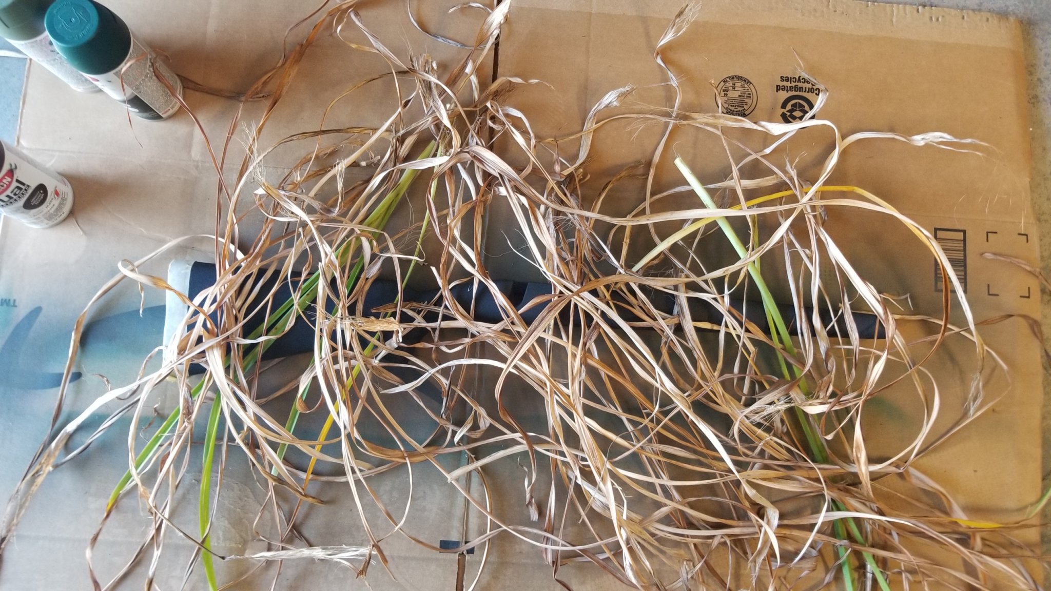

If you don't have a left over stock you can always lay a stock on some heavy cardboard, draw the outline, cut it out, hang it, put down a white base coat and then go to town practicing. It's only two dimensional but at least you get the feel for how far away you have to hold the cans, how tight you have to hold netting if you use it, what shape your sponges need to be, or how much pressure to apply, how to position stencils if you use them, what the colors actually look like, ...you get the picture.

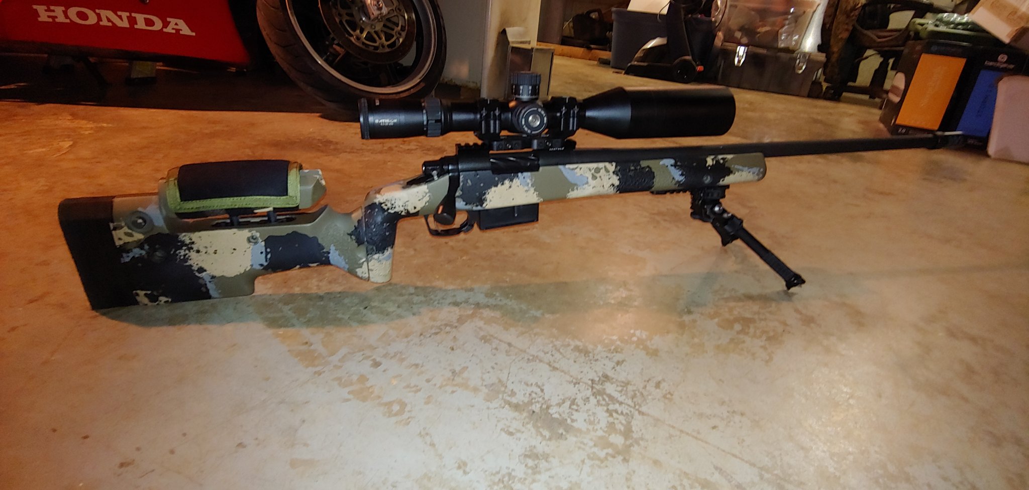

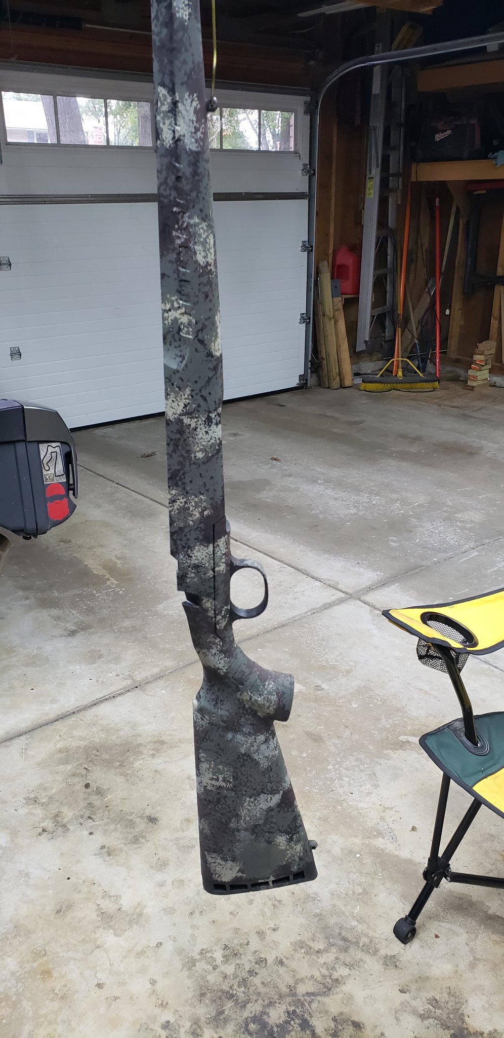

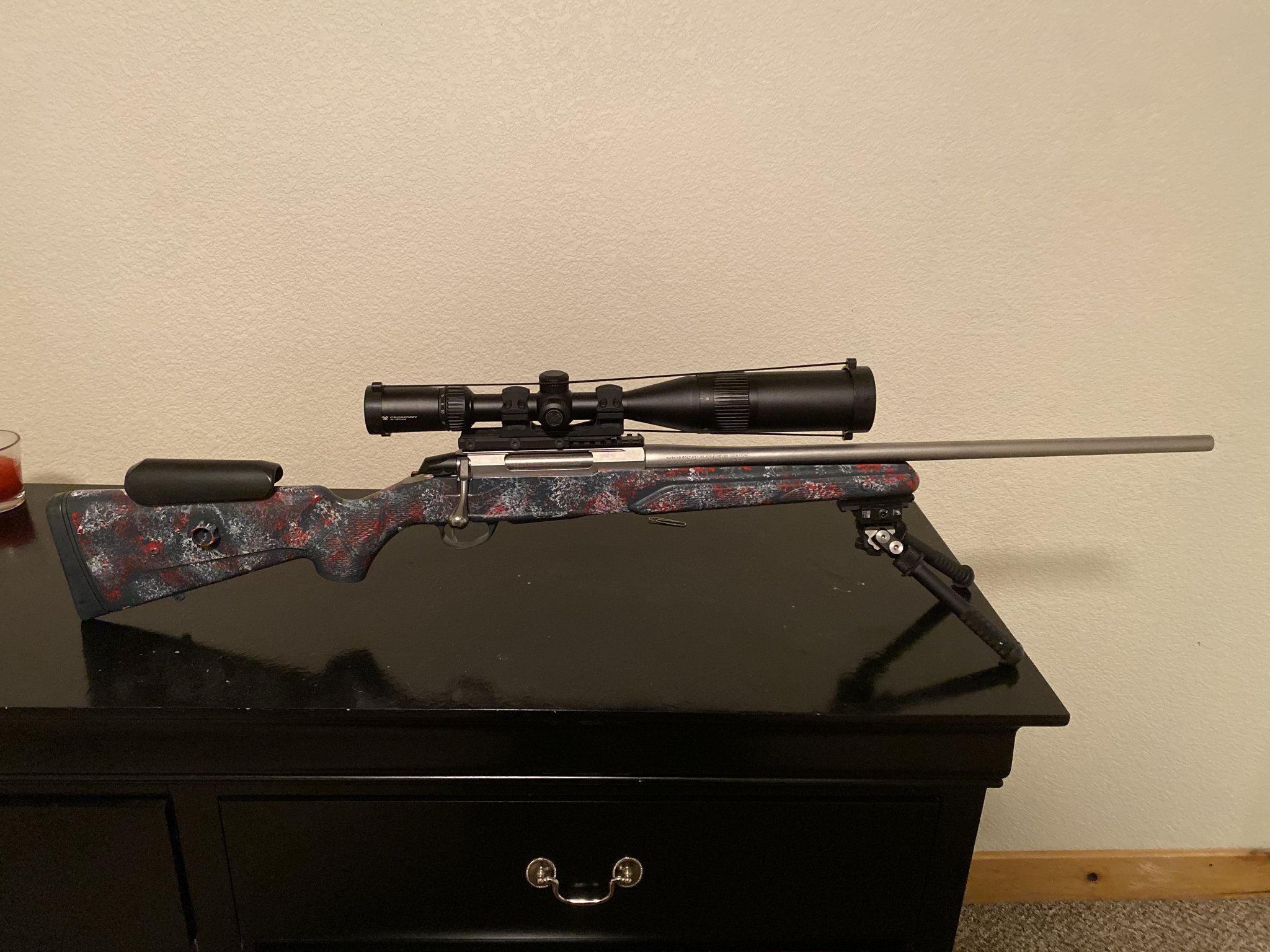

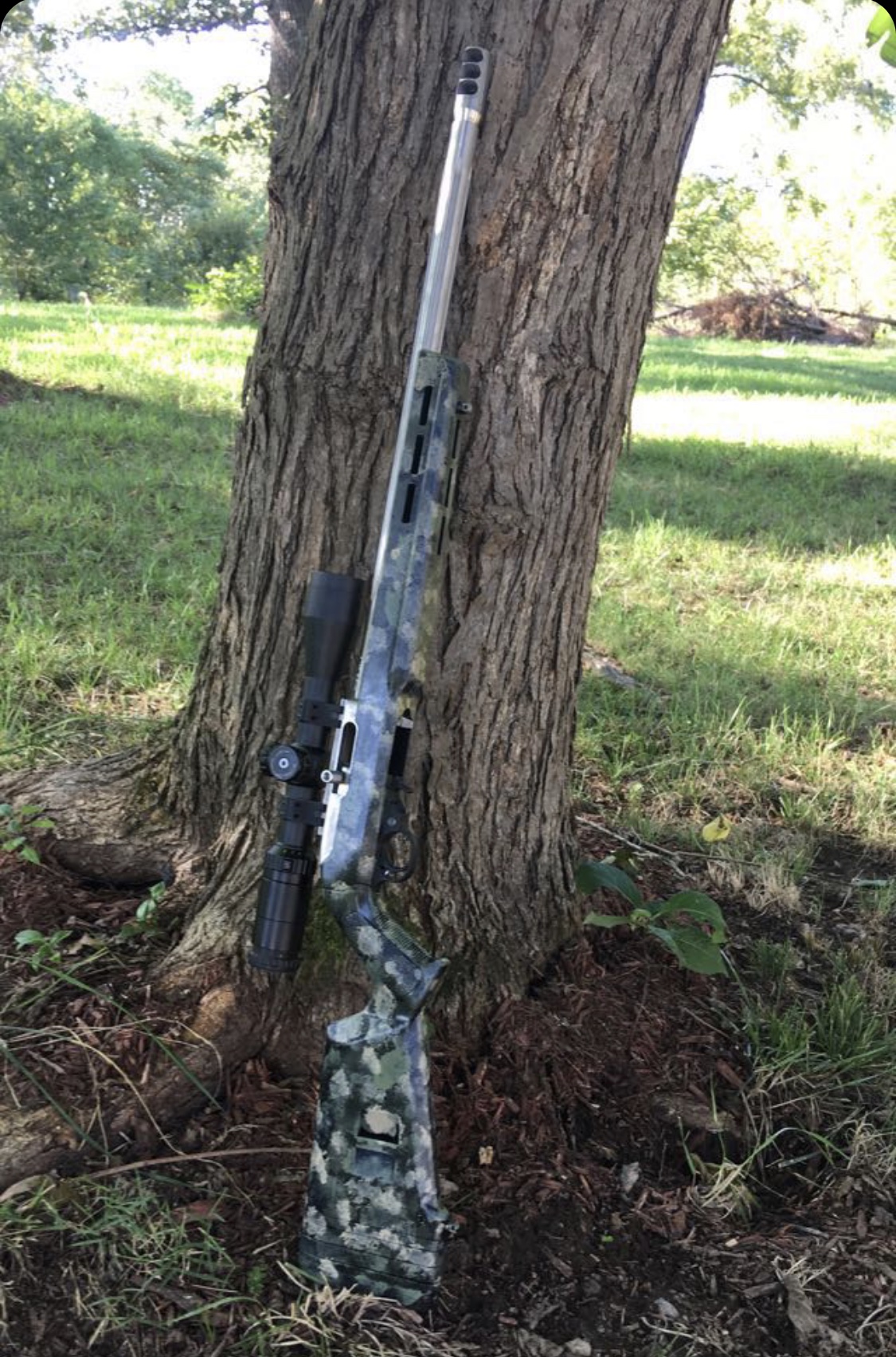

I did my tikka up as such. Some spruce trees around where i hunt, but majority of vegetation is sage and dry prairie grass.
Did you do the buttpad too? I usually tape it off and leave it black because the soft rubber usually flakes off fairly quickly even if one applies clear coat.
Nope, had taken it off so i didnt have to bother with tape. Tucked the plastic bottom metal in there so the pattern carried through

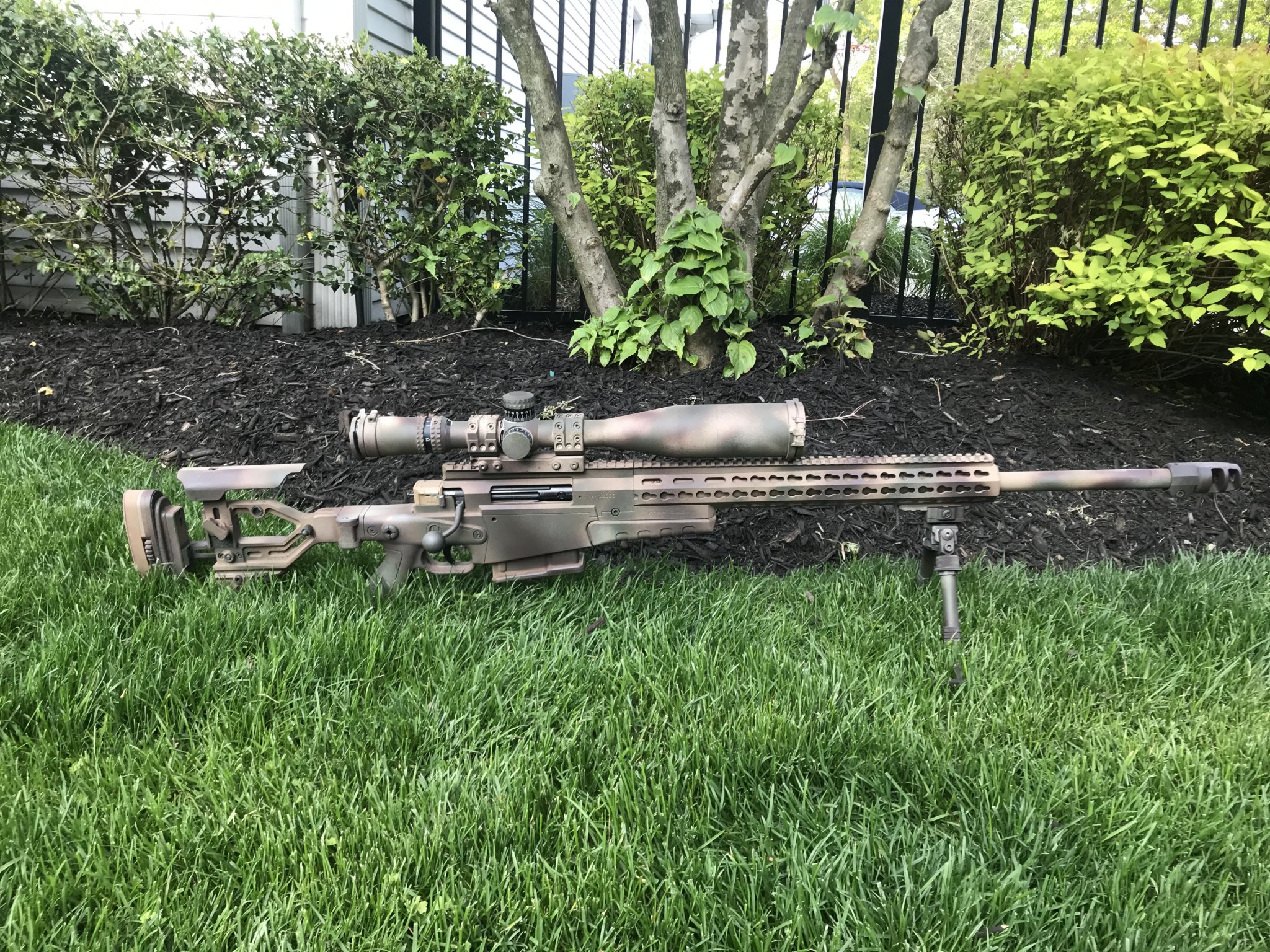

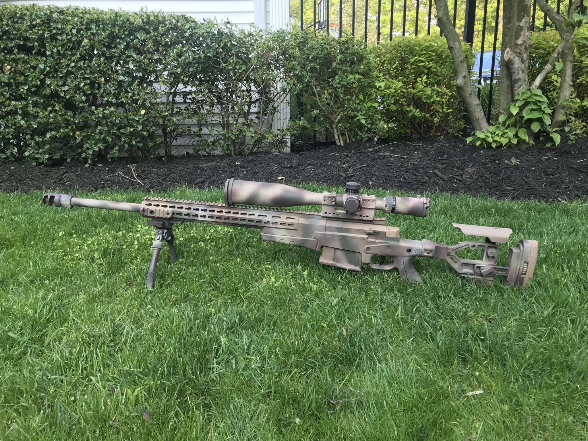

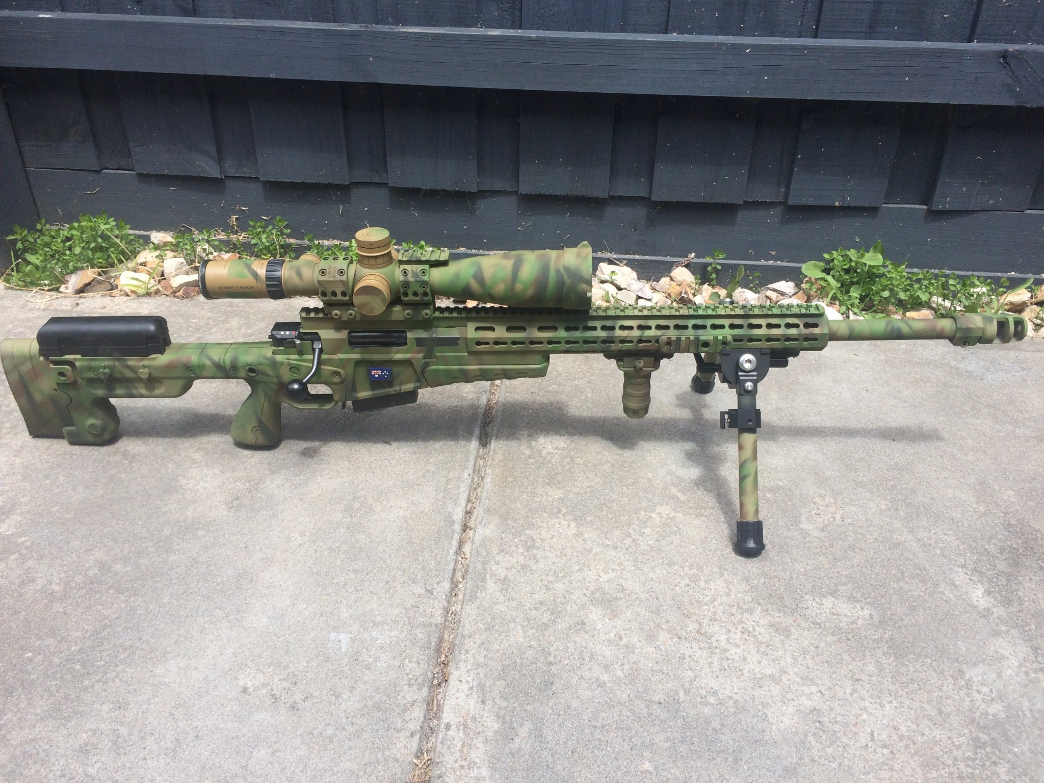

I painted my AXMC a while back. I did use a sponge technique, but I didn't want to replicate the Manners look. Here's a video that my son made of the project. It's not really a how-to, more of a chronological documentation of the process, and an illustration of the level of disassembly necessary to get a professional quality finish.
