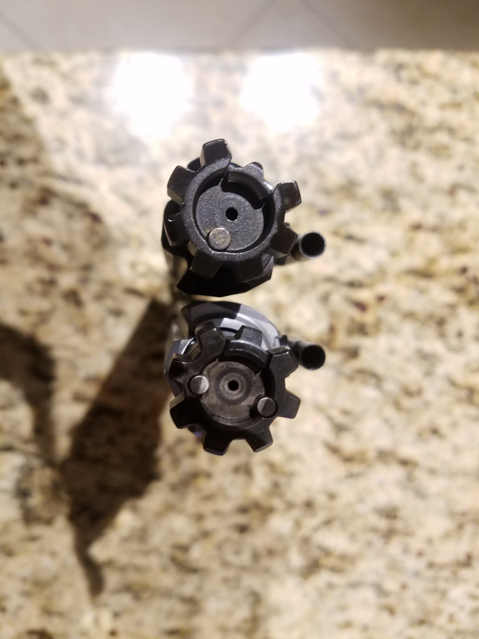

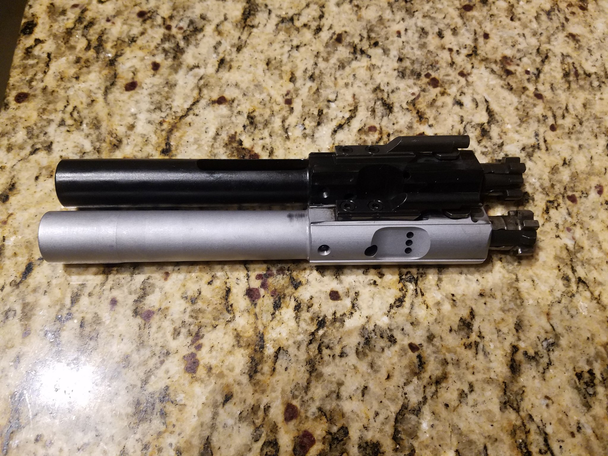

I know the bolt and gas system are unique.
Im fairly certain the bolt is like any other DPMS style bolt. The SR15 however has proprietary bolt but that's a different topic for discussion. The carrier on the SR25 has a narrow hammer channel which only allows the use of a KAC match trigger which is a negative in my opinion. The gas tube and gas block has a unique connection; the tube has a flared end with a nut very similar to what you would find in aircraft tubing. The gas block is also unique in the way it is held to the barrel. Other than those few things the SR25 is like any other DPMS or Armalite rifle.
I did not think the dpms bolt would work in a sr25. I thought maybe the lmt would, but didn't think any other brand would. Is the dpms pattern modeled off of the sr25 pattern?
While I don't have a $900 KAC SR25 BCG I do have an MWS BCG which is compatible with the SR25, and a DPMS BCG and everything is measuring within .001" within each other as far as lug length and width and overall lug diameter. Both measure .125" case head depth. These BCGs are being used with Criterion barrels; one ine a Mega Maten upper and one in a CMT Tactical upper. Headspace was checked with Forster go and no-go gauges and passed the checks. I'd have no problem using a DPMS BCG in an SR25 as long as it passed the headspace check.
