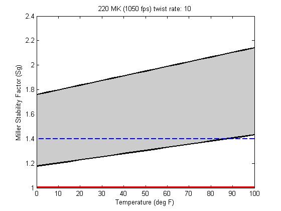

The stability of the bullet is not quite as straight forward as it looks at first glance. I've plotted the stability domain to answer the question originally posted. The stability of the bullet is dependent on several things; and as such it varies even if we assume the muzzle velocity is temperature insensitive and is always 1050 fps.
Below is a plot of the stability factor for a 220gr MK at 1050 fps and given a twist rate of 1:11.25 as conditions vary from 0 deg F to 100 deg F:
The gray area is the stability factor. The blue line is at Sg = 1.4 which is the minimum we'd like to see for a properly stabilized bullet (ref. Bryan Litz). The red line is Sg =1 which is the transition between stability and instability. If you are at sea level your stability curve is the bottom black line, but if you're at a higher elevation your stability line is closer to the upper black line. I set the upper black line at a pressure that corresponds to about 10,000 feet above sea level. Notice that the bullet in certain conditions is below the red line and is completely unstable! In other conditions the bullet is marginally stable, and it's only at very high altitudes that the bullet is properly stable.
Now here is the same plot with a 1:10 twist barrel:
There's a big difference! I hope this helps you understand what's going on. Cheers.

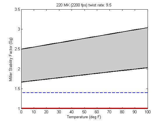

I'm working with the 220 smks as well, gas gun, 1:9.5 16". I understand it's a long shot but if I can get it up to 2200 fps or so, could it work?
Also, can you help me understand how temperature is the primary variable in determining stability in the chart you provided? Is it just air density?
It's not the primary variable; temperature is just the most likely to change. I made the graph that way, because it just seemed the most reasonable way to display the data. I mean, it's not like you're likely to change elevation by several thousand feet with the same temperature, right? You're right to say that the temperature relates to air density, but it's just one of the variables.

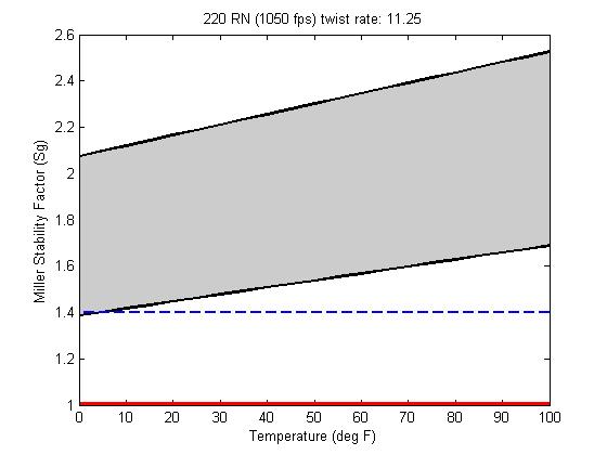

I agree that the RN 220 bullets would be a much better choice for a 11.25 twist barrel. Here's the stability region for that;
They're actually kind of ideal.

A 16" 308 should be able to push a 220 MK to about 2200 fps. And with a 9.5 twist rate the stability region looks like this:
Looks like you're in good shape in any altitude and temperature.
