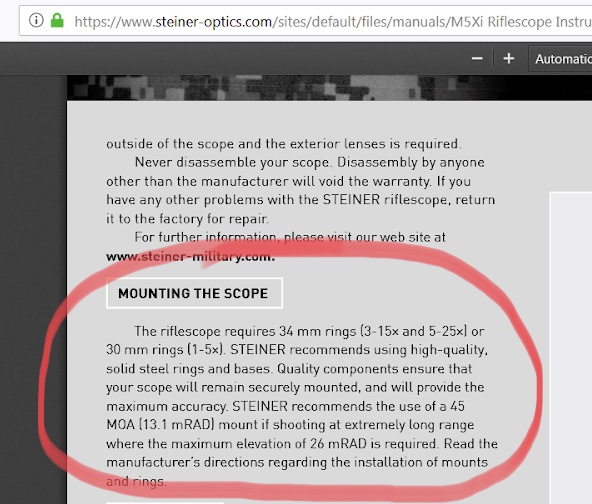

FYI Steiner recommends the use of 45 MOA rails with their military line of scopes as this maximizes the scope’s amount of internal travel while still allowing clear sight picture over the muzzle and allowing a zero range of 100 yards.
So you could either use a 20 MOA base and then a 20 MOA mount or just look for a base with more cant.
Reactions: Jayjay1 and MOUNTIC
45 moa rail for a Creedmoor? That’s retarded.
I don’t disagree, the point is that Steiner designs their scopes with that amount of cant in mind. Obviously you don’t need to use that amount, but you can go up to that amount...
Then why are you endorsing it for a Creedmoor? For one, it doesn’t need it. And the image quality, eyebox, and adjustment accuracy suffer when the erector is bottomed out like that.
FFS I am simply saying it’s possible to use that much built-in cant. If the guy is wanting to make sure he will absolutely have enough internal adjustment, Steiner says you’re able to use up to 45 MOA bases. Again, I am not “endorsing” it or saying that it’s otherwise necessary for the Creed. Just saying that’s what the manufacturer recommends.
Also, if what you say is true, I’m not quite sure why Steiner would “recommend” it. Think I might listen to them over a keyboard warrior though.

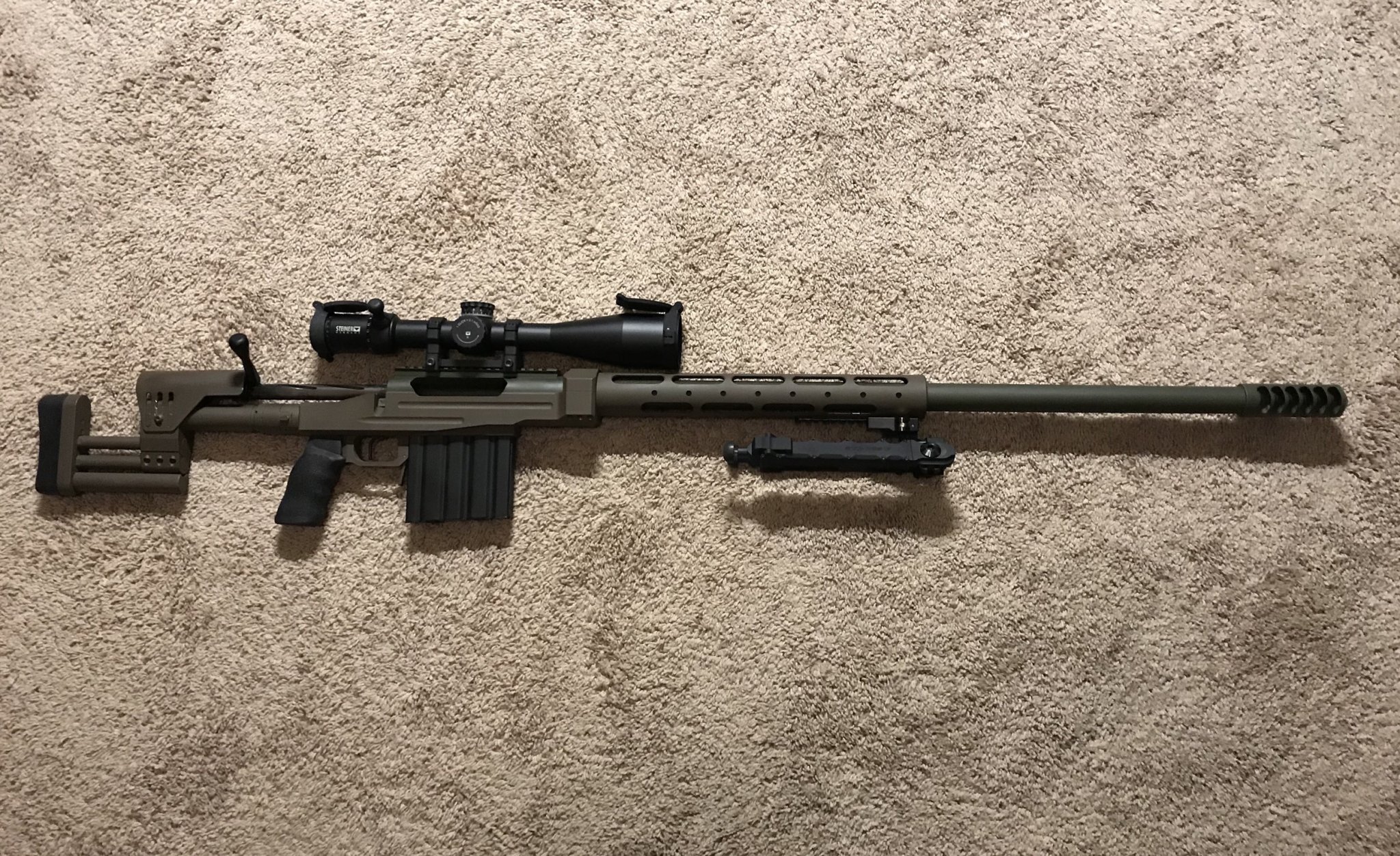

I dunno man, this T5Xi sure seemed to be ok with 70 MOA built in... maybe that’s not what you meant?
