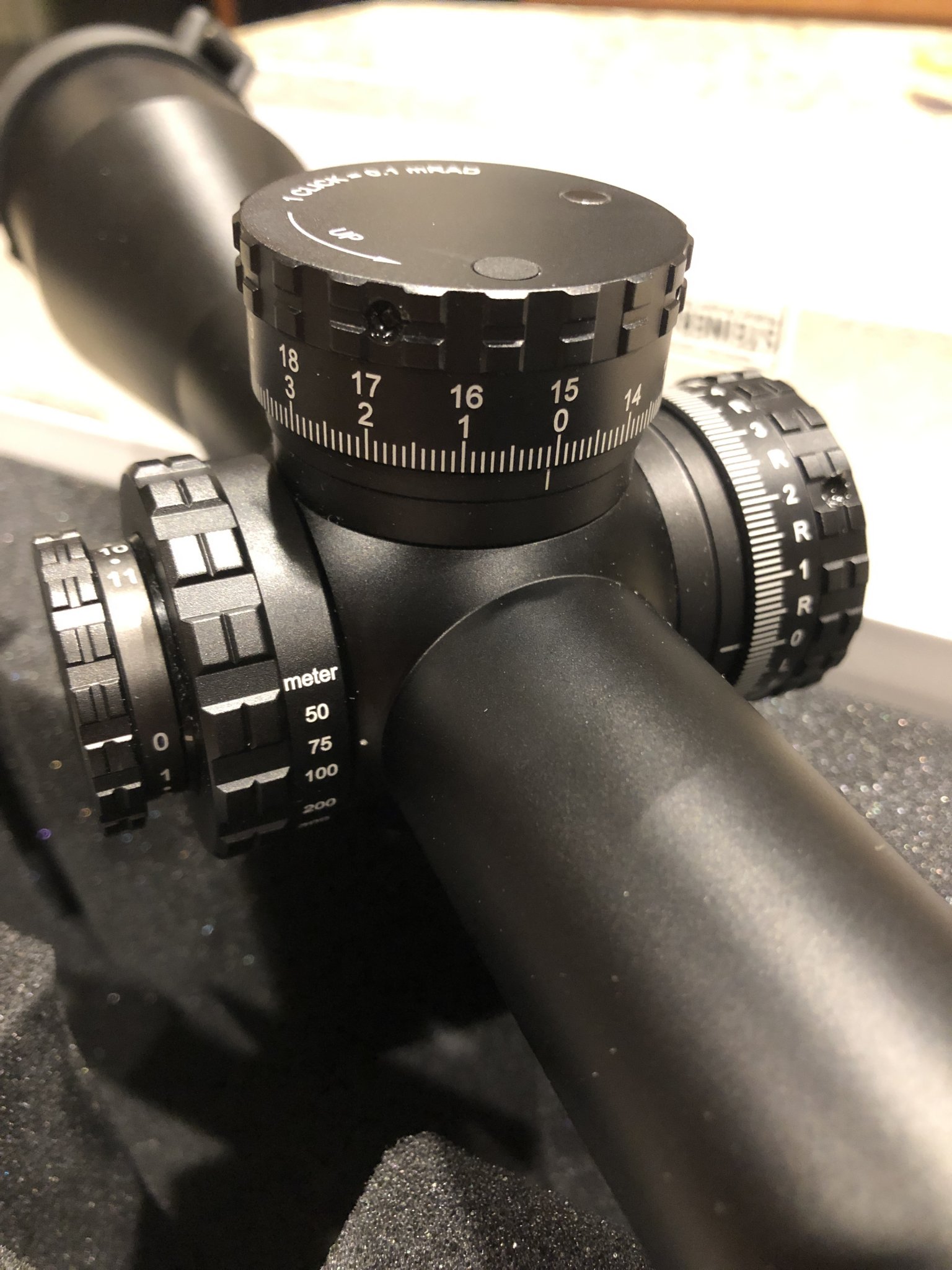

Today at the range, it's 18ºF, and despite the cold, I managed the controls just fine. Clicks are stiff. At first, I had to be a little careful I didn't run past an adjustment. Not a problem, just a different feel.
The way the scope handles parallax is interesting. I'm probably coining a phrase here, but depth of parallax is sort of shallow. Oddly, the way it's handled makes fine tuning really easy. The parallax knob is stiff, not Kahles stiff, and adjustments are distinct. Turing the dial you go from blurry to blurry with a nice fat sliver of sweet spot in-between.
The diopter adjustment is circa 2003 fast-focus-eyepiece fast. My first impression lamented it wasn't stiffer or locking or both. Flip caps quickly become unintentional levers when seated on diopter rings. This diopter ring didn't need a lever. At this point, this is really my only gripe.

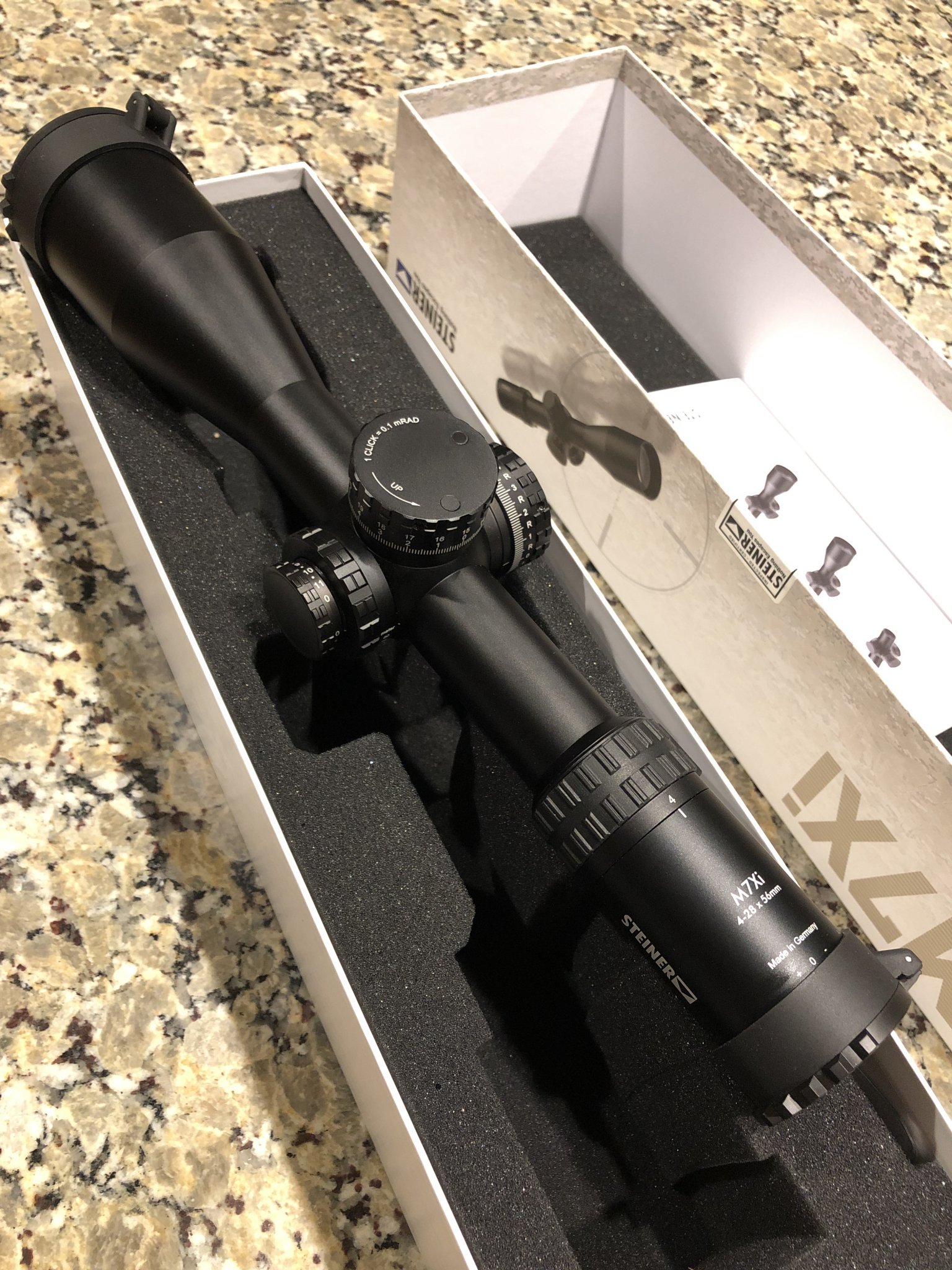

The box contained a scope with two flip caps attached, a ziplock bag containing a hex wrench, and another enclosing a lens cleaning cloth. That's it. No paperwork, warranty card, manual, nada... Spartan. I actually double checked the box seal thinking it might have been opened. It wasn't.
I wish it'd come with a manual, but I like it.

I also took notice of the contents included in the box (or lack thereof), but then went on to think about how much stuff is included with other optics and just how little I use them... 95% of ‘accessories’ stay in the box and never get touched. It’s also pretty cool to think that Steiner knows a pair of scope caps is just about all that’s needed to make a customer feel good about their purchase. No need for a shade or fancy tools or anything. Put out a good product at a good price point and you don’t need to worry about the rest.

Total elevation is “only” 27 mils.
On the bright side, zeroing is a piece of cake. Loosen 2 of 3 set screws and the turret spins freely without clicking. It does not come off completely and there is no cap or anything to remove. Simply zero the rifle using the turrets, loosen the set screws, and spin the turret to zero. Re-tighten and you’re done. No ZS to mess with - it’s .2 below zero and that’s where it stays.

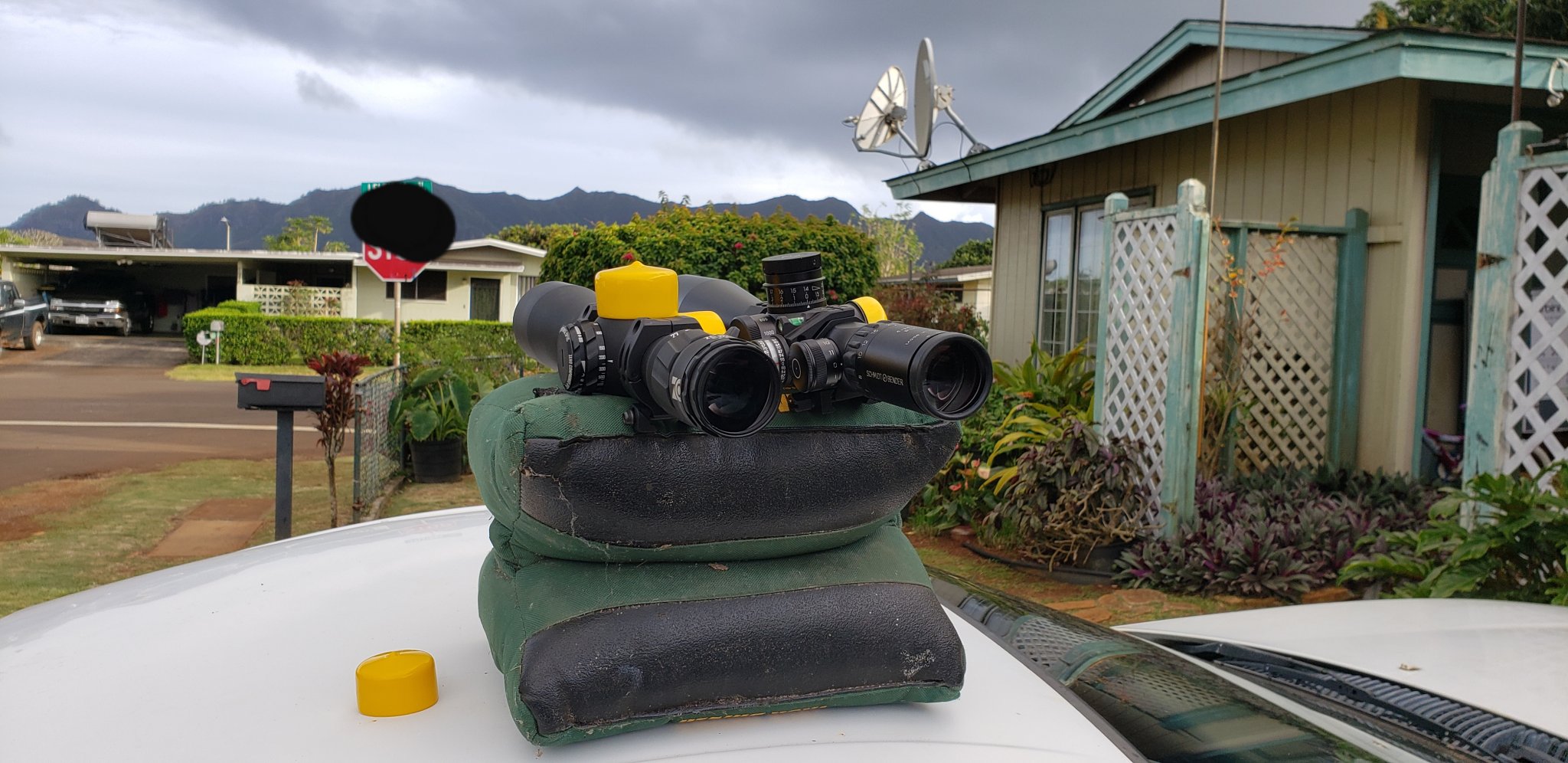

I compared it with the Zeiss Victory 6-24x56 and S&B PM II 5-25x56. Both scopes are around 10 years old.
I put up a paper target at 100m, 300m and 500m. The target was marked with letters in different dimensions. (Similar to the test at the eye specialists) Comparison was done during different light conditions. I used each scope at same magnification and tried to read the lowest numbers in the centre and at the edge. The biggest difference I saw at low light conditions. M7Xi was the only scope I could see the bullet hole at 500 meters.

I needed to play for around 20 sec to have the right settings. My eyes are still very good. The diopter setting was around - 0,3. Parallaxe adjustment was easy. What I did like is that the Parallax nob is moving smooth, but not too easy.

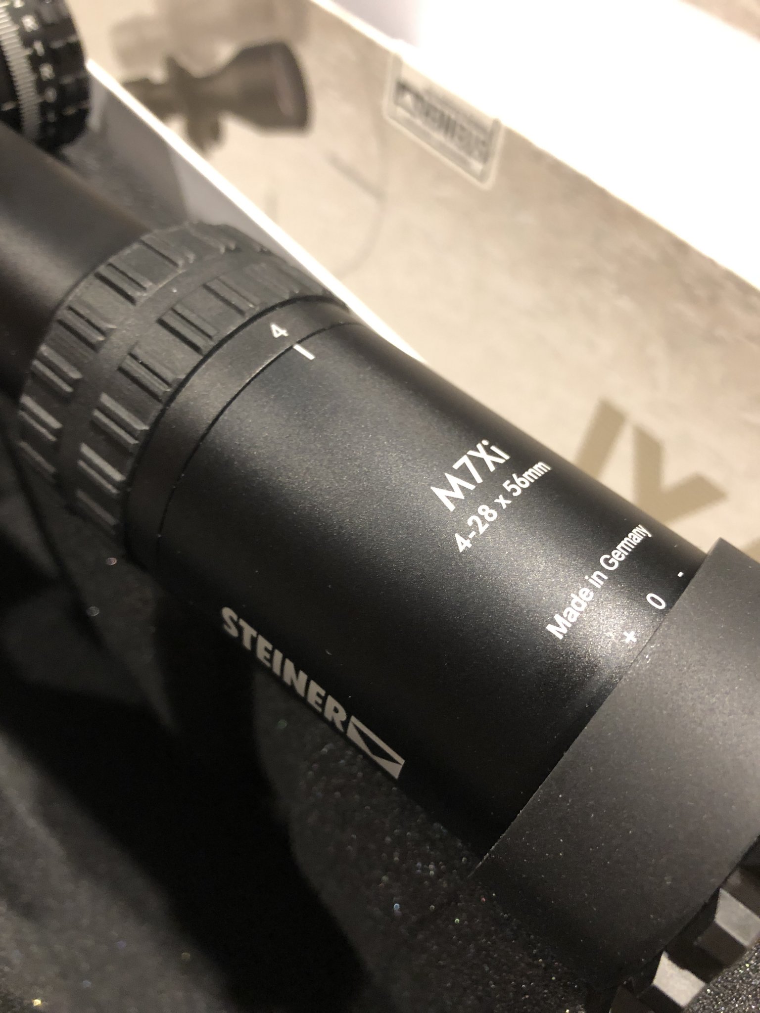

My M7Xi arrived today. It was too dark outside to compare the glass to the M5 by the time I got home.
