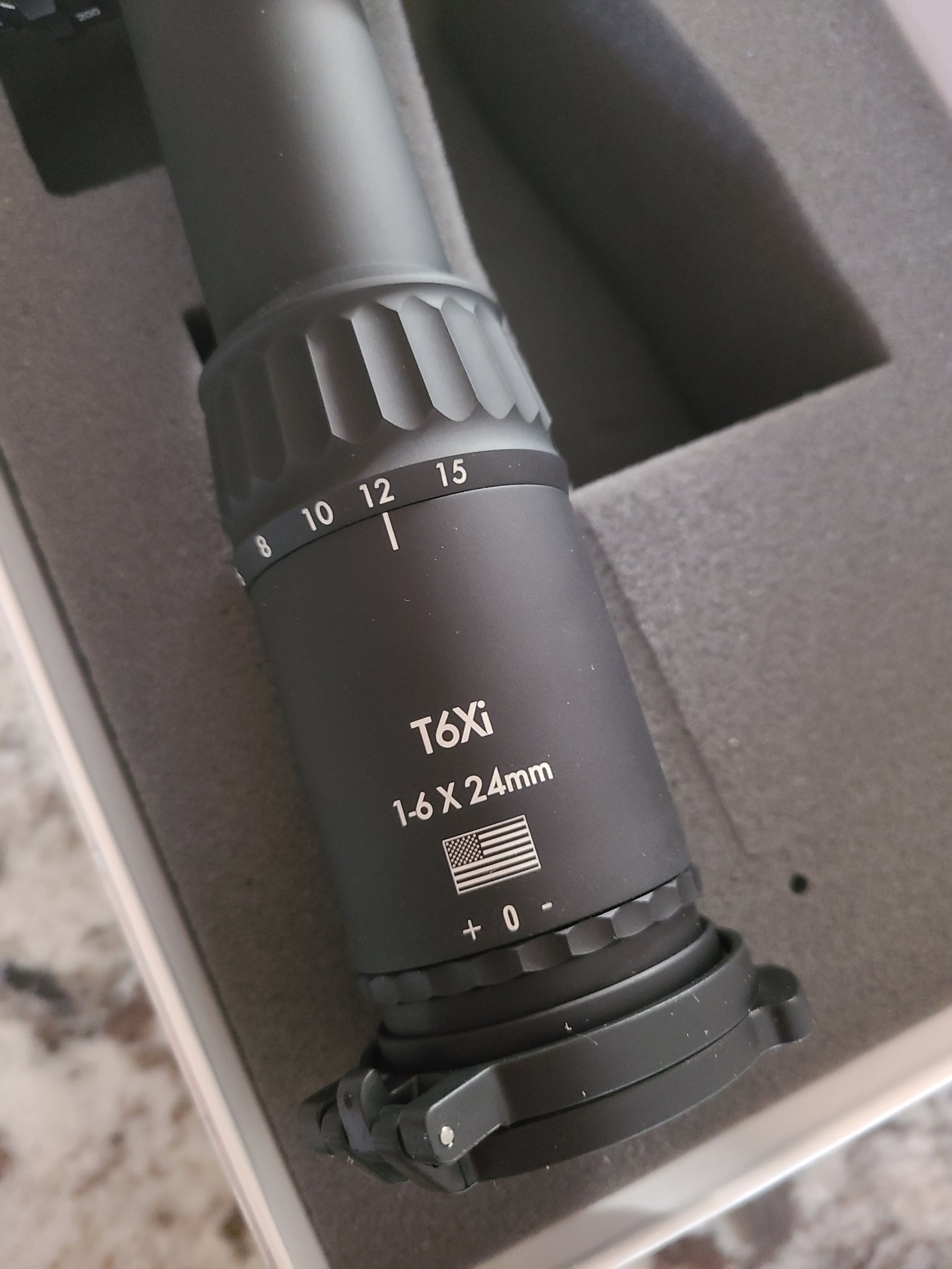

Been enjoying my 1-6...

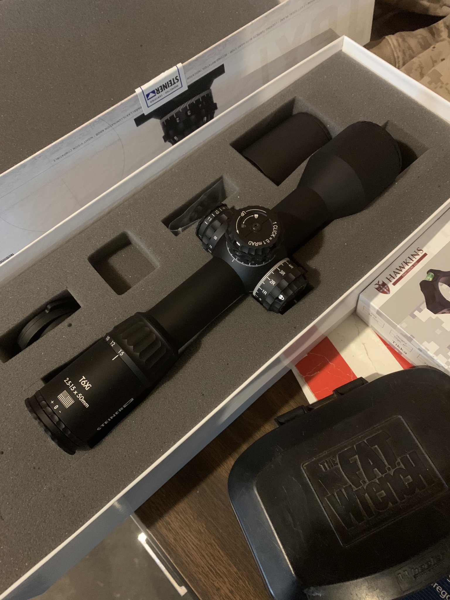

Got my 2.5-15x50 today, excited to see how it performs. I like how the turrets lock and unlock. It’s going on a hunting rifle a Tikka T3 with a bartlein barrel chamber in 6.5x55 AI.
Asked if we could change reticles in the 2.5-15 and they said no.
I want the msr in it for hunting though i guess the scr would suffice. Still wish it was lighter

Just got my 2.5-15 today... can the turrets be realigned on these? My hashmark hits dead in between the hashes on the turret?
Wondering if it can be realigned or if it needs to go back to steiner?
Did you loosen the two screws on the back of the elevation turret?
Can you align the marks when you loosen the set screws to zero the turret?
