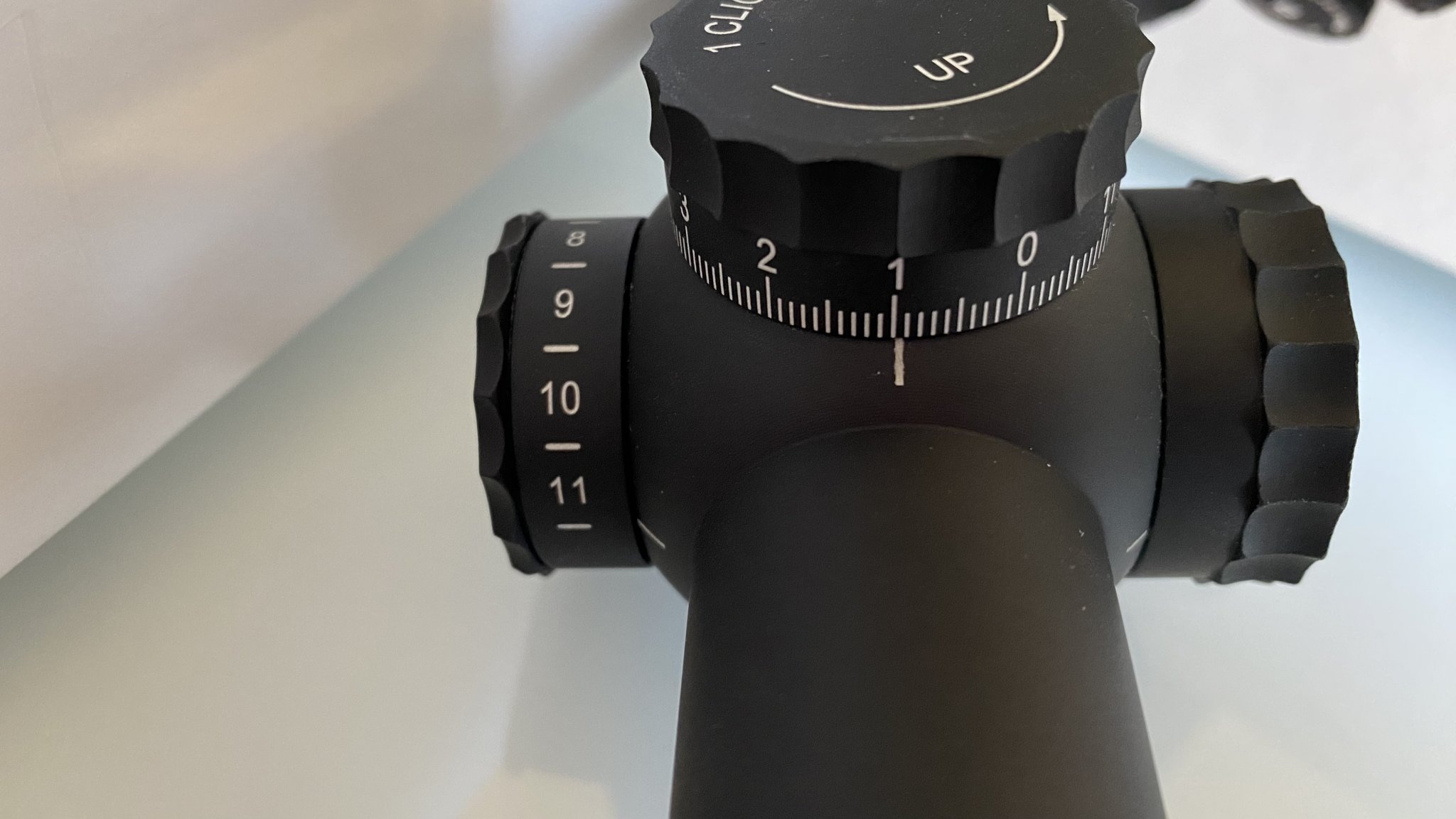

Update on the 1-6 with misaligned turret markings. I sent a request to the warranty department for repair or replacement. Their response was “that is in spec.” They then directed me to return the optic and order a new one if I wasn’t satisfied.
I purchased the optic via a pro program that doesn’t allow for returns or exchanges so I thought I was stuck. I reached out to the sales team directly to see if I could exchange. They initially told me to go to my pro program but after I explained that the program doesn’t allow for that avenue, they reached out to the program to confirm. Once confirmed, the sales team then reached out to me directly and provided me with a return label and RMA and will be exchanging the optic for a new one.
I’m thankful that they’re giving me this path forward and I’ve just sent the scope in. Hopefully the new one does not have this issue. I’m disappointed that the warranty department was unwilling to make it right and I had to work with the sales department to do so. Seems like the departments are unaligned in what is or isn’t acceptable or “in spec” for the optics.
I’ll keep the thread posted on how the new optic turns out.

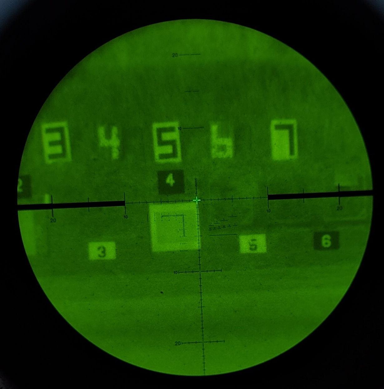

Range day:
PVS-30, 200 yds about 8x, illum on
Increasingly having a good time with the MSR2. Worried there was a lot going on but now getting used to it after decades of dots, using most of the bits properly, and today (well, before dusk and dark) the lighting was such that the floating dot really did it's thing properly, got the full speed out of it etc.

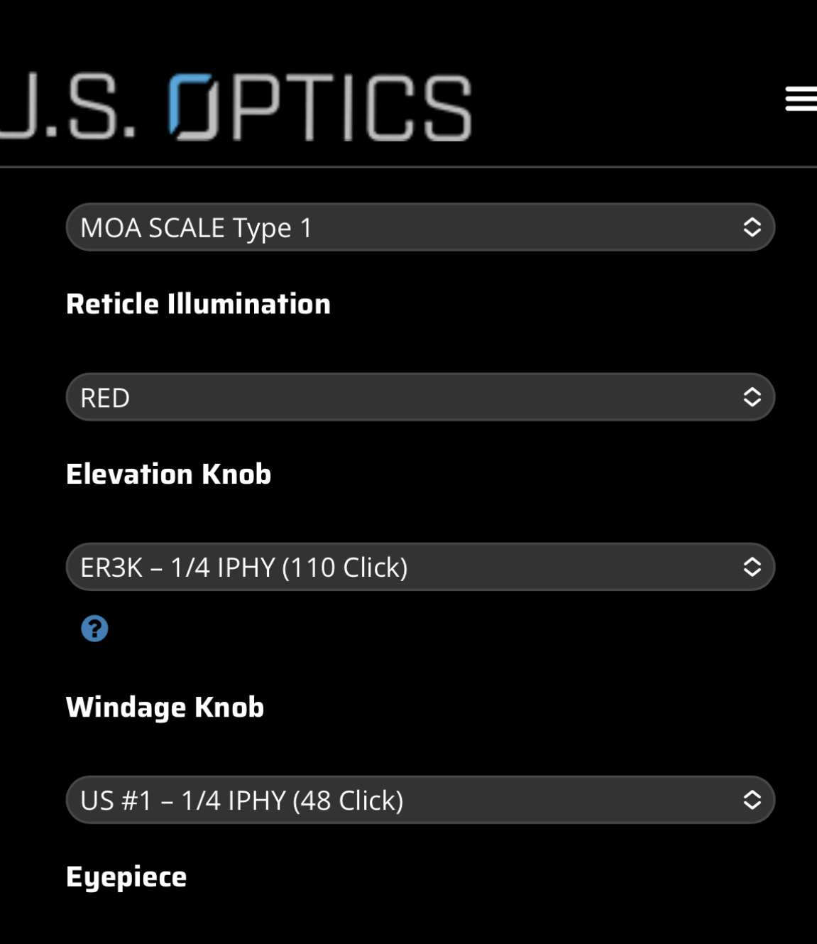

IPHY inch per hundred yards. USO still uses this for some reason. I haven’t seen anyone else using this. There’s no worry using MOA, the vast majority is making TMOA
They do? Damn. Figured they would have straightened that out by now. Oh well.

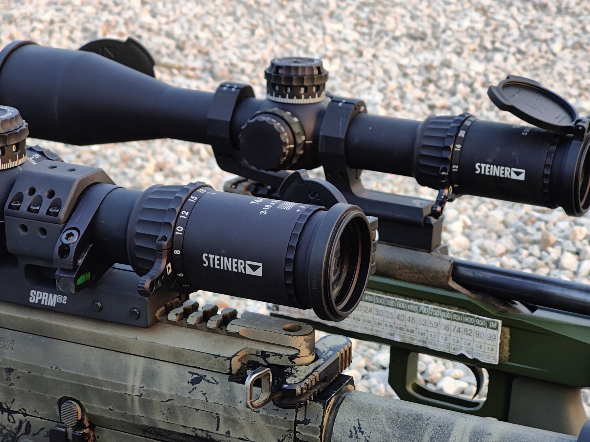

I have exactly this pair, for compare; XTR-Pro 5.5-30x56 SCR2 1/4MIL, vs T6Xi 5-30x56 SCR MIL. Still not even sure how that happened, ha. I mean, I *know* how it happened, I get the new post notifications on my damn phone, all day long. :ROFLMAO:
Peeped an XTR Pro at a match a few months ago and felt it looked like my build-inherited XTR3 after a glass spa day (and with better turrets), so I snagged one here (and sold the XTR3, you all know how this works). Then I started reading the hubbub in this and other threads here about the Steiner, spotted one here, and picked one up too. With the thought that I'll pit them head-to-head against each other, Kahles 5-25i as a benchmark, I'll hopefully find a clear (pun) winner among the two new darlings from Greely, CO. Steiner's still in the box, the Burris has been out once so far. So far the Kahles is still my all-around king considering glass:$$, but hoping these other two come close (and that only one is a winner to me so I can convert the other one into a Cronus and some reloading crap! :rolleyes:)

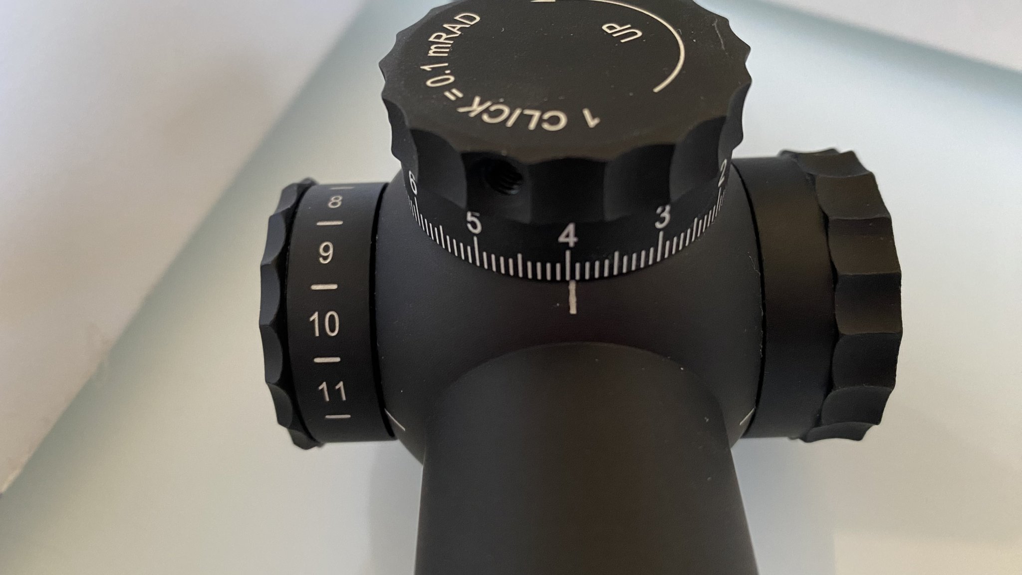

Then you have NATO Mils vs MRAD: 0.1 MIL (NATO) is actually 0.98 MRAD
The info above taken from https://www.schmidtundbender.de/en/service/did-you-know/127-turrets/1521-moa-mrad-mil-cm.html
Here’s a Wikipedia page section with the relevant info bolded & italicized below. Irritating.

Received my replacement 1-6.
And…exact same issue of aligned turret markings. Seems like for the 1-6 this is just going to be standard for the model.
The optic is 100% outside of that issue so I guess I’ll just live with it.
I may be mistaken, but if you loosen the set screws and clock the turret it will be aligned... I believe mine were misaligned until I reset the turret at zero after actually zeroing my 1-6 on my rifle....
Yep, not sure what his "issue is".
Loosen the two set screws and align the turret.
My 3-18x56 had misaligned elevation and windage turrets from factory. After siting in, you can align them perfectly. They aren't splined......so you set them wherever the hell you want.
Reactions: TacticalPlinker
So line them up? What's your issue? Loosen the two turret screws, slip the turret to line them up and tighten down. These turrets aren't splined, so you can set them wherever........unless the 1-6x is somehow different from the 3-18

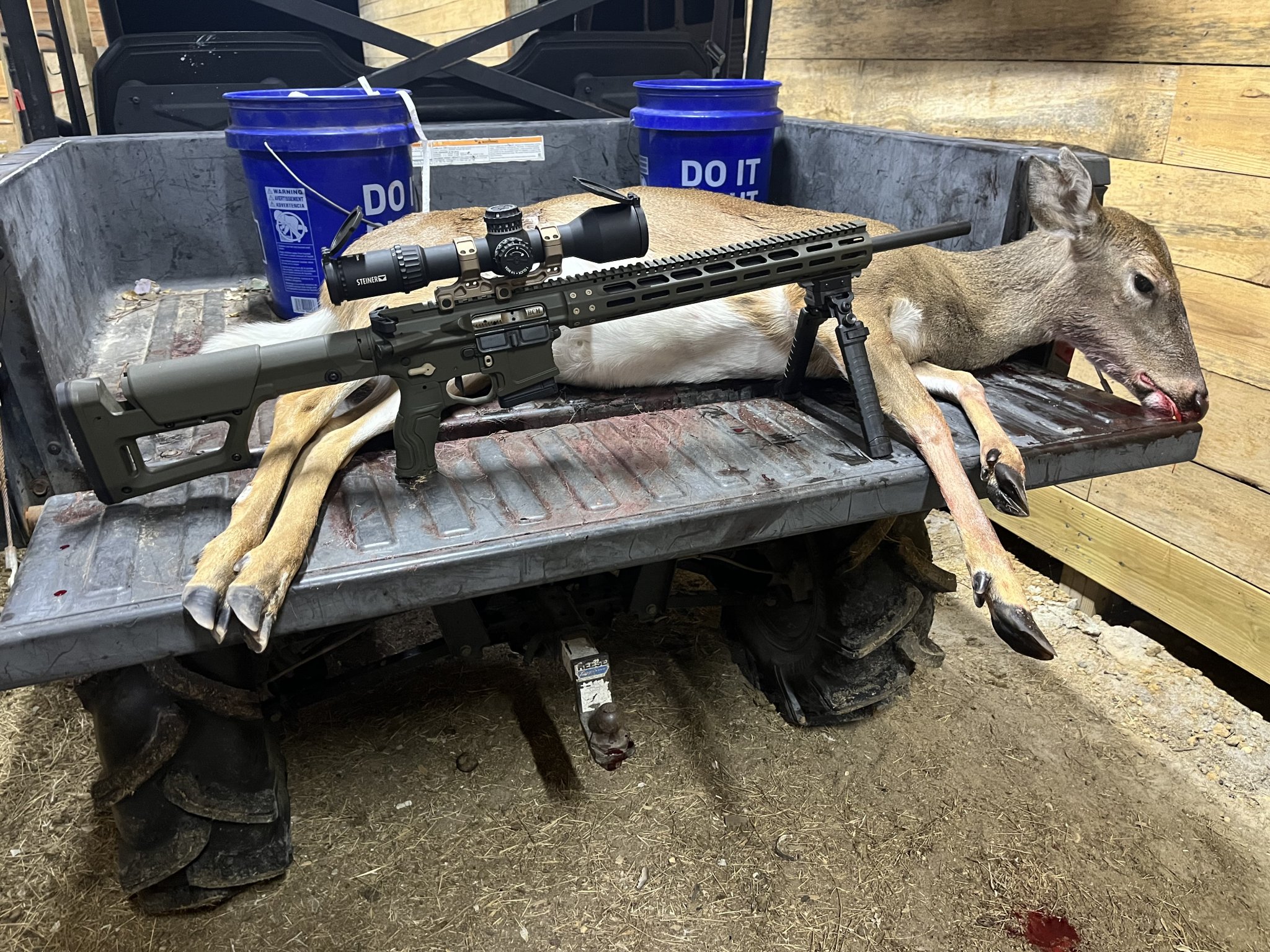

Ordered a 2.5x15 T6xi MOA reticle back in the first of October when they were released for a new Precision DMR style 5.56 I was building. I haven’t got to abuse it like some shooting several times a week, but I have ran it hard when I have shot and in 3 months it still zeroes back out where I set it (which it should). Glass clarity is fantastic, light transmission at dusk/dawn is great, reticle is not a true day light bright but is fantastic in low light by the lowest settings being very useful and no reticle or target washout (actually had to use it at dusk on a doe). Turrets are audible with about the perfect amount of resistance to where it requires a little effort but I would never be concerned it was accidentally moved even without it locked. It is a little heavy, but it is a scope that feels like it’s made for a little abuse. I am very satisfied with the optic for the features at the price point and think I’m going to order another higher magnification for a large frame AR build I’m working on now.
I did use the scope and rifle to finish filling my freezer with some meat as well with 4 does at the end of the season.

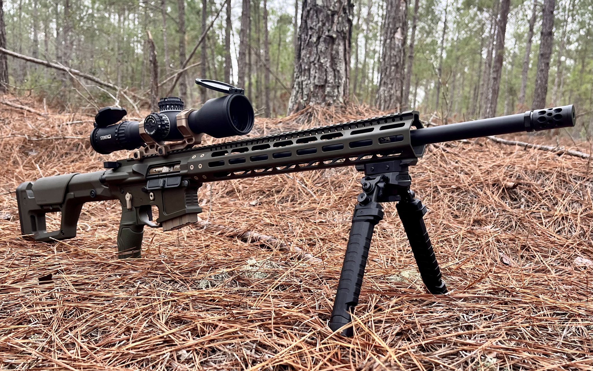

Sitting on my Origin Proof 6mm Creed mule deer hunting rifle. Can't wait to get some rock chuck practice this spring and use it for hunting in the fall.
That’s a gorgeous rifle. Hoping mine looks half that decent. Went with a Tikka action in 6.5 creedmoor, Bartlein carbon fiber barrel and an Iota eko stock. Planning on running it suppressed 100% of the time so I’m only doing 16.5” on the barrel. Just got to decide on a suppressor.
Are those Seekins rings?
Thank you. I hope yours turns out excellent as well.
Yes, Seekins rings...."Low"
Mesa Precision Altitude Stock. Hawkins "hunter" Flush DBM bottom metal. MDT 3 round plastic mag, pretty much flush.
Bighorn Origin SA
24" Proof Bighorn Prefit (from Stocky's ......Proof Chambered Prefit).
6mm Creedmoor
PVA Jet Blast 3 port
Trigger Tech primary set at 1.5lbs
I'm going to load 112 Barnes.
Currently getting brass by shooting Norma Factory 107HPBT.............Shoots sub 1/2 MOA with factory. Many groups cloverleaf at 100.
One of the most consistently accurate rifles so far, I've got less than 100 rounds through it. Looking forward to getting a bit more brass and loading those 112 Barnes.
