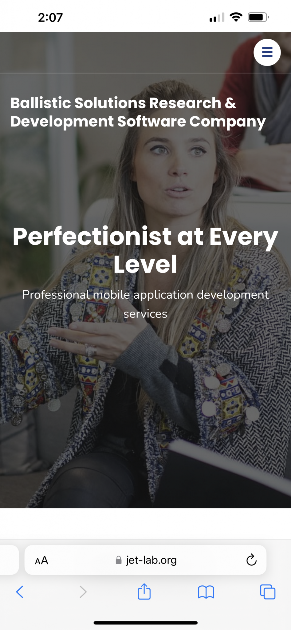

Interesting…there’s an app in the US Apple App Store called, oddly enough, Chairgun Elite Ballistics. It either stole the entire general user flows, reticles, and targets etc from Strelok or it is the same owner but based in Poland and Italy. Or I suppose the tech could have been sold/licensed and transferred to a separate entity not affiliated with Igor.
The below site is linked off of the App Store page:
Addresses on that page, for posterity:
Warsaw, Poland, 02-502
Monza, Italy, 20900, Lecco 56
The website is…uh…sorta weird and obviously a template was used. Who puts a corporate chick on the first page of a ballistic tool’s website? And from the home page, one cannot get to the privacy policy.
The name of the company is Ballistic Solutions Research and Development and the guy listed is Siarhei Raichonak. It’s been up on the App Store for at least a year.

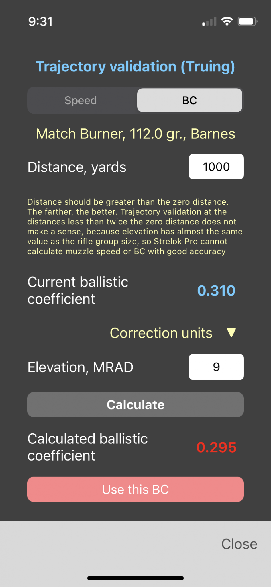

I get it, but it's a dumb way to do it since you then have to waste a round (or many) to see if your guess is correct.
In Strelok Pro, if you know your speed/MV is correct (say 2722fps, which you can verify/true at 400-600 yards first), and then shoot out to 1000 yards using, say 8.7mils, and see that it's low, one can just measure the distance with their reticle to see the difference between their POA and POI (let's say it's 3 tenths). Then, all one has to do is tap "truing", switch it from MV to BC, enter 9mils, it calculates the new BC, hit "use this BC", and voila.
The next round will go where it's supposed to go, no guessing, easy peasy.
Honestly, with a good App/solver, if someone belongs to a club with known distance targets in the 400-600 range for MV, and 600+ for BC, they don't even need a chrono anymore. Once they've got their MV they can go out further and true their BC, and once out at distance, if their groups are consistently small and their waterline looks good, then their SD/ES is probably good too.

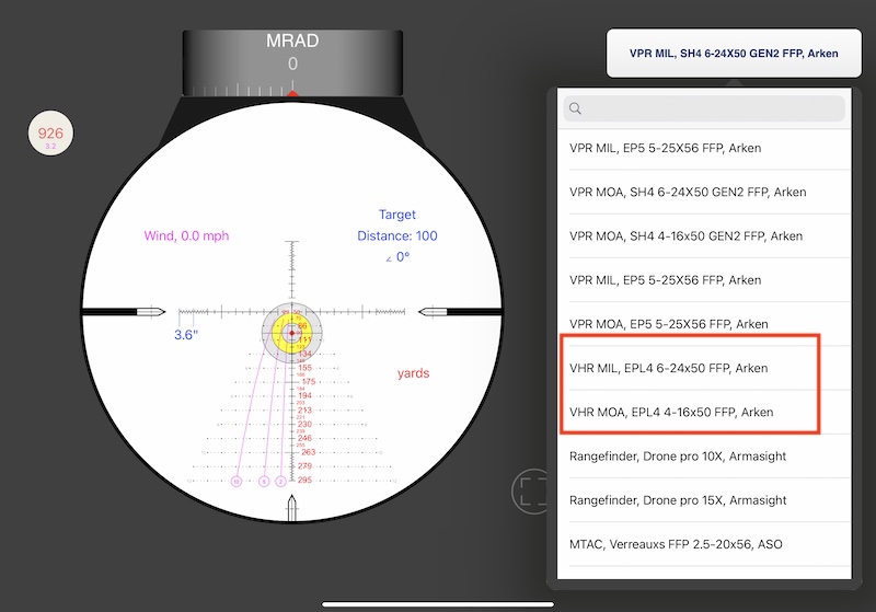

I just checked Strelok Pro on my iPhone and iPad Pro and the Arken VHR MIL, EPL4 6-24 and VHR MOS EPL4 4-16 are listed.
I haven't finished transferring everything over from iStrelok to Strelok Pro, so I haven't gotten that far. When I went to swap the scope data on my Ranger 22 to the EPL4, it wasn't there, but that was a month or 2 ago. Maybe he updated them recently.
I hope he updates the PA SLx 1-10x28 ACSS Griffin M10S MIL reticle soon.

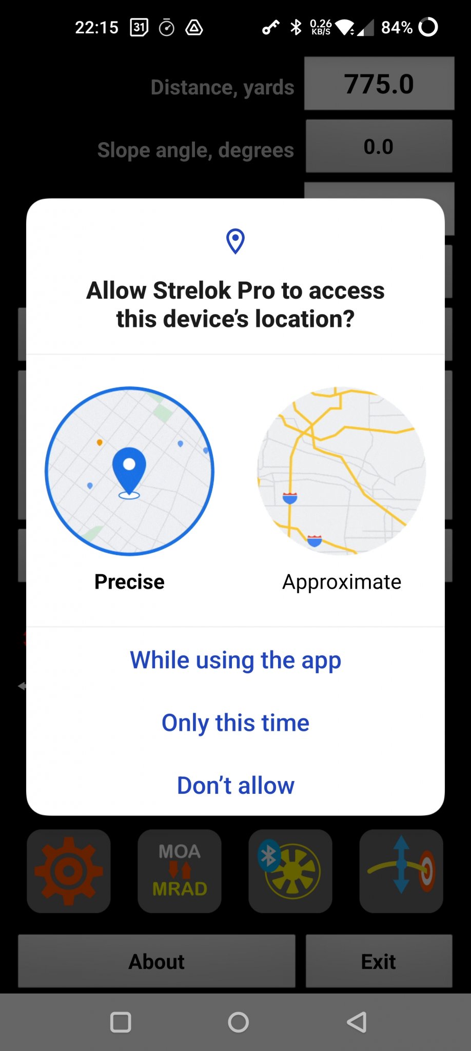

Anyway, just with the latest update, I got this new feature:
And denied it. This is an OS-provided dialog. The app is blocked at a low level from getting access to stuff unless you let it, so: no location for mine. Pretty much guaranteed. If you worried.

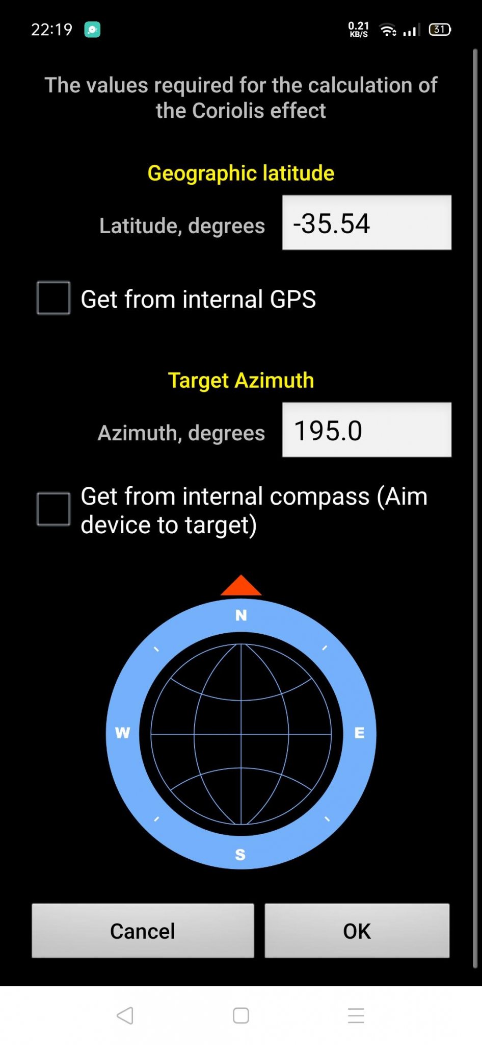

GPS is for coriolis effect. You can always enter data manually, or ignore it. You don't really need it unless you are doing weird long range things.
