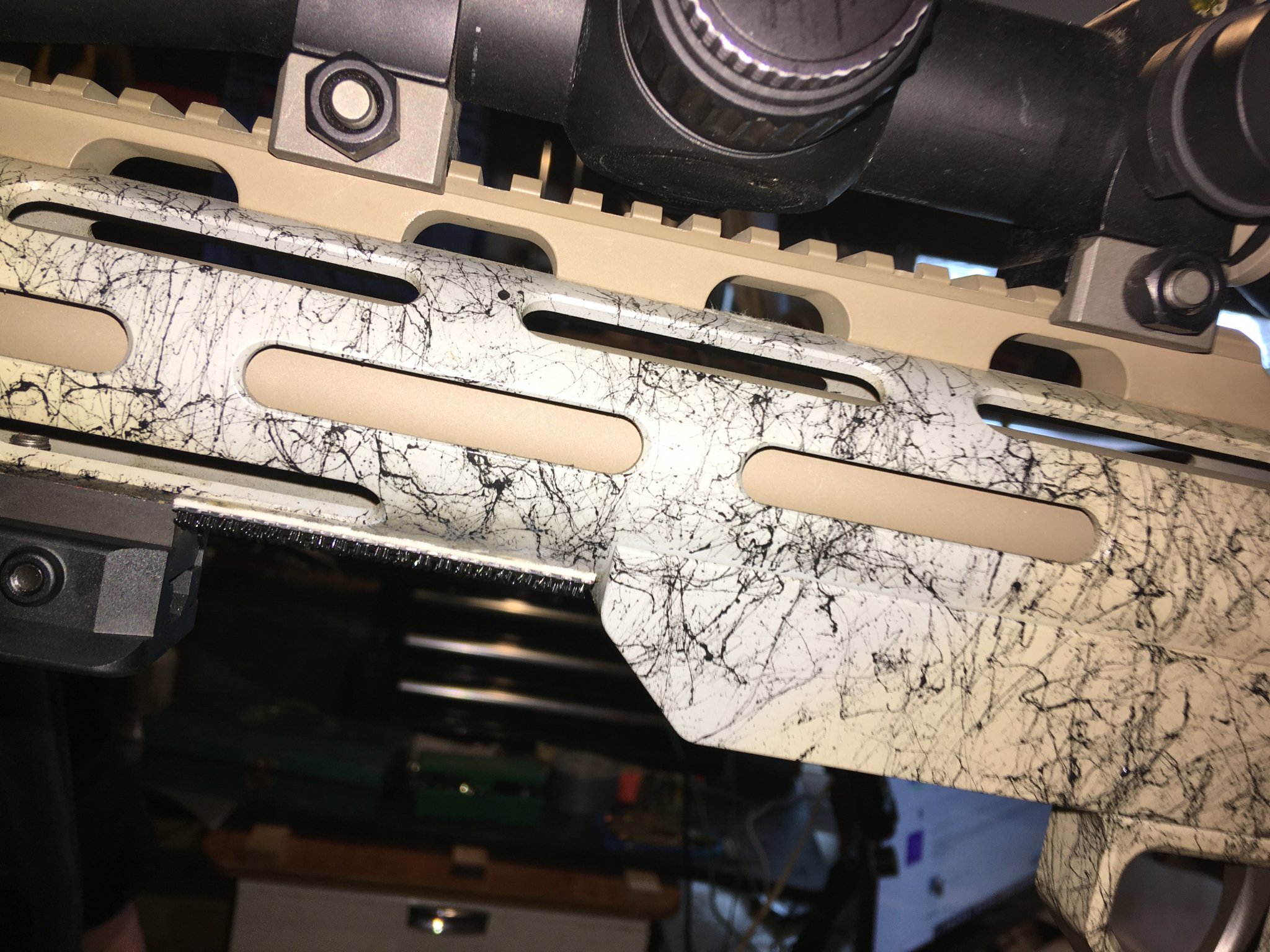

What I found was the barrel was in contact with the channel at bottom just in front of the lug. This wasn't letting the action settle all the way down into the V block chassis (that was my theory). No biggie, I just relieved that area & mocked it back up. With the action screws snug, I could still slide the barrel/front of action side to side in the channel = about 1/8" @ front of stock. O my, WTF is going on here?
My understanding of how the mini chassis works is that its suppose to provide 6 points of contact + recoil lug. 2 x V block @ front of action, 2 x V block rear action, 1 x radius bottom rear, 1 x radius bottom front, + recoil lug.
In my case the action was hitting the 3 points of contact at the rear, and none at the front except for the recoil lug and the flat shelf behind my lug. That "shelf" part of the chassis was to high by .0035 holding the action up out of the v block & resulted in all that side to side slop. I wound up milling the shelf on the mini chassis down .040 & bedding recoil lug area with Pro bed 2000 (for like $12 you get everything needed). I now have full chassis contact & the bedding will not allow any for/aft movement.

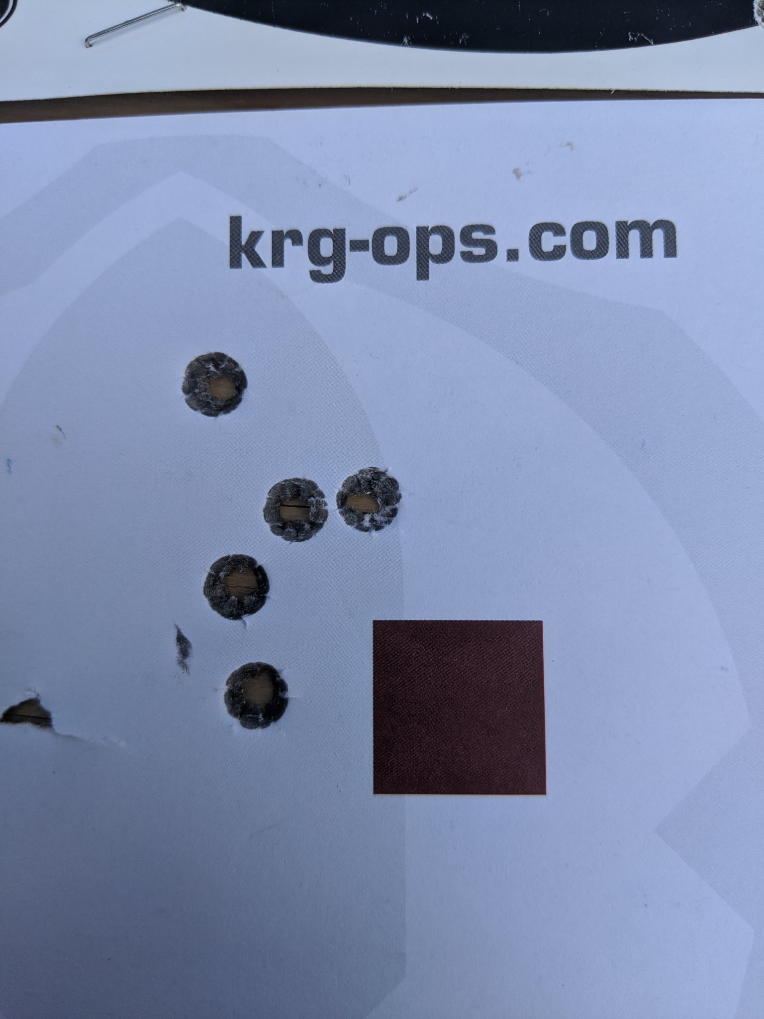

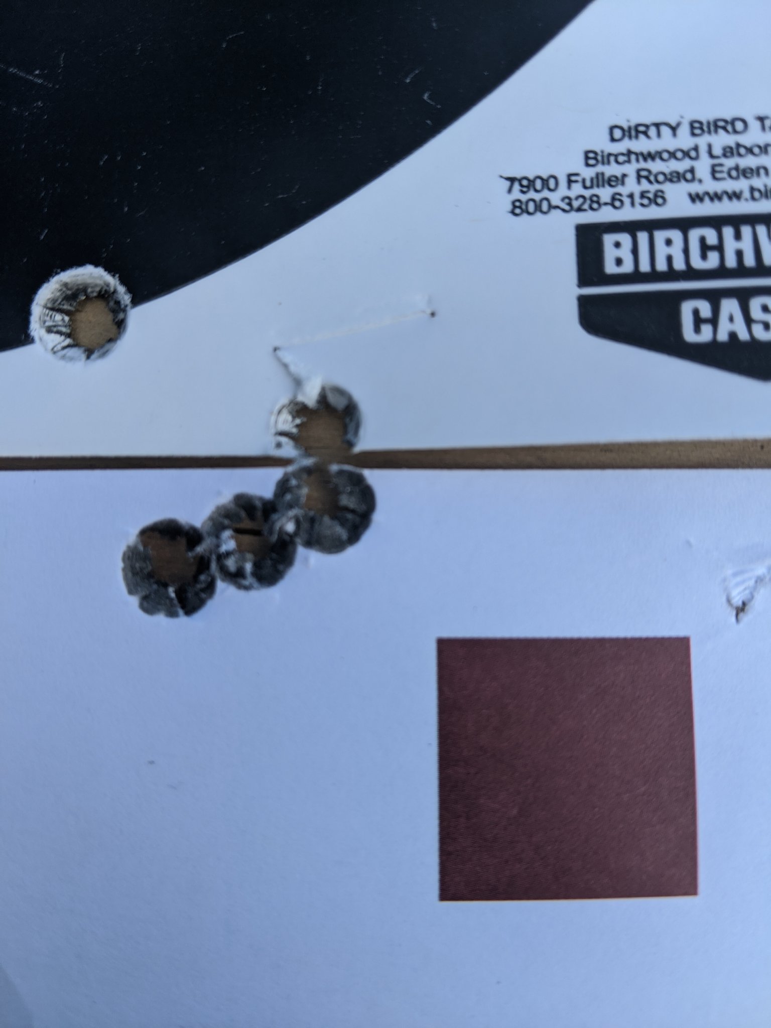

The test group that came with the rifle was 3 shots .7 MOA with factory Hornady 147 ELD-M & I'm assuming that was a machine or fixture rest. My first (and only) attempt at a group during barrel break in (shots 20-25) was 5 shots .4 MOA @ 100 with Factory 147 ELD-M. That was off a bench with bi-pod, rear bag, and auto loader extrodinare pulling the trigger. Pretty sure I'd flunk the shooter evaluation @ one of Frank's classes (not the safety part).
Based on factory test target, I'm sure I'd have been shooting 1+ MOA 5 shot groups & been very disappointed, had I not caught the problem and fixed it.

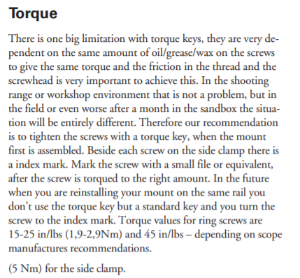

As others have stated, and I'll say it again: torque the Spuhr caps to 25 in-lb. You'd be surprised at how little torque 15 in-lb is. I have personal experience (as do many others) that wandering groups can be remedied by going from 15 to 20 to 25 in-lbs. It's right in the manual, "torque to 15-25 in-lbs".
And there's no need for loctite on the Spuhr cap screws, I don't know where you saw that. That is likely messing up your 15 in-lb applied value as well, especially if you cleaned them first.

Spent a few rounds getting on paper again since I had taken everything off of the rifle after that last range visit. Then settled in and ripped off 5 rounds. This is Georgia Arms remanufactured .308 with a 168gr BTHP bullet in once-fired brass. This is NOT their match ammo (I blew through all of the match I had and when Covid hit, it wasn't a priority to pick up more).
That was shot at 200 yards and measures 1.421" for a 0.678 MOA group. This was one of the better groups I've had with this rifle. I wasn't happy with it by any means, but it wasn't completely abysmal. Brake was on by the way. So I unscrewed the brake and shot this. Same load, same distance:
I measured it on the target stand, but forgot to bring my camera to the target with me so I had to re-create the two pieces of paper later. That flyer in the upper left was shot #4. Knew I pulled it before the pin hit the primer. If you include the flyer, that's a 0.874" 5-shot group measuring 0.417 MOA. If you exclude the flyer, that's a 0.562" 4-shot group measuring 0.268 MOA. Remember, this isn't match ammo.
Unfortunately, my day was over at this point. My range has some new rules in place and I (as well as a few others) got screwed by them. You get 1 hour and 1 hour only at your selected range (they have 5 distinct areas/ranges at this facility). No more than 10 ports per range (by comparison, the 200 yard line has 28 target slots regularly).
I got there around 8:20AM (facility says they open at 8:30), and when I got to the 200 yard line I realized that I was late. Everyone had targets up and were down behind their rifles already. I set up my gear and waited. Next target change was at 9AM. By the time everyone got back from putting up new targets and whatnot, it was 9:10ish. I spent a few minutes getting my zero back, then took my time and tried not to heat up the barrel shooting both groups. When I finished that second group, it was 9:30 which was both time for a new target change, and for me to leave (my hour was up).
So anyway .... the f'n brake. I've never heard of that before, but the evidence was clear. I'm rather surprised that Mark pinned it as quickly as he did. And happy as all hell. Both for the fact that the rifle is what I originally hoped it would be, and that the ass-hats in this thread were both rude AND wrong. Wins all the way around.
