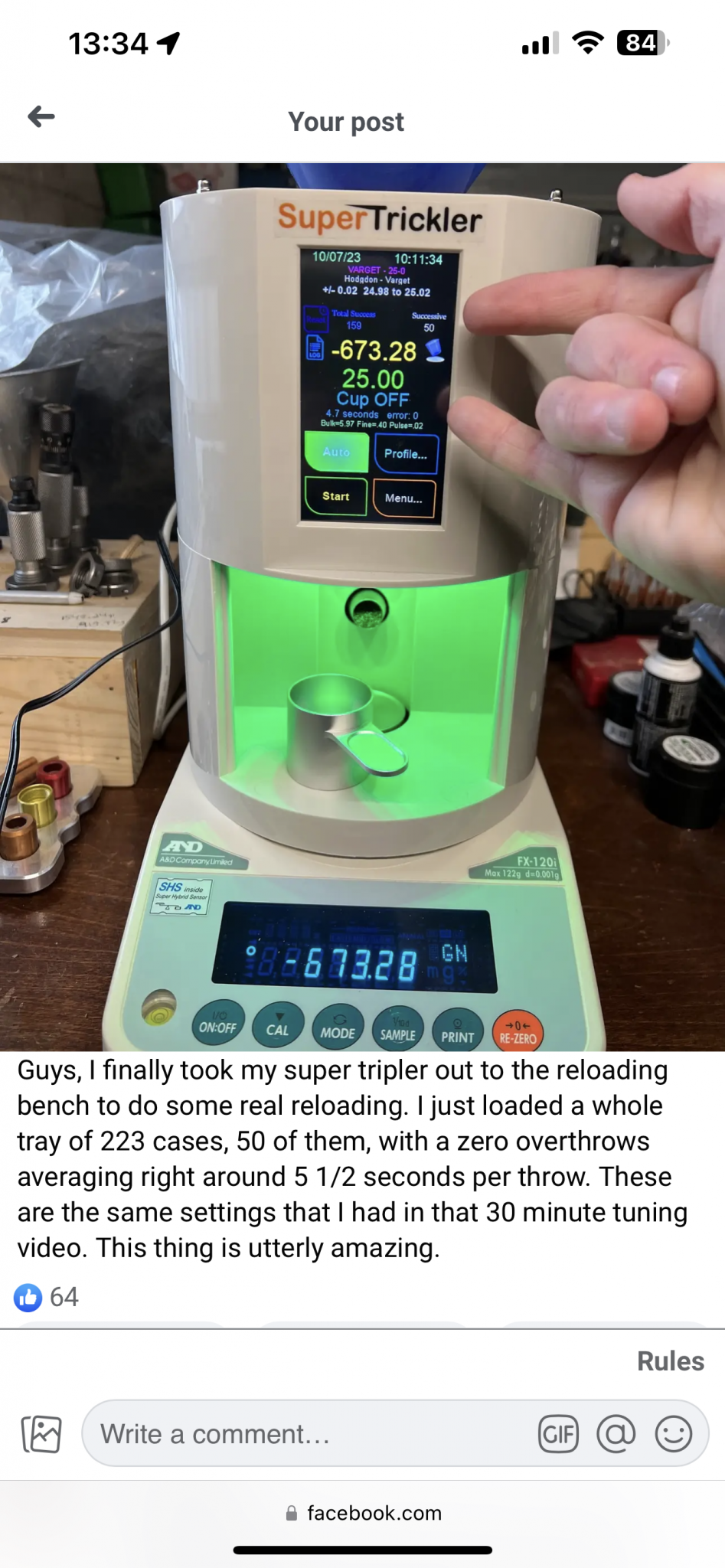

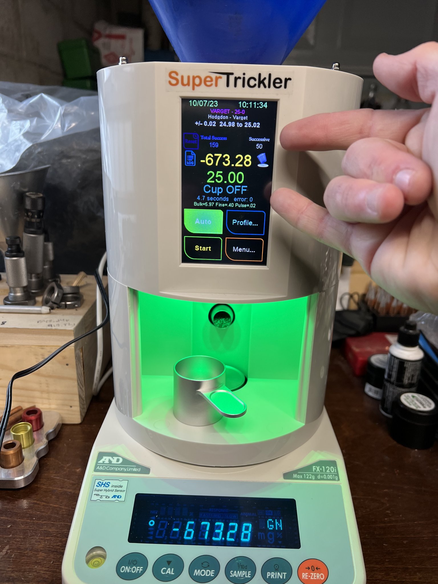

View attachment 8049289I finally took my super tickler out to my reloading bench for some real world work. 50 in a row with zero overthrows, a whole tray of 223, averaging right around 5 1/2 seconds per throw. Check the stats. Last one was 4.7 seconds.
We need to have a contest to see what the best results are with different settings. And if anybody wants to go head to head with their auto tripler, hit me up :)
ETA: these are the same settings from the 30 minute "tuning" video posted above. I learned from Peter Kowald, the software/AI developer on the FB group, that the numbers under the time (4.7 seconds) that say bulk, fine, and pulse are the "inflight" weights for that last drop. So you can monitor them for stability and to understand why some throws are different/slower/faster/overages than others - it's because of those varying and unpredictable inflights. In the video I didn't describe it correctly.

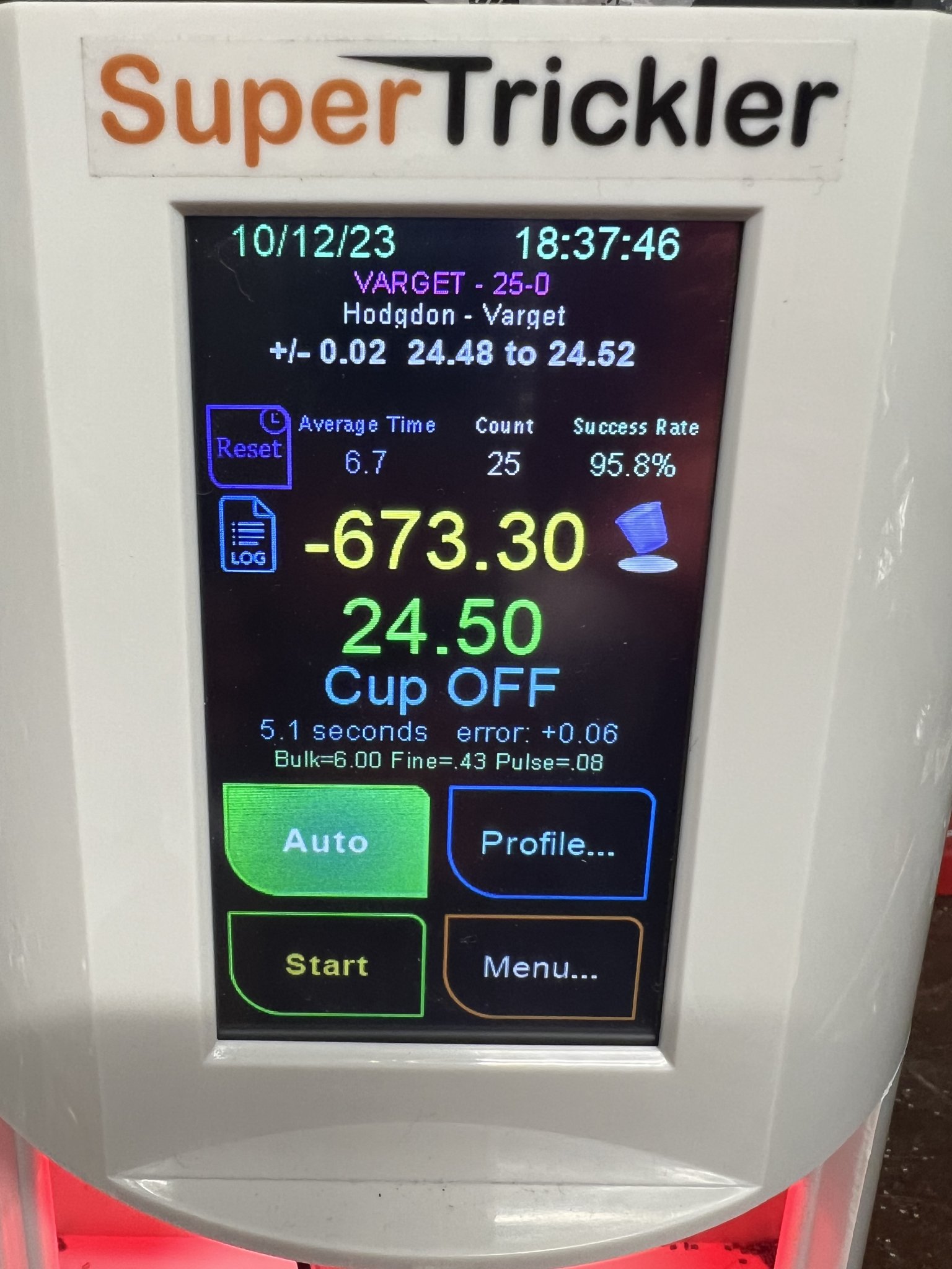

So apparently, I’m a beta tester now. Check out this newest update for the read out. Statistics. Exactly what we want to know as far as I’m concerned and I bet you will agree. It now tells you your average drop time your number of drops and your success rate. You can reset it manually whenever you want and you can either include over charges or exclude over charges in the average. Now, we can all compare our settings with statistical output, measured by the machine which prevents cheating and selective presentation of the data. This means if I share my screen like this one and I had 25 drops with an average of 6.6 in the success rate of 96%, that’s what I had. You don’t have to count on me to tell you oh I got 50 in a row with an average time of XYZ and only ABC over charges. The machine prevents you from exaggerating your results with these outputs.
Notice too that I cheated. I recorded these outputs with a red light below meaning that I did it right after an overthrow. You can know that by lookig at the error under cup "OFF" where it says 0.06 (which was a 0.06 overthrow). And, my 6.6 time is higher than my optimistic post above where I said 50 in a row with average "around" 5.5 seconds. Part of the reason for this is I'm running the machine in my unheated garage which is 25 degrees right now and the machine is *definitely* temperature sensitive like Alliant Reloder powders. The vibration fine/pulse motor has markedly different operating characteristics in different temperatures. If you're in a temperature controlled environment, it's a non-issue. But if it's cold, the fine/pulse settings change significantly as the machine heats up. I will have a post about that and how to compensate for it in the future on the facebook page.

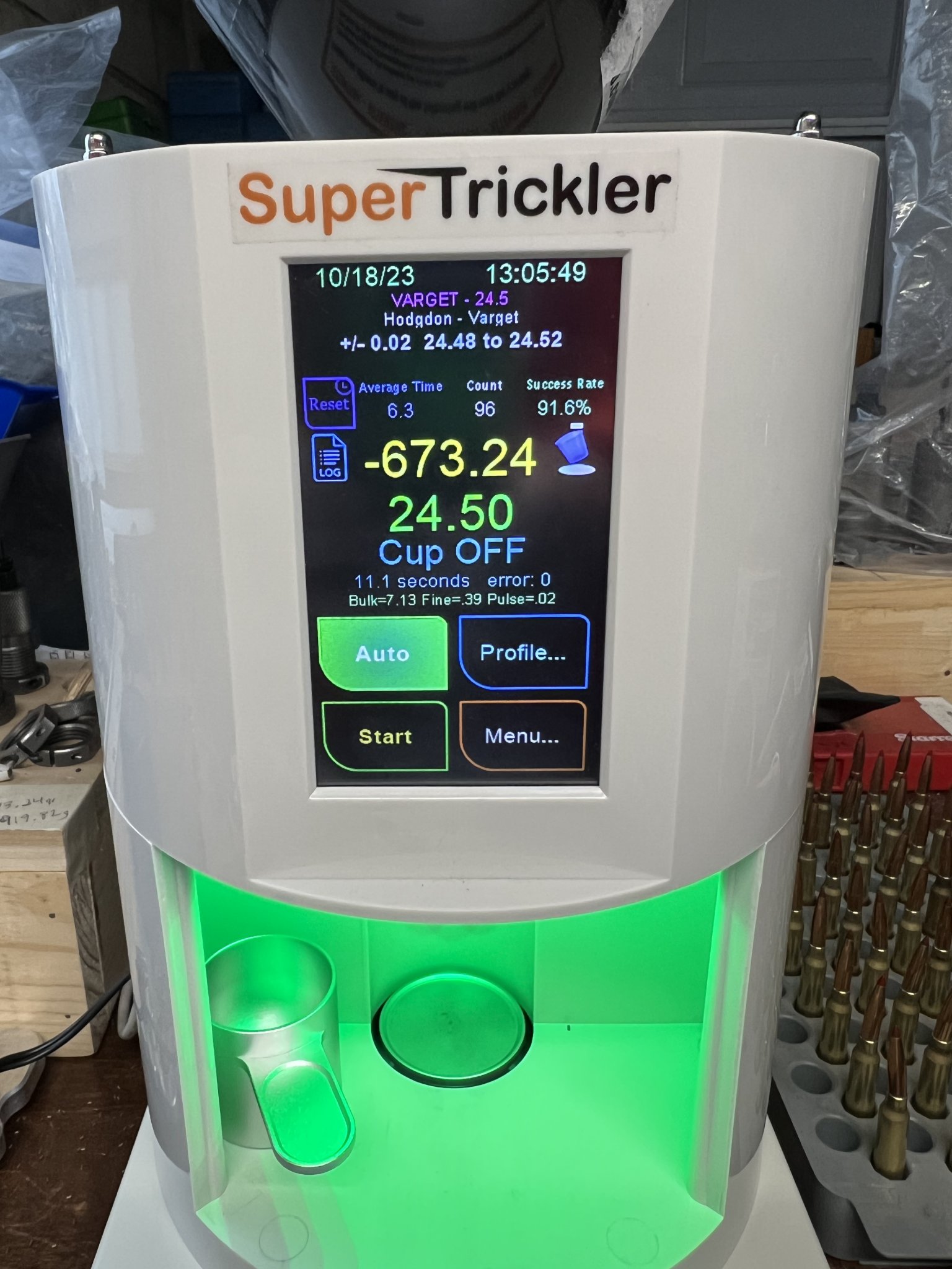

96 223 VARGET loads average time 6.3 seconds (see beta firmware screen settings) and 92% accuracy. Plus this was in my 30 degree garage which is suboptimal cuz I had to adjust the vibrator settings as the fine motor heated up. So the 92% was *with adjustments in real time* because of temperature changes. :) if you do the math, the throws took 10 minutes. If it takes you the same 6ish seconds to move the cup back and forth, you could charge 100 cases in well under 30 minutes. Maybe even 20. ;-)

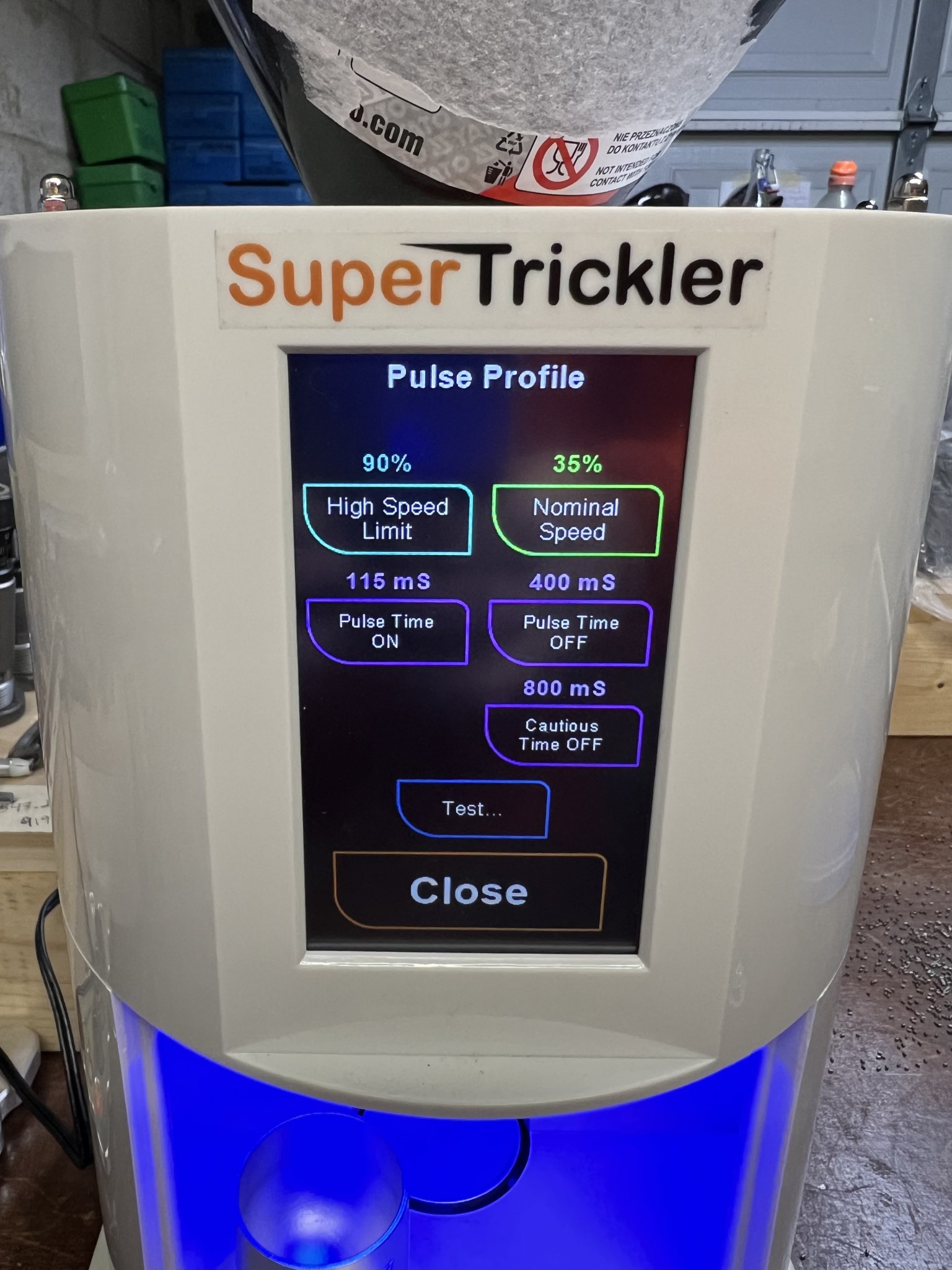

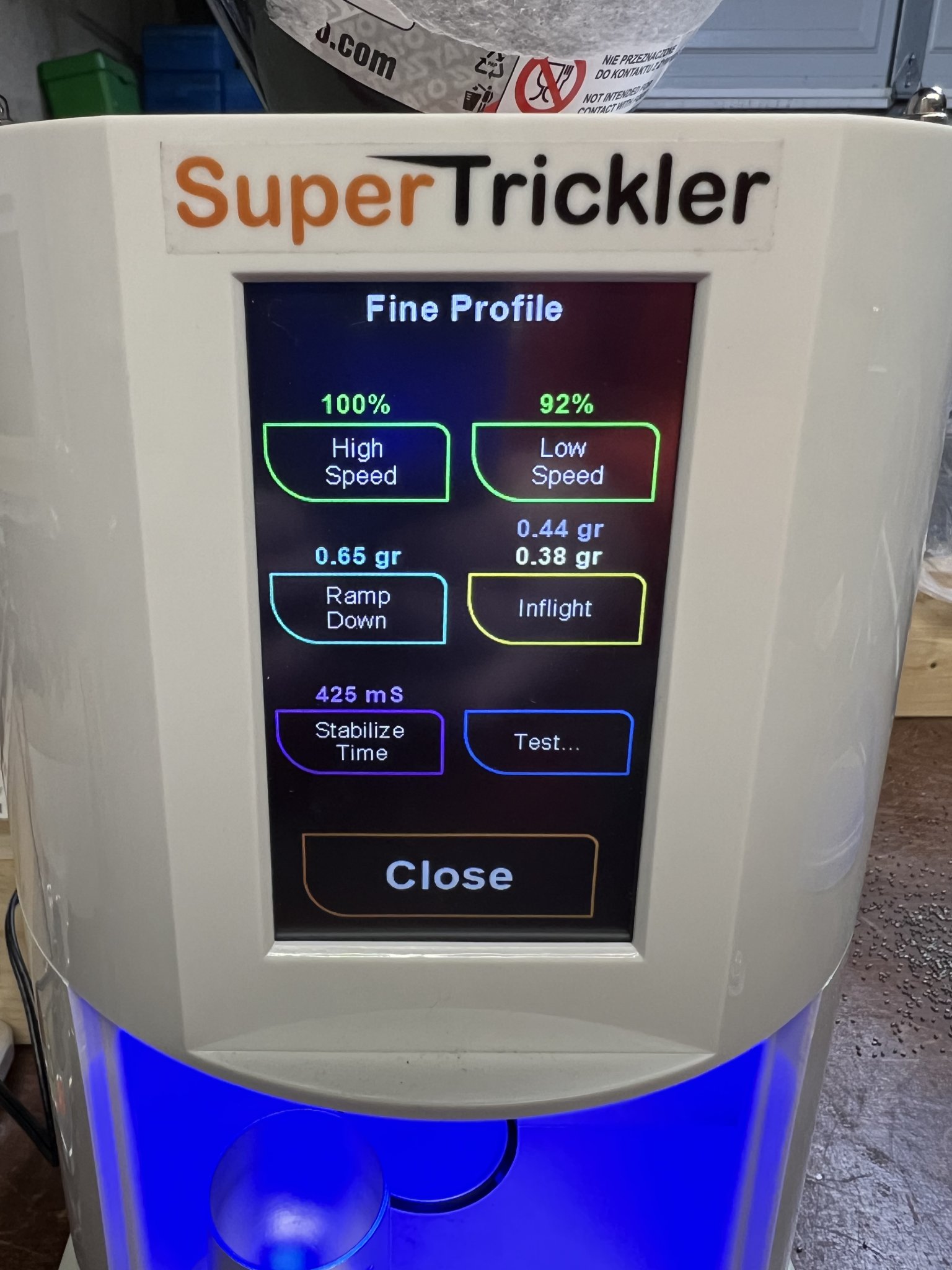

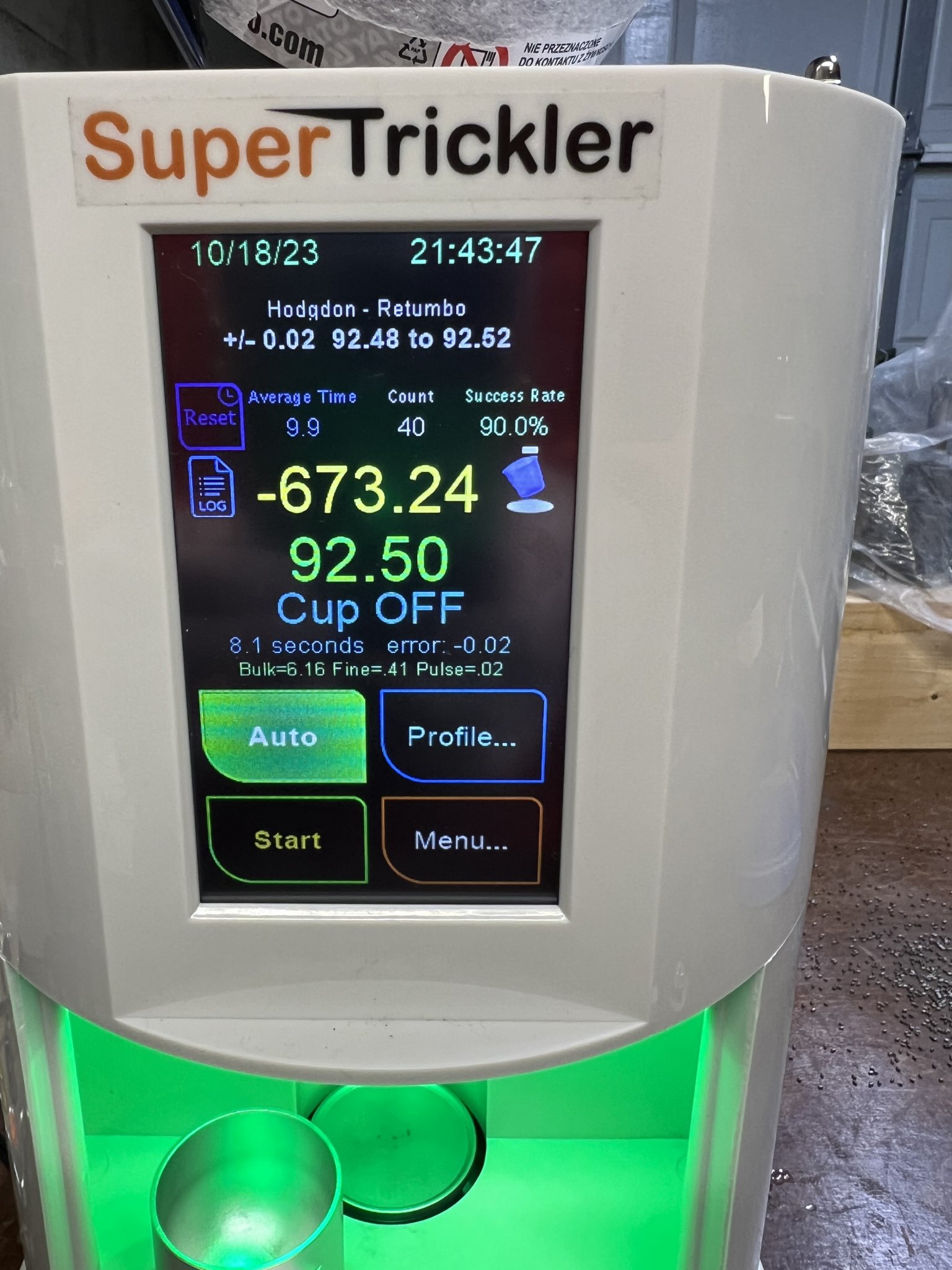

I met my match with RETUMBO tonight. Hours of fiddling with it, and nothing but blood, sweat, toil, and tears. But I achieved my goal. I would not consider it a realistic goal, honestly, because RETUMBO is just a difficult powder to dispense. Consider it an upper limit to what you can to. I did manage to dispense 40 charges of 92.5 grains in under 10 seconds with a 10% error rate. That was the goal. I'm not sure honestly I could duplicate it over the long run. Observations:
First, don't try to push the limits like this unless you're in a climate controlled environment with a stable temperature. As the temperature changes, so does the vibratory motor speed and you will drive yourself mad.
Next, you HAVE TO watch the small tube when you make changes if you have lofty goals.

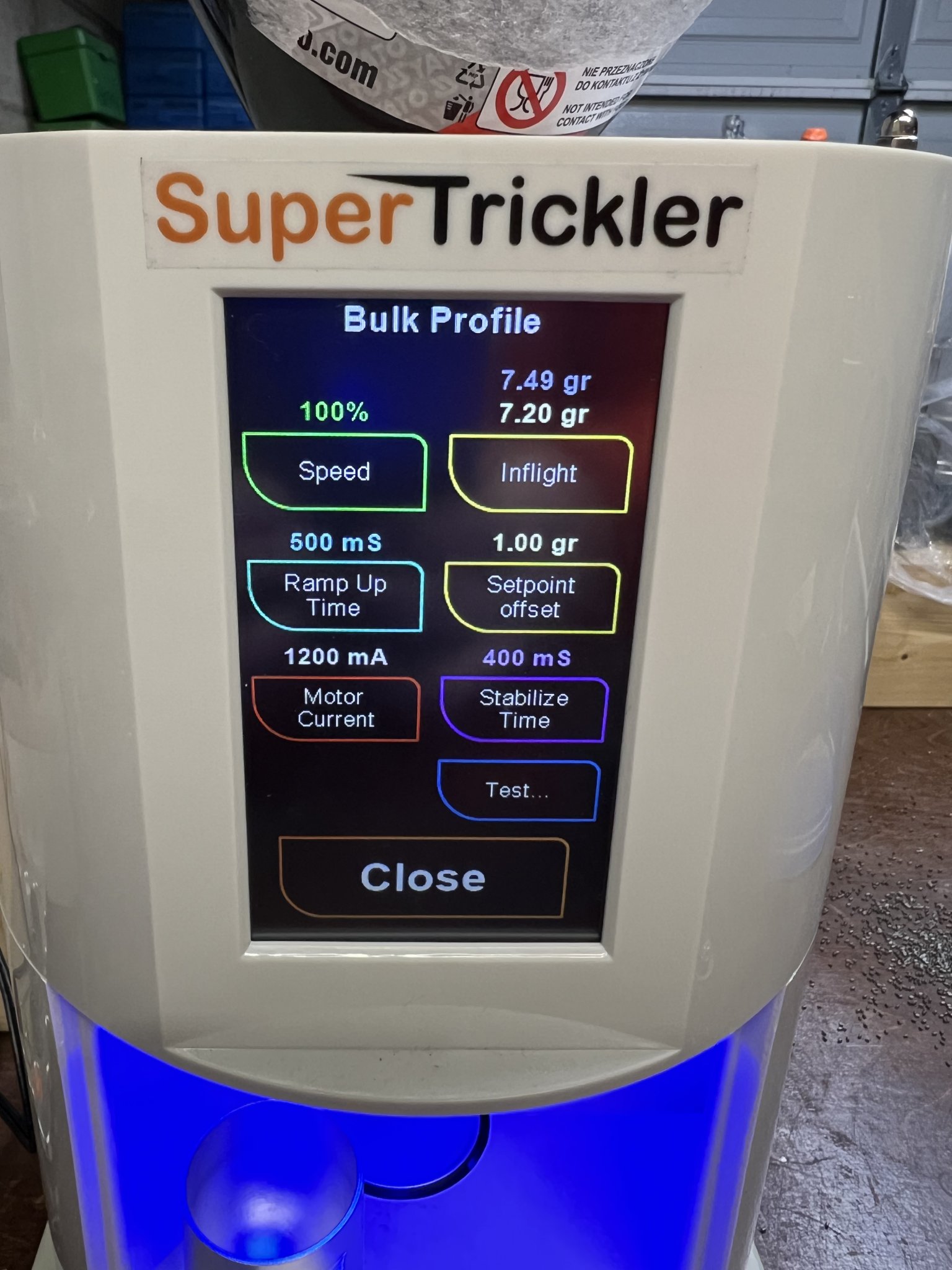

With RETUMBO (and probably lots of large stick powders) small tube loading is a key factor for consistency. For RETUMBO, you only want the FINE MOTOR to engage for one run. If it does a second run, the tube will be variably loaded and wreak chaos on consistency. Also, I set the fine motor speeds in a narrow range which was also to force it to do the same thing each load to make tube loading consistent for the pulse instrument. If the tube was variably loaded for the pulse phase, overages went through the roof.
That's about all the guidance I can give other than my final settings which are in the pics below. I had to change basically every setting. The "stable" times are longer than they are for my other powders, is the only other general guidance I can provide.
Good luck. Honestly, 12-14 seconds with >90% success rate is more realistic for this powder which nearly drove me mad.
Do note that while I was "fiddling" with the machine, I could have loaded about 400 338 Lapua rounds - I only loaded 100, but on the up side, even if you screw around and have a 25% error rate while you're "tuning" (I did), you're at least loading shells with the 75% that were *spot on*, and, if you're like me, you had a lot of fun in the process. #retumbo #supertrickler
