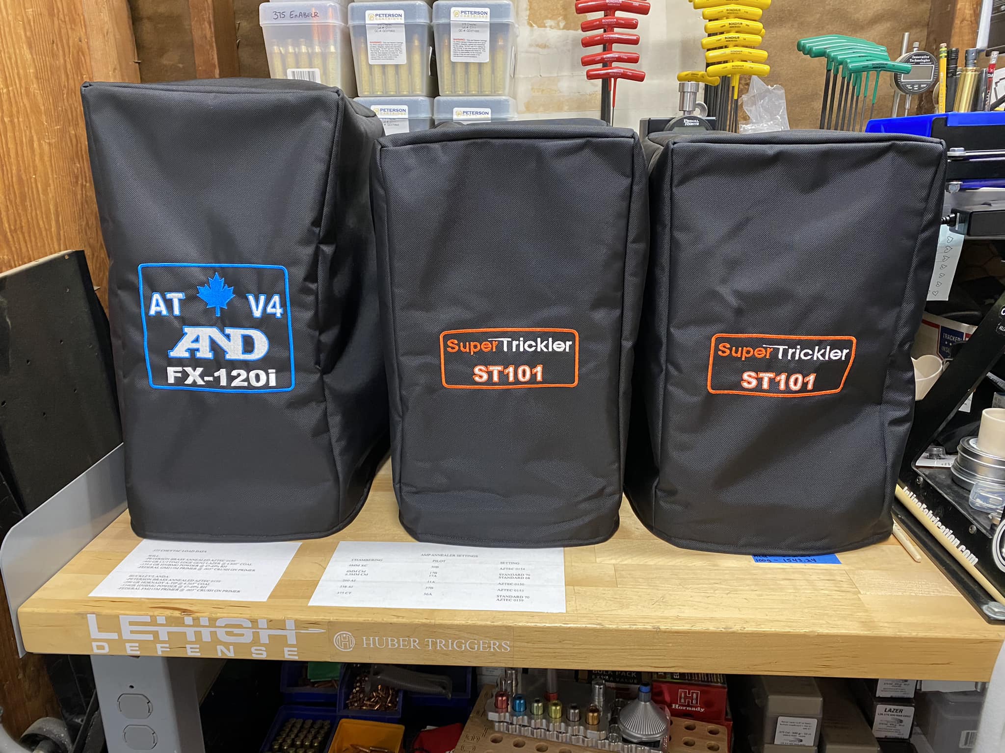

Customer posted this on the FB page. I like seeing the covers on the equipment.
yea I saw this.... like I said on that thread too. Technology is outdated the moment you buy it.
If when you wear it out you still love it, and it is still a great offering, then you buy the current model.

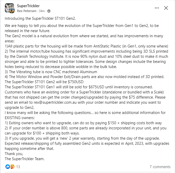

I wager that a future update (I have no knowledge of this, just speculation) will change the vibratory motor so that it is not so highly temperature sensitive as it currently is. That is my only major complaint with the super trick lawyer, that if you set it up in a 70° room and then try to use it in a 20° room your settings won’t work until about 50 throws when the motor starts to warm up and even then they won’t be perfect.
The listed updates for Jenn to do not seem worth it to me to pay $150 and ship the thing back to Denmark. If there are later upgrades which are still compatible with the majority of the apparatus, I might consider sending it back then or if I needed a warranty claim. There are some static issues, but I don’t have any problem with my tube or how it turns.
Looks like there will be a US based shop for upgrades... So looks like shipping may be more reasonable.

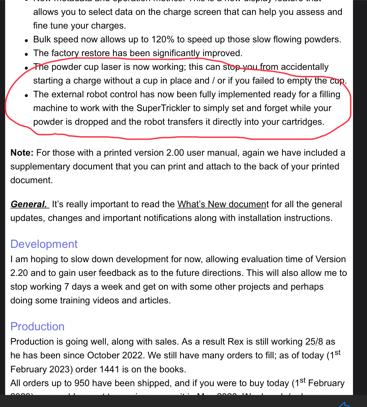

when I was watching the updates on the supertrickler Facebook page like 6 months ago there was a video of the super trickler dumping weighted charges right into cases . It looked like a conveyor belt bumping the charge . Did any one else see this or have the video of this ? I can’t seem to find it now . Now that piece of kit will be truly revolutionary .
I don’t have a picture of the robot. But this was in the email from them today
Reactions: Herb Stoner
Yes, that video is down further on the page and I have not heard anything other than prototype but that’s why there is that large multi pin port on the back above the one that you use for your data cable. I think that that apparatus is going to be prohibitively, expensive, except for people who do very large volumes, I also think it is going to take a good deal more effort to refine to functionality than the super trickster did.

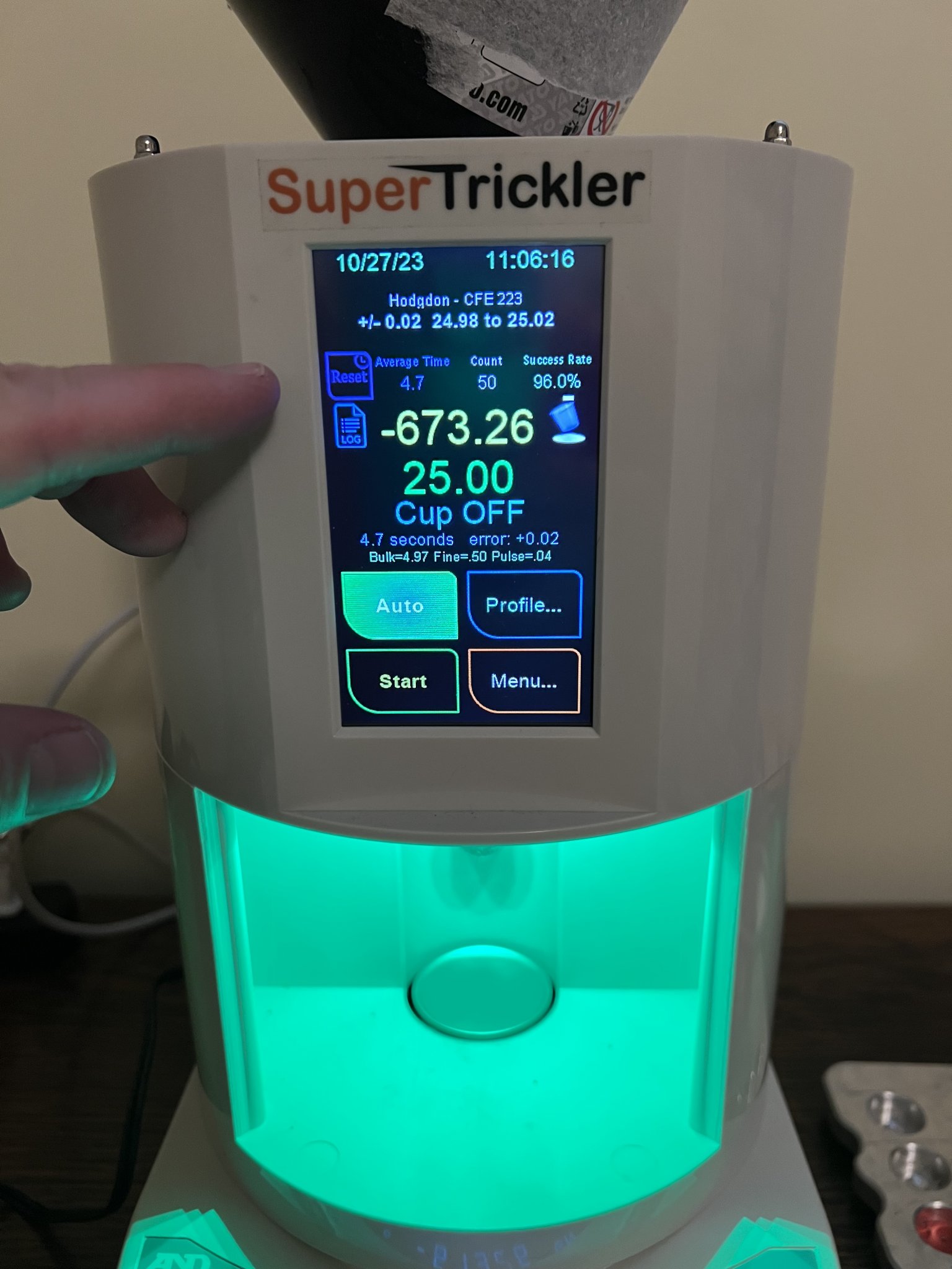

This is the first time I’ve played with a ball powder, and I don’t even reload CFE 223, but I did it for somebody who asked - I forget if it was in this thread or somewhere else. Anyway, 4.7 seconds average over 50 drops with a 98% success rate. It says 96 but that’s because my son dropped a pair of pliers on the table during the pulse phase and threw it over. not sure what guys are getting with CFE and the ATv4 , but I doubt it’s this good. I say that because if I recall correctly, the autotrickler does better with the small balls LOL
powders
Normal inside room temp 68-72 degrees . Shooting for 12g
I couldn’t find your post and I don’t have CFEBLK but I did CFE 223 with a target of 25.0 as above. Without changing anything but the target charge, I got average under 4 seconds for a drop of 12 grains CFE 223 over 10 drops. I don't think they're optimized for a drop that low (higher error rate) but it's close. If you're having trouble send me your actual settings and I'll see if I can help you tune it up.

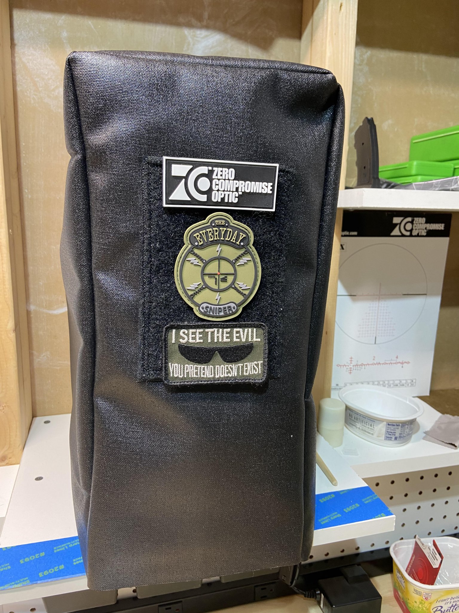

That is what I did. Mine is on a shelf that is attached directly to the wall studs.

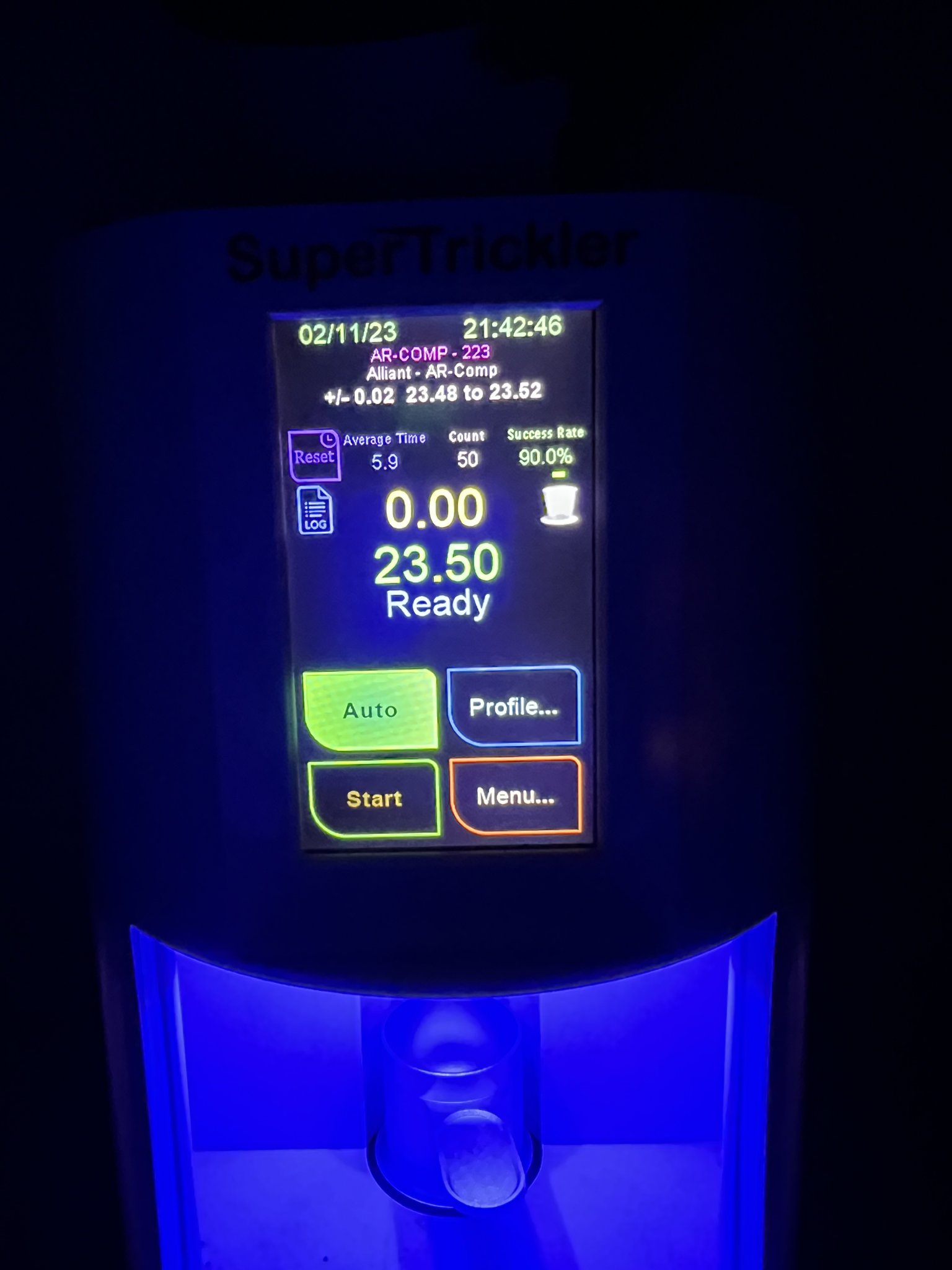

A new beta update I tested tonight for about 500 drops shaved 20% - more than a full second off AR-Comp drop times. Nothing short of amazing for an incremental improvement.
We're talking about taking drop times from 7.5 seconds to under 6 seconds with IMPROVED accuracy.
I'm not sure you guys understand how talented the developers are, and how unceasingly they are working to improve an already superior product.
Good things seem to never stop coming, my friends. You will be pleased, I promise you.
