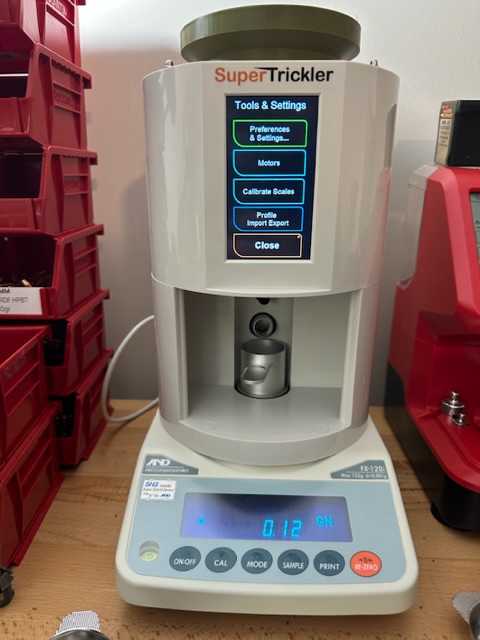

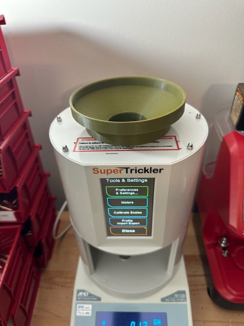

super trickler

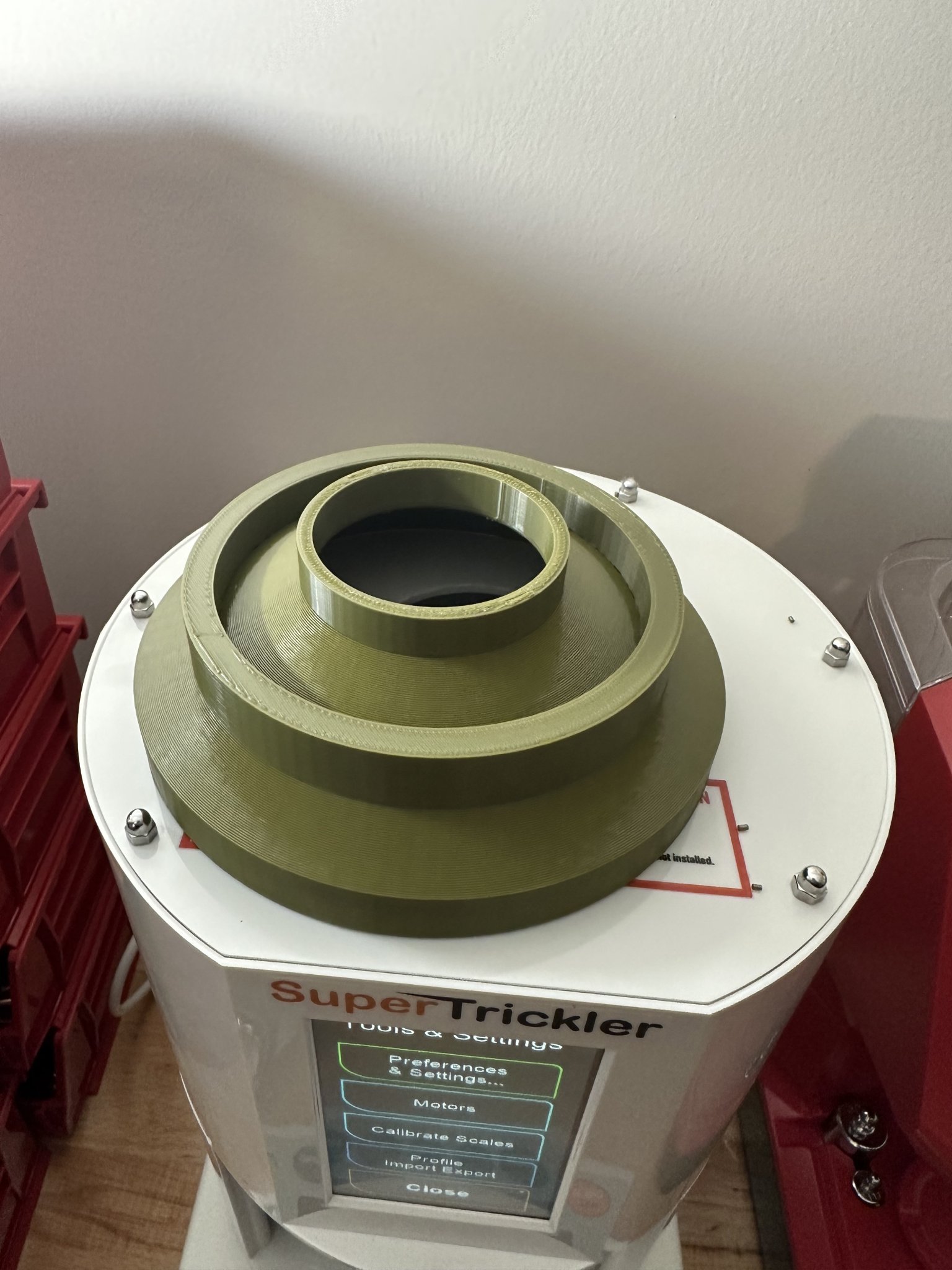

Spun up a funnel for the top, can make the STL available, may work on other parts if anyone is interested.

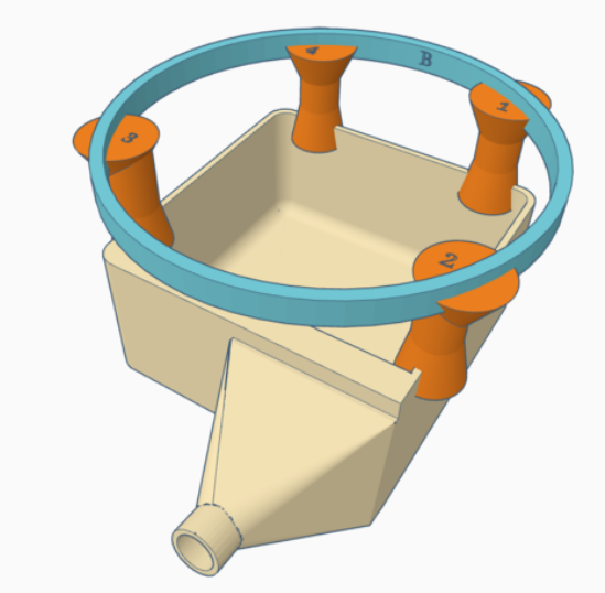

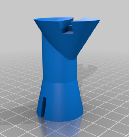

Free code/files for printed stuff (e.g., emptying platform) posted on the FB page by Andy Howard
From the Andy Howard FB post.
https://www.thingiverse.com/thing:5...Xoo5EeqlKZhePw5amQVsMHU4X2J2VT7koksoUKXw7acV0
SuperTrickler powder measure stand.
This design can be used independently, or it can be attached to the square SuperTrickler powder bowl (designed by Peter Kowald) that people are 3d printing.
The ring has a small B on what would be the "Back" of the ring. This would be at 12:00 if you were looking down at the ring like a clock.
It has 4 pillars (legs). IMPORTANT: Each pillar is unique!! They need to be positioned on the ring starting with number 1 at the 1:00 position, and working around the ring clockwise in numerical order. The pillars have a small keyway that matches with a cutout in the ring, so when they mate together you know the ring and pillars are in the correct position.
****If you printed the powder bowl with any changes to the x or y dimensions, this will NOT work on your bowl.****
Reactions: straightshooter1

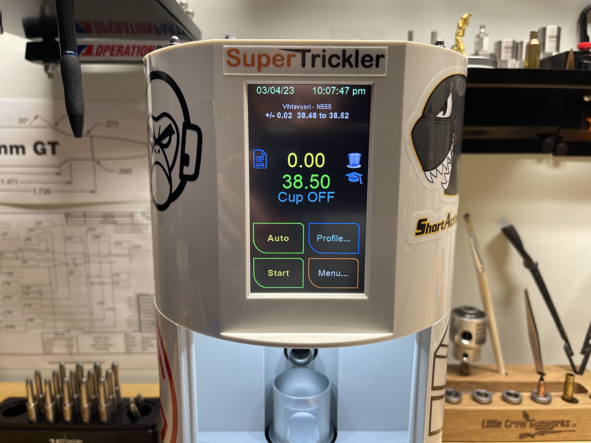

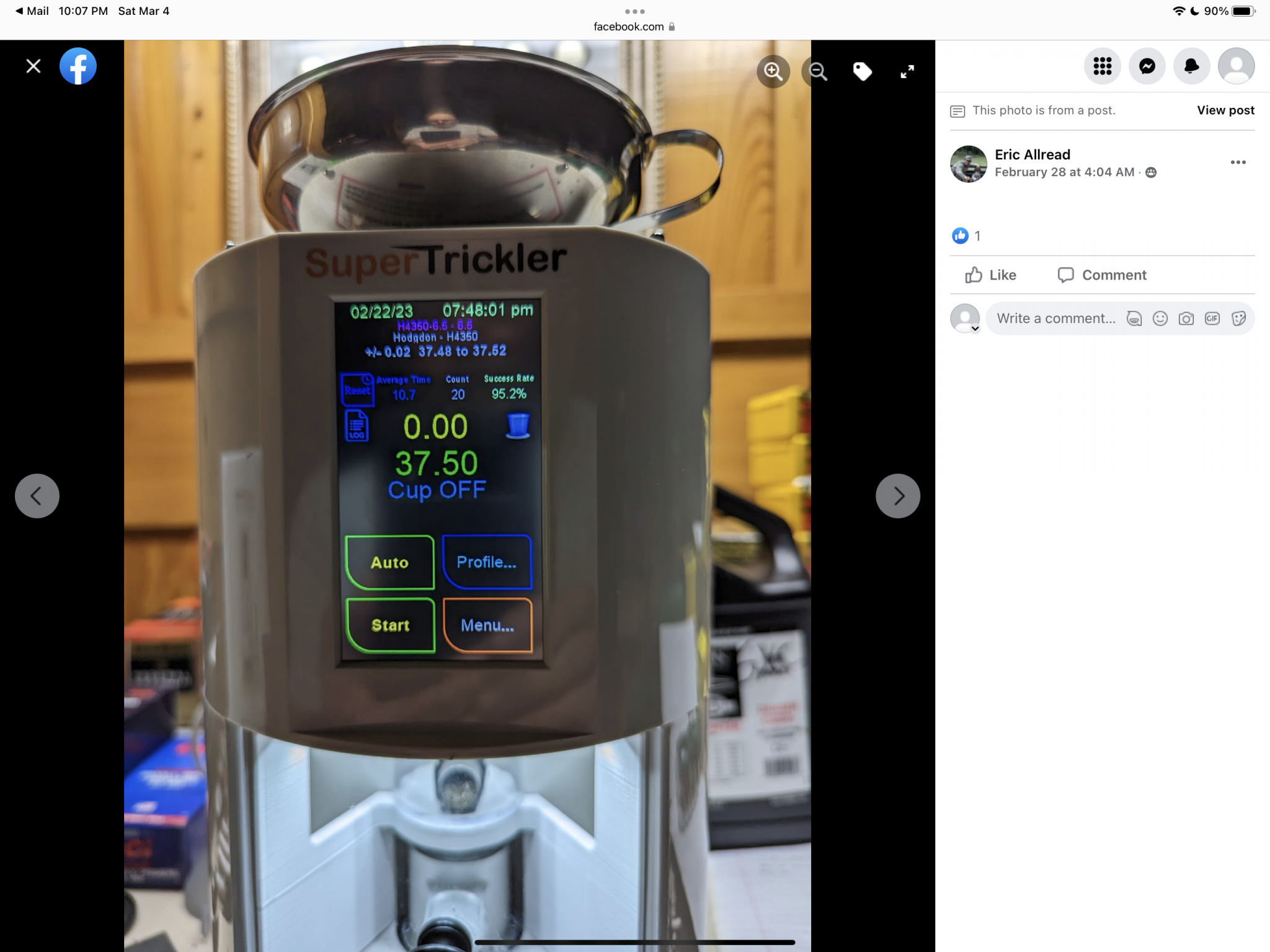

Hey I just noticed all my log data is gone . It doesn’t show me any info . It shows the paper with the corner folder that says log but no info . Did i hit something or did something get screwed up with my last update ?
A few weeks ago but I haven’t used it much befor tonight . I loaded 250rds of 6gt and noticed it didn’t say how many rounds have been thrown correct like it used to . Didn’t know if it was something that can be turned on or off but I can’t find anything like that in the settings and was just wondering if it was like that before I updated it . I don’t remember
I took the pic on the left of a trickler on there Facebook page the one on the right is mine as you notice it’s missing info
