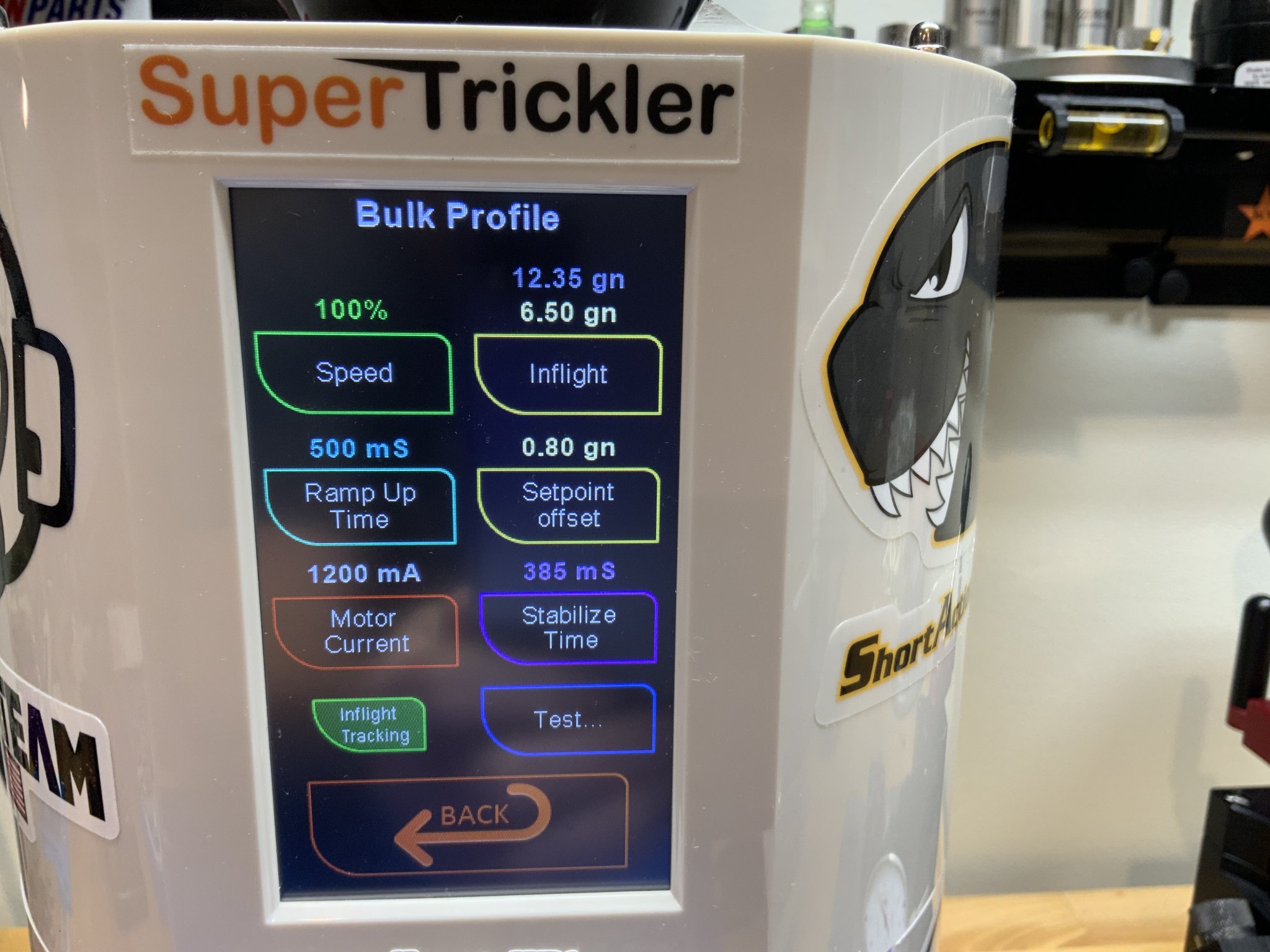

There is an enormous discrepancy between the bulk in flight that is calculated, and what is set. On your settings.
Set the bulk in flight to 12 greens

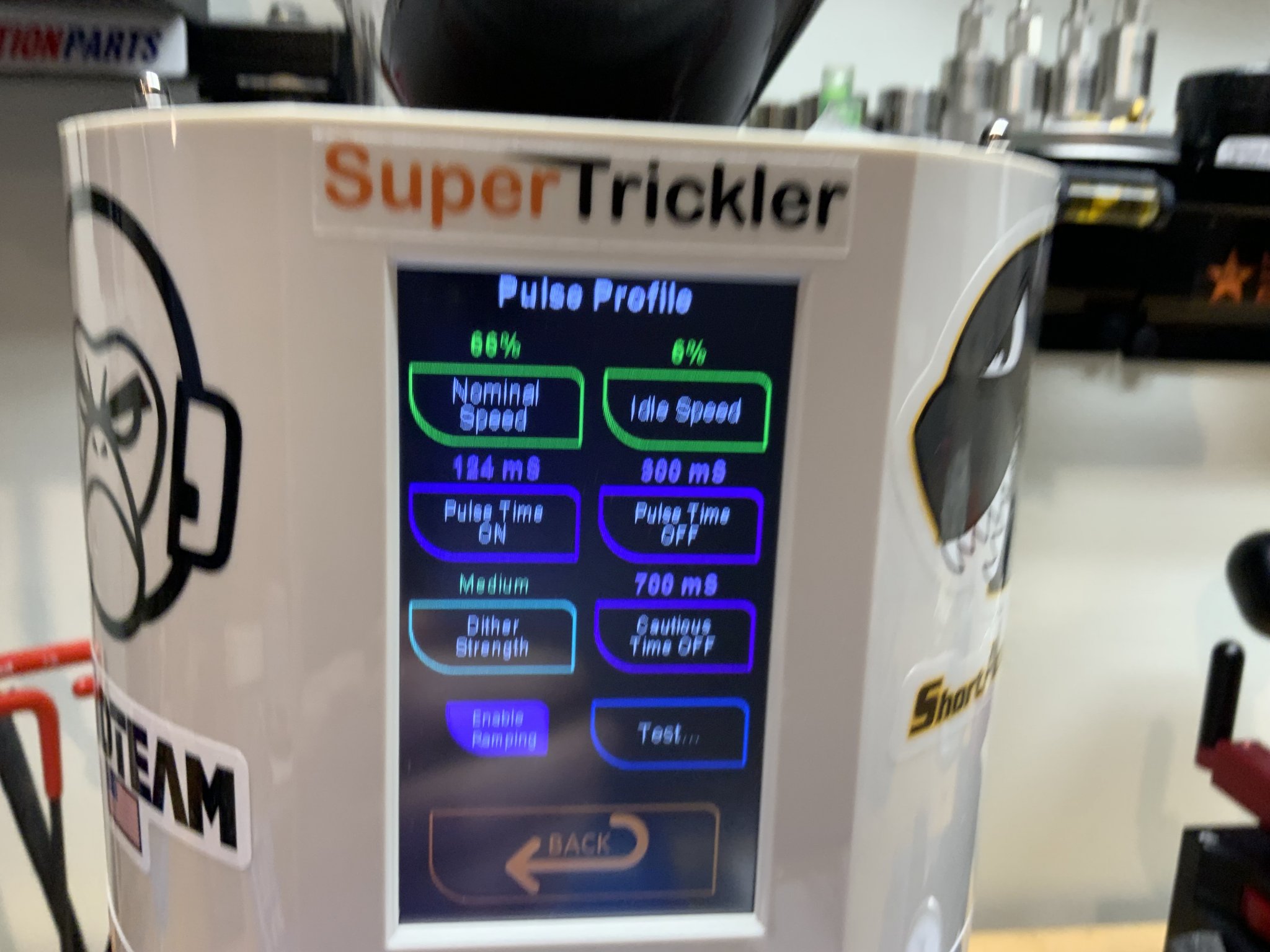

Also, your idle speed for your vibratory motor is high. Turn that down to like two or 3%
I was a beta tester, but I sold my machine, so my memory is starting to get rusty, but that’s where I would start

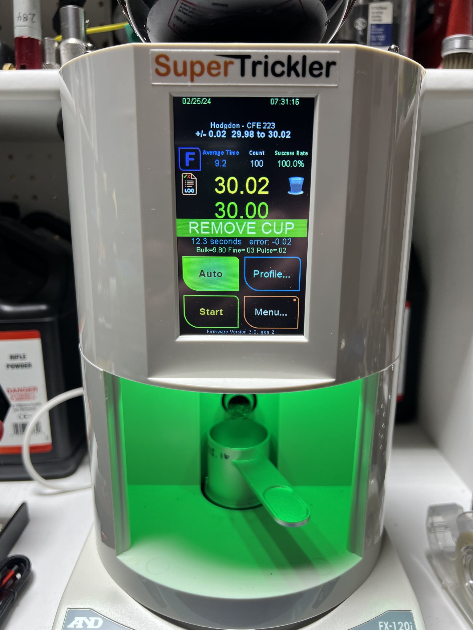

Ok updated to 3.0 a few days ago. It has completely fixed the ST for me. I am getting 90% + throws 15 seconds or less. I could tune it faster but I am so happy with the accuracy that I don't want to mess with it. The 10% remaining overthrows are almost only .02 over.
Its night and day difference throwing H4350, and I would assume will be the same for other extruded powders. It works so well I just bought a second machine. Still have the IP trickler on pre-order but may just end up selling it.
If you have a ST, do the update ASAP. Its a game changer.

Down loaded 3.0 yesterday and it works great in Varget. Ran 44 straight ave. 16.5 seconds. This is a huge improvement over the 2.41.
I was about done with the supertrickler as well until 3.0. Without any tweaking and using only AI, I threw 100 straight with an 88% success rate with an average throw time of 9.5 seconds of Varget. For now it looks like it’s staying on my bench. But that IP set up looks tempting as hell :ROFLMAO:

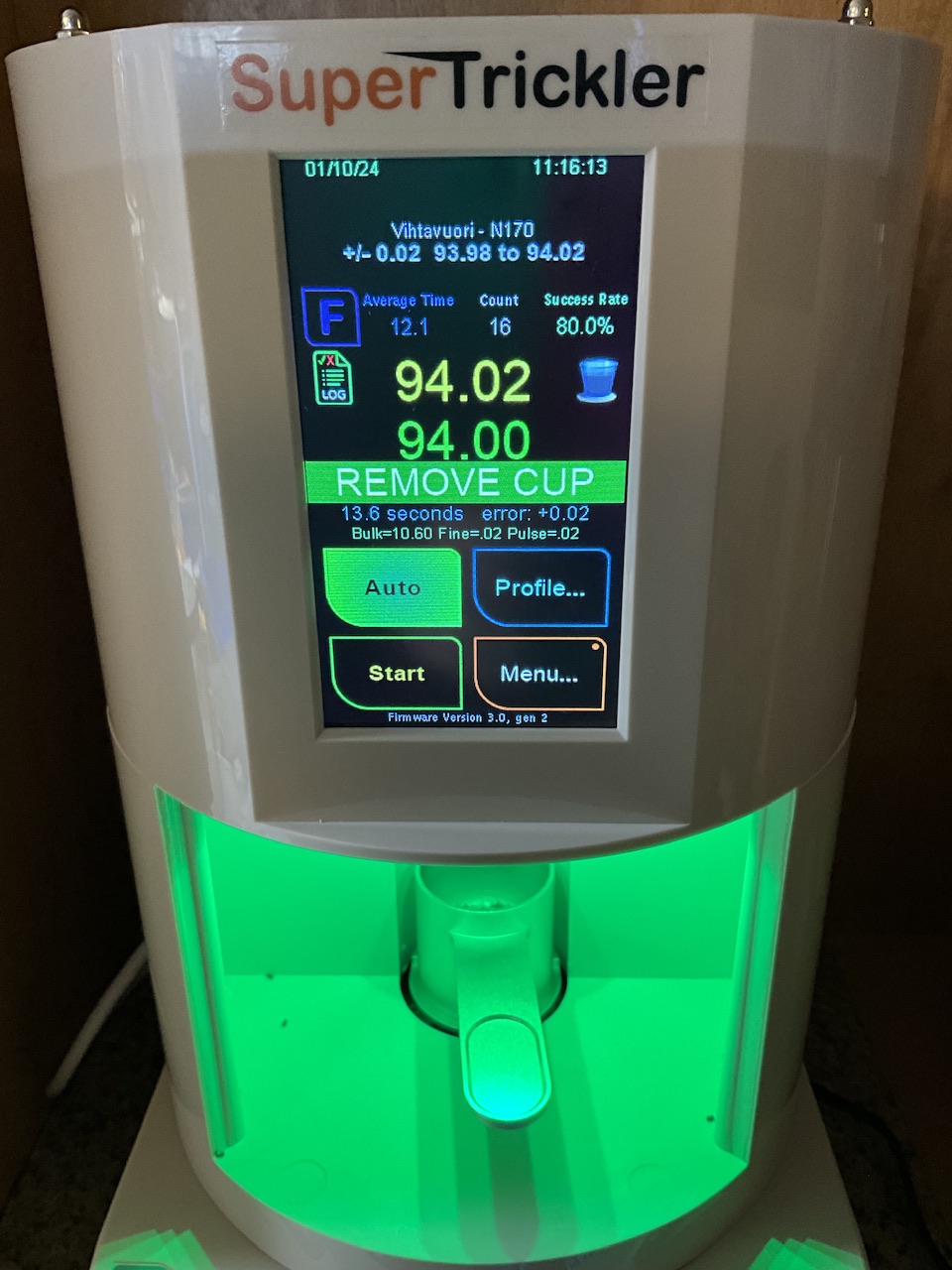

94.0gr of N170. Let AI figure it out first. After some fiddling, I adjusted bulk offset to 1.3 and fine to 0.14
Never had 80% success rate before. More tweaking probably would help, but this is doable.

This is with the 3.0 update?
Yes. Like I mentioned, I did not have much time to play around and I think it can do better yet. Observing the process it seemed that both bulk and fine go “overboard” easily and 1 kernel appears to be .02, so tweaking both bulk and fine helps to make sure that at the end pulse is getting used for the final drop. It added about 2 secs to the avg time.

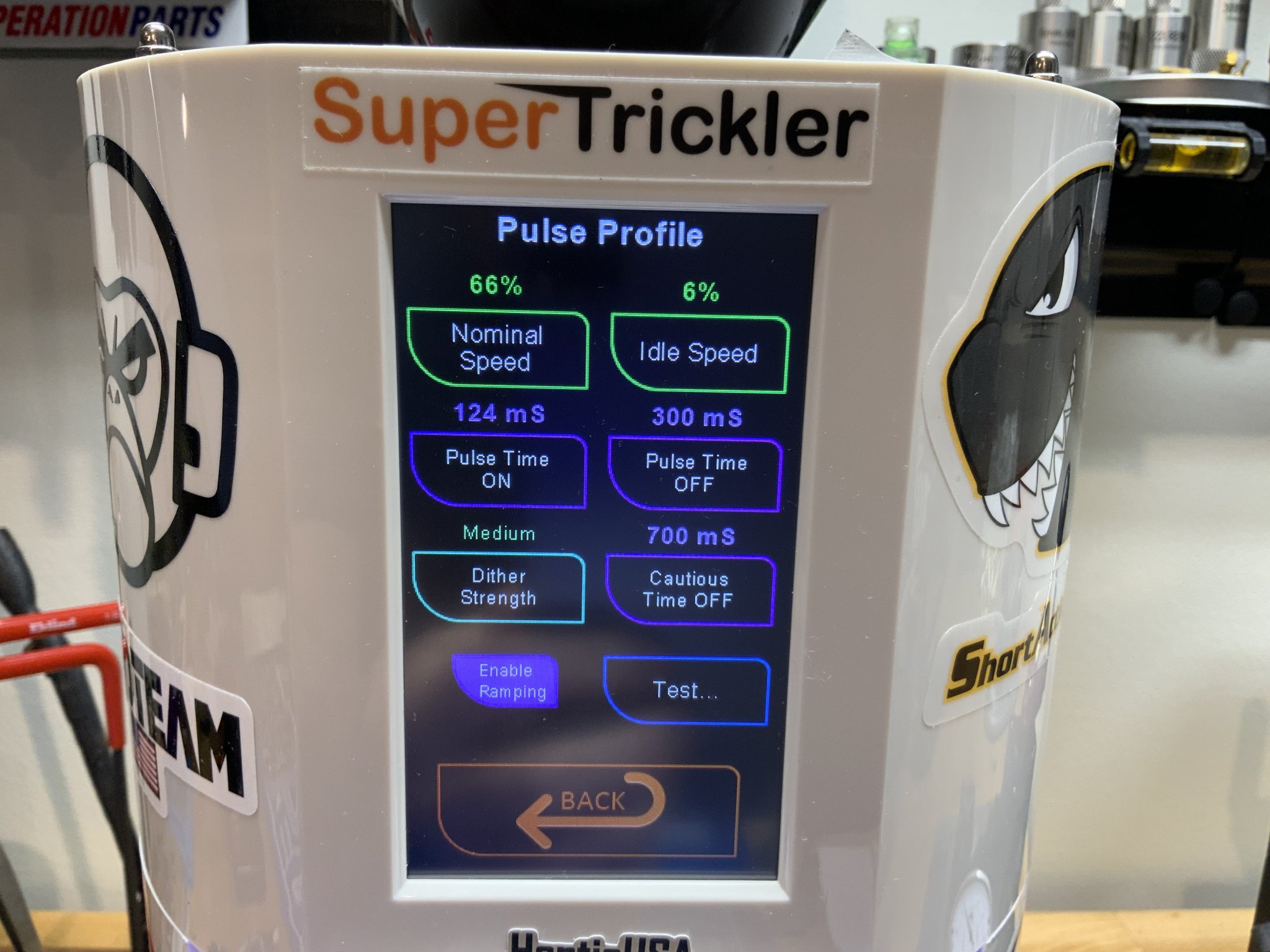

Well, here’s a new one for me ref the ST. Finally running low on 174gr SMK x54R handloads for my SVDs, it was time to make a preset for 45.5gr of IMR 4064 to make a few hundred rounds over the next month or so. I tweaked the settings and saved the new profile earlier this week without issue before putting the powder back in the keg as I knew it would be a few days before I got back to loading.
Fast forward to today, and powder is not going into the small vibrator tube. Prime the tubes all day long, powder is flowing from the larger bottom tube, the vibrator tube is vibrating, but no powder is falling in the small tube. WTF?!?
What am I missing? Tried poking a pipe cleaner down from the powder hopper and up from the vibrator tube, thinking a couple long kernels perfectly blocked the entrance, but didn’t seem to encounter any resistance or knock anything loose. So, what the fuck?

I actually dusted off my ST after a longer hiatus than I realized to load up some 54R. Took me a bit to tweak a preset for 45.4gr of IMR4064, but once I bumped up the vibration setting by 20ms it was dropping to within .02gr in 12-20sec. That's plenty fast for me as I'm seating a bullet after I charge each case. If I was using a loading block, I'd probably play with it some more. I normally got 10-15 throws before it would overthrow, and it would normally overthrow to 45.44 or 45.46, which is still plenty accurate for my 54R loads in an SVD. I thought about expanding the approved range, but wanted to see how it did holding to the tighter window.

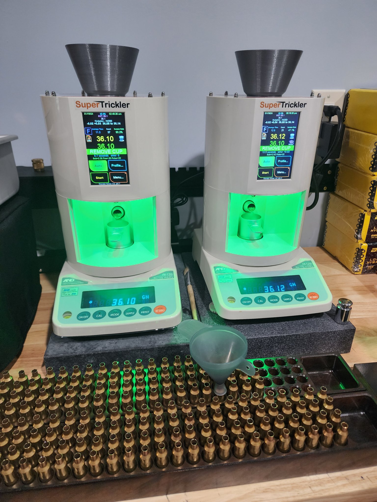

I see you have blocks of Granite under the scales. What do they do? I understand more stability.
I have a 1/2 sheet of Aluminum on my wood block tabletop, would that be the same idea?
Or does the Granite offer something different?
Honestly...not much. Mostly used as a riser but ideally it's a level surface that doesn't change with temp swings. Also adds some weight to the table.
