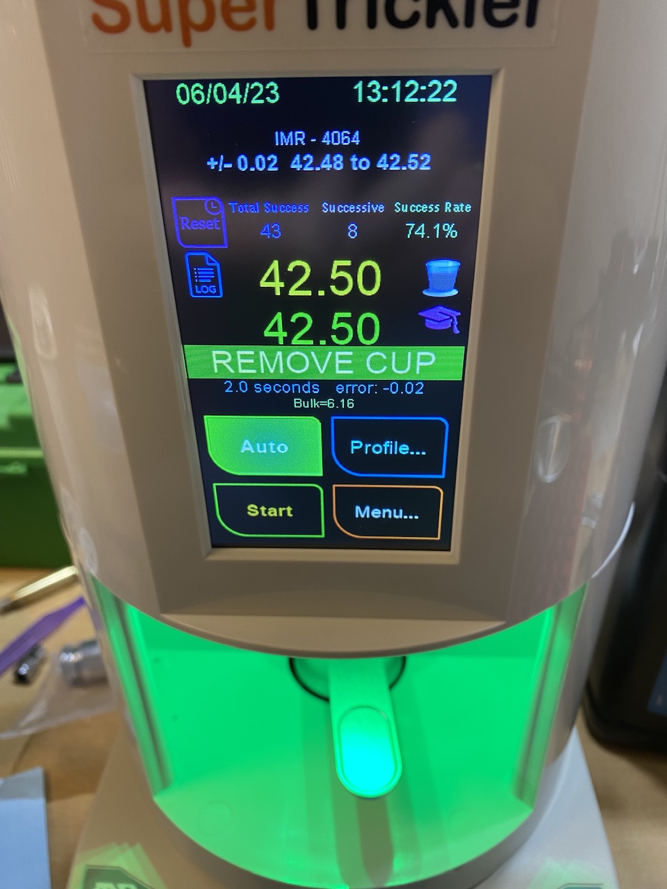

I was hoping AI learning would get me to 90+ % Accuracy. It got me between 70 and 75%. That said, avg time was well below 15s. In fact, 3.9 secs at some point was not really a surprise anymore (I know, it’s crazy). I wouldn’t mind bumping up the time by another 10 seconds if that would get me better than 90% numbers, but I would have to mess with it, learn and experiment, which I don’t want to have to do and which is why I opted for the self-learning thing In the first place.

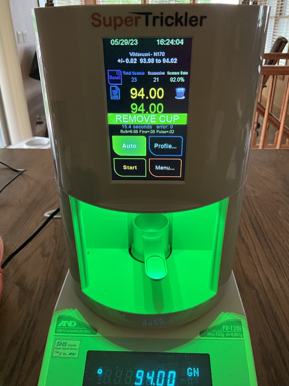

Another update. I‘m sitting here at my kitchen table and me moving around or one of the dogs walking by makes the scales readout move (up and down). Almost to the point of “don’t breathe” or it will affect your charge. This thing is scary accurate!
Better move it into the basement where there’s a concrete floor. Maybe get a dedicated shelf or something to eliminate vibration.
Initially I didn’t completely understand the vibrator speed thing (I figured it would take a woman to read that section of the manual 🤪), but it pays off to read up on it and set the min and max settings for your powder. There’s an option in the menu where you can observe what’s happening when dropping at both min and max vibrator settings (the manual says to make sure it doesn’t bounce out of the cup) and on my wobbly table I noticed any little movement by me would sometimes result in a lower read and then the next kernel takes it over the edge. Simply turning min or max vibrating speed down makes a big difference in my opinion. You can see it on the display where the icon is either shaking or blinking. I’m still averaging 15 secs (just a guess, probably still less). Btw… N170 is pretty coarse so especially with that in mind I’m very impressed. With that being all you have to do and let AI do the rest, this thing is IT.
I don’t want another science project or have to join facebook to copy or exchange settings. I’m at an age where I’m done learning. I just want to use and enjoy things. The ST101 lets me do that. I can handle the min and max vibrator thing as long as that’s all there is to it and it’s a 1 time deal. It is.

AI seems to do about 50-60% of the work. But it's back to watching the tubes after that.
I turned the "fine" setting back on. Still don't understand how to set the "idle".
Make sure “Simple Profile Mode” is turned off. V2.4 defaults to that setting so AI does all the work, you have to turn it off in order to set the idle speed.
Do you know what to look at when setting idle speed? From my understanding the vibration won't give any visual ques?
You might hear a slight difference in the tone of the pulse, but otherwise it will just push kernels out much faster/more consistently. More often than not I end up between 25-35% idle speed depending on the powder.

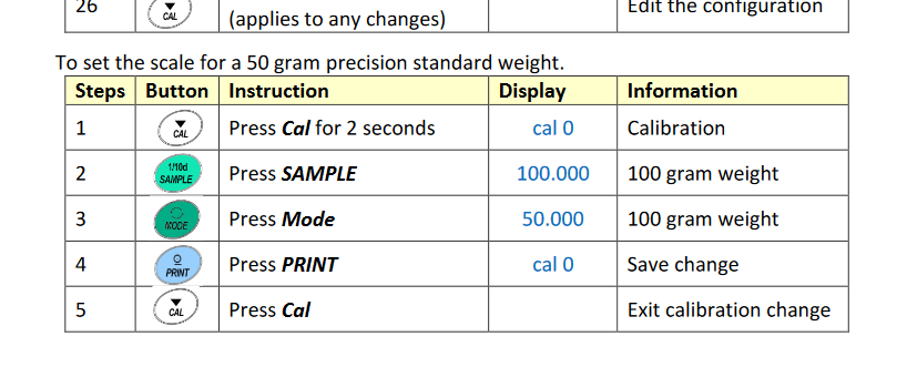

I believe that's only if you'd like to change your calibration weight from 100g to 50g.
