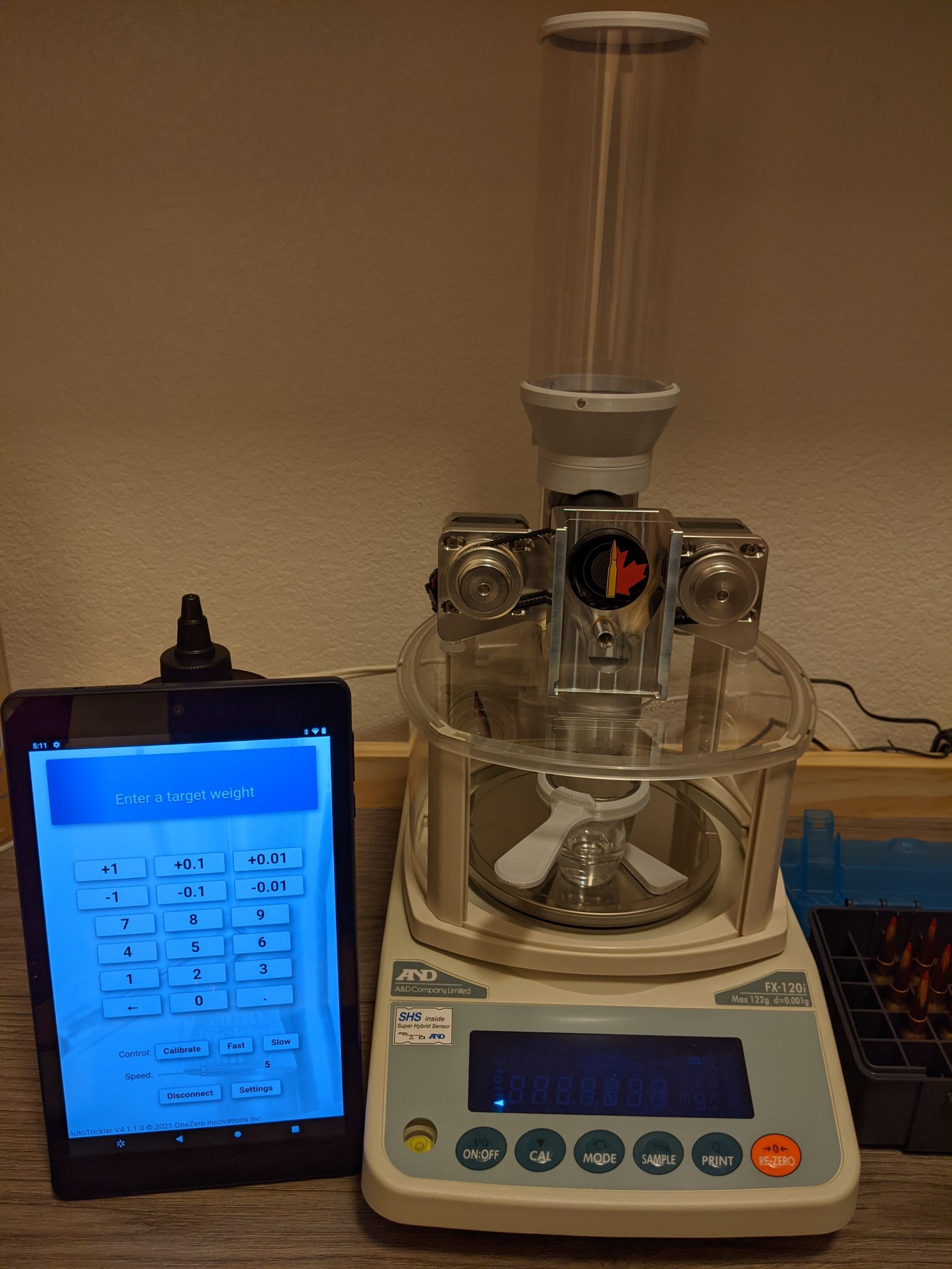

If you want a dedicated screen, I can confirm this $69 tablet works.

View attachment 7764866If you want a dedicated screen, I can confirm this $69 tablet works.
That's good to know. It has me reconsidering the ATV4. When you hook this tablet up can it communicate beyond the reloading room? For example, if a computer's left on in the office down the hall can this device link up to it? Can you tell the tablet to only communicate with the ATV4?

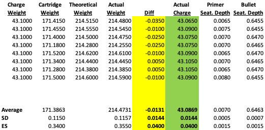

Just a data point on the V3 (but really the entire set up). This is all weighed on an A&D EJ54D2 - it is accurate to .003 grains. The scale was in an environmentally stable environment, calibrated and perfectly level. This is for a charge weight of 43.1g of Staball 6.5 - its only 8 measurements and not enough to be totally statistically significant although the difference of the errors is small. I weighed the unloaded primed cartridges with as little handling as possible and using gloves. I had just gotten the V3 so wanted to make sure it worked as advertised - I dont do this often, this was for an 8 shot string to prove that the charge weight worked. These particular 8 shots had an SD of 4.6 and ES of 16 fps as measured by a lab radar with an average speed of 2883. One note - the primer seating was done with the CPS and got me the best results of anything I've tried. Basically the Autotrickler seems to work as advertised with a .02 grain error which on both sides coincides with a .04 grain maximum spread.
For me, this set up gives me the confidence I need for my particular application. As to the advantage of a Prometheus - personally, knowing myself and the level of my anal retention, if I could afford it, having 0 difference would be great to have because I always want everything to be the same . Wether that matters or not on target, I wont even attempt to argue (.04 grains vs 0). Ironically enough, the BR guys that shoot at my club use Chargemasters at the bench but are loading to the environment for the particular time they are shooting. I have no clue but find all of this conversation very interesting so thank you all.
Just to be absolutely clear regarding the charge weight (column 1): Is that value (43.10) what the V3 was set to throw or what the scale readout actually read (or both)?
Thanks!
Thanks!
Yes that was the programmed charge on the V3. I didn’t record the actual weight from the 120 (in retrospect I probably should have) - I went straight to the other scale with the filled case to check against the theoretical weight. I was just checking how accurate it is. The weights do vary by .02 on the display here and there so it would seem what you see is what you get based on this small sample. Maybe next time I will try getting all the charges to the exact same weight and not accept the .02 but that defeats the purpose of this machine vs throwing a charge and finishing it with my dandy . For my purpose that’s plenty good - that load was capable of sub .25 moa groups. However, I do have a call into @okran because I truly want to understand what he is saying as I’m sure it will help my reloading.

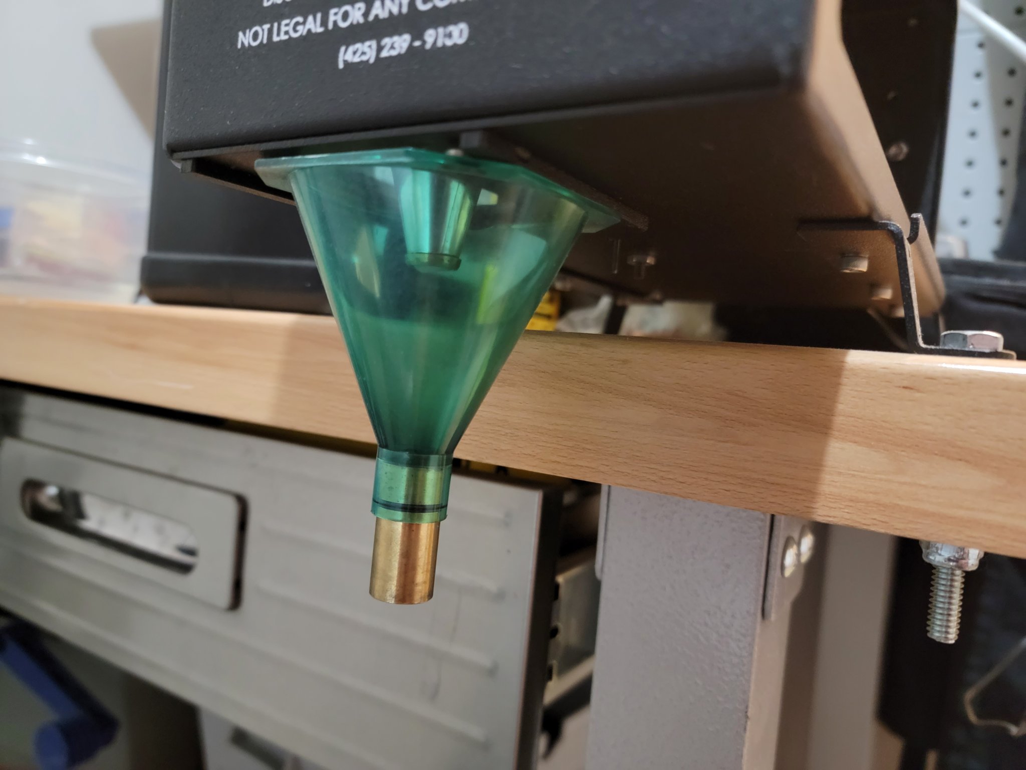

The Prometheus itself uses a short funnel to put the powder into the cases. I believe it's an RCBS, matching the powder throw supplied with it, with inserts made by Brand for different cartridge diameters. Powder drops from the weighing funnel (just a metal cone with a stopper ball to seal the hole in the bottom) into the second funnel, but the weighing funnel already extends an inch or so down into the second funnel. The weighing funnel protrudes outside of the metal housing on its own, the second funnel helps protect it from being bumped or disturbed.
In short, the funnel would have nothing to do with it because the Prometheus itself uses a funnel in the exact same fashion, and also doesn't have any additional drop height that might serve to compact powder since it drops the powder from below the top of the funnel anyways.

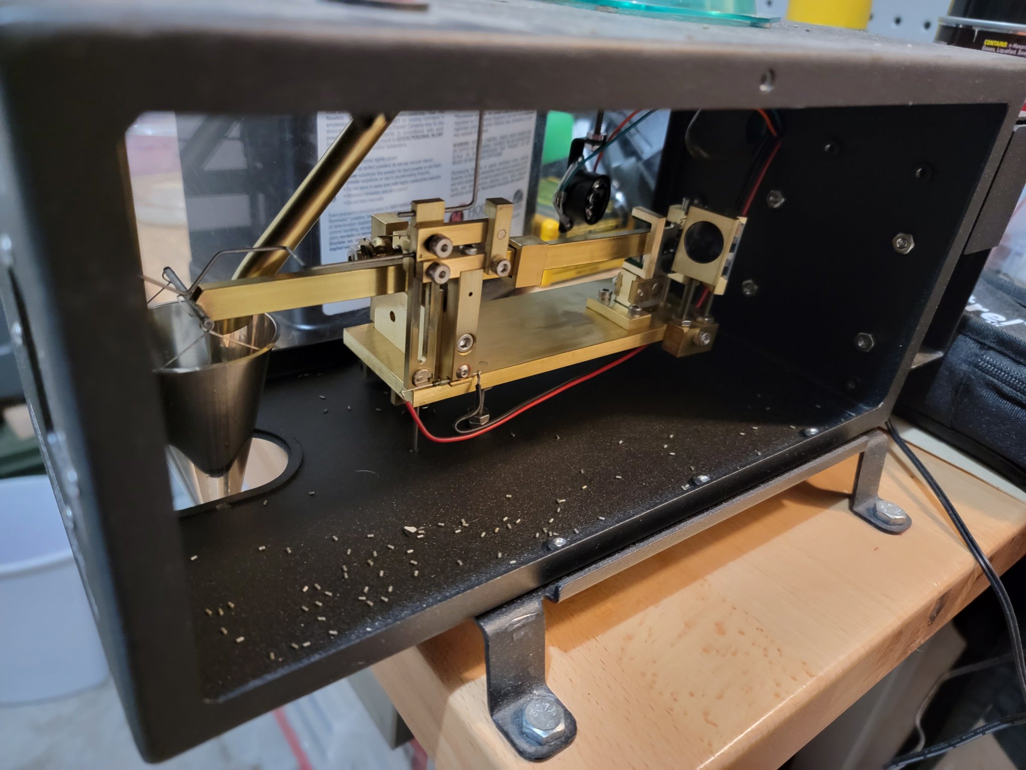

Why is there kernels of powder laying all over the place in virtually every picture of an autotrickler/FX120 setup? Do people think that only happens when it throws a charge? A clue, perhaps? ;)

As you can clearly see in the photo below, the Prometheus drops powder from below the top of the funnel negating any potential "drop tube effect" exactly like I said above.
Also, you want to talk about powder kernels scattered everywhere while pretending the Prometheus never has that? The Prometheus scatters so much powder that Brand has to specifically tell people not to use pressurized air to clean it out. You, of all people, should know this because Brand posted the info on your own damn forum website! https://forums.gunhive.com/topic/3722/cleaning-scale-and-inside-of-housing
This is how a Prometheus looks inside after loading about 200 rounds with Varget gunpowder.

Yes. It's because the cup wasn't aligned under the funnel correctly. In the off chance you do get a grain on top of the pan, just clear the pan and redrop the charge. Missed grains on the side do not affect anything, as they aren't part of the weighing.

That test was 180 cartridges, loaded over the course of about 5 hours the afternoon before. The ATV3 was powered on for the entire duration of the powder measuring portion, which took about 100 minutes for each device due to changing powder weights and discarding any charges that were XX.X2gr or XX.X8gr that occasionally happen because extruded powder kernels weigh more than 0.02gr each.
Thing is, everybody loves to pretend like balance scales are not prone to errors themselves when the reality is that they have just as many issues as electronic systems. They must be perfectly level to be accurate, and must remain very solidly affixed to be precise. The Prometheus can be leveled from front to back, but has no mechanism for leveling from side to side which can affect its accuracy if you do not go out of your way to level it that way yourself (and you have to level the scale inside the box, not the box itself). Balance scales are also quite sensitive to how clean or dirty they are, in addition to increased sensitivity to any vibrations that are often present if your press is on the same bench as your scale. The Prometheus has a balancing edge made of sapphire for increased durability, but it is still prone to damage like any other beam scale if your bench or the device is bumped while the beam is setting upon on the balance.
Ignoring all of that entirely, to pretend the Prometheus is a solely analog system is itself untrue. It uses an Arduino Uno and two IR beam sensors to determine when to slow the trickle speed, and when to stop the trickle altogether. It's an elegantly simple solution and plenty sufficient for the job it completes, but still requires careful placement of the sensors when manufactured and periodic checks to ensure correct behavior.
At the end of the day, one of these devices is certified by metrological institutions to hold 0.02gr precision and the other is a balance scale that is made (very well, I might add) in a backyard tool-shed with unverified claims of 0.05gr precision. I believe those precision claims despite the lack of certification, based on my experience, but to pretend like it's better solely because it's a physical system rather than electronic is a foolhardy and brazen claim rooted in a fundamental misunderstanding or distrust of electronics.
In either event power conditioners are a recommended practice for the fx-120i, but the truth of the matter is that even with florescent lighting in your loading room and the scale plugged into the same circuit as your refrigerator or air conditioner (nasty power-hogs that do more to "contaminate" a circuit than any other in most homes) the fluctuations in measured weight will be quite small and almost always less than +/- 0.04gr, or still tighter than the precision of the Prometheus. You can test it for yourself if you don't believe me - go ahead and plug the fx-120i into the "dirtiest" circuit in your home (if you have an outlet that shares a breaker with your AC or fridge, that's the one) and calibrate the scale when you first power it on. Then go ahead and wait until you hear the fridge/AC compressor either kick on or stop running if it was already running when you first calibrated the scale, and put the calibration weight back onto the scale. You'll see exactly how insignificant the difference is in the grand scheme of things first hand, because the scales already have decent (not great, but decent) power circuitry built-in for device protection and to help maintain precision.
Seriously, it doesn't matter if you use an ATV3, ATV4, SuperTrickler, or a Prometheus to measure charges for your ammo. They all measure ammo very precisely, more precisely than the ammo itself can be metered in the case of the fx-120i (because it measures weights less than a single kernel of most powders), and they all do it very precisely time and time again. The advantage of the Prometheus is not precision, the advantage of the Prometheus is a simplified work flow because you just hold a case under the funnel and work the powder measure with no extra steps.

So no kernels escape when people are manually throwing charges into their cases and leaving those cases hang open hundreds at a time? lol
When kernels splash on an FX120, they can land on the weighing tray, hidden from the operators view. When kernels splash in a prometheus, they land on the floor of the machine, NOT a part of the weighing.
I can easily run my prometheus completely manually, with no electricity. All the sensors and electronics do is automate it. It is 100% mechanical in its weighing capability.
Run a full case of powder on an autotrickler with small funnel. Drop that same exact charge from a prometheus and you'll have more room in the case. Prometheus mimics a drop tube... period.
People can drop kernels, yes. Same way that the Prometheus can and has dropped kernels if you don't hold the case up to the funnel correctly. As mentioned before, the Prometheus simplifies the work flow to reduce the odds of user error but user error is a variable for either system.
The weighing tray is literally right there in front of you, not hidden from view by anything. If you choose not to look, then yes it's possible to have a kernel or two on the weighing tray that will affect the weight of the charge it was measured for. The Autotrickler and Supertrickler both re-zero their scale each time you set the cup back down, however, meaning such a problem would effect a single thrown charge only and would cause it to be off by literally 1-2 kernels of powder at most (any more and it's really visually obvious they're scattered all over.

Little additional anecdotal comment. I compared the weight on my fx120i to an Sartorius lab scale (both calibrated) and they were exact to the .01 grain. I also read somebody who has periodically checked his fx120i over the course of a year and it never needed re-calibrating.
Possible dropped kernels and human error in loading case seem to the be biggest potential error.
