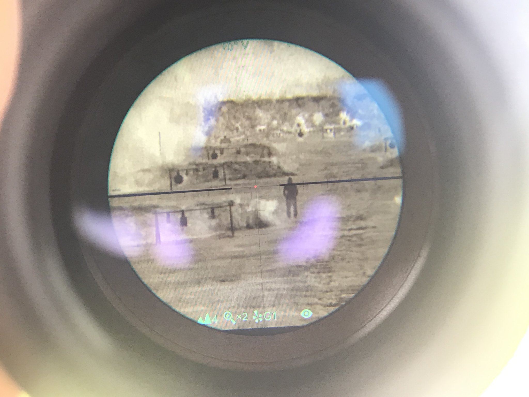

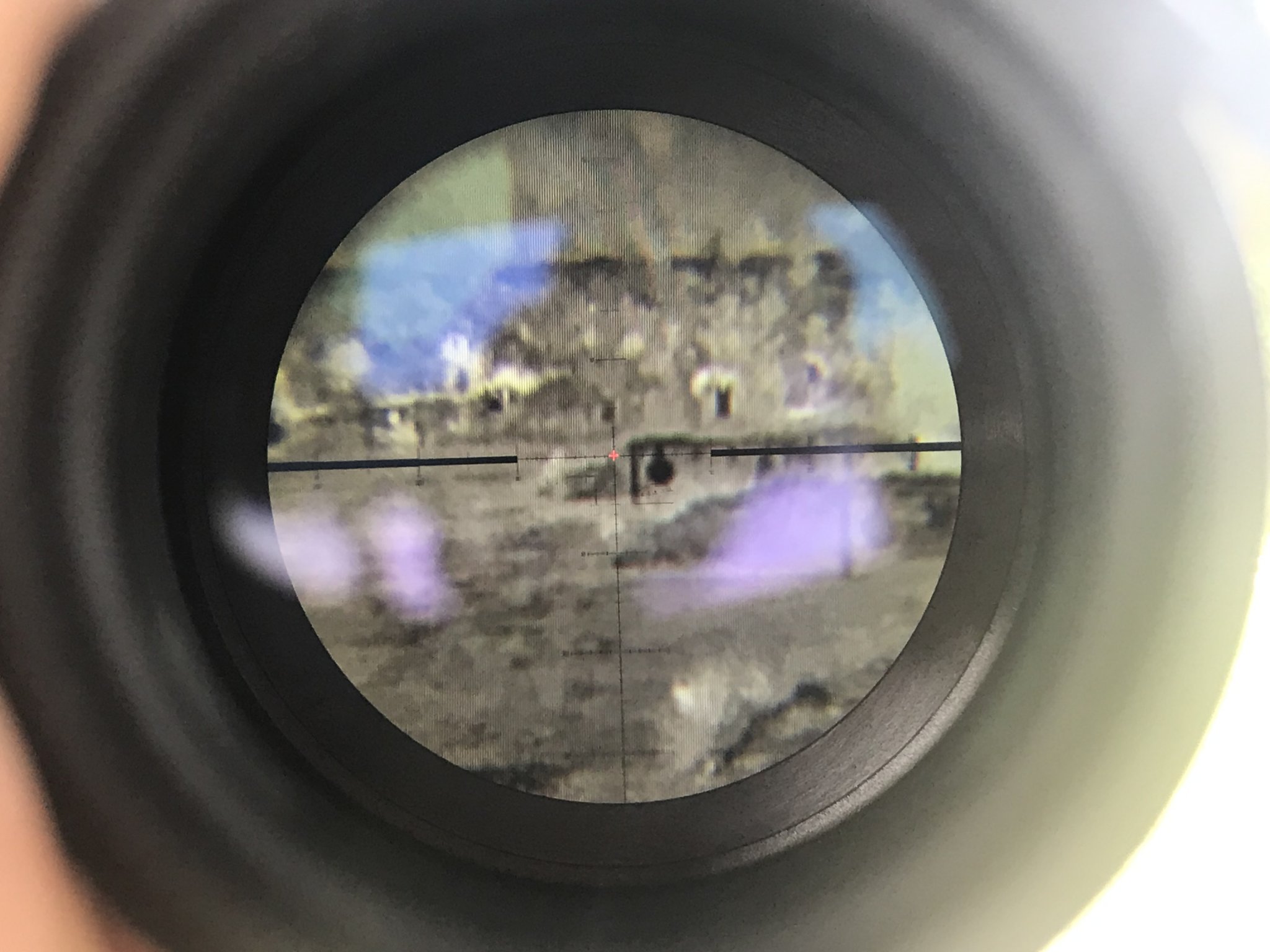

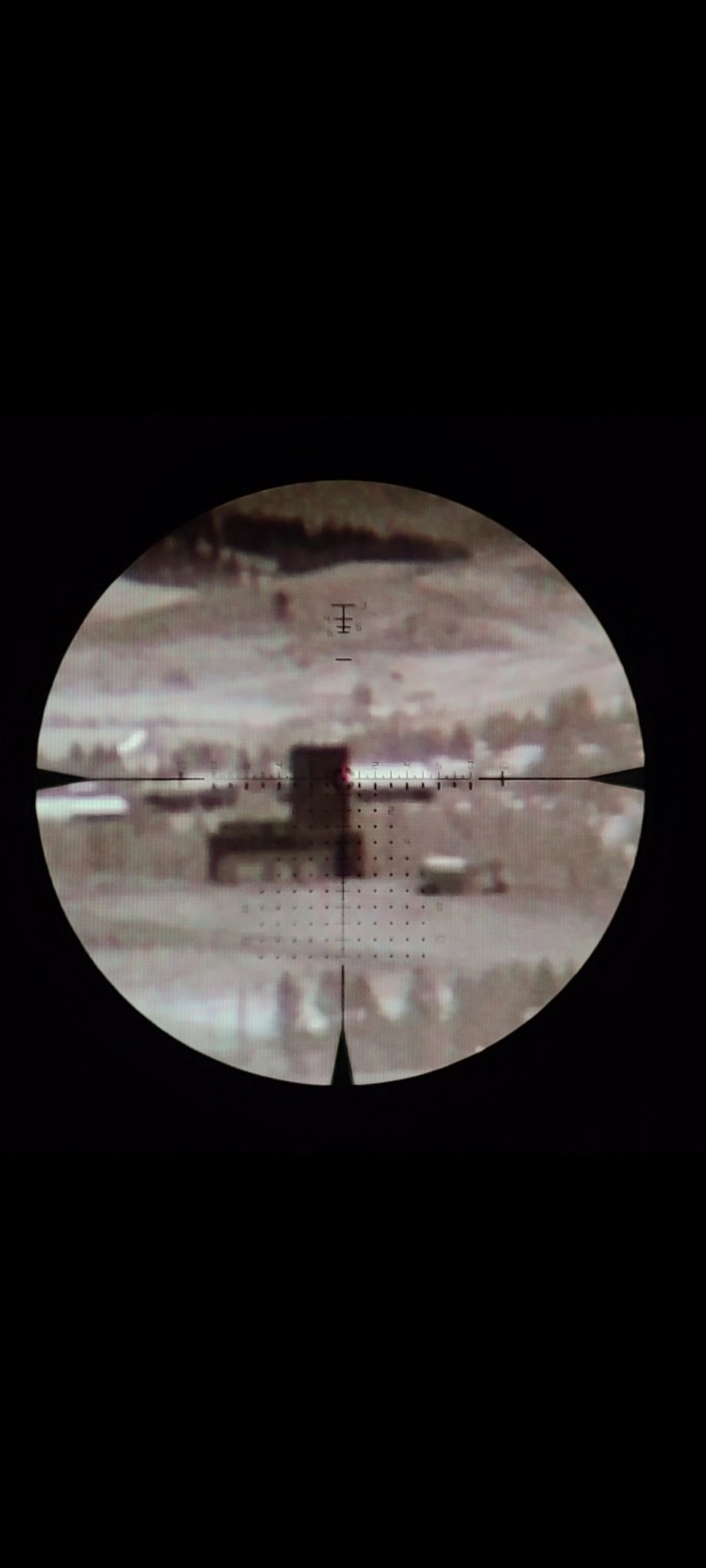

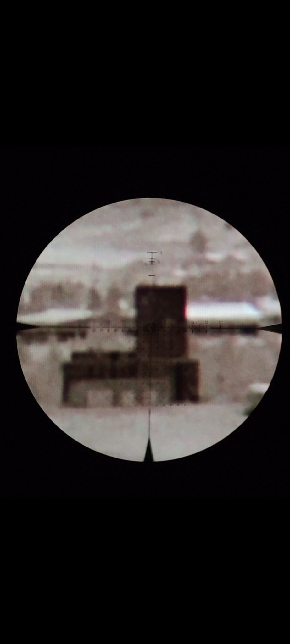

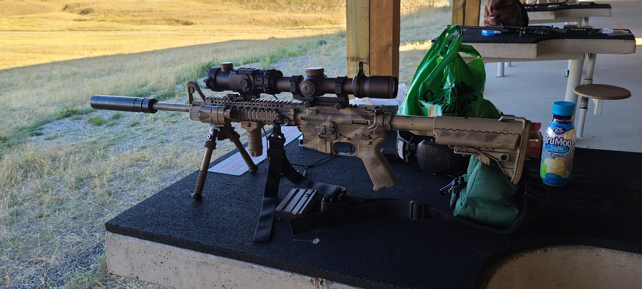

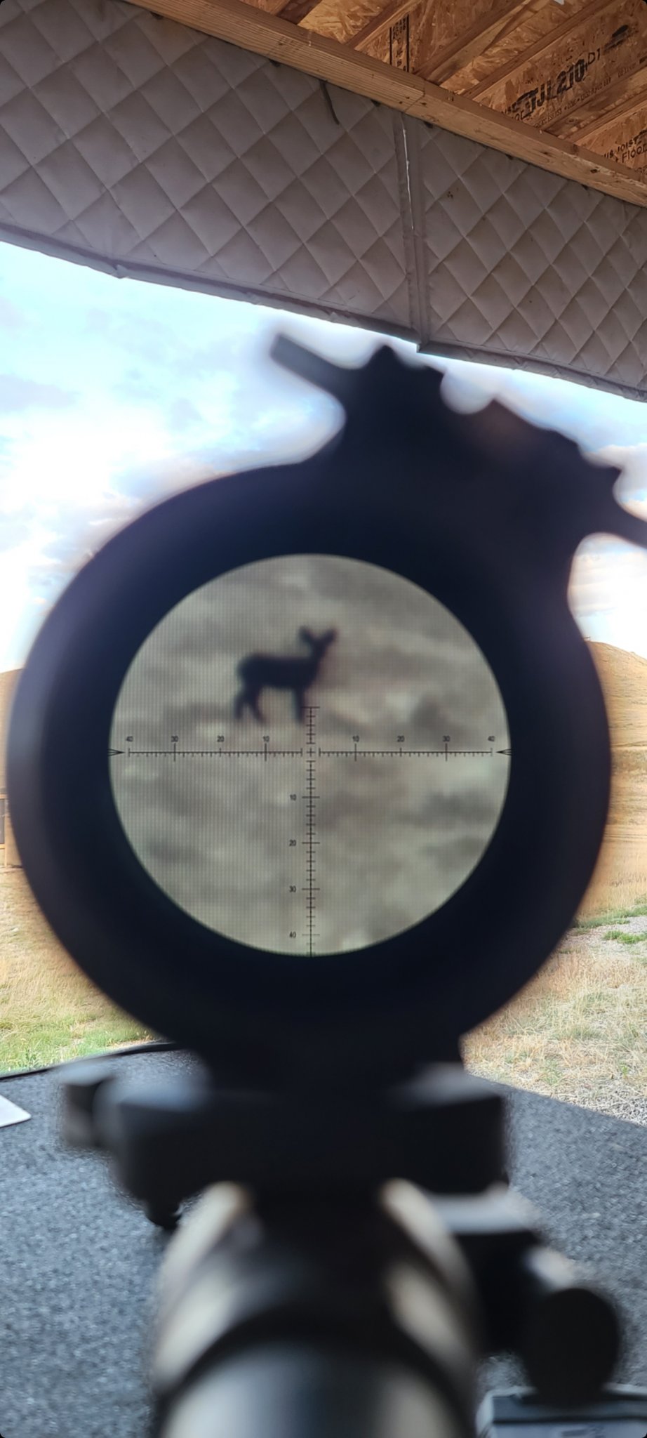

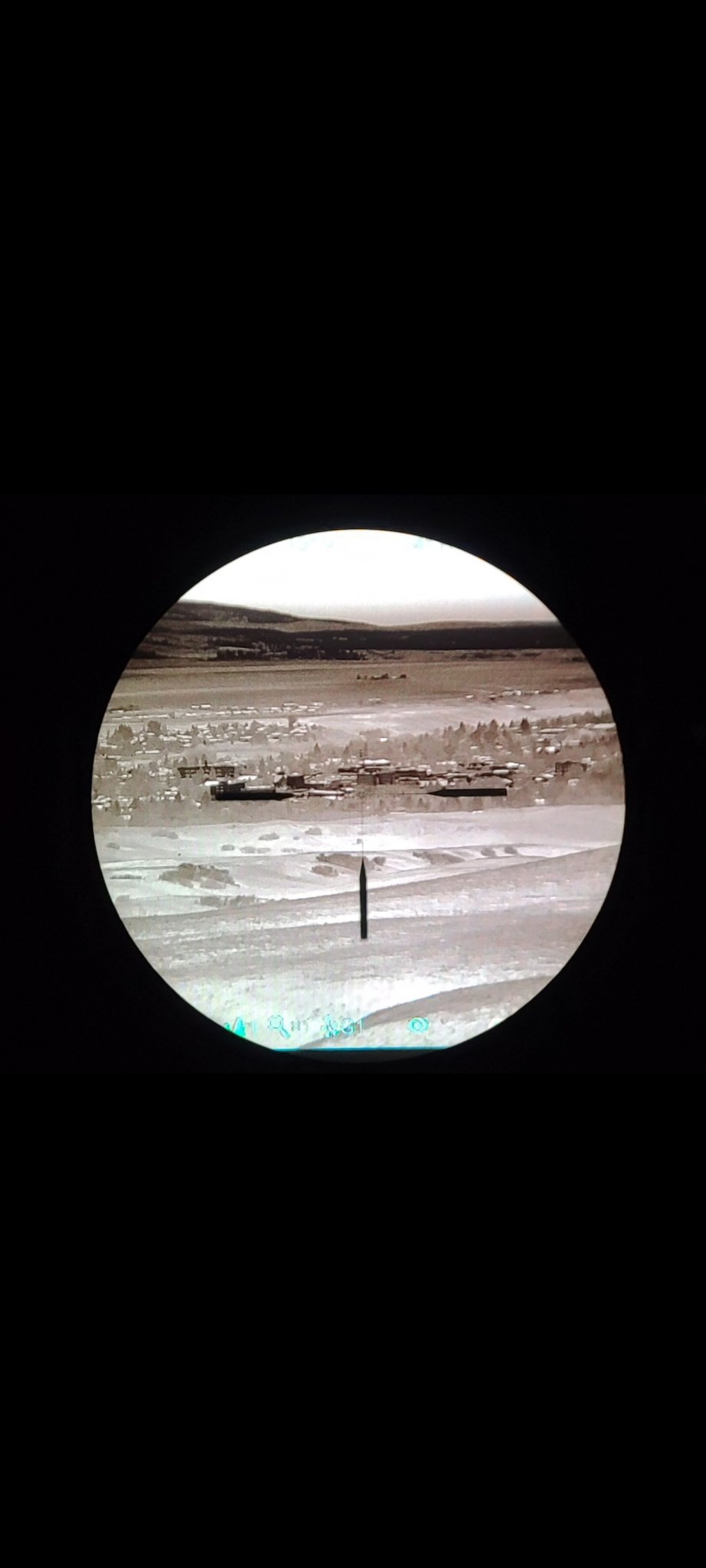

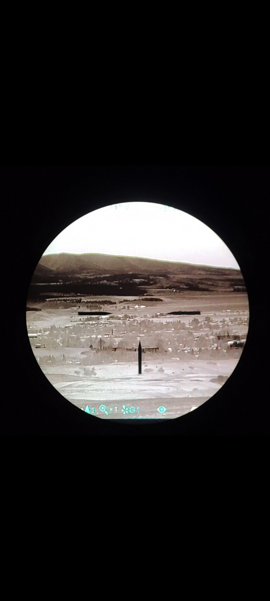

Some pics from today.

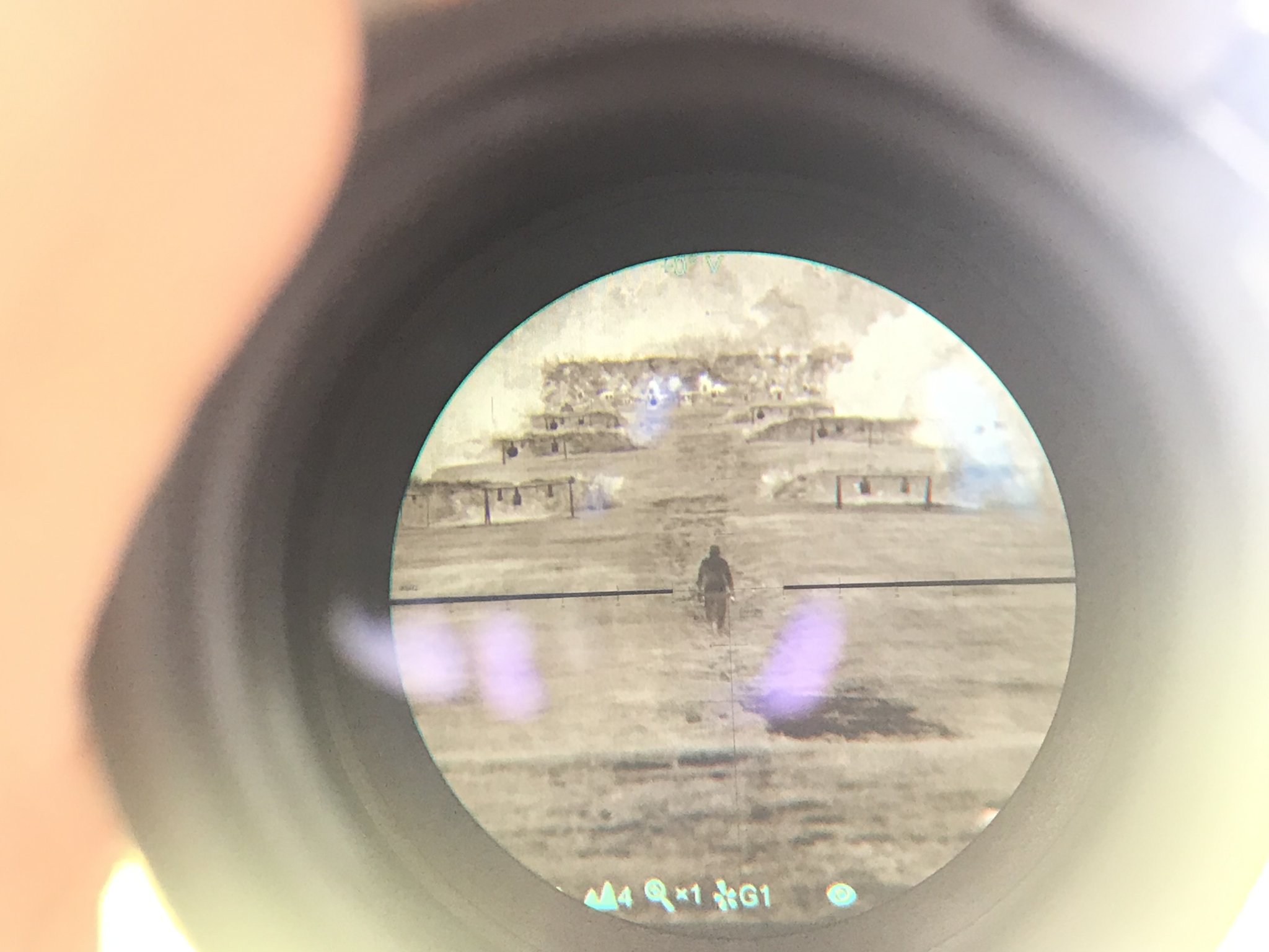

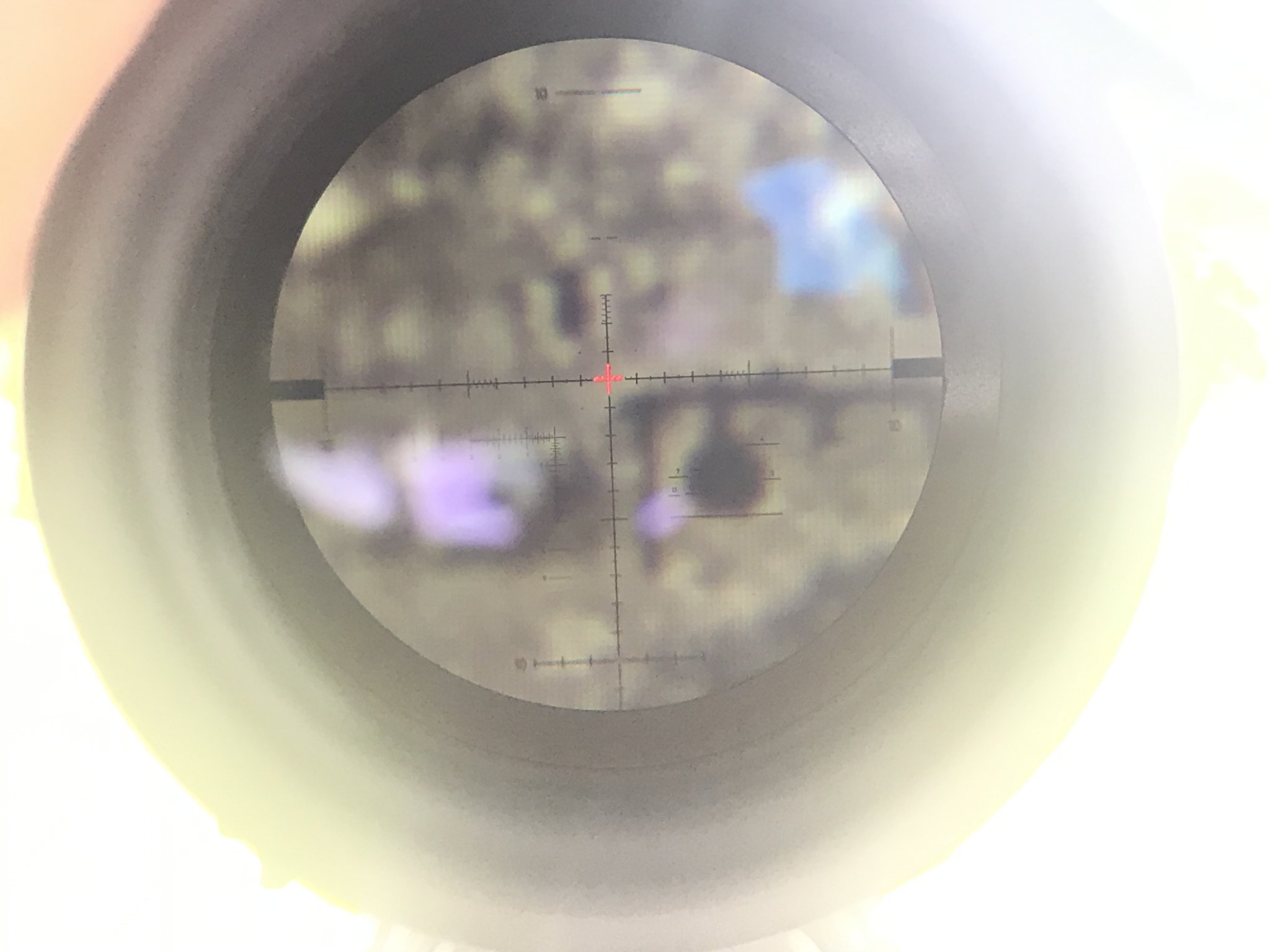

I took my Steiner M5xi 3-15 off my AR 6.5 and put it on an extra rail. These pics don’t really come close to doing it justice because in order to get the image perspective that big I had to 2x digital zoom the camera on my phone…so by default the resolution is 1/2. Regardless it gives you some idea. These are pics of my buddy walking out to 500 painting targets. I left the optical mag pretty low because it’s flipping hard to take these pics and trying to take multiple and adjust the magnification level simultaneously at multiple distances while the subject is moving is next to impossible.
3x optical at ~100
3x optical at ~150
3x optical 2x digital at 200
3x optical 4x digital at ~250
3x optical @300
4-5x optical 2x digital ~450

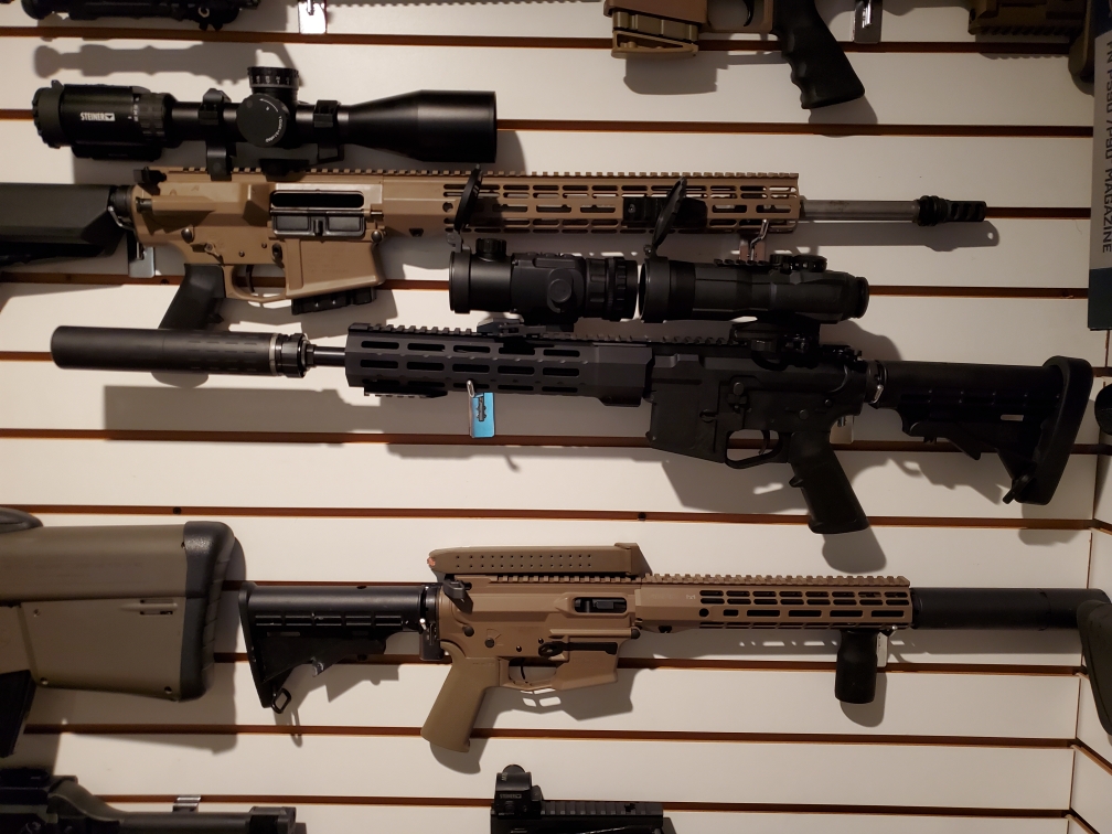

I thought that rifle looked awful familiar, started looking at the benches, and realized when I read the name. Small world.
I was just looking at the units the local store brought in, and was told to go online and look up the Bering units. Looks like John should have asked you which units he should be selling.

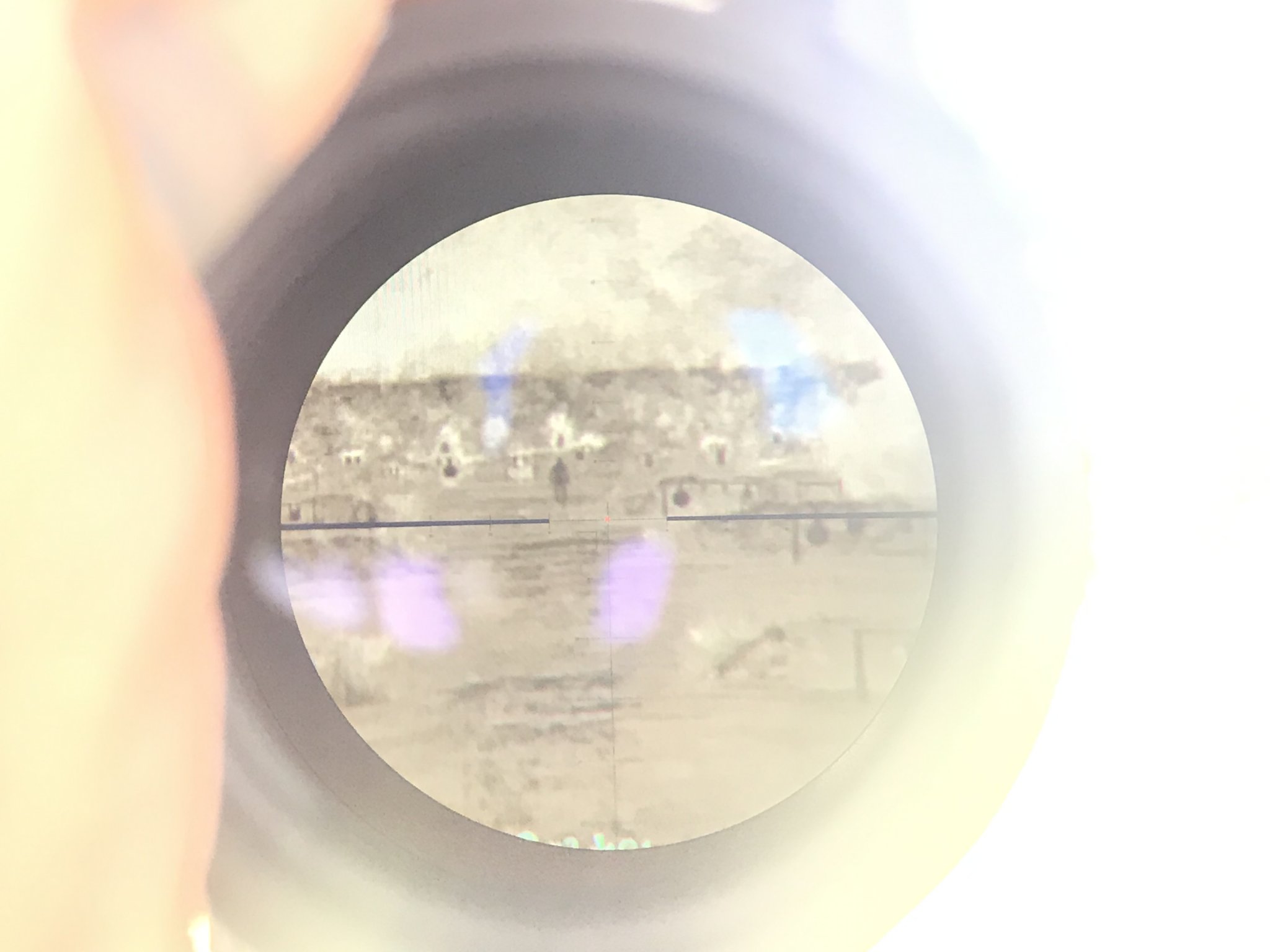

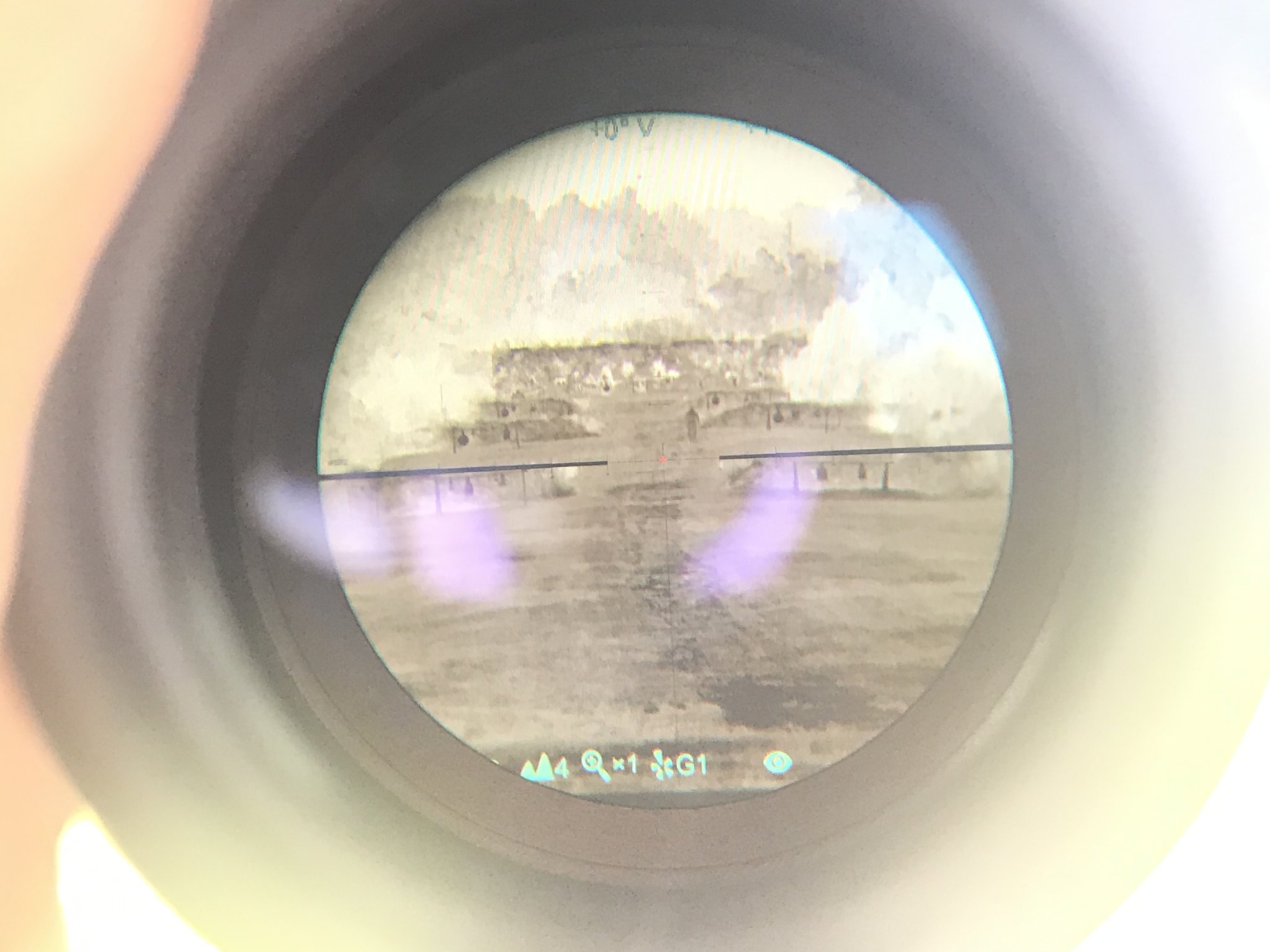

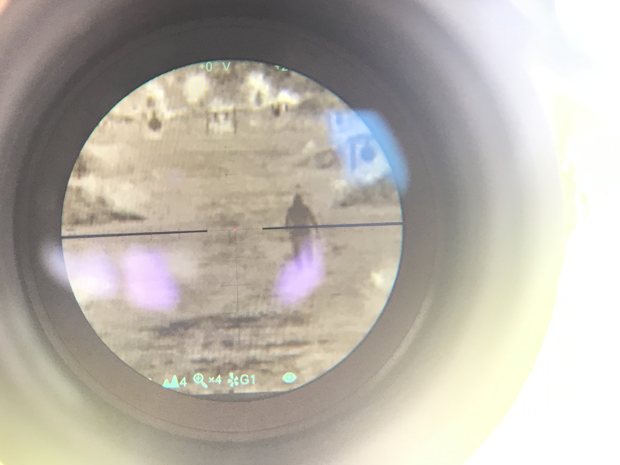

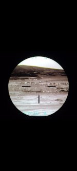

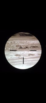

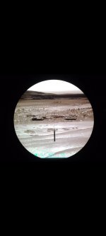

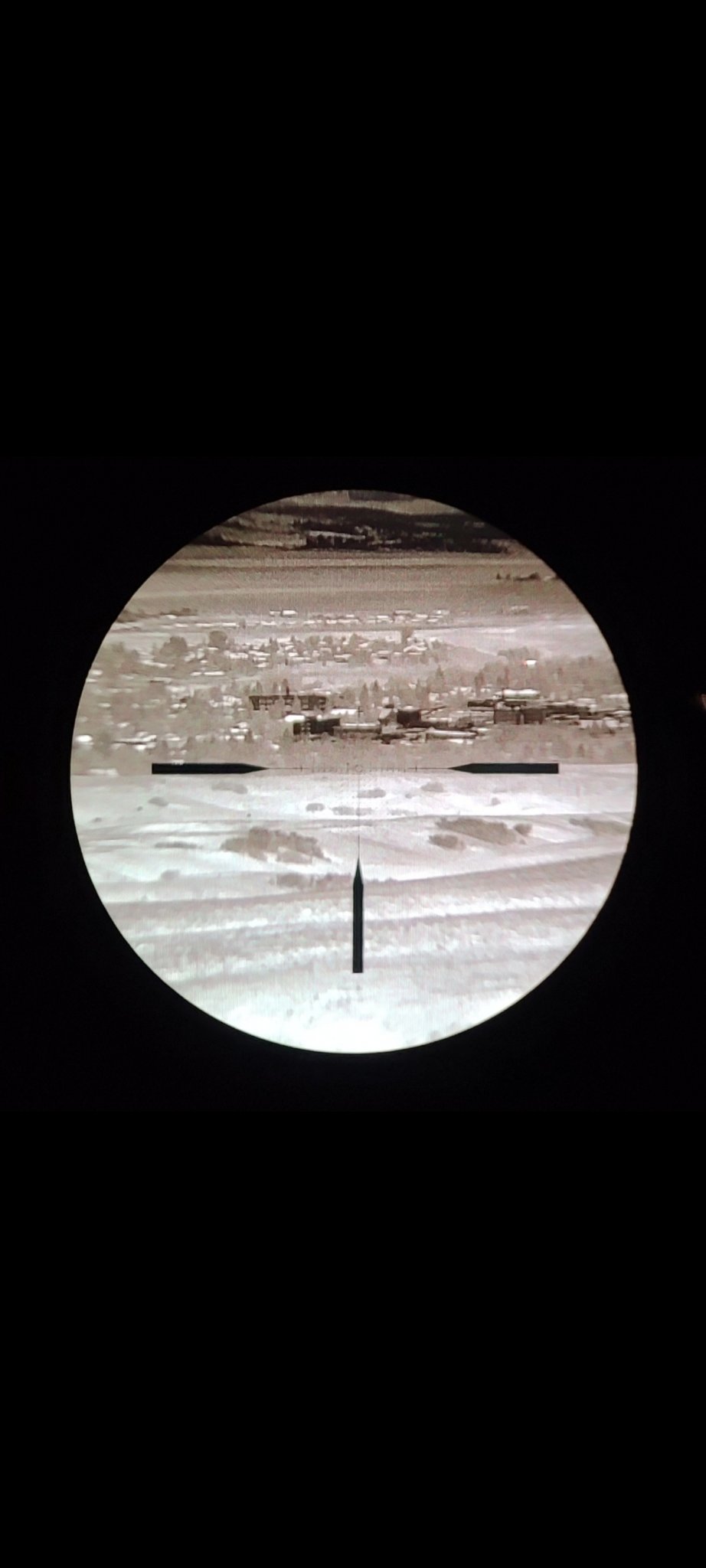

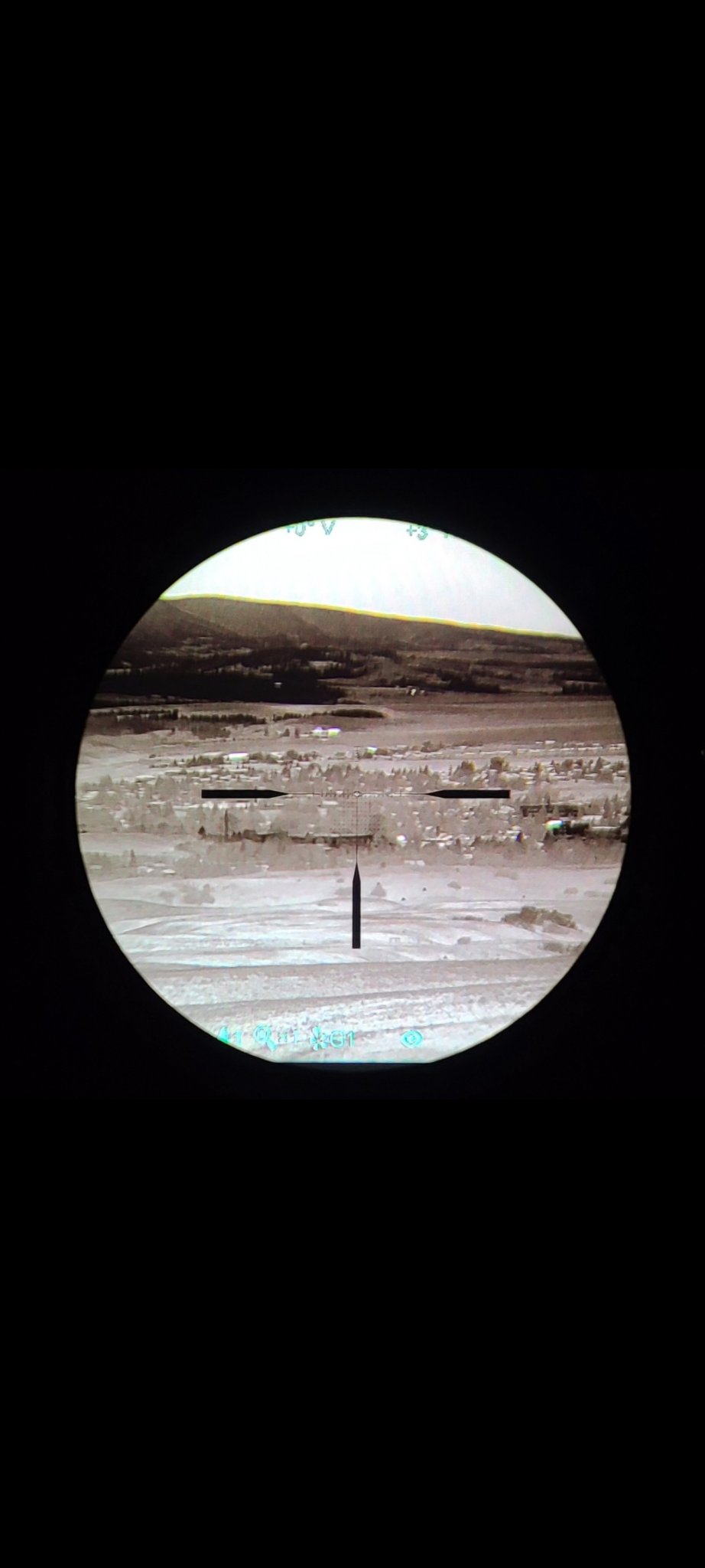

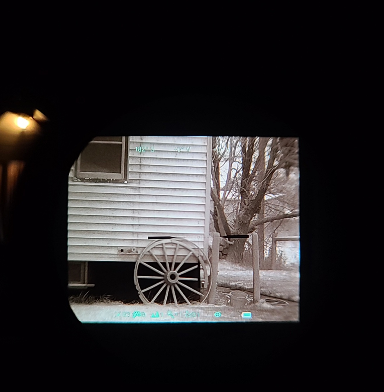

Got some ultra long distance shots last night looking out to 30 plus miles. As you can see, this scope can see WELL past what the detection range is... and can even detect cows at over a mile, houses at least 3-4 miles away. Pay attention to the mountain in the back ground and you'll notice that you can still see trees/deviations in the landscape.
Most photos were taken at 3-4 optical mag 1x digital, one at 10x optical 1x digital and another right after at 10x optical 2x digital on a building that's 1 mile away.

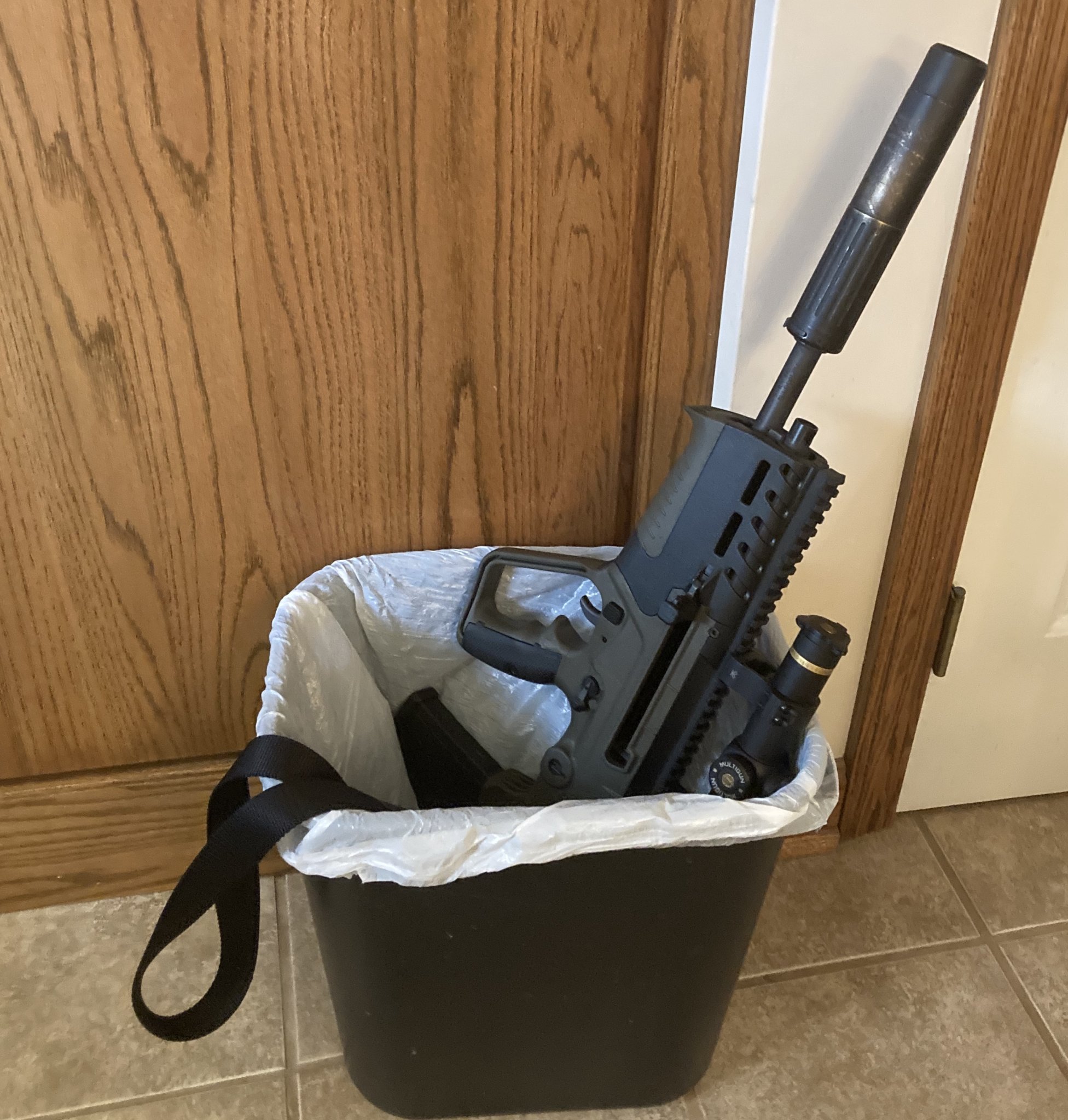

Haven't had an opportunity to use it yet, but I sold all of my dedicated thermals with this new clip on and steiner's clip on being released later this year. I completely agree it's cost effective to just have multiple of these clip ons on multiple systems rather than one LWTS-LR.
How do you like the mount? Not sure I understand why the cantilever but it might be needed in some rare situations. Any option for a more inline mount?

But then I also want the best of both worlds... as you mentioned scanning is either going to dictate an LPVO or QD removal.
In the optical world, more zoom almost invariably means less FOV... but here is what I see that’s interesting:
SY C = 8.8x7.0 degrees
SY R = 8.5x6.4 degrees
XP50 = 12.4x9.3 degrees
Is this correct? This says the 1X native clip on barely has more FOV than the SY R 3x scope which would suggest that they both are basically similar for scanning except the SY R is doing it at 3X. Even more interesting is the suggestion that the XP50 has *notably* (like 30-40%) larger scan area than even the clip on and does it at 2X.
It would seem to me the best/fastest scanner of the 3 should actually be the gen 2 XP50 equipped with a QD Mount. And max resolvable range should be between the SY C and SY R.
It doesn't work that way with the SY-C. The SY-C magnifies the image going to the sensor 3 power - just the same as the SY-R does...but then the SY-C DEMAGNIFIES the image 3x to get a 1x output on the rear. But the 1x output is at 3x the resolution of native output.
Put another way - the pixels per milliradian of the SY-C is very high - allowing an optic to magnify the image to 3x before you have exactly the same image that a SY-R has on the back end. This is very useful for making the day optic work right and provide an acceptable image.
75mm units do this even better, with more ass end demag.
This demagnification I’m assuming this is why you need the attachable eyepiece to use it as a scanner, and the native magnification if you just held the sy-c up and looked at the screen would be less than 1x (~.33x?)
ok, so the IR side of things on both the Super Yoter R and the C are about the same native ~3X (?); but the optical side of the R is an eyepiece and the optical side of the clip on just smooshes the image down so when your scope zooms in on it the screen doesn’t look like pixelated ass (?)
If I’m understanding correct...
At 3x dayscope mag, the SY C would look about like the 3x native SY R. And the SY C with 6x dayscope (or 3x dayscope + 2x digital) would look about like the SY R at 6x (3x native + 2x digital)?
So the SY R and C should both handily outdistance the XP50 because they’re starting with higher native mag. Sounds like the C is the one I want, then... easily clips to rails on my ARs and Tavors and direct mounts to bolt-gun scopes... lets me keep my eye relief and reticles and not be dismounting primary optics.

Good points. I’ll guess I’ll just have to bin this guy...
