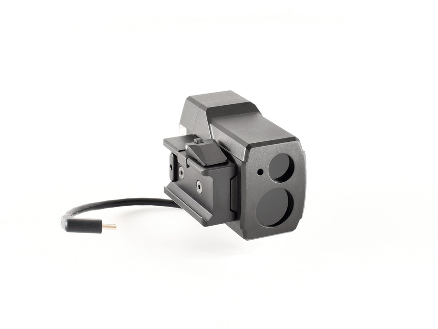

I'm hoping at some point the iray add on lrf can be made compatible. The programming is probably completely different so not sure if it's even a possibility.
That would be fantastic. Does the Yoter C have an aux port of any type? Maybe they do this in a Yoter C 2.0 or a Yoter C 60mm :)
It has a usb port for power which i think does video out but i don't plan on doing that so i haven't really looked into it.
Honestly if it's a good rangefinder just a dimable display on the back would be fine.

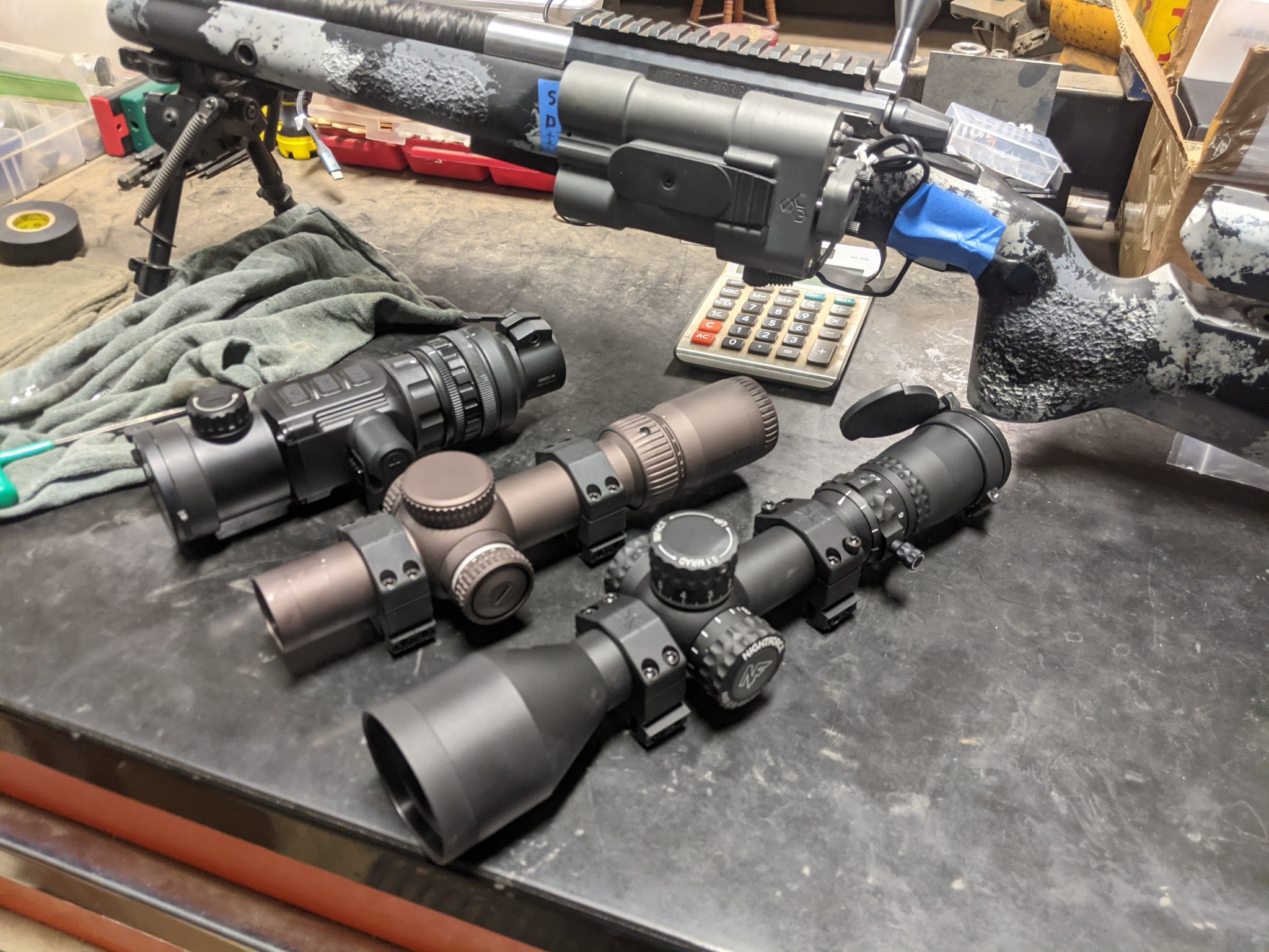

As far as thermal clipons and parallax, here are the setups I documented using in the past year ...
VO PST g2 1-6x with Breach as a clipon using MA dove tail and skeet mount. Got good alignment with the day scope, which is using VO mount, it was sold with.
This one got 1" groups at 50yds and I killed a couple of mice with it. Just testing. As an "emergency" thermal clipon, it works out to 200yds, but the image gets fuzzy above 2x on the day scope.
This VO had no parallax adjustment and the breach has no user usable focus. The breach does have a diopter.
NF 2.5-20x with Genesis A40 clipon
The NF has parallax adjustment, in general I set these to minimum value for clipons. The A40 has manual focus but no diopter, its designed as a clipon.
Tig-IR 6z+ with L&S mk4 2.5-8x
I used this setup quite a bit with good results, tight groups, hitting where I was aiming out to 350yds. The Tig has no manual focus or diopter. The mk4 has no parallax. I tested it out farther, but sweet spot seemed to be inside 350yds.
The Tig did come with 3 swappable mount plates, to enable you to configure it to optimize for various center height mounted day scopes. I was using 36mm net mount for the Tig, to most closely match 34mm mounts on my bolt guns (which are 34mm center to match 1.31 center height of UTC (33.2mm). The L&S mk4 is in Larue 1.535 mount, but had no issues.
Tig-IR 6z+ with L&S mk6 3-18x
I used this setup some when I first got the Tig. The L&S has parallax, the Tig has no manual focus or diopter.
And here's UTC-x with L&S mk6 3-18x
The UTC has manual focus and internal reticles but no diopter. The L&S has parallax.
So, as an example, the UTC with an internal reticle turned on, can be seen to exhibit a bit of parallax.
As stated, I generally turn parallax to minimum distance setting when mounting clipons. You are parallaxing to something a few inches in front of the day scope objective, so its not going to be perfect.
But judging by results, including mount/remount testing, with me standing up and walking around between each remount, and shooting multiple groups at 100yds, the effect of the parallax is not detectable. Over the past year, I've also shot steel out to 660yds and the bullets hit where I was aiming. This was with the UTC and the L&S mk6.
For clipons with diopters, it is critical to adjust the dipoter to achieve minumim POI shift and likely that diopter adjustment will be WAY different than the diopter adjustment for your mk1EB, so you have to mark it, if you want it to be repeatable.
If your clipon has a reticle, you can turn it on and compare to your day scope reticle and easily experiment with observing your parallax. There will be some. Your control for that is consistent head position behind the day scope. With consistent head position, the reticle should also remain crisp.
But bottomline, I can't talk about the Yotester situation as I've never touched one, so those who have with need to chime in to add to that data.

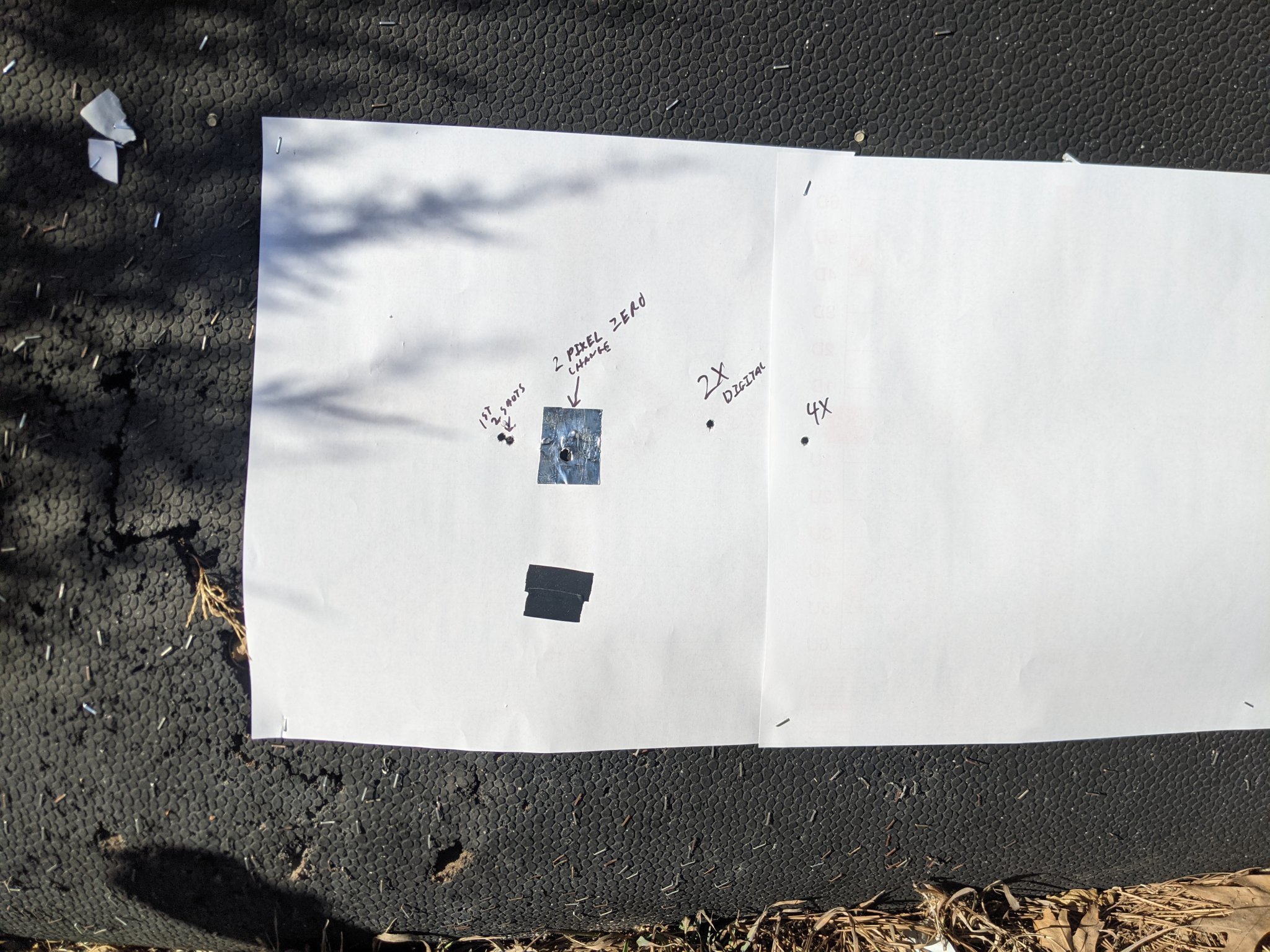

I shot the coyote last week at 402yds by dialing 1.2mils on the scope. I shot the one at 320 by holding .7mils. Those were with the day scope set on about 12x. As long as you do not use the digital zoom function of the Yoter-C, the dials and holds remain accurate.
If you digitally zoom a clip-on to 2x you need to double your dope. Multiply it by 4 for 4 times zoom. My zero changes by 4" and 8" when I digitally zoom the scope, so I don't use it that way.
Thanks for the clarification, exactly the information I was looking for.
Reactions: Ksracer
You can also change this. You can adjust your POI for the different digital zoom levels so that it remains the same regardless of what digital zoom level it’s one.
Are you referring to using the zoom calibration function in the menu or setting different zero coordinates for each for each zoom level?
It’s the same thing. You calibrate your image/POI at 1x, then do it again at 2x, and then again at 4x. If you don’t, you’ll get a POI shift when you use digital zoom.

Totally concur. It sounded to me though that he said his POI shifted 4” and 8” when he goes to 2x and 4x. If the image is calibrated at those digital magnifications, then the POI for where the crosshairs or center dot are shouldn’t change. Only your hold over value or what you dial. Which makes sense though. At 2x the image is twice as big so double your hold. At 4x etc.
However, if the image isn’t/hasn’t been calibrated at digital magnification levels then you’ll get a POI change at the crosshairs when you change digital magnification levels.

No, were talking about 2 separate things.
Holds and dials should double with 2x, but your zero should remain centered.
The first few minutes of this video on Bering's website illustrate the zoom calibration on the Yoter-C. Maybe I'm missing something, but it doesn't say anything about making separate adjustments for 2 or 4x. Only to center the two reticles over each other.
This is what my reticle does after I follow the instructors in the video.
And if I shoot 1 shot each on 1x, 2x, and 4x.
Did you have a unified zero before you made that adjustment? It looks like your optical zero is left of the thermal target. If you shifted the digital image to your zero that’s going to carry over and be twice the shift at each digital zoom level. Your optical zero and thermal zero at 1x need to be the same. I.e. make your optical zero the center of your thermal target and then calibrate the image to your crosshairs.
I’m out of town and don’t have mine in front of me…it’s been a bit since I made those adjustments but I thought you could also adjust it at 2x and 4x. I could definitely be mistaken because I did it several months ago. However having a unified zero prior to is critical. Maybe @jstokes1 can chime in if he has his available.
Yes, the day scope is zero'd to the rifle. I'm 99% certain that when you move the white reticle to the center of your day reticle on 1x it makes the change on 2x and 4x at the same time.
I know that when you are in 2x or 4x and enter the zero menu, it's kicks you back to 1x for your adjustments.
Let's assume that my the zero on my day scope was off for a minute. The scopes were locked into a test sled that doesn't move for the video I made titled "Centered Zoom Calibration." Ignoring what the bullets might do because they are irrelevant at this point, my day scope reticle should not shift places on the target while zooming if that calibration worked correctly. Check out this next video. If I move that white cursor 2mils right and .4mils high, now my reticle stays centered while I zoom, like it's supposed to.
Also, please don't think I'm trying to argue. I've put some time into this and I can't figure it out and neither can Bering. I realize that it will work if I leave that white reticle offset, but it's a PIA and that's not the way it's supposed to be.
If you've got a solution, I'm all ears.
