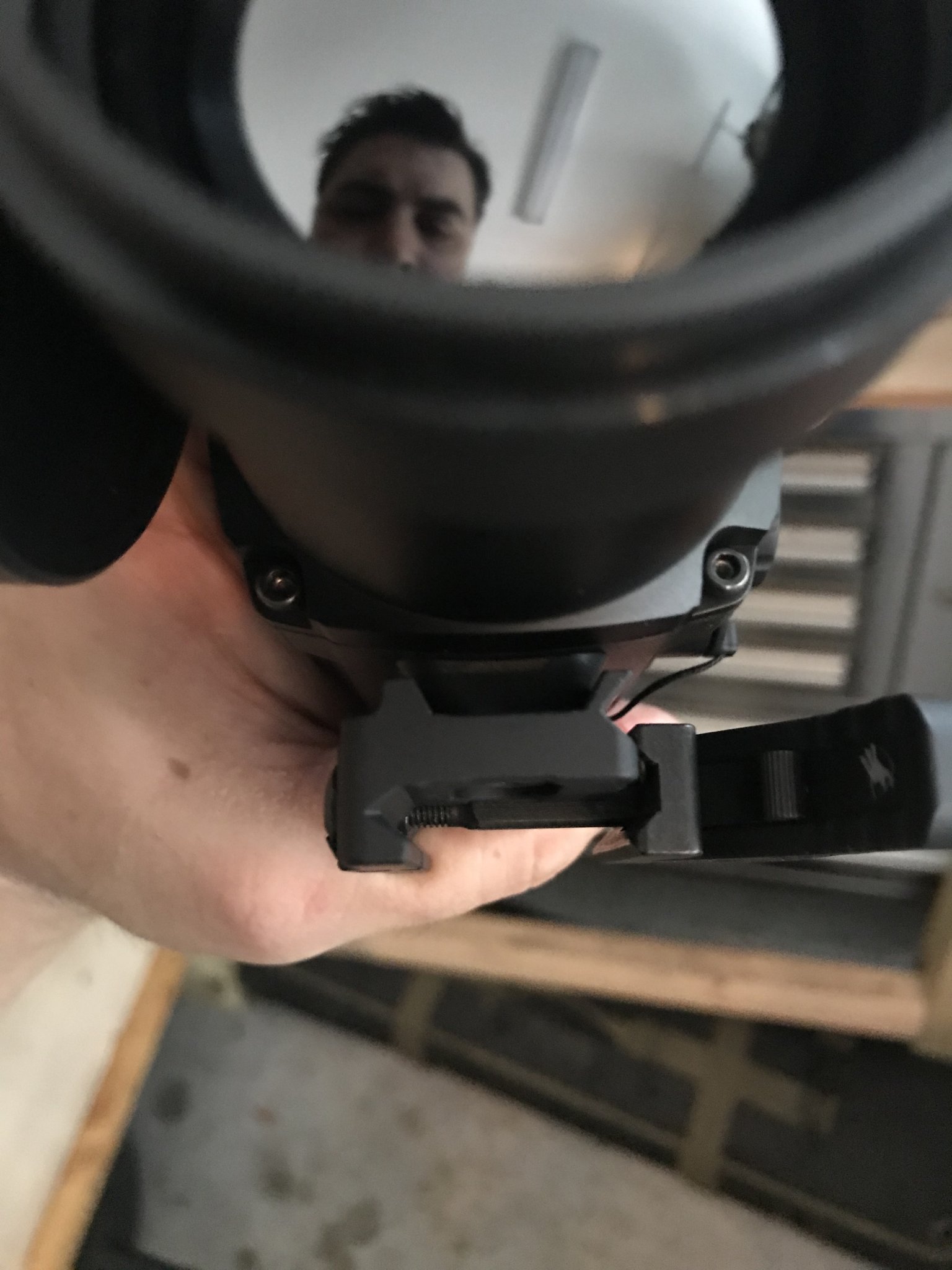

Does the C come with a LaRue mount like the R and can you tell if it's removable? I plan to swap between rifles and won't be shooting 1000yds but was hoping for a decent rtz. I believe the mounts on the Bering wmt scopes are epoxied as well as bolted. Was hoping to get mine by this weekend but no shipping notification yet....

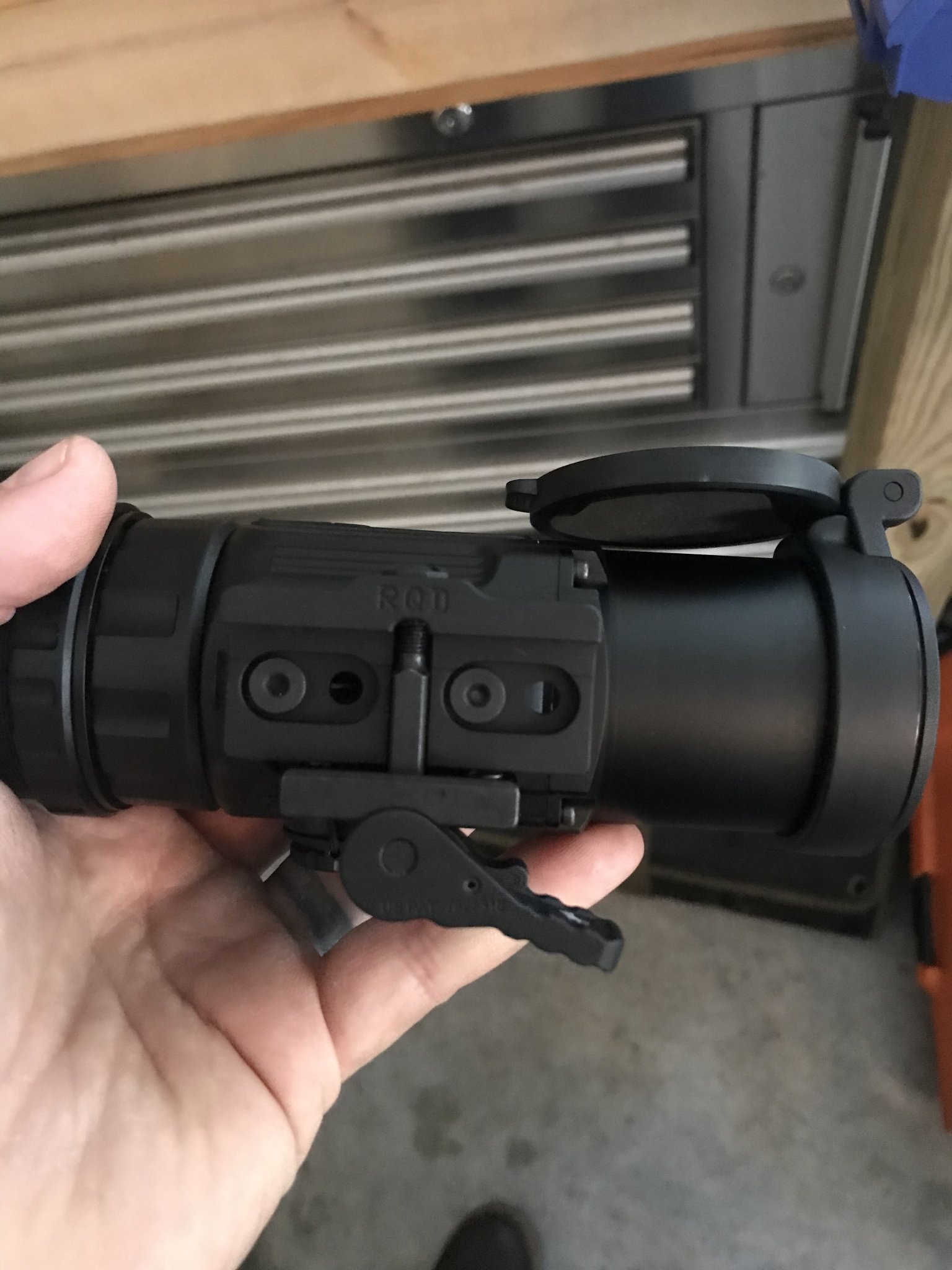

The C comes with Bering’s mount. @jstokes1 has been using it with good repeatability. It’s not fancy but it works. It can be replaced with the ADM-Ricco mount. That’s what I did. It conforms to the base. Very solid and repeatable.

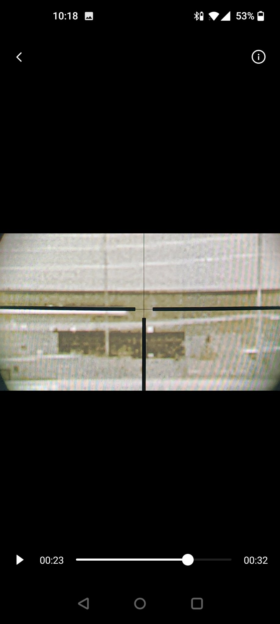

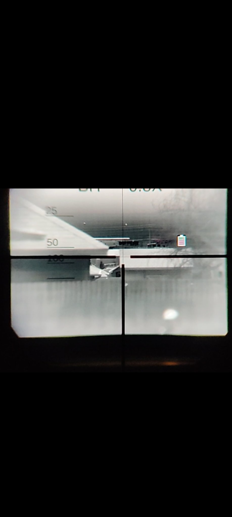

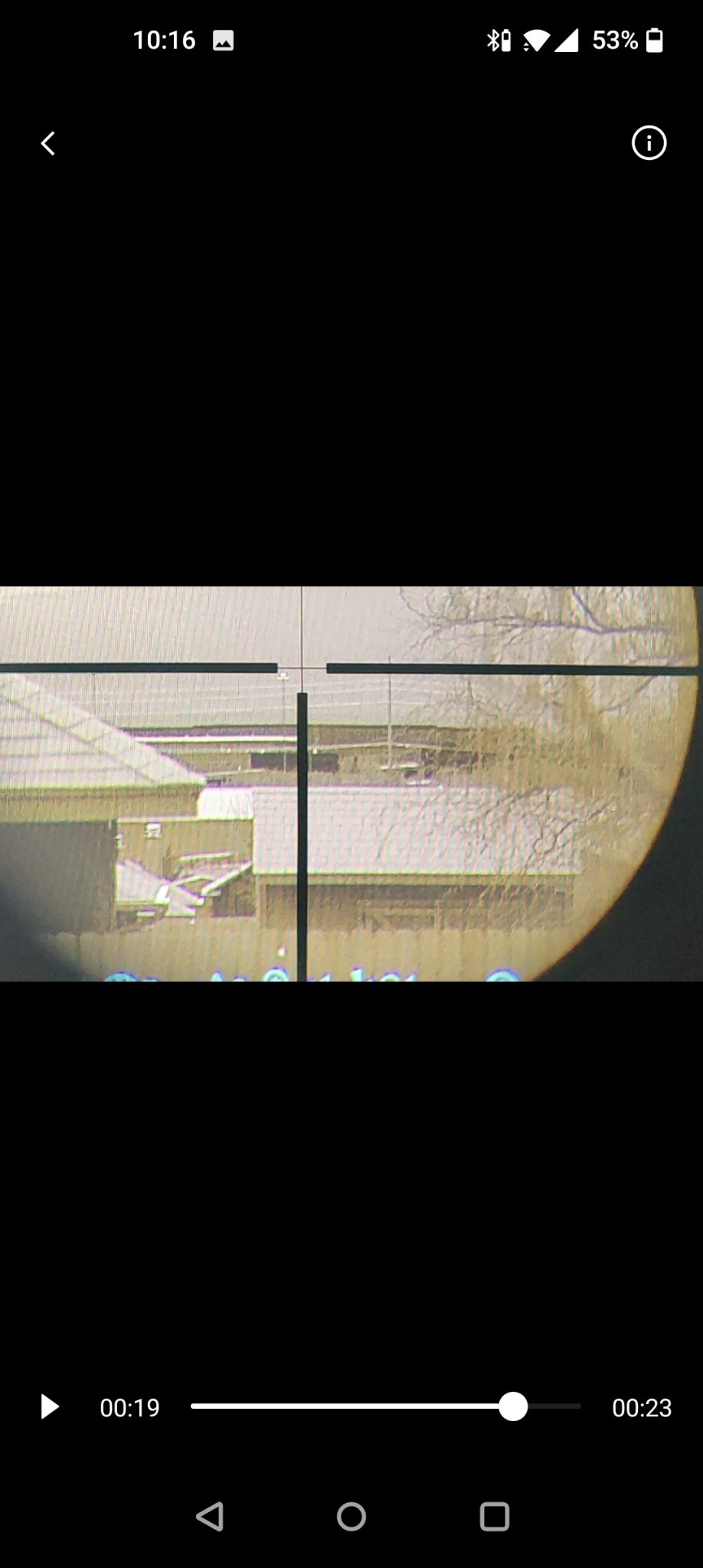

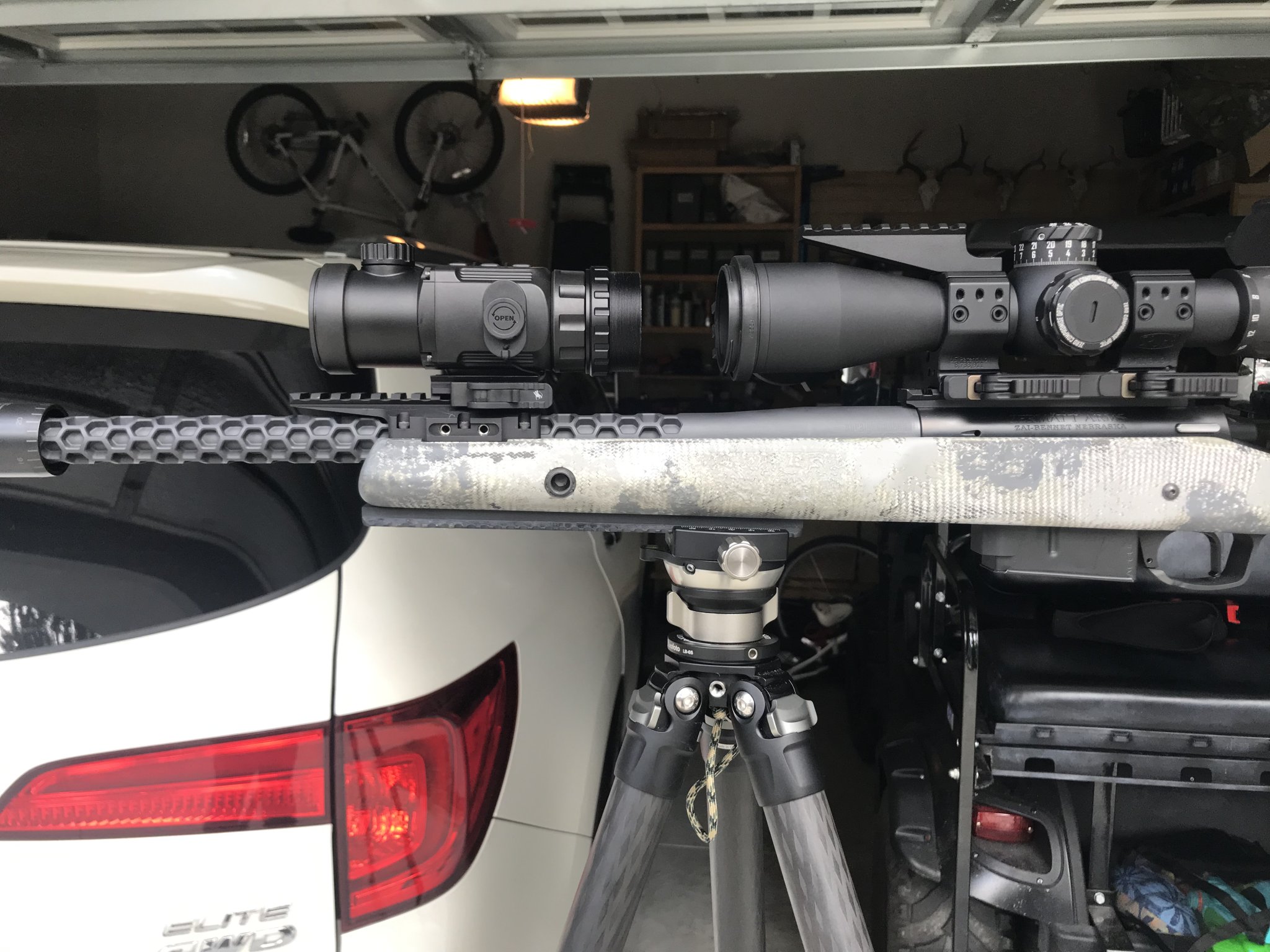

I use mine in front of a 1-10 Razor and a 4-20 ZCO. Read through the posts on here. There’s a bunch of pictures at different magnifications etc. You can see the entirety of the screen at 2-2.5x. Best image for PID on 1x mag (for the Yoter) is up to 6x optical, but works very well up to 10x. At 2x digital mag on the Yoter, you can go up to 15-18x to assist with shot placement. Look at the pics. They convey what you can expect.
Yea, i am sure a 4x bottom end is going to be fine from the pics i have seen. Just wondering about how much of the screen you lose with only 4x on the bottom end. It is kinda hard to tell from the pics. Sounds like a 1 or 2x on yhe bottom end is ideal.
PA GLx 4-16x here. No border info visible, but all the centered menu buttons you need, are, as are the Advanced menu buttons. IIRC in advanced, you loose 1 item at the top (ClearView?), but it's not a daily use one. Totally usable with a base of 4...once I actually commit everything to memory, it's probably even easier.

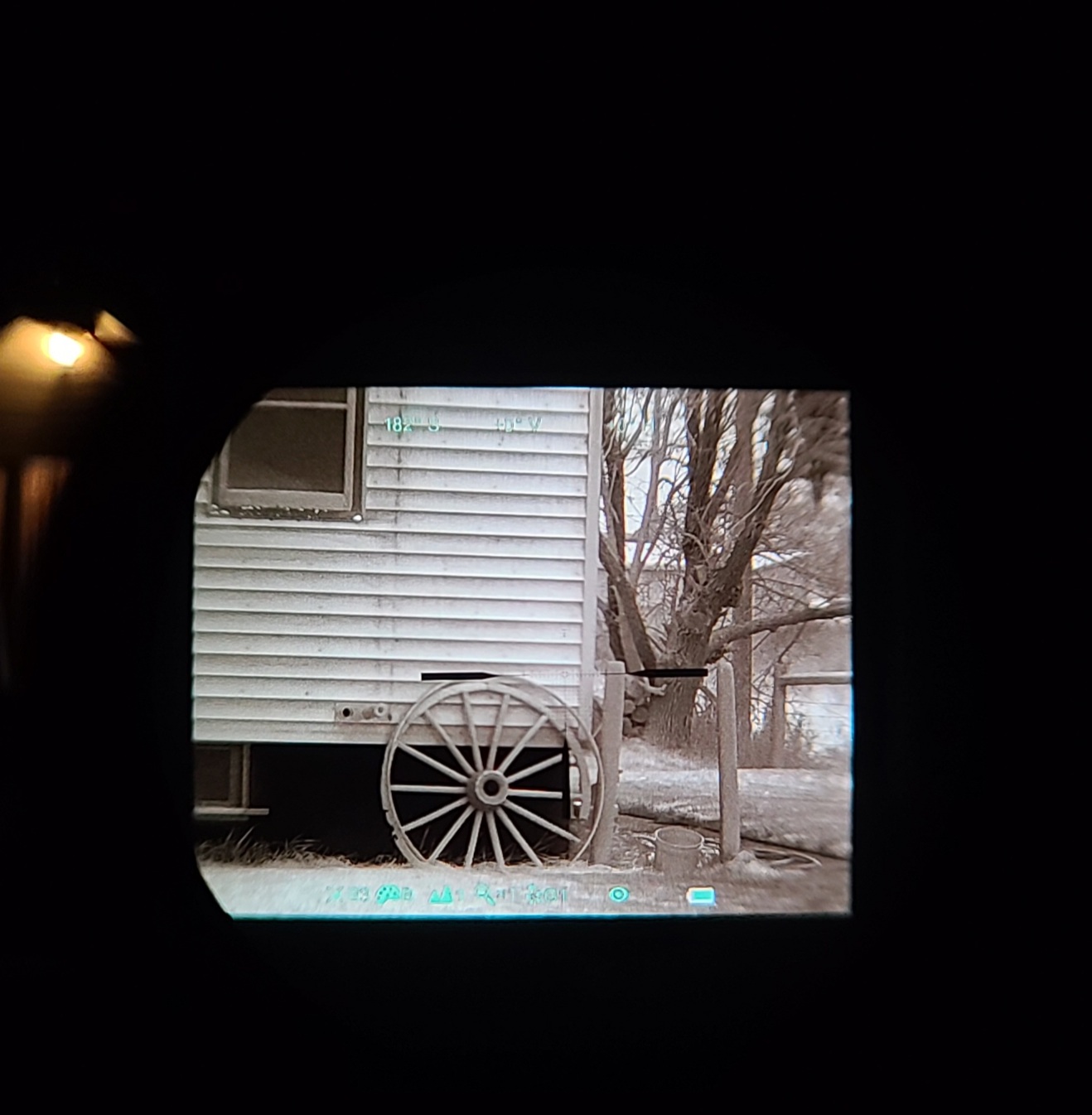

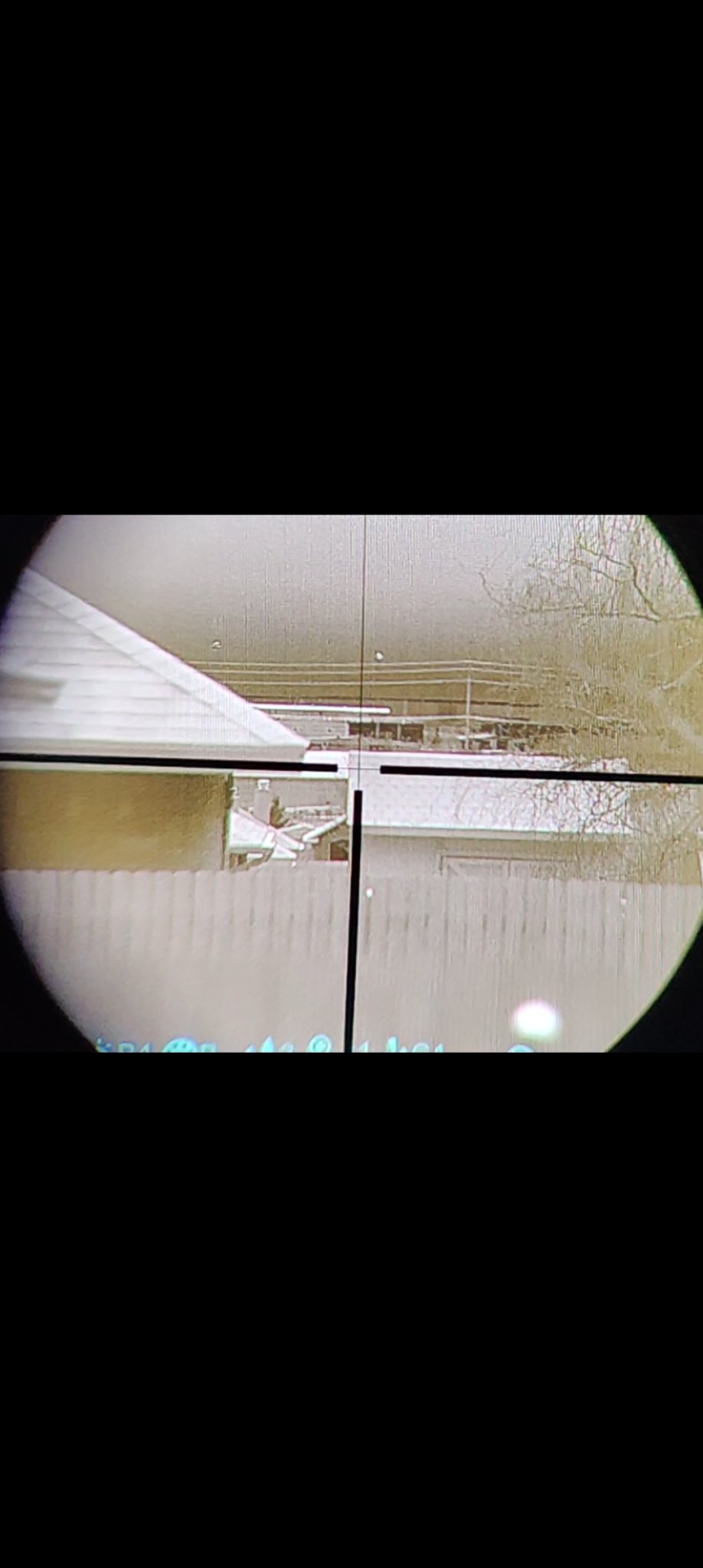

Here are a couple of cell phone pics off of my back porch last night through a Tig Ir and the Yoter C. Both pictures are taken handheld through a Zeiss diavari 2.5-10x50 with each respective clip-on. For reference, the power lines are 1400 yards and the far building is 2,450yards.
Like others have said the adm rico mount. The 1.7 vrs 1.5 doesn't seem to matter. I would recommend if you plan on getting the adm to get it up front before you do all your zeros or you'll be doing all that over again.
With adm mount and 1.57 scope mount.

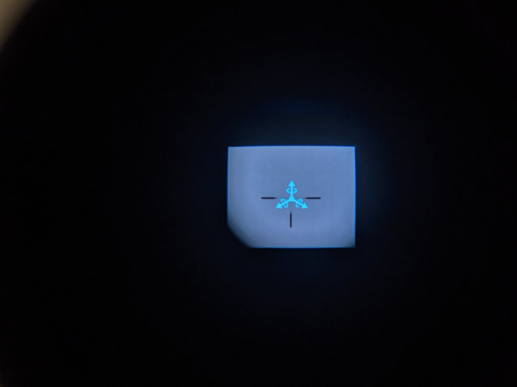

Can anybody tell me what this is? A Mongolian throwing star? Maybe a relic leftover from the Star Ship Enterprise?
I'm trying to calibrate the compass, but I can't figure out which way to hold or rotate the scope... Lol
Does anybody know for sure?
There was a manual (in English) in post 172 if you didn't see it. Not sure if that's helpful or not
The scope I'm using actually came with a manual. It tells you to rotate the scope along 3 axes 360* each. I'm confused if those axes are in the horizontal or vertical plane. The compass is giving me some weird readings, so I just want to make sure I'm calibrating it right.
