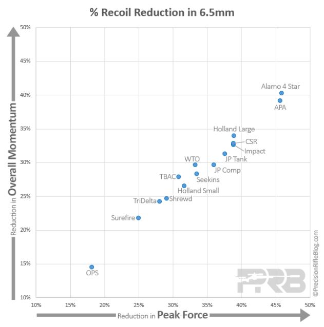

Back on topic. Suppressors absolutely affect the recoil!
Everyone will tell you “it only reduces the felt recoil”
I shake my head at that, because, umm what other way you perceive recoil other than what you feel!?
Suppressors also reduce muzzle blast and muzzle rise.
I’d say this is imho or my 2c, but it’s been proven, there are dozens and dozens of articles proving the benefits a suppressor has on recoil.
Anyone who says they don’t really reduce recoil doesn’t understand the mechanics and geometry of recoil
Here's a little test you can do to understand the difference in recoil between a brake and a suppressor
Grab a .50BMG with a big tank style brake on it, like the AR-50 and some of the Barretts have. Get nice and prone and send 5 or 6 rounds downrange.
Take off the break and put a suppressor on, or grab a similar weight bolt gun with a standard suppressor on it. Get nice and prone and sent 5 or 6 rounds downrange.
(There is a reason Barrett designed the suppressor for their M107A1 to have a brake on the end of it and suggests you use it).
A well designed, aggressive brake that is specifically tuned for maximum recoil mitigation, will reduce recoil better than a suppressor.
However for most smaller, commonly shot calibers, the overall benefits of the suppressor tend to make it preferable to a brake.
Many people also add a bit of weight to the overall rifle which lessens recoil with a suppressor.

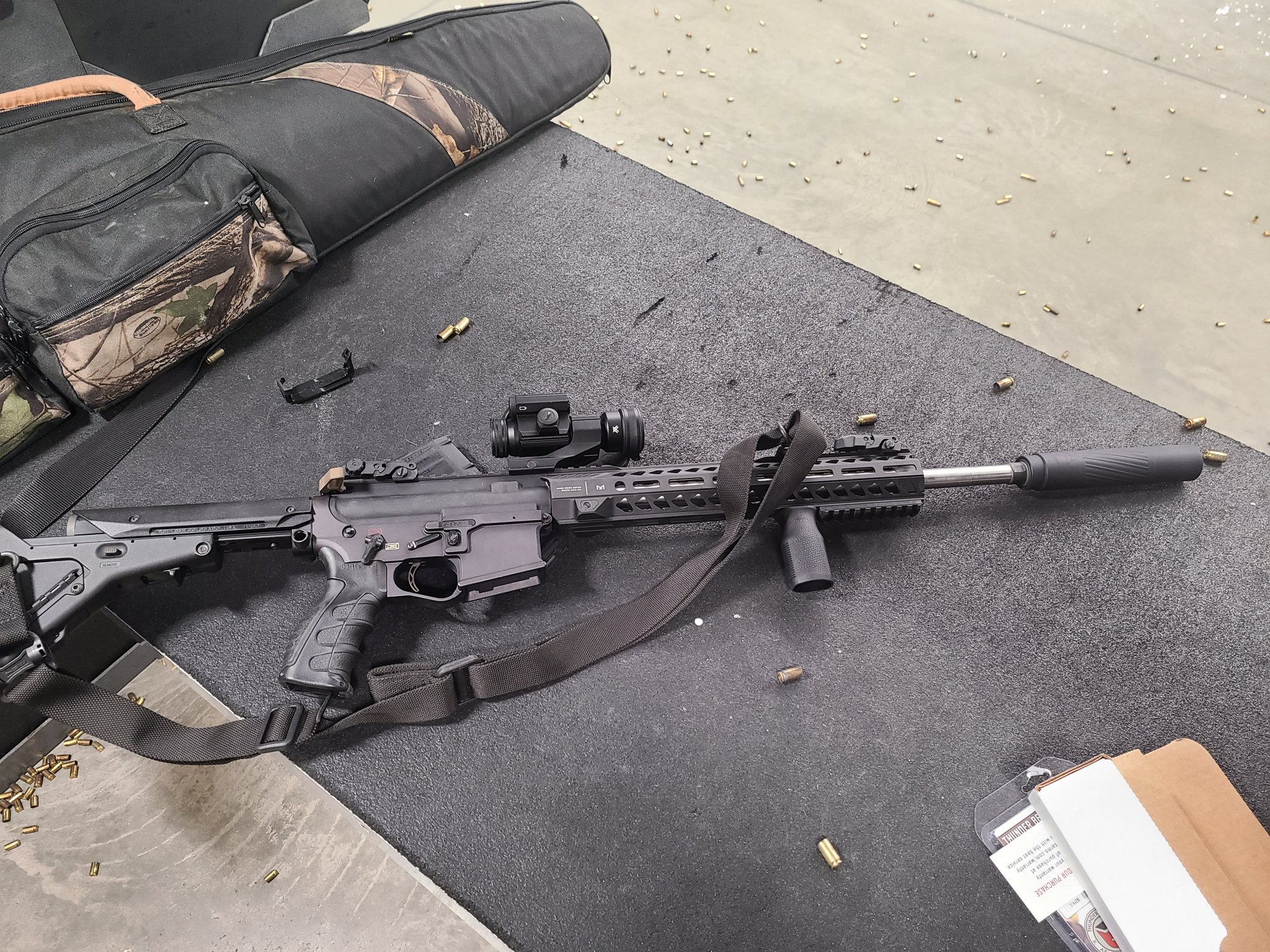

Since your all now invested: I see lots of people saying they want the shortest can when hunting. I get that longer barrels catch stuff and can be a pain, but when I am busting brush its held weird for me anyway so I don't drop it or get stuff in the barrel. So isn't weight the factor I should really worry about, or is there something else that I am missing? Is the ultra 7 the great can for hunting but an ultra 9 to big? I thought I might get the best overall with a 9 and would just have to suck up the weight. So is it overall length, or weight or something else? Or just go get a nomad and not care :). Guess I got a bit more research and comparison to make. Thank you all for the help.
Dead Air Nomad-LT
