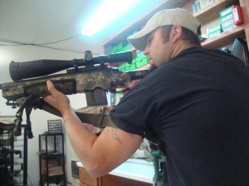

Well, here it is for the folks who have everything except but the knowledge of how a sling works.

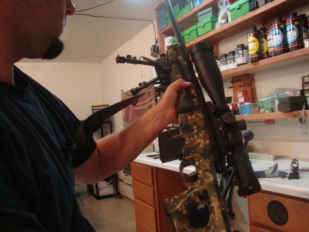

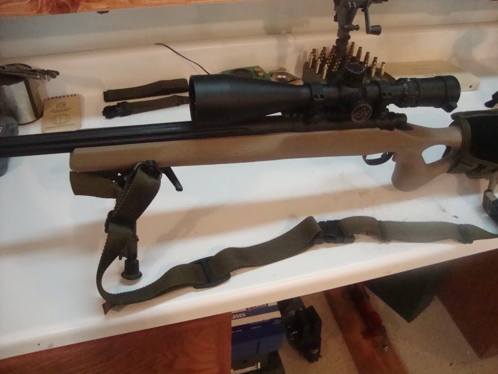

First, you put the sling on your rifle, like so.
The slider must be able to slide down against your arm, behind the bicep, to lock the sling to your arm. I have heard such asinine posts that the sling don't work, the slider does not work properly. It is because your not using it right!!!!!!! Turn the thing around, and try again, you might be surprised.

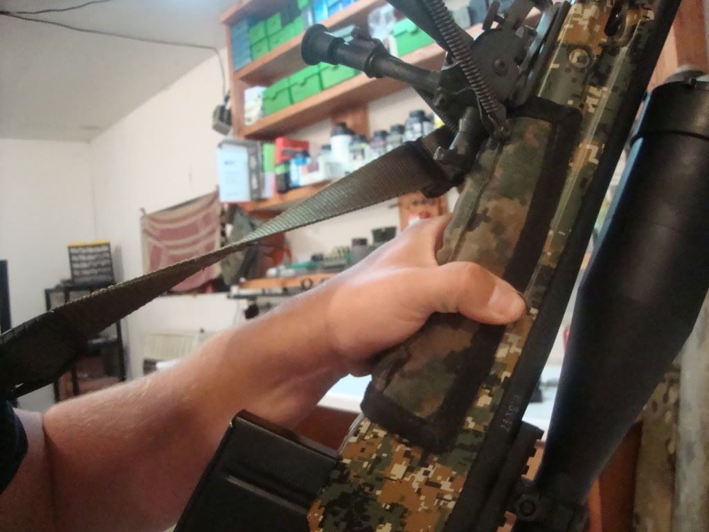

Next, give the sling a 90 degree twist to create a cradle for your hand.
If you use a AI stock, or have a swivel on the right forend of your stock, attatch your sling here, as this causes a twist in the slings, and forms the cradle naturally, like so:

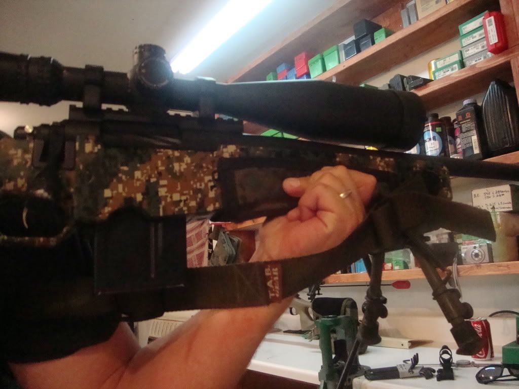

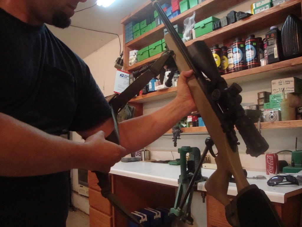

Next, slide the slider tight against the bicep. If your sling keeps sliding down off your bicep, it is because it is small, do some pull ups, and try again later.
Shoulder your rifle, and see if it is tight. You should be in extreme discomfort as you force the butt pad into your shoulder. Do not be alarmed, this is weakness leaving your body. If the sling is not tight, it is not working.
The sling will fit differently, when shooting from the sitting position, as opposed to firing off hand. The sling tension should be set up in the position you will be firing from most, for me, that is the sitting position. While standing, it will be looser, just do to the positioning of the arms and shoulders.
Practice dry firing from the sitting position, from either the Army or Marine postion, which ever you find more comfortable. My digital camera battery died, so I did not expound on this topic, but can be shown in this demonstration by CS Tactical.

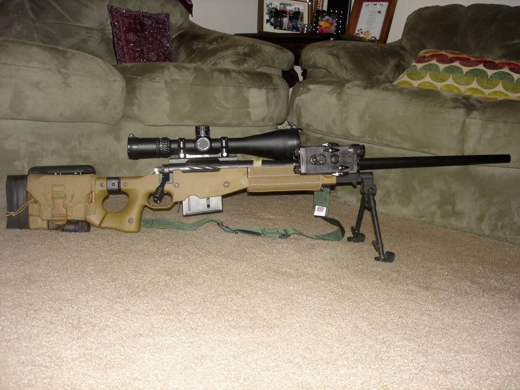

But everyone has them and use them because they are so cool... no way, besides the one picture you posted with the white label is an AI Sling, that can be on wrong because it's English.
So, since you got the AI Sling wrong I think it negate this whole post.

The point remains the same, English blokes don't know what they are doing with their slings either.
