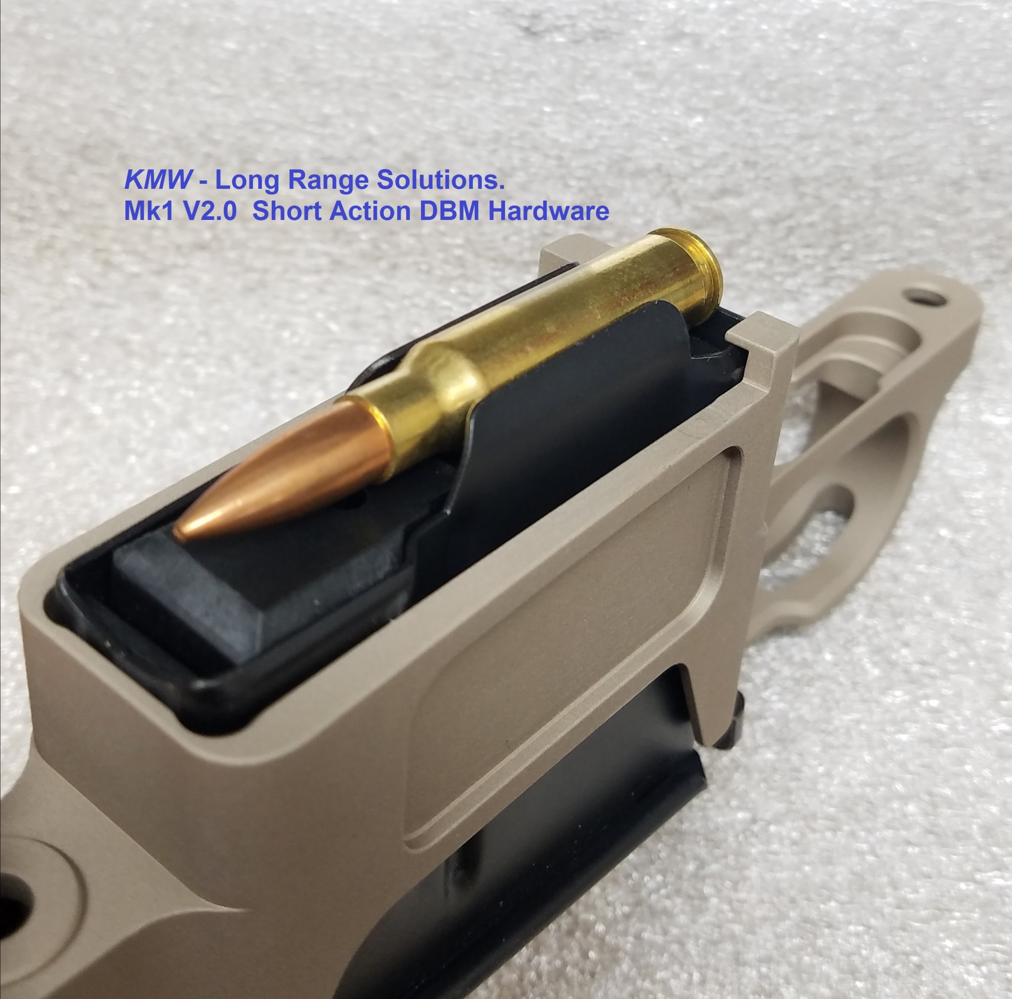

MAGAZINES
for these rifles:
Previous discussions regarding AW vs AICS pattern magazines are a moot point with these rifles.
These rifles will not accept Accuracy International AW magazines or any other AW clone.
The bottom metal hardware is compatible with the AW magazines but the Surgeon receivers are not.
Unless you special ordered your action from Surgeon with the receiver bottom cut for AW mag clearance or had a 3rd party re-machine it, you will not be able to use AW magazines regardless of what bottom metal or chassis you have.
Accuracy International Part number 3901 (5 rd AICS) and 3902 (10 rd AICS) are the only 2 A.I. manufactured version that will work.
To be honest, the 3902's have been pretty terrible on consistency in the last 2 or 3 years with half of the ones we have seen needing the lips opened to run reliably in any gun.
The MagPul AICS 5rd (Part #MAG549) magazines actually have been running as good. The MagPul 10rd version (Part #MAG579) is definitely more reliable than the 3902 factory mags on average.
MDT and Accurate Mag clones of the AICS also run well.
PSA: Bottom Metal Hardware for these rifles.
All rifles in this group utilize the Gen II SENTINEL DBM bottom hardware.
This hardware incorporates the new'ish Captv-Mag feature that limits magazine movement once the magazine is latched.
Captv-Mag is two integrally machined in control points on the top back of the magwell box that intercept the top back edges of the AICS type magazines. They are designed to float about 0.020" off the bottom of the Rem and Rem clone receivers while still blocking the magazine from over-traveling upward.
This feature ensures that the user will not inadvertently cause a malfunction or bind the bolt when pressing the magazine against a barricade, window sill, truck hood, rock, etc. Ditto for resting your rifle on the magazine when shooting offhand/positional or on another support.

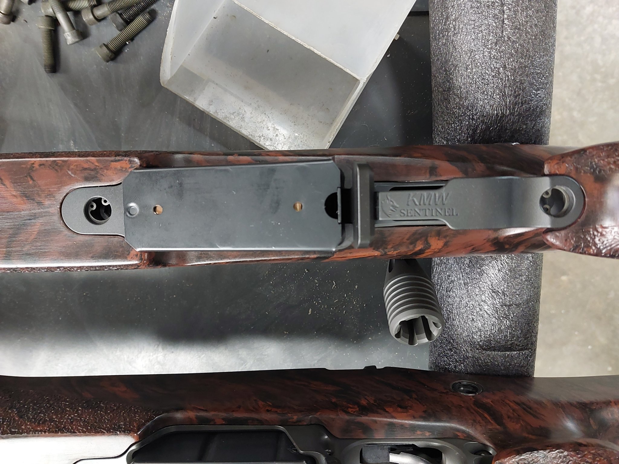

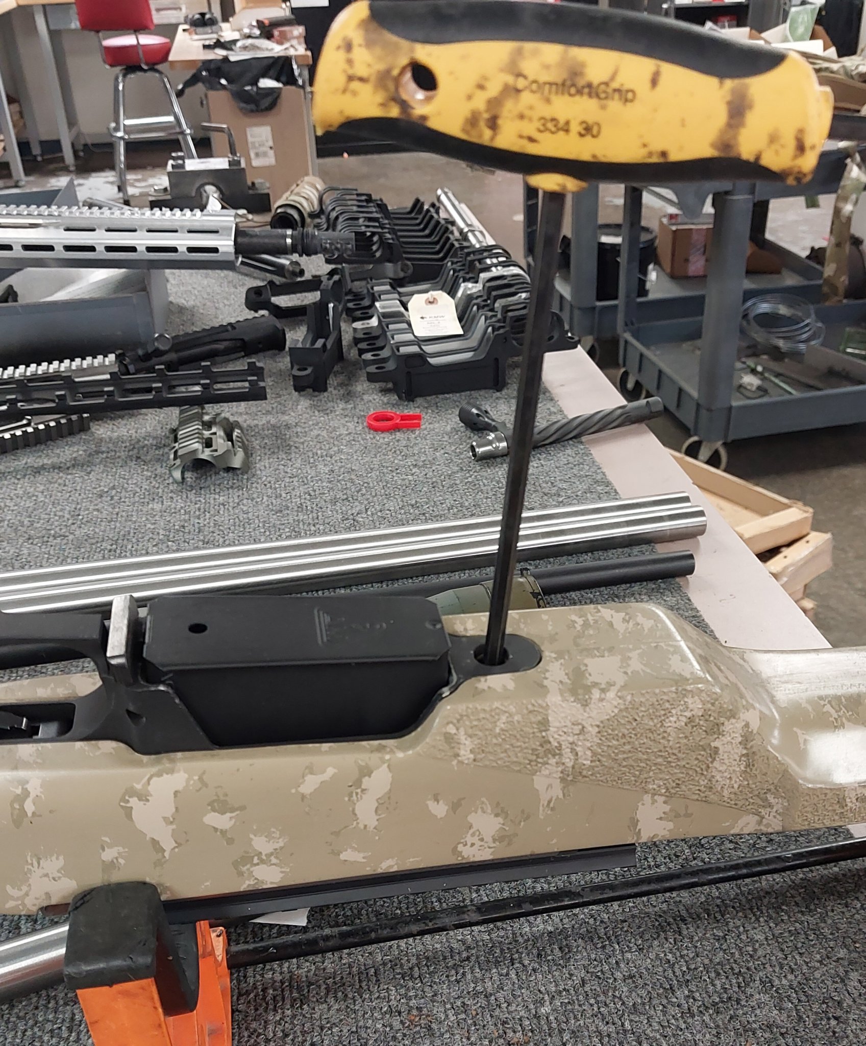

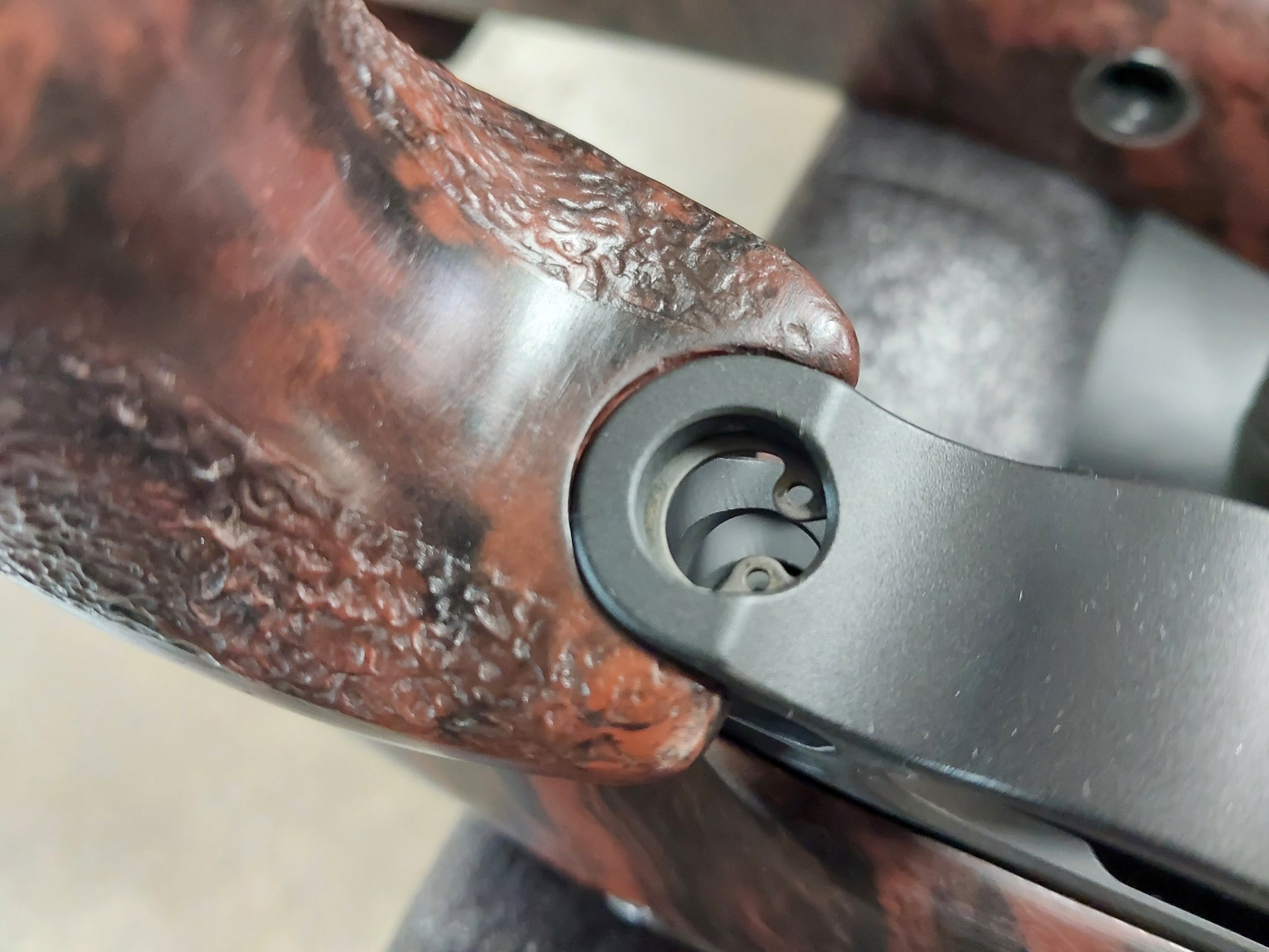

STOCK BOLT RETENTION

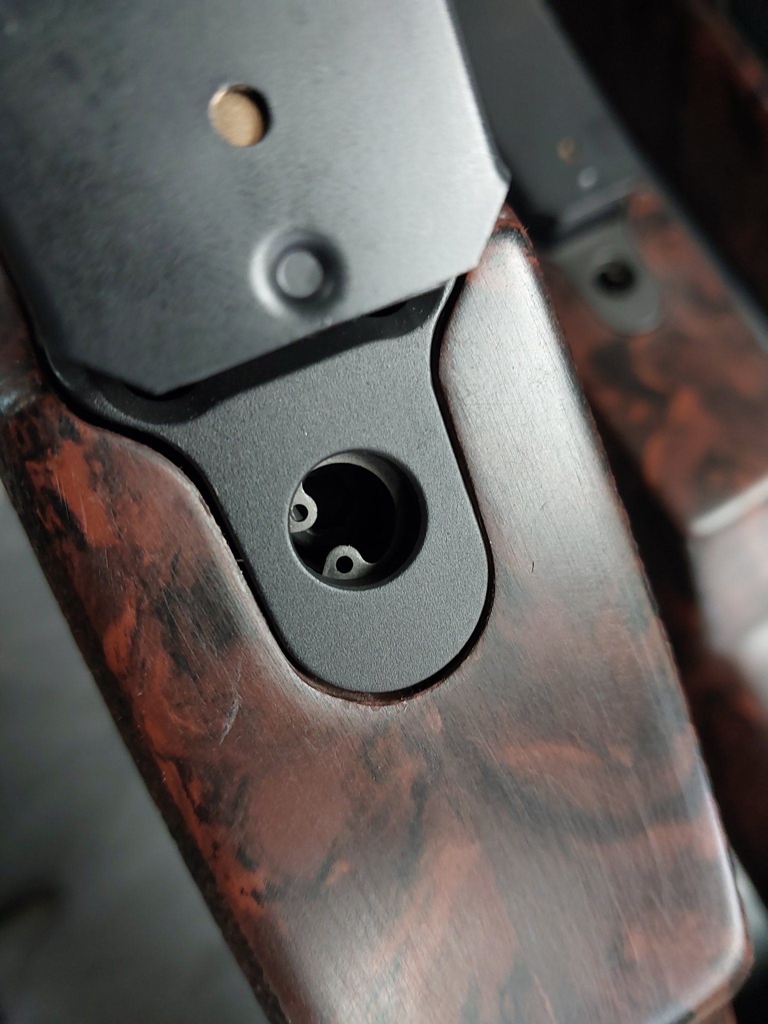

You will notice a small internal groove on the I.D. of the stock bolt holes. The bottom metal should have 10mm internal snap rings in place within these grooves. This feature allows the rifle to be taken down in the field or in the shop with a standard T-handled hex wrench without the chance of losing your stock bolts.
The retention rings look like this when in place.
The hex wrench/key can access the stock bolts with these retention rings still in place.
This has been a standard feature on SENTINEL bottom metal since 2007.

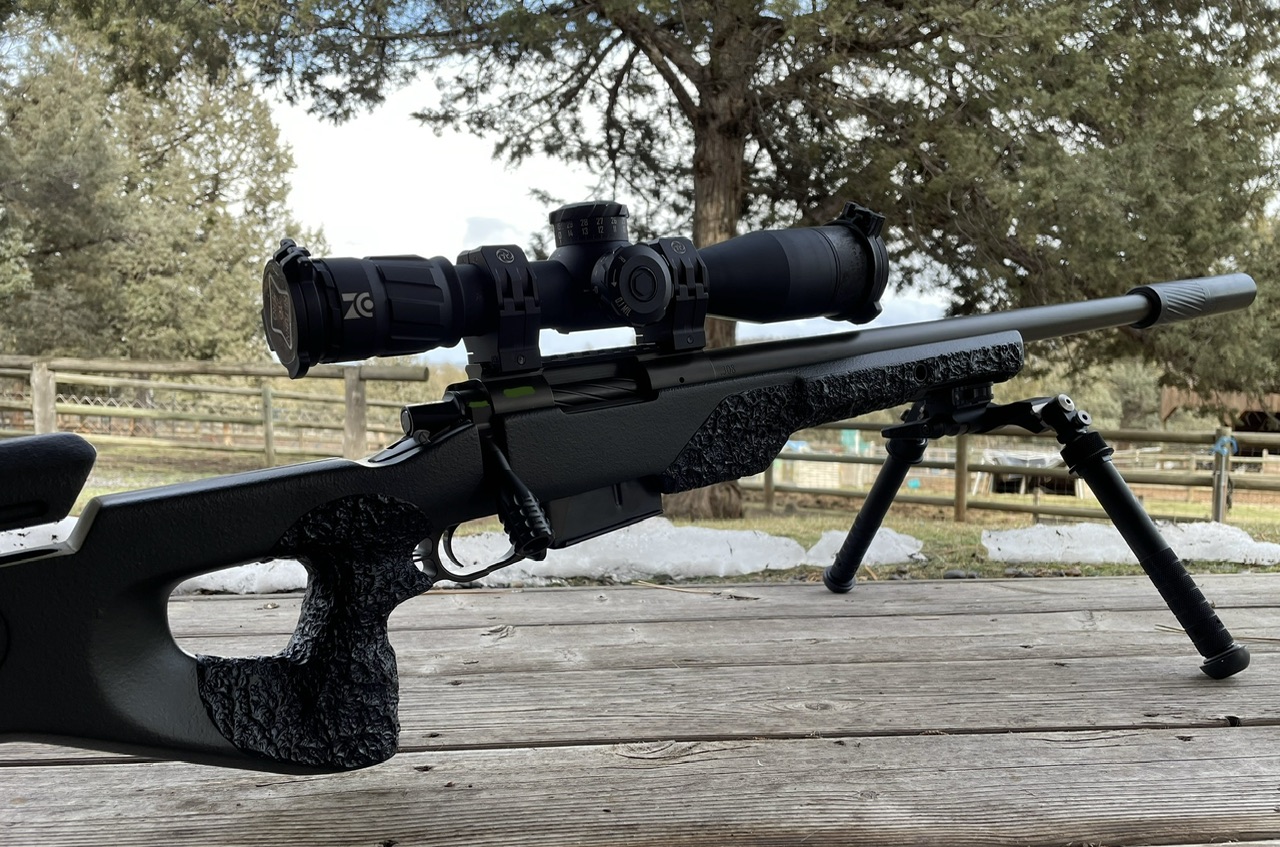

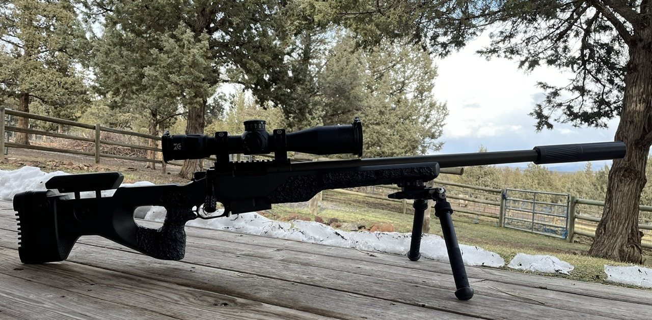

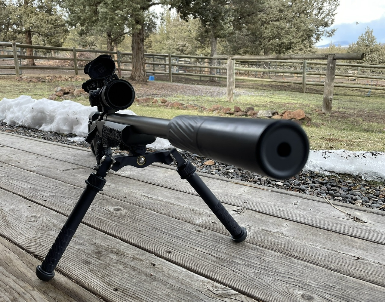

Yeah 420 looks great on there! I went 527 but like that 420 on there, I’m rocking the same can too.
I love my 527 but run it on a 6.5CM. I traded the 527 for another 420 for this rifle as I want to try the 10mil nle mpct2x for my next 527.
The 420 in the photo has a ARD attached so looks longer. Love the TBAC cans!

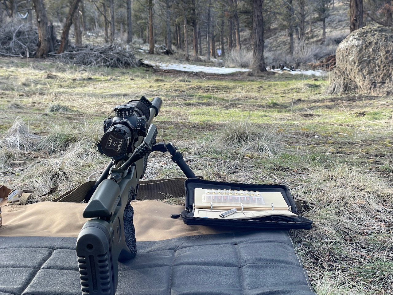

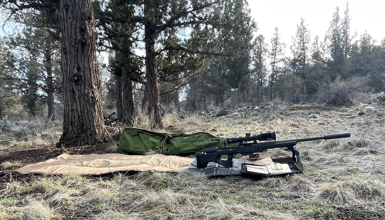

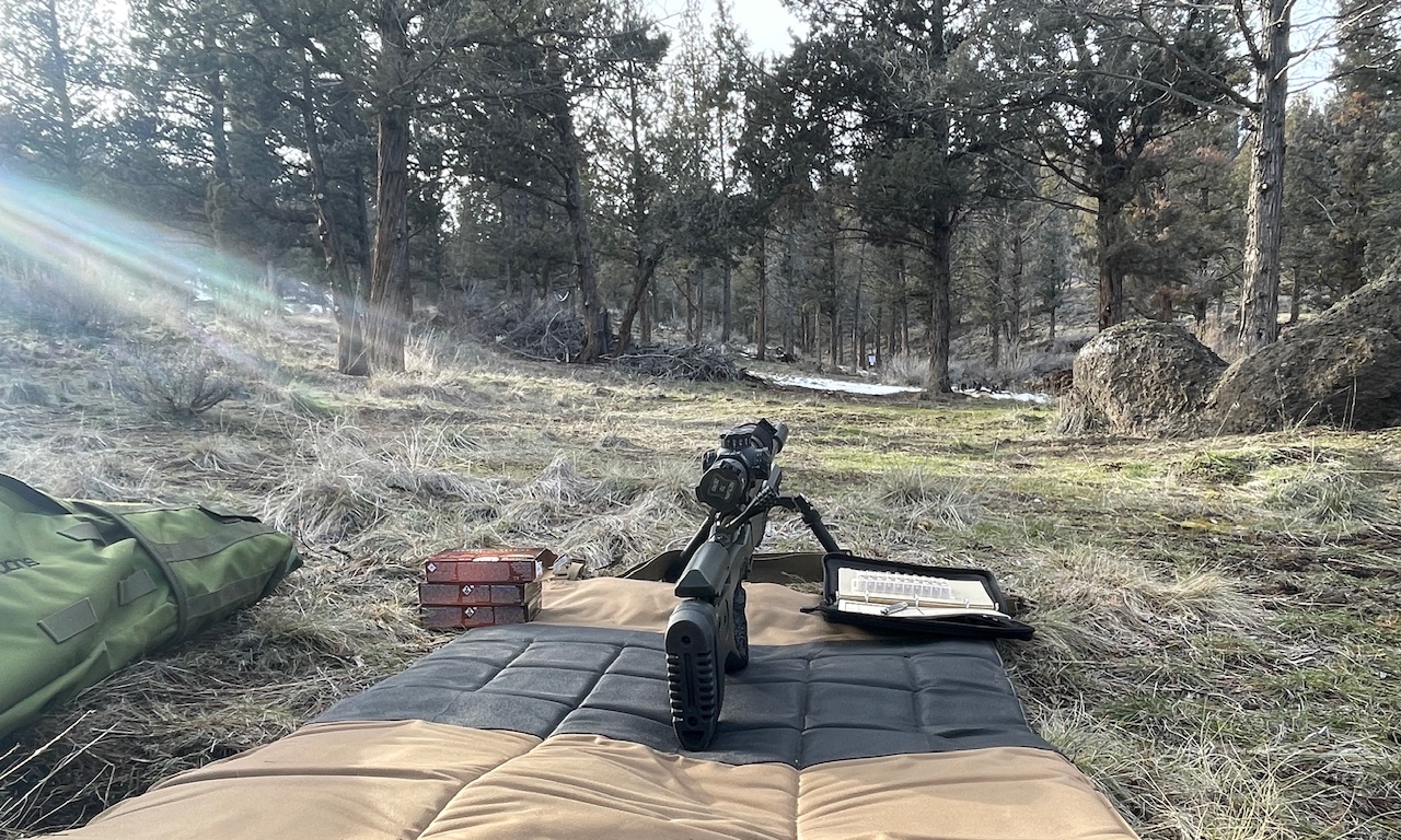

Got out briefly this evening, had to stop when my flock of Turkeys were heading to their roost and wanted to cross behind my target.
With a rifle like this I can never blame my tools! Shows me exactly what I am doing wrong.
Sometimes they die...
I forgot my rear bag, so I was shooting off my fist on top of two, stacked boxes of FGGM 175's 😆

That's why the vertical is there.
Get a good bag and you will eliminate it if you use it right
