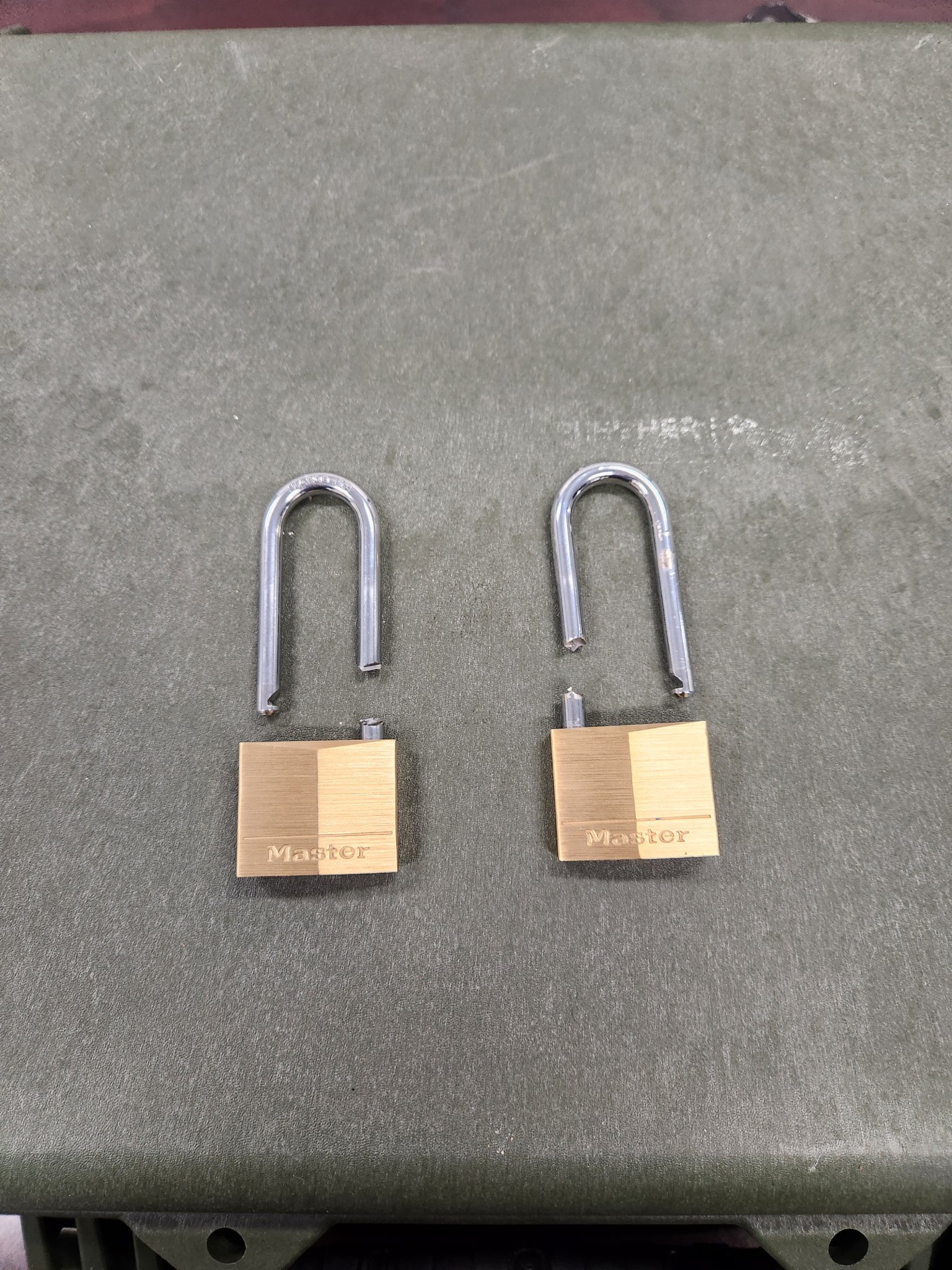

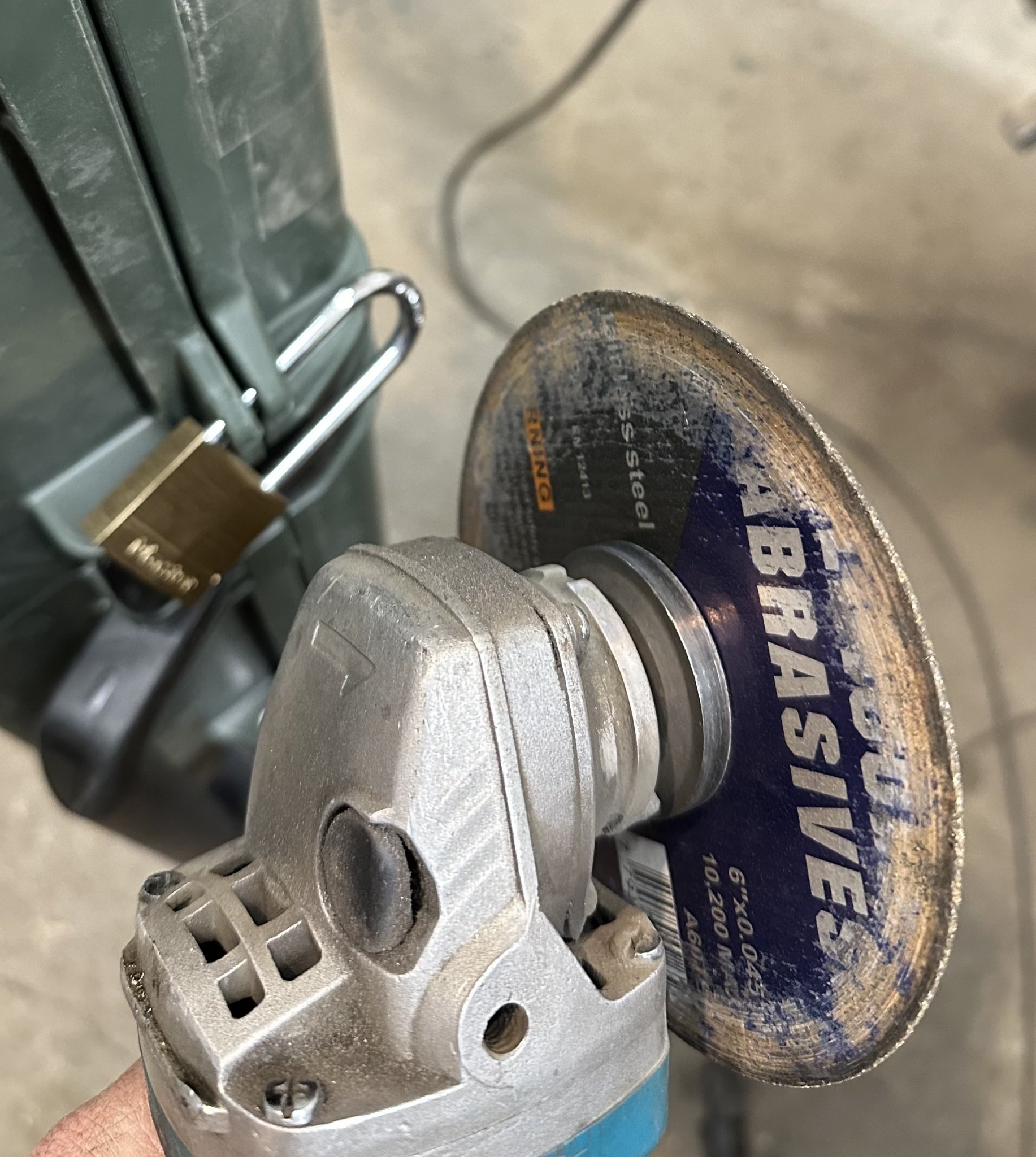

In mikes Defense he did ask me if I have bolt cutters so I dont have to wait for keys…
Sirhr
I chewed mine off....

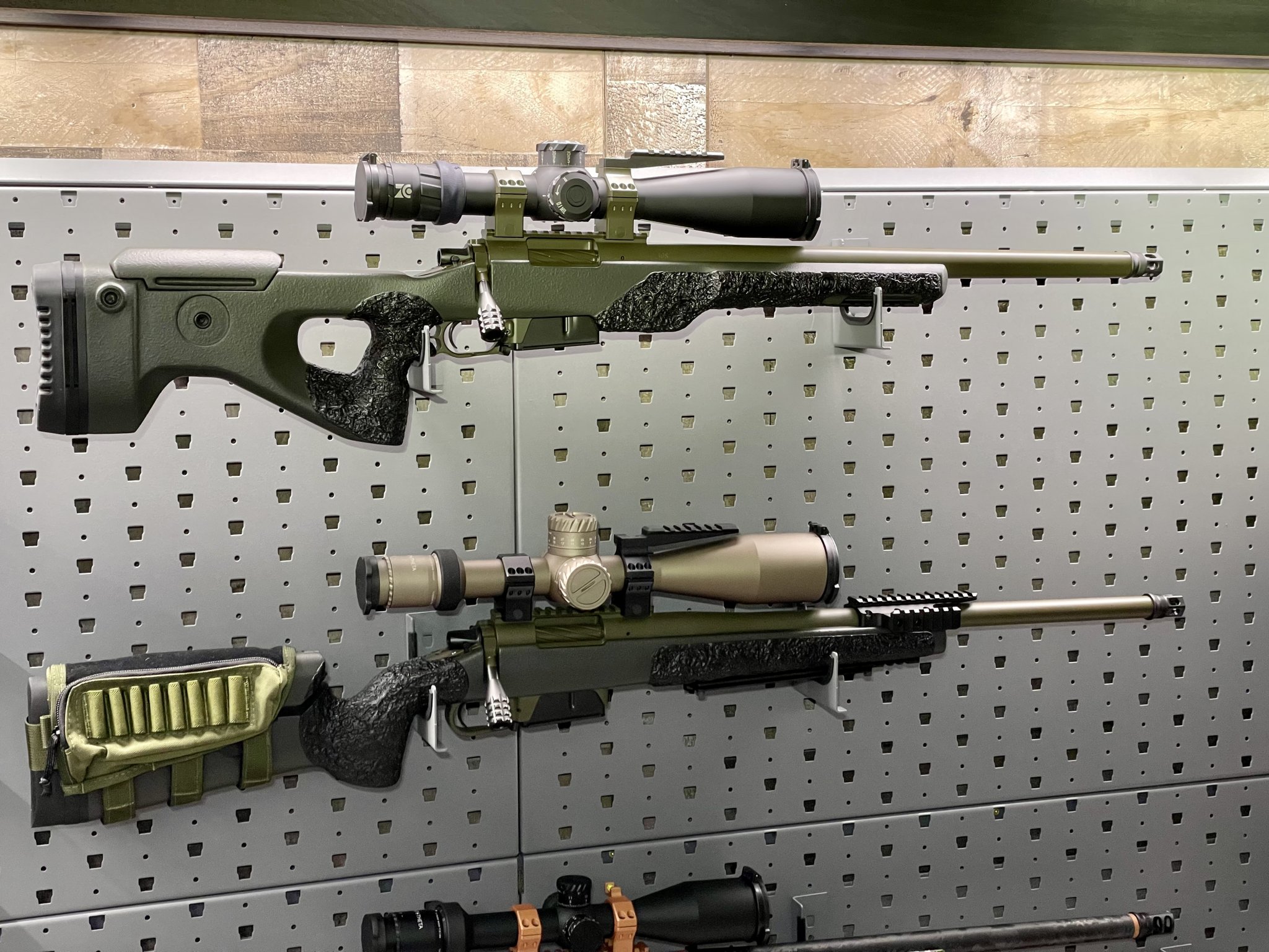

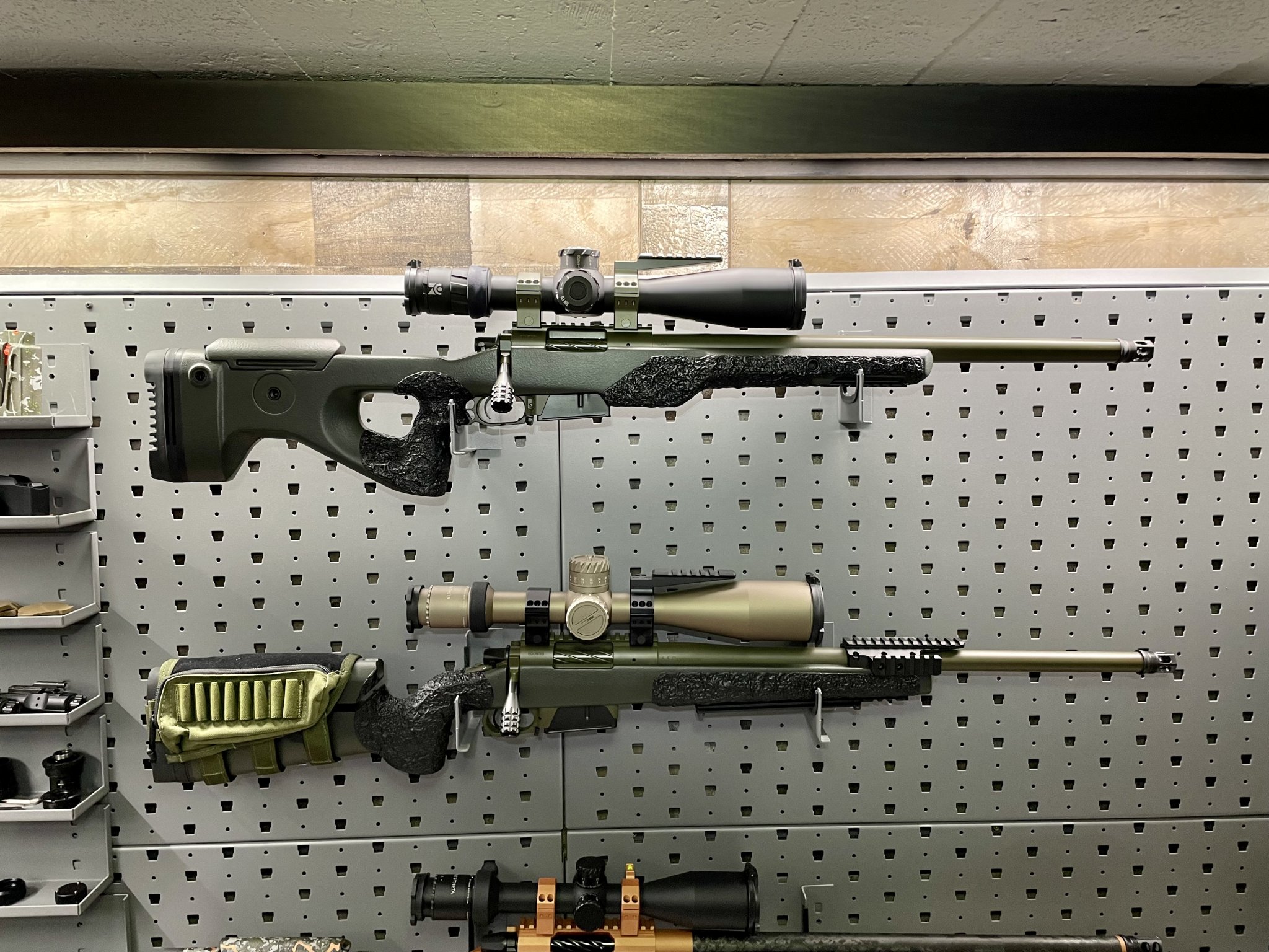

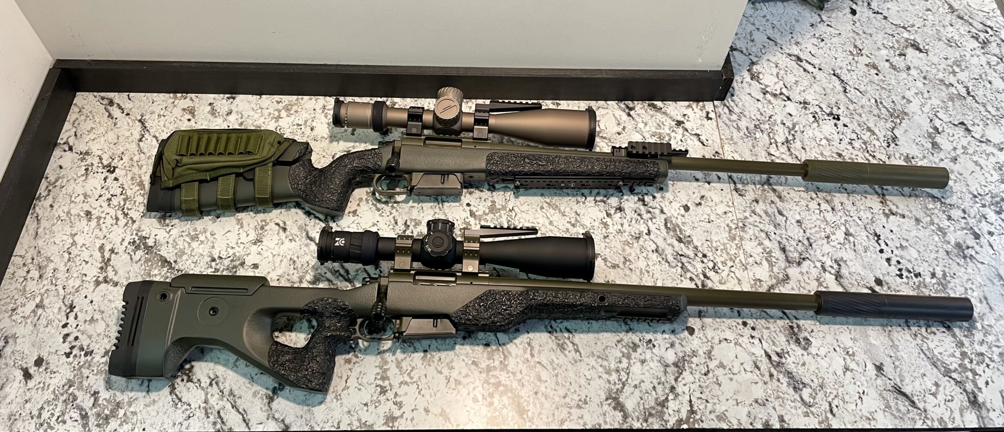

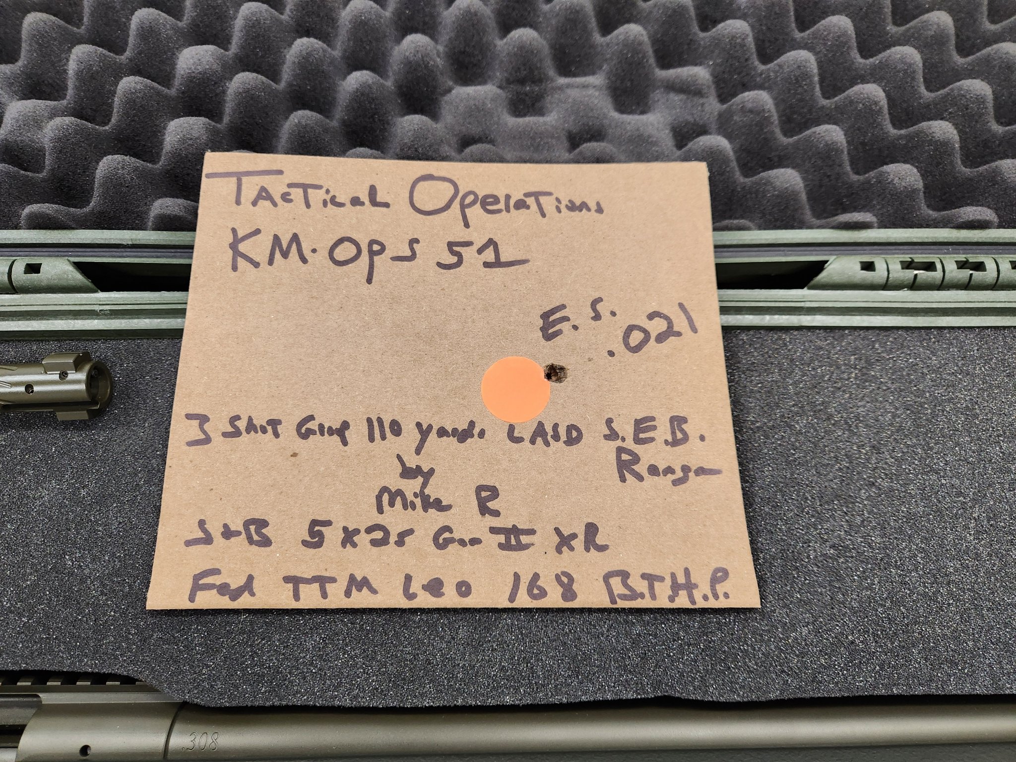

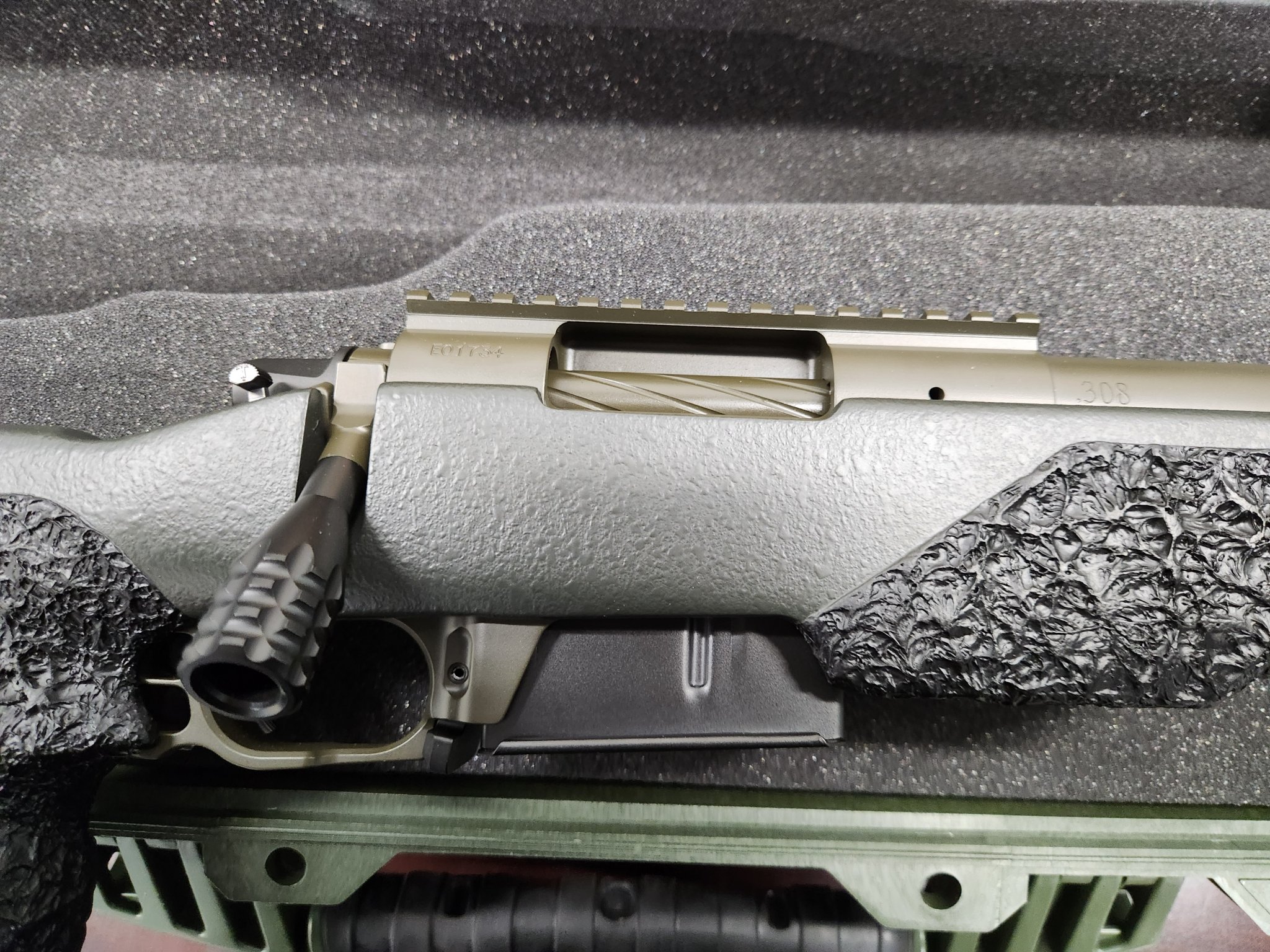

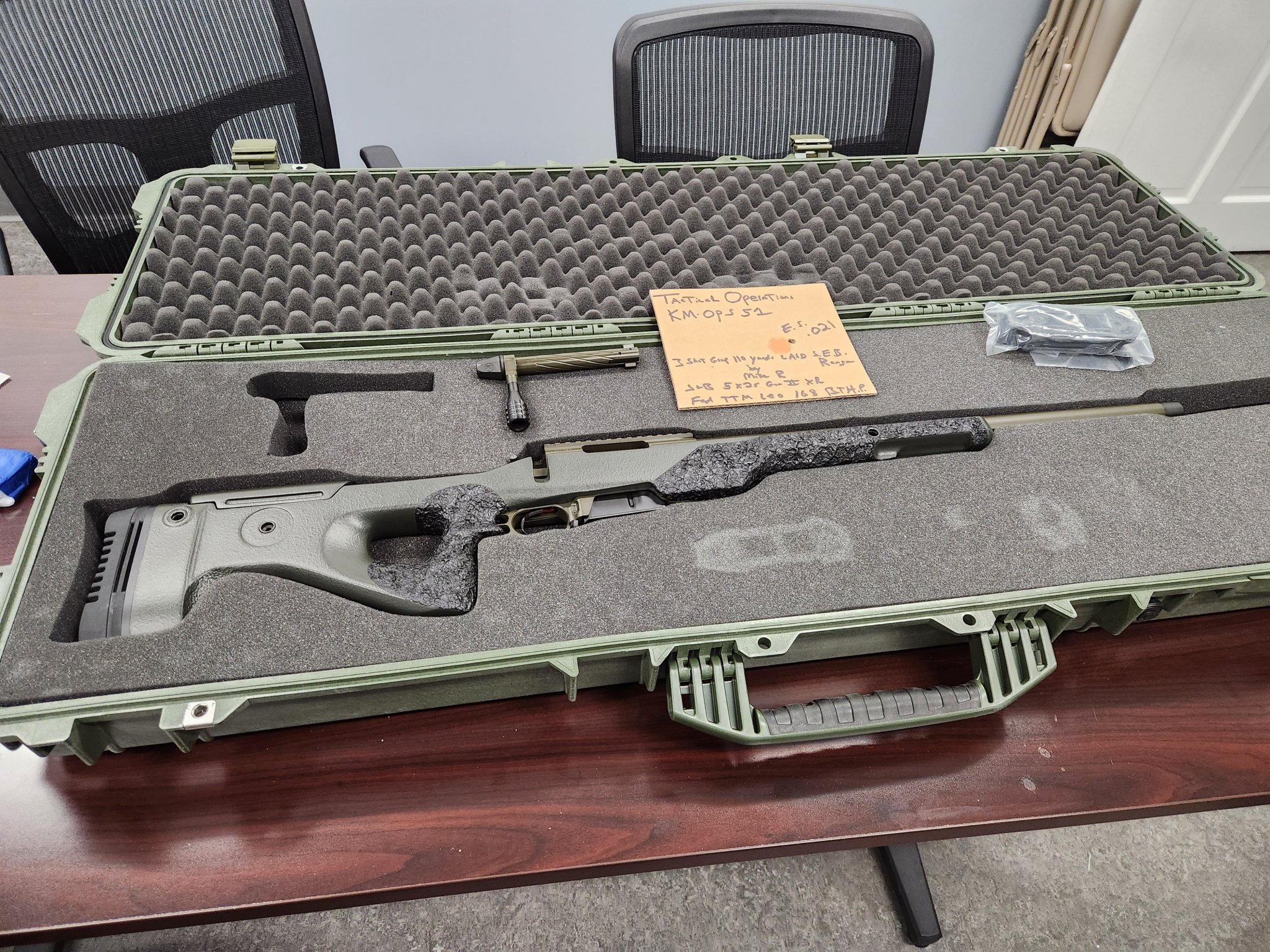

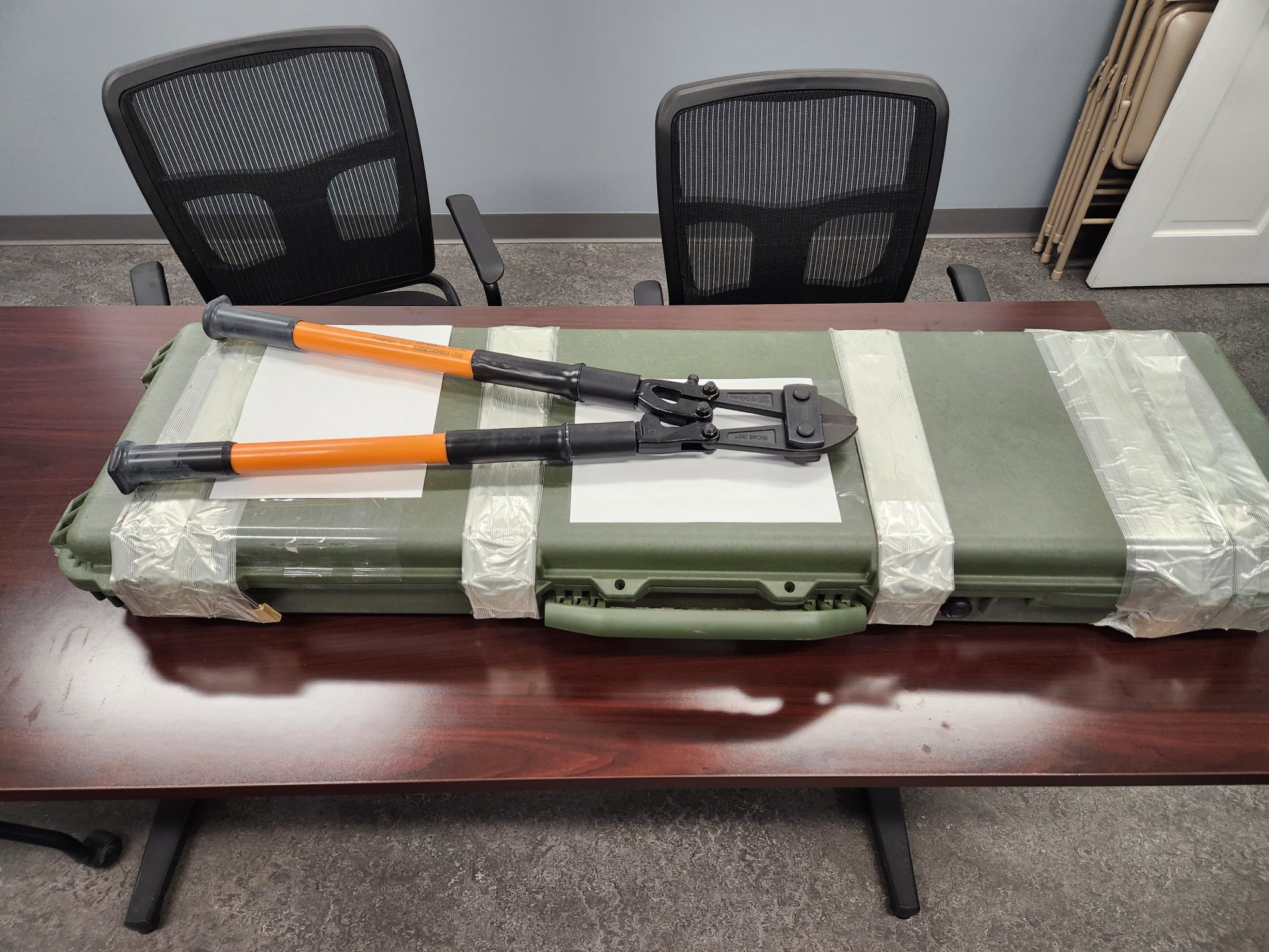

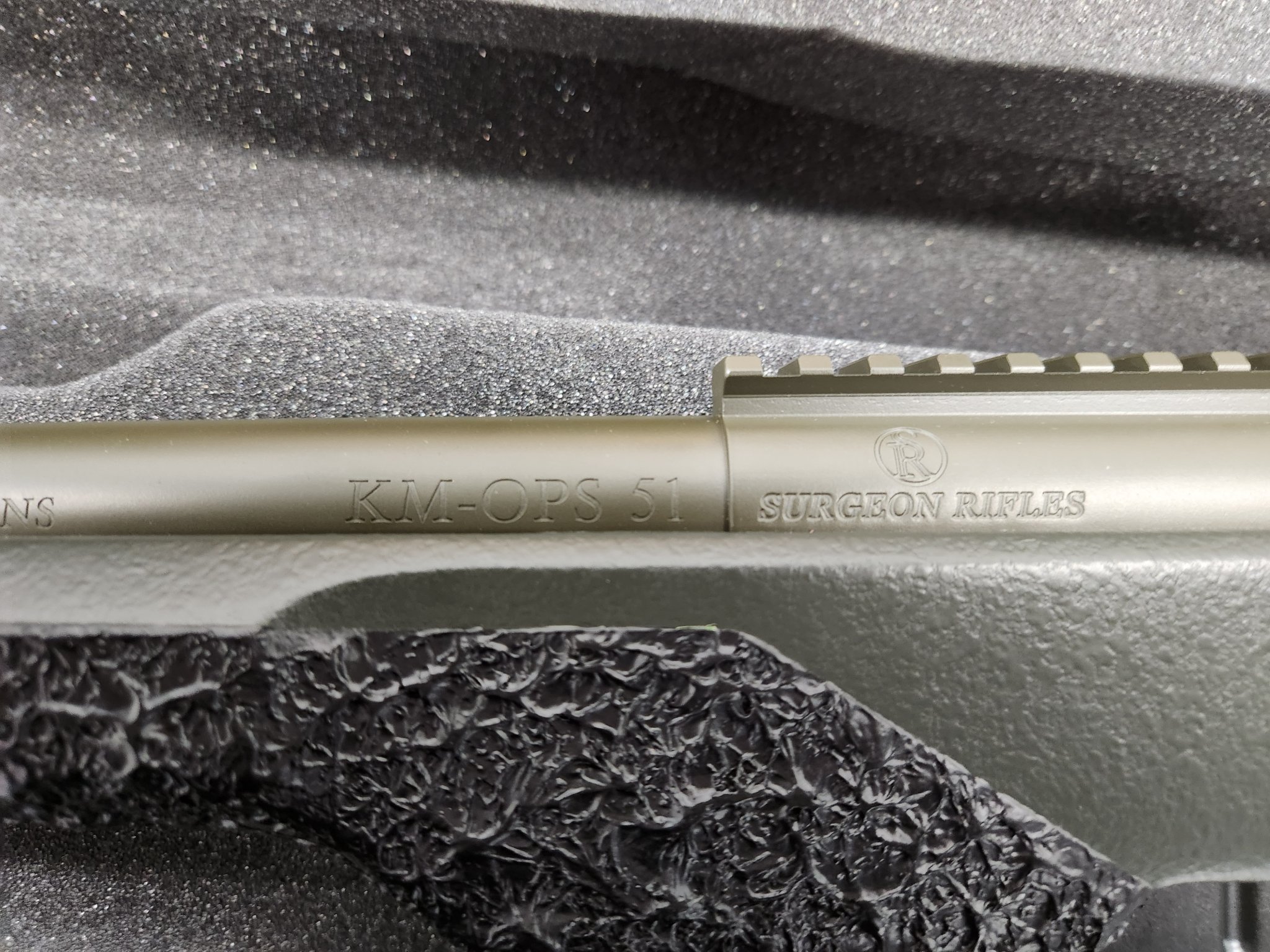

After my last TacOps rifle, I invested in a good pair of bolt cutters! For those who are still waiting, it is MORE THAN worth it. This rifle is a true work of art.

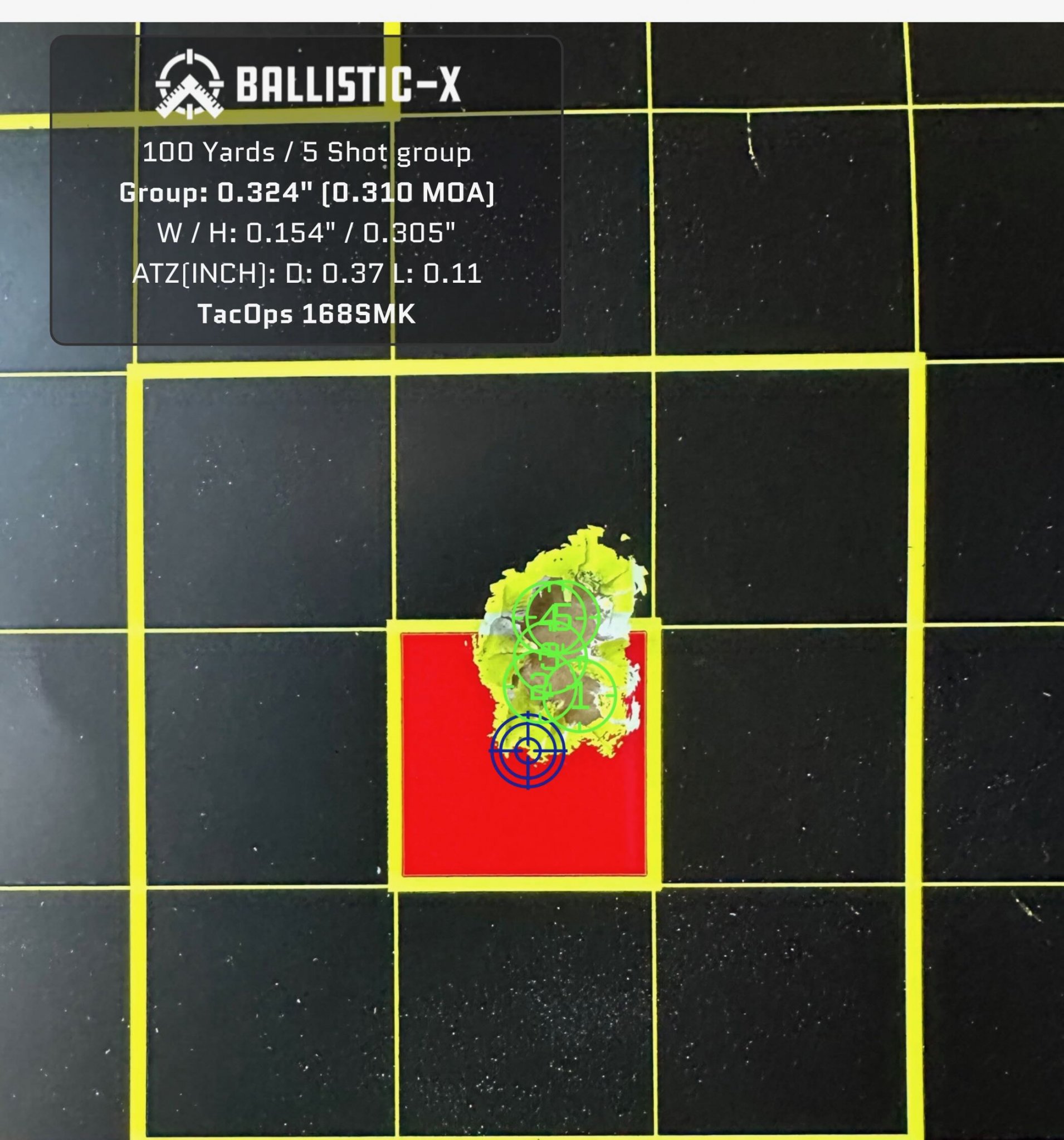

Why is no one posting groups yet…don’t you guys shoot or it’s all sage queens around here

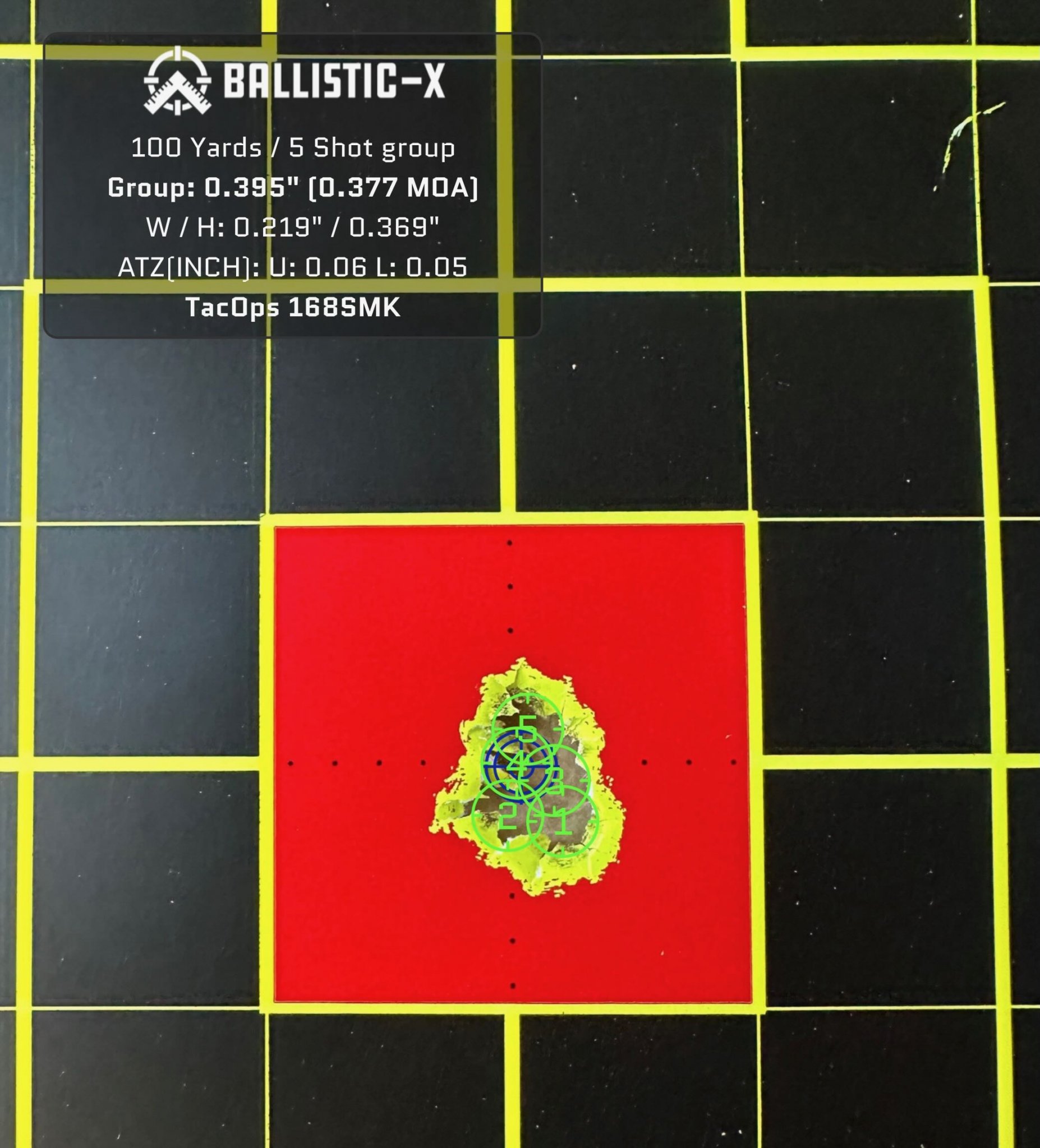

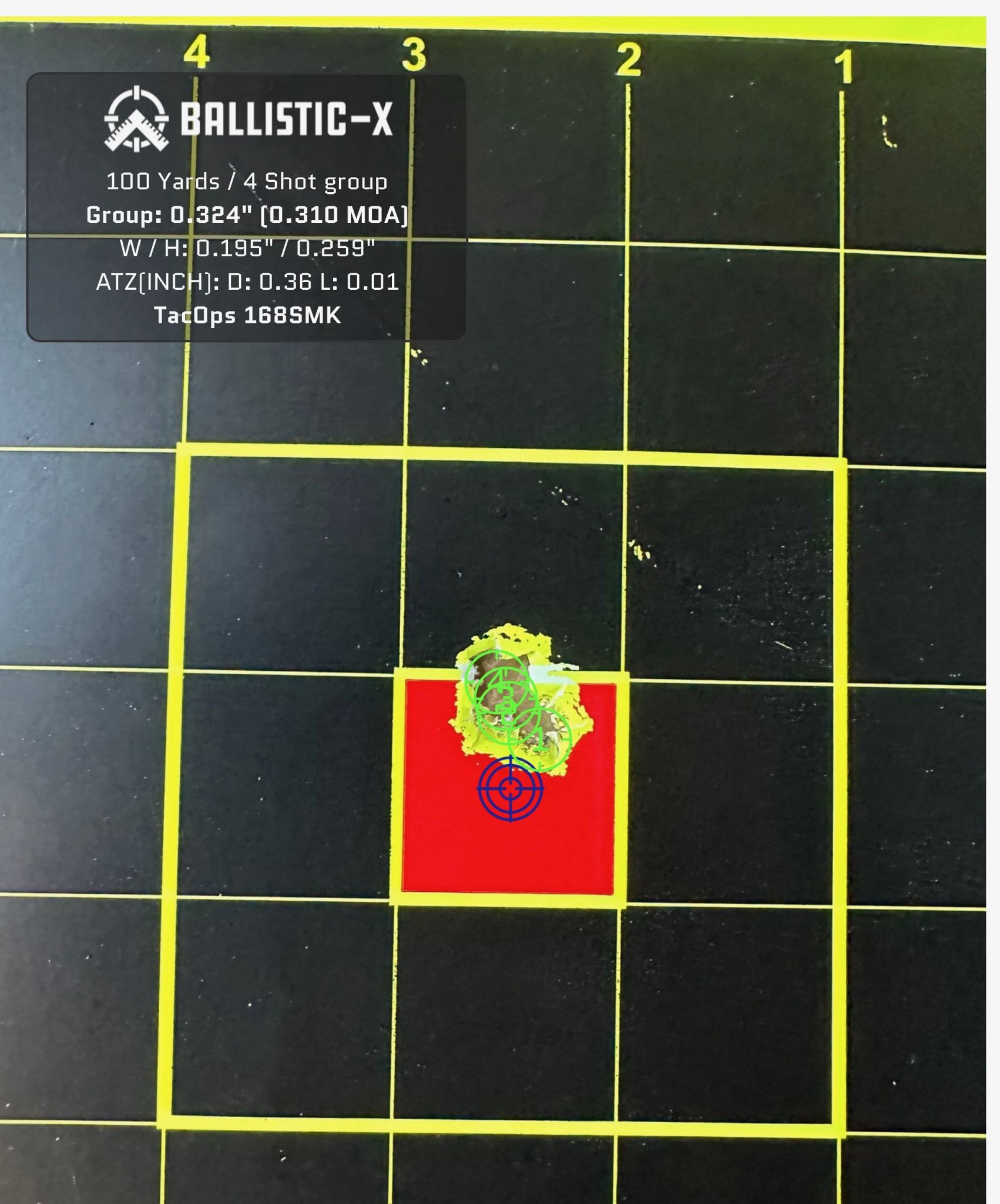

Shoot a lot...just have 4 rifles that I shoot regularly. This is from my last range day. 3 consecutive strings.
Second time using the rifle. It is MONEY.

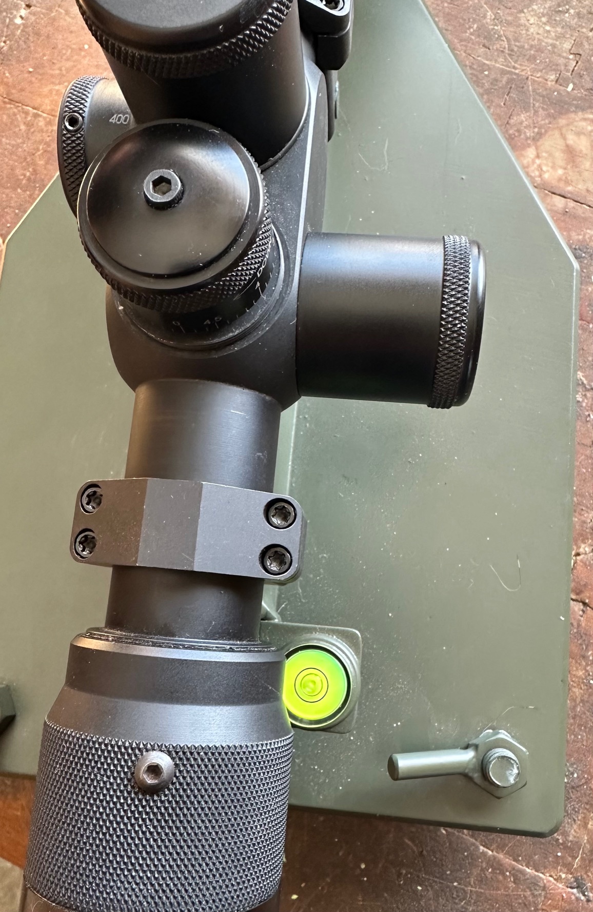

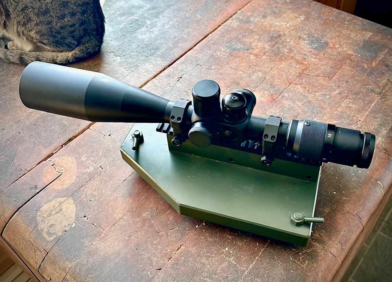

Start with my scope leveling fixture. I have a plumb at 80 yards out from this butcher block (weighs 400 pounds... very stable) So first set up the scope testing tool and got it leveled. Then I can set up the rings and plumb the scope on a perfectly-level base vs. on the rifle itself. The action has a machined-in base. So I know it'll all be level when it's done. The base of this was cut by an awesome Hide member, BTW. And I machined the rest of it to dead-nuts. It has three leveling feet and a bubble that is attached to a foot machined to the upright. Great tool!
Decided to go a bit old-timey with this. It's an early USO 5 - 25 built by JBW and with one of the first Horus reticles fit to a 5-25. Illuminated reticle with the switch on top. Totally amazing scope. For those that remember... this is the one that went missing when it 'magically' disappeared from a Fedex Office in Connecticut. And 'magically' reappeared after the Connecticut State Police stopped by and I mentioned to the depot manager that as it was ITAR-controlled, if it didn't reappear, he'd have a visit from Federal Investigators. WIthin 24 hours it was 'found' and on the way! Cats are helping, naturaly. Badger rings.

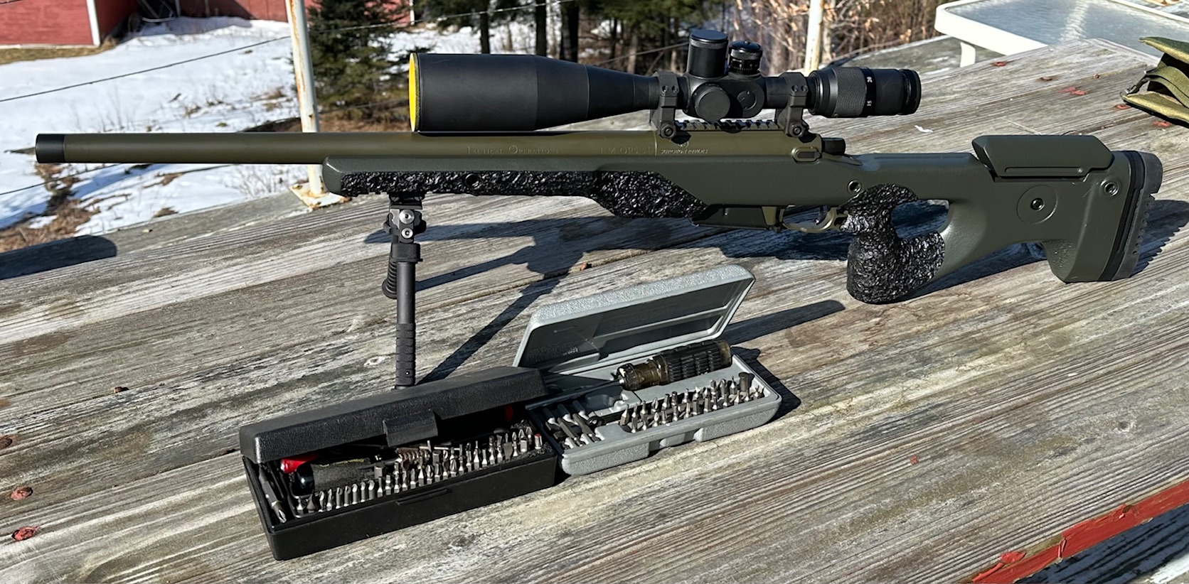

Note the tools for mounting. Helps to have the right tools! Torque wrenches... every bit known to human kind. After it's sighted and the rings are slipped, I'll index the screws with a bit of red paint. Always check your torques and look to make sure screws don't move. Attention to detail! Someone asked about the grip and it is really amazing. Funny, when I first saw pictures of it I was reminded of the old Plaster "Ultimate Sniper" stock -- my first custom stock. And while it's probably sacrilege to mention both stocks in the same paragraph, the Plaster Stock was so rough that it needed smoothing and sanding. But once it was 'cut back' a bit, it gave an excellent grip. This finish is amazing. Smooth and comfortable but no way you'll ever have anything but a great grip, including with gloves (not tested that yet.) It's a really cool finish.

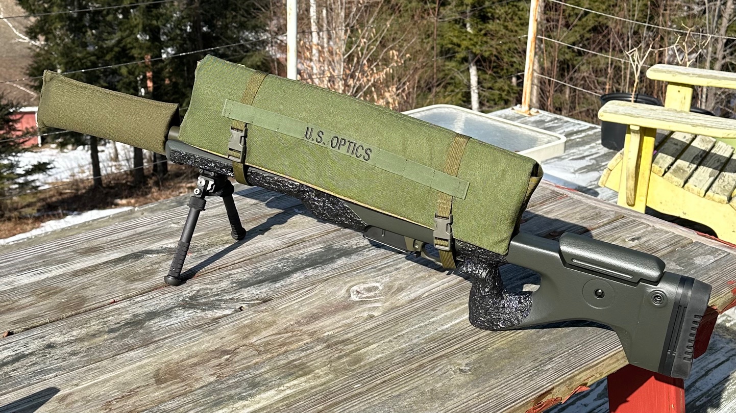

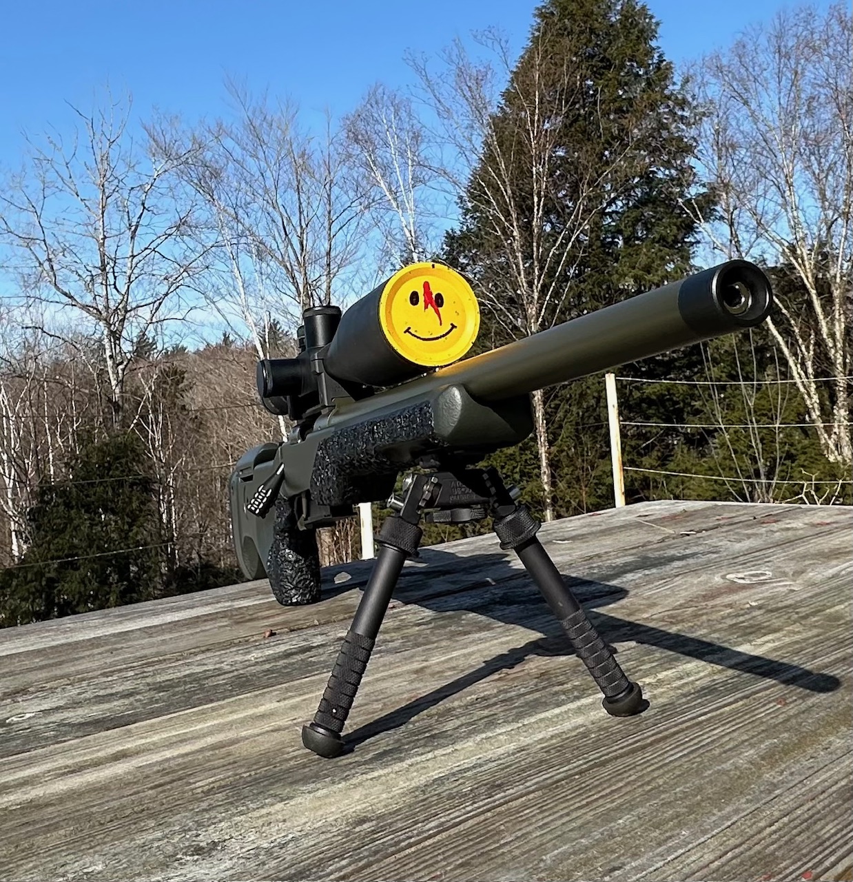

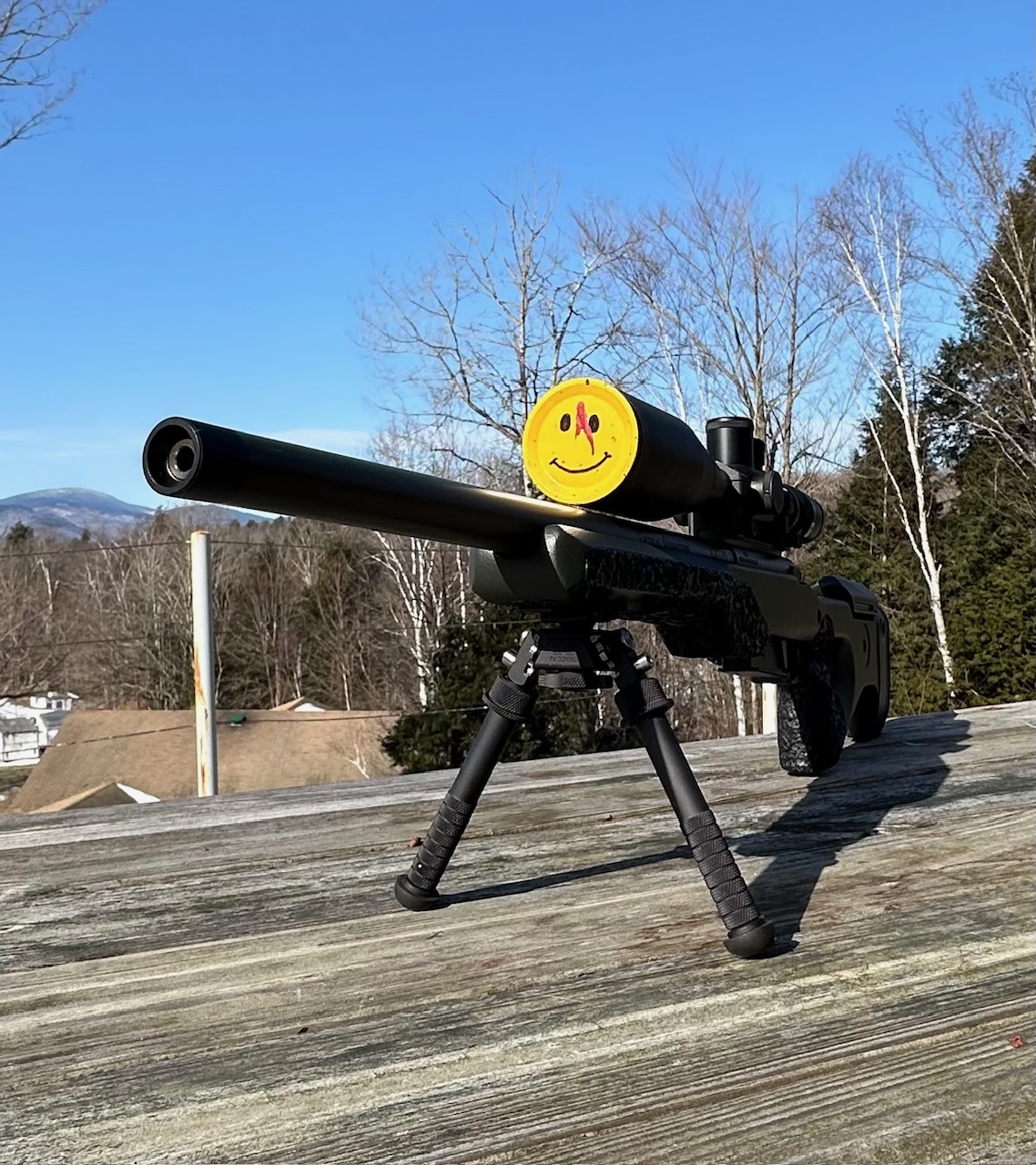

Always make sure you have a nice scope cap. Yellow makes it hard to forget at the range. Decided to use the Atlas off my .14 Eichelberger. At least for the time being. I like the older Atlas. They are rugged, simple and light. Probably look for another one used. Or maybe get something else. It's not like the .14 needs a particularly rugged bipod!!! And I wanted a bipod today to set things up and I think this one will stay on this rifle.

Off side. I mounted the ring bolts on this side because they interfered with my single loading when on the bolt side. Here they are nice and out-of-the way. Nice thread protector and beautiful muzzle work by Mike and his team. Every detail is just perfect.

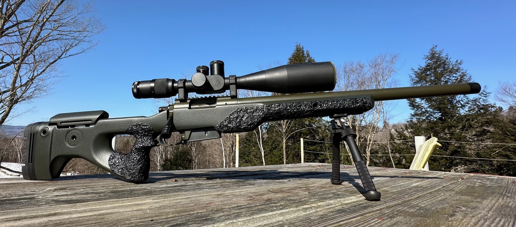

And a beauty shot... though I can probably get a more beautiful shot later. The only thing so far that I have to get a bit used to is the trigger. It's a bit light for me. And I am used to two stage triggers. That said... I don't see it's going to be an issue and I plan on trying to get used to it before changing it. It breaks super clean. I just like a bit more poundage which is merely a personal thing. In its case, the rifle looks huge. Put a big 'ol USO on it and suddenly it's pretty darn compact! Of course, with a suppressor on it, it will grow quite a bit!

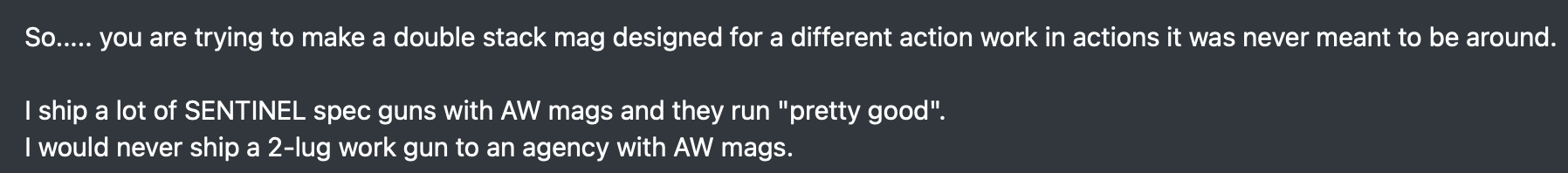

Are you suggesting that there's any amount of smiths building LE rifles and setting them up for AW mags instead of AICS? Especially two lug?
Below is a clip from a Mr. Cross in another thread. Most I know feel the same way. I like AW mags and run them in as many rifles as I can. But, I'd never run them in a non AI work rifle, nor would I ever set them up in a non AI work rifle.
There's also typically no need for a 10rnd low profile mag in domestic LE bolt guns. So, you'd be doing extra work setting up an AW mag for something that isn't needed.
