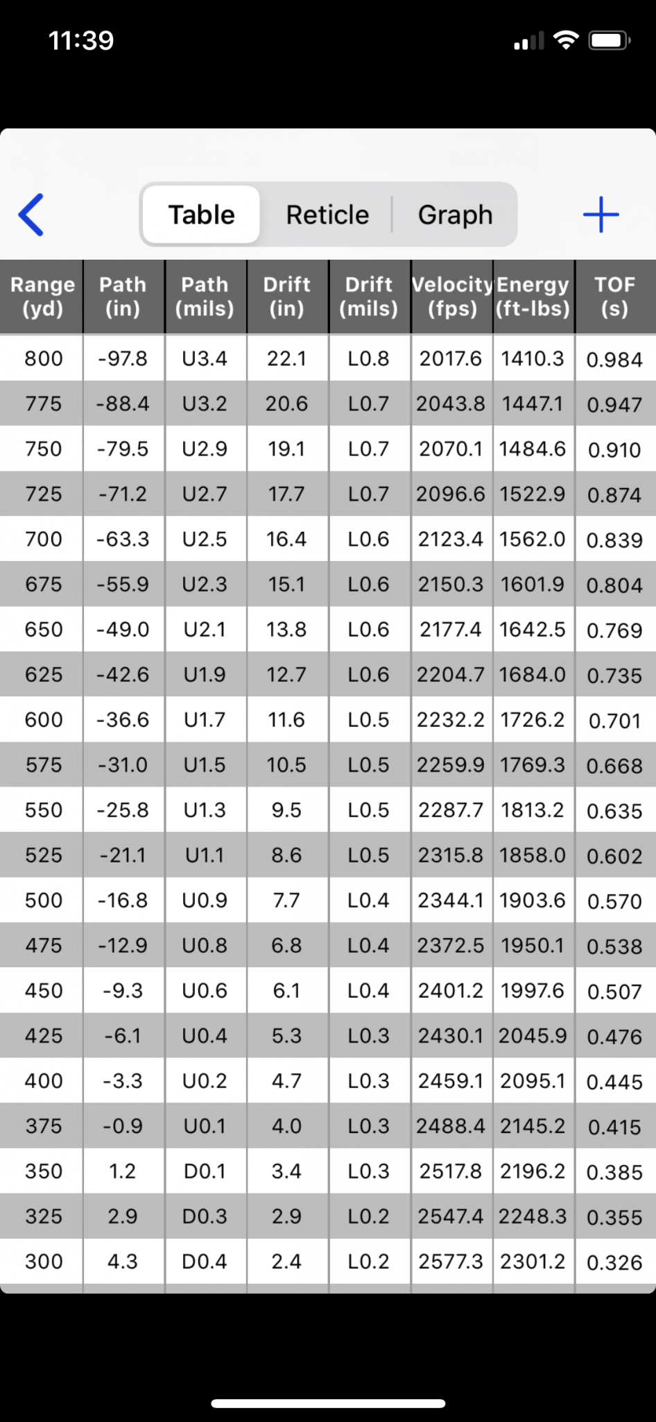

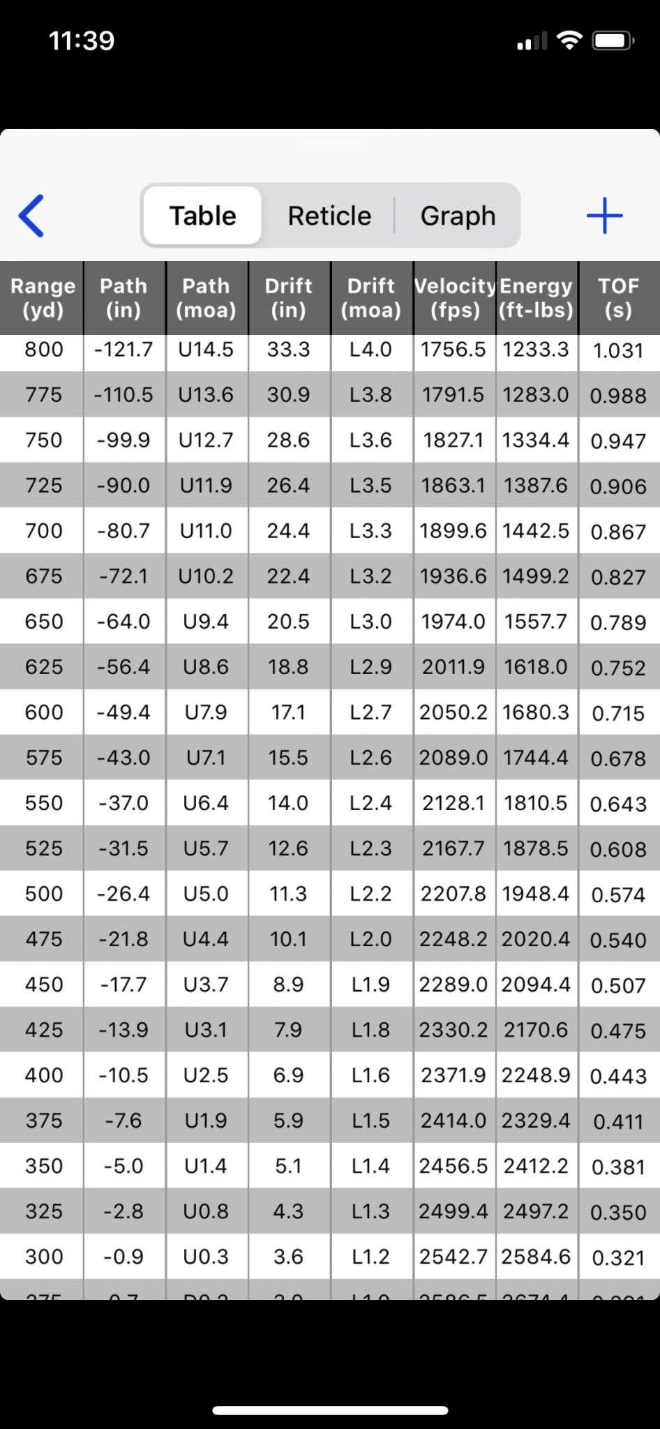

    6.5 PRC Berger 156 EOL 2950 fps 1410 ft/lbs
    vs .300 Wby Mag 180 Accubond 3100 fps 1233 ft/lbs at 800 yrds respectively. Recoil is minimal compared to Wby Mag. Interested in real world experience. Thanks
