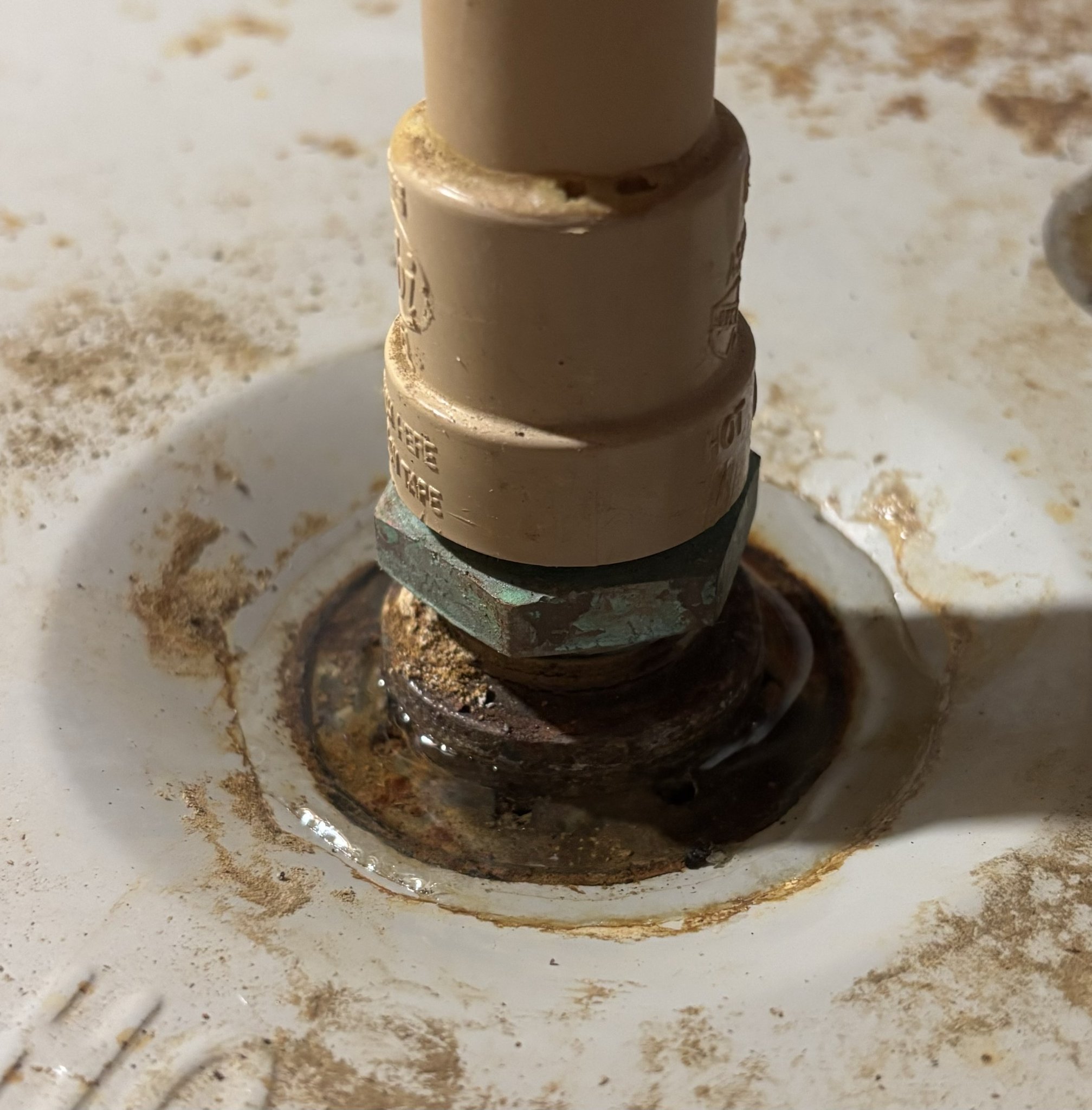

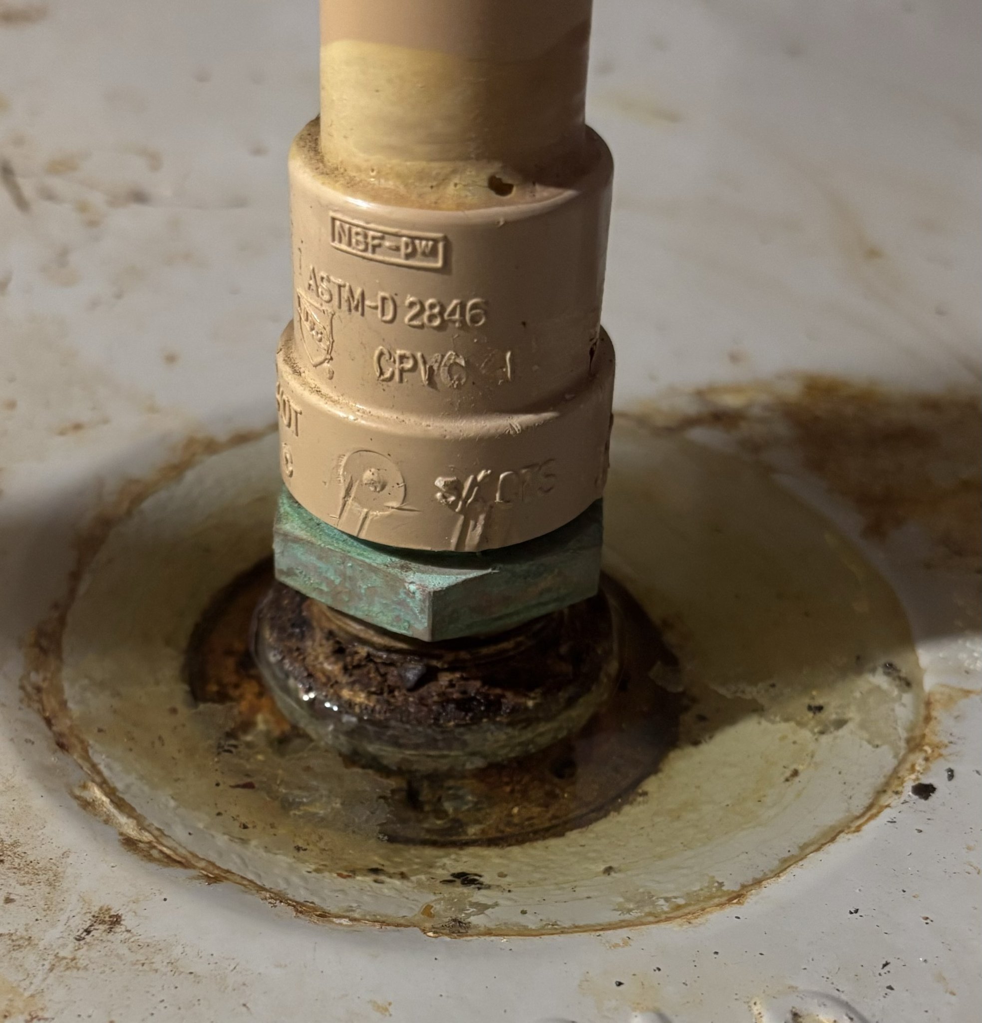

I have a 50 gallon and a 30 gallon water heater in my crawl space. The 50 is leaking from the fittings where the inlet and outlet pvc connect to the top. Probably not a good idea to drop money into it since the water heater is 20 years old.
Looking at replacing it with a Rheem tankless. Does anyone have any experience with a tankless? Regrets? Definite yes?

Here is a pic of the top of mine where it’s leaking. Wondering if it is worth repairing? It still produces very hot water and this is the only problem area I am aware of.
Depends on a few things, dip tube being one of them.
IF you can find a reliable and honest plumber or a friend who has plumbing skills one of them might be able to tell you.
If the dip tube has never been replaced it might break on inspection depending on construction even though you're still getting plenty of hot water.
If it's generally in good shape a decent, honest plumber might repair it for <$1000 ... warranty on the repair would be much shorter than warranty on replacement.
