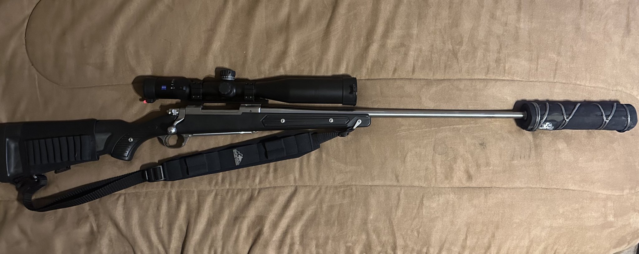

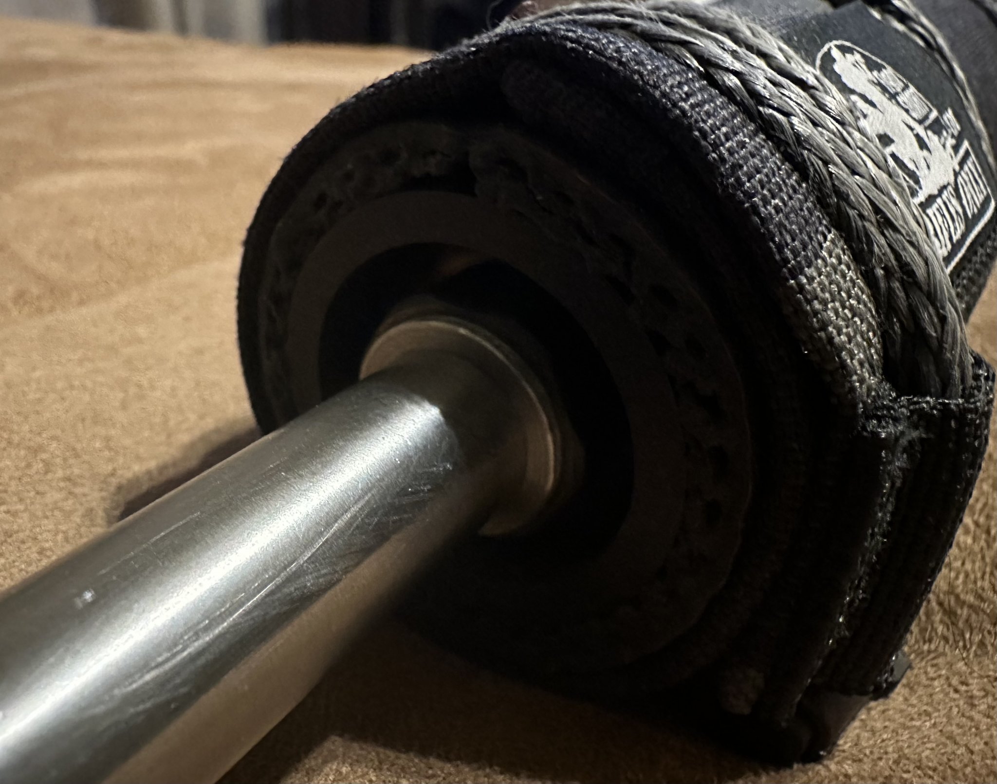

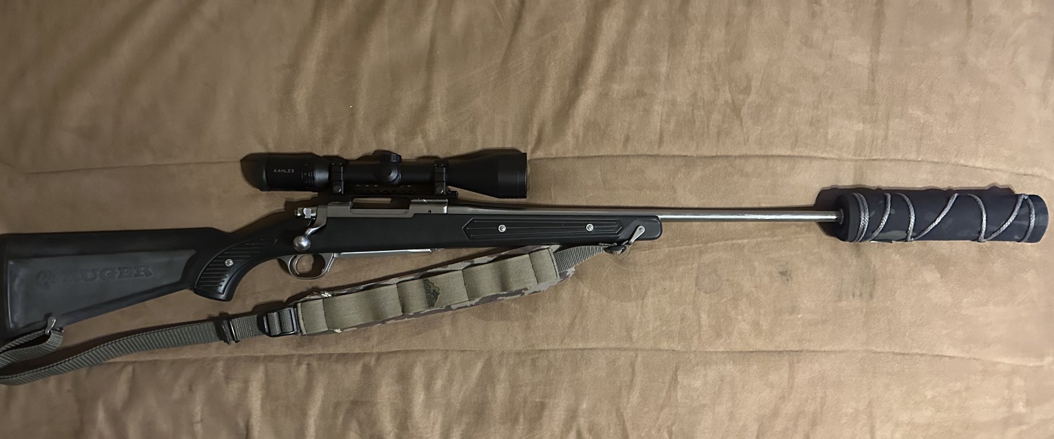

Looking at getting a 6.5 and 30/06 fieldcraft threaded for a light weight hunting rifles.
Was wanting to do 5/8 direct thread and wondered if the hub is a better option or stick with direct thread.
Weight is a concern
Dominus or ultra 7

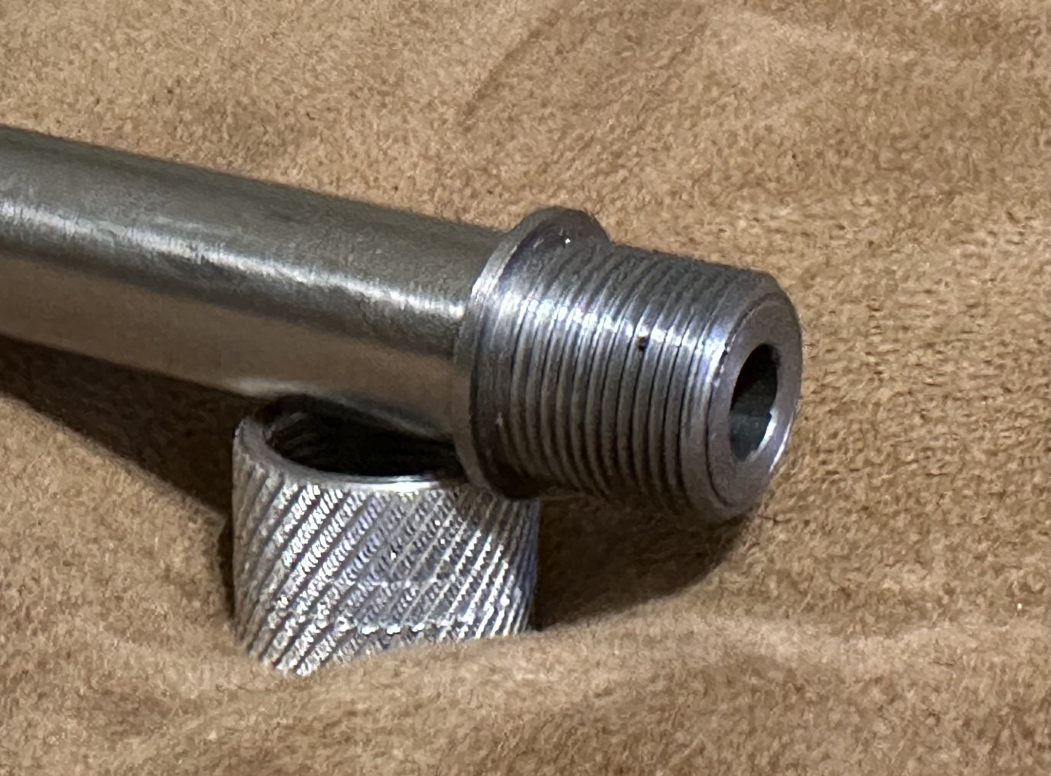

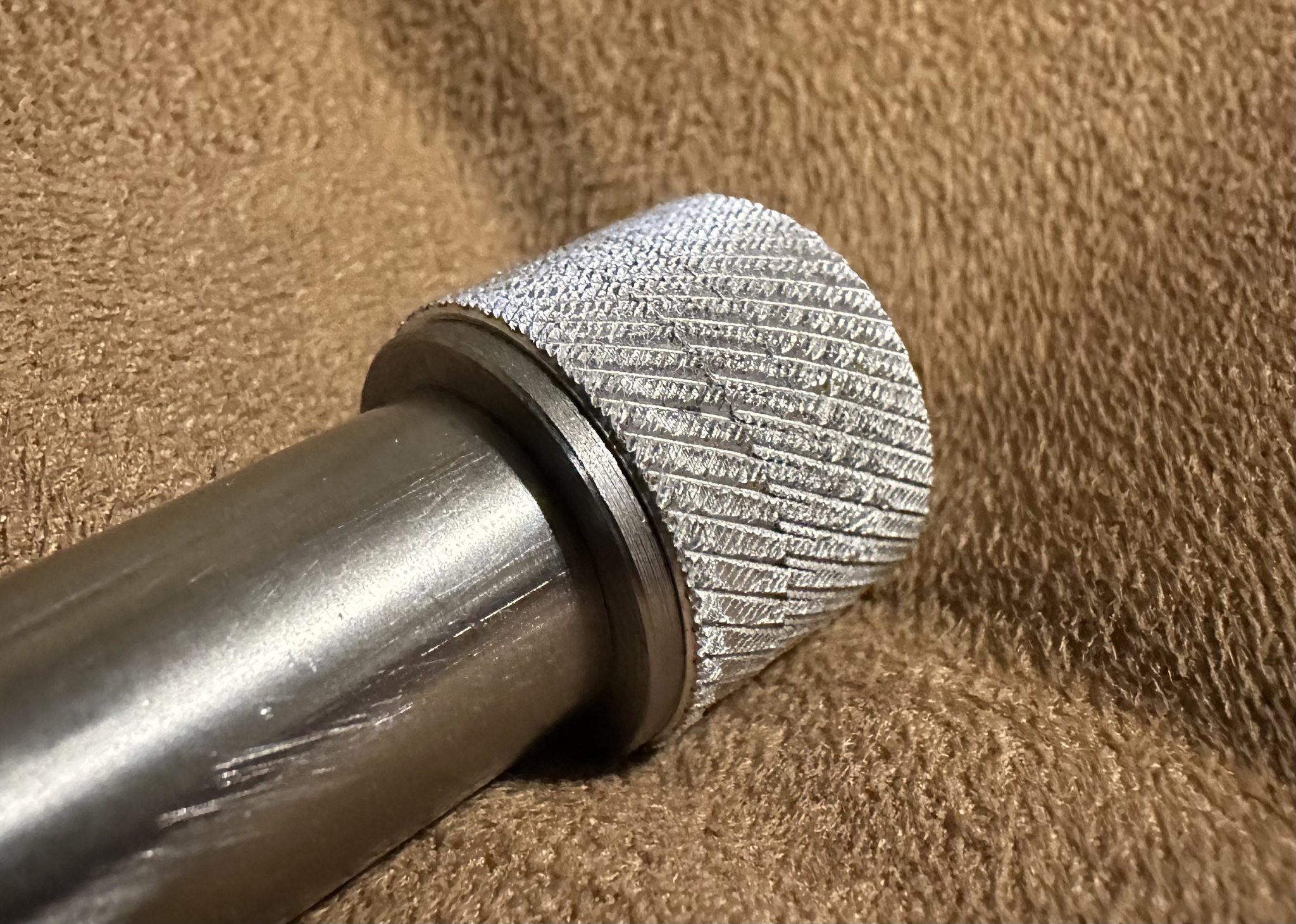

If the barrels are not thick enough at the muzzle to get a proper shoulder for 9/16 threads (ie 0.662" before cutting), then I recommend getting the CB mount with a face mounted brake.
If this photo is representative of reality,
their threads do not have a proper undercut.

Have your smith thread them just small enough to get enough shoulder to properly attach a custom made adapter, then permanently attach the shouldered 5/8-24 adapter to the barrel and once it cures, thread the adapter bore-centric so it's straight and true with the bore. Then you can run direct-thread or a QD mount. I had to do that with 2 thin pencil barreled Ruger M77 MKII rifles from the 90's.
