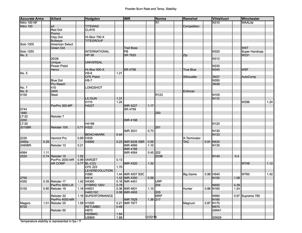

I saw this on accurate shooter forum today: The number next to some of the powders is the change in fps for every 1 degree. IDK how accurate these numbers are or what range they are accurate for.
Reactions: fat7hogs
Range? I would hope at the muzzle! I know what you mean though really ;)
Hmm, not too sure there. I have much different numbers than this - unfortunately not compiled in an acceptable format for posting. Then again, even lot-to-lot of the same powder can vary also.
Yeah I’d say .77 fps for every degree with Ar Comp is totally wrong. Without looking at what I have, I’d say Ar comp would be around .10. Varget and H4895 would be double those numbers. Xbr is higher too.
Yeah I wouldn't trust this. Not like it's dangerous load data - just not accurate. Experiment away!
I use 1.1 FPS per 1 degree F for Varget.
0.7 FPS per 1 degree F for H1000.
This is just the stuff that I remember off the top of my head (no access to my data at the moment).
