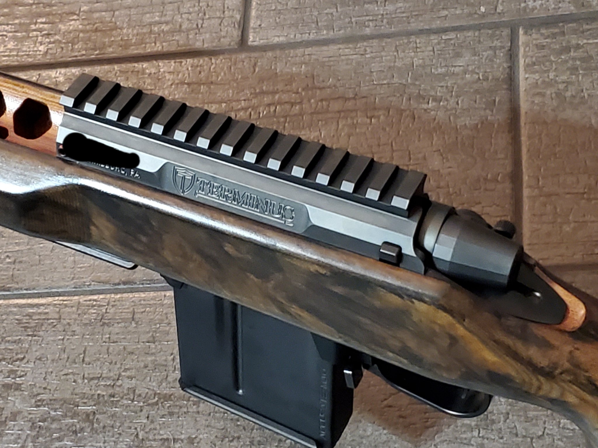

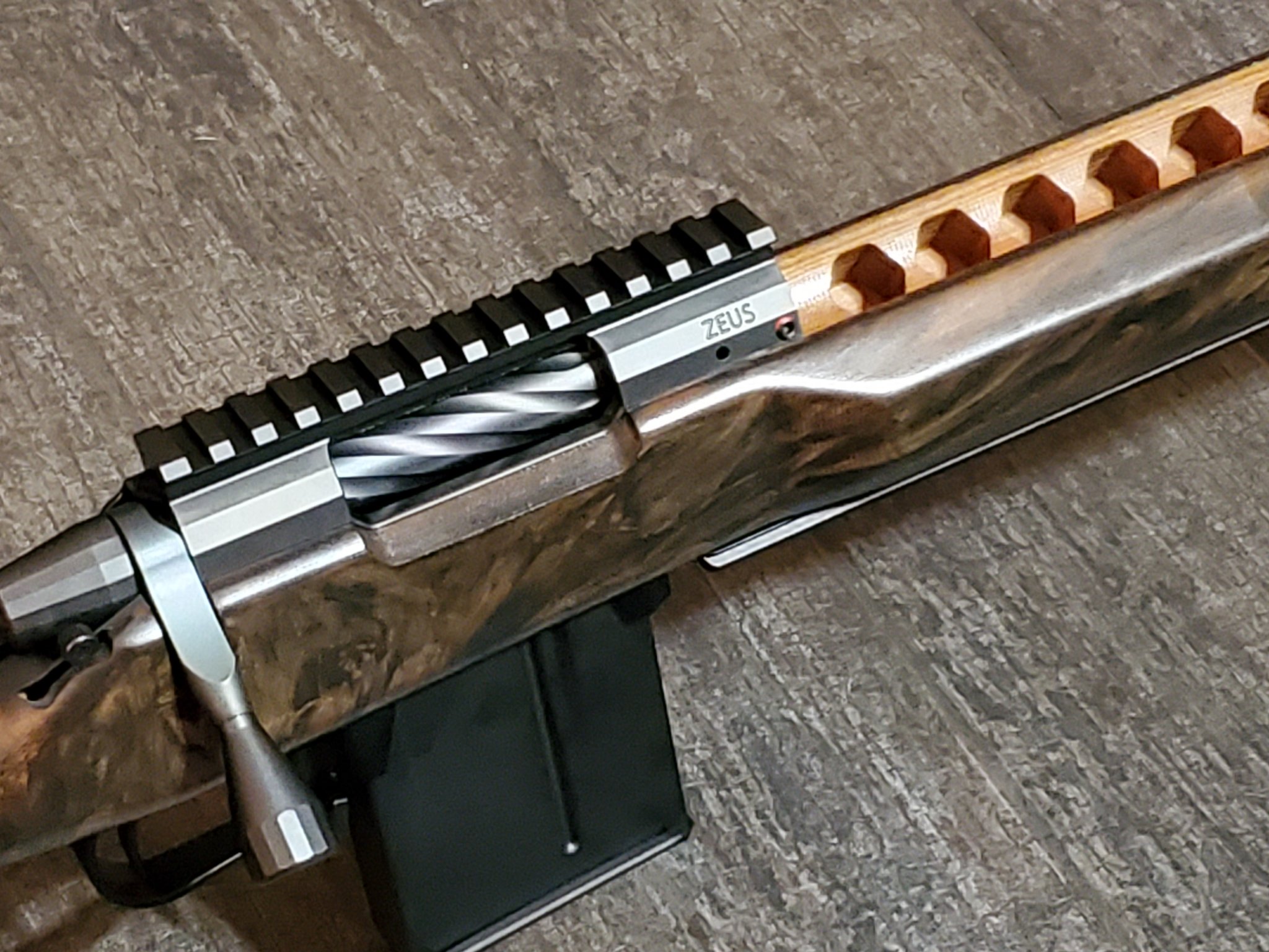

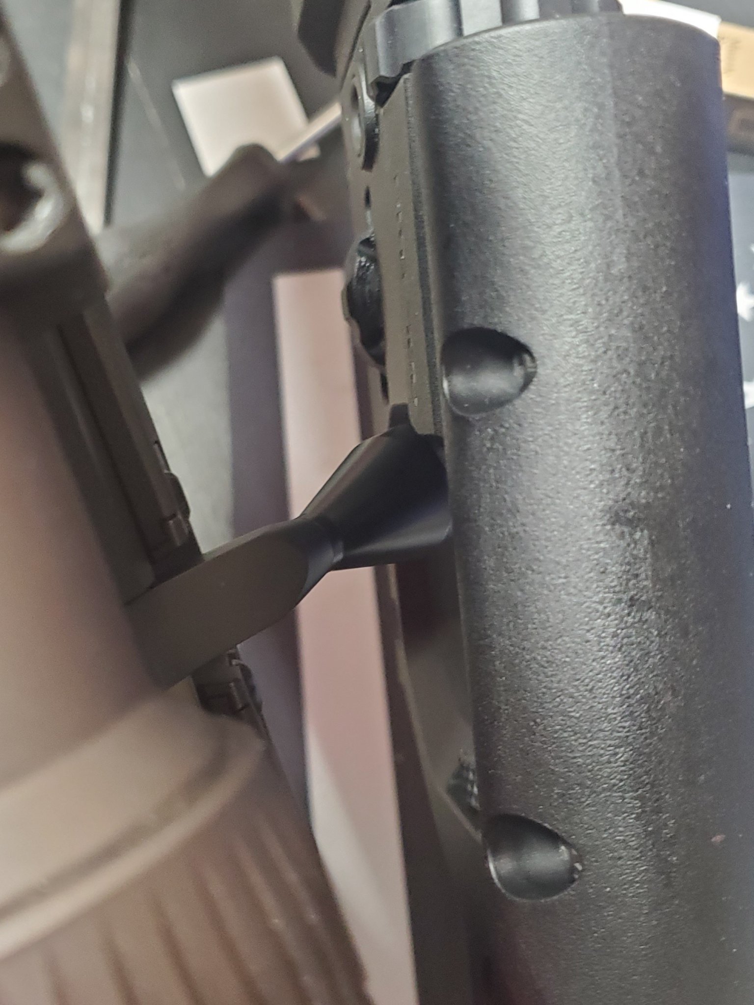

Some of the issue is that the Zeus bolt is straight rather than swept. I threw a Defiance action in and it fits as it should. I bought the chassis because it does a bolt side folding. If either of the alternatives to the factory bolt were slightly narrower it may work. I originally was looking at the ball knob anyway to mimic the AI bolt knobs (sort of). I'm looking for a measurement on the ball one from the seam (were it meets the bolt lever/arm) to the bottom of the ball and the max width. Same for the hour glass one. TY I appreciate it!!

Has anyone replaced their bolt knob with either the round or hour glass knob? Turns out that the magpul pro 700 chassis won't fold over the original bolt. Was hoping that one of the two may allow it. Looking for dimensions. I like the action too much to use a different action, and I like the chassis too much to use a different stock/chassis.

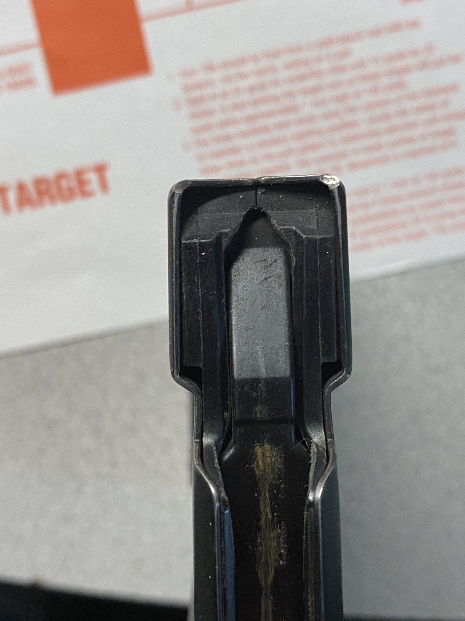

The issue of the top round being skipped over by the bolt is caused by one of two conditions. First is the magazine latch being too short which allows the magazine to sit just below the height where the bottom of the bolt head (either 5 o'clock or 7 o'clock position depending whether the round is feeding from the right or left), or the top round presenting (angled) in a nose high - case head low attitude so that the case rim slightly below bolt head and it skips over the round.
If it's the mag latch being too short, you'll need to find or fabricate a longer mag latch. (KRG and MPA both sell an extended mag latch/catch specifically for this purpose). If it's the cartridge presenting case head low-nose high, it can be corrected by removing the follower and spring, and slightly bending the spring where it is riveted to the follower so that it applies more pressure to the rear of the follower. Let me know when you start checking - I can post photos that might help.

I spent a long time working with AW mags. I got 308 to run successfully with 400 rounds straight without problems. I got 6GT to run in them with a lot of tweaking and it was only about 80-90% successful. Every once in a while the round would catch and not go straight into the chamber.

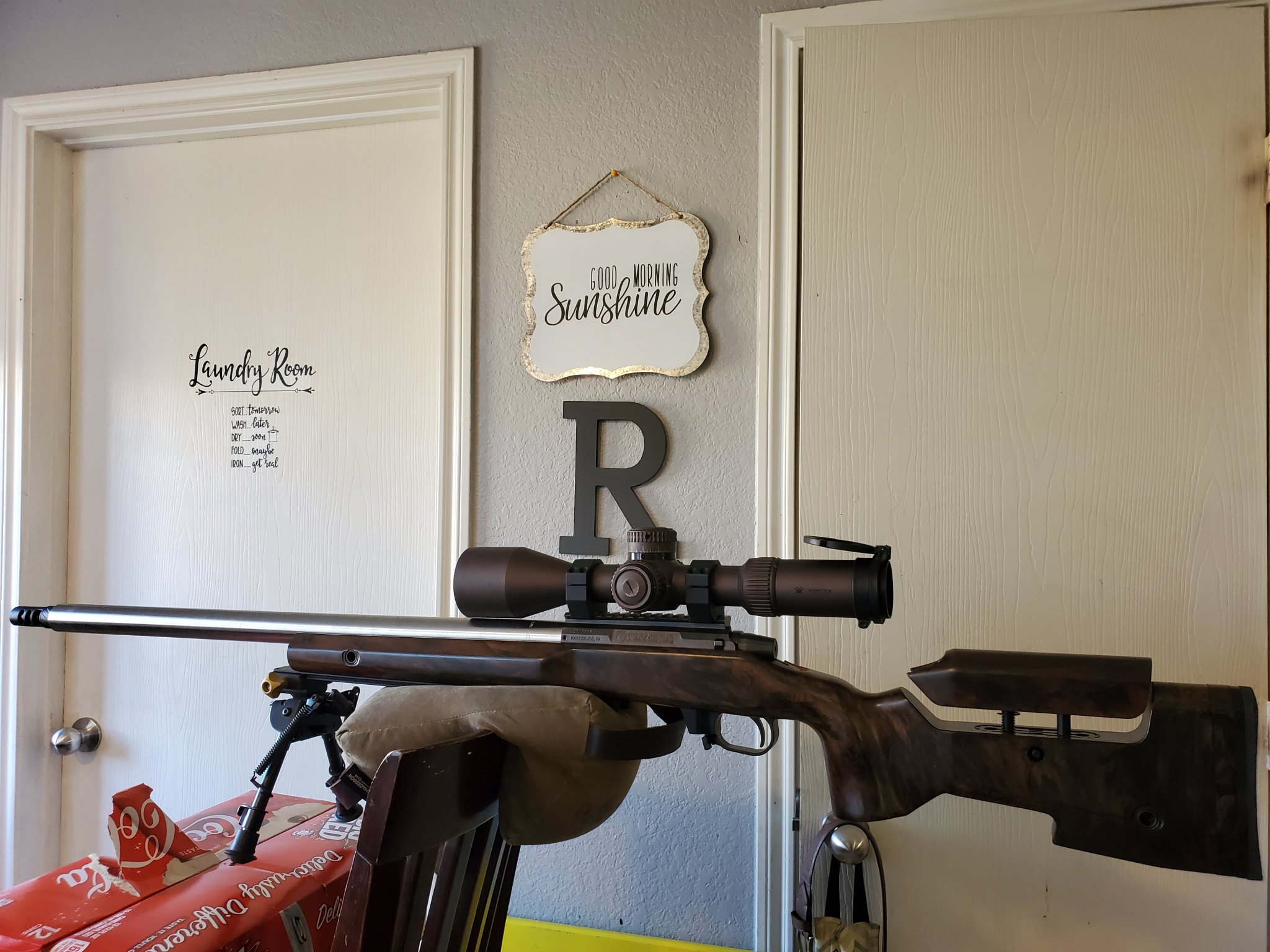

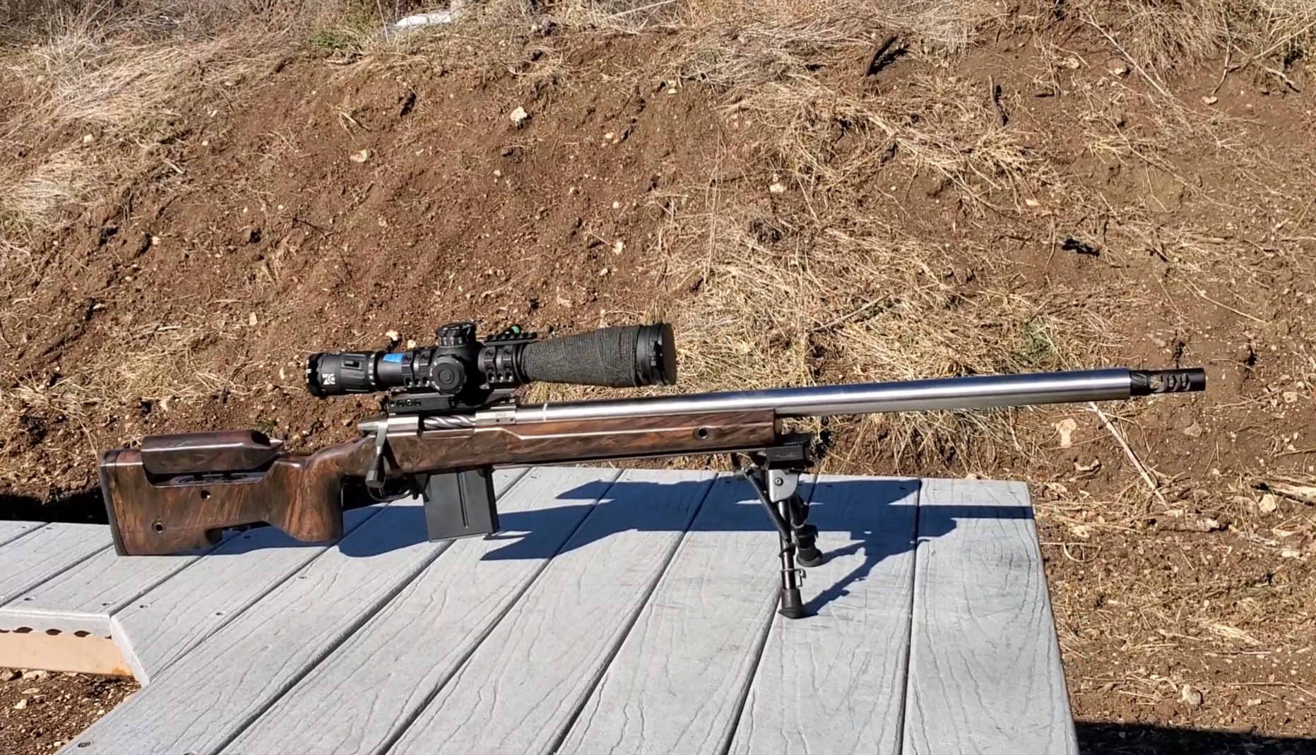

Finally shot the Terminus today...it was everything I hoped for. Took 6 rounds to establish zero. First group was the 3 shots in the pic. Had it out to 1k and it was good to go. Put 100 rounds through it today and will shoot the local match tomorrow with it after gathering dope.
The ZCO, Foundation and SPR chambered bartlein were awesome. I was also really impressed with the Hornady match 6 Creedmoor. It hammers in every gun I put it through as a side note.
Wind was 1.0 to 1.8 mils at 1k today so there was horizontal inconsistencies but elevation was solid.
