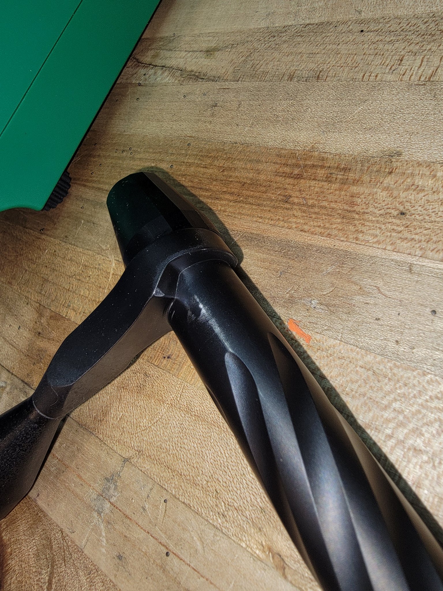

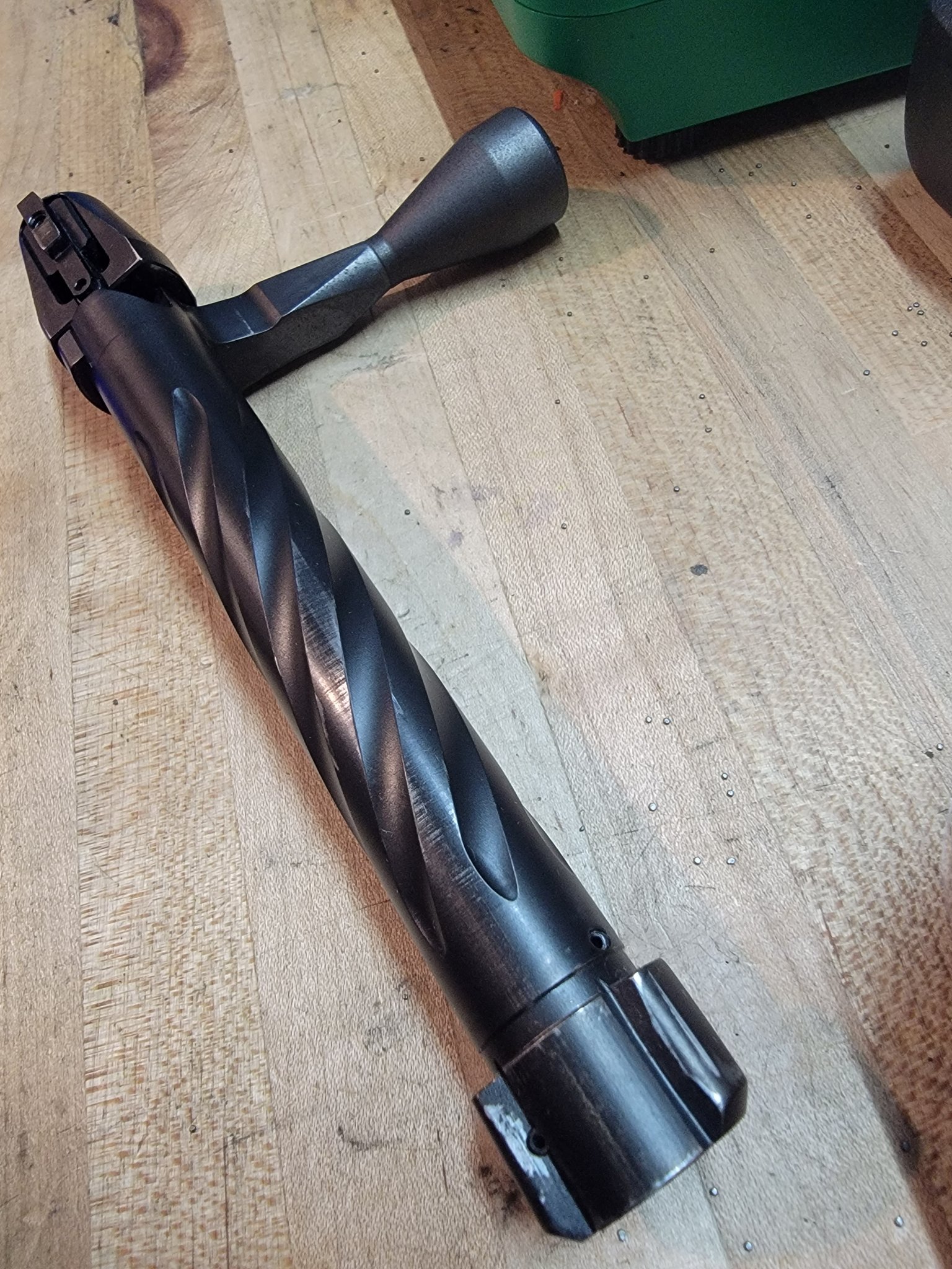

What are the bolt shroud, bolt handle, and cocking piece made of? My guess is the bolt and action were DLC treated in different batches. And that is why there is a discrepancy. But sure... maybe it's because of the different materials? But looking at photos of other actions, I don't see the same thing.
Off the top of my head I can’t remember but they could be aluminum
Well they are all the same deep black color. So if the underlying metal type matters...

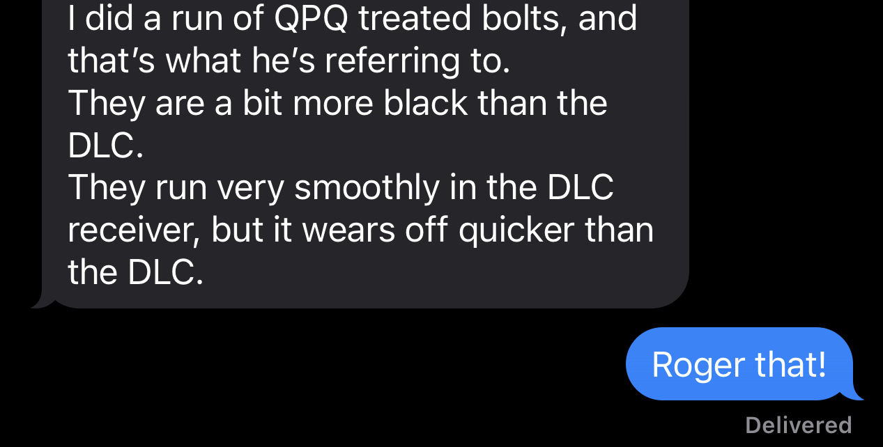

Turns out @Pat McGroin was correct. I text Joel for you

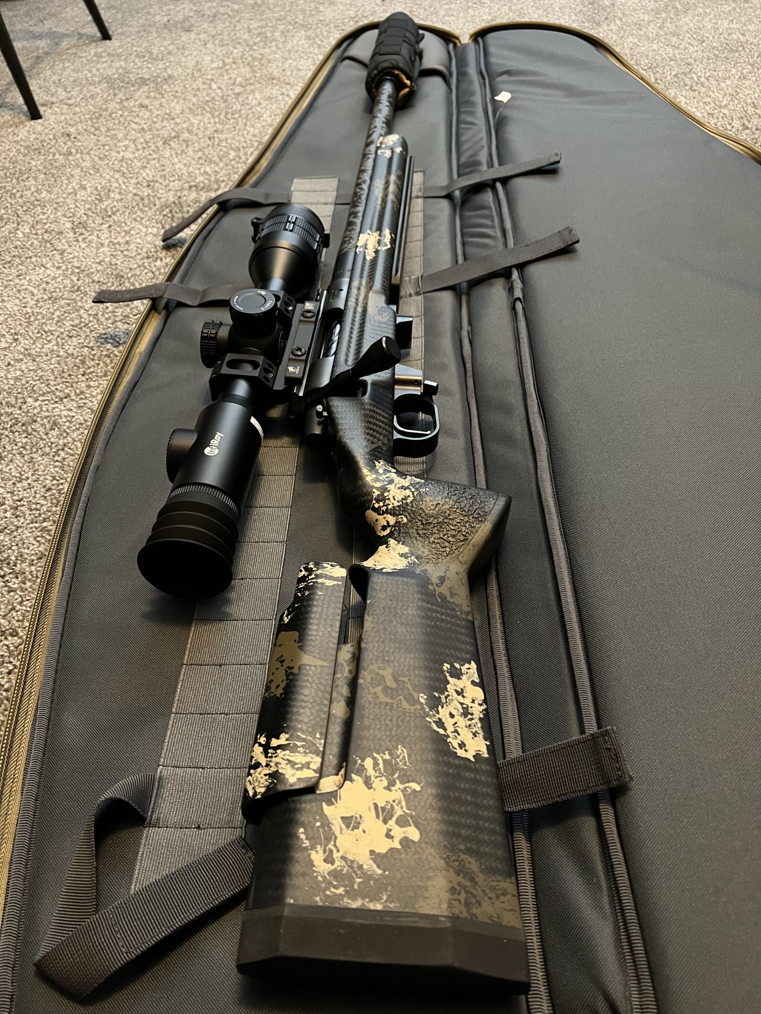

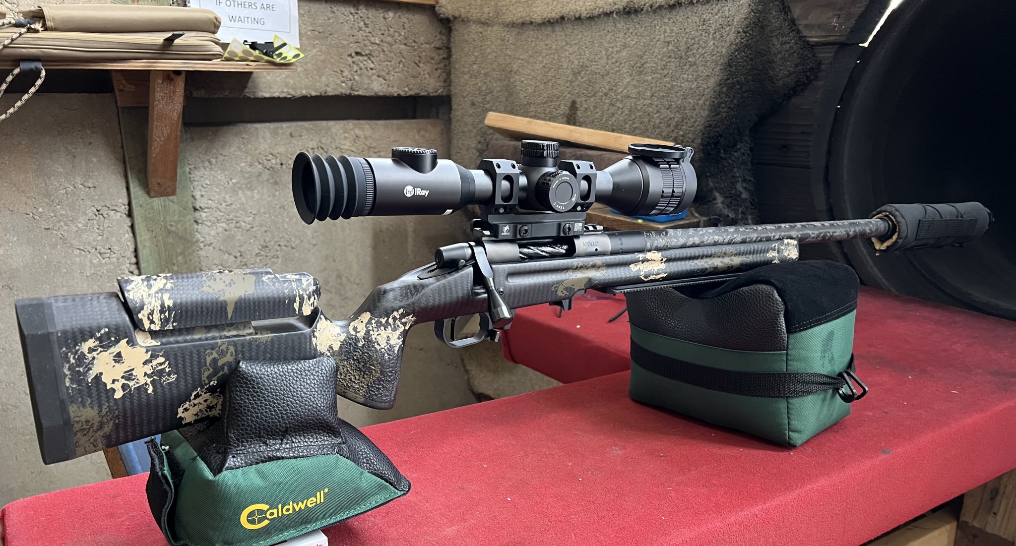

Finally got my Zues QC put together in 6.5 CM. Took 20 rounds of Hornady 140 gr Eld-m and 20 rounds of Federal 140 BTHP to the range to break it and me in. Probably not smart to adjust and feel out a new chassis at the same time as a new barrel, action, bipod, trigger...etc, but oh well. I wanted to get things fleshed out before starting load development and see what the bore looked like for cleaning after 40 rounds.

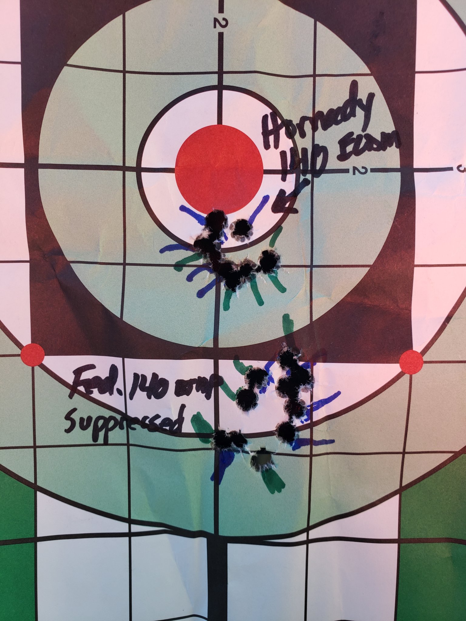

After 20 rounds, it and me were finally adjusted and settled, so I tried an experiment since this IS a QC action. I shot 5 rounds of each, then loosened the QC screws, broke the barrel free (just half a turn), snapped it back on, torqued the QC screws, and shot 5 more. NO POI SHIFT! Action is bedded in a MDT ACC with Marine-Tex. I did not remove the action from the chassis when i broke the barrel free.
And no noticeable copper fouling. Barrel is a 26" Bartlein LH gain twist 8.25-7.5. Chambered by Bugholes.

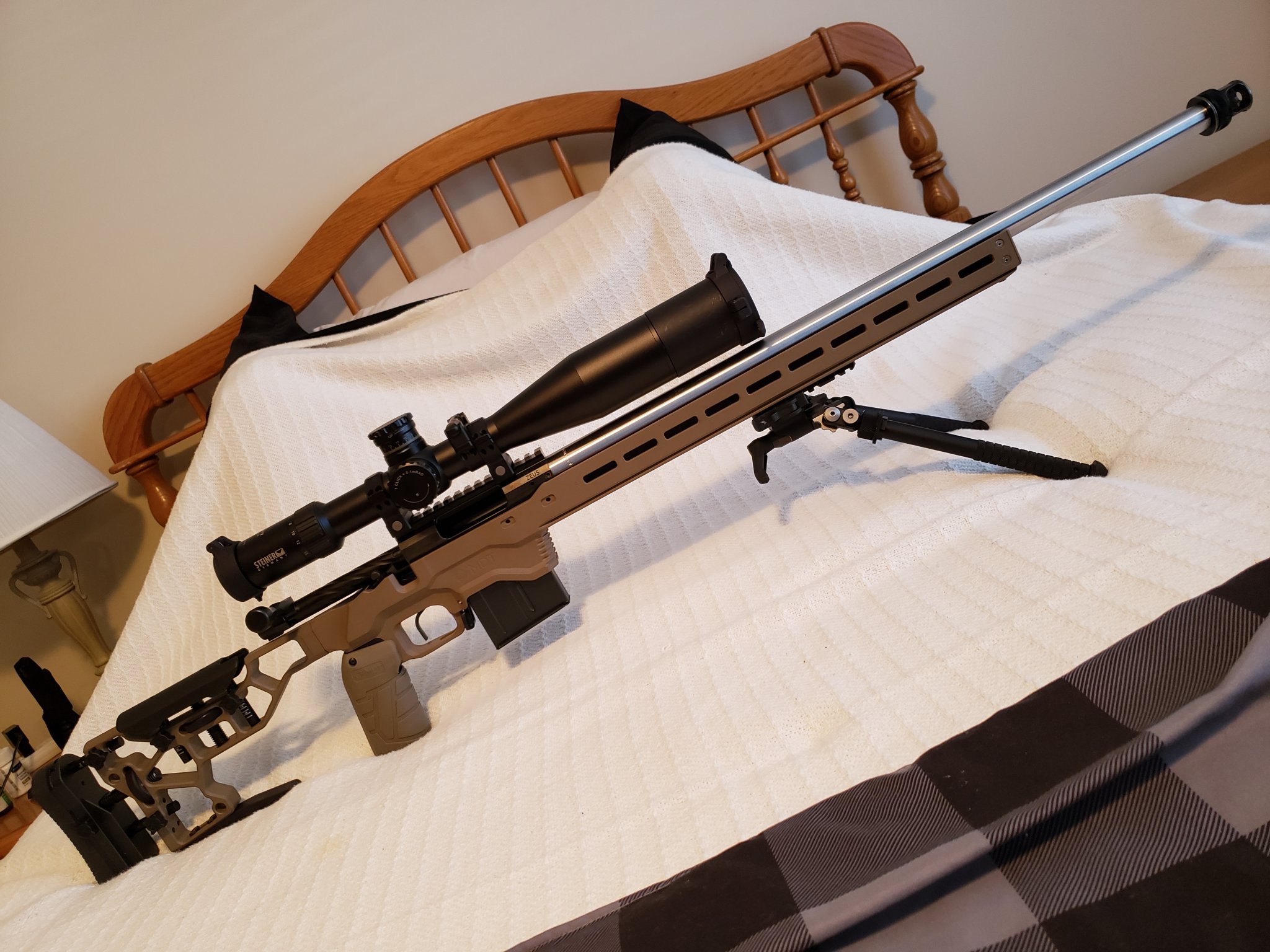

As promised... Pic of current set up.

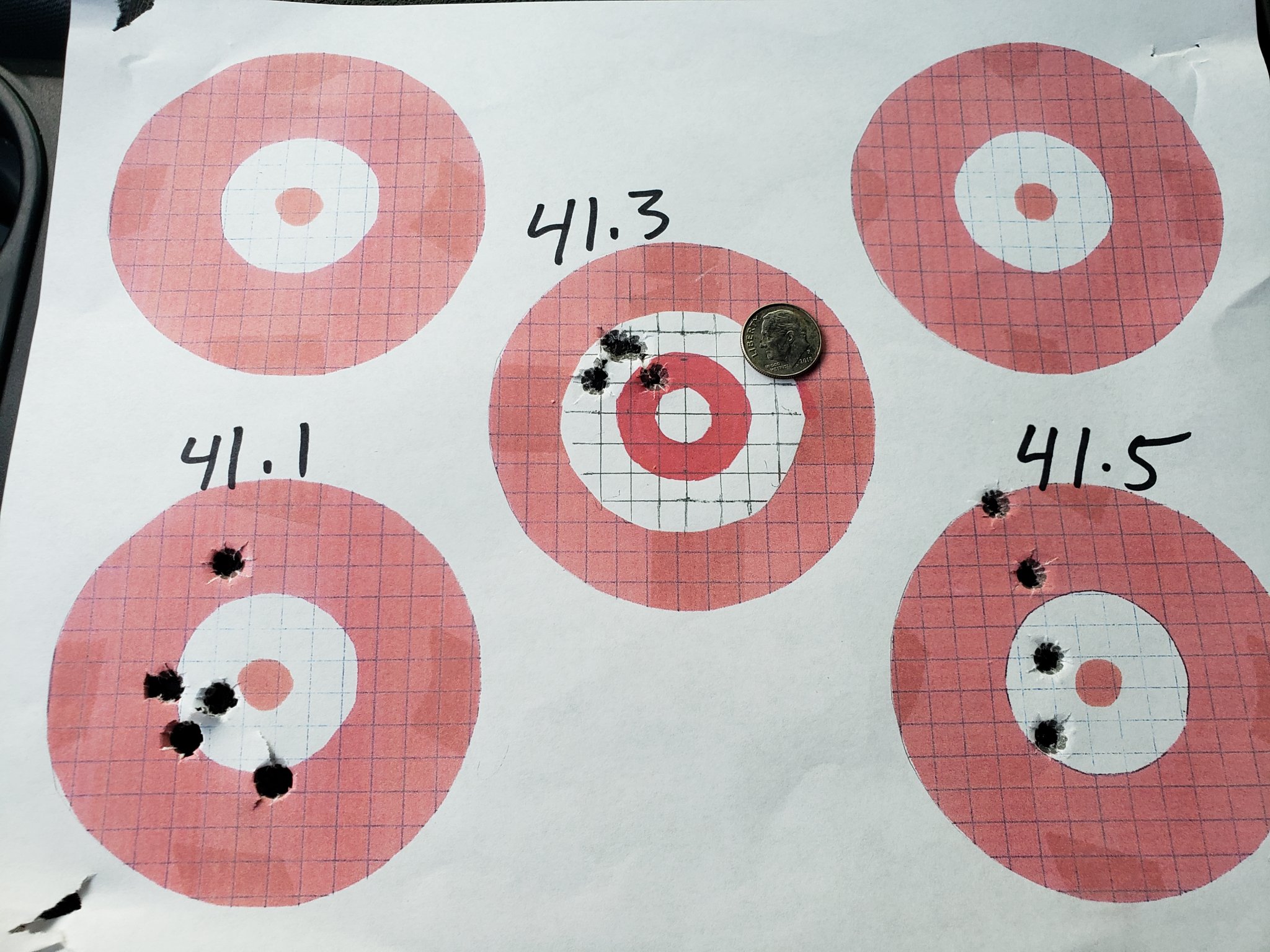

Pic of Federal and Hornady 5 round groups on same target after resetting barrel.
Pic of settled upon load. 5 rounds @200 yards.

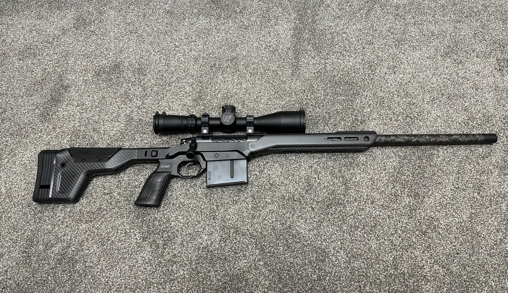

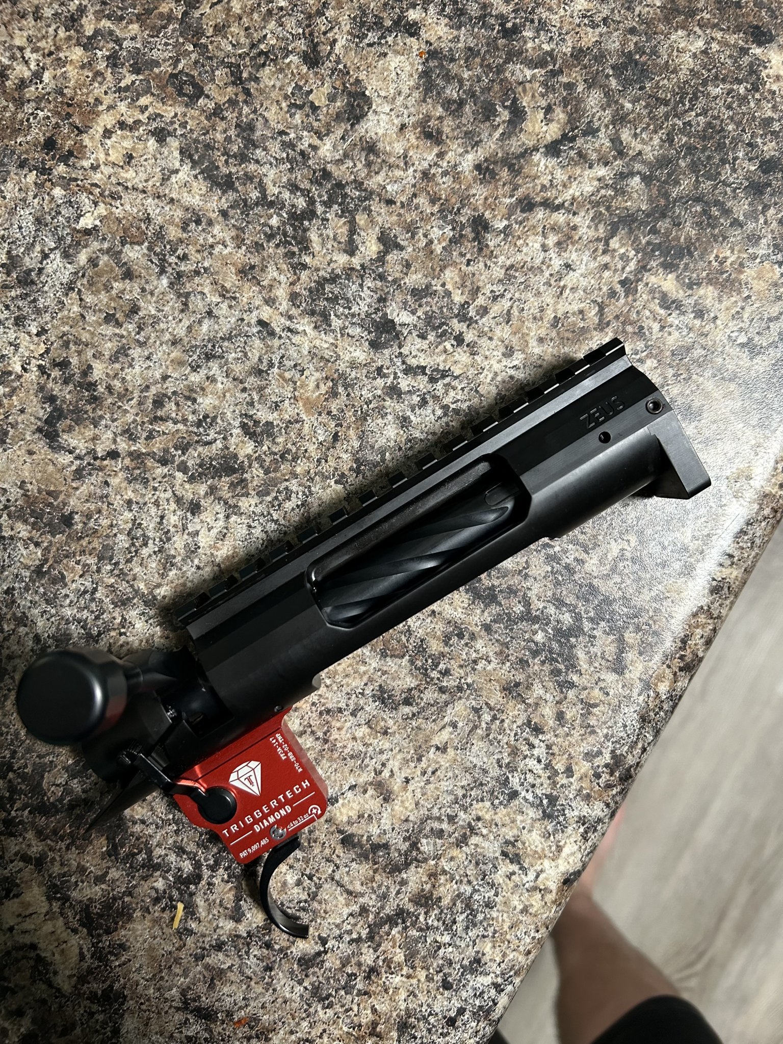

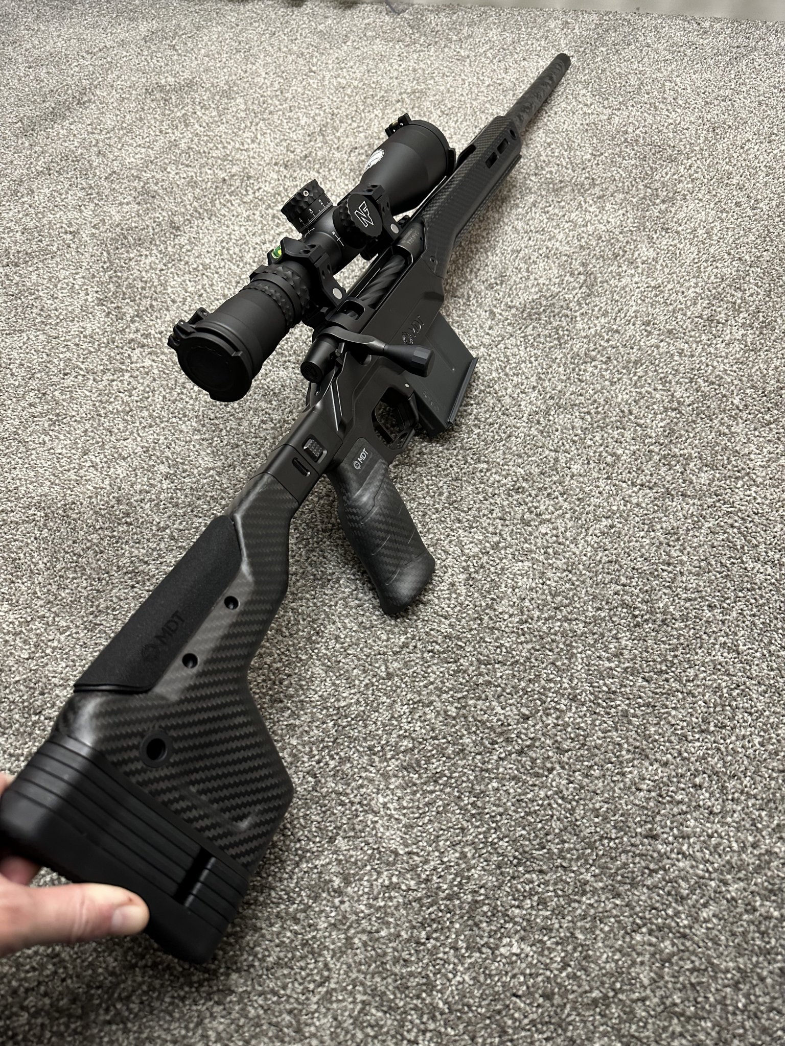

Finally got everything to finish setting up my Kratos Lite
Proof 22” 1:8 done by bugholes in 7 PRC
MDT HNT 26
Nightforce NX8 4-32x50
Triggertech Diamond Flat
Hawkins Ultralight Rings
MDT mag
Waiting on Dead Air Nomad-Ti

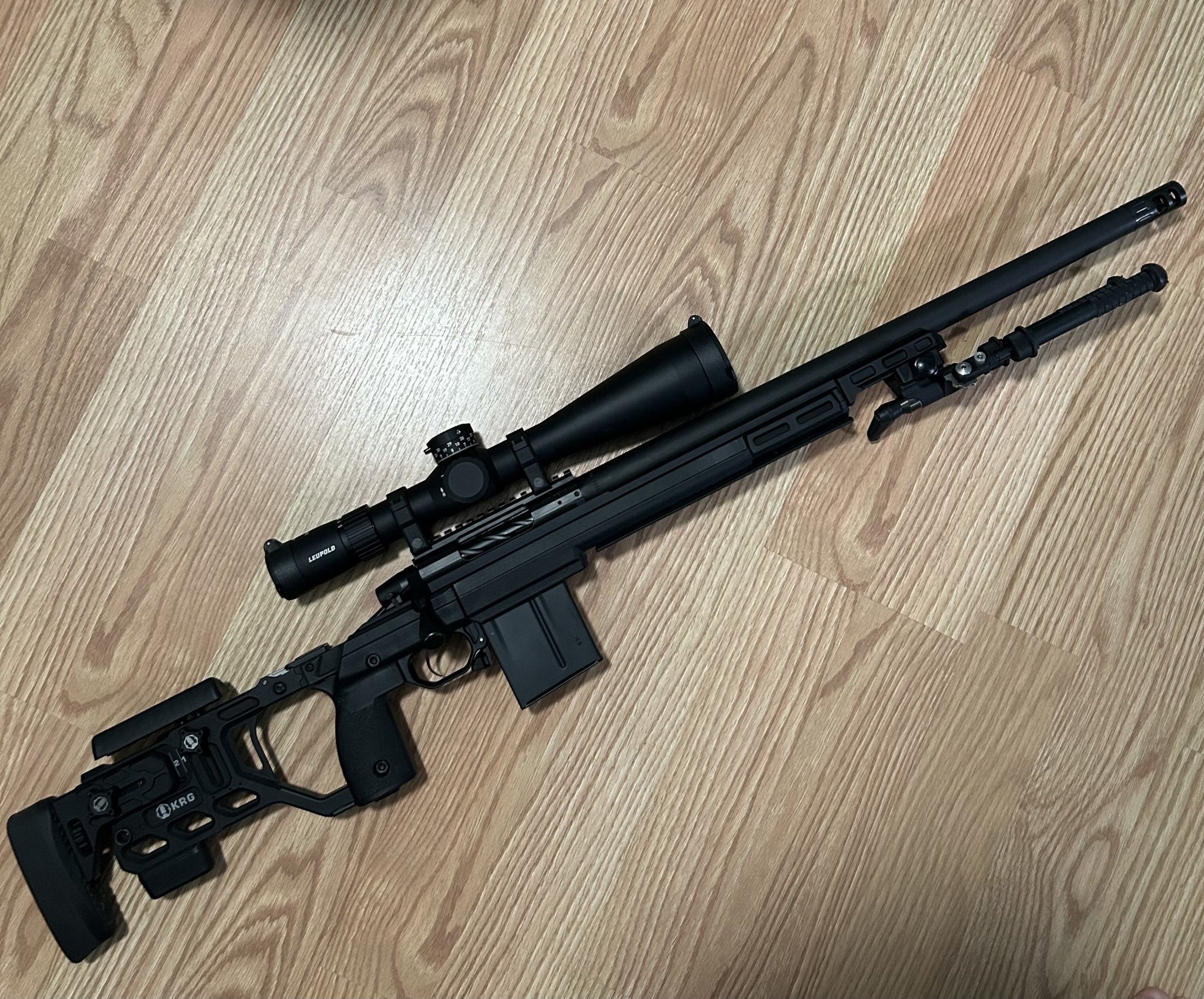

I just finished an identical rifle only difference being a Zeus SA QC, Vortex LHT scope and 419 hellfire brakes. 24" 6.5PRC, 22" 6.5CM and 22" 6GT proof barrels.
It weighs 8.7 Lbs without a mag or bipod and with the 24" 6.5 PRC barrel.
If anyone is wondering, the HNT26 stock covers the quick change set screws on the SA Zeus QC. I'm probably going to machine a little notch or holes in the chassis to remedy this.

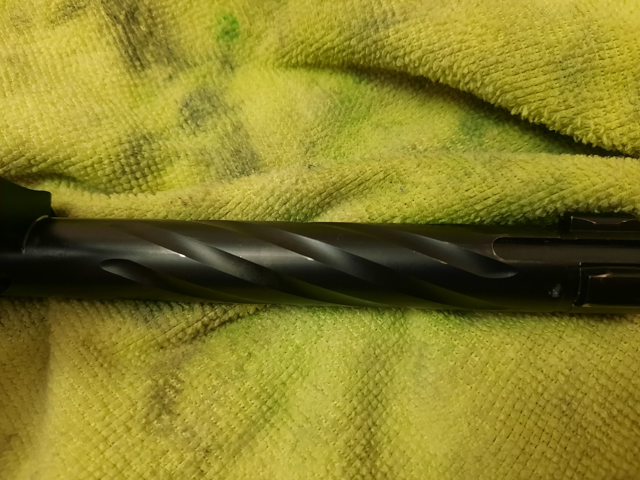

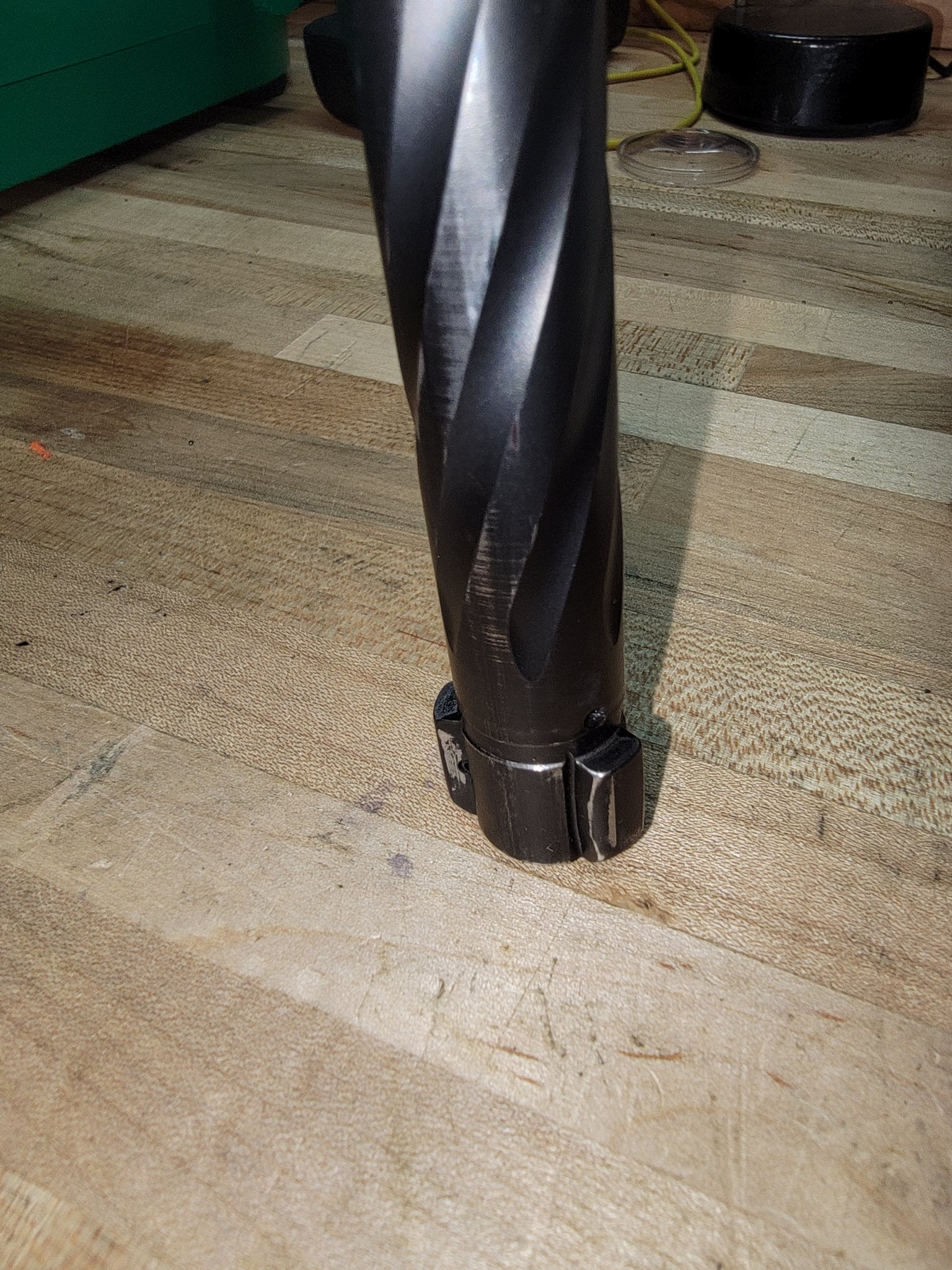

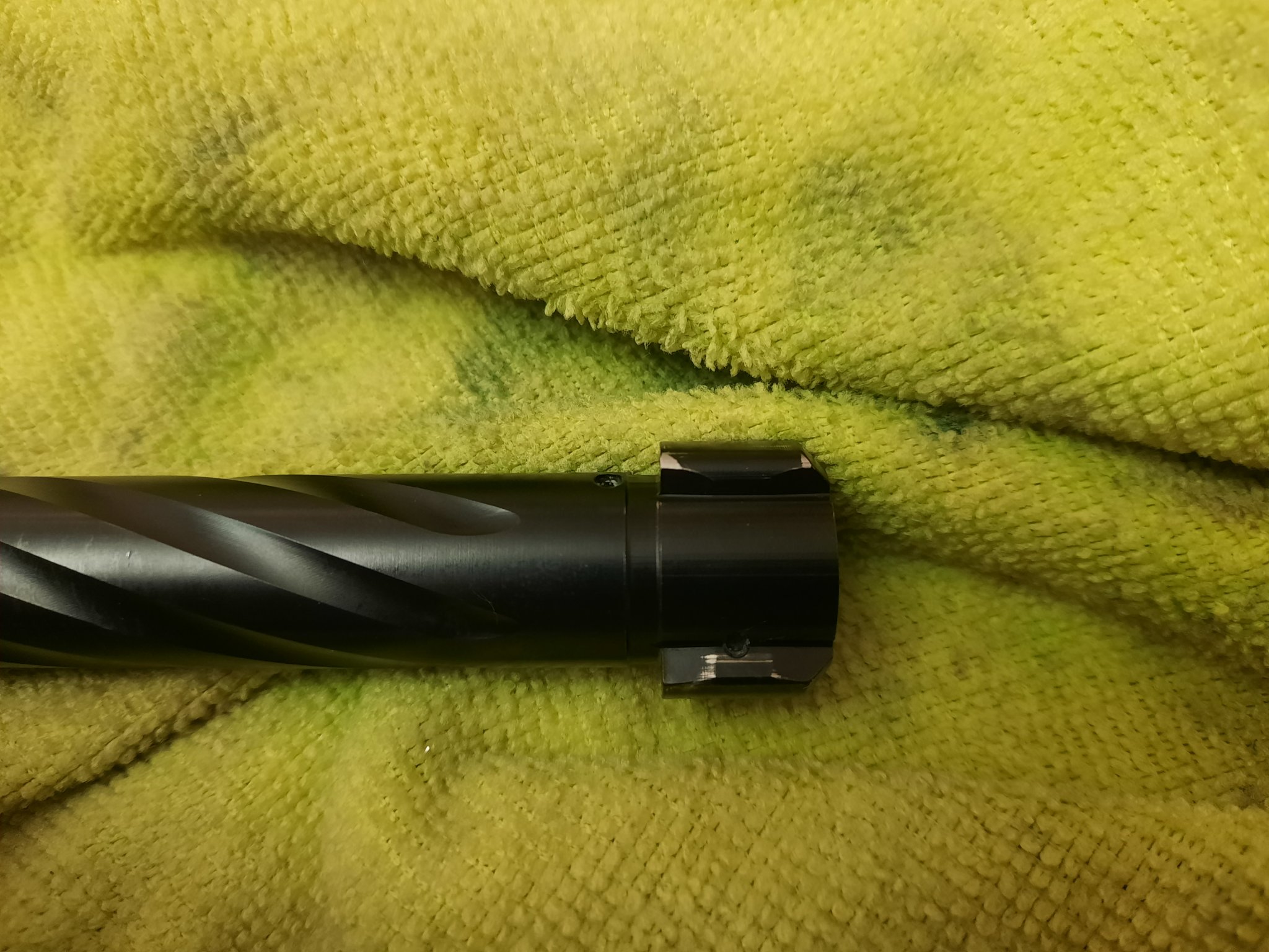

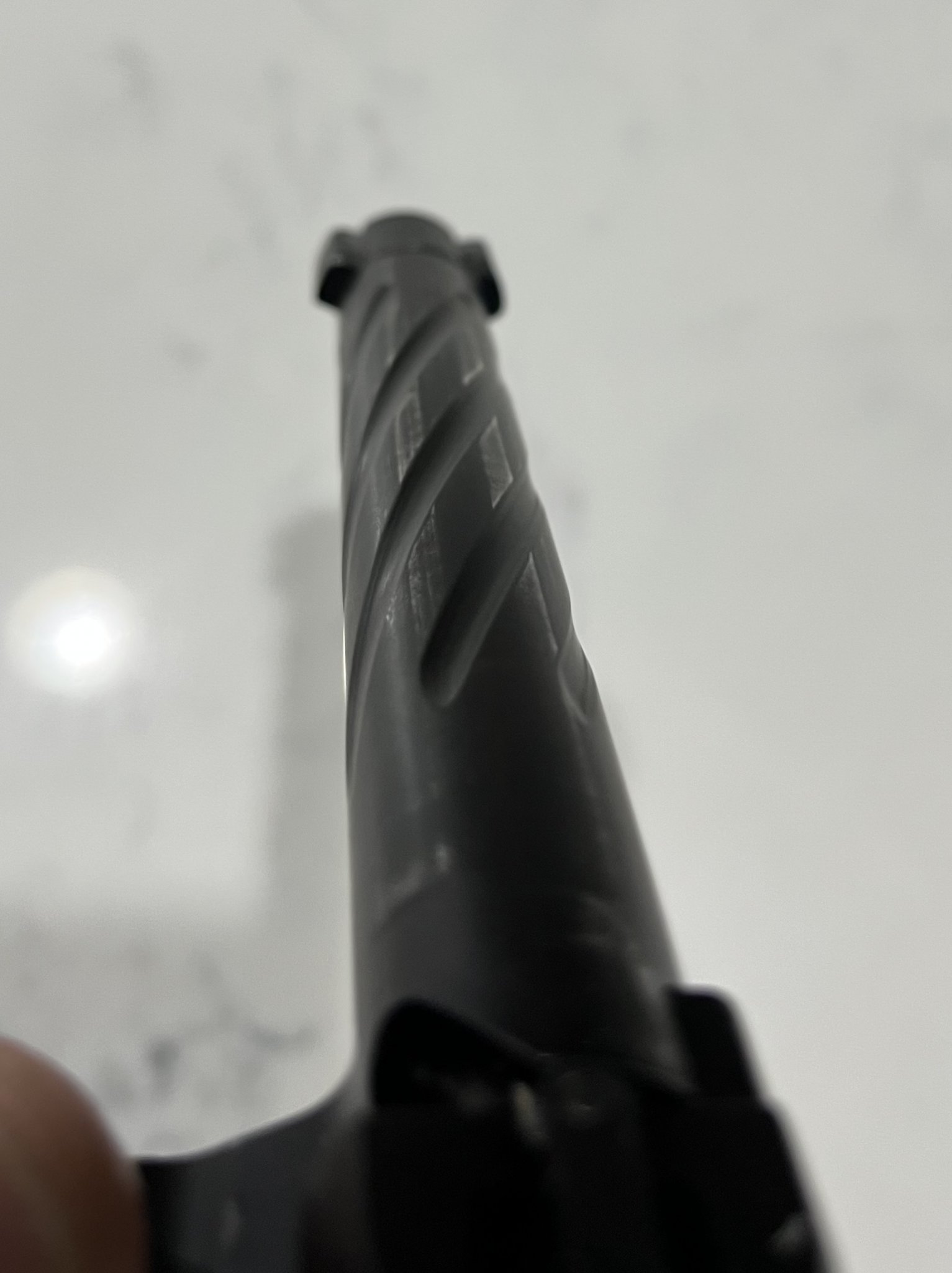

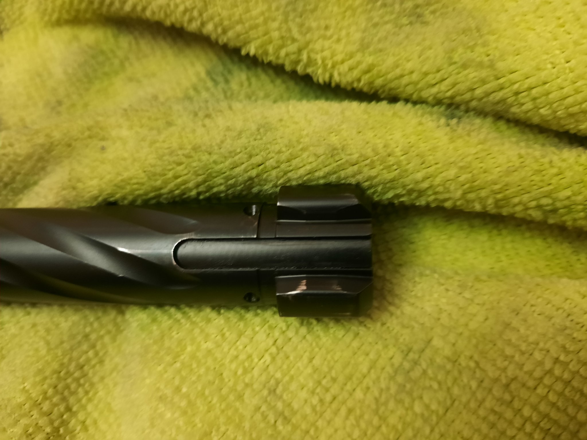

I got my action last year and have put less than 400 rounds through it. I have kept a light film of oil on the bolt body and some grease on the lugs. After I went shooting for the second time I noticed some wear on the body near the handle and a couple spots on the fluting as well as on the lugs. Is anyone else having wear like this on their bolt? Or is this just normal wear for a bolt.

I have about 50 rounds on mine and am showing a little more wear on the bolt body and maybe a little less on the lugs. My lugs aren't wearing in the corners like yours, but rather in the middle.
I assume it's somewhat normal as DLC coatings are pretty thin... I thought mine was wearing a little quickly however. I also keep. it lubed properly.

I have one lug that has wear in the center and the corners look fine. I keep a thin film of oil on it but I'm gonna give the BoreTech Qwik-Dri Lube a try to see if it helps slow the rate that the finish gets worn off.
It’s a little tricky to capture the wear - sometimes the lighting will make it look worse than it is and sometimes you can’t see it in the pic.

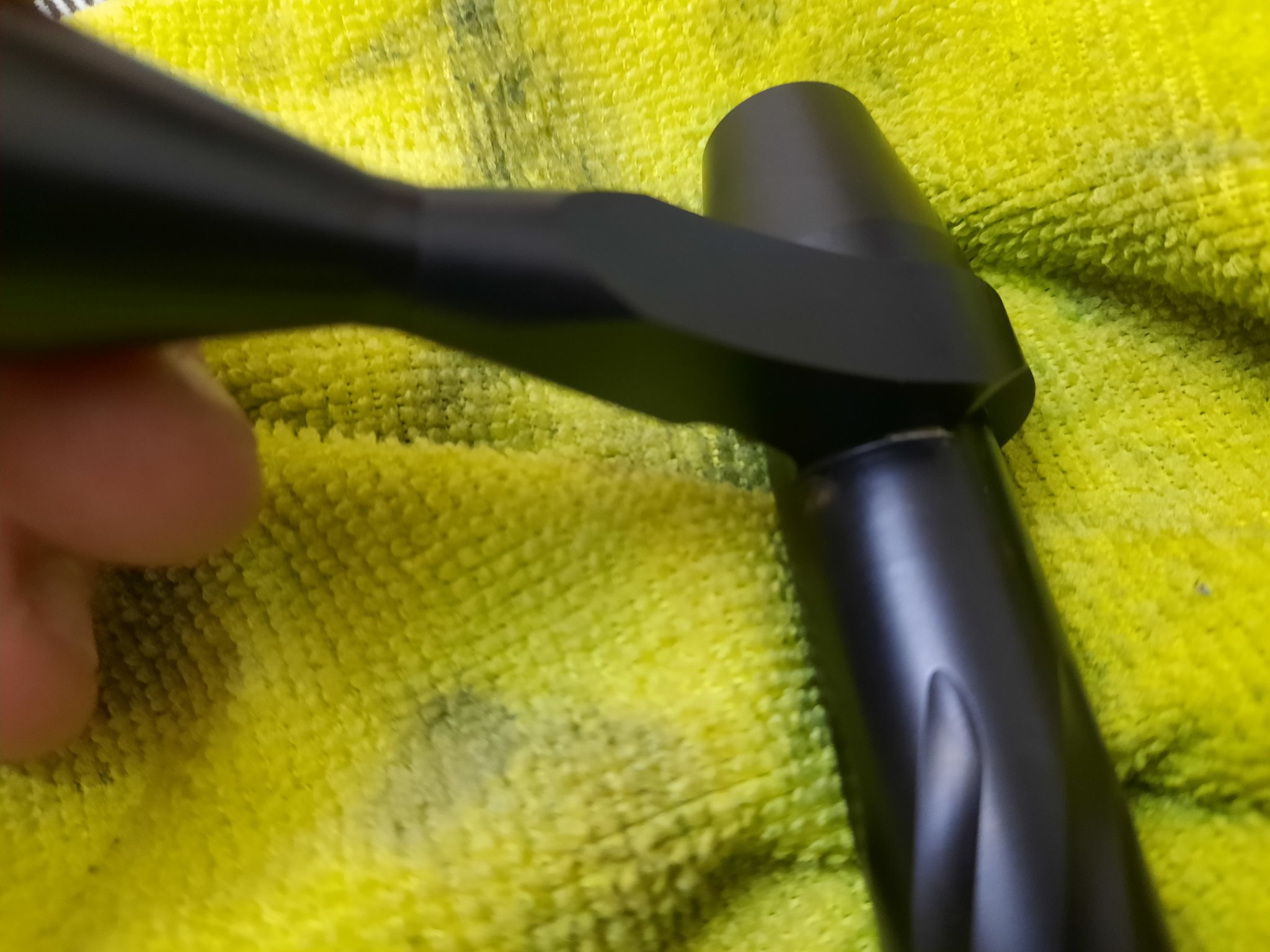

Here’s a shot of the underside of the bolt.

If your showing wear on DLC after 50 rounds I’d have the coater or oem take a look.

Without seeing the gun, it looks like the mag is sitting a little high and the lips of the mag are pushing/rubbing on the bottom of the bolt. Also likely means it has uneven pressure on it when being cycled and going into battery.
Keep the action and bolt clean and oiled, make sure nothing is rubbing when you move the bolt back and forth and close it with the magazine in. Only way to keep something brand new looking is not to use it.
In my experience, the bolt will show some wear initially, but will pretty much stop once those high surfaces have create clearance through use and friction. Here is one of my bolts that has probably 7-8k rounds on it. Some in pretty dirty and harsh conditions.

I would say that’s pretty normal, but consider yourself lucky. I got a bad batch of dlc (super easy on and has since been changed manufactures) and I have so much dlc gone!!!
Have done quite a few actions with both dlc black and fde. FDE wears faster, but both wear. Don't expect a miracle, it's a coating and will show wear.
Same goes for the nitride case hardening. However the nitride is smoother of the two..
