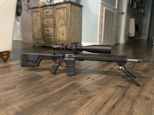

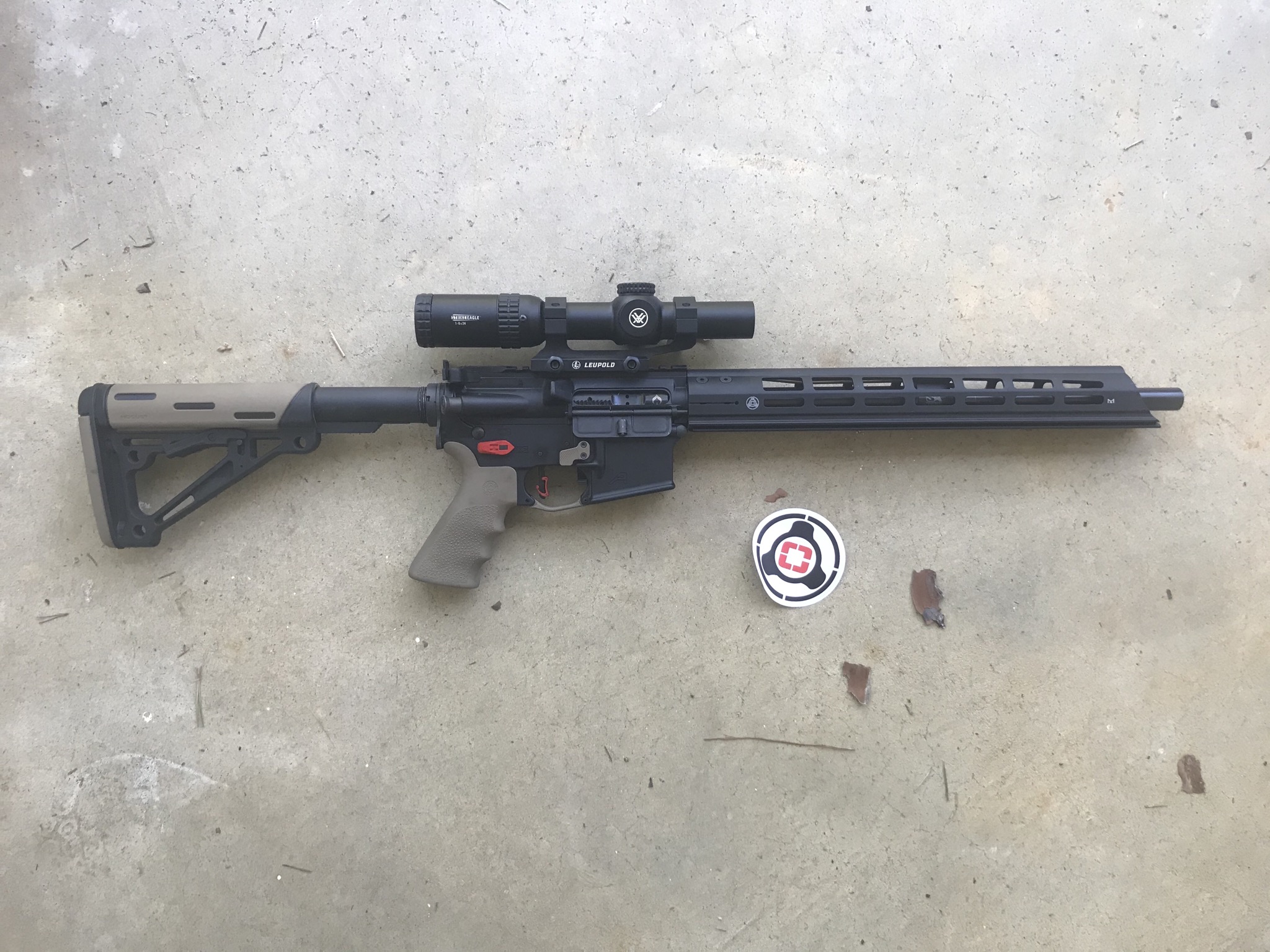

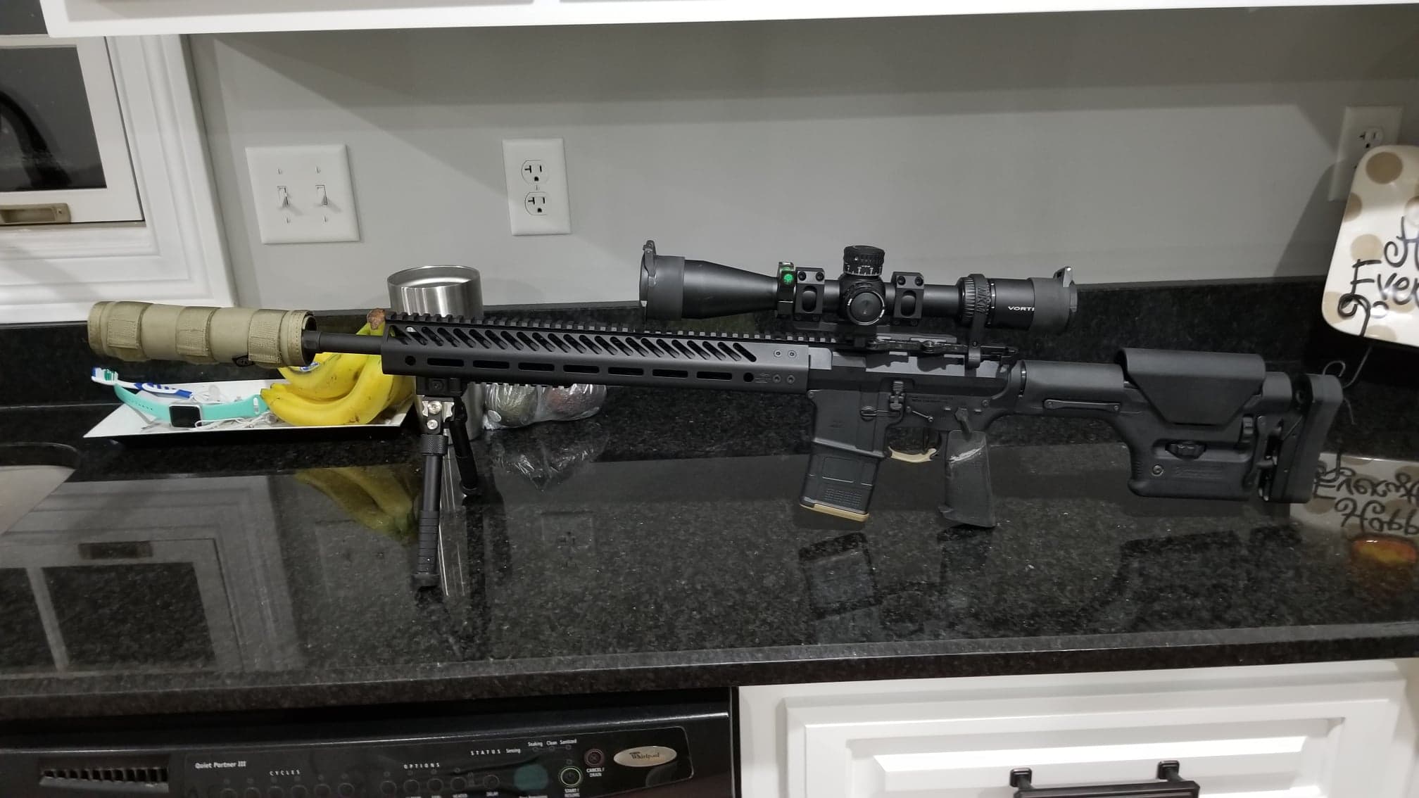

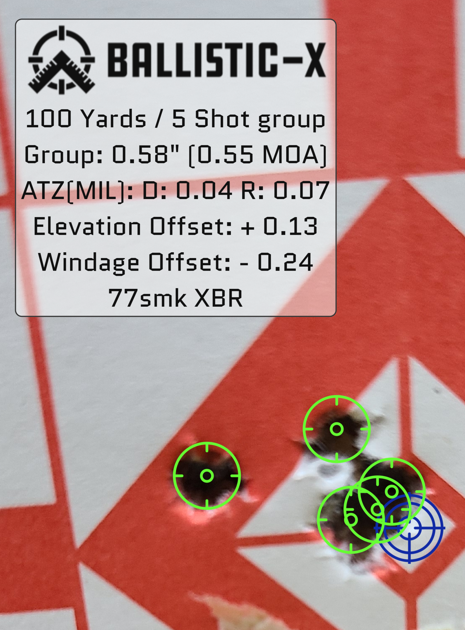

Just finished this guy up.
I'm not really fond of the Anderson lower, but it's all I could get my hands on.
Anderson lower
Aero upper
Ballistic Advantage 18" fluted ss premium 223 wylde
Stngr handguard
JP bcg
Seekins charging handle
Luth AR stock

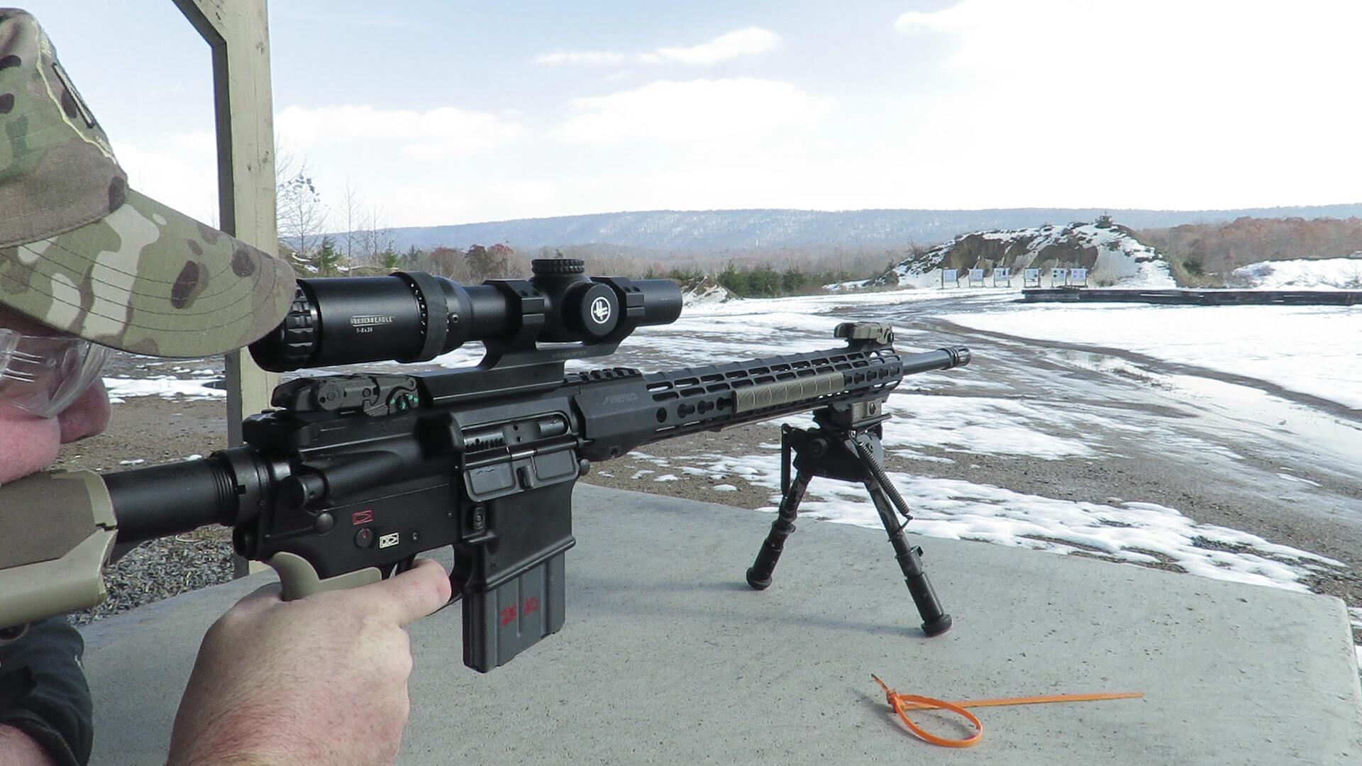

20" blaster I put together for an article a while back, maybe 2 years ago while I was checking out a Bergara 20" AR barrel. The receivers and handguard are from AeroPrecision, the BCG is a Brownells nitrided unit, and the LPK was a Stag Arms kit. It shot ok, I think with some more time to figure out what it liked it would've been a solid MOA gun. Slinging 55's it was dead on with the BDC out to 400.

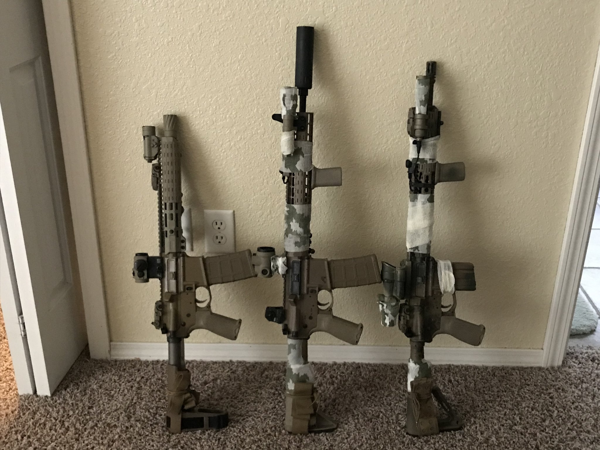

I've posted others on here I'm sure so I'll just do the ones I don't think were around then.

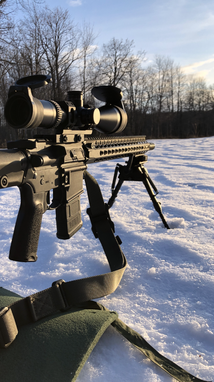

Most recent DMR AR build. Bedded Krieger bbl.'d, URX4, SSA/E, FMOS BCG, Saker can, Mk4 2.5-8x. This thing is amazingly accurate and soft shooting too with the mid length gas:

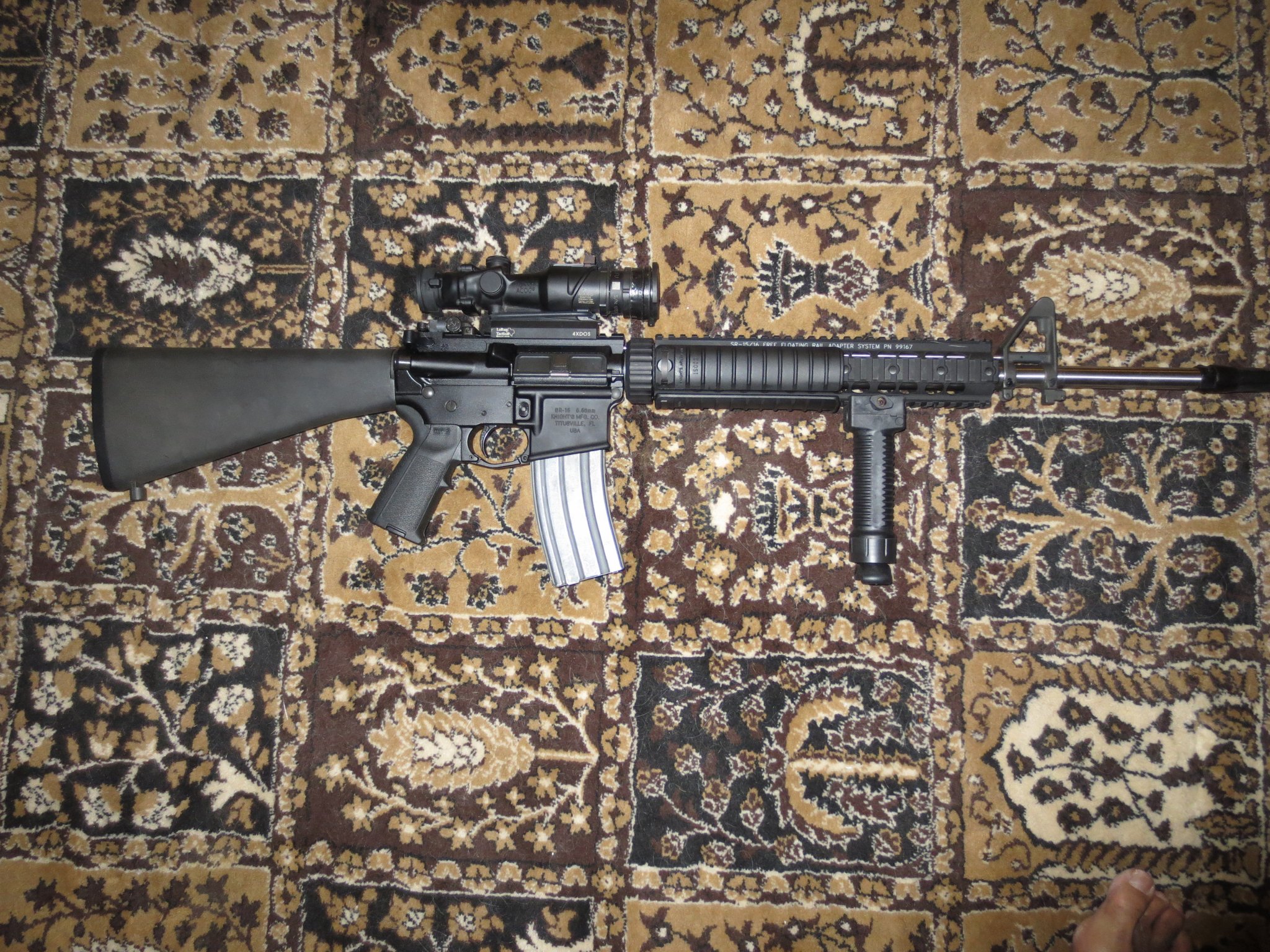

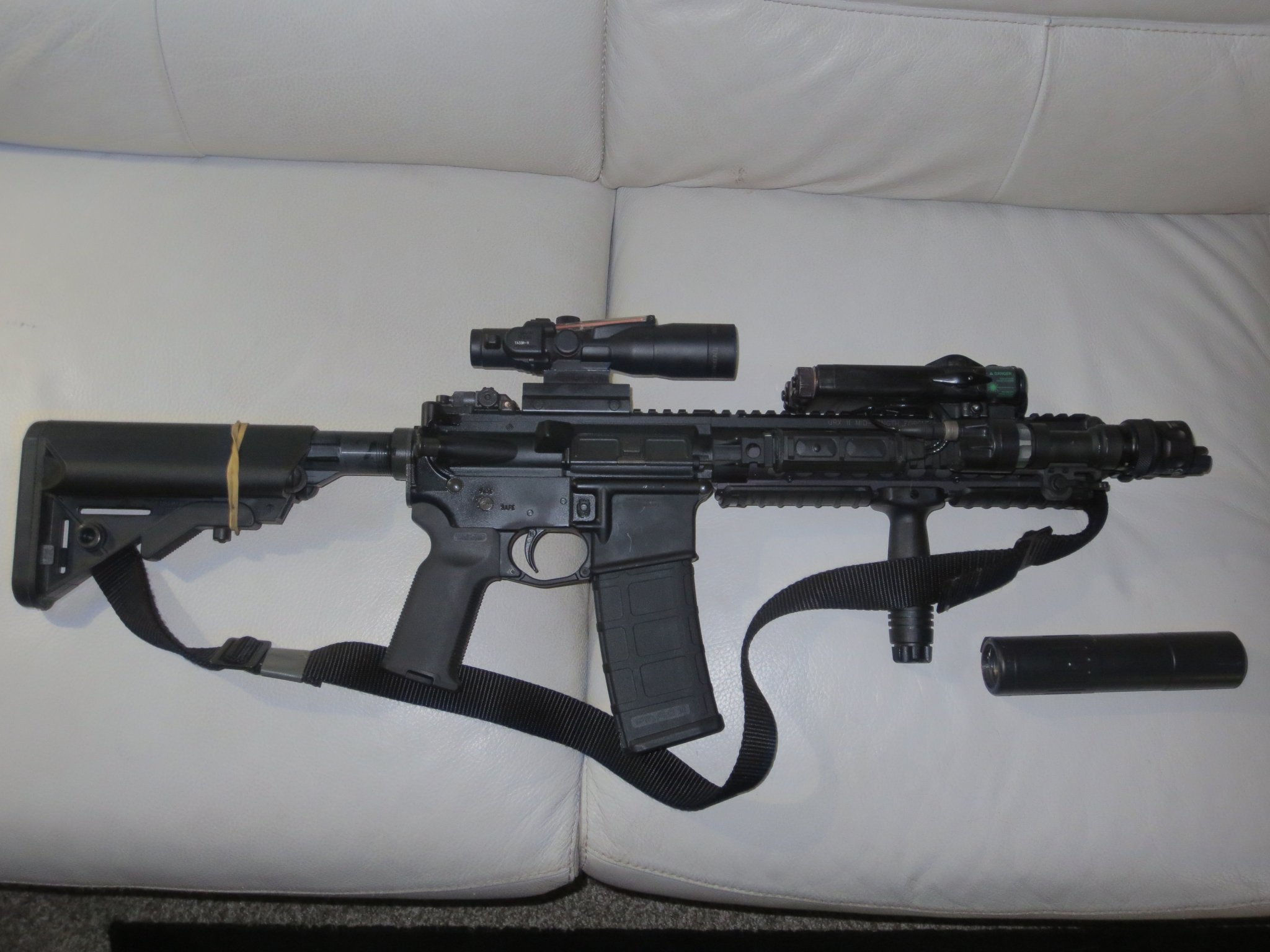

Had it awhile, just don't think I took pics. 11.5" Noveske bbl., URX2, Geissele single stage, FMOS BCG, AAC 556SD. A 1MOA SBR.

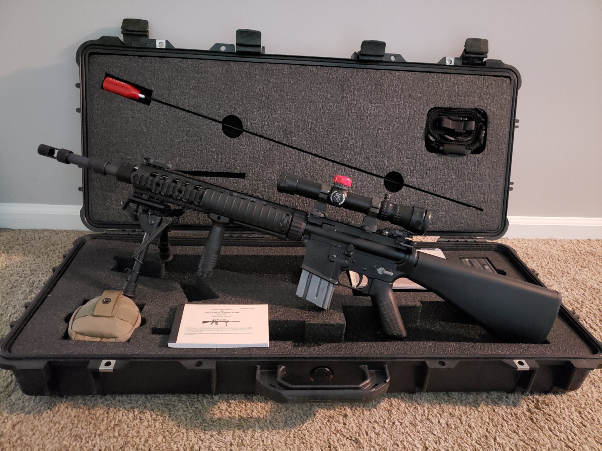

This one got given away to a member on here in more or less the same configuration. Well, we all pitched in parts and I donated the barrel and other parts and they bought the handguard. Turned out to be a fine shooter too and couldn't have gone to a better guy. Do good shit and karma will reward you with new rifles and parts (sometimes).

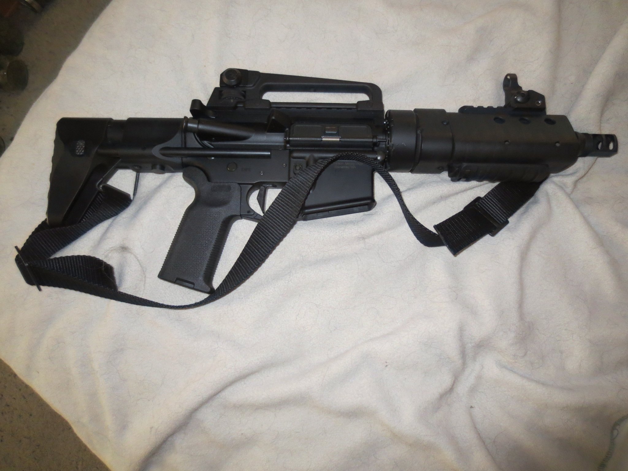

The simplicity of this one is the most attractive feature. At about 21" in .300BLK, it's a pretty damn fine PDW to have been created almost entirely out of extra parts laying around. Always goes bang, supers or subs, can or not.

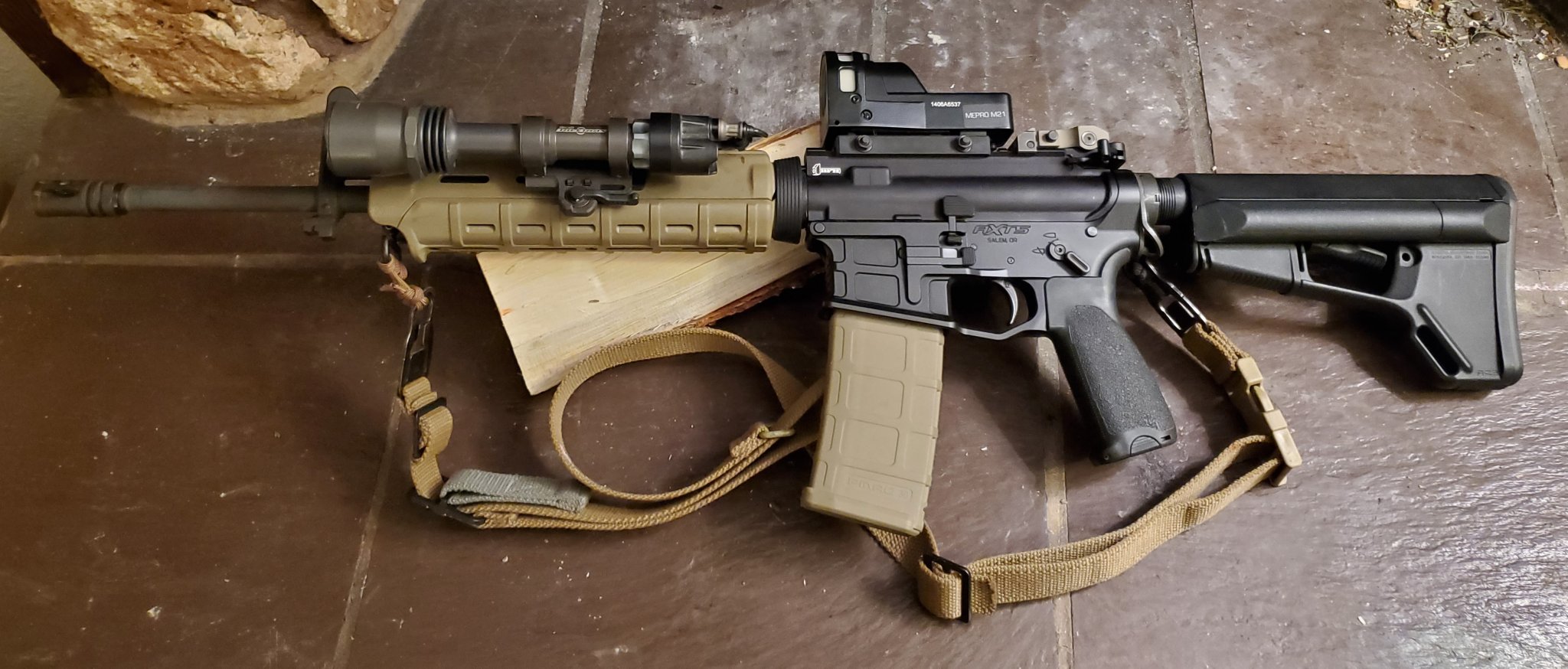

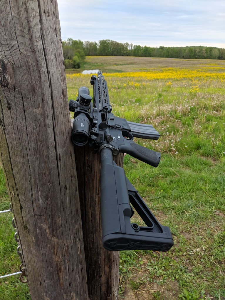

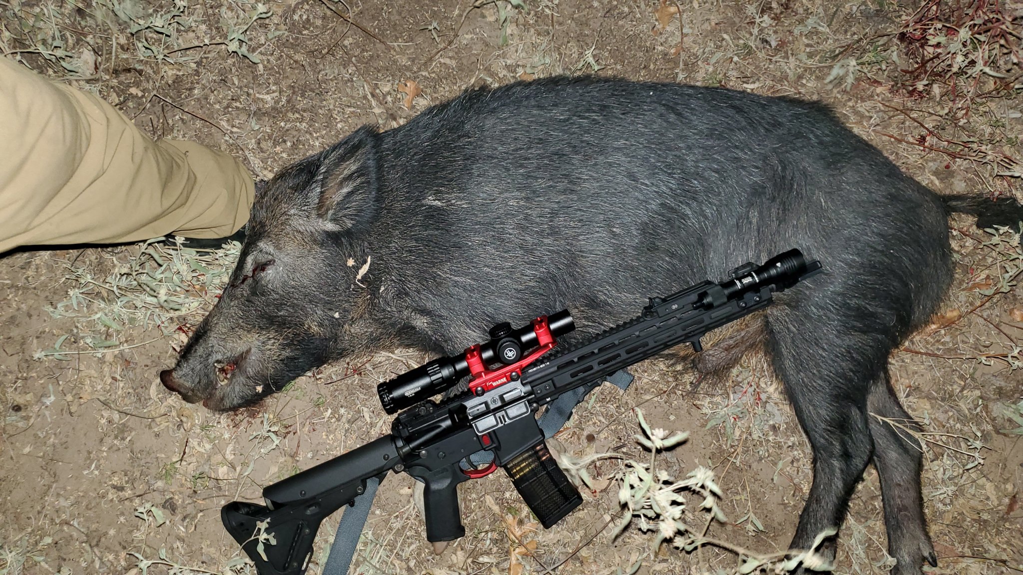

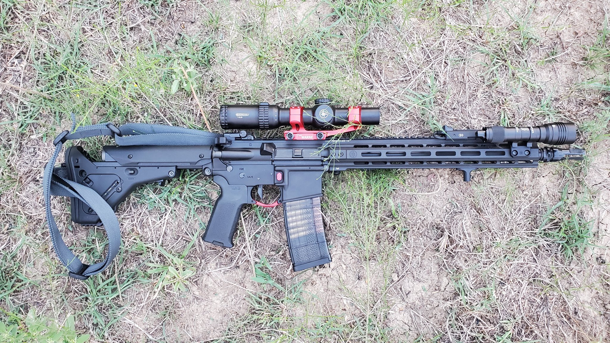

PWS MK114 Mod 1 upper 14.5"
Dead Air flash hider
Streamlight protac hlx with Cloud Defense LCS and Arisaka 45' mount
Arisaka hand stop
Warne scope mount with Vortex Strike Eagle
Magpul Pro buis
Bastardized Rock River Arms lower-bought the original rifle when I turned 18
Gen1 Magpul UBR stock
Geissele SD-C
Seekins Precision mag release and trigger guard
It's only flaw is being a little heavy. But it runs great suppressed and has been phenomenally reliable. Also have been very impressed with light setup.
Took the hog with it a week or 2 ago.

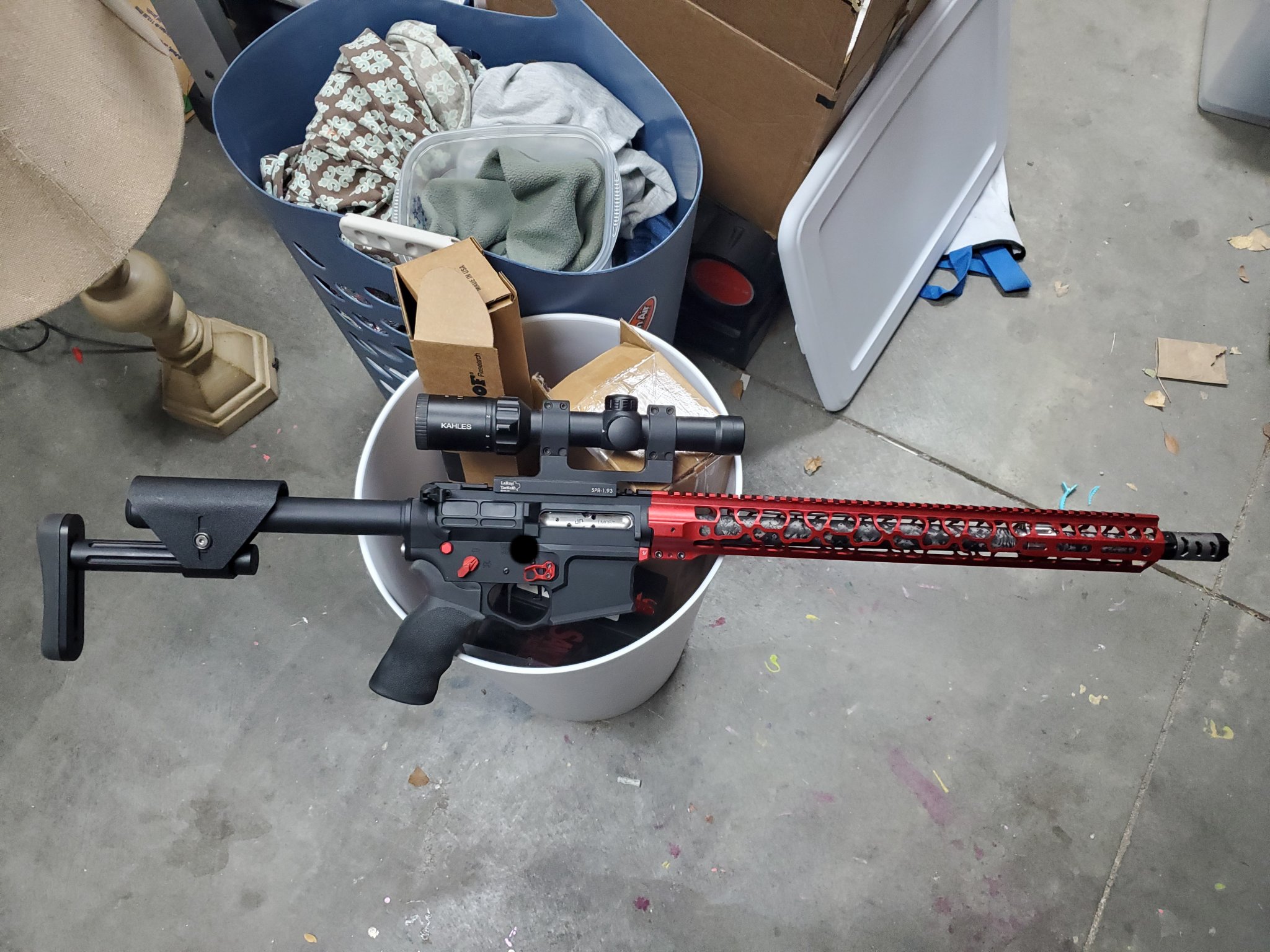

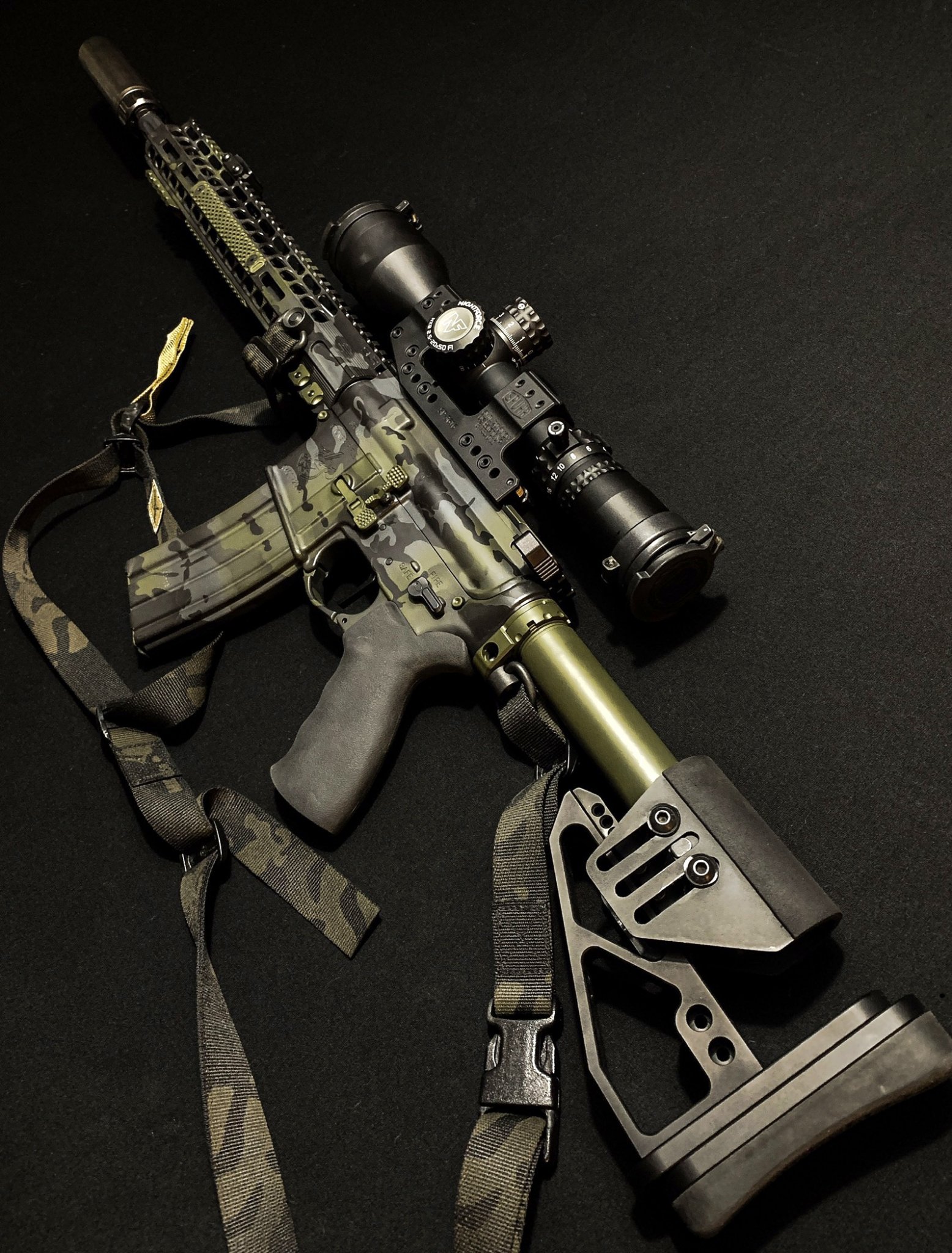

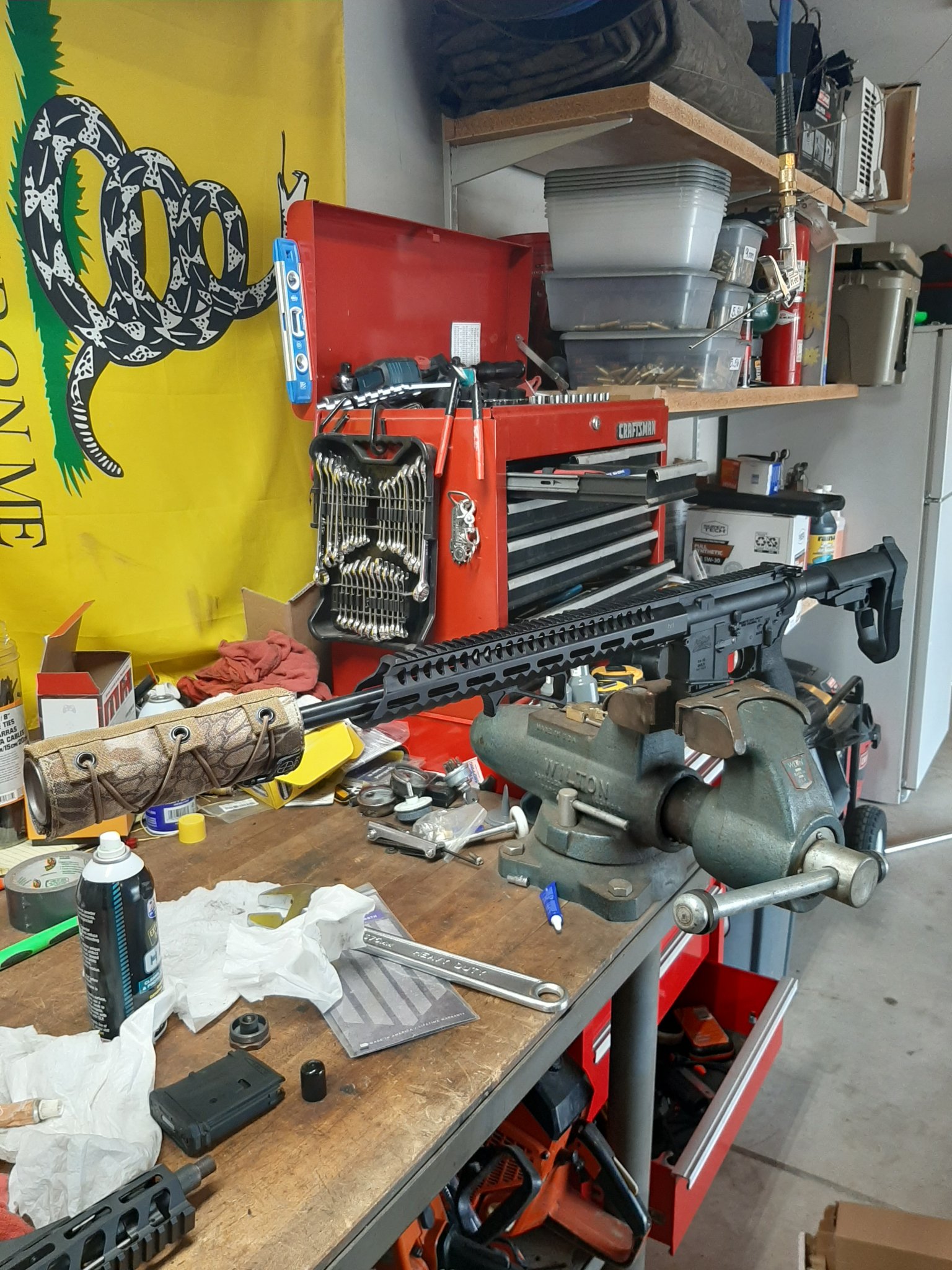

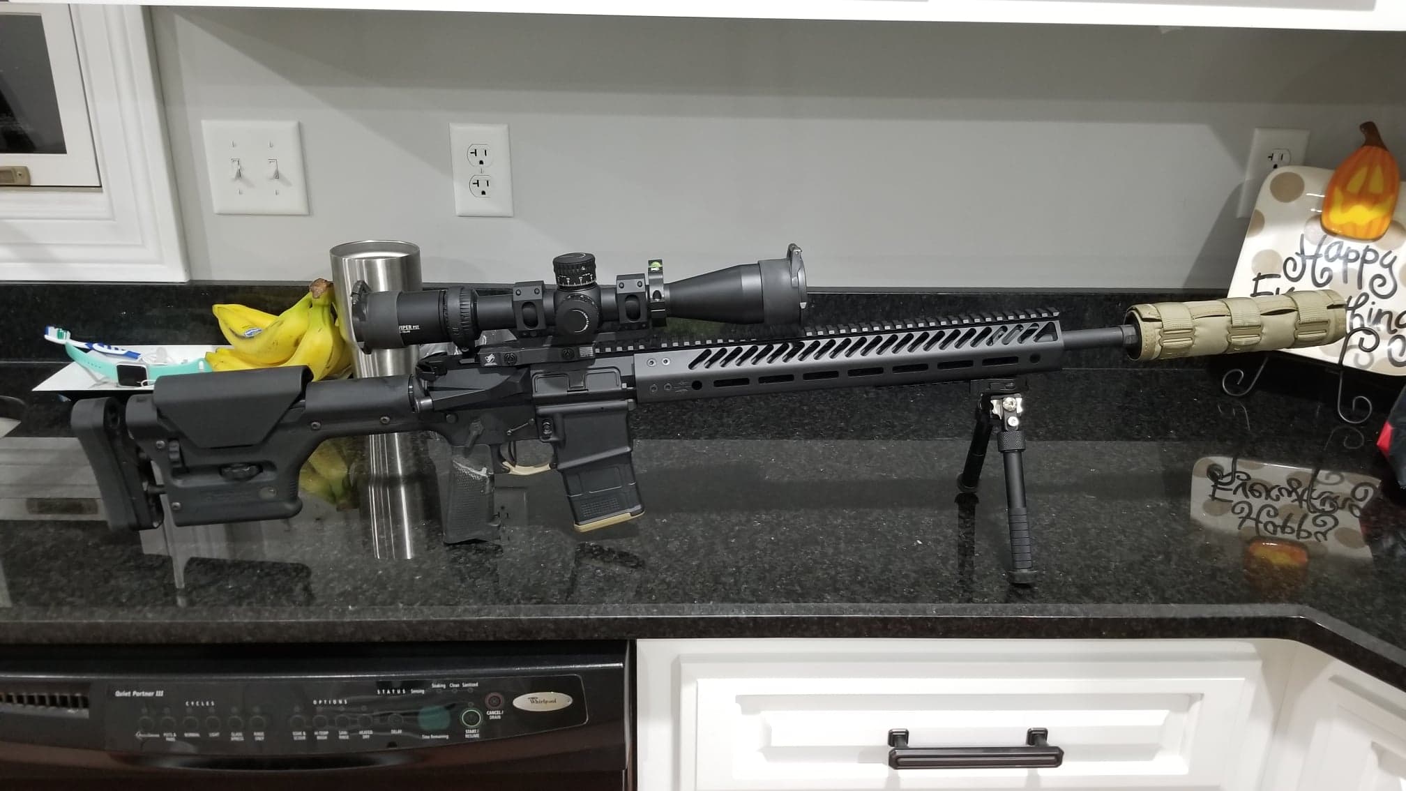

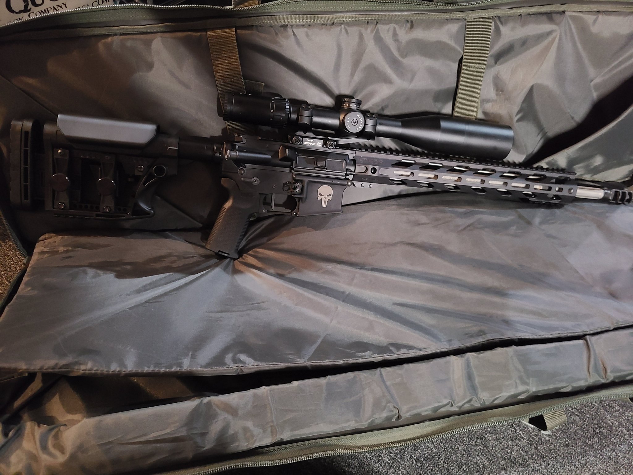

My latest pieced together work bench masterpiece.
Used Seekins DMR upper
Good ole PSA lower
Larue MBT trigger
Strike LPK
Used PRS g2, weight added in the tube
A2 grip cut and glued to a sharper angle
I have 69 and 77 match kings, as well as 75 Hornady bthp to run through it, unfired so far.

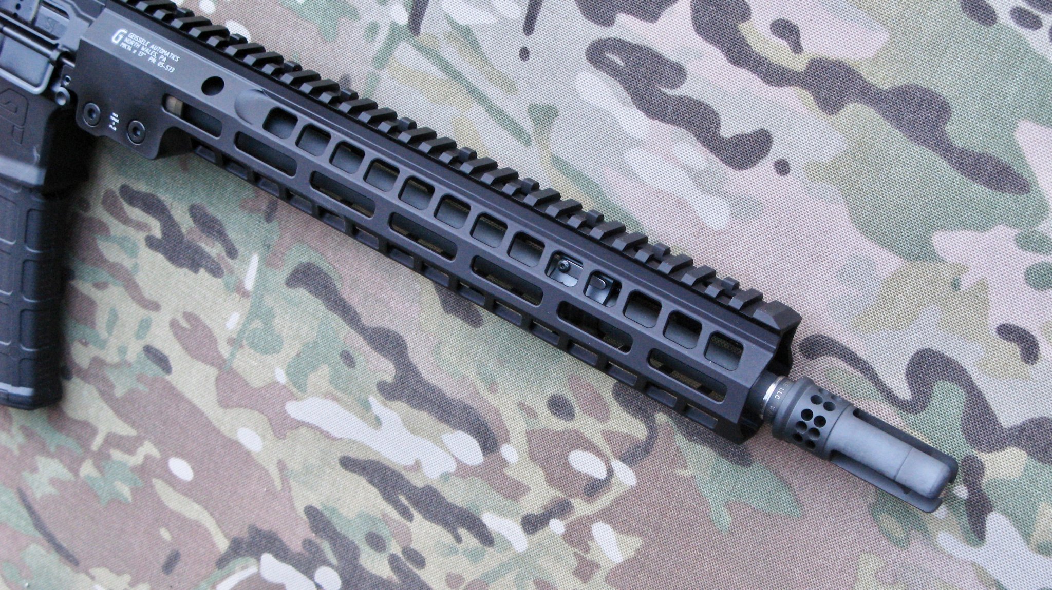

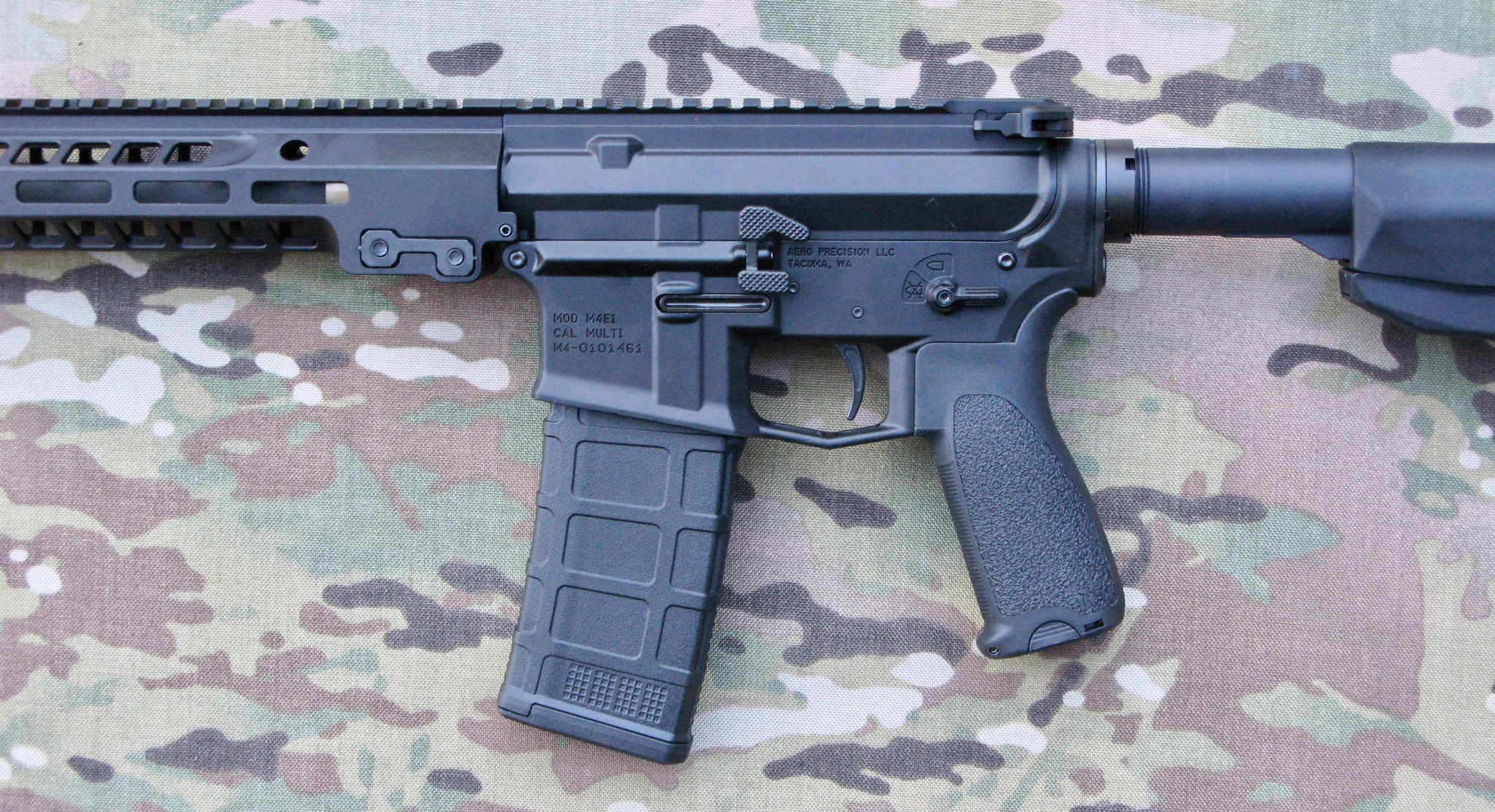

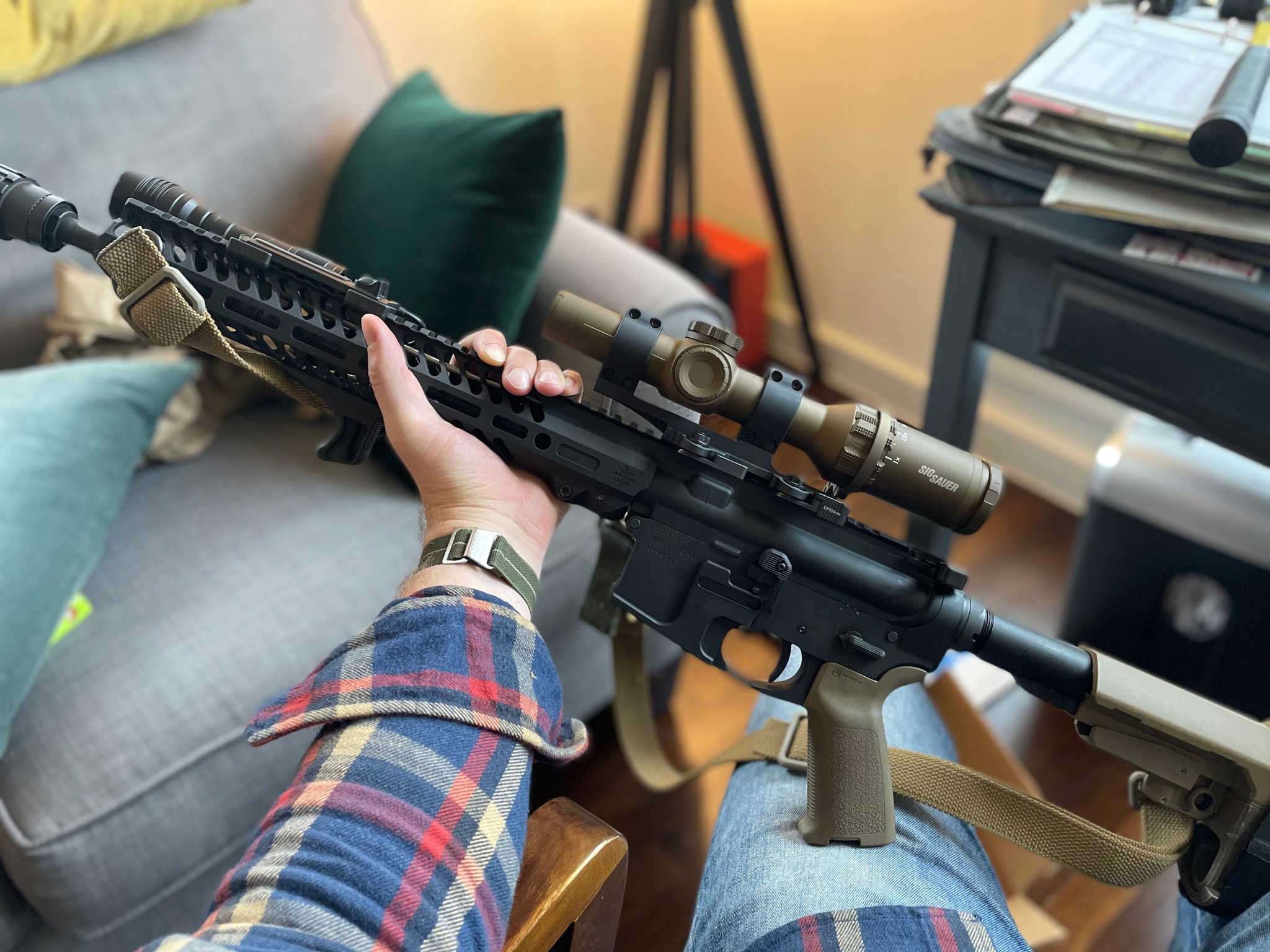

A blaster I'd like to have on call full time in my Jeep: Aero Precision M4E1 upper and lower - best bang for the buck in this realm, by far; another bargain - Criterion 13.9" C/L mid-length gas barrel, with seriously tight gas port - for use with full power ammo and/or suppressed - only; SLR adjustable gas block - for better gas control when suppressed; Surefire WarComp pinned and welded by MattMcLearn of McLearn Custom; Geissele MK 14 rail & Maritime bolt catch; SanTan Tactical BCG; BCM Gunfighter 3B charging handle; LaRue MBT trigger, again the best bang for the buck; DHD small parts; Vltor A5 recoil system; Stock and pistol grip by BCM; Magpul Pmag 30-RD.
That looks beautiful! I really like some of the upgrades that I really think are almost must-haves for what price they are. MBT, Vltor A5 system. What optic do you think you'd put on it?
