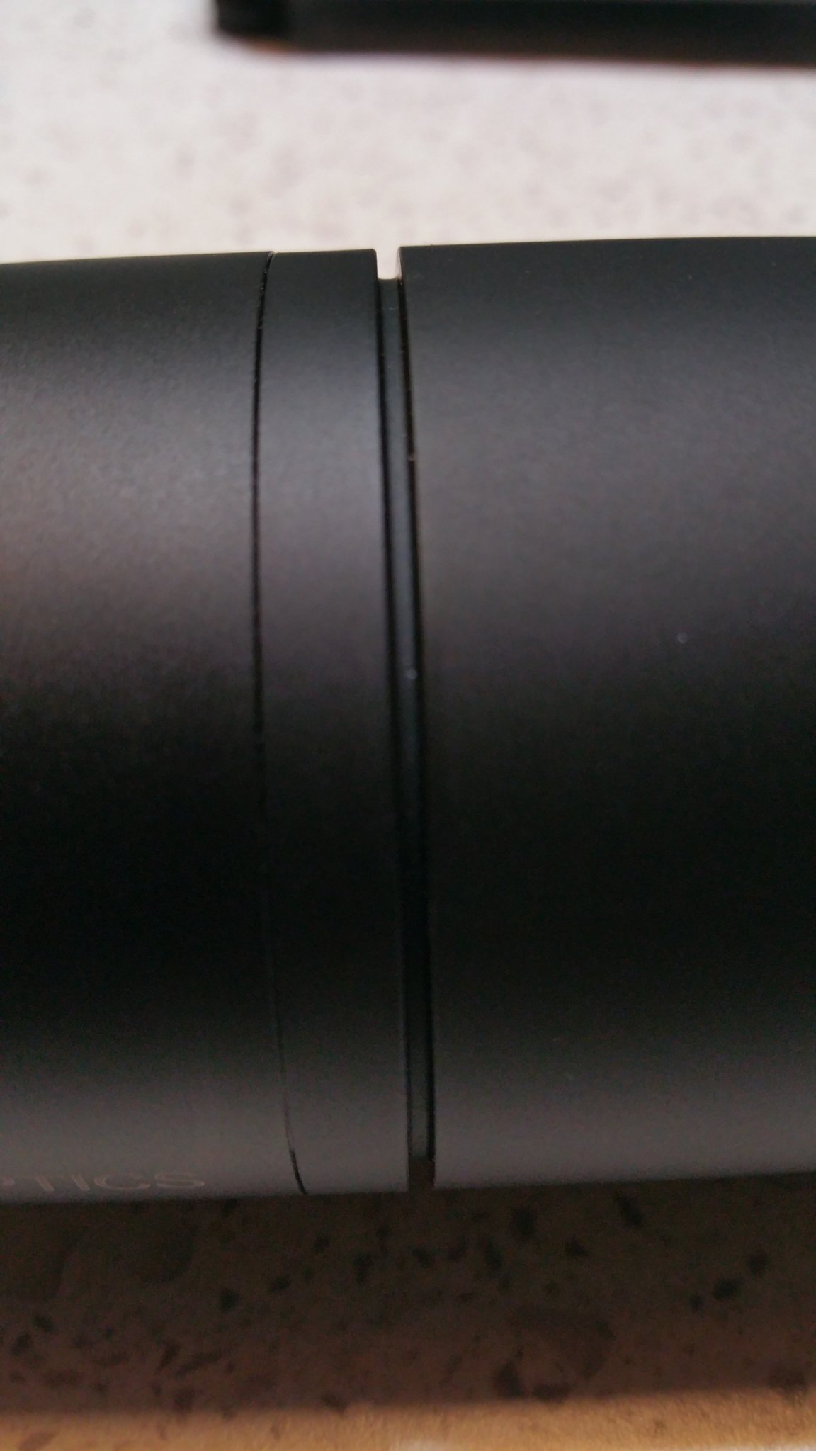

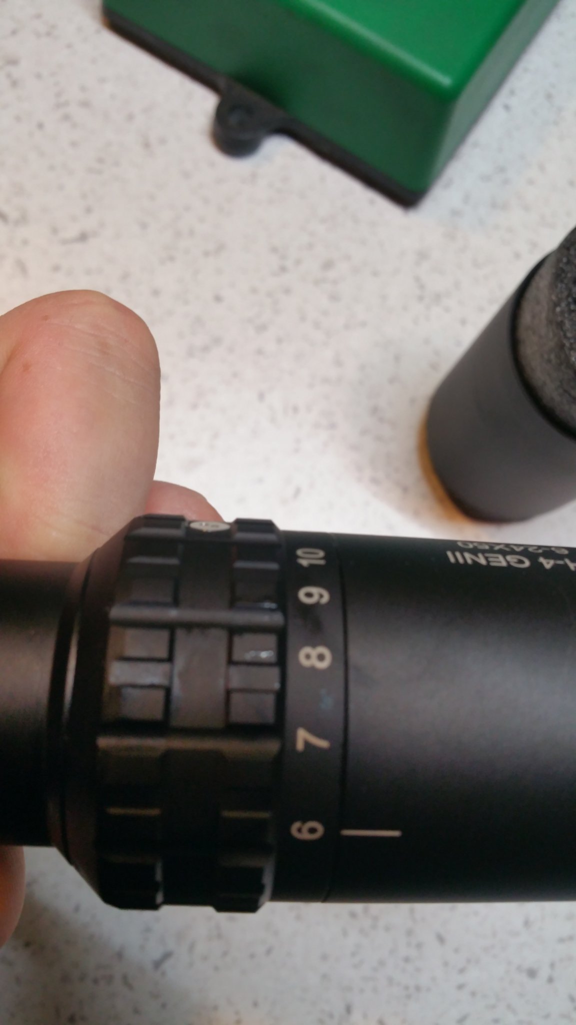

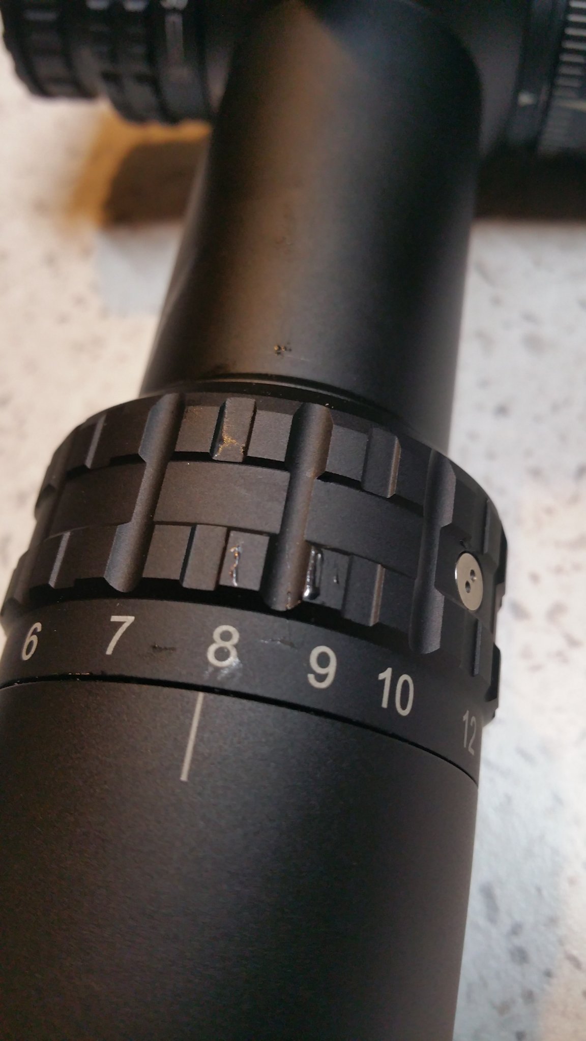

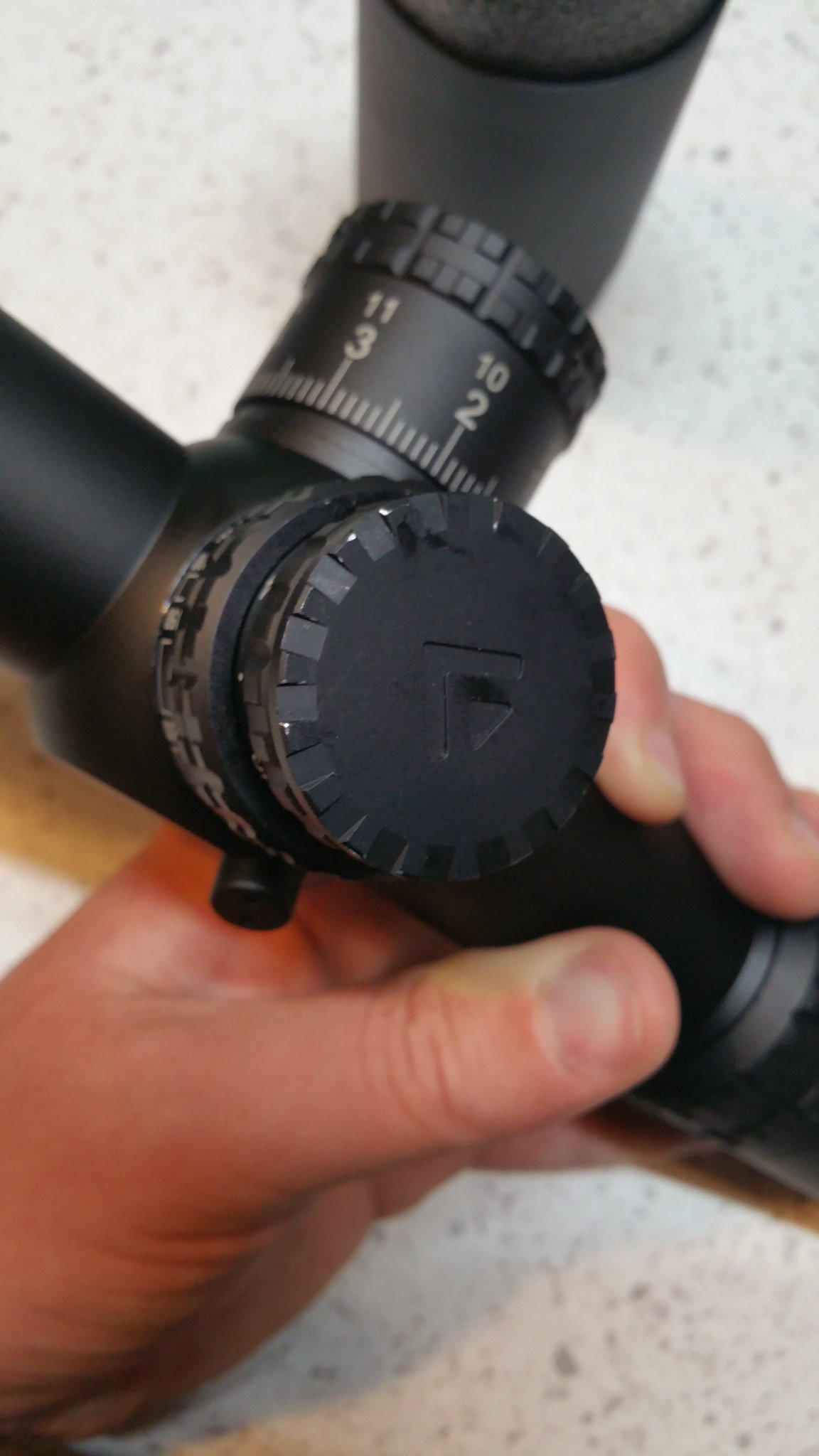

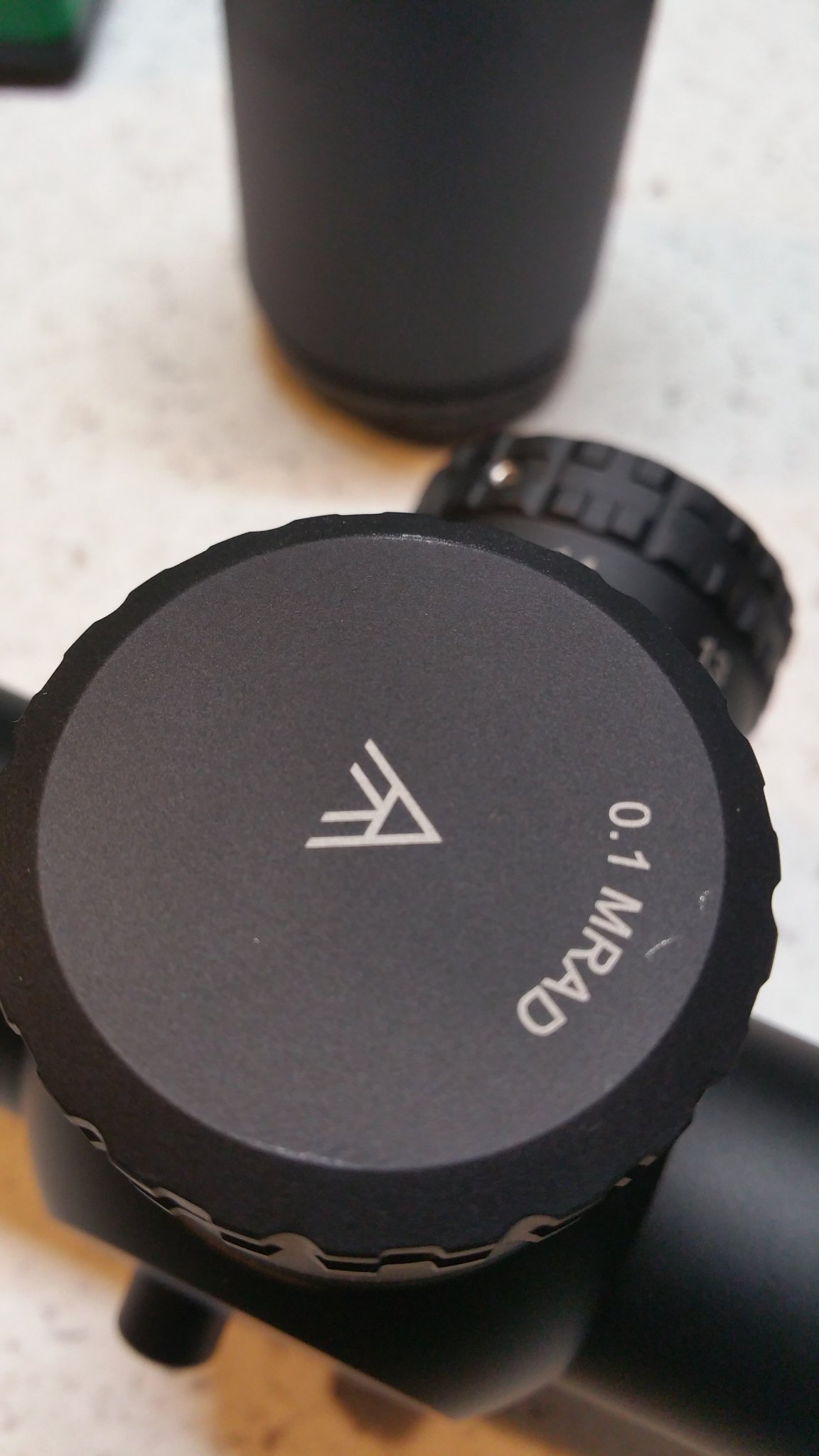

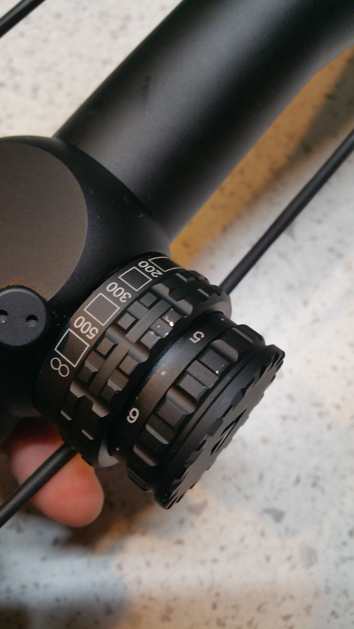

Got a 6x24 SH4 yesterday. Glass, turrets and reticle are nice. Those are what I bought the scope for. Unfortunately the sunshade only goes in about half way then makes a horrible noise and binds. Something is wrong with the threads (I am not cross threading), also some kind of heavy duty glue was dripped on the mag ring, the windage/parallax knobs have some small rashes and knicks on them. It would appear they are really rushing production to meet demand. Luckily I almost dont care about the marks but the sunshade bothers me a bit. I just want to shoot and will probably just keep it to avoid more hassle.
That doesn't even look like a new scope man, mine looked better after ~1.5 barrels, 3000 rounds and IDK how many back and forth range trips.
I'd email Arken and ask for an exchange, IMO don't even bother mounting that thing...
