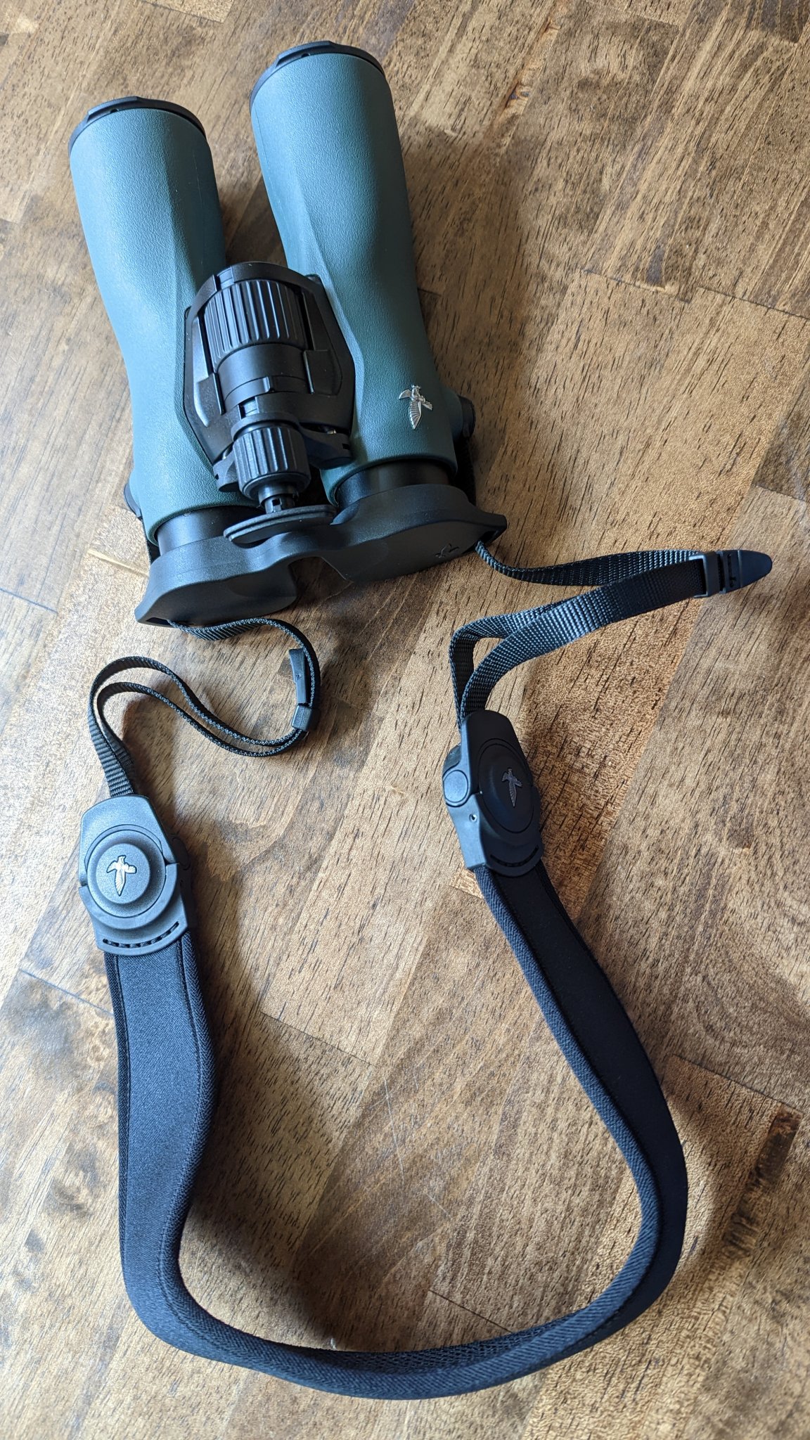

I recently picked up a pair of NL Pures in 10 x42. I have other Swaros as well as Zeiss and Leicas. The Pures are hands down the finest binoculars I have ever had the pleasure of looking through. The field of view, clarity, and ergonomics leave every other pair of binoculars in the rear view mirror. I find them almost mesmerizing to use. The optional forehead rest is a game changer for glassing with higher powered optics. If anyone is looking for non ranging alpha binoculars, these are the pinnacle.

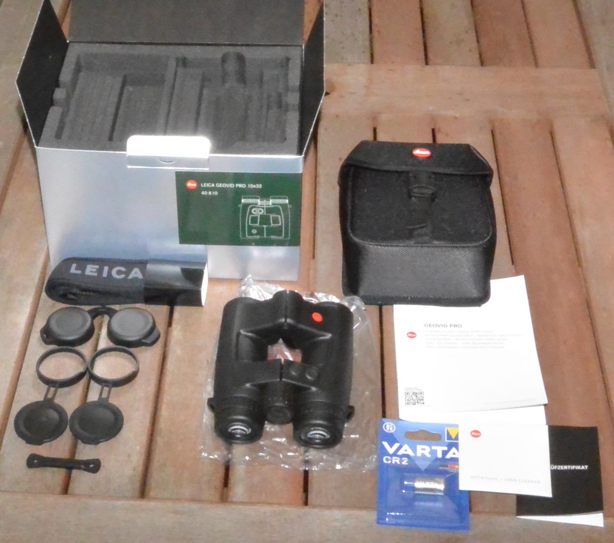

The Leica Geovid Pro 10x32's arrived today. Here is the worlds worst unboxing picture because the kids were jumping around like banshees and that is really all I had time for. I should go sit across the field from the house and check up on them with the binos instead of occupying the same room as them to get a break.
Obviously I'll be doing a full SnipersHide review of these. Here is the link to the yearly 2022 review blog to follow the progress. Of course the review will be on the SH front page when done.

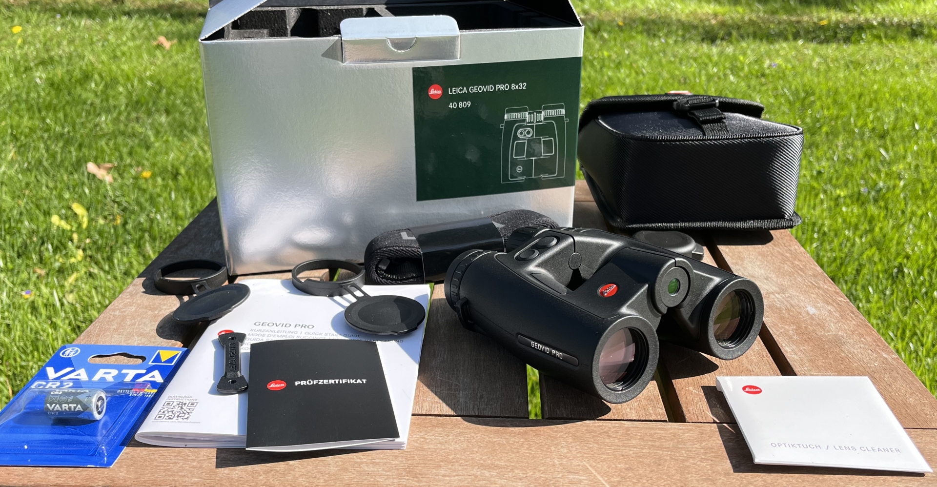

Leica Geovid Pro 32 Unboxing
Great job as usual on the full Leica review @BigJimFish.
