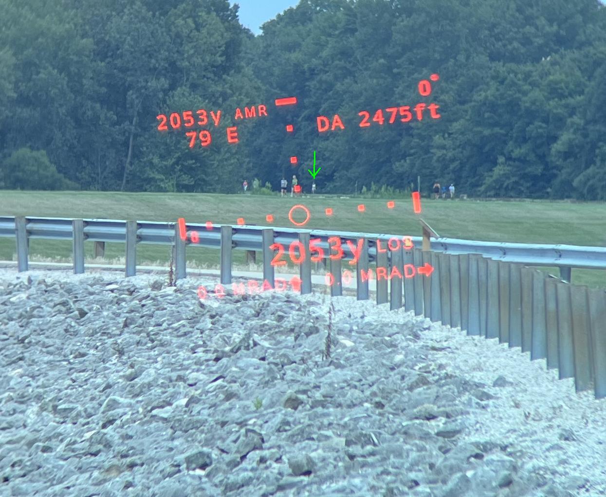

Sig Kilo 10K-ABS HD ranging a person at >2k yards

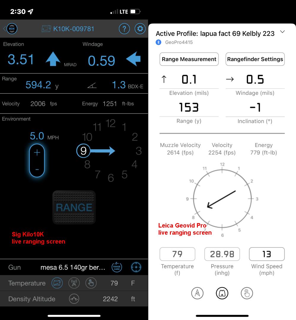

Sig Kilo 10K vs. Leica Geovid Pro live smartphone ranging screens.
I'll start with the areas in which the Sig 10k's uniquely excel. As you go out beyond 1,000 yards, the 10k's increasingly are able to range more targets than not only the Leica Geovids, but also any other rangefinder anywhere near their price. These things can range a person at more than 2,000 yards and will hit a tree line at 4,000. If your usage involves ranging targets, really, really, far away, you probably don't need me to tell you this though. You probably already have 10k's because they are currently pretty much standing alone as the only 905nm ranging product that is reliably ranging actual targets beyond a mile. They are an obvious ELR choice. Also of interest to the competitive shooter is the Sig 10k's unique pixel based display. Most rangefinders use a segmented display similar to older digital clocks. Sig is using a 304x256 pixel AMOLED display that allows lots of stuff to be able to be simultaneously displayed. The post range display includes the yardage, compass bearing, DA, inclination, drop, drift, terminal velocity, and terminal energy. It is all right there the moment you range. This display also gives you a robust menu system that is easy to navigate without three letter acornyms you will forget. This makes it easy to change ranging mode or to switch between the 30 ballistic profiles you can store onboard. Other plusses for the 10k are the BDX system, nice extras such as a wind meter that is included and can communicate directly with the binos, and a nice carrying harness. It's has the downside, that due to the constraints of the coatings required for the excellent display, things look blue through the 10k's. This is mostly cosmetic, but it is quite noticeable.
The biggest thing that the Leica Geovids excel at outside of meeting those basic rangefinding and ballistic needs is performance as binoculars. These things look, feel, and perform like high end bird watching binoculars. Their open frame and general shape is super comfortable. Their controls are butter smooth, and the image they deliver is excellent. If you want to use your rangefinding binoculars a good deal outside of rangefinding duty, these are the obvious choice. In this way they would be in the vein of the Swarovski EL ranges or Zeiss Victory RF's except that they are significantly cheaper, and, when you add AB Elite, they have better ballistic software. The Leica Geovid Pros are also currently in 32mm, though 42's are coming next year. You have, or will soon have, a lot of choices in both magnification and size. The 10k's only come in 10x42mm with no other options planned. Lastly, when compared to the Sig's, Leica currently gives you a lot more access to AB's functions when not connected to the binoculars. You can true the muzzle velocity and DSF using existing data and access range cards and target cards unconnected. So, you can easily spitball loads or compare ballistics on different calibers you might be looking into. You can also true muzzle velocity at distances below 300yds, I must for slower cartridges such as .22lr. Hopefully Sig will open this stuff up in the future. Software can change, and I've pushed for it, but right now, only Leica lets you easily muck about.
So, there you go, a quick comparison of the Sig 10k's with the Leica Geovid pros. I think both of these binos will meet most long range shooters most central needs and each sure offers some unique, different, and excellent characteristics beyond that.

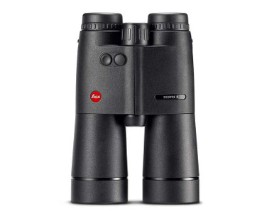

If you want a 15x LRF bino there’s the Leica Geovid R 15x56 (provided you don’t need connectivity to a kestrel or a phone).
I own the previous model (max 1200 yds) and I can say they are very very nice.
New ones have a 2000yd range. I think it is the only LRF bino out there at 15x. A gotcha might be the EHR (equiv horizontal range) is artificially limited to 1200 yds, which is dumb. Manual says it’s for “safety.” I think that’s a euro law thing that the new Geovid Pros get around via an up-charge for AB which unlocks their full range for EHR.
I called Leica and they told me the new and old models have the same (excellent) optics but on the new ones they improved the laser and ergros (two buttons instead of one, moved button from left hand to right, more eyecup positions).
Anyway, as a colony hunter the prev version works great for me.
