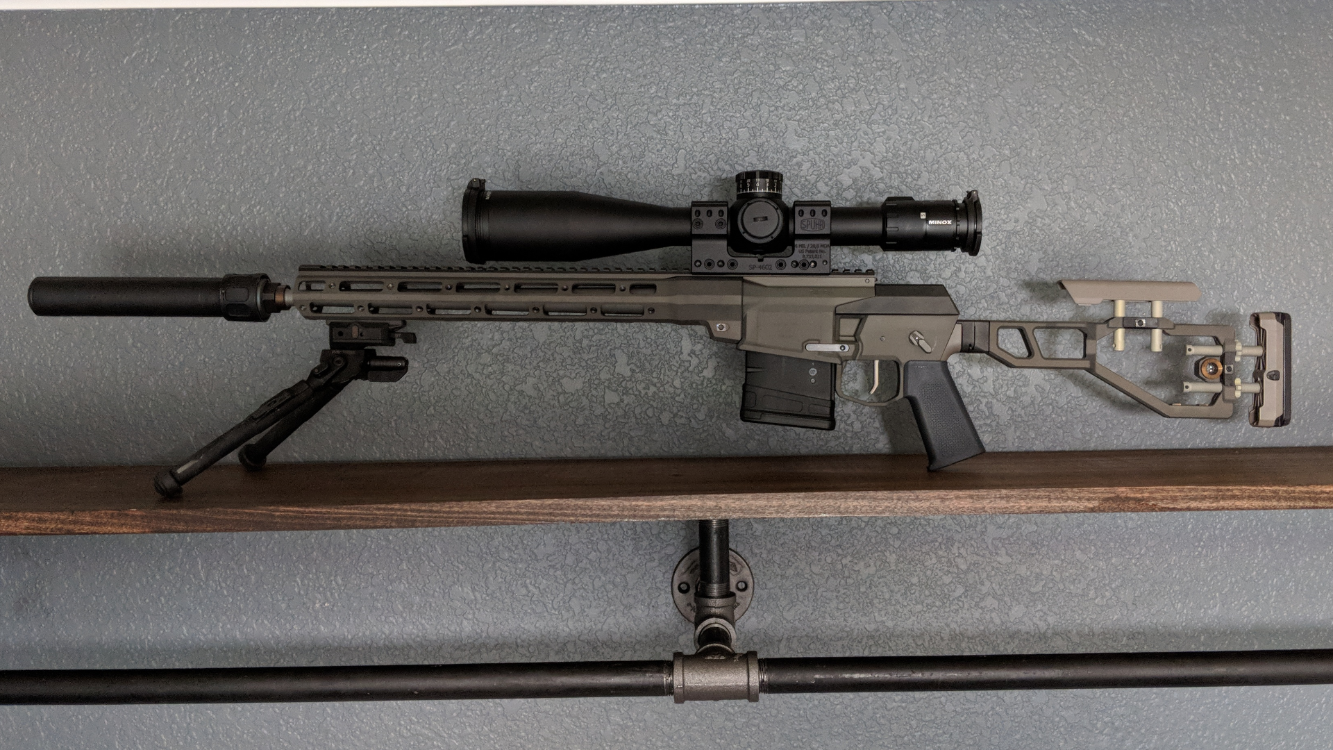

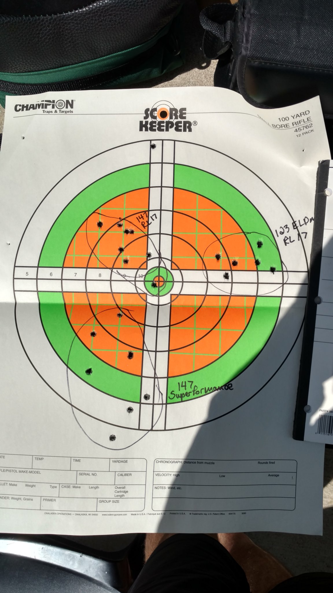

Well I got the scope mounted and made it out to shoot a couple ladder loads. I went with the Mark 5hd 3.6-18x44 that I think fits this gun well.
Shooting the Fix from the bench with Mac loads definitely reminds you how narrow the butt pad is, but it's not unbearable. The trigger is incredible, no complaints at all there. The bolt lift started very heavy, but got a little better with use. My serial is 299, no idea if this was before or after the break point of the new bolt setup.
For the ladders I used reloader 17 with 143gr eldx, 147 eldm, and the 123 eldm. I also made one load with superformance and the 147 eldm, as I had great luck with that powder in my 6.5 Western Hunter. The Fix definitely seemed to prefer the reloader 17 with the 143's and 147's.
I shot these at 200 yards and had some great nodes appear just below Hornady book max. My Chrono is still on loan with a friend, but based on my results I made up another 25 of the 143's with 41.2 grs, and 147's with 40.0 grs of rl-17. I will be shooting these out to 600 yards friday, over the chronograph.
Really love the rifle. When you look at the machining content and quality, it's not hard to justify the cost. My barrel arrived with some nicks and smudges in the bead blast, but I'm sure I will do much worse. I'm anxious for the taper adapters to come back in stock to get the can on:oops:, and for the release of the bigger butt pads(I know, I'm soft).
I had the remainder of some browning factory loads the gun did not like to free up so ignore the random shots around the bull. Top of the ladder was very encouraging.
Really love the rifle. When you look at the machining content and quality, it's not hard to justify the cost. My barrel arrived with some nicks and smudges in the bead blast, but I'm sure I will do much worse. I'm anxious for the taper adapters to come back in stock to get the can on:oops:, and for the release of the bigger butt pads(I know, I'm soft). View attachment 6906282
View attachment 6906287View attachment 6906288I had the remainder of some browning factory loads the gun did not like to free up so ignore the random shots around the bull. Top of the ladder was very encouraging.

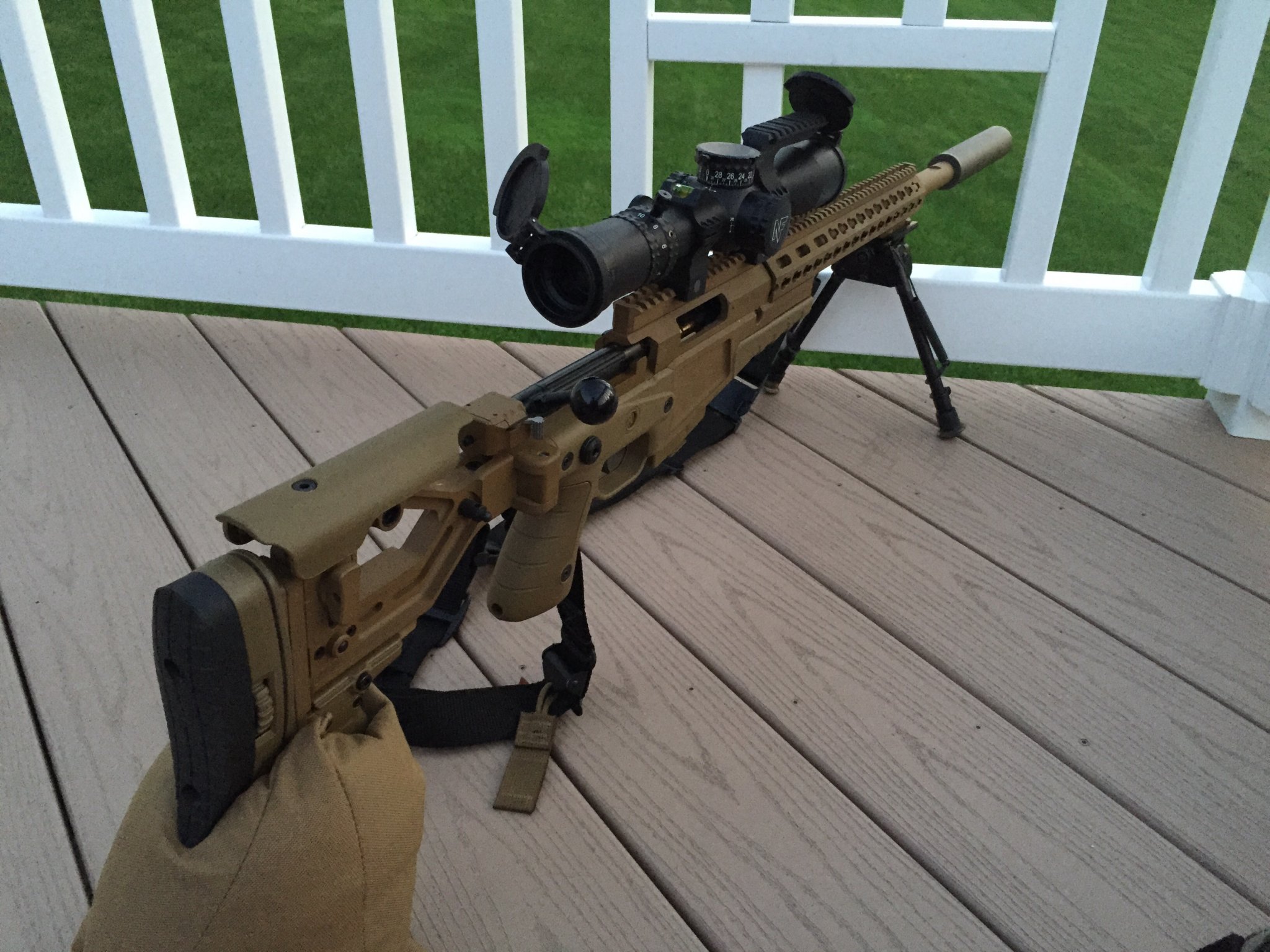

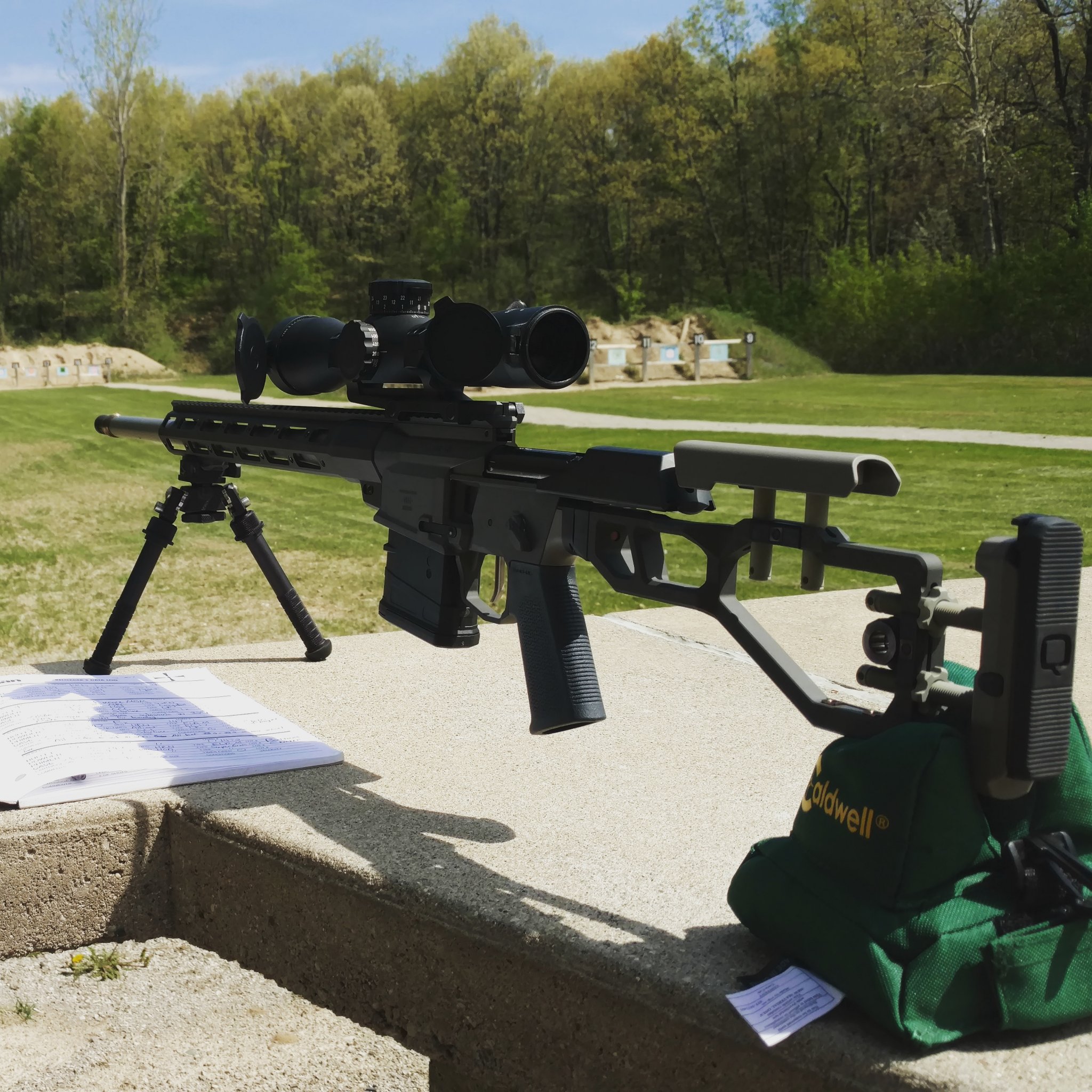

That is the same scope I’d like to do on mine. Could you please post a side picture?

Yes, sorry I thought I had some on my phone but I will take a few when I get home. The mount is less than ideal, its a little high at 1.5" and the captive bolts are on the ejection side. Supposedly Leupold has some coming in the Mark 6 line, but I think my Spuhr might migrate off my Pierce chassis gun to this.

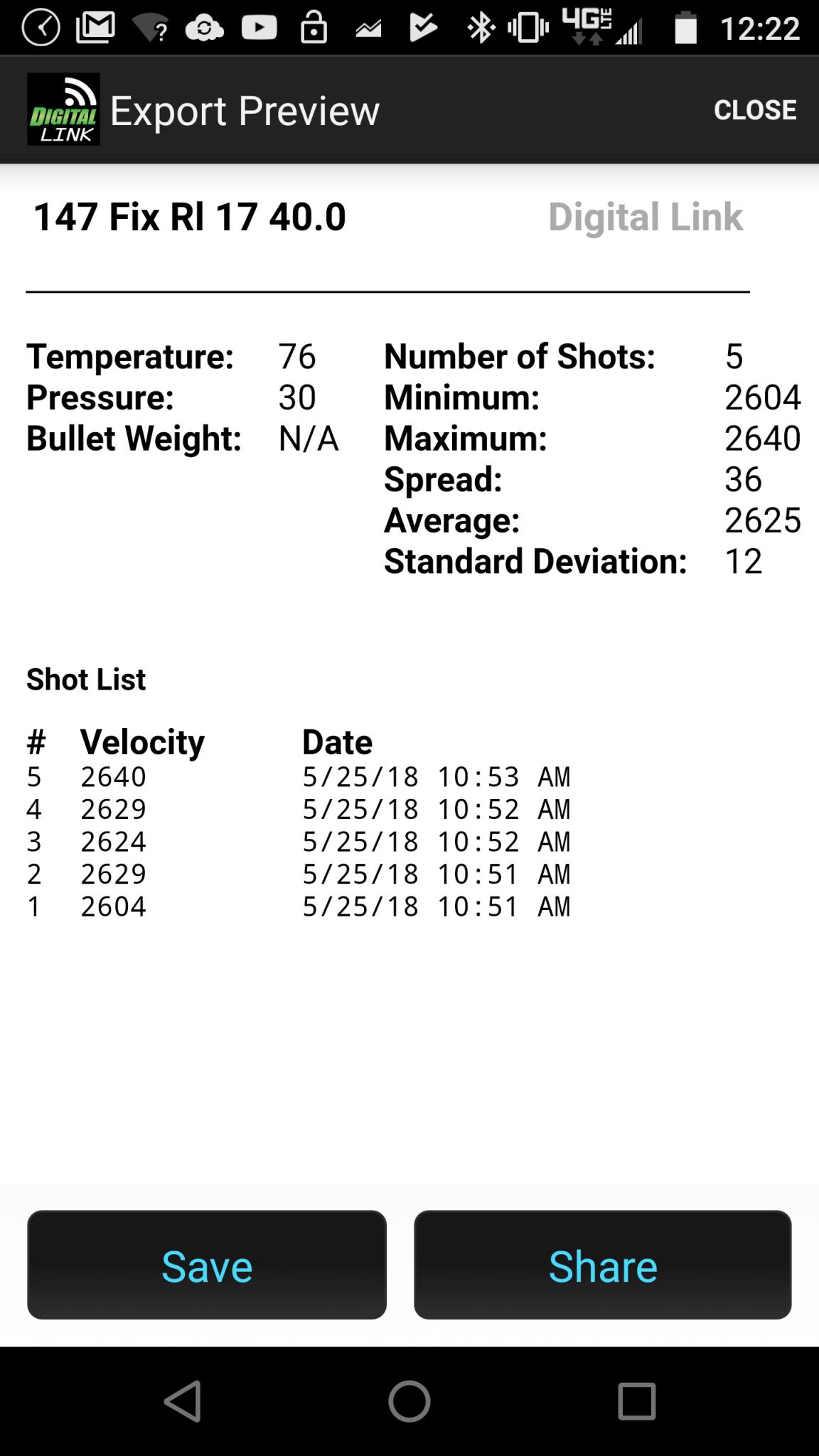

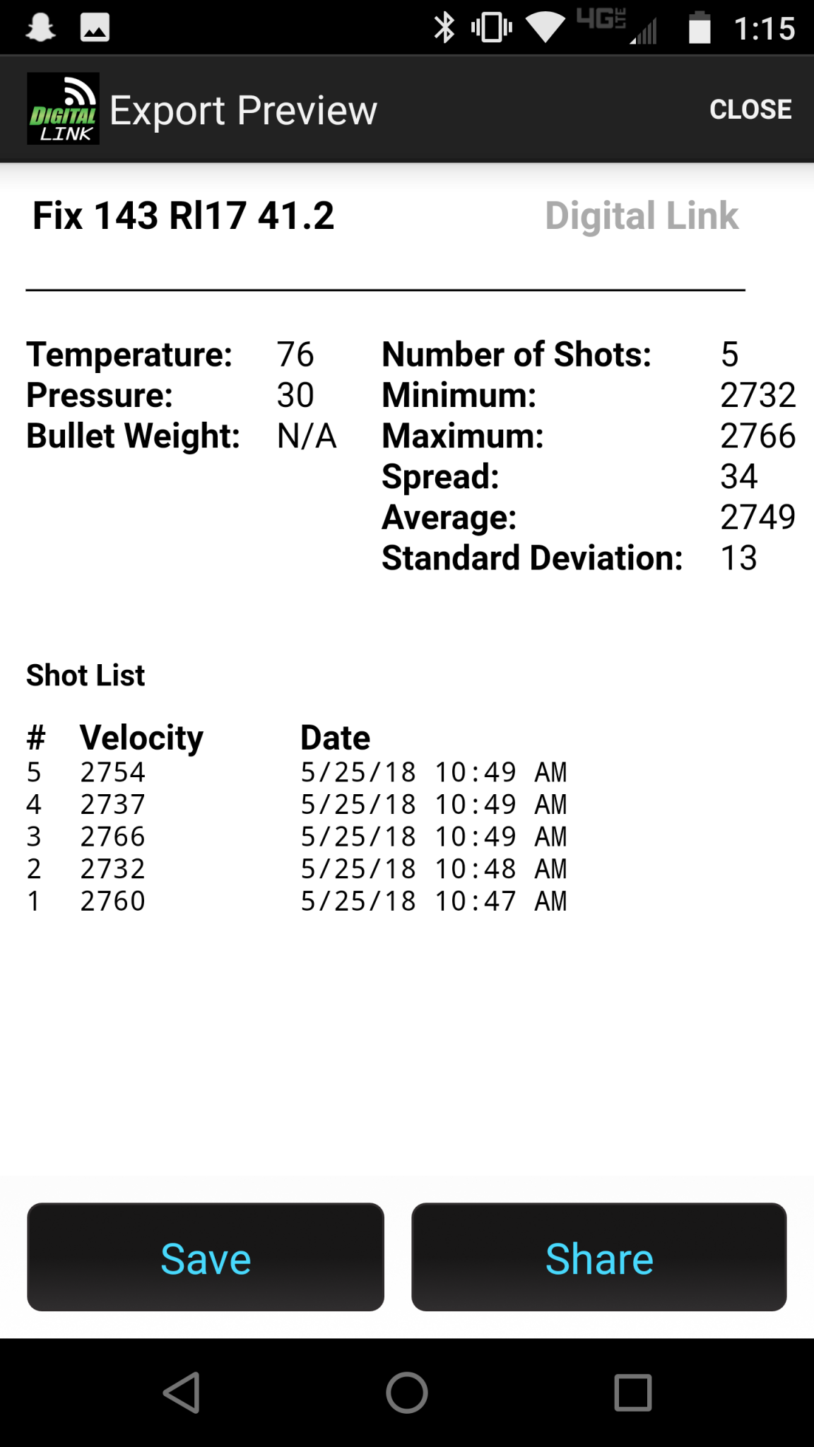

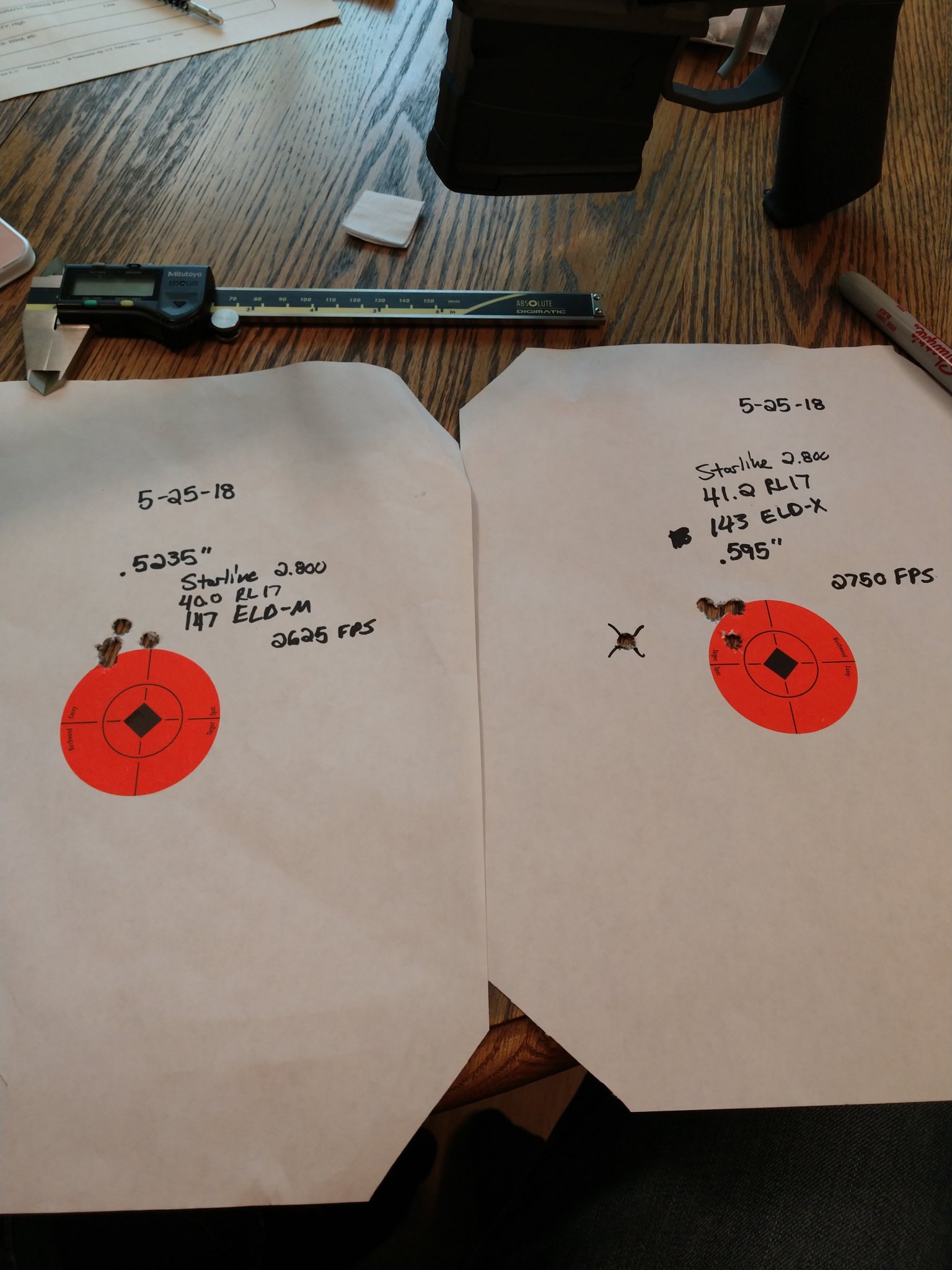

Got out to test the promising reloder 17 loads today. Both the 143 and 147's shot great, especially considering the cobble of old 2x6's and cinder blocks we were using as a bench.
The bolt is still sticky, moreso with the 143's. I'm hoping that will improve with time and more rounds. Still love the rifle!

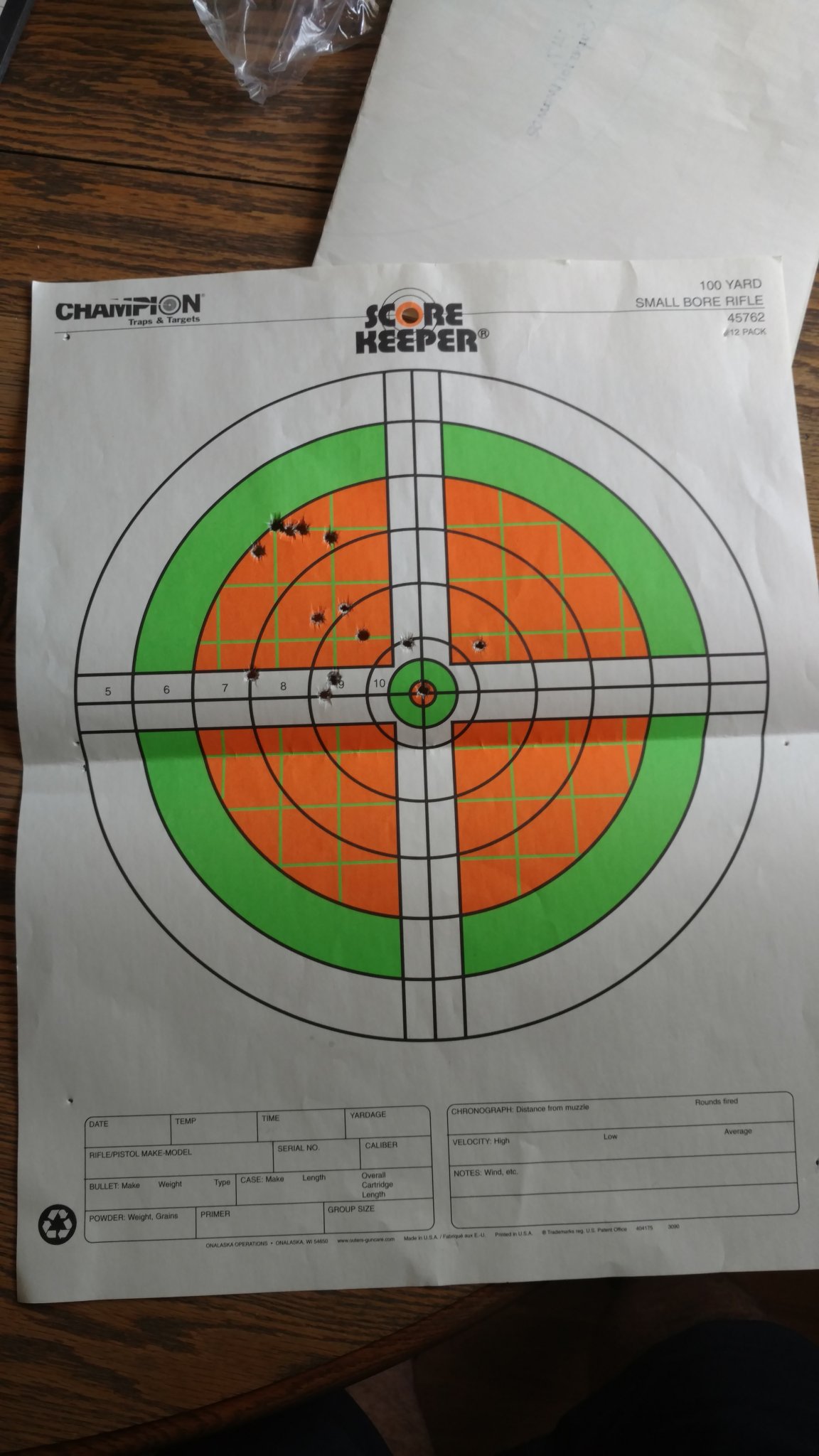

Shot a ladder test today with my 16" Bartlein Barrel. With the 178gr ELD-X being .18 inches longer then the SMK 175 gr, I was assuming that I needed to start lower in charge then what the 175 smk's take. Well... good thing I did. I was seeing pressure signs at 42.2gr or Varget. With 175gr SMK I usually start my ladder at 41.6 and work up. After 4 shots into the ladder at 42.2gr of varget, I had flat primer and hard bolt. So I worked back to 40.2 grains and shot it from there.
Federal Once Fired FGMM brass. CCI Large Rifle Primers. Trimmed case to 2.005. 2.800 COAL. Varget Powder. KAC QDC suppressor. Results:
40.2 2367
40.4 2368
40.6 2375
40.8 2373
41.0 2359 (and another to verify (2358)
41.2 2378
41.4 2397
41.6 2412
41.8 2423 (another to verify 2412)
42.0 2426 (another to verify 2421)
42.2 2446 OVER PRESSURE SIGNS
Factory 175gr FGMM out of this gun was at 2510 +/-
The first 4 rounds in the ladder test had an SD of 3.8 and ES of 8. Could have just stopped there. The 5th round was lower at 2359 followed by the 6th round right where the first 4 were at. I shot 41.0 gr again to verify and I was at 2358 (only 1 fps off the first 41 gr round) So I knew this was a good number. I also shot the 41.8 and 42.0 again as the first go around only showed a 3 fps difference. Even though I want the extra velocity, I think I am going to load up some rounds in the 40.6-7 range. I dont want to load anything up close to over pressure signs that may come back and bite me on a hot day. Saving some wear/tear, powder, and living with the lower FPS, I think will be better for this gun in the long run. If I want to move heavy pills 3k fps, Im picking up a 300 win mag or 300 wsm.
