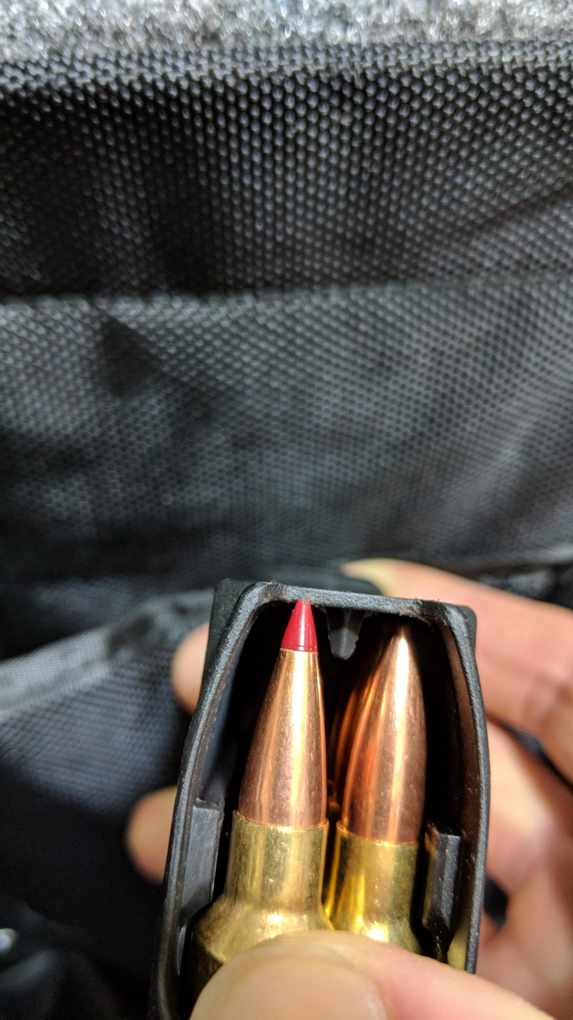

I have a few boxes of 300wsm ELDX 200 gr ammo and it loaded up in the SR25 mags. The issue is the case is much larger diameter and there is no way it would feed out of a SR25 mag. The lips of the mag are for 308 rounds so the 300wsm sits much lower in the mag. Trying to strip that round out would just push it into the mag body and go nowhere. A new mag would need to be made for sure. I believe Sammi spec for coal on 300 wsm is 2.860.
Could the feed lips be opened up on a metal mag like Kac or Larue?
Now this I was pleased to read. I didn’t for a minute expect the rounds to fit.
A new mag follower and a steel mag with the feed lips adjusted accordingly and I’m sure it will be good to go.
I just tried on my gen 3 pmags mags and those didn't fit. The coal on these rounds I just mic'd up are 2.832. I think with slight modification and using a slightly shorter bullet (without plastic tips), would make it work on these mags. The ELDx is a really long pill and something like the Barnes VLD Hunter may work well for saving some case capacity. Time will tell. I'm sure someone already has this all figured out..
Kac and Larue mags fit these fine as they take rounds to 2.871. Pmags look like this...

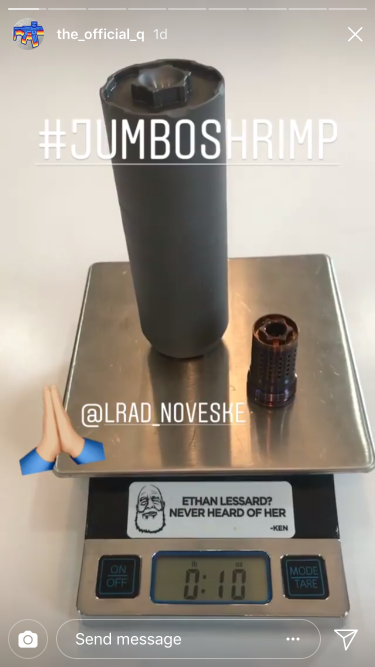

Anyone see the "Jumbo Shrimp" 6.5 suppressor on the_official_q's Instagram story? Not sure if it is wider, but it looks like it might be even shorter than a Trash Panda and weighs like 8.5 oz by itself, 10oz with the Cherry Bomb. Will be interesting to see.

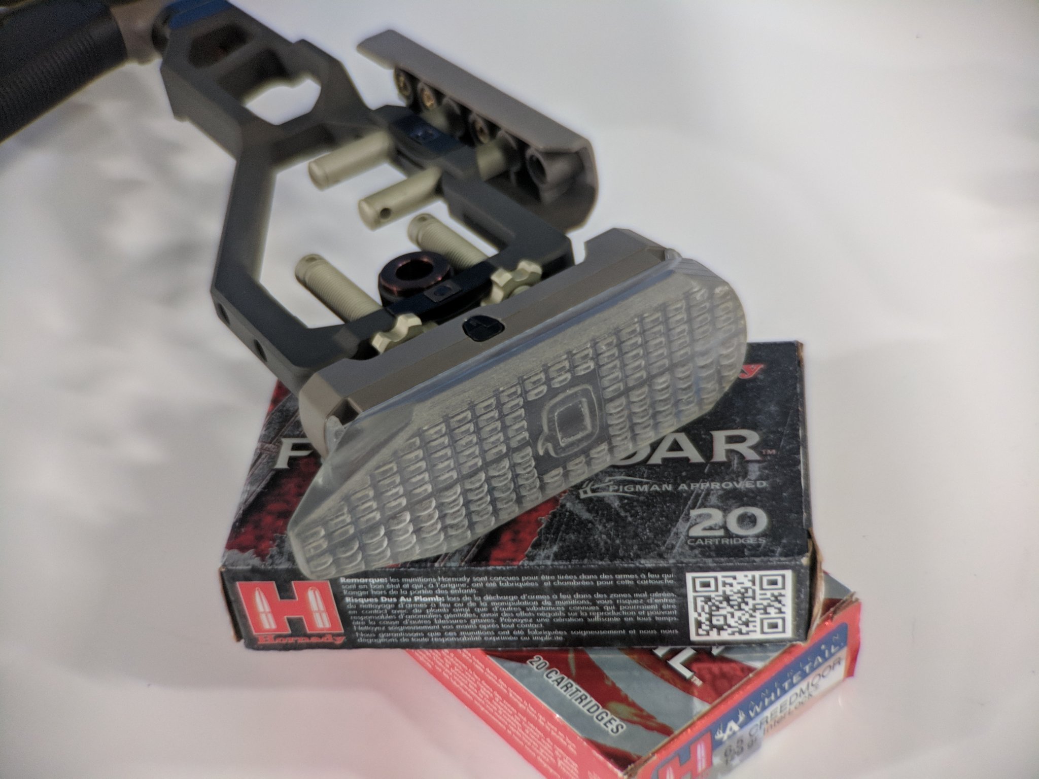

I want to update my take on my Fix, in case it helps anyone on the fence. I still think it may be the best all around rifle there is, and I tremendously like mine, as I said before. I've found two things I'd like to change though, and both are related to the butt pad. One, I wish it was adjustable for cant. That's about the only thing it is missing, in terms of adjustability, and I think it is a worthwhile feature on a gun, especially if there isn't a big weight penalty, like there is with most traditional stocks.
The next thing I may have to eat a little crow on. The buttpad really could be wider and softer. Think AI buttpad, which I find to be about ideal. When I got my Fix, it was winter, and as it warmed up, I have of course shed layers. With anything more than just a t shirt on, I don't really notice the problem, but now that I am firmly into T-shirt weather, the very small footprint of the pad really focuses the recoil into my nerve bundle/clavicle area. I know why they made it so small, and for field use or tripod use, it is fine, but for extended shooting sessions, I just don't have enough padding.
A replacement pad, that just slipped on and off with the original hardware would be ideal. This way you could swap pads depending on your needs, and the thicker, wider, softer pad could have cant built into it very easily. I imagine you could even rig the AI plate to it in some way, but I haven't tried.

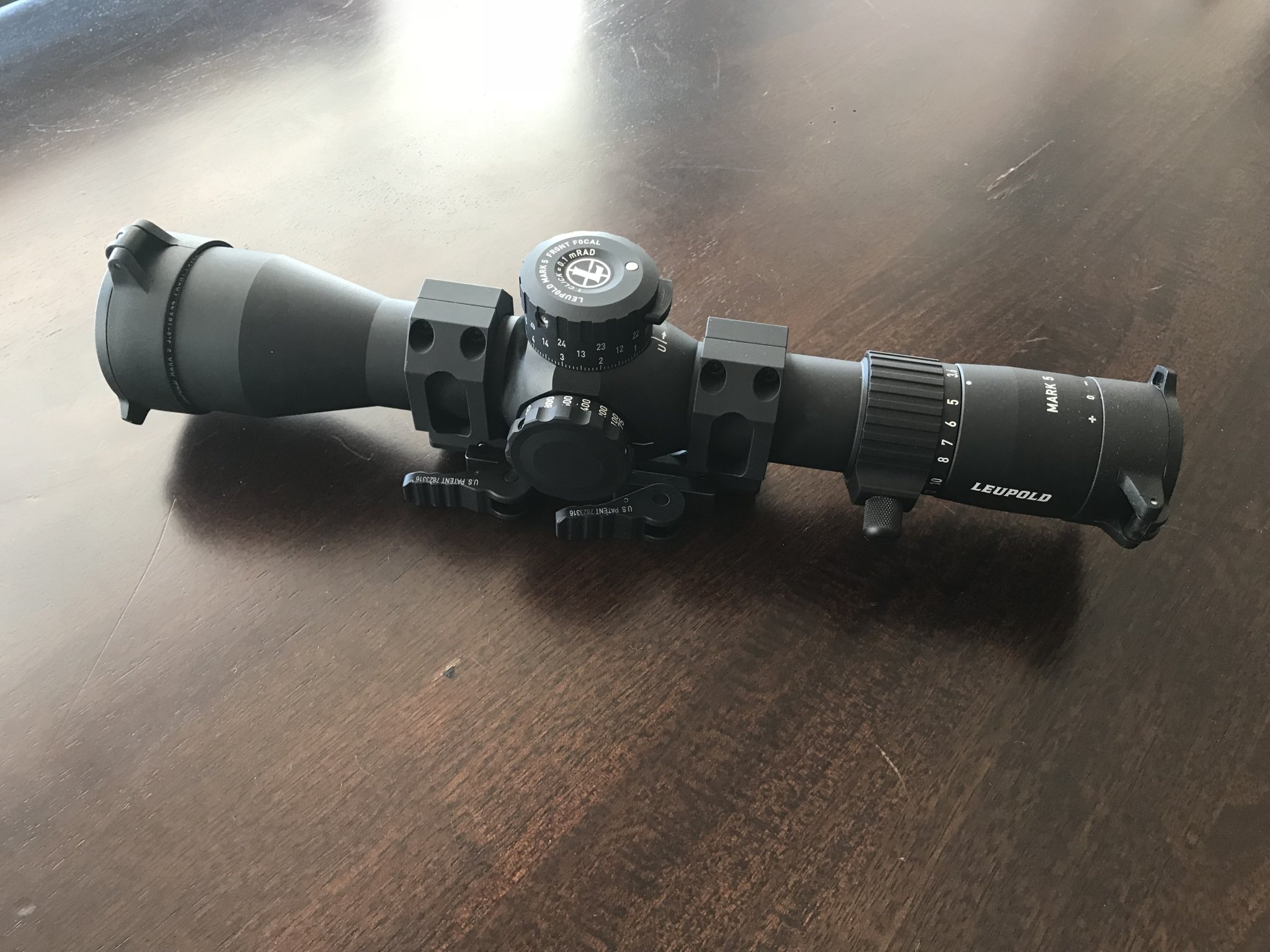

Got my Mark 5 Tremor 3. It’s a perfect fit for the Fix!
I'm glad someone else spotted this. I snapped a screenshot of it before it disappeared. Wish I had another shot from a better angle, but this is what I have. I couldn't count all of the baffles, but it looks like maybe it's a Trash Panda minus 3 baffles and a smaller aperture. By my rough calculations, that would put it around 6" long. It showed 8.5oz on the scale before the Cherry Bomb bumped it up to 10oz.
Nice call on the screencap - I hadn't thought about it. But yeah, sorry for no link folks, it's the ephemeral nature of Instagram stories. I am sure we'll see something announced ... eventually.

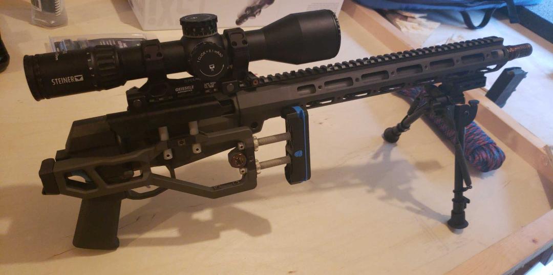

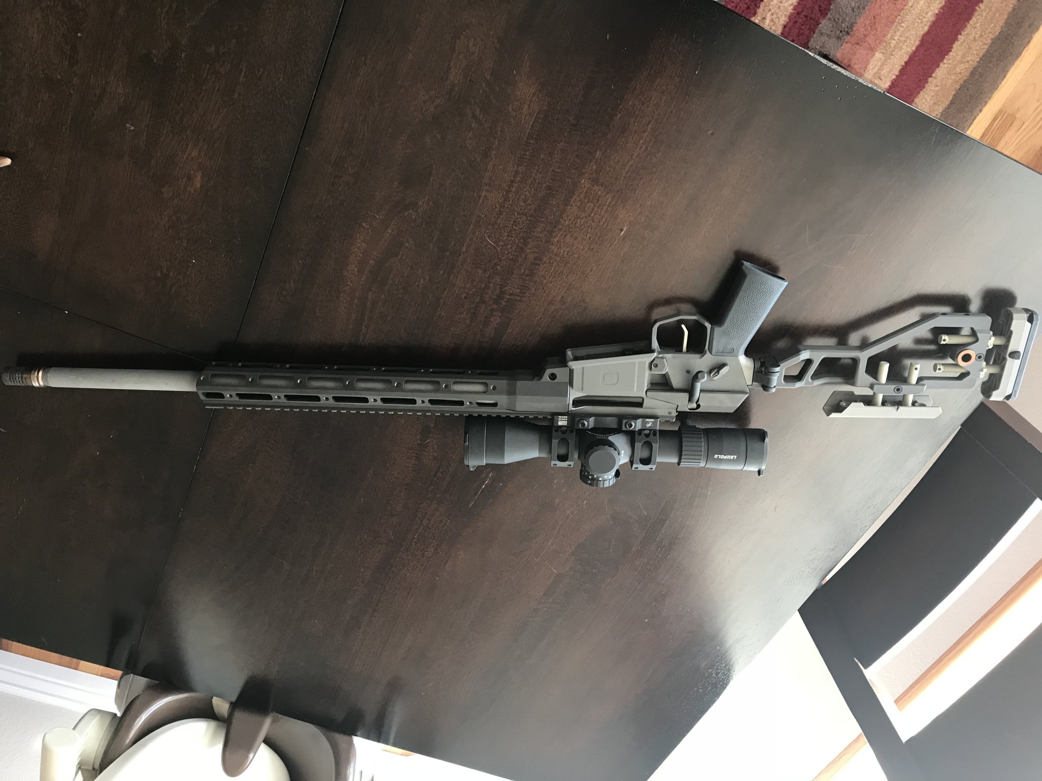

I received my scope back warranty work, set it up and went out two weeks ago to work with the setup and get used to this rifle. I tried FGMM 168 and 175 like Kevin said and it shot a lot better than with the Lapua 175 Scenar-L, the Lapua a lot hotter load than the FGMM. The rifle shot well with both FGMM loads even though I pulled through the trigger a few times and screwed the groups up, also a concrete bench with a piece carpet doesn't help, but like i said, a hell of a lot better groups. I have been trying different setups with the stock and it has been helping with the recoil since the first time I shot it. This weekend I am going to test out 168 Berger loads that I use in my M5 to see if this rifle likes them, fingers crossed.
