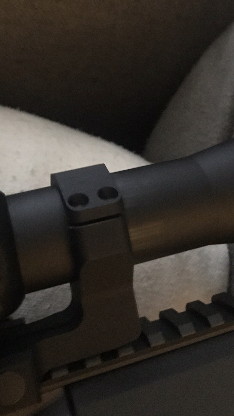

What do y'all think about Badger unimounts? I am already hearing the collective "Seriously? :rolleyes:".... but looking at my rifle this morning it looks like the scope shifted about 1/2" toward the muzzle over the course of the day. It didn't rotate any... just shifted on that one axis. I tightened exactly to Badger's specs "Place the scope in the rings, put on the cap and install ALL the screws loosley, (do not use Loctite) holding the short end of the T-15 wrench tighten about as tight as you can get it. (holding the short end of the T-15 wrench!)" but that didn't seem to work. All the bolts are still tight and I can't move the scope around by hand but it DEFINITELY shifted. I am going set everything back up and torque to 25 in/lbs, like I normally do, and see what happens. I may still have issues, but I don't think the scope moving around did me any favors.

That definitely isn’t good. If your scopes moving in the mount there’s no way accuracy is going to be great. Never had any issues with badger mounts myself, but I prefer Spuhr. Spuhr has a lot of meat contacting the tube and their torque specs run higher.
I may have just not have tightened it enough. I pulled out the torque “wrench” and, while tight, they were not quite at 25 in/lbs so gotta give that a try before wasting a busy man’s time
Seriously?
I kid. I was going to ask about that. The reason I asked for the groups is that may have been an issue. Looking at them this morning I think that’s part of the issue for sure. Two rounds touch. Then two rounds close together 2 inches over. I think you have an optic problem my friend.

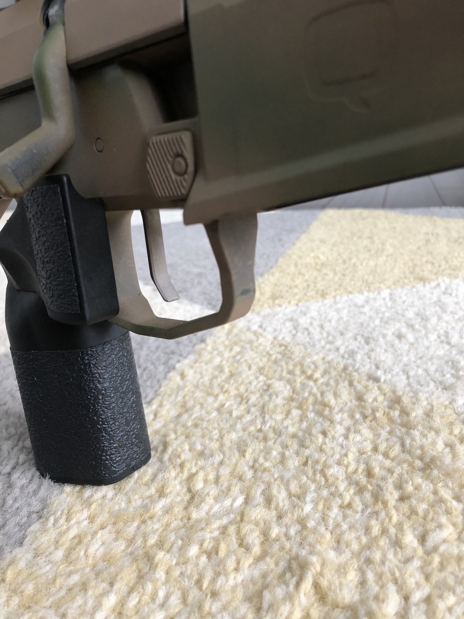

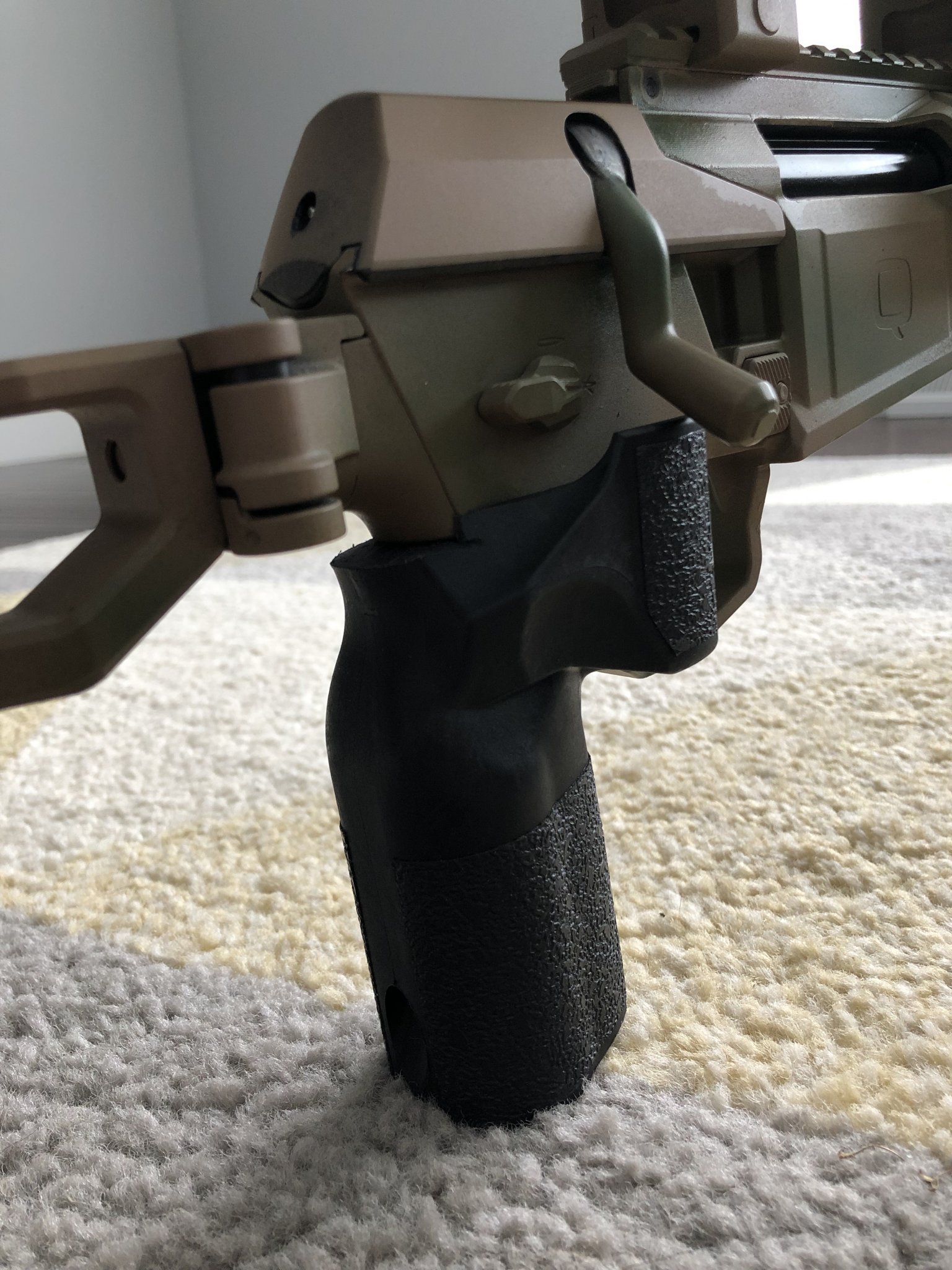

Here’s some shots of the vert grip. I like it a lot. Had to trim the back strap a bit and I may take off like 1/8” from the finger rest but the grip is amazing ????

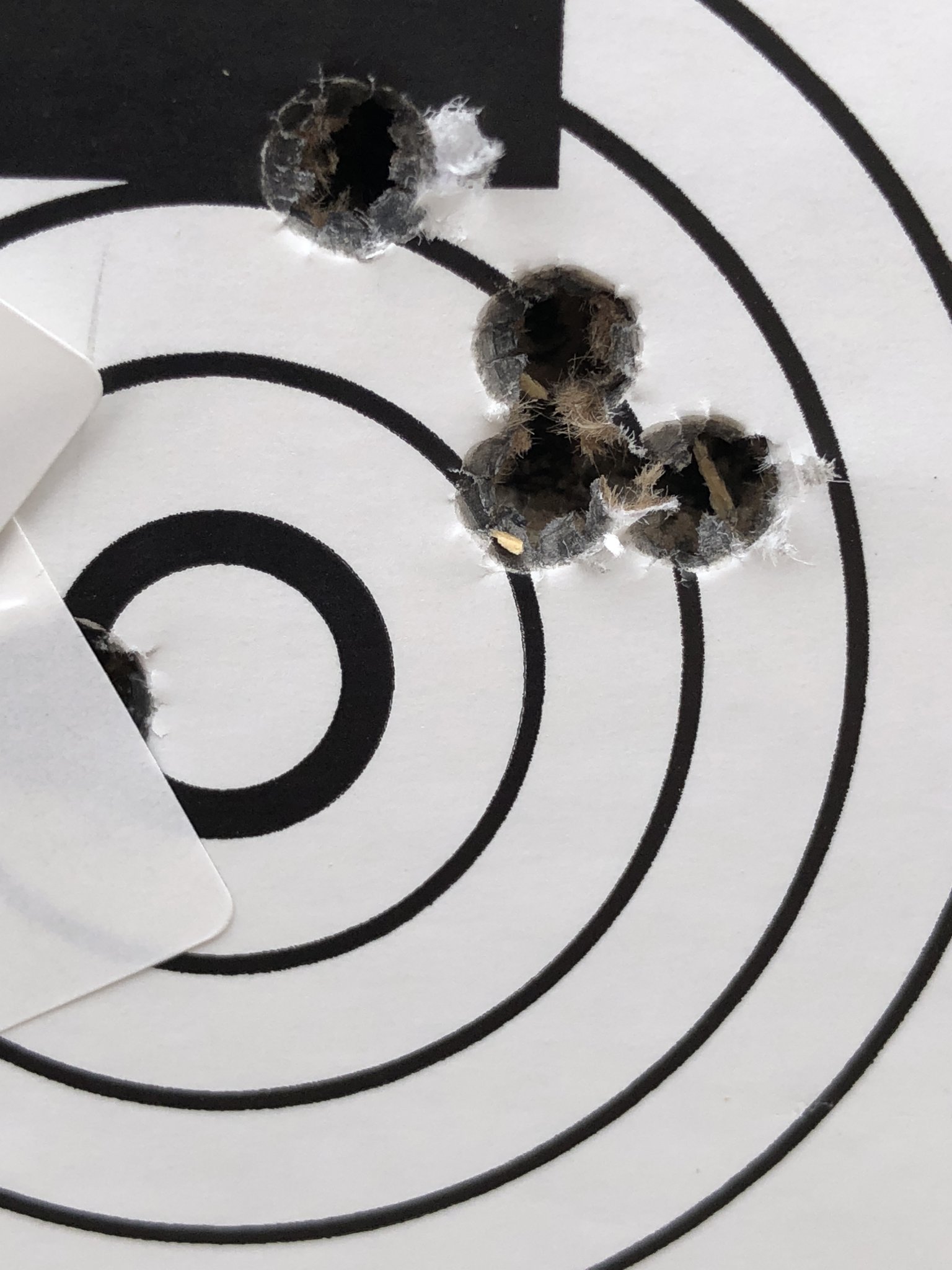

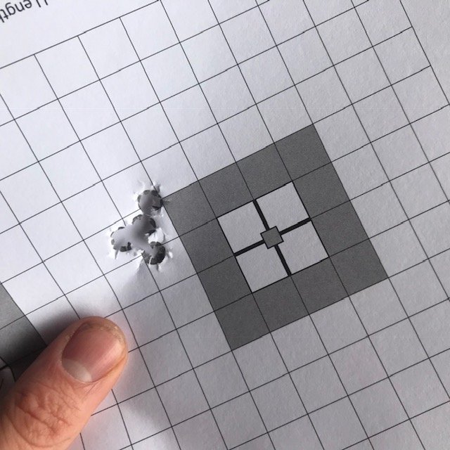

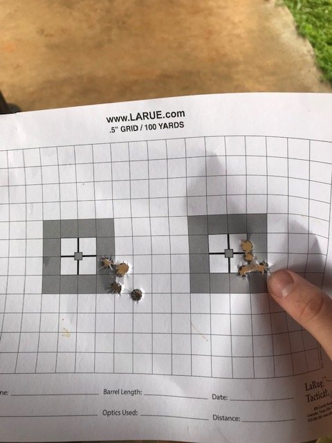

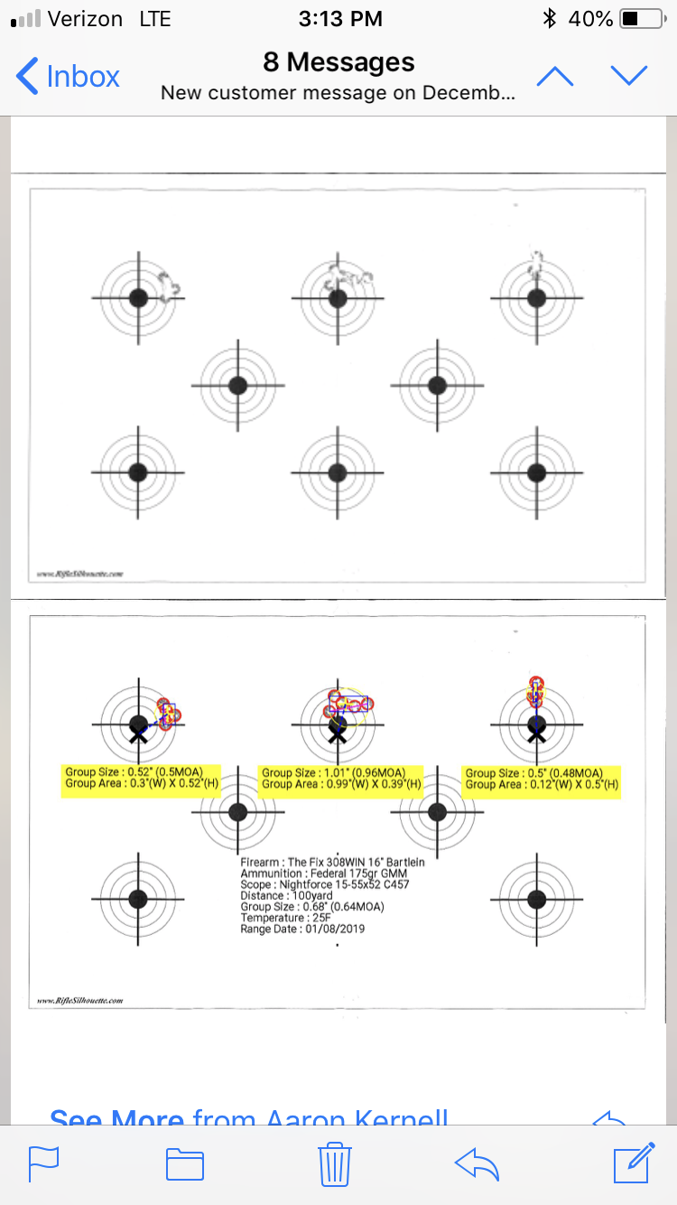

Alright so I am going to have to eat my words on the accuracy. Actually got the scope rings torqued to 30 in/lbs (i think they were prob around 10-15) and having a properly installed scope made all the difference in the world. Shot 3 5 round groups... one with Hornady 168gr ELD-M and 2 with 175gr FGMM (shot 2 because I knew I pulled a shot in the first group... as you will *see down and to the right*). This is out of the B/T .308 16".
One thing I noticed today (what caused me to pull the shot) is that the thinner cheek rest makes it hard to lay on like you are laying on a pillow, if that makes sense. I had inconsistent pressure when i pulled the trigger and it when low and to the right.
Single group is FGMM... on the other target, it is Hornady ELD-M to the right and the FGMM with the flyer to the left . All are 5 round groups
Great to hear it was the scope/mount and now you can just get used to the rifle and actually see when you pull a shot.

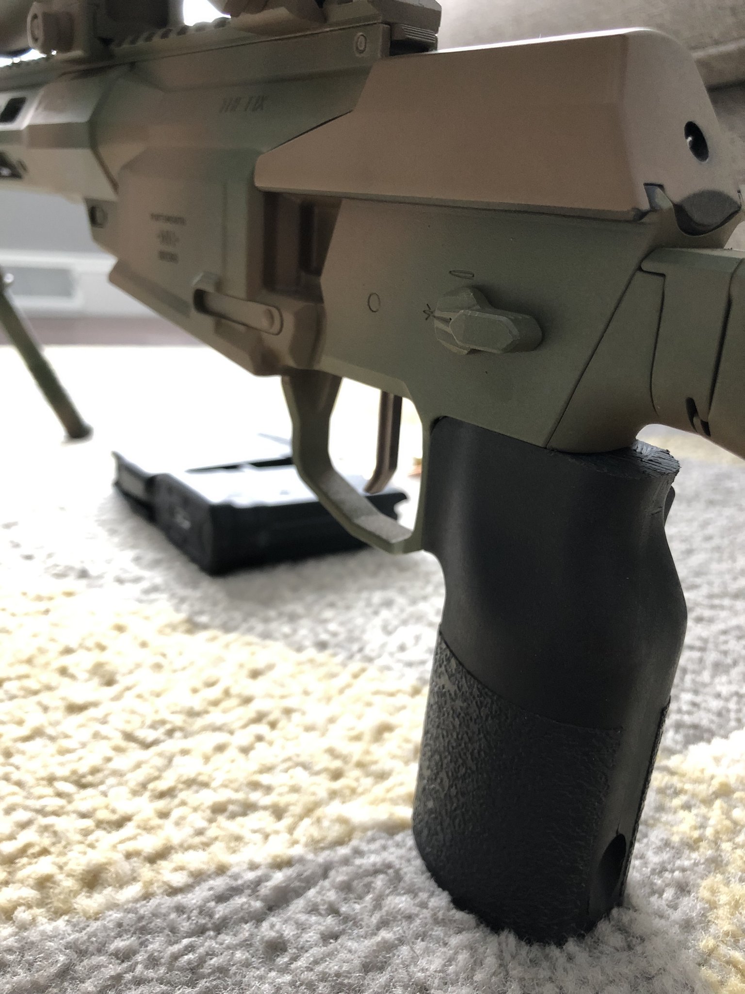

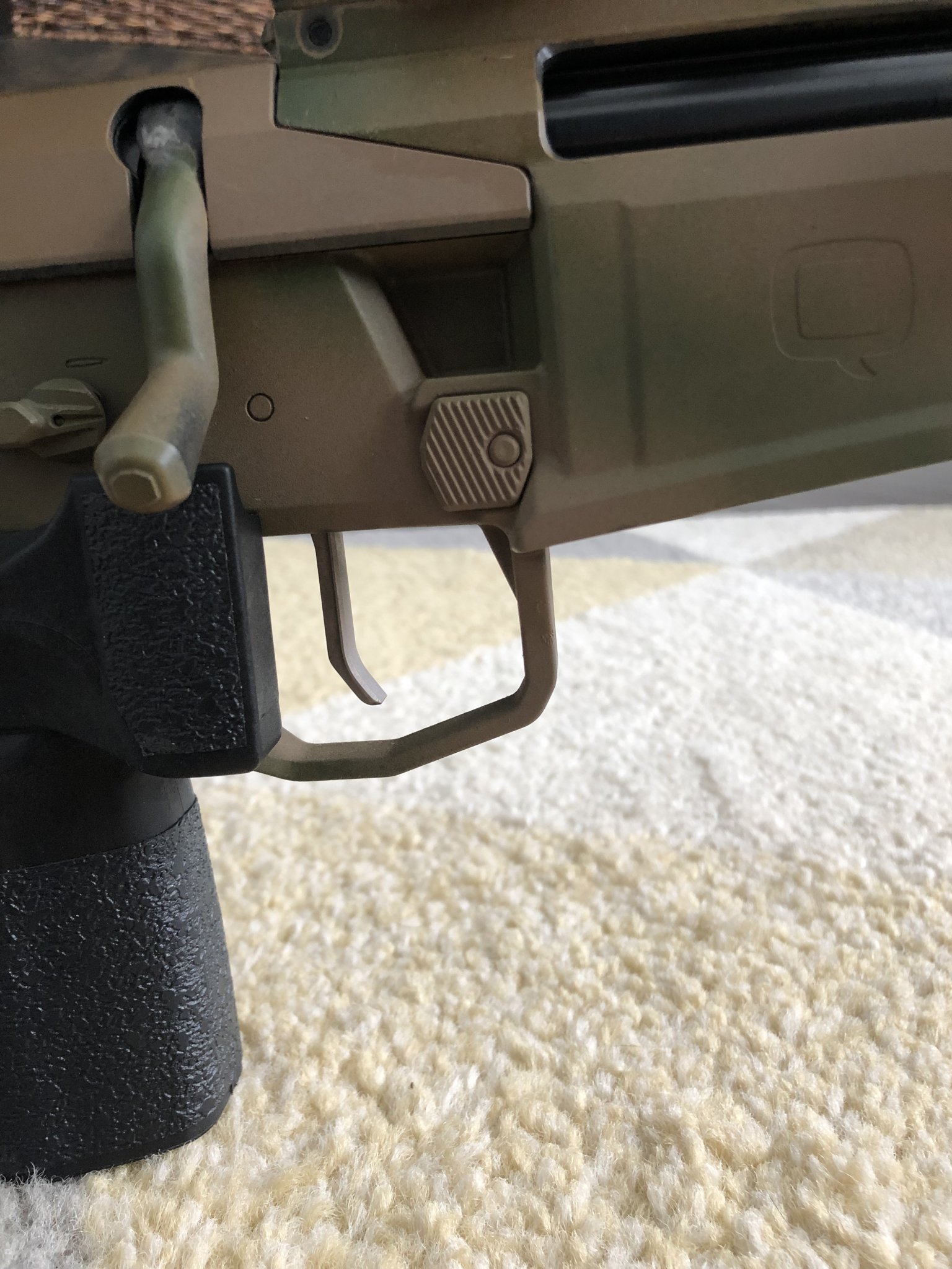

That’s a great looking setup. Maybe one day I’ll break down and paint my fix, I just don’t want to ruin the look of it if I screw up.
What is with the bulge on the grip where your trigger finger goes? Is that to promote a better trigger pull?

I think the rifle shoots fine. I still have other issues with the product itself, but I can work with those. Basically look at points 1-4 on my original report. The fix is a great design, but I feel like certain aspects of the execution fell a little flat. @newguy2k3v2 's suggestion about the velcro is excellent and I will definitely be putting that to use, but I will always have a bitter taste in my mouth from what I have seen from this Kevin guy (whether I know him or not). When one guy is calling us "fags" despite the fact we are spending thousands of dollars on his products, and another (Dave) offers to take on a nobody like myself's case, despite the fact that he has no obligation to do so, financial or otherwise, says a lot about character and who has it and who doesn't. I wish I could have lied and said it wasn't shooting well just so I could go meet the man and get the opportunity to shoot with him, but I will not waste his time unnecessarily. As I have said before, buying a good product from a shitty person doesn't satisfy me. Good products from good people. We are all on the same team here when it comes down to it and I think it is obvious that Dave Tooley understands that. I encourage people to think about not only what they are buying but who they are buying it from.
Happy you identified your problem. When good guns shoot that bad it's almost always a mechanical problem. You or anyone else is welcome to stop by. I'm a shooter and enjoy hanging out with shooters. I have 200 yds shooting out of the shop door. Out to 1200 about 6 miles away when there's no crops in the fields and I going to seriously work at finding a permanent location out 1500+ this winter.
Thank you!!
Yeah it promotes a 90 degree finger. It looks a little odd and it takes a minute to get used to, but I noticed when trying to group that my hand feels the best when it’s in the position of this grip. ????
