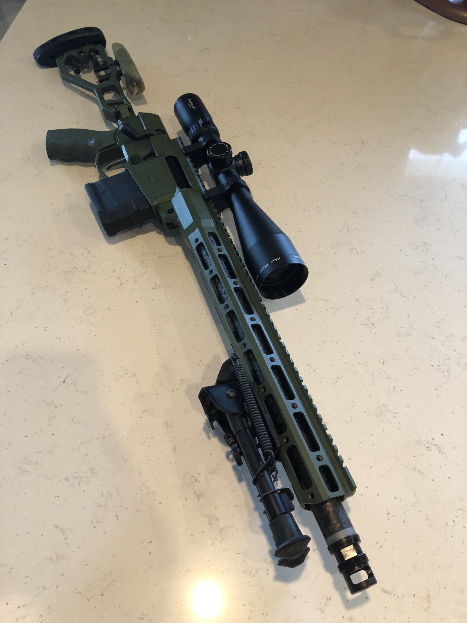

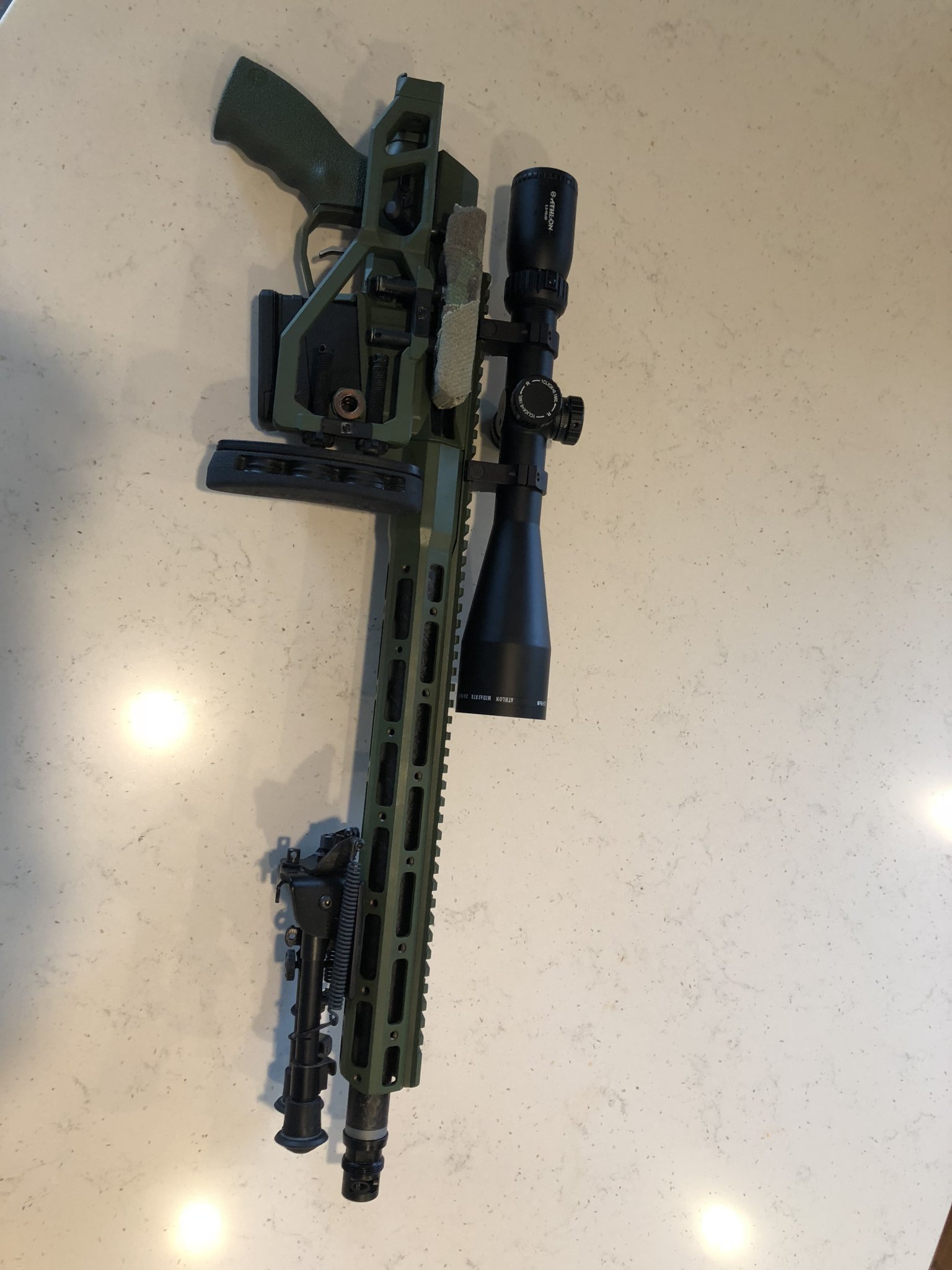

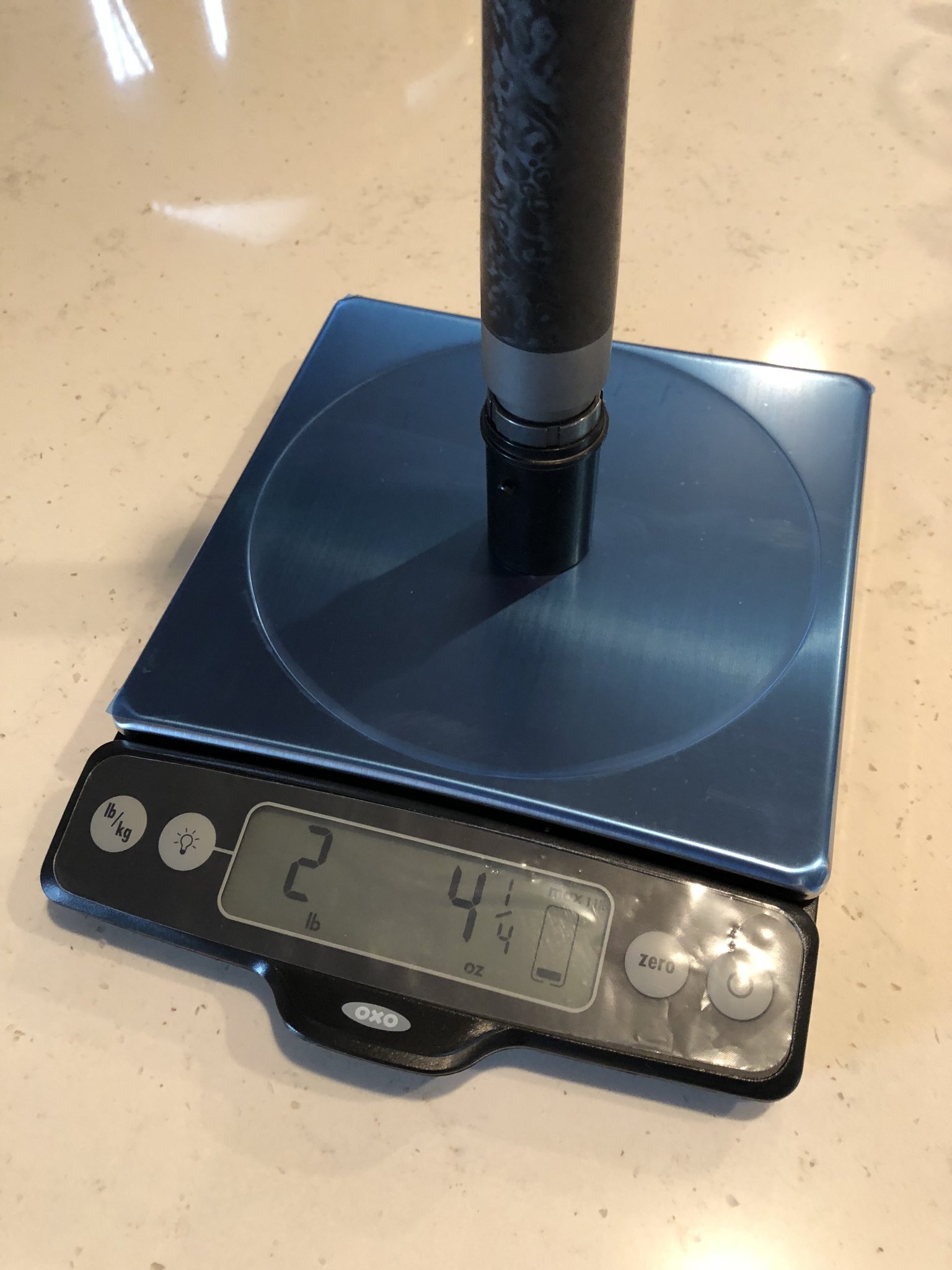

16.5 inch 6.5 Creedmoor Proof Carbon barrel wirh jam nut and extension, threaded 5/8-24 weighs 2lbs 4.25oz
Just weighed the Q 22inch 6.5 Creedmoor barrel without extension or jam nut but including the cherry bomb is exactly 3lb 9oz.

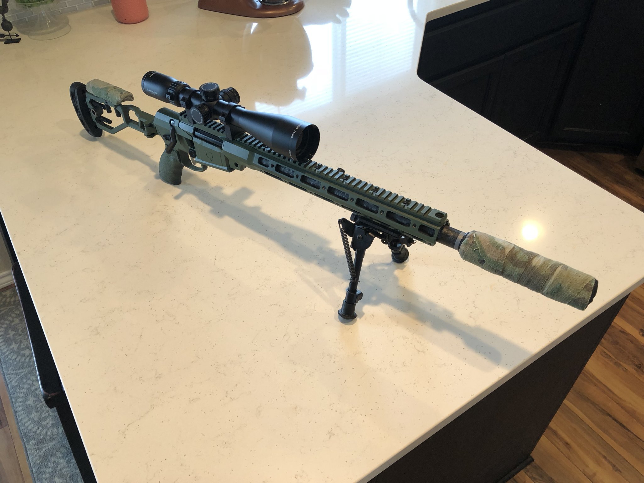

6lb 4oz without the scope bipod or mag.
8lb 2oz wirh scope and rings.
10lb 10oz with scope, rings, Harris brms bipod, suppressor and a 10 round mag of 130grn.
Bipod is worth 13oz. Scope and rings are 30oz together. Suppressor is 17oz with the brake. Mag full of ammo is 10oz.

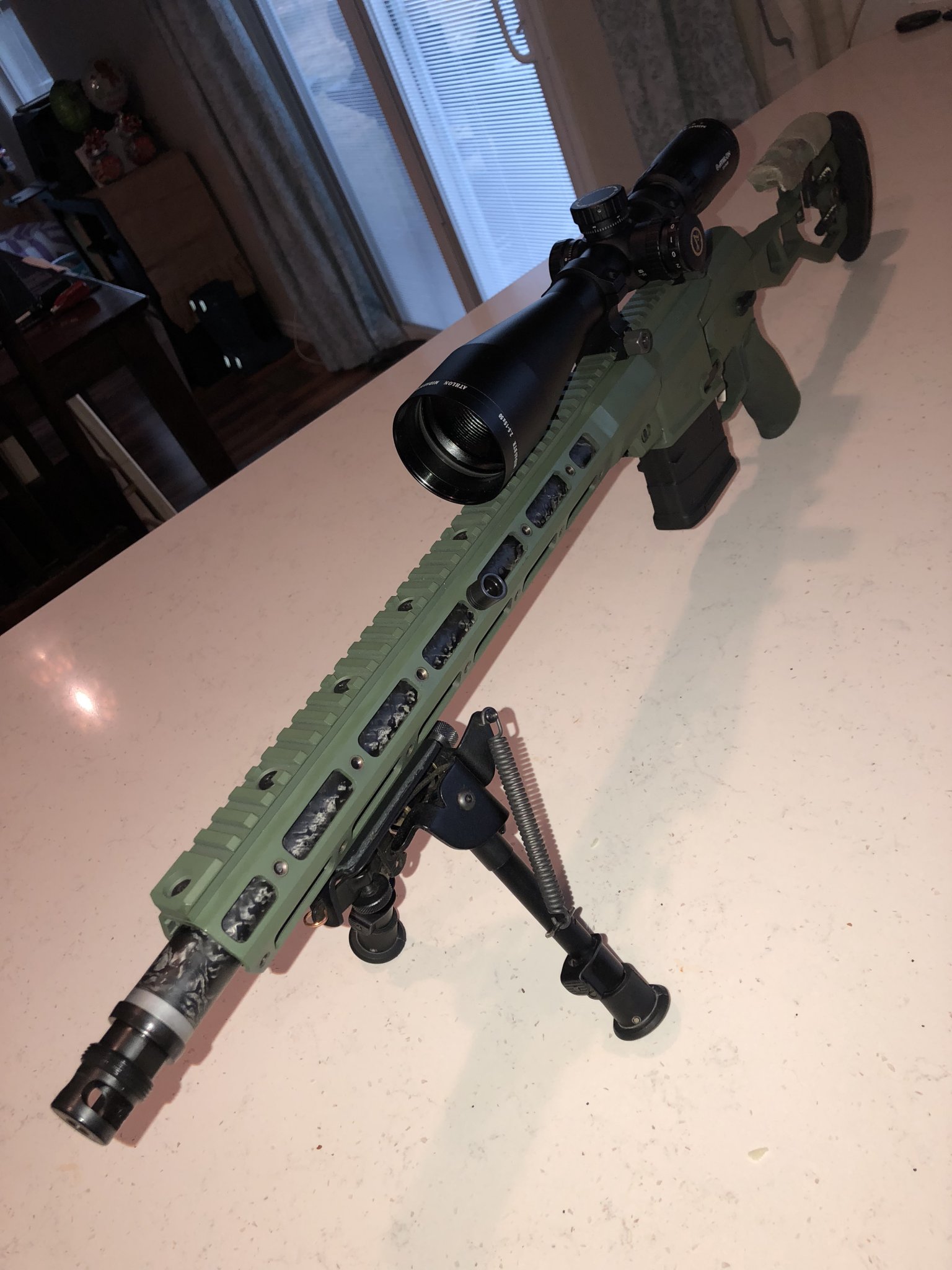

I’ll take the carbon fix barrel out tomorrow to give it a go. Can’t wait!

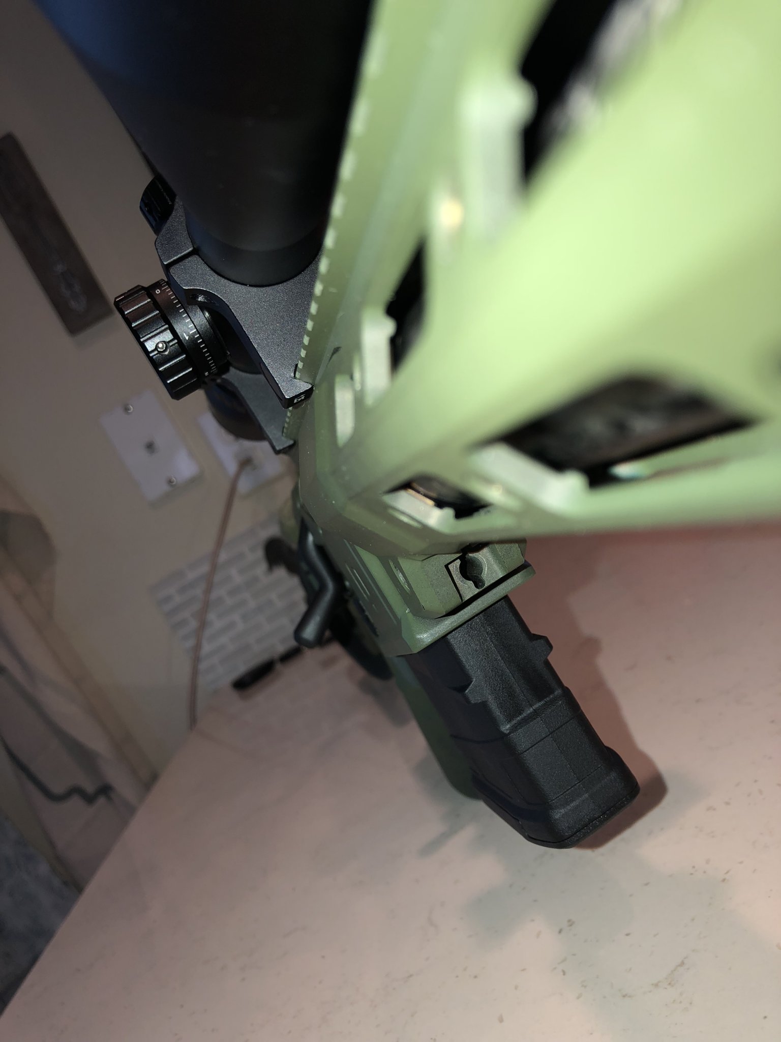

The breech is pretty tight.... but the gap is big enough I can make my iPhone pick it up. It looks a lot bigger in person (the gap looks bigger) @redneckbmxer24

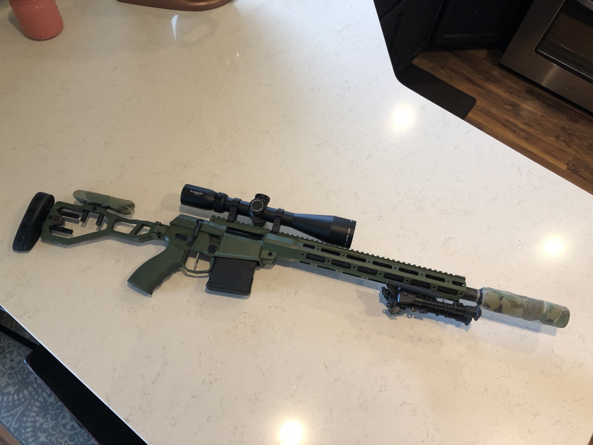

my gun is 11.5 pounds
22in creed
mark 5 with sphur mount
Atlas bipod
Trash panda suppressor
Pretty snug but shouldn't cause any issues. That shorter length really accentuates how thick those barrels are. I think I am going to go the 24" 6.5 Proof route as soon as I have the funds and extensions are available, unless a better offer surfaces in the meantime. @redneckbmxer24 what are the chances that your people can make extensions that would work for these rifles?
